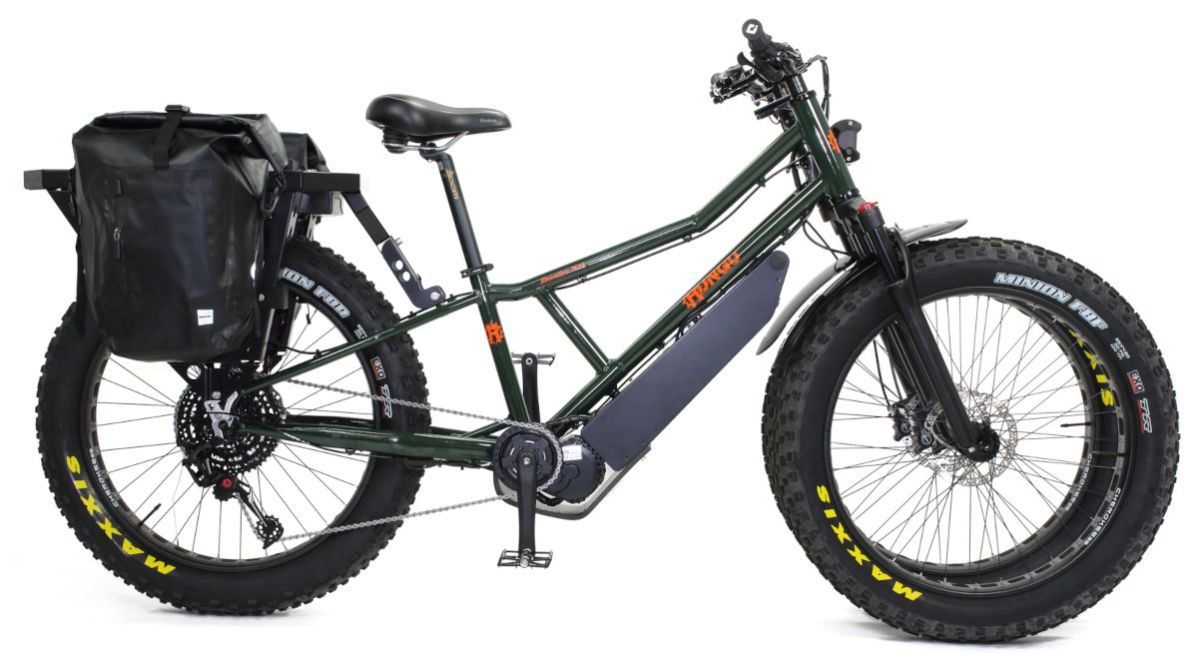

26” Wheels

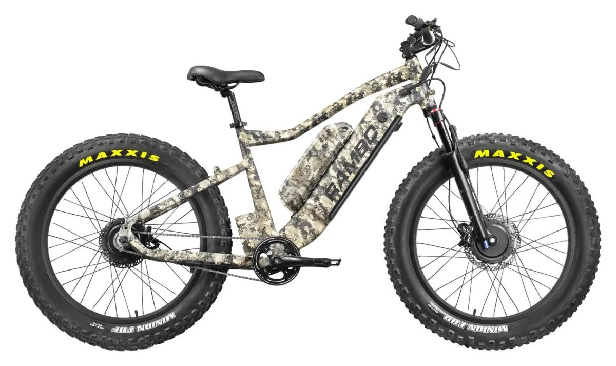

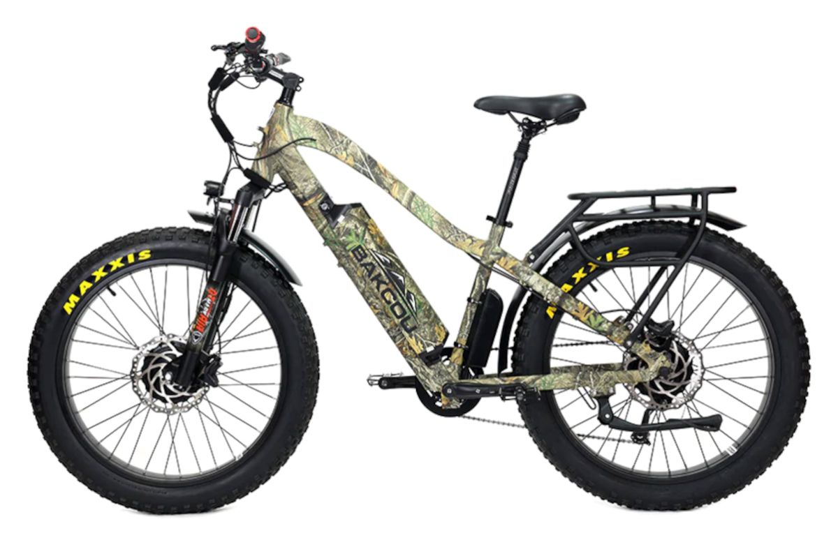

The vast majority of electric huntbikes are built with 26” wheels and 4.0” wide, go-anywhere tires.
26” wheels used to be the standard on ordinary mountain bikes. It is now an obsolete MTB size, having been superseded by 27.5” or 29” wheels, which can reach higher top speeds.
When 26” wheels are wrapped with huge tires, their diameter equals that of many larger wheels. For this reason, they have become the most common size on all fatbikes, including huntbikes.
Take note: Almost all huntbikes are electric fatbikes but not all electric fatbikes make good huntbikes.
27.5” Wheels

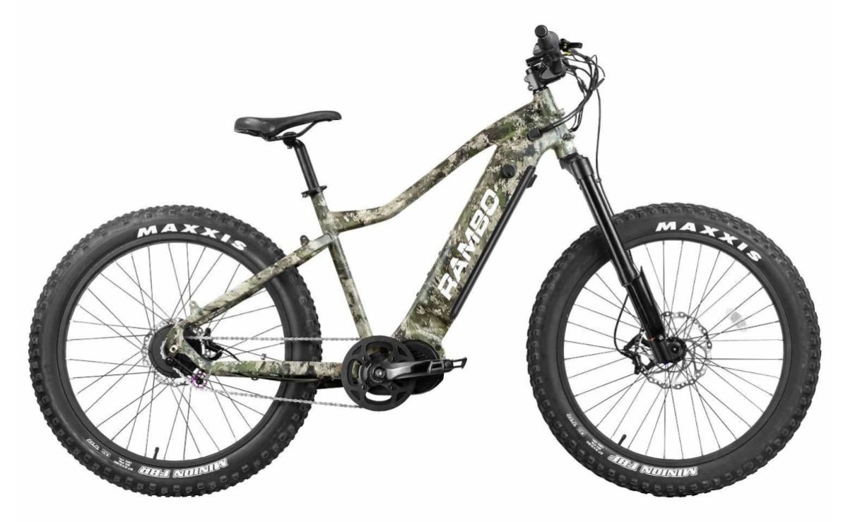

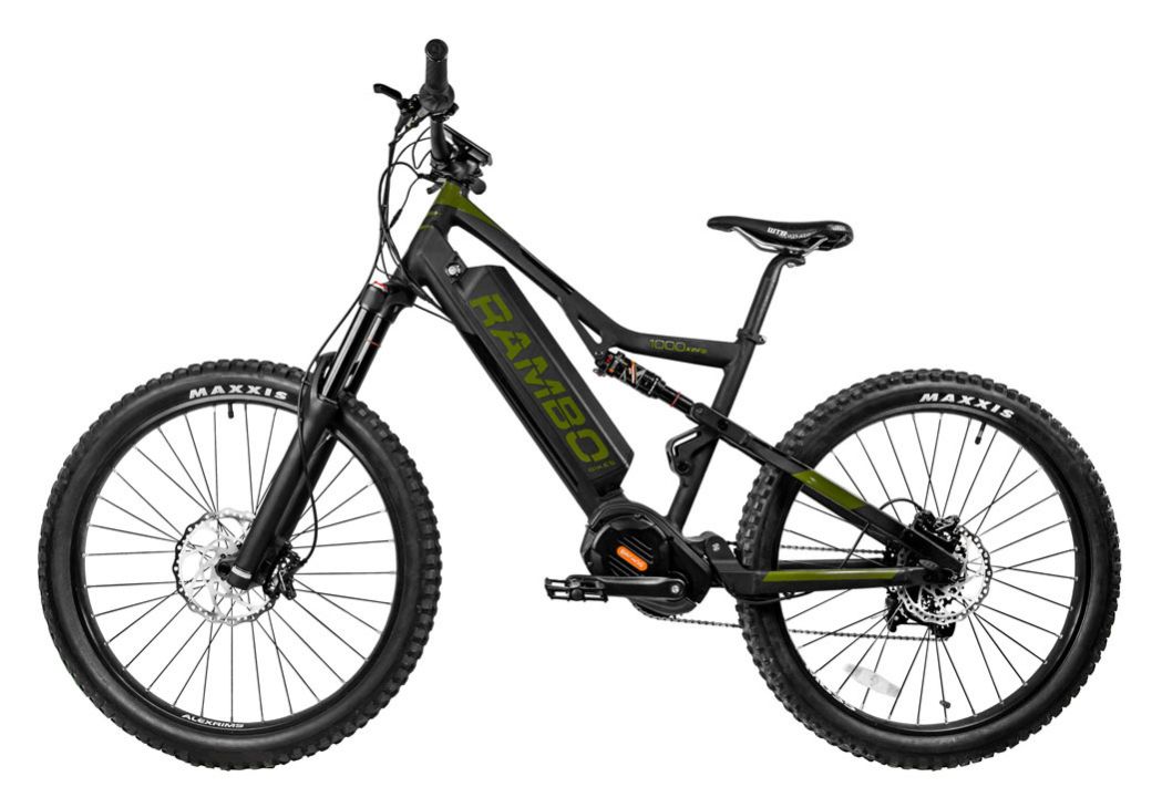

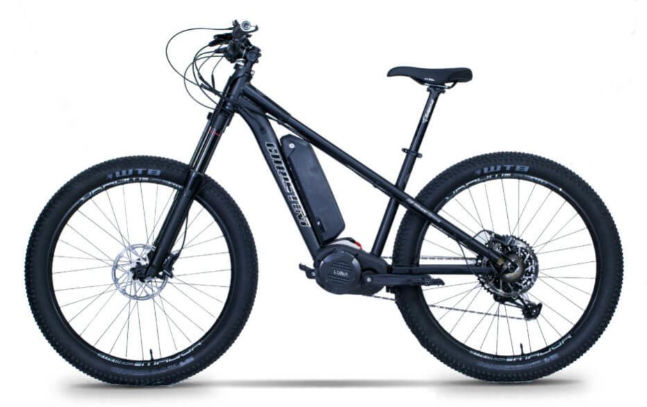

Some huntbike-oriented manufacturers offer full-suspension bikes with 27.5” wheels and ‘plus-size’ 2.8” wide tires. This combination can supply a comfort level comparable to that found on 26” bikes with 4.0” wide tires.
Full-suspension bikes with the 27.5”×2.8” tire combo can be found for less than $1500 up to around $7000:
- Eunorau UHVO: An entry-level option running on a 36-volt system.
- Eunorau Specter-ST: Mid-priced, 1000W mid-drive, step-through.
- Eunorau URUS: 500W mid-drive, e-MTB-oriented.
- Rambo Rampage: 1000W mid-drive option at a premium price.

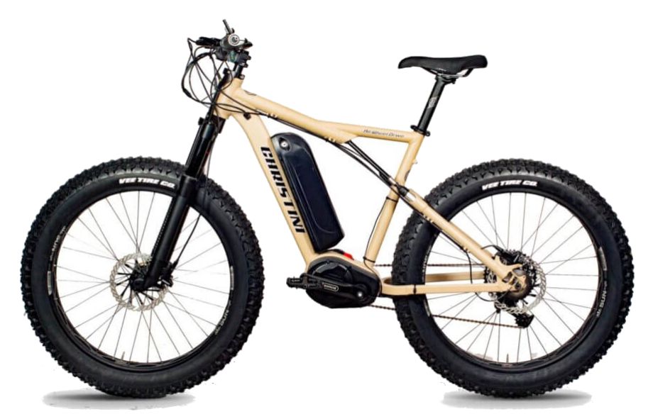

For less than $6000, true all-wheel-drive bikes with 27.5” tires become available:
- Christini AWD Fat E-4: An intrepid adventure/huntbike with 4.0” wide fat tires.
- Christini AWD 27.5+: A hardtail E-MTB with 2.8” plus-size tires.
True-fat 27.5” tires are an uncommon and specialist option that will add significant cost to the price of your new huntbike, but they roll faster than 26” options.

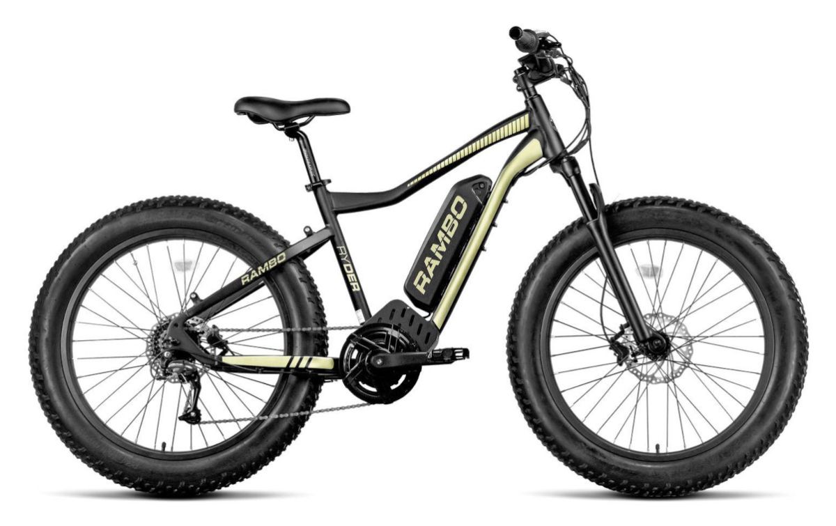

Some hunting-focused e-bike brands have one or two models available with 24” wheels. This allows the manufacturer to build a smaller-framed bike that’s suited to shorter, smaller and/or younger riders.
On at least one model, the ‘Small’ size uses 24” wheels while larger sizes have 26” wheels.
24” huntbikes are available at various levels of quality, from around $3000 up to almost $6000. Some examples:
- Rambo Ryder: 750W mid-drive – 24”×4.0” tires.
- Quietkat Ranger: 750W or 100W hub motor – 24”×4.0” tires on size ‘Small’ only.
- Bakcou Flatlander ST 24: 750W hub motor Step-Through – 24”×4.0” tires.
- Bakcou Mule ST 24: 1000W mid-drive Step-Through – 24”×4.0” tires.

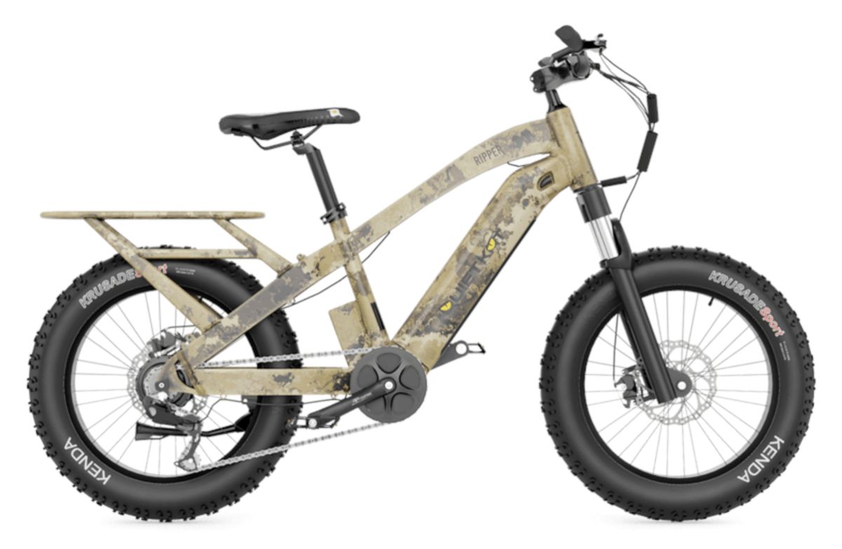

One huntbike-specific manufacturer makes a little camo huntbike for kids. Just like other kids’ bikes, it has 20” wheels, the same size as a BMX… but with 4.0” wide balloon tires:
- Rambo Ripper: 500W hub motor – 20”×4.0” tires.

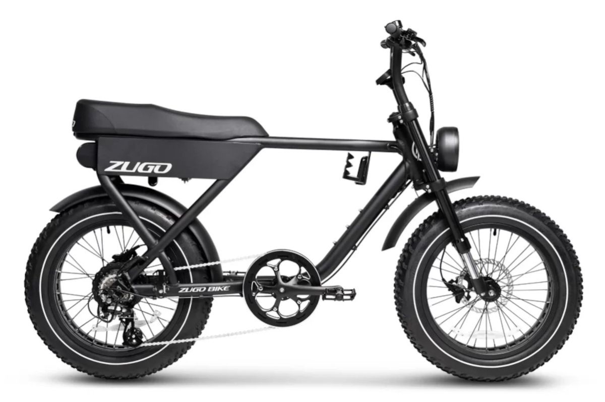

- Zugo Rhino: Moped – 750W hub motor – 20”×4.0” tires.

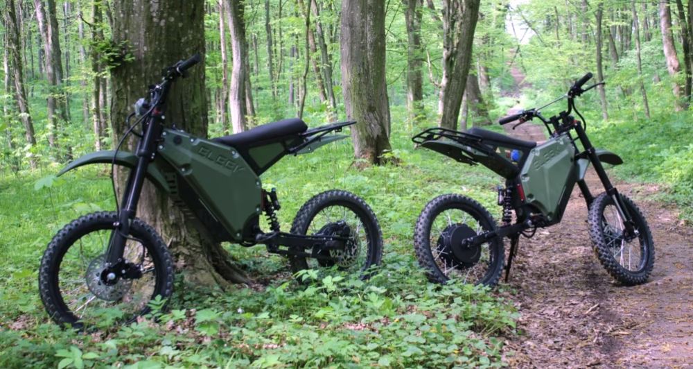

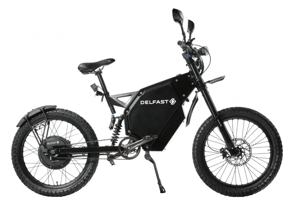

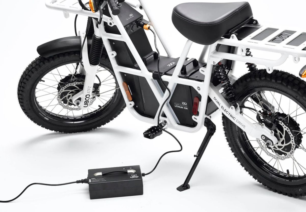

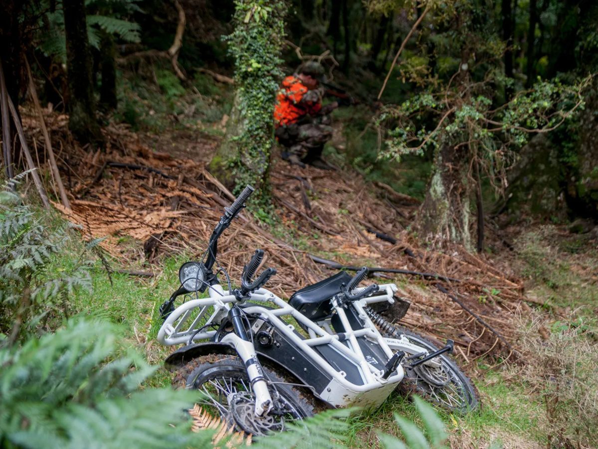

17” to 19” Wheels
These wheels are specced on vehicles that could be more accurately described as off-road ‘electric motorcycles’ or at least as ‘electric mopeds’. They are well-suited to hunting.
Like non-electric motorcycles and mopeds, they use smaller-diameter wheels to increase maneuverability and decrease wind-resistance at higher speeds.
The tires on these ‘e-bikes’ are not as fat as those found on regular electric huntbikes. With more power and battery available, they can be equipped with heavier-duty suspension to compensate for fat-tire comfort. Traction is boosted by a more-powerful motor.
On the options that are practical for use as an electric huntbike, tires are 2.75” wide:

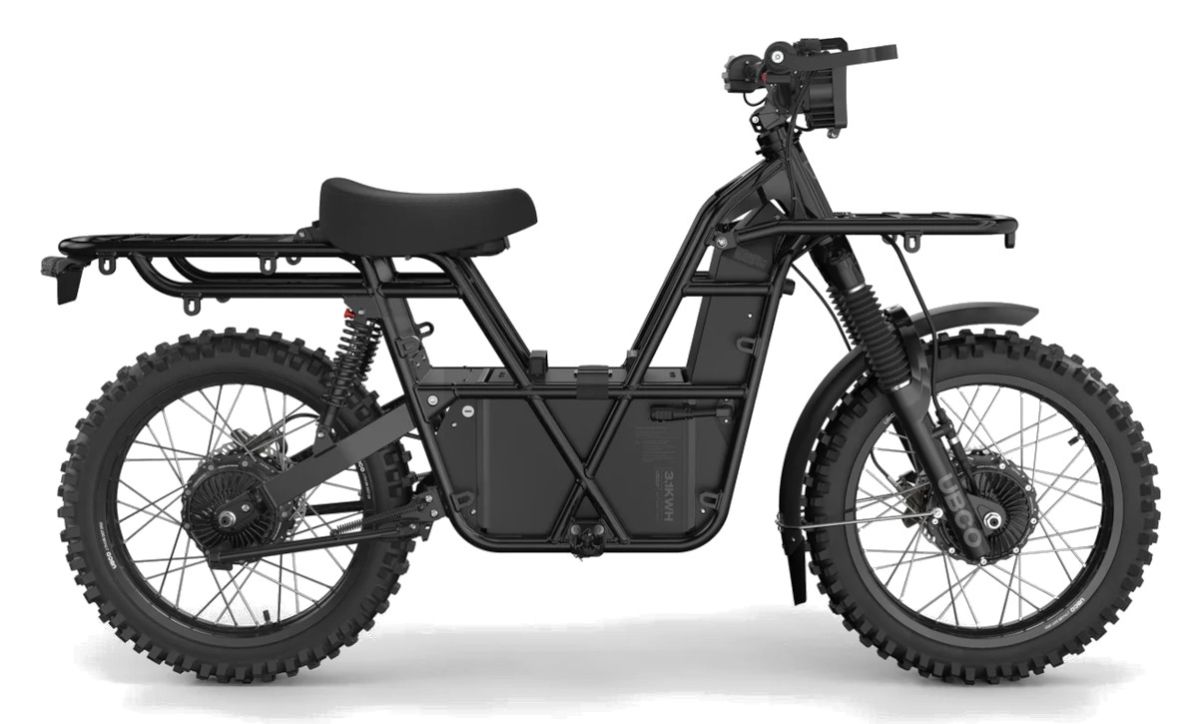

- 17″ – UBCO 2×2 Work: Motorcycle – Dual 1000W×2 hub motors – No pedals.
- 19″ – Delfast Top 3.0/3.0i: Moped – 1000W hub motor – 72V – With pedals.

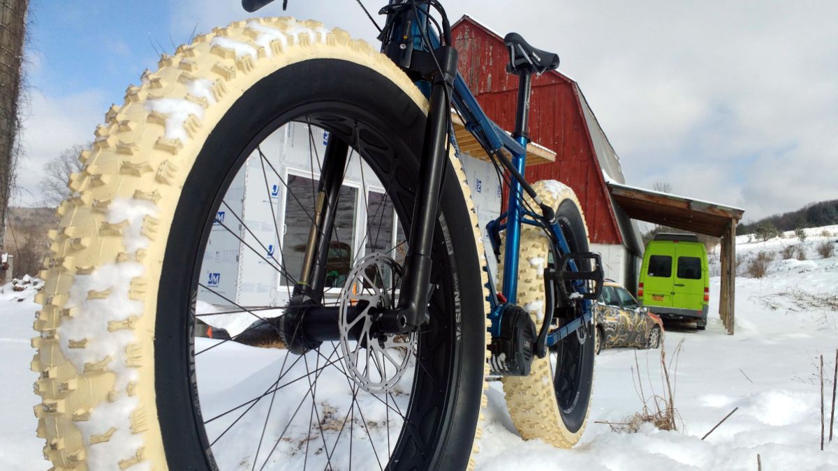

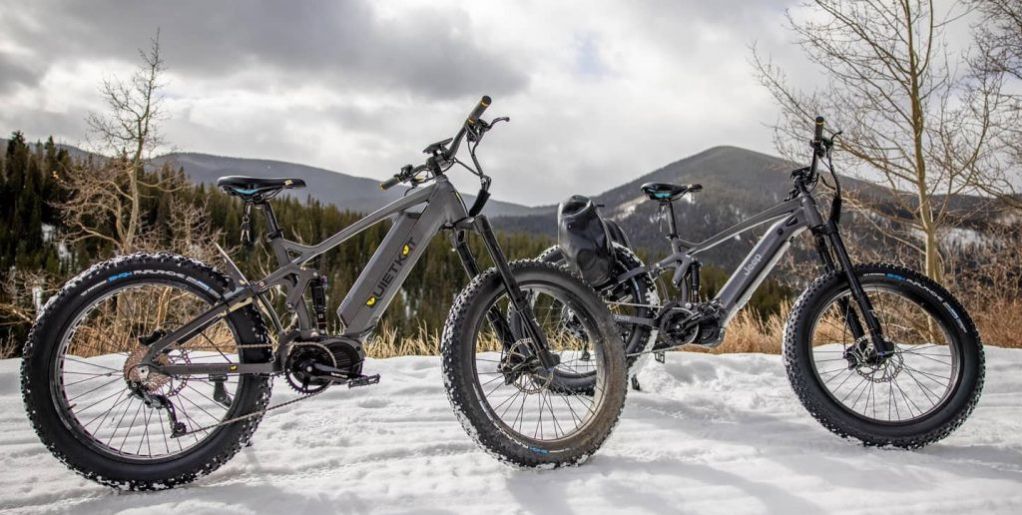

Most huntbikes are fatbikes (or ‘fat-tire bikes’). ‘Fat’ tires are loosely defined as being 3.8” or wider. The huntbike standard is 4.0” wide tires on a 26” wheel. This accounts for most new electric huntbikes right now.
When it comes to fatness, 4.0” is plenty wide. This huge footprint allows you to ride over loose sand, mud, snow or dirt, in addition to rocks, sticks and debris.
Fat tires are run at much lower pressures than on-road tires, which gives them the ability to act as suspension while absorbing bumps and rolling over uneven surfaces.

- Rambo Prowler
4.0” Inch:
Full-Suspension Bikes With ‘Plus-Size’ Tires
As previously mentioned, these bikes may tackle similar terrain to fat-tire bikes, in similar comfort, thanks to increased suspension. New full-suspension bikes are available with 27.5” tires in these widths:
2.8” Inch:
- Rambo Rampage
- Eunorau URUS

- Lower-Power Moped: Zugo Rhino – 4.0” wide tires.
19” and 17” Inch Tires
As discussed above, electric motorcycles and mopeds use smaller wheels and narrower tires than electric fatbikes. With their extra power, they should have no trouble traversing the same rugged terrain that can be ridden on a fatbike with 26”×4.0” tires.
There are a couple of options that fit the purposes and price range of a prospective electric huntbike buyer. They all use 2.75” wide tires:
19” Wheels – Electric ‘Mopeds’
These beasts have pedals, but it can’t be guaranteed that they are there for more than decoration:
- Delfast 3.0
- Delfast 3.0i
17” Wheels – Electric Motorcycle
Despite being less powerful than some ‘mopeds’ (Delfast), these machines have no pedals:
- UBCO 2×2

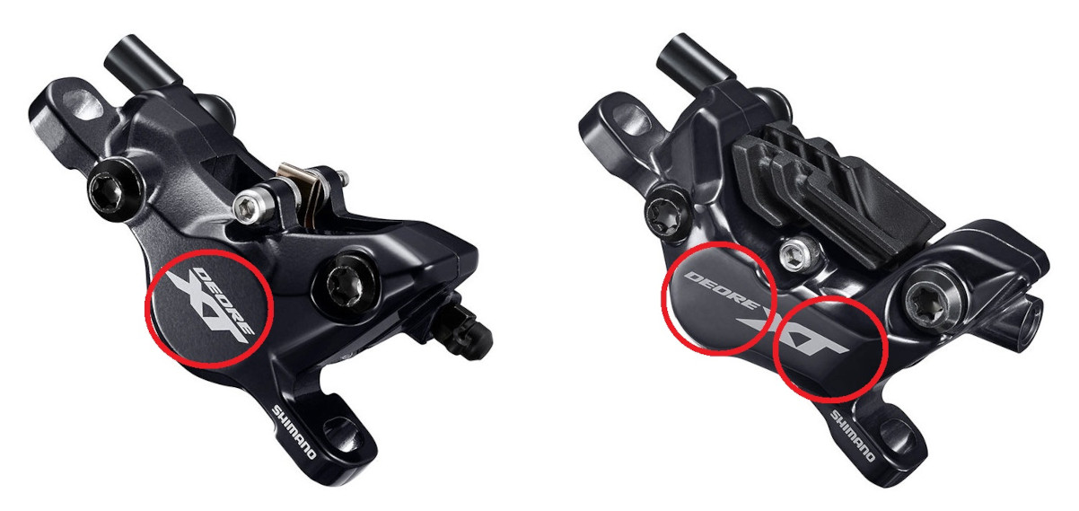

Number of Pistons
Hydraulic brakes may use two or four pistons per caliper. If ‘number of pistons’ is unlisted, you can assume the number is ‘two’.
A four-piston model applies two pistons to each side of your brake rotor. The extra surface area creates more friction and greater stopping power. For many hunters, two pistons may well be enough. If you, your cargo or your bike are ultra-husky, you’ll seek four-piston hydraulic disc brakes.
Regardless of whether you really need them, it’s important that you don’t rip yourself off. If you’re shopping in a price range where four-piston brakes are the norm, make sure you get them.
Most entry-level mechanical disc brakes are single-piston affairs. If a bike doesn’t specify the number of pistons in their mechanical disc brakes, you can assume they’re single-piston. Dual-piston brakes are superior but rare on low-priced huntbikes.
Below $3000, huntbikes are equipped with two-piston hydraulic disc brakes. From $3000 to $5000, about half of all new huntbikes are offered with four-piston options. From $5000 to $7000, you should expect them. Above $7000, all huntbikes use them.
Rotors
There are three sizes of disc brake rotor specced on off-road bikes:
- 160 mm
- 180 mm
- 203 mm
Larger rotors provide greater stopping power. Smaller 160 mm rotors need to work harder.
The lowest-priced huntbike options may use 160 mm brakes, which are present on two e-bikes with small 20” wheels. Both bikes are under $2000 and have been used for hunting but are not intended solely for this purpose.
At least one e-bike with full-size wheels is equipped with these small 160 mm rotors. An off-road bike with 26” wheels and 160 mm rotors is under-specced and should be avoided.
Dual 180 mm rotors are standard on huntbikes under $3000 and are capable of doing a sound job. Above this price, you’ll find huntbikes with rotors that are either:
- 180 mm front and rear.
- 203 mm front and rear.
- 203 mm front / 180 mm rear combination
(because most braking power is required at the front brake).
Obviously, you’re getting more bang-for-your-buck with two 203 mm rotors or a 203/180 mm setup. All huntbikes above $7000 should be fitted with at least one front 203 mm disc rotor.

Electric motorcycles and mopeds are in another weight range to most huntbikes. They are fitted with robust steel frames, huge batteries and big (or dual) motors. This helps them to ride faster, further and with a bigger payload.
Additionally, on an e-motorcycle, a rider can not contribute pedal-power. Here are some examples:
- UBCO 2×2: 140 lb to 156 lb (electric motorcycle)
- Delfast 3.0i: 154 lb (electric moped)

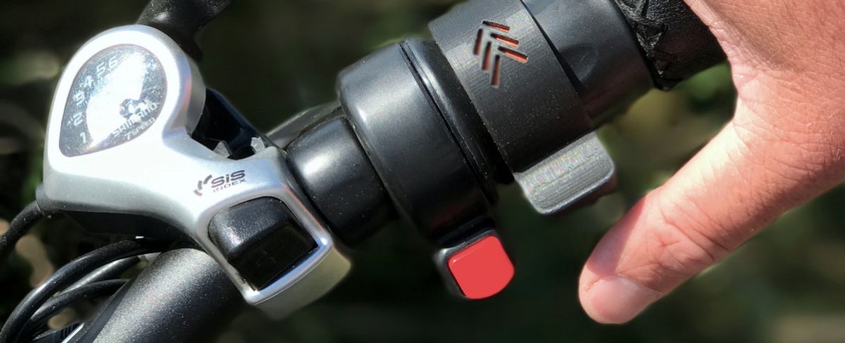

Throttle Only
Most huntbikes are large and heavy. As a hunter, you’re probably hauling a lot of kit and cargo, so you will want access to a throttle. This will give you the ability to accelerate from a dead stop, when initiating pedaling is too much of a strain.
Most huntbikes feature a throttle that is activated by a thumb-switch, button or grip-shift. This allows you to accelerate without pedaling.
Many of these bikes also feature multi-level pedal assist options. Keep in mind that working the throttle unassisted will drain the battery fairly quickly.

Batteries
Many first-timers aim for a huge battery, in an effort to cover the longest possible ride. The problem here is that large batteries add considerable weight. This extra weight slows you down and requires more power to overcome, creating a Catch 22 situation.
In any event, ‘slightly more battery capacity than what is needed’ is a good yardstick.
48 Volt Batteries and Systems
Most huntbikes are specced with a 48V battery and electrical system. This means they use a 48V battery (or two in dual battery setups), 48V controller and 48V motor. From around $3200, 48V dual battery bikes become available.

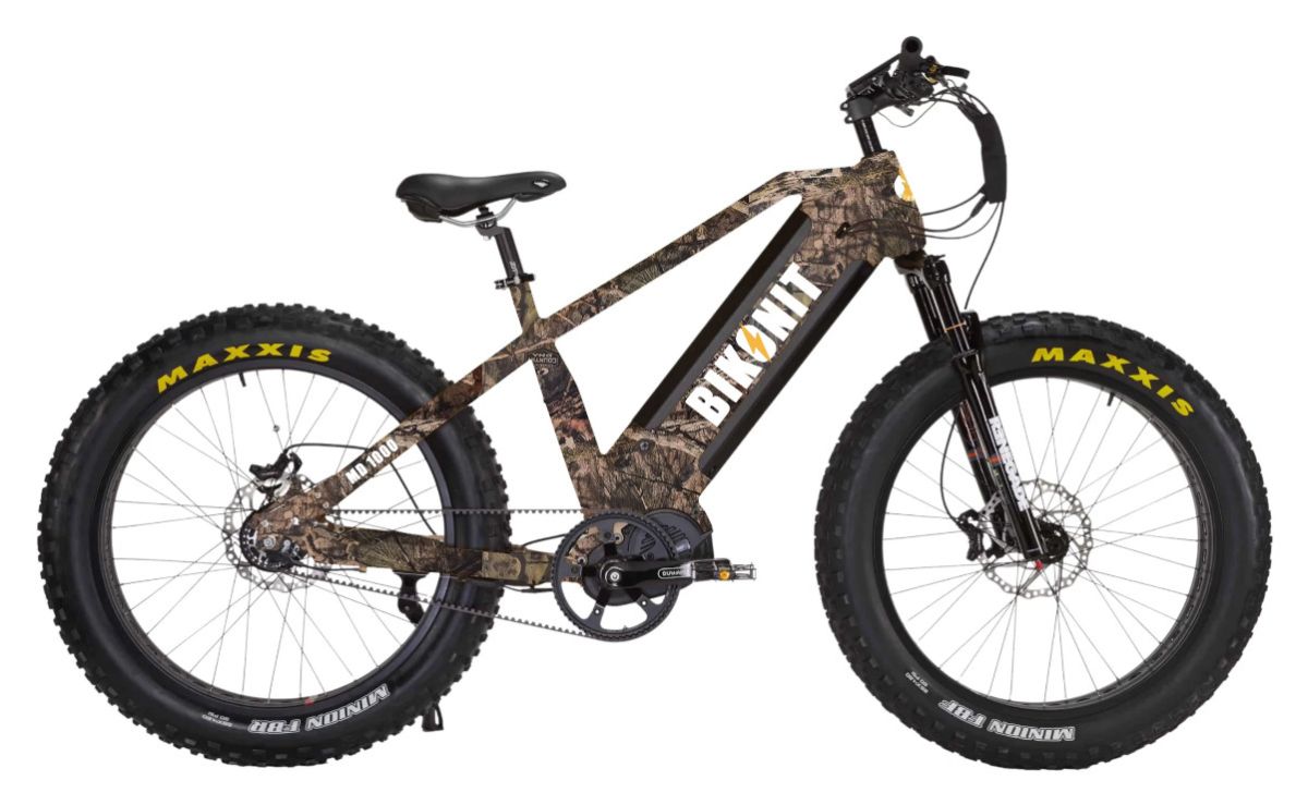

- 48 V 30Ah (15 Ah[×2]) – 1.44kWh – Mid-Drive (750W) (Bikonit Warthog MD 750)
- 48 V 30Ah (15 Ah[×2]) – 1.44kWh – Mid-Drive (1000W) (Bikonit Warthog MD 1000)

Hub Motors
Hub motors are situated within the hub of an e-bike’s rear wheel.
On new huntbikes, rear hub-driven motors are the most common and affordable option. Front-wheel-only hub motor bikes present safety concerns and are now mostly obsolete.
Dual hub-motor, all-wheel-drive huntbikes are available from multiple manufacturers. These feature a hub motor in both the front and rear wheels.
Benefits
- Hub motors are usually the cheaper option.
- As a reliable, self-contained system, they require minimal maintenance.
- If your chain breaks, you can ride home solely on the power of the electric hub.
- If your hub motor fails, you can pedal home using your bike’s drivetrain.
- Hub motors put less stress on your bike’s other gearing components.
Things to Consider
- Hub-driven systems can overheat on long, steep climbs.
- They’re heavier than mid-drive options.
- Tire changes can be complicated, involving disconnecting motor wires.
- Direct-drive motors don’t have any internal gears.
- Geared hub motors have a single gear ratio.
- Having a heavy hub motor on the rear wheel can imbalance an e-bike.
- Spokes are more likely to break, due to the weight of the hub in the wheel.
- The width of a hub motor may limit cassette gears to seven speeds.
- Tire widths are limited by the rim that’s attached to the hub motor.
- Hub motor cadence sensors may result in lurchy or awkward motor timing.
Hub-Driven motors offer maximum assistance for less pedal effort. This suits senior riders or those with a disability, as well as anyone seeking physical rehabilitation for an injury. But they’re also great for anyone who’s a less-experienced or less-frequent cyclist. If you’re a new rider or returning to cycling, a hub-driven e-bike may be for you.
Mid-Drive Motors
Benefits
- A central location leads to even weight distribution on your e-bike.
- They tackle steeper hills for longer than a hub motor of similar power.
- Riders generally report a smoother ride quality.
- They are typically lighter and smaller than a hub motor of comparable power.
- Direct pedaling input leads to more range, especially across climbs.
- Tire changes are unaffected by mid-drive motors.
- A torque sensor accurately meters out assistance according to pedal power.
- More open to different set-ups that use standardized bike components.
Things to Consider
- They are usually the more expensive option.
- These motors depend on more rider input, through pedal-power.
- Mid-drives wear harder on chains and cassettes.
- They are more complex and require more maintenance than hub motors.
- Some brands don’t offer repair options outside of warranties.
Mid-Drive motors suit riders who want an engaged ride with full access to their bike’s range of gears. They are the preferred option for experienced cyclists. Riders who know how to change gears will be able to attain an efficient ride and extend the life of a mid-drive e-bike.
You will find that a majority of higher-end and higher-priced huntbikes use mid-drive motors.
All-Wheel Drive E-Bikes
A number of all-wheel-drive (AWD) bikes are available for the prospective e-bike hunter. These can be divided into two main types:

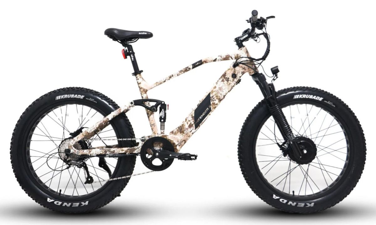

1. Dual-Motor All-Wheel Drive
These bikes have a hub motor in both the front and rear wheels. Usually, both motors are of the same wattage. In some cases, the front hub motor may be less powerful than the rear-wheel hub motor.
As you can imagine, two motors use more battery. It’s important that the manufacturer tunes the bike so that output is well-balanced and/or synchronized between the two motors.
There are a number of dual-motor e-bikes available from specialist hunting e-bike brands, starting at around $1700. Generally, as price increases, so too does power:
- 250W (Front) + 350W (Rear): Eunorau FAT-AWD
- 500W (Front) + 500W (Rear): Bakcou Kodiak AWD
- 500W (Front) + 500W (Rear): Rambo Krusader
- 750W (Front) + 750W (Rear): Eunorau Defender-S
- 1000W (Front) + 1000W (Rear): Rambo Megatron
- 1000W (Front) + 1000W (Rear): UBCO 2×2
The average weight of a dual-motor huntbike is 74.86 lb.
2. All-Wheel Drive – Mid-Drive Motor
These bikes are made by a specialist manufacturer that targets hardcore adventure and exploration enthusiasts. In short time, hunters and huntbike retailers became drawn to these bikes after realizing the obvious benefits they present on hunting expeditions.
These bikes use a mid-drive motor that sends pedal-power to the rear wheel. A patented system of bevel gears and drive shafts transfers power from the e-bike’s rear wheel to the front wheel, ensuring that all-wheel drive traction kicks in during slippery conditions. This allows these bikes to ride up and across especially steep inclines, as well as over slippery rocks and roots.
Due to the specialist components used, these bikes become available in the high $5000s.
They are all equipped with a 1000-watt mid-drive motor:
- 26” × 5.05” Tires: Christini Abominable
- 26” × 4.8” Tires: Christini AWD Fat E-5
- 27.5” × 4.0” Tires: Christini AWD Fat E-4
- 27.5” × 2.8” Tires and 150 mm Suspension Fork: Christini AWD 27.5+
On average, an AWD mid-drive motor e-bike weighs 64.5 lb. This is a full 10 lb less than the average dual hub motor alternative.

The UBCO 2×2 and Delfast 3.0/3.0i are the most high-powered, hunt-ready ‘e-bikes’ within our purview. The UBCO has no pedals or pedal assist and can therefore be accurately described as a ‘low-powered electric motorcycle’. While the Delfast does have pedals, these are really only present for legal reasons. Electric motorcycles and mopeds output considerably higher torque than other huntbike options:
- Average E-Motorbike/Moped: 274 Nm
Torque levels claimed by manufacturers of three-wheel bikes are a lot higher than those specced on most huntbikes.
This includes the electric motorcycles mentioned above. This is due to the increased grip, traction and weight on these bikes’ front two wheels:
- Average Three-Wheel: 308 Nm

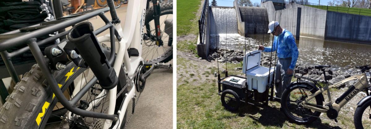

As a hunter, you can buy gear that is custom-made to attach to your e-bike and carry your equipment securely.
This includes racks or claws designed to mount your bow or gun conveniently on your huntbike’s handlebars, frame or rear rack. Fishing rod holders are also available.
Hunting Trailers and Game Bags
Bike trailers have been around for a long time. Recently though, e-hunters have become spoiled for choice with custom-built game trailers, designed to carry deer or other game.
Insulated game bags are also available. These fit within a game trailer and help to keep your kill cool, fresh and hygienic.
Some huntbikers choose to carry gear on their back. For others, this is uncomfortable, sweaty or just inadequate for the amount of gear they require. For those hunters that prefer to haul cargo in their trailer, there are a number of options available, some with their own suspension setups.

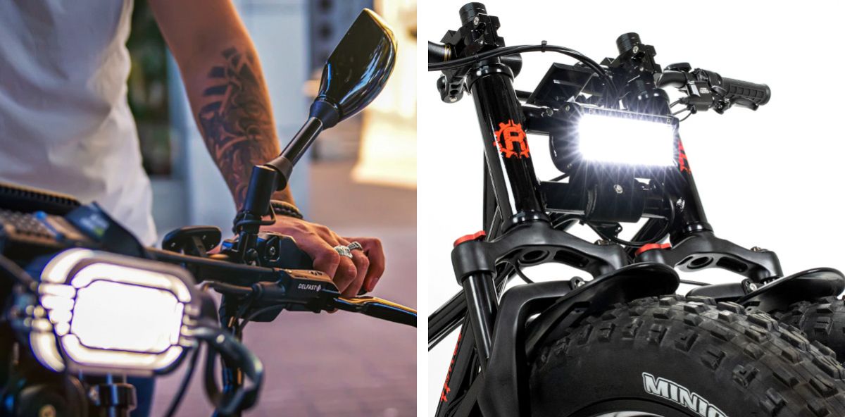

Front and Rear Lights
Ideally, your new bike comes with integrated front and rear lights. They’re wired into your e-bike’s electrical system, so they can be turned on and off via your display unit and never need to be recharged.
More than half of all new huntbikes are supplied with an integrated headlight. Integrated taillights are less common, only being fitted to around one quarter of all new huntbikes. Instead, about 10% of new, mid-priced huntbikes come with a free non-integrated taillight. These can run on batteries or be USB rechargeable. Most often, they are of average brightness. Many riders replace them quickly.
