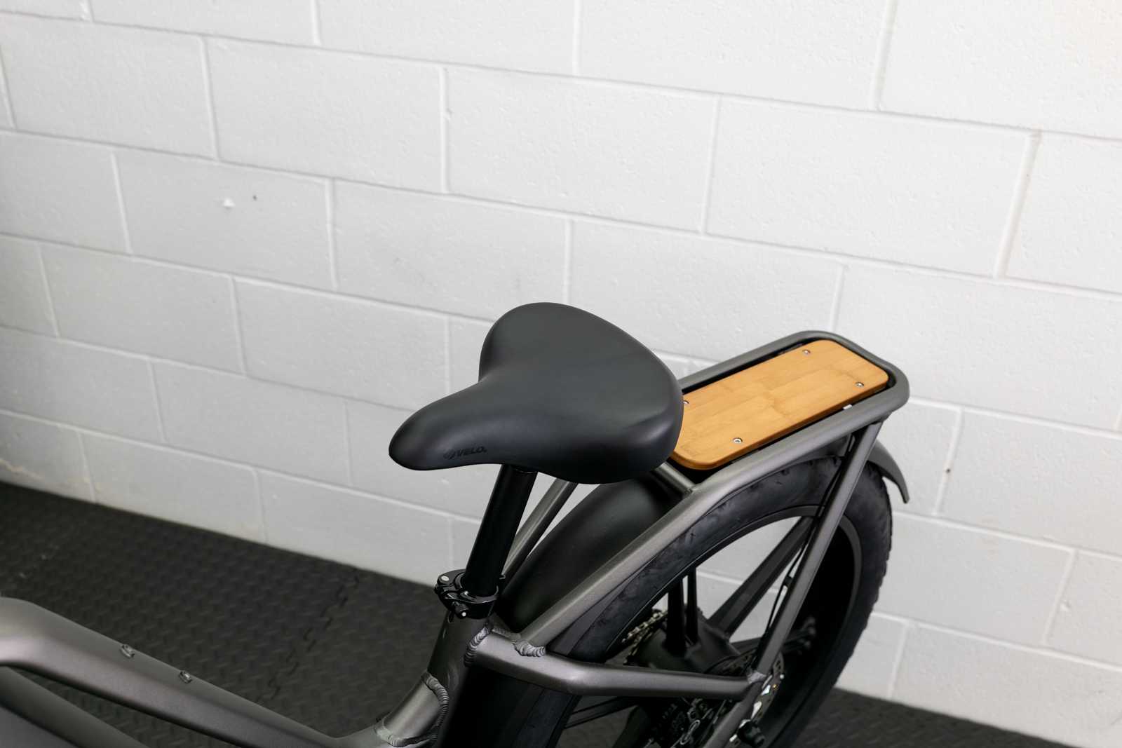

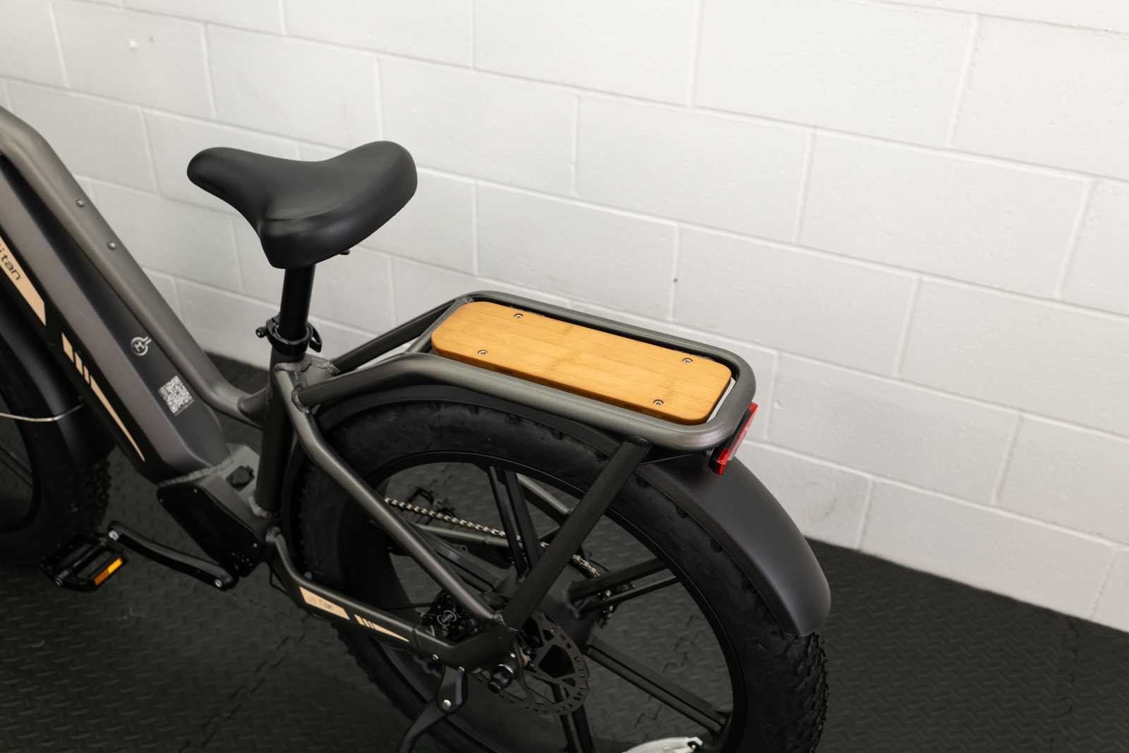

  • Welded rear rack rated for 176 lb

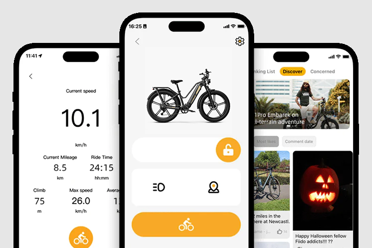

  • Confusing app and our test bike's slow keyless release

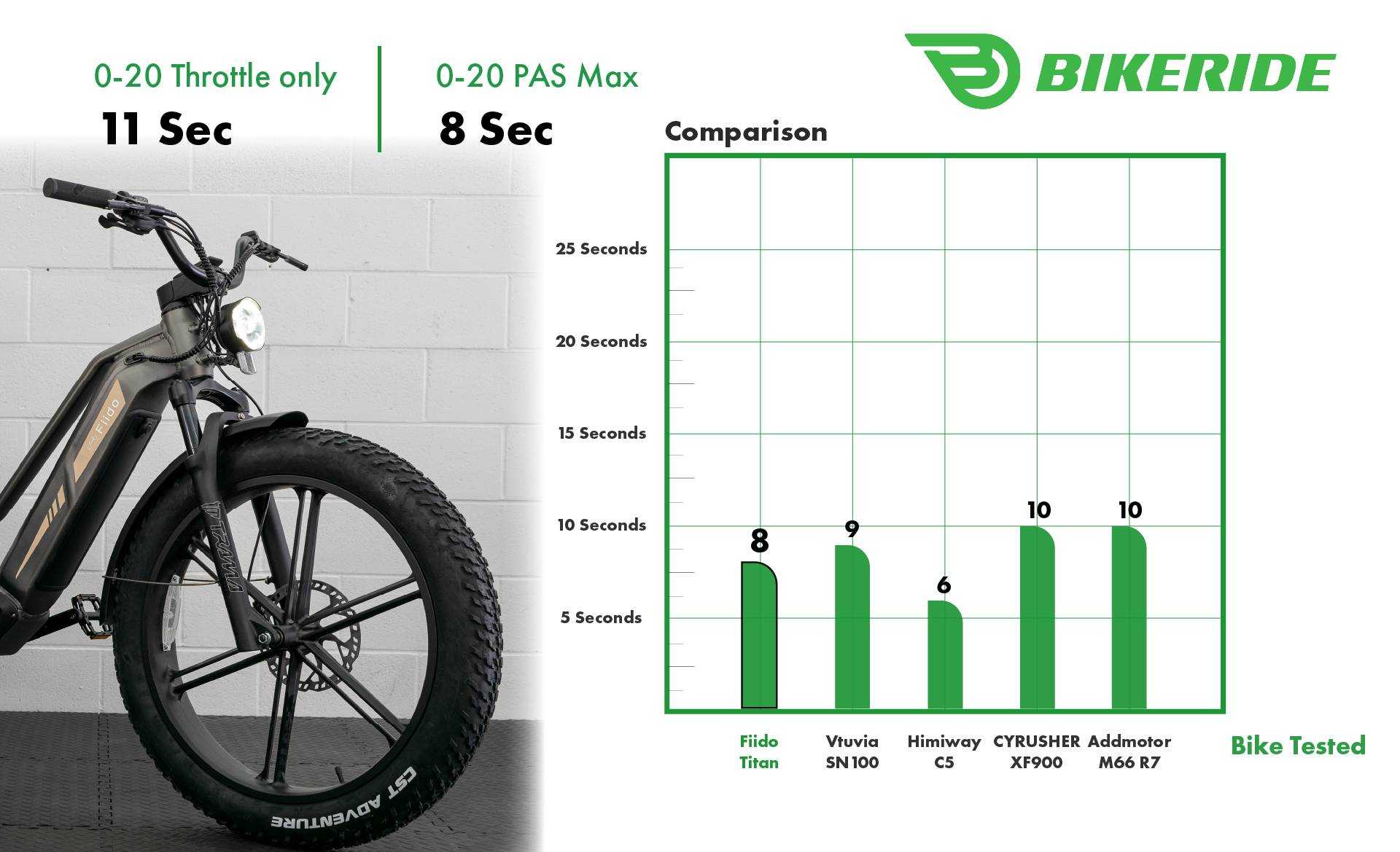

Acceleration 0–20 mph
Measured
Unlocked, the Titan reached 20 mph in 8 seconds on maximum pedal assist, tied for third of five in this comparison group. On the throttle alone it took 11 seconds, putting it fourth of five.
The acceleration run, with both results.
0–20 mph, max pedal assist
Seconds · shorter is faster
CYCROWN Nomad Pro7.0 s
Puckipuppy Labrador Pro7.0 s
Fiido Titan8.0 s
Jasion Thunder Pro8.0 s
Velotric Nomad 1 Plus12.0 s
Fiido TitanComparison bikesAverage of similar bikes (8.1 s)
0–20 mph, throttle only
CYCROWN Nomad Pro9.0 s
Puckipuppy Labrador Pro10.0 s
Fiido Titan11.0 s
Velotric Nomad 1 Plus13.0 s
Fiido TitanComparison bikesAverage of similar bikes (9.6 s)
Max pedal assist: 8.0 sThrottle only: 11.0 sAverage of similar bikes: 8.1 s pedal assist · 9.6 s throttleTies third of five on pedal assist · fourth of five on throttle

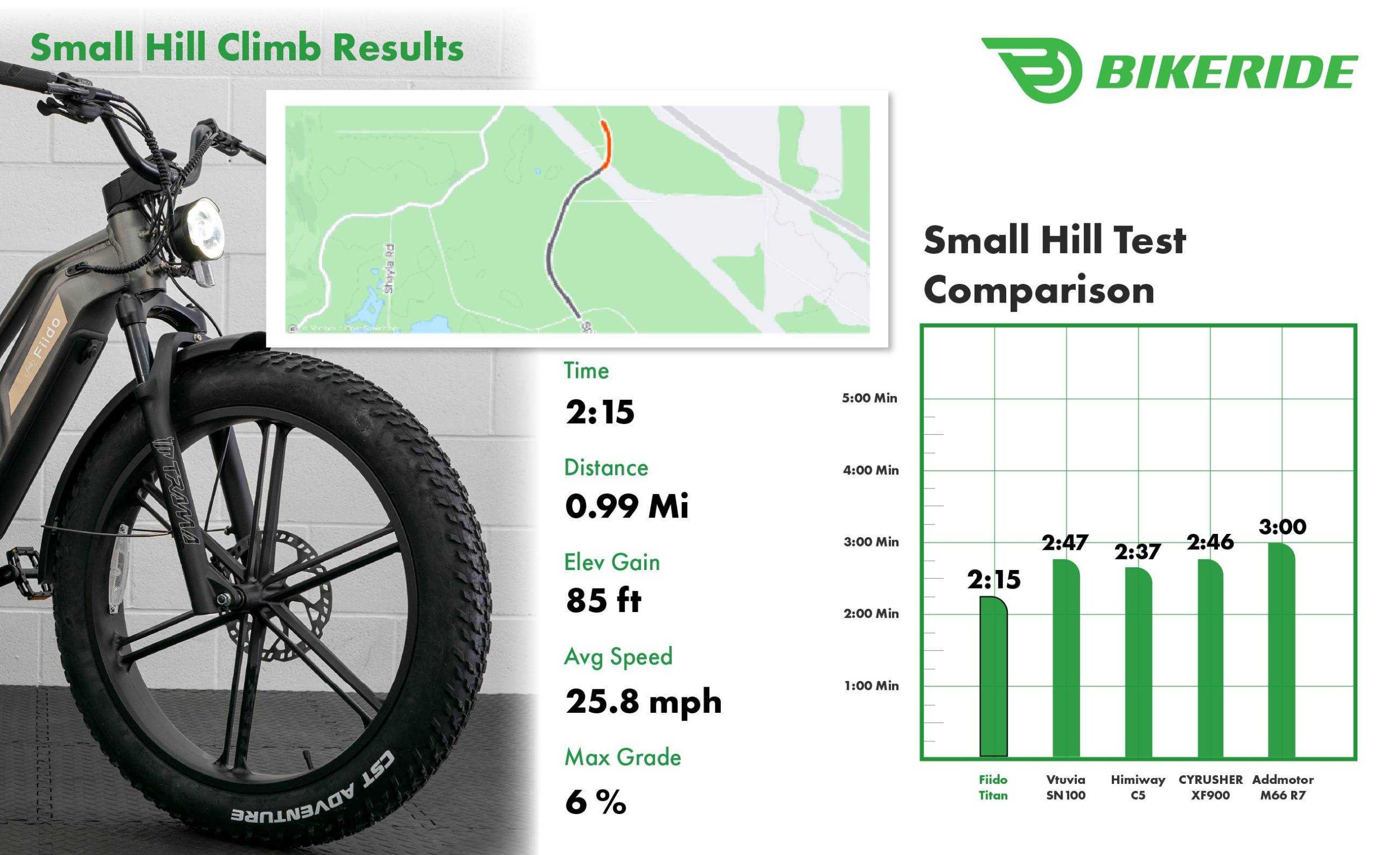

Unlocked, the Titan climbed the gradual hill (0.99 miles at up to a 6% grade) in 2:15 at an average of 25.8 mph. That is second of the three uncapped runs in this comparison group.
Gradual hill climb, max assist
Minutes:seconds · shorter is faster · 0.99 mi · 79 ft gain · 6% max grade · capped and uncapped runs flagged
Jasion Thunder Pro uncapped2:03
Fiido Titan uncapped2:15

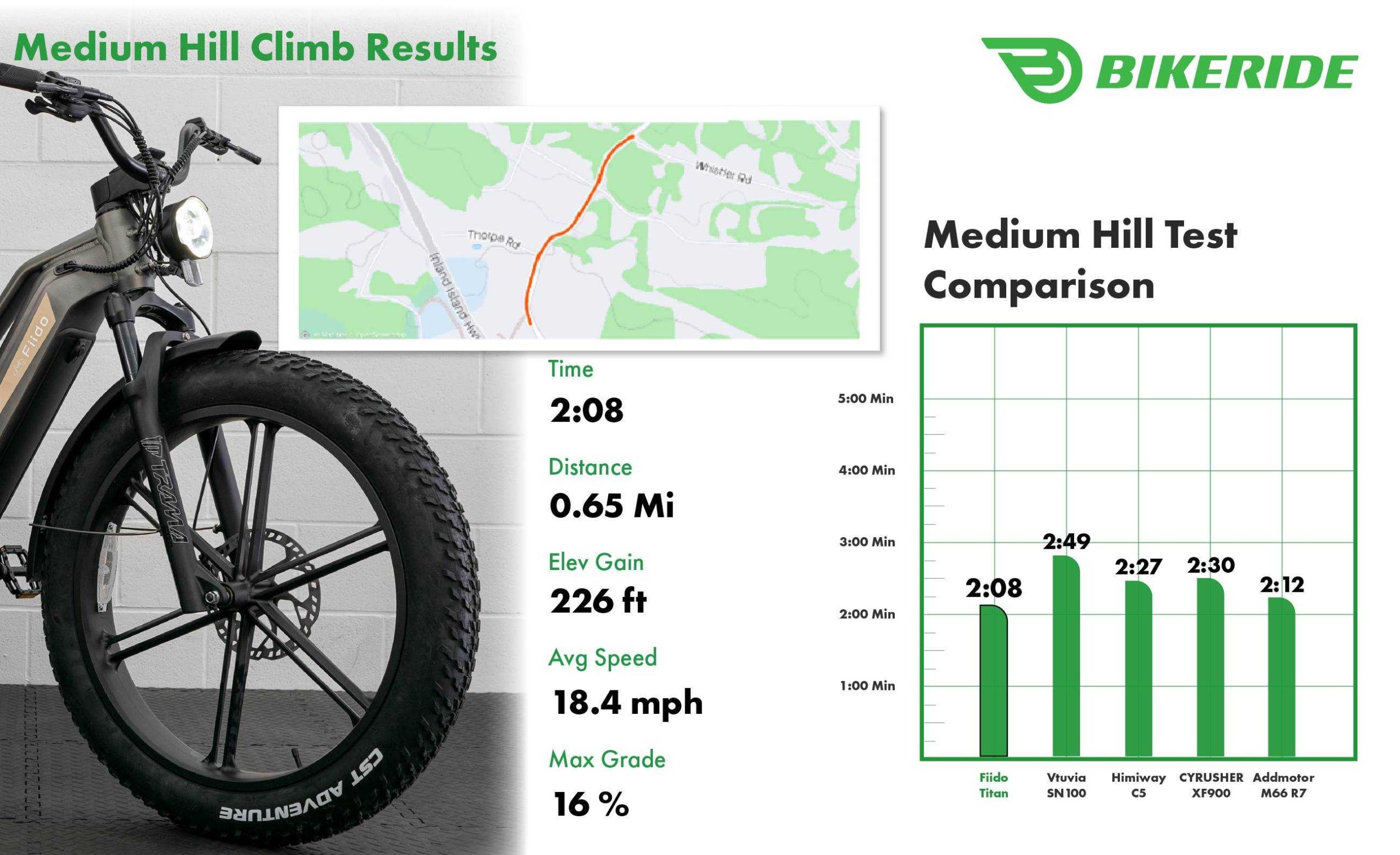

Climbing Test 2: Steep Hill
Measured
On the steep hill, 0.65 miles with 226 feet of gain and a 12% maximum grade, the Titan took 2:08 at an average of 18.4 mph. Like the gradual climb, it ran at its 28 mph limit, so it doesn't compare directly with bikes capped at 20 mph and is not ranked.
On a path under the trees.
Steep hill climb, max assist
Minutes:seconds · shorter is faster · 0.65 mi · 226 ft gain · 12% max grade · speed limits differ, so no average
Jasion Thunder Pro2:00
Fiido Titan 28 mph limit2:08
Puckipuppy Labrador Pro2:19
CYCROWN Nomad Pro2:31
Velotric Nomad 1 Plus2:44
Titan, 28 mph limit: 2:08 · 18.4 mph avgNot ranked: 28 mph limit
Hill start on steep grade4/5Good torque for hill starts.

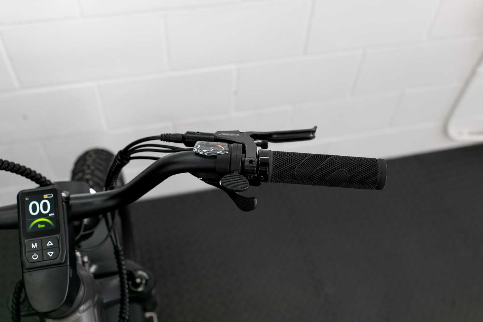

The thumb throttle.
Class:  Class 2 as shipped, unrestricted when unlockedTop speed:  15.5 mph as shipped, 28 mph unlockedAssist levels:  three as shipped, five when set in the appThrottle:  thumb lever at the right grip, same limit as the pedal assist
Unlocked, the throttle also powers the Titan to 28 mph, so it doesn't meet Class 3 rules. Many trails and multi-use paths restrict faster e-bikes, so check local rules before unlocking.

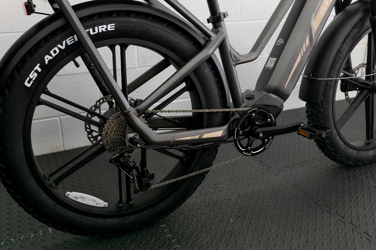

The Fiido Titan's rear wheel from the left side: the hub motor sits behind the 203 mm brake rotor in the one-piece cast wheel
The 750W rear hub motor: 55 Nm, claimed.
Motor engagement5/5Quick to respond.

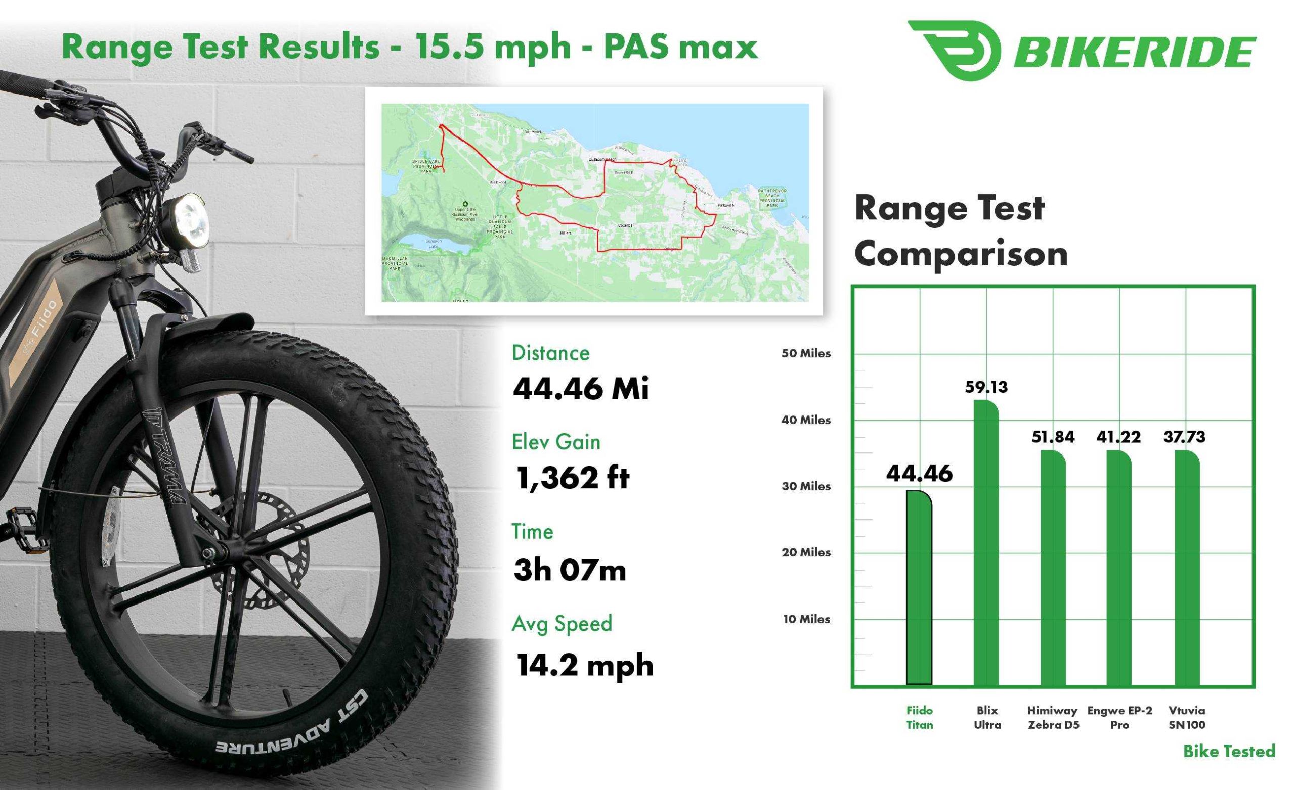

Range Test 1: Max Assist (15.5 mph limit, as shipped)
Measured
At maximum assist with the factory 15.5 mph limit, the Titan lasted 44.46 miles on our standard loop, with 1,362 feet of elevation gain, at a 14.2 mph average.
Scott on a gravel road through the forest.
Range at maximum assist
Miles · longer is better · 20 mph limit unless flagged
Fiido Titan 15.5 mph limit44.46 mi
CYCROWN Nomad Pro32.92 mi
Puckipuppy Labrador Pro30.56 mi
Velotric Nomad 1 Plus29.57 mi
Jasion Thunder Pro27.70 mi
Fiido Titan 28 mph limit27.04 mi
Fiido TitanComparison bikesAverage of similar bikes (32.5 mi)
Titan, 15.5 mph: 44.46 mi · 1,362 ft climbed · 3 h 7 min · 14.2 mph avgAverage of similar bikes at max assist: 32.5 mi+37% vs. similar bikesNot ranked: 15.5 mph limit

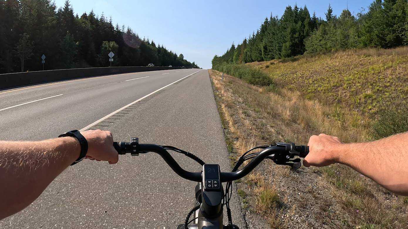

Range Test 2: Max Assist (unlocked, 28 mph limit)
Measured
Unlocked to 28 mph, the Titan lasted 27.04 miles, with 1,070 feet of elevation gain, at an 18.1 mph average.
From the handlebar on a highway shoulder.
Titan, 28 mph: 27.04 mi · 1,070 ft climbed · 1 h 29 min · 18.1 mph avgAverage of similar bikes at max assist: 32.5 mi−17% vs. similar bikesNot ranked: 28 mph limit

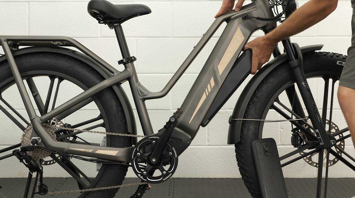

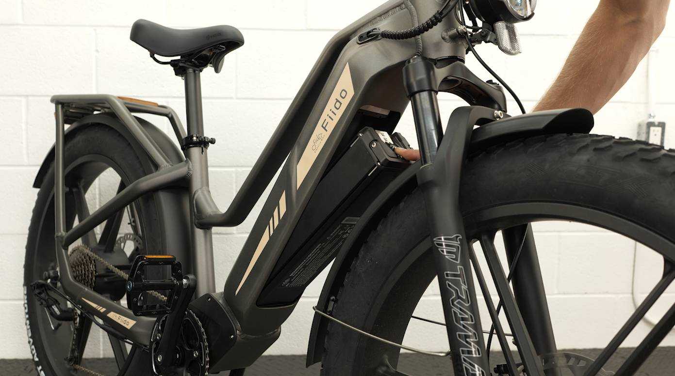

The 48V 14.5Ah battery (696 Wh) sits in the down tube behind a plastic cover, which lifts off after you slide the lock at its top. Our test bike had no key. An electronic lock releases the battery from the Fiido app, or from the display when you press the up and down buttons together and enter a code. The battery then pops out against a second catch, a metal tab above it. To refit it, slide it in until it clicks.
In both range tests the battery level dropped steadily, which made the remaining range easy to judge, and the bike kept several miles in reserve after the low-battery warning. We found the app release slower than a key would be. Fiido has since added a key and a manual release to the Titan. The Titan is UL 2849 certified.
Slide the lock and the cover lifts off.
Pressing the tab frees the battery.
✓ Removable battery, electronic lock✓ UL 2849✓ IP54, display IP68 (claimed)
Charge-gauge accuracy5/5Drops steadily and reliably, with miles in reserve after the low-battery warning.
Battery removal and locking2/5Keyless release by app or code, slower than a key, and a dead bike can't release the battery.

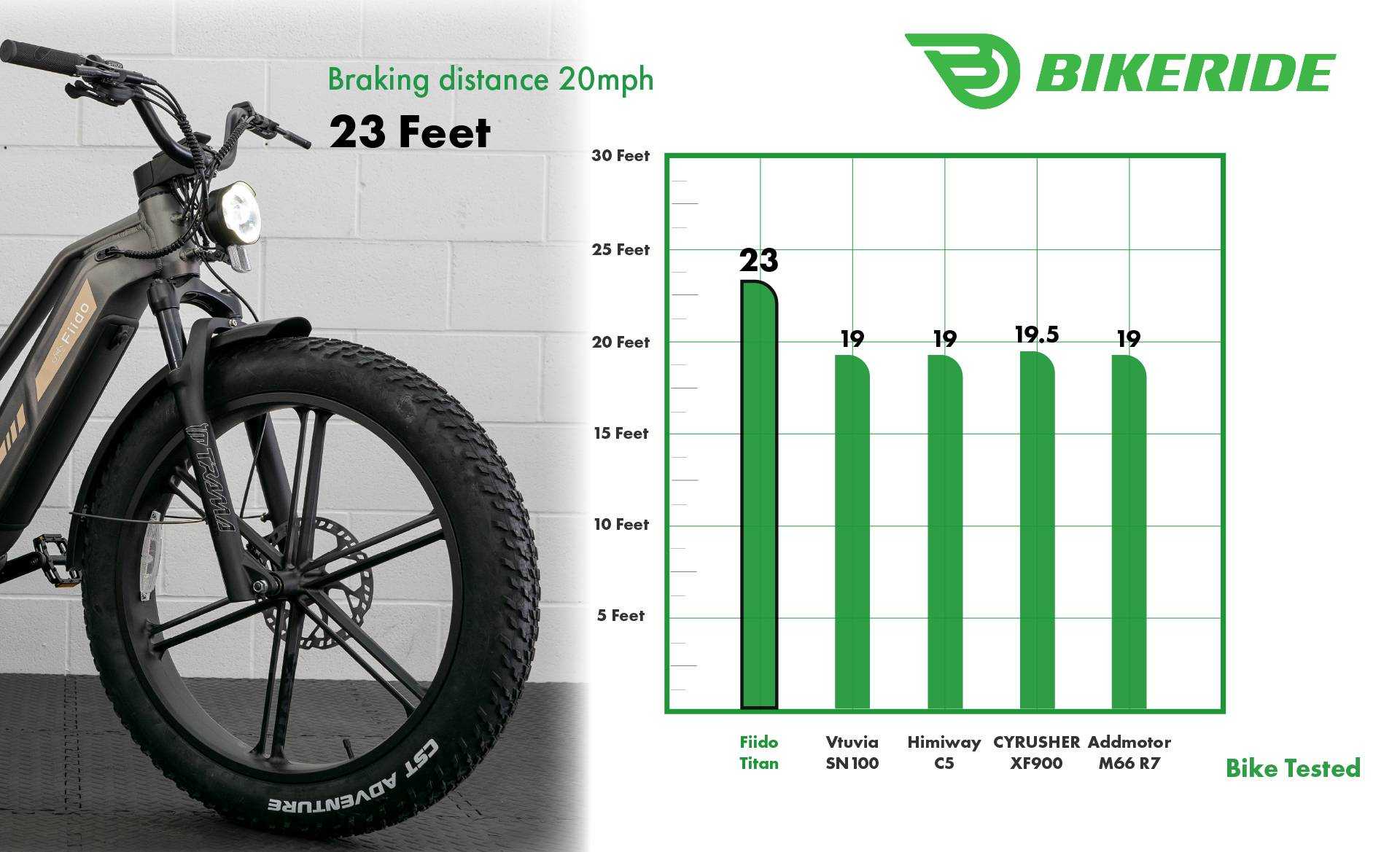

Brake test: 20 to 0 mph
Measured

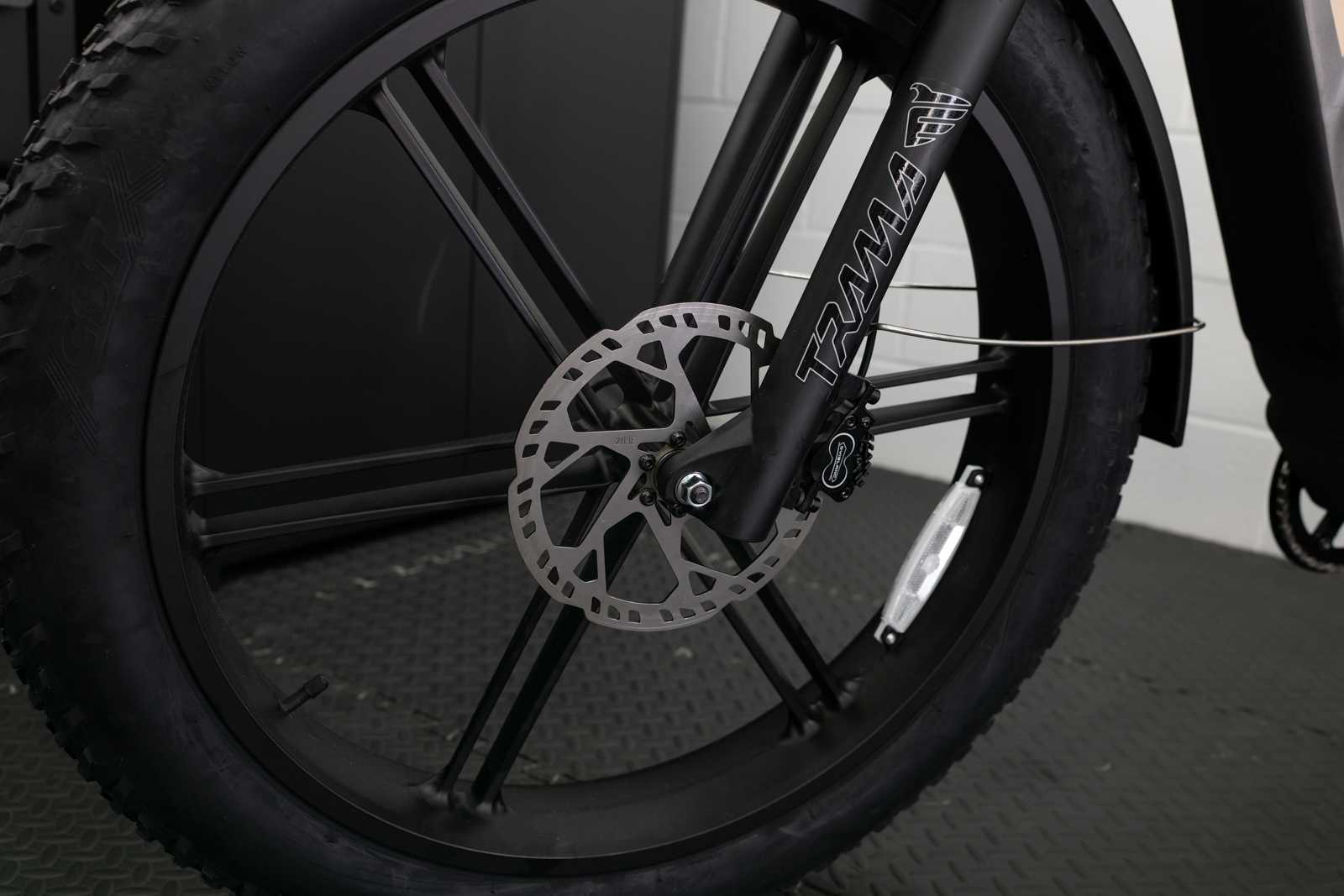

The DYISLAND hydraulic brakes have four-piston calipers and 203 mm rotors front and rear. Even so, the Titan needed 23 feet to stop from 20 mph. That is the longest stop in this comparison group.
The full stop from 20 mph, seen from above: 23 feet.
Braking distance, 20–0 mph
Feet · shorter is better
Fiido Titan23 ft
Jasion Thunder Pro21 ft
Puckipuppy Labrador Pro21 ft
CYCROWN Nomad Pro20 ft
Velotric Nomad 1 Plus16 ft
Fiido TitanComparison bikesAverage of similar bikes (19.7 ft)
Where the Titan sits: braking distance
Compared to the 17 fat-tire e-bikes we have tested
Titan
16 ft (best fat-tire result)Braking distance27.7 ft (longest)
Titan: 23 ftAverage of similar bikes: 19.7 ftLongest in the group
The Fiido Titan's front brake: a 203 mm rotor and four-piston DYISLAND caliper on the suspension fork
The front four-piston caliper and 203 mm rotor.
Brake feel and modulation2/5Lackluster, at 23 ft from 20 mph despite 4-piston calipers and 203 mm rotors.

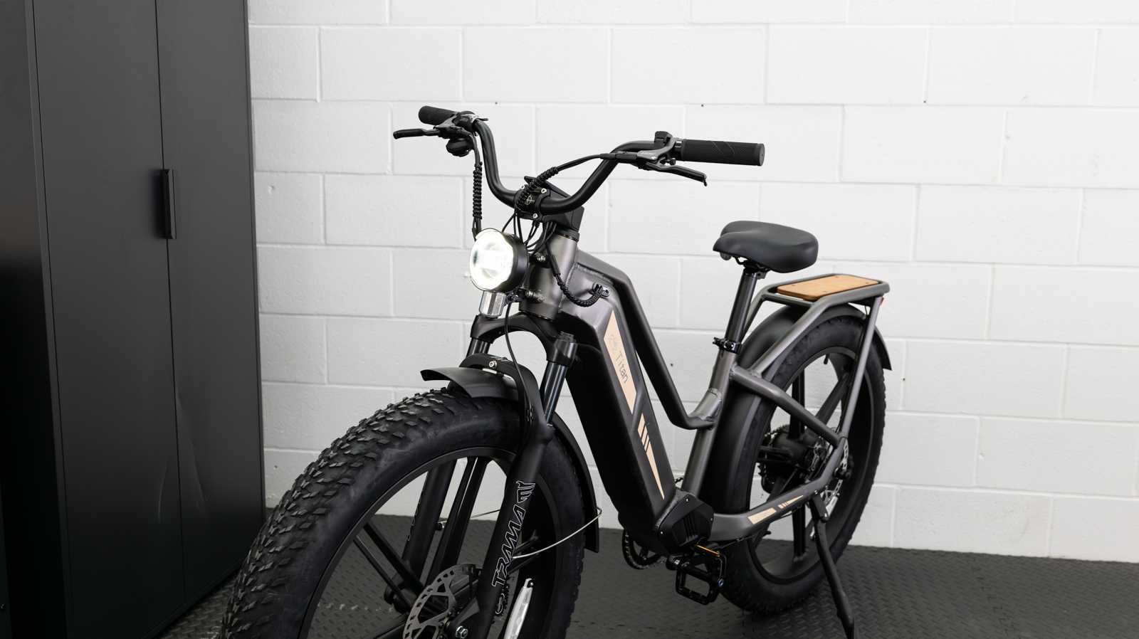

The headlight and the rear light are wired into the bike's electronics, and one button on the left control pad controls both. The rear light is built into the back of the rack. We found the headlight bright.
The Fiido Titan from the front, with its headlight lit below the riser handlebar
The headlight, lit.

The Selle Royal saddle is plush and was comfortable on short and medium rides, but toward the end of our 44-mile range test it began to cause chafing. The straight lock-on rubber grips gave a secure hold. The aluminum platform pedals, with small pegs, are basic but did the job.
The Fiido Titan's padded Selle Royal saddle, with the wooden deck of the rear rack behind it
The padded Selle Royal saddle.

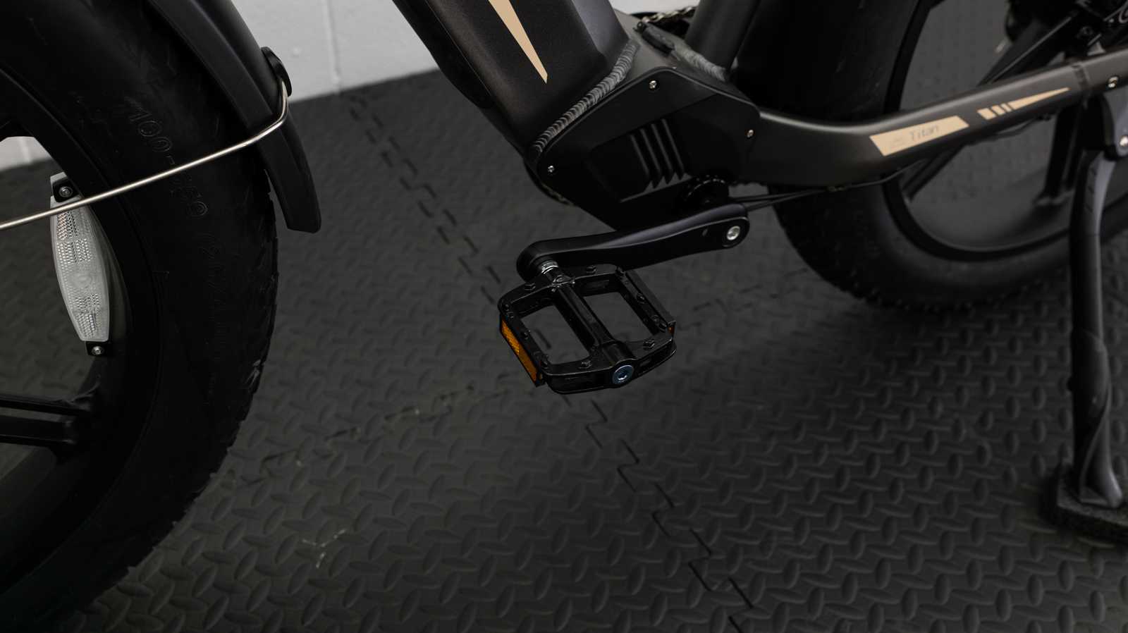

The Fiido Titan's aluminum platform pedal and crank, seen from above in the studio
The aluminum platform pedal.
Saddle comfort3/5Plush and comfortable, but it caused chafing late into a 44-mile ride.
Grips and pedals3/5Secure lock-on grips and basic aluminum pedals.

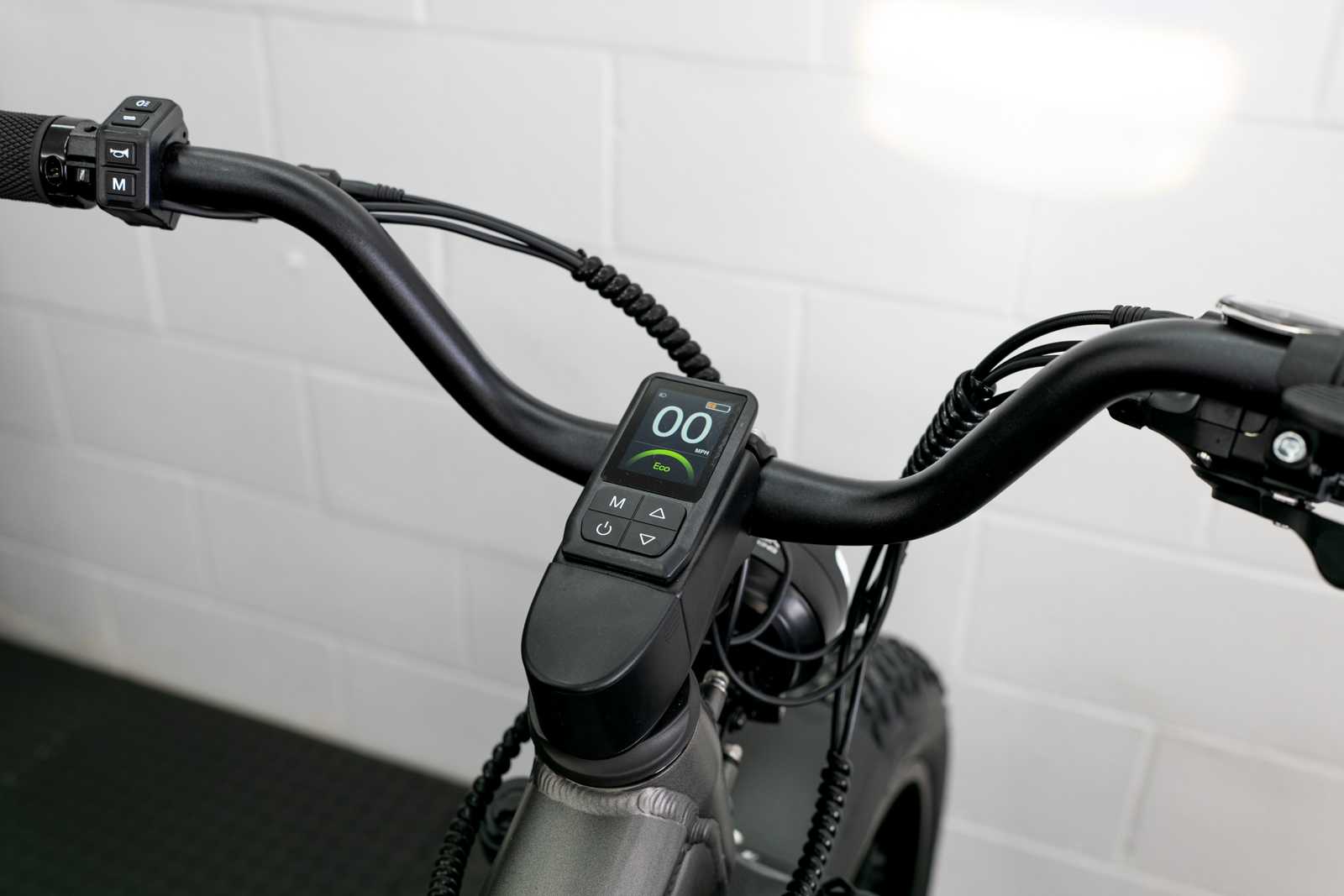

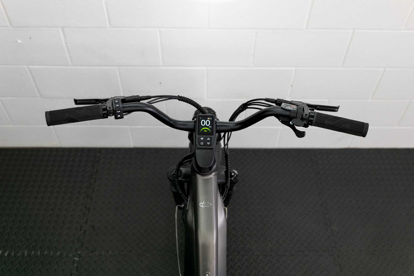

The Titan has a riser handlebar. Its aluminum brake levers have a reach-adjust dial, so you can set how far the lever sits from the grip.
The Fiido Titan's riser handlebar seen from the saddle side, with the display at its center
The riser bar, with the display at its center.
A dial on the lever sets its reach.
Cockpit adjustability3/5A standard riser bar and stem, with no bar or stem adjustment.

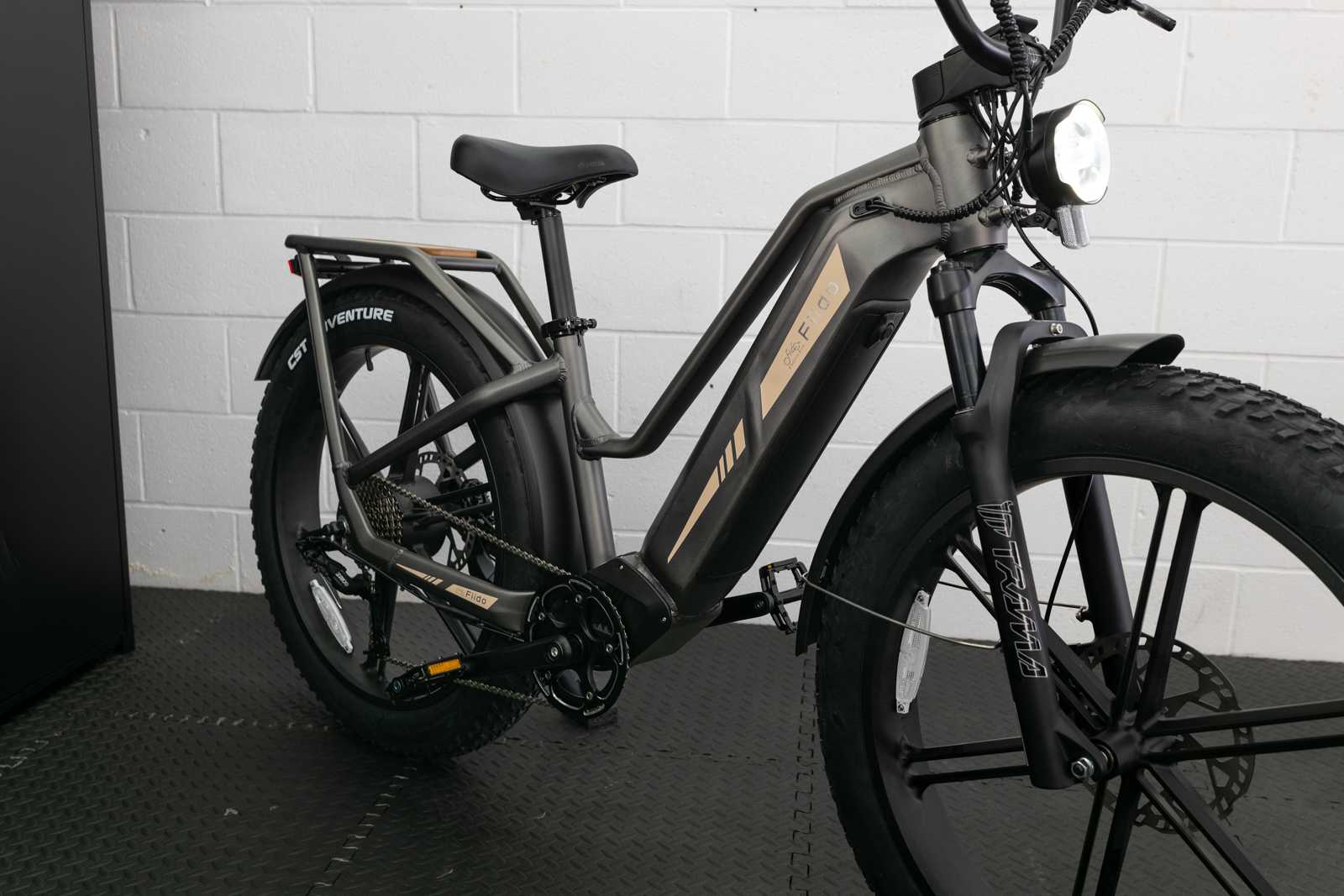

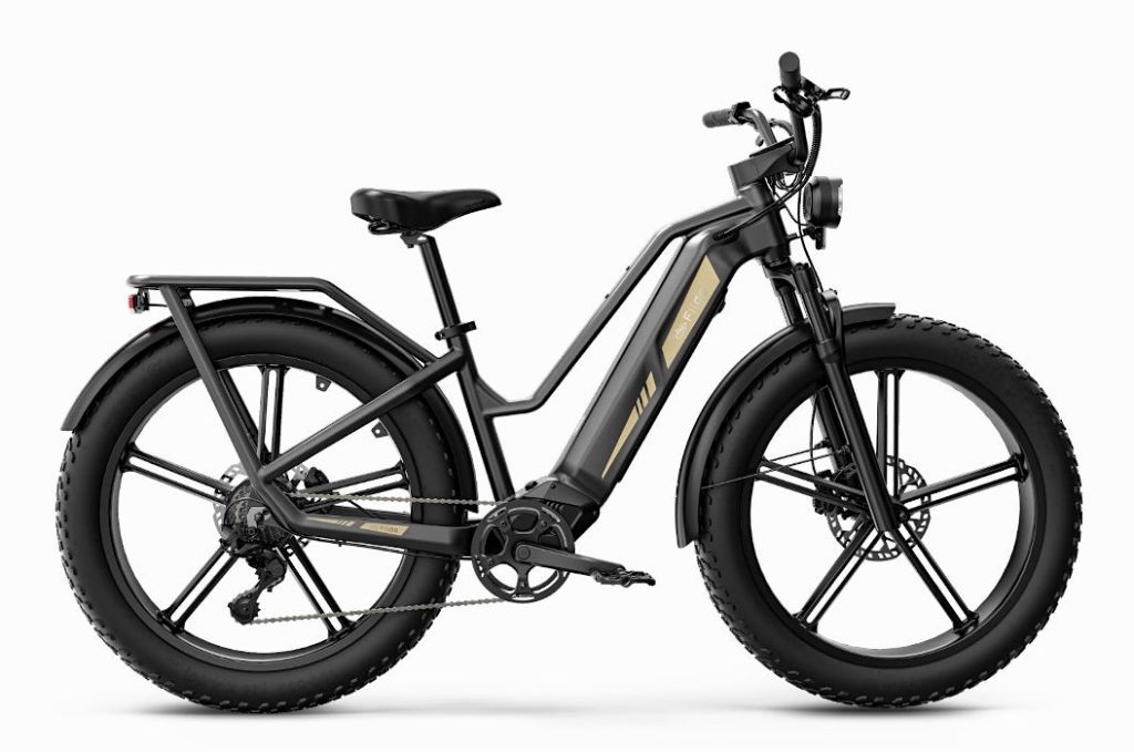

The 6061 aluminum frame is a mid-step, with an oversize down tube that hides the battery and a rear rack welded into the frame. It felt firm and flex-free on the road. Our test bike was silver.
The Fiido name on the cover of the Fiido Titan's down tube, which hides the battery
The down tube hides the battery.
Frame welds and finish5/5Strong welds at the integrated rack and a pleasant silver finish.
Cable and wire integration3/5Cluttered at the front, with about five cables under the stem, then cleaner where they enter the frame.
Rattles and squeaks3/5Few rattles, but the chain slaps when riding off-road without a clutched derailleur.

The 9-speed S-Ride drivetrain pairs a 42t chainring with an 11–32t cassette. That is a wider range than the 7-speed, 14–28t setups on many e-bikes, and it let us keep a comfortable cadence at different speeds. The shifter and derailleur are budget parts: shifts sometimes needed finesse to go through smoothly, and the second trigger is tucked so tightly under the shifter that our thumb had to hunt for it.
The Fiido Titan's 42-tooth chainring, crank and chain from the drive side, below the battery
The 42t chainring.
The S-Ride trigger shifter.
Shifting performance3/5Reasonable, but the budget shifter is a bit clunky.

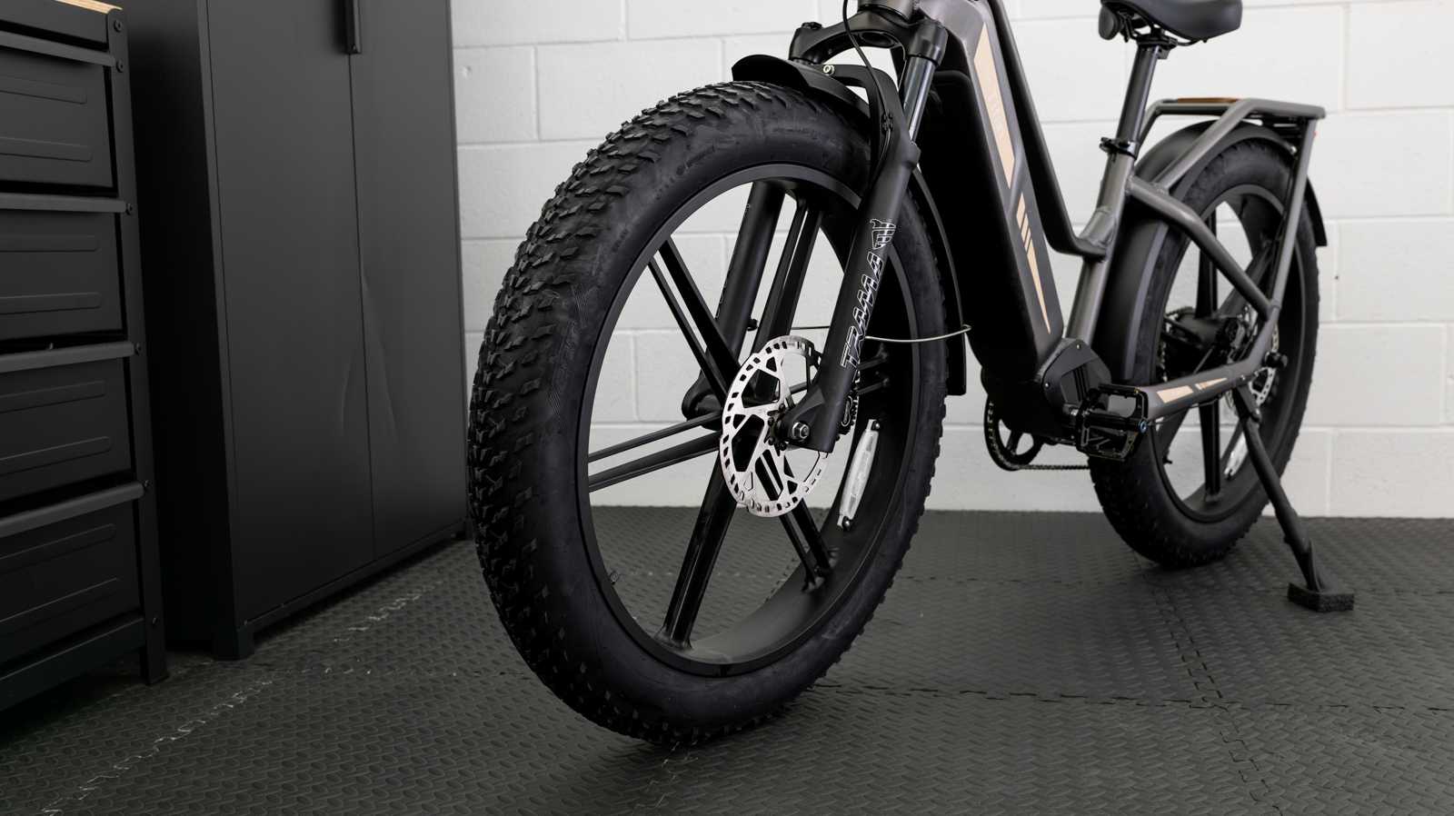

The 26×4" CST Adventure tires have an aggressive tread that gave good float and grip in loose dirt and gravel. They are louder on pavement, though under motor power we noticed no extra rolling resistance. They take up to 30 psi and have no puncture protection.
The welded rear rack is rated for 176 lb. Fenders, front and rear lights, and a single-sided kickstand are included, and the fenders and kickstand gave us no trouble. Fiido also sells a rack that carries two more batteries, plus pannier bags, front racks, and phone holders.
The Fiido Titan's welded rear rack with its wooden deck, above the rear fender
The rack is welded into the frame.
The front half of the Fiido Titan from the drive side, with the front fender over the 4-inch tire
The front CST Adventure tire and fender.
Tires4/5Good float and grip off-road, loud on pavement, and no puncture protection.

The Titan has two control pads. The one at the left grip has a light button for the front and rear lights, an assist button that cycles through the levels, a horn, and a mode button that switches the main screen between its two layouts. The pad under the display has the power button, a second mode button, and up and down buttons.
The Fiido Titan's display on the stem, with its four-button pad below the screen
The display, with its button pad below.
Changing screens with the mode button.
Display readability5/5A large color display that's easy to read in the sun.
Controls4/5Good usability and layout.

The Fiido app connects by Bluetooth and delivers updates. It releases the battery, turns the bike on, switches the lights, and shows ride data on a dashboard. Its settings menu unlocks the speed limit and switches cruise control on and off. We found the app hard to use, with confusing names and descriptions for some features.
✓ Battery release✓ Speed-limit unlock (Rocket mode)✓ Cruise control
Companion app2/5Interesting features, but a sometimes glitchy, confusing UI and an unlock code every time.

The brakes are DYISLAND hydraulics and the drivetrain is S-Ride. The wheels are one-piece cast alloy, so there are no spokes to true or replace.
Maintenance burden3/5Typical upkeep for a coil fork and derailleur.
Serviceability and parts2/5Several proprietary parts, including the electronic battery lock, motor and display.

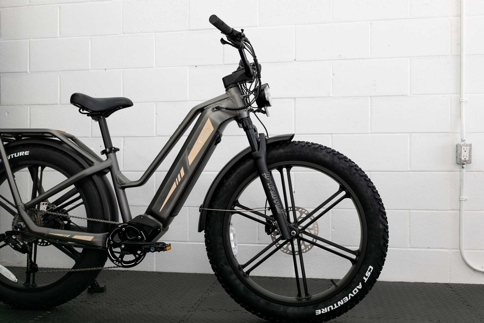

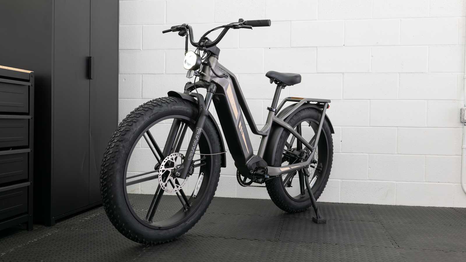

The Fiido Titan from the front three-quarter in the BikeRide studio
The Titan in silver.
Value verdict4/5Good value, with some quirks.

0–20 mph, throttle onlyvs. 33 other 750W hub e-bikes11.0 s9.6 s10.6 s
0–20 mph, max pedal assistvs. 34 other 750W hub e-bikes8.0 s8.1 s8.4 s
Gradual hill climb, uncappedvs. 11 other 750W hub e-bikes, uncapped runs2:152:342:21
Steep hill climb, 28 mph limitno like-for-like average2:08——

Range (max assist, 15.5 mph limit)vs. 16 other fat-tire e-bikes44.46 mi32.5 mi29.6 mi
Range (max assist, 28 mph limit)vs. 16 other fat-tire e-bikes27.04 mi32.5 mi29.6 mi
Range vs claimedvs. 17 other fat-tire e-bikes62%58%54%

Brake test, 20–0 mphvs. 16 other fat-tire e-bikes23.0 ft19.7 ft19.3 ft
