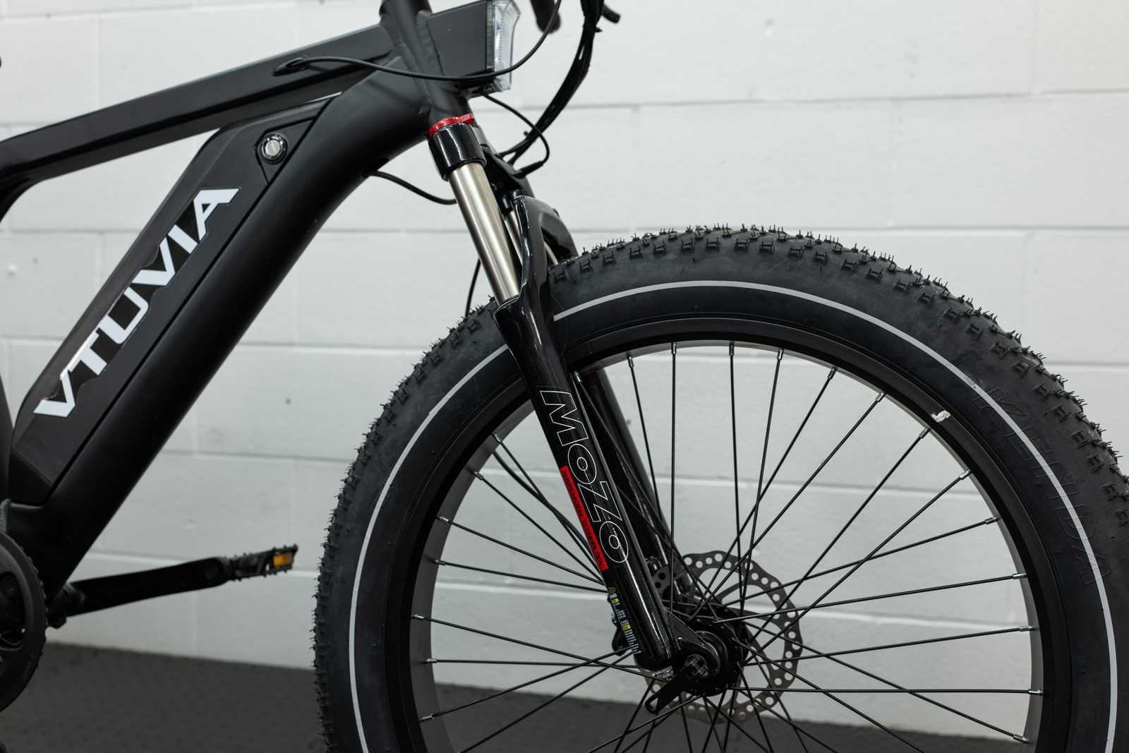

  • The 120mm Mozo suspension fork and 4" Kenda tires absorb bumps well.

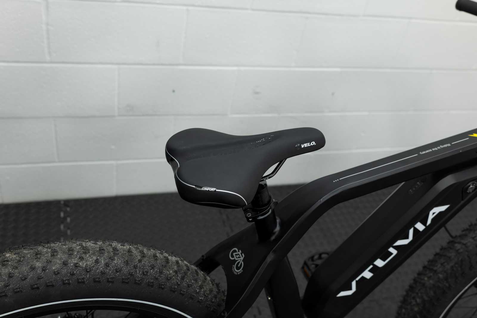

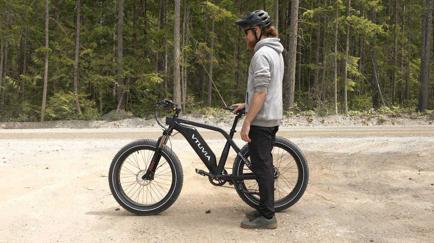

The Vtuvia has unusual geometry. Despite its size and height rating of 5’8″ to 6’5″, the pedaling position isn’t optimal for me at 6’0″. The seatpost is too short, so there isn’t enough room for full extension while pedaling. I would need a couple more inches for proper fit. In contrast, with a 31″ standover height, riders under 5’9″ won’t be able to mount the bike easily.

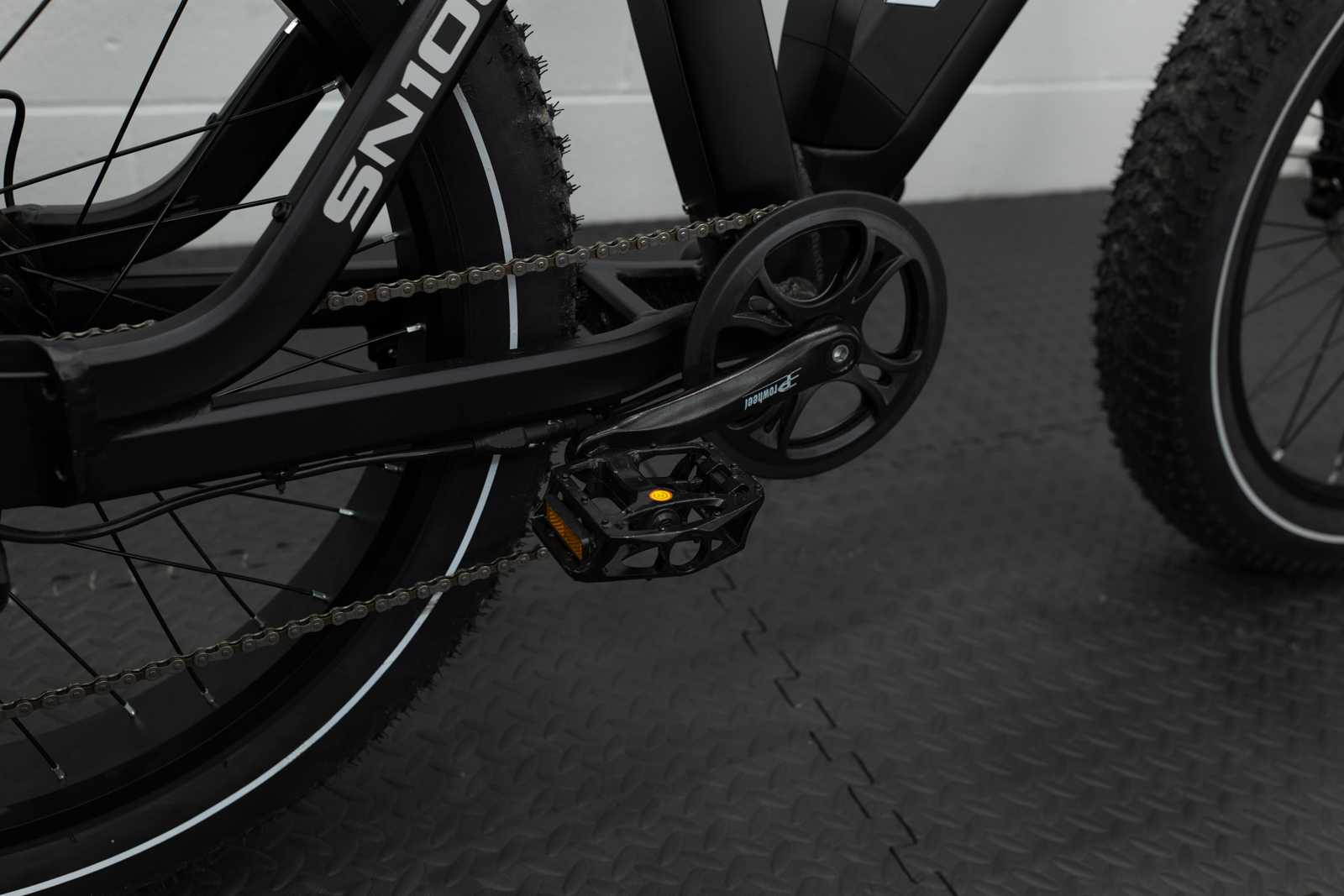

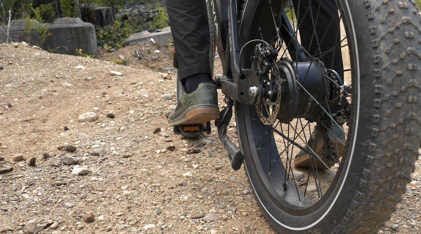

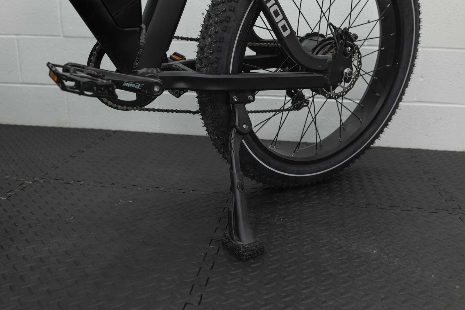

Poorly Positioned Cranks and Kickstand
The SN100’s cranks and kickstand are poorly positioned, causing me to hit the heel of my sneaker off the kickstand or chainstay constantly while pedaling. This even happened to a tester with smaller feet.
While this is a minor annoyance, it requires removing the kickstand to address. However, it’s not possible to avoid bumping the chainstay.

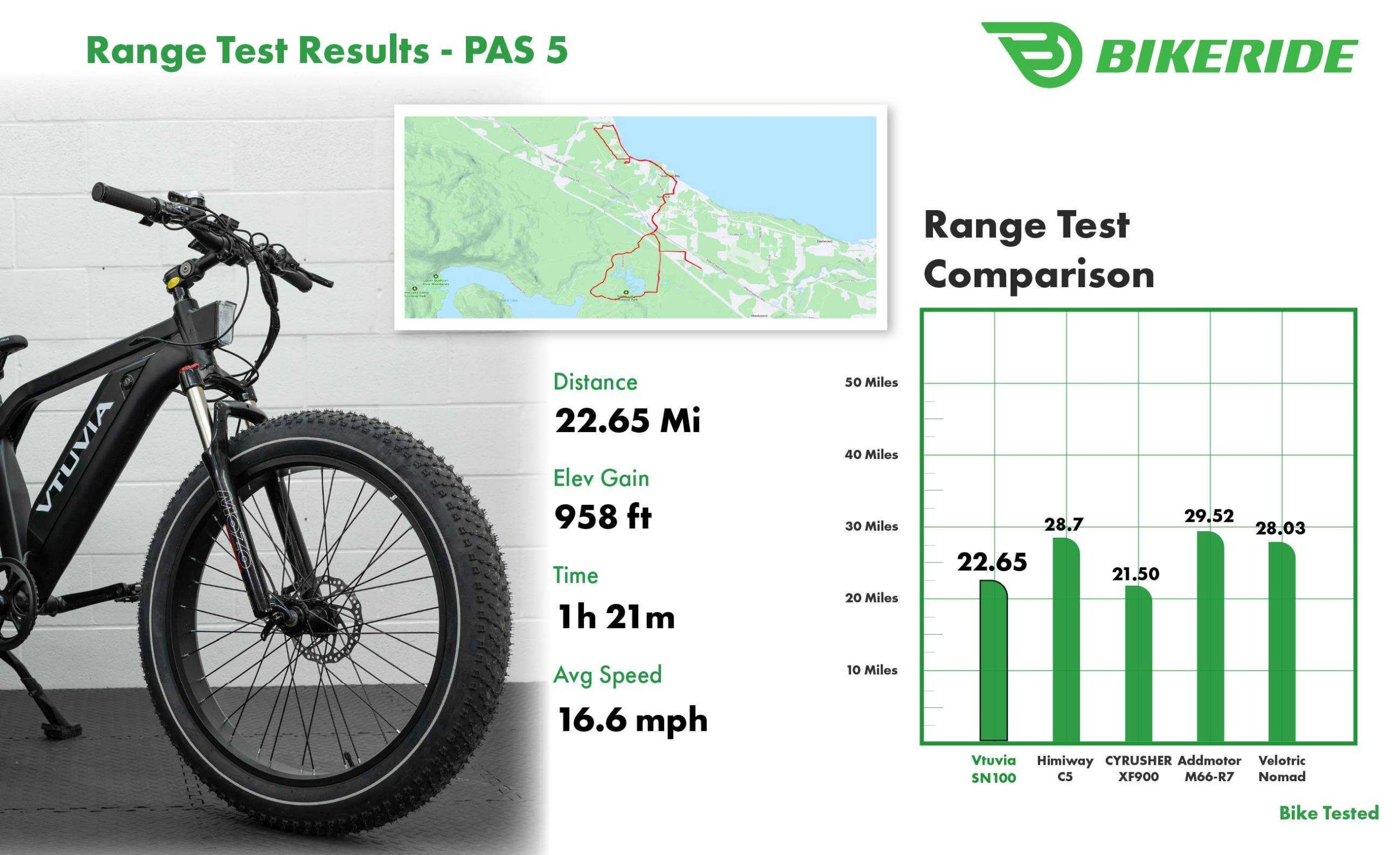

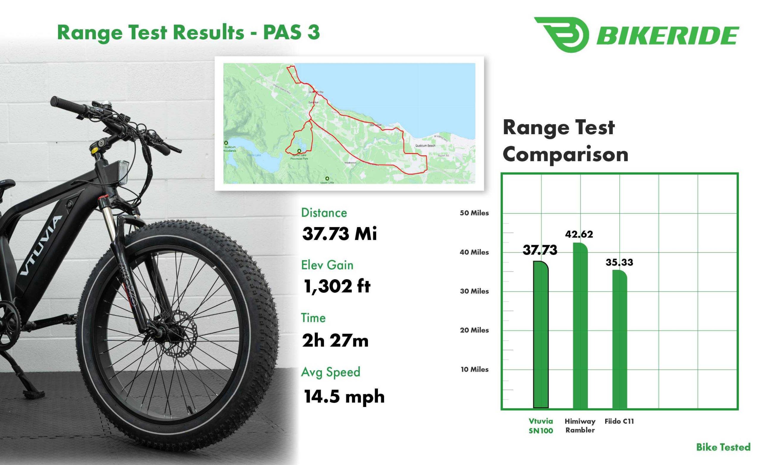

Battery Level Fluctuation
The battery readout fluctuated dramatically during the range test, dropping from 100% to 76% after two minutes. Releasing the throttle or stopping pedaling caused the charge percentage to jump back up.
After only eight miles, the display showed 40%, yet I managed to cover another 13 miles. Overall, the battery indicator’s inconsistency is frustrating as the fluctuation makes it hard to determine how much range you have left.

The SN100 is far from perfect. A major downside is the sizing. The short seatpost kept me from achieving a comfortable pedaling position despite being well below the max height. The high top tube also limits fit for shorter riders and makes mounting and dismounting a challenge.

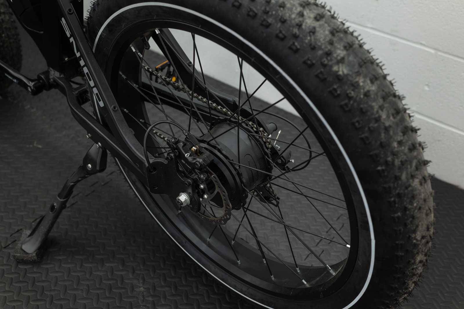

Another issue is the chainstays that flair outward from the bottom bracket, causing the rider to hit them or the kickstand while pedaling. I got my heel caught multiple times during testing.

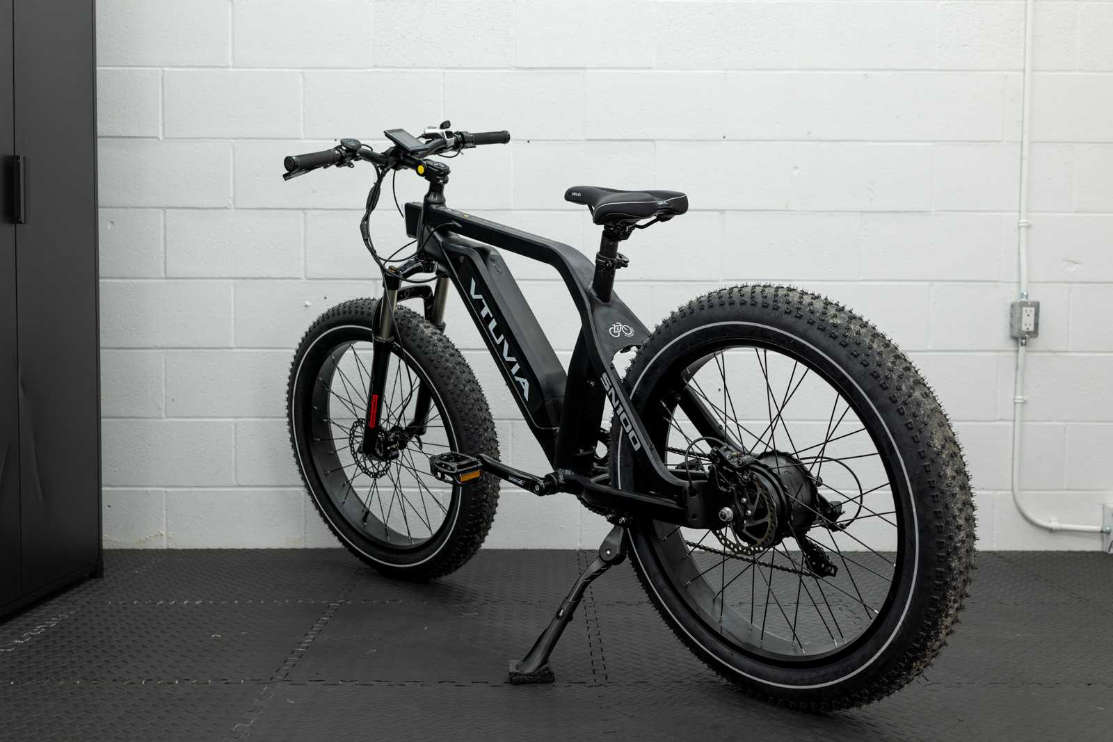

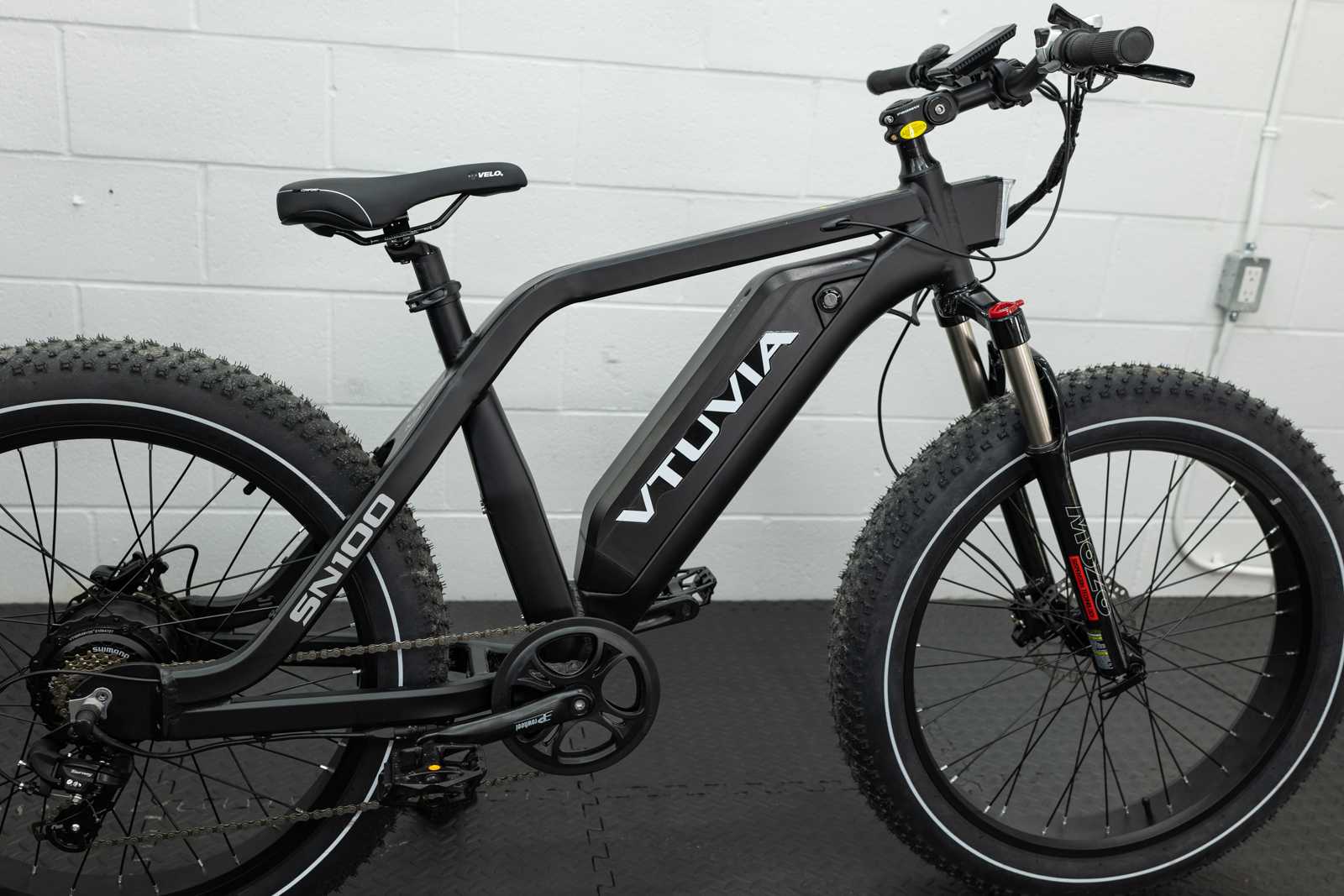

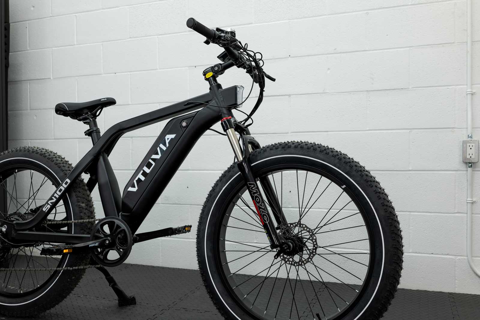

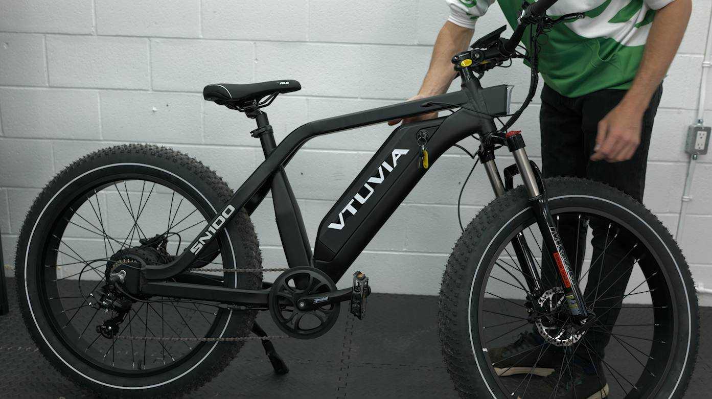

The SN100’s frame feels well-built and robust, with thick welds and no noticeable flex. The frame is large, the bottom bracket is higher than average, and the stack is only 20″. Thanks to the stem, which has 60° of adjustment, the riding position can be adapted slightly.
Overall, the geometry left me feeling slightly cramped. I would have liked a longer seatpost to help achieve a comfortable pedaling position.
The high standover means the bike is unsuitable for shorter riders under 5’9″. The maximum recommended height of 6’5″ also seems exaggerated. I felt at the limit of the bike’s height range at only 6’0″.

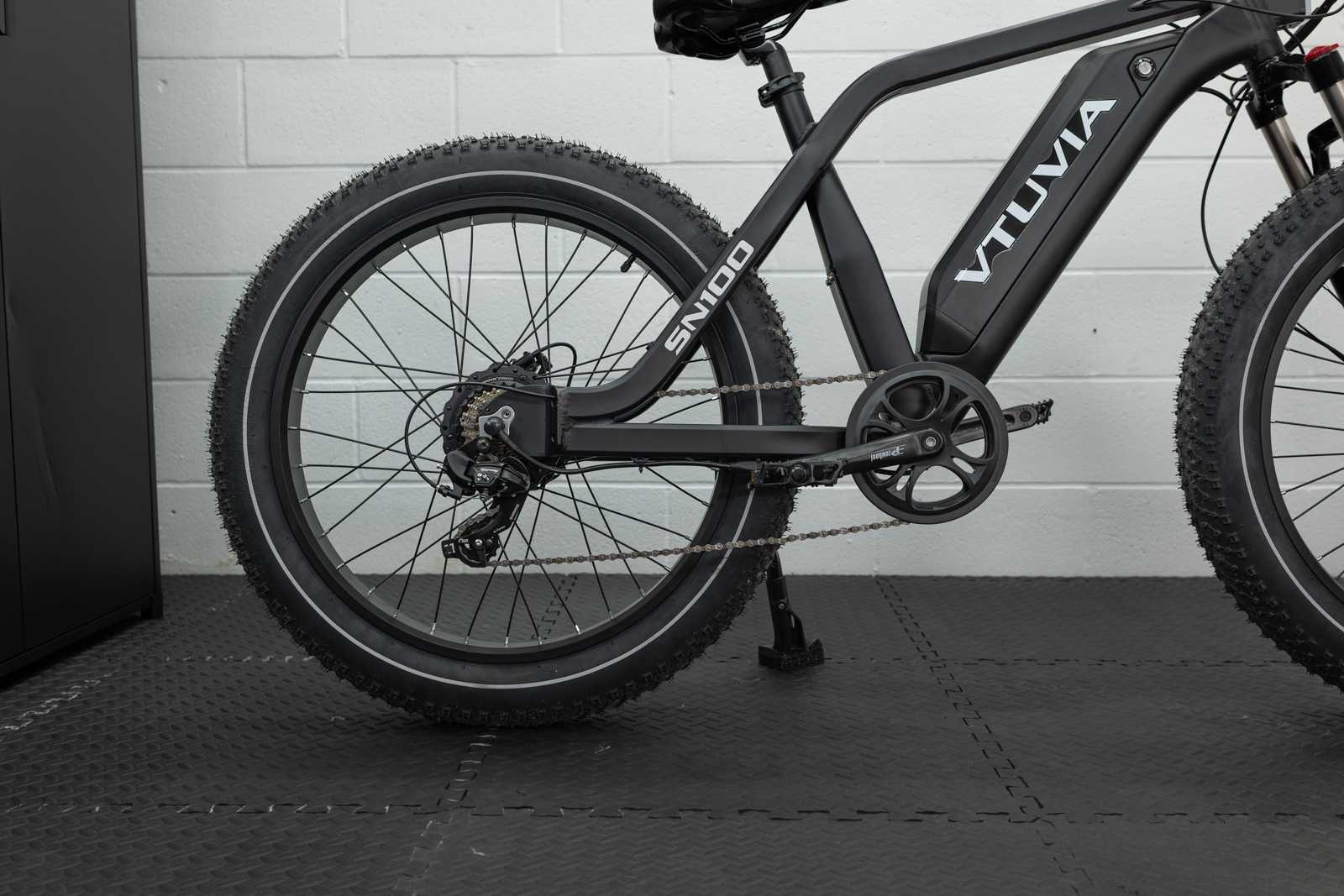

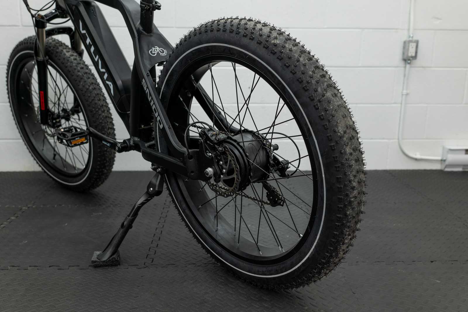

Another frame design issue is the left crank’s position in relation to the chainstay. This caused me to bump my heel off the chainstay and kickstand unless I turned my heel outward.
Finally, the bike uses a 120mm Mozo coil suspension fork with lockout and preload adjustment. This is a budget component, but the 120mm travel improves ride quality somewhat.

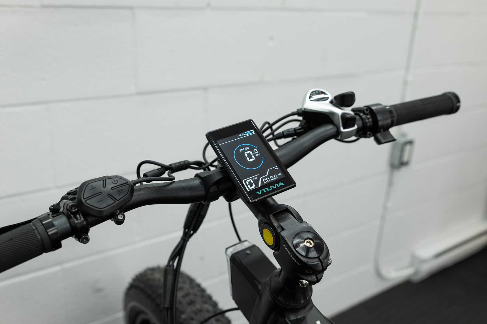

Display and Control

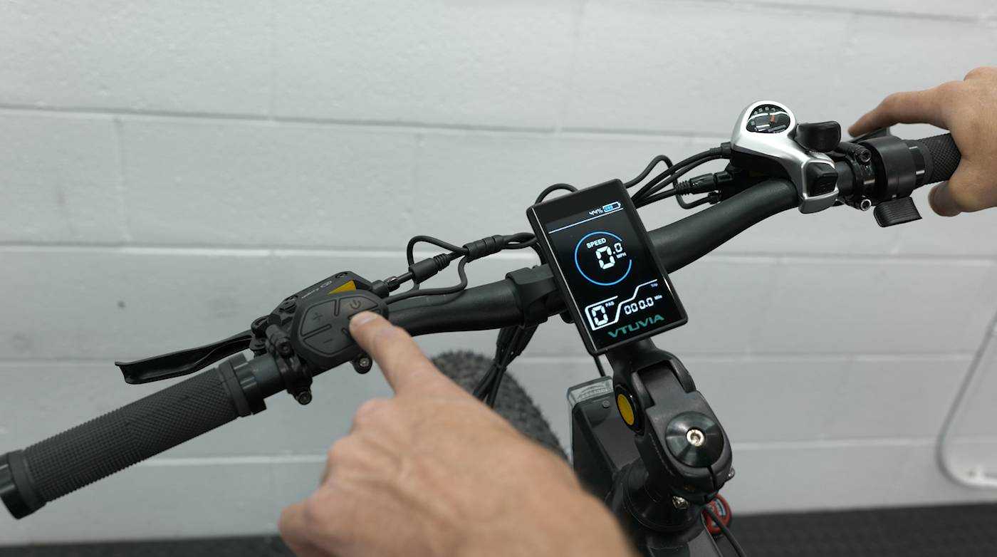

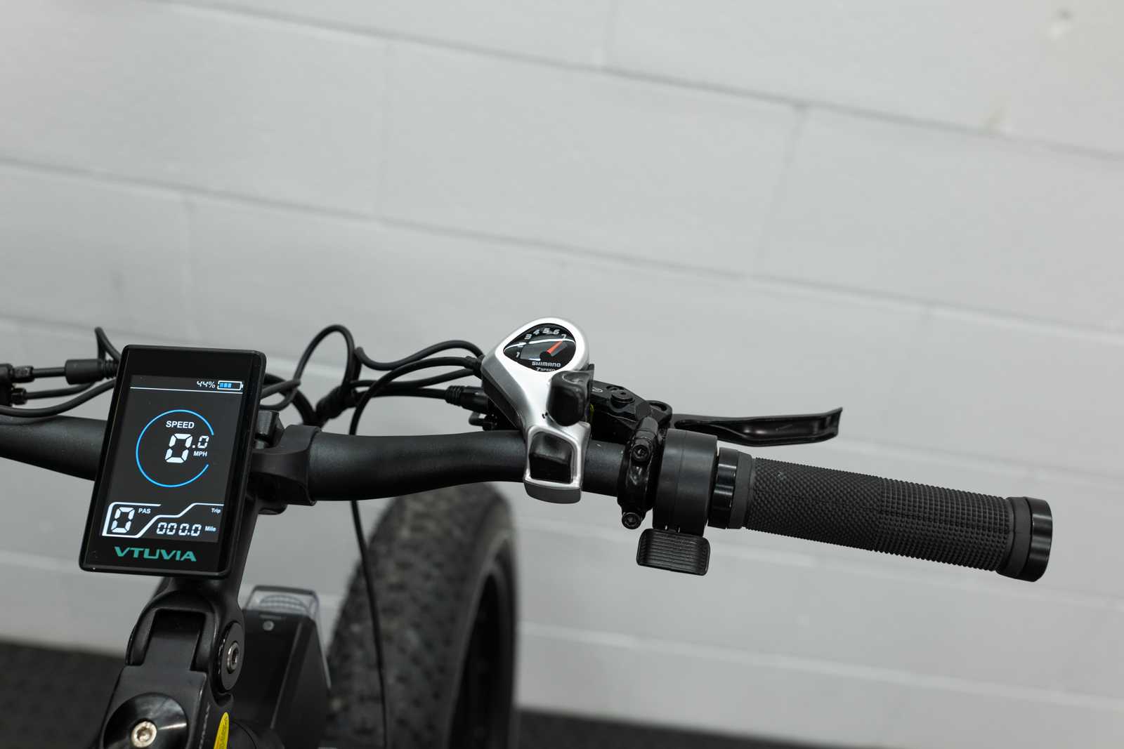

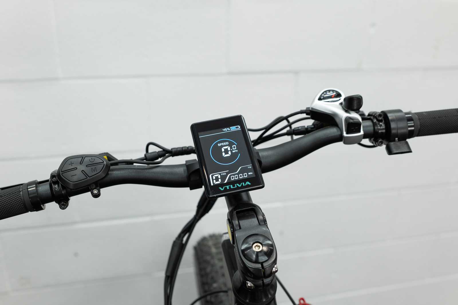

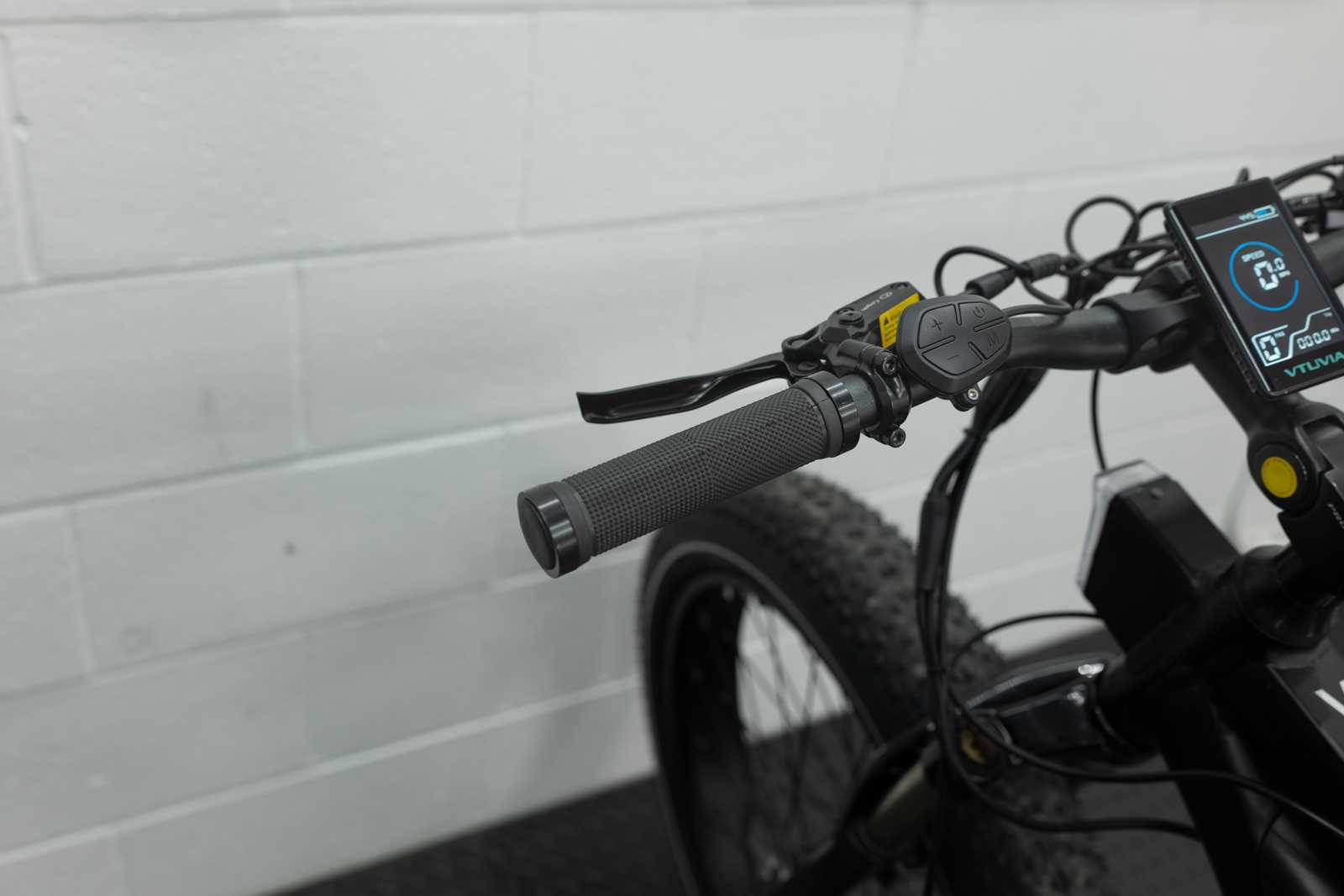

The 3″ color display pairs with a four-button control pad. The up and down buttons control the PAS levels and the menu options; the mode button cycles through current, average, and max speeds.
Holding the up button turns the headlight on or off. Holding the down button turns on walk mode. Pressing and holding the menu button activates the USB port on the display. Double-clicking the menu button opens the advanced settings.
The bike doesn’t need a key to operate, and it doesn’t feature a display lock, so removing the battery is the best way to ensure someone cannot turn the bike on.

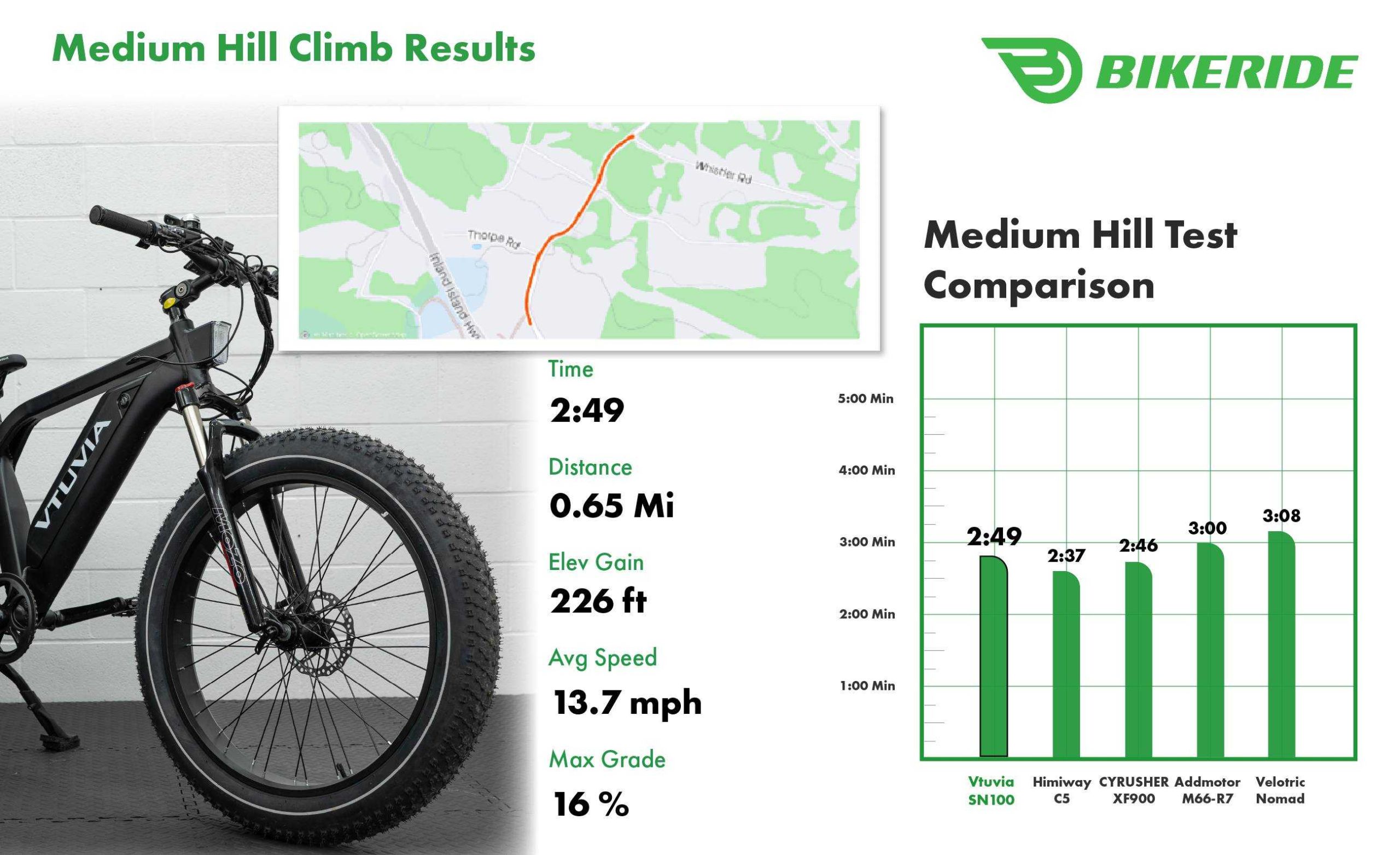

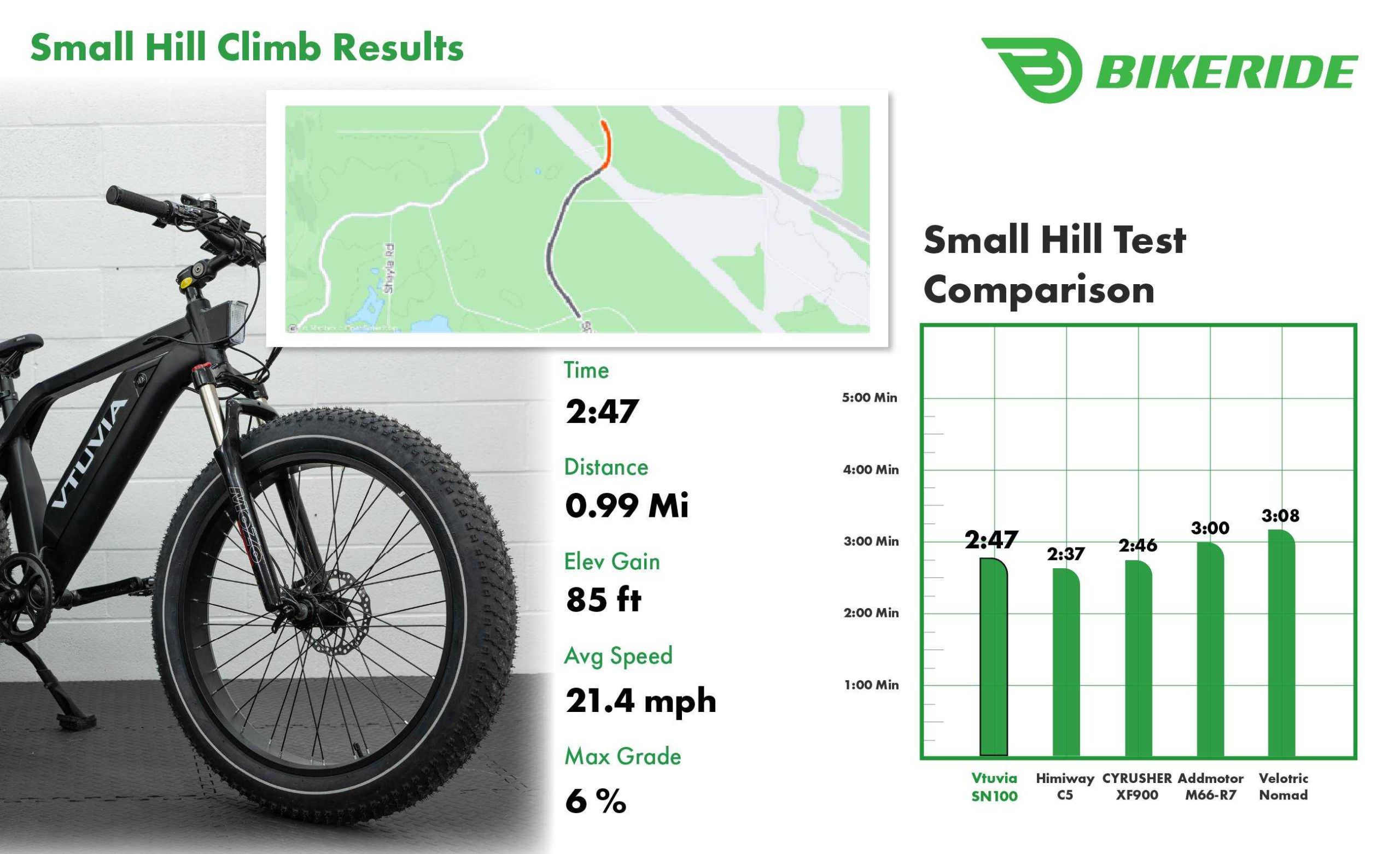

The bike performed fairly well in our hill climbing tests, with speeds slightly higher than other 750W e-bikes.

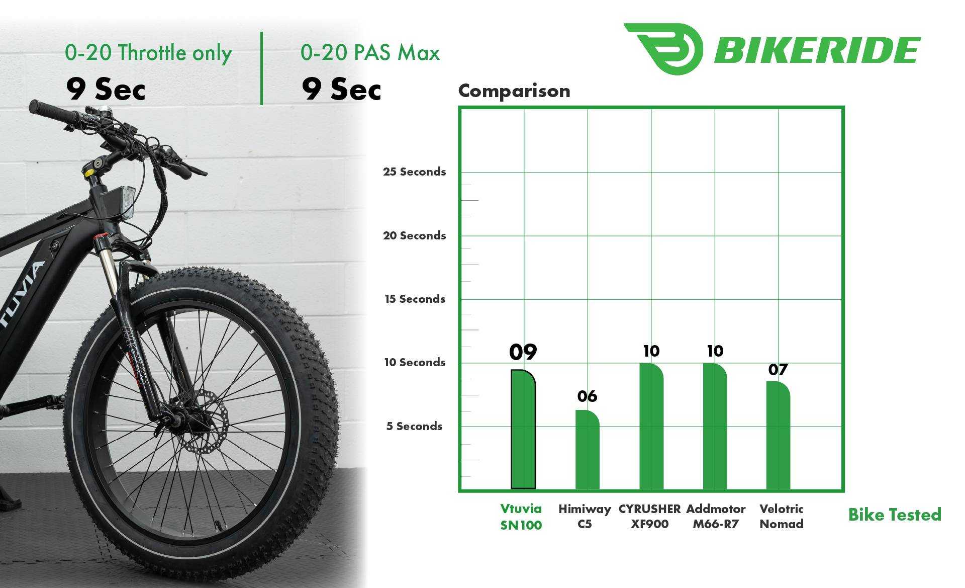

The bike also performed well in our 0-20mph acceleration test, managing nine seconds with PAS and throttle. The SN100’s smooth yet fast acceleration is our favorite feature.

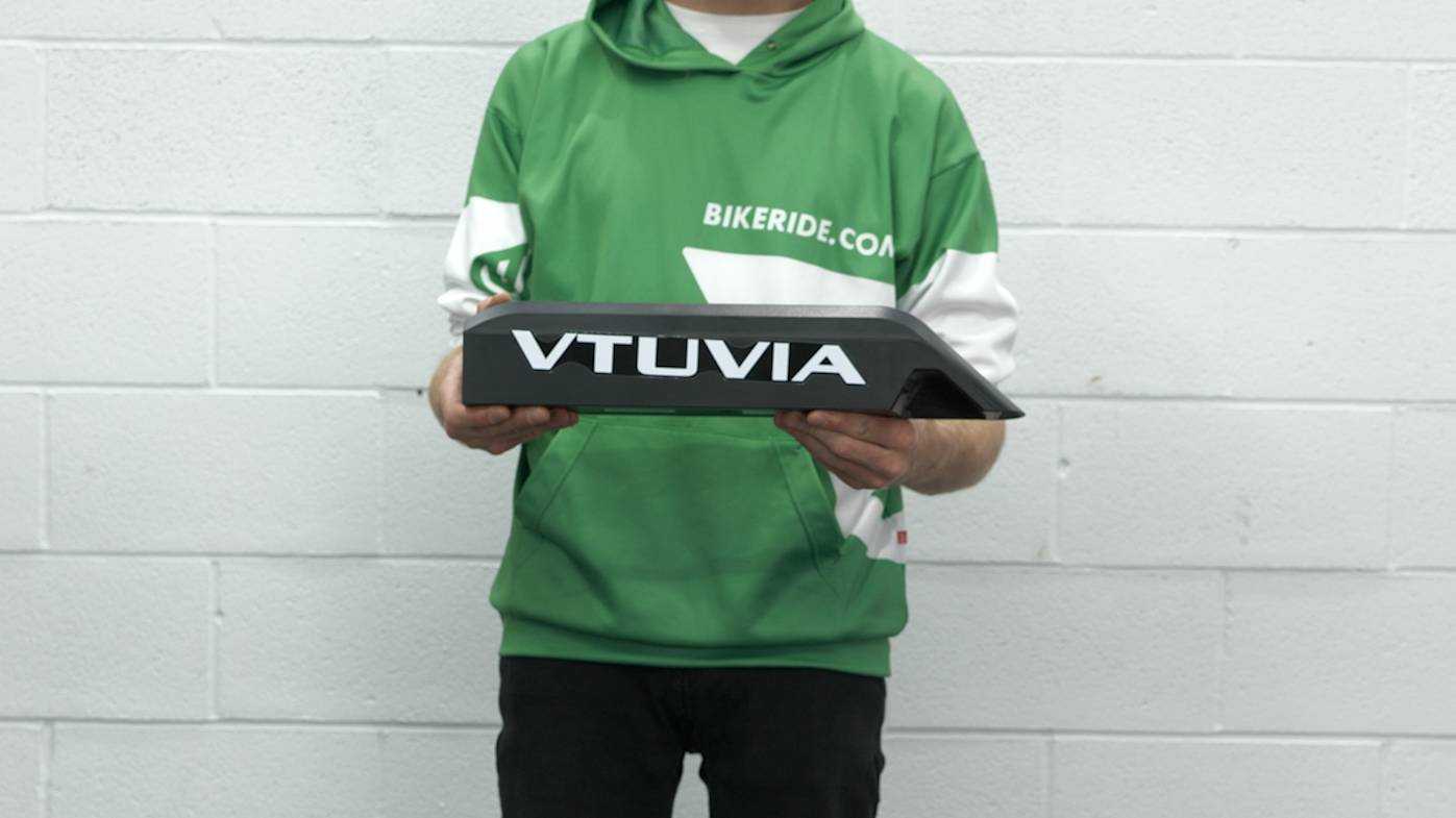

The updated SN100 has a 48V 14Ah (672Wh) battery with UL 2849 certification. It’s integrated into the down tube and is easy to remove, with the keyhole located on the upper part of the down tube.
The bike comes with a basic 2A charger, which takes about seven hours to charge fully. This battery is slightly smaller than average, which was reflected in our first range test, in which we covered only 22.65 miles at 16.6mph average using the highest assist level (PAS 5). This is lower than the average distance covered by similar bikes.
In assist level 3, we covered almost 38 miles with an average speed of 14.5mph. This is a closer representation of the real-world range.

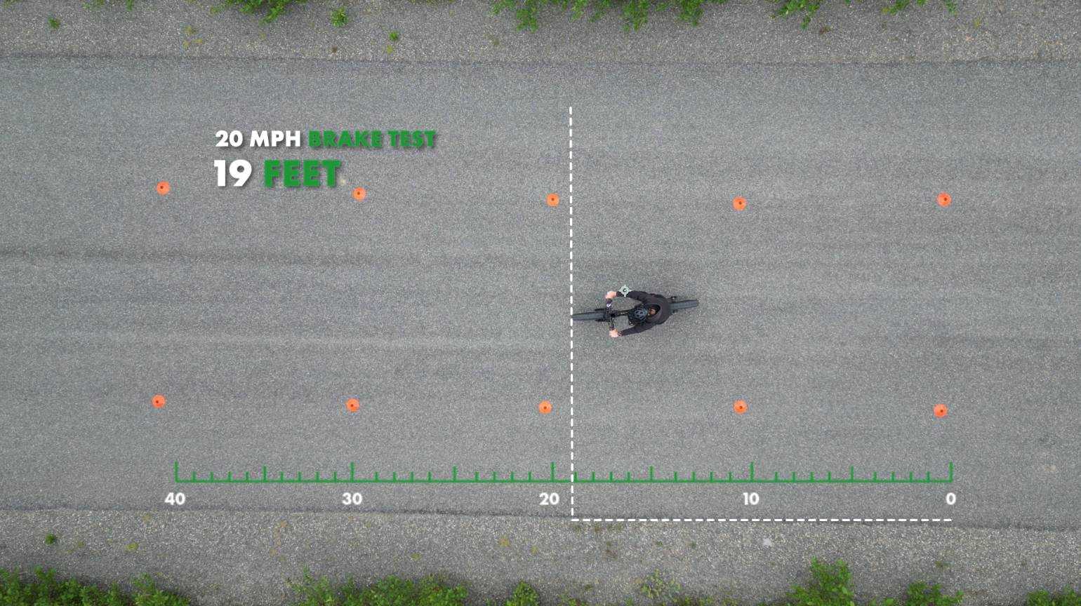

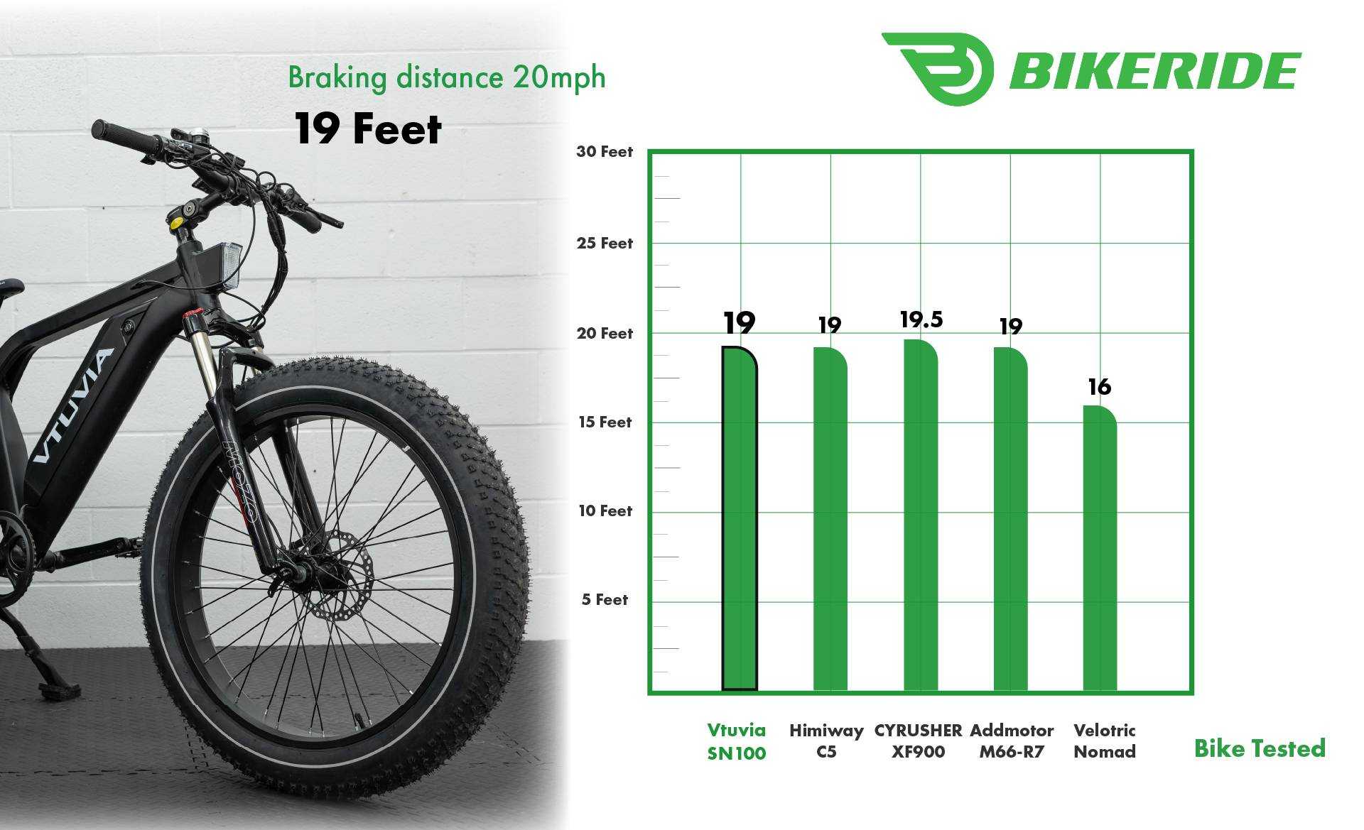

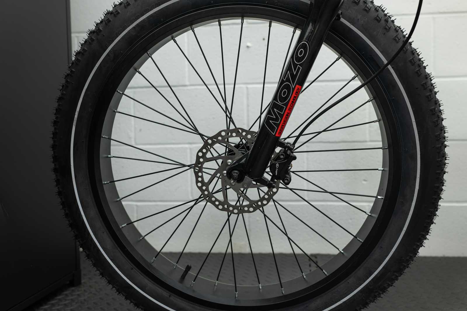

The SN100 has two-piston Logan hydraulic disk brakes with 160mm rotors and reach-adjustable aluminum levers.
This brakeset is cheaper than Tektro or Shimano alternatives. However, it performed well in our tests, with an average stopping distance of 19 feet.
This result is in line with similar e-bikes. That said, I would appreciate having larger 180mm rotors as they help shed heat that builds up on longer descents, deteriorating braking power.

Finally, the single-sided kickstand works as required but gets in the way when pedaling because of the chainstay design.
