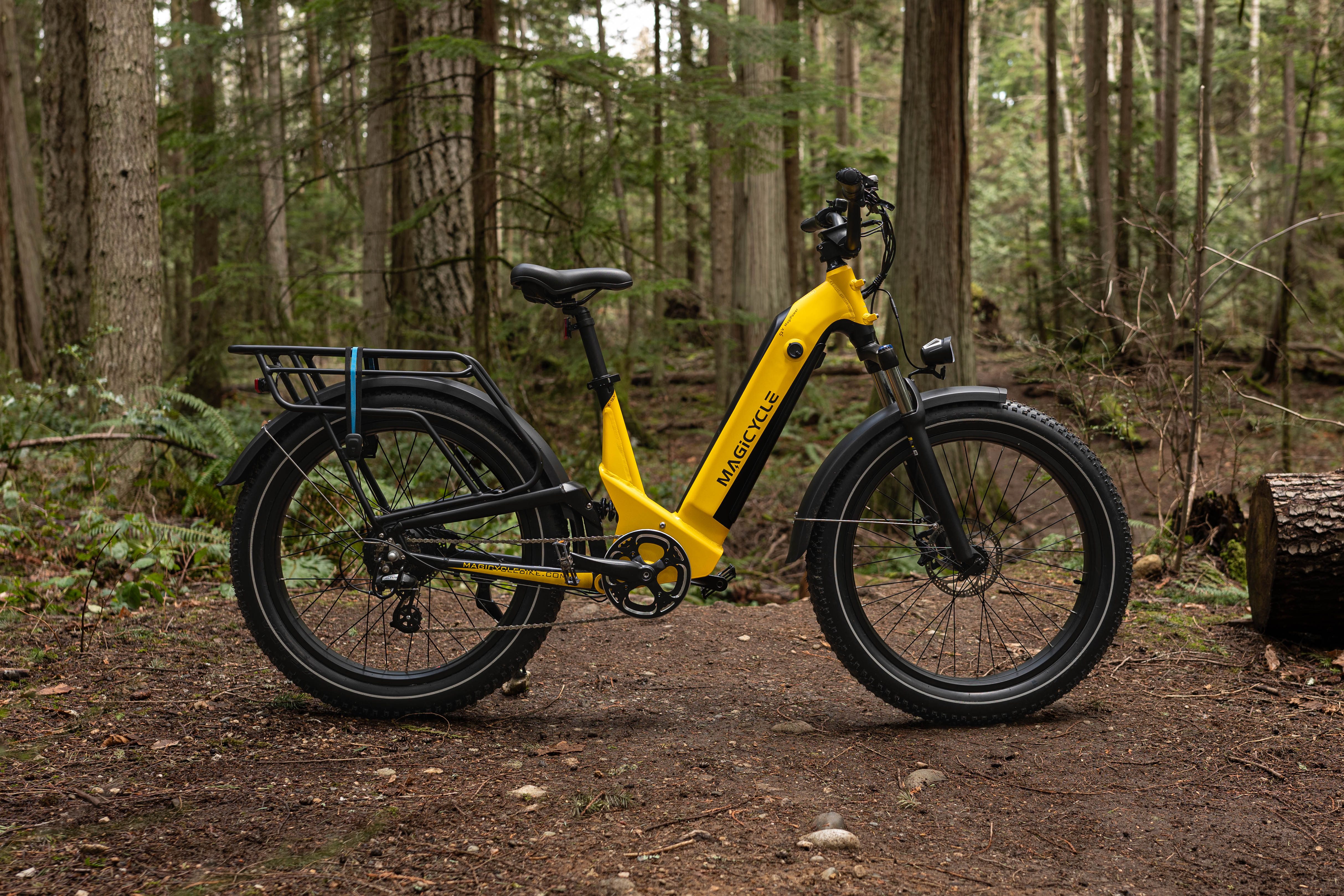

The Magicycle Deer is a full-suspension fat-tire e-bike with a 750W hub motor and a 52V battery. It reached 20 mph in 7 seconds on pedal assist, and its suspension kept us comfortable in the saddle on rough gravel roads. On the other hand, it lasted just 27 miles at max assist, it needed a lengthy 27 feet to stop from 20 mph, and it felt cramped for our 6'0" tester. Magicycle has since released the Deer 2.0.
  • Quick to 20 mph: 7 seconds
  • Climbs most hills with ease
  • Comfortable seated ride on rough roads
  • Large color display with deep settings
  • Longest stop in the comparison group: 27 feet
  • Cramped for a 6'0" rider

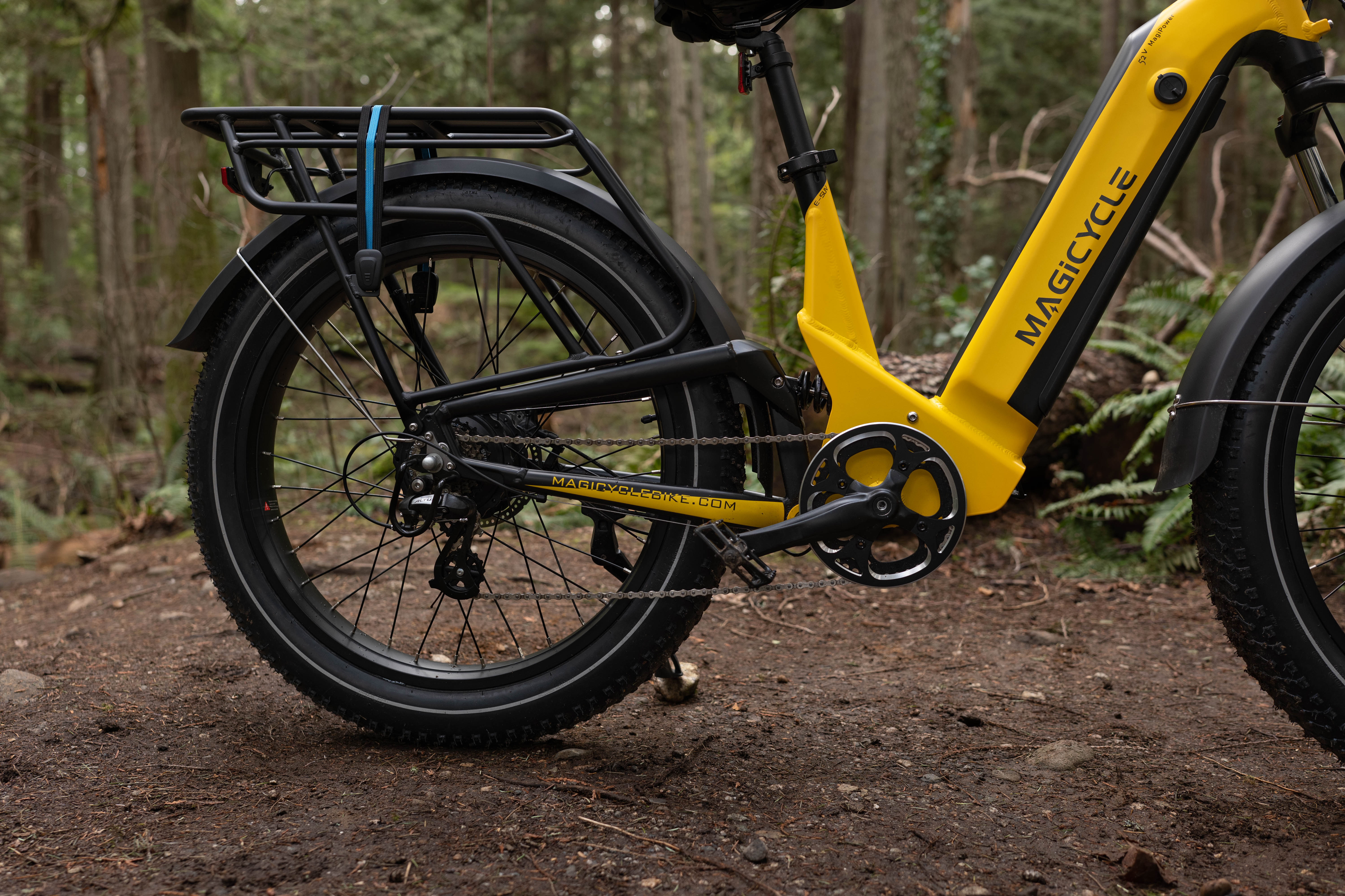

  • Rear pivots flex from side to side

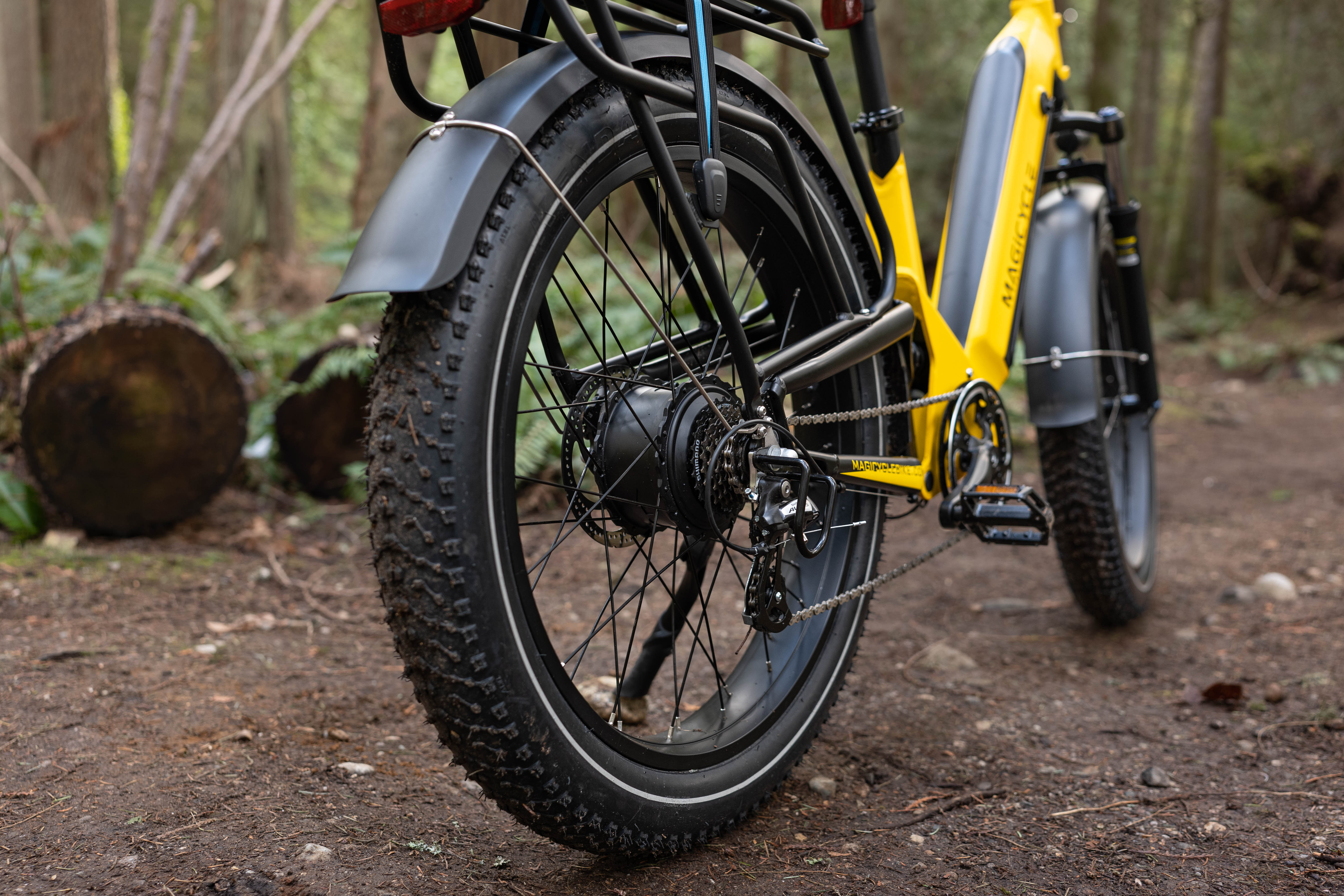

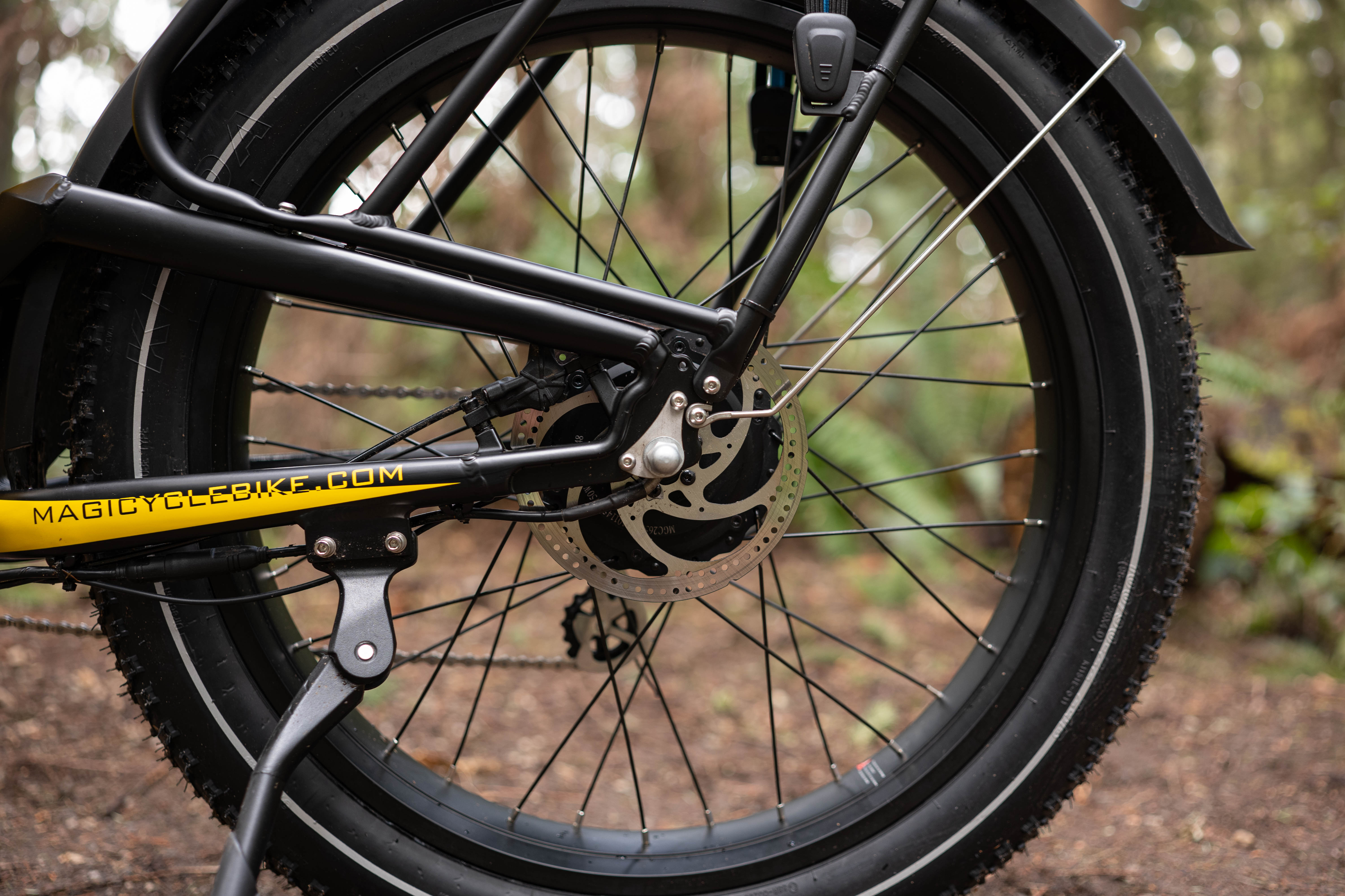

The Magicycle Deer's rear wheel from behind, with the hub motor at its center and the 4-inch Kenda tire
The 750W rear hub motor: 96 Nm, claimed.

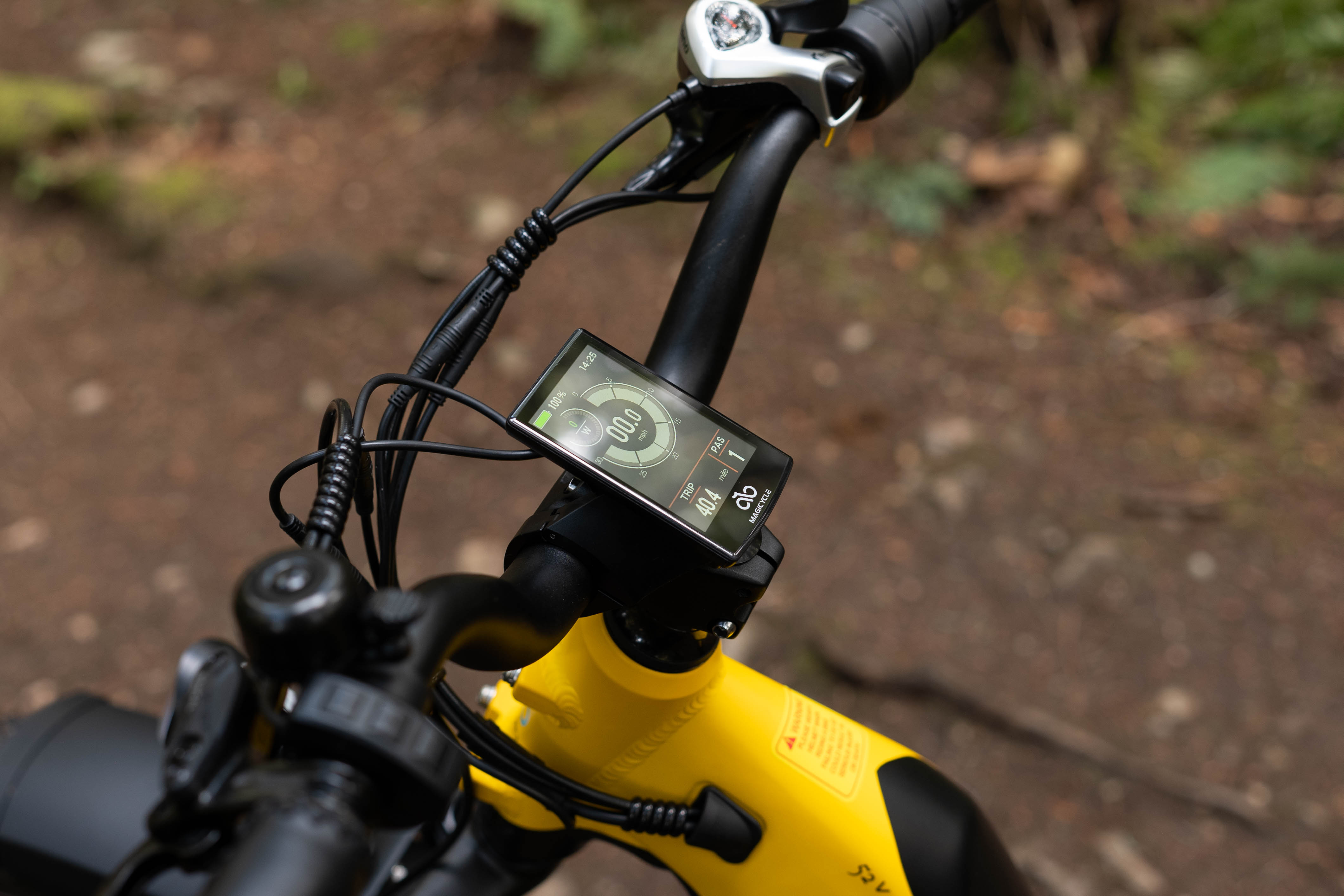

The Deer ships as a Class 2 e-bike, and the speed limit can be set anywhere from 8 to 28 mph in the display menu. The half-twist throttle alone took us to 25 mph. There are seven assist levels as shipped, and the menu can change that to three, five, or nine. Holding the throttle for more than ten seconds starts cruise control.
The right side of the Magicycle Deer's handlebar: the leather grip, the shifter and the color display
The right grip, shifter, and display.
Class:  Class 2 as shipped, limit adjustable to 28 mphAssist levels:  seven as shipped (three, five, or nine in the menu)Throttle:  half-twist, right gripLevel speeds as shipped:  9 mph at level 1, 23 mph at level 7
A throttle that runs past 20 mph doesn't meet Class 2 or Class 3 rules. Many trails and multi-use paths restrict faster e-bikes, so check local rules before raising the limit.

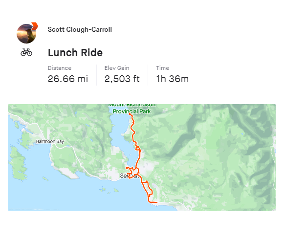

At maximum assist on our original test course, the Deer lasted 26.66 miles, with 2,503 feet of elevation gain. That is fourth of the five bikes in this comparison group, but with two to three times the climbing per mile, so the distance doesn't tell the whole story.

Deer: 26.66 mi · 2,503 ft climbed · 1 h 36 min · 16.7 mph avgAverage of similar bikes at max assist: 32.4 mi−18% vs. similar bikesFourth of five in the group

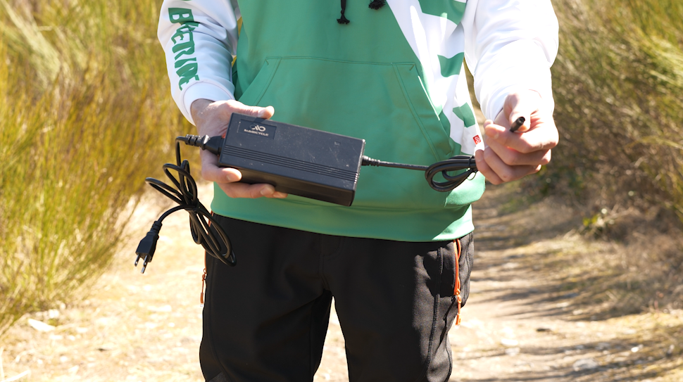

The 52V battery charges on the included 3A charger, which has its own cooling fan. By our calculation a full charge takes at least 6.7 hours (20Ah ÷ 3A). Magicycle quotes 4 to 7 hours. The battery can be charged on or off the bike.
Charge time: 6.7 h (calculated)Average: 6.3 h

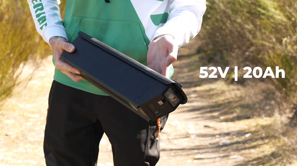

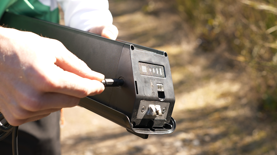

The 52V 20Ah battery (1,040 Wh) uses LG 21700 cells and sits inside the down tube. To remove it, turn the key in the side of the frame, then release the battery with the knob at its top. It slides in and out only when the fork is pointing straight ahead. The battery is heavy, but it is well hidden and held securely in the frame.
Removing the battery from the down tube.
✓ Removable battery, keyed lock✓ Charges on or off the bike✓ Motor IP55, battery IPX6, controller IPX8 (claimed)
Charge-gauge accuracy2/5Drops fast on steep climbs, and the bike shut off with 5% still showing.
Battery removal and locking3/5Slides in and out easily with the key and knob, once the fork is straight.

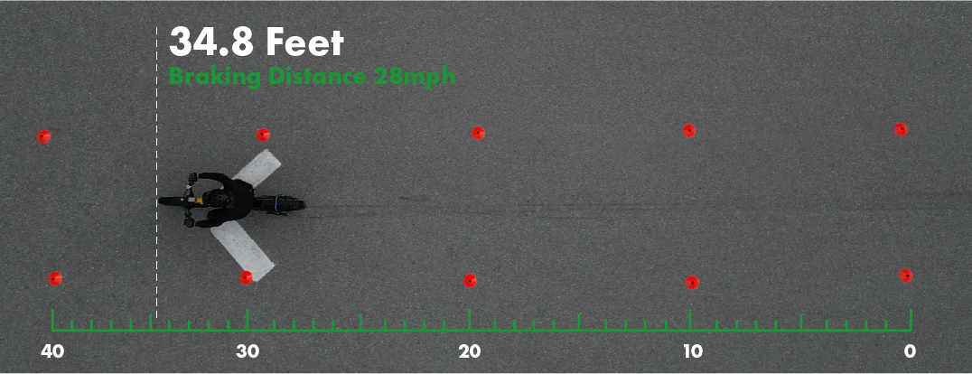

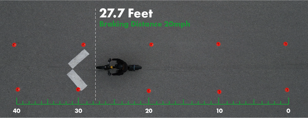

Brake test: 20 to 0 mph
Measured
The Bengal Ares 3B hydraulic brakes have 180 mm rotors. The Deer needed 27 feet to stop from 20 mph. That is the longest stop in this comparison group, and much longer than the average of the bikes we've brake tested. On the trail the brakes felt strong, and the rear wheel locked and skidded easily, so they need a light touch.
The stop from 20 mph, seen from above.

Magicycle Deer27 ft
Fiido Titan23 ft
Himiway Cobra20 ft
CYCROWN Nomad Pro20 ft
Cyrusher XF90019.5 ft
Magicycle DeerComparison bikesAverage of similar bikes (19.8 ft)

16 ft (best fat-tire result)Braking distance27 ft (longest)
Deer: 27 ftAverage of similar bikes: 19.8 ftLongest in the comparison group
Brake feel and modulation2/5Below-average stopping power.

The rear pivot area, where the frame flexes.

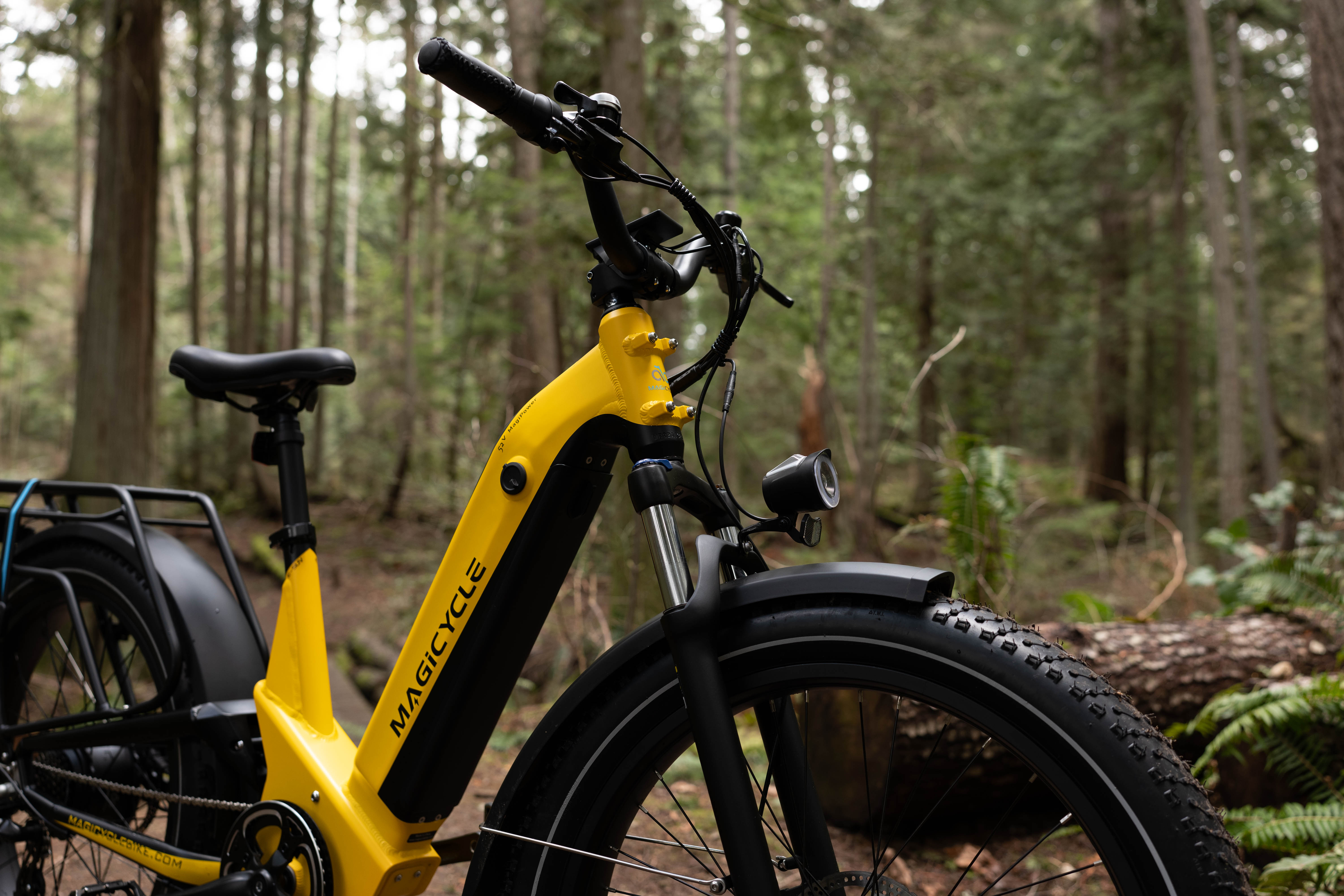

The Deer has a 100 mm coil fork with a hydraulic lockout and a coil rear shock tucked low in the frame. Together with the 4-inch tires, they soaked up bumps, rocks, and roots, on pavement and off it. We rode rocky gravel roads at 25 mph while seated and stayed comfortable. On harder hits the rear fender seemed to touch the tire.

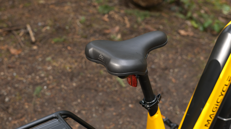

The saddle is wide and well padded, and we found it reasonably comfortable. We disliked the stitched leather grips: they are slippery, and because they don't lock on, they twist on the bar. The Wellgo platform pedals gave reasonable grip.

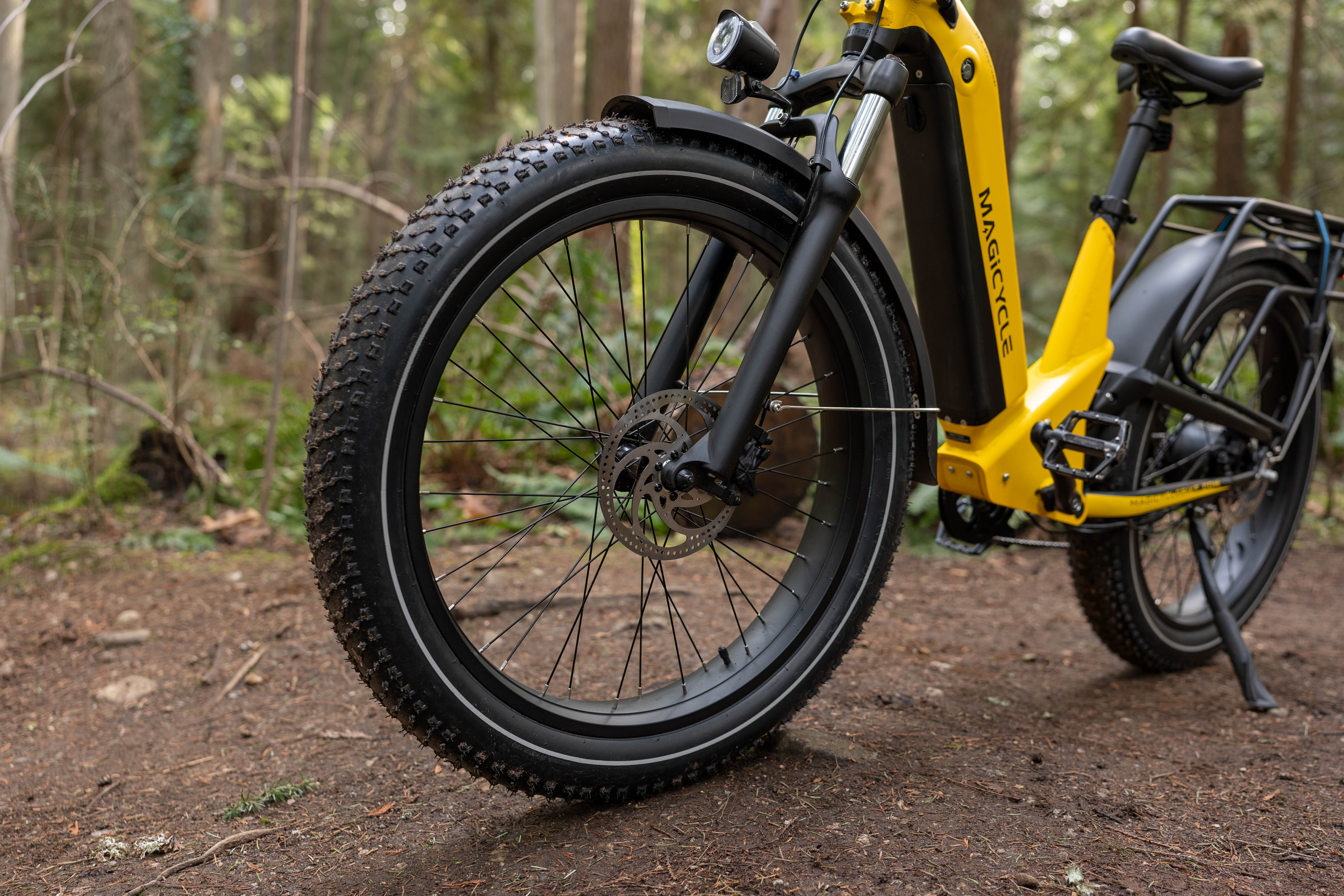

The front half of the Magicycle Deer, with its coil suspension fork, fender and 4-inch tire
The coil fork has 100 mm of travel and a lockout.

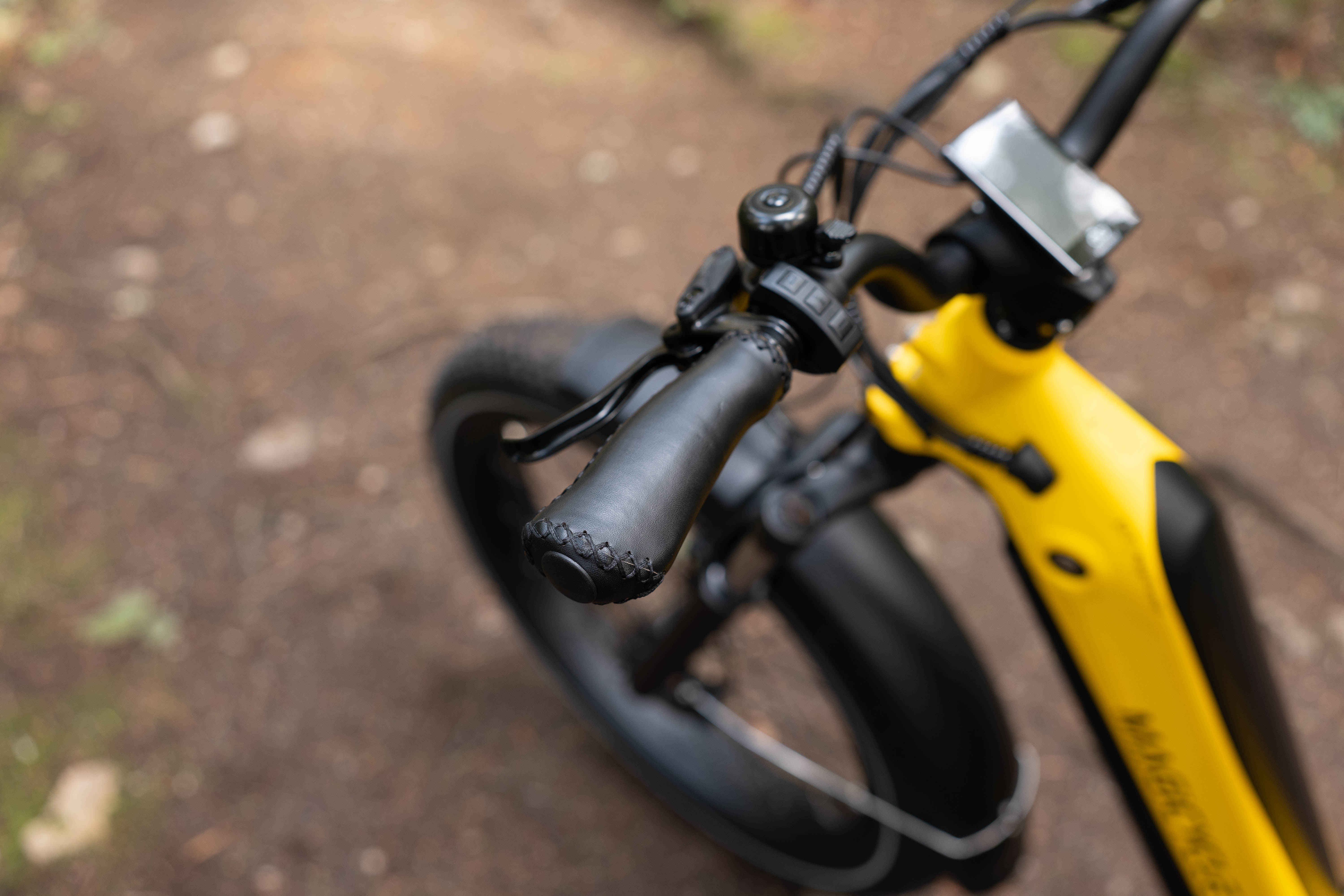

A stitched leather grip on the Magicycle Deer's handlebar
The leather grips twist on the bar.
Saddle comfort3/5Large and cushioned, with reasonable comfort.
Grips and pedals2/5Slippery leather grips that twist, and Wellgo pedals with reasonable grip.

Suspension, rear shock3/5Smooths rough ground for a seated rider, but the rear pivots move side to side.

The Magicycle Deer's riser handlebar from above, with the color display at its center
The riser bar, with the display at its center.
Cockpit adjustability3/5A standard riser bar, and the display is fixed at the center of the bar.

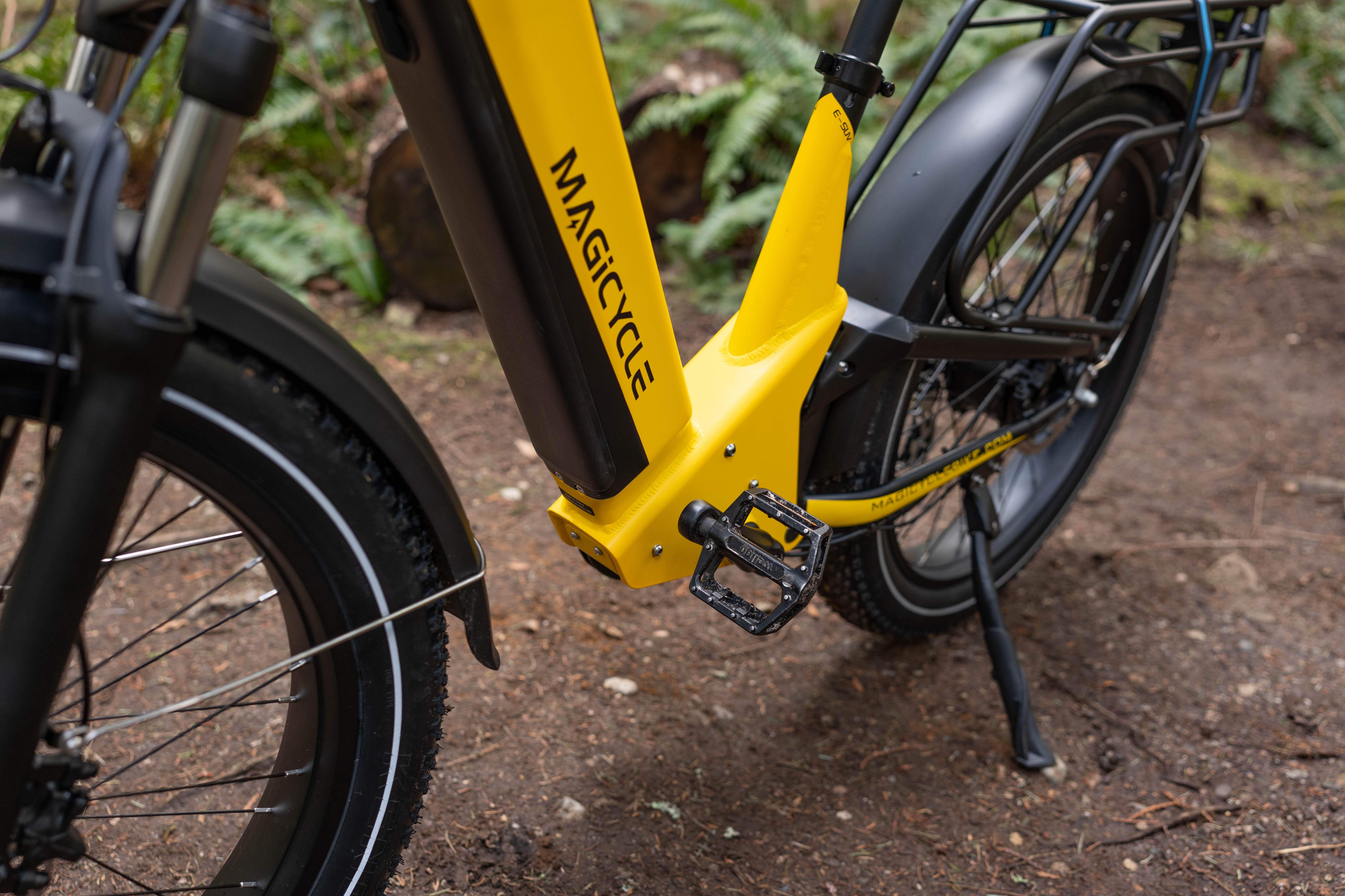

The 6061 aluminum frame is a step-through, with the battery inside the down tube and the rear shock low in the frame, ahead of the rear wheel. A robust aluminum section surrounds the bottom bracket. Even so, the frame flexes from side to side at its two rear pivots.
The Magicycle name on the Magicycle Deer's yellow down tube, which holds the battery
The down tube holds the battery.
Frame welds and finish4/5Clean welds, with good quality paint and finish.
Cable and wire integration3/5A loosely bundled cable mass at the bar, but clean internal routing through the frame.
Rattles and squeaks2/5Chain slap on rough ground, and the rear fender seems to touch the tire on hard hits.

The 26×4" Kenda tires have a knobby tread that gave good traction on trails, though we found it easy to start a slide on dirt and on pavement. They run anywhere from 5 to 30 psi.

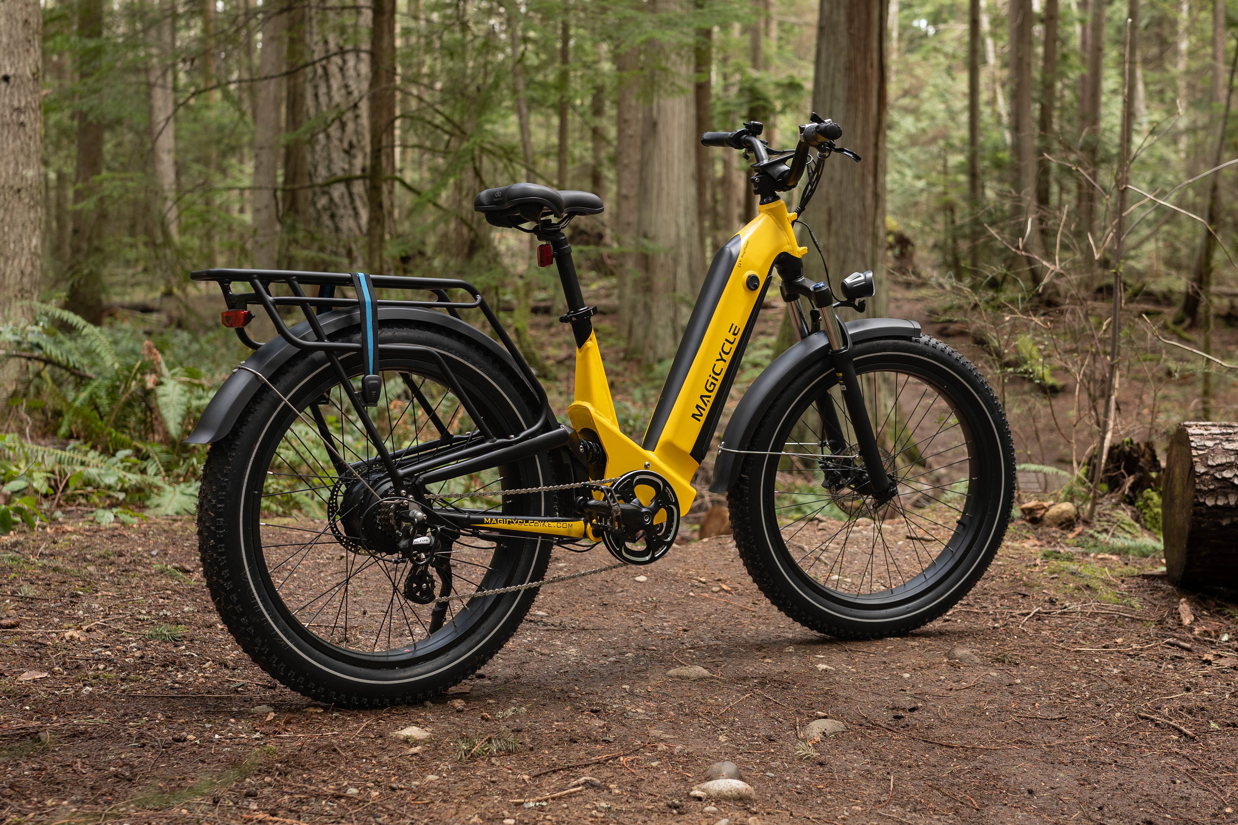

The step-through Deer comes with a rear rack, plastic fenders, front and rear lights, and a single-sided kickstand. Magicycle also sells locks, bags, baskets, and a trailer.
The Magicycle Deer's rear rack above the plastic rear fender
The rear rack and fender.
Tires3/5Knobby 4-inch Kendas with okay traction and added comfort, though easy to slide.
Included accessories4/5A rear rack, plastic fenders, integrated lights with a brake light, and a kickstand.

The large, full-color display sits at the center of the handlebar and has a USB port. It shows the battery level as a graphic and a percentage. A four-button pad by the left grip controls it. The up and down buttons step through the seven assist levels and a "P" mode that switches off both the throttle and the pedal assist.
The settings menu goes further than most. The speed limit, number of assist levels, power of each level, slow start, and password protection are all adjustable.
✓ USB port✓ Adjustable speed limit (8–28 mph)✓ Adjustable assist levels and power
Display readability4/5Large, full-color, and easy to read.
Controls4/5A four-button pad by the left grip, and a deep settings menu.

The battery locks into the frame with a key, and the display menu can set a password.
✓ Keyed battery lock✓ Display password

Maintenance burden2/5Full suspension adds upkeep, and the wobbly rear pivots are a long-term concern.

The Deer has a 52V 20Ah battery with LG cells, hydraulic disc brakes, full suspension, and a full-color display. It also has a cadence sensor, an entry-level 7-speed drivetrain, and slip-on grips.
Component level for the price4/5A big 52V battery, full suspension, and hydraulic brakes, held back by a basic 7-speed.

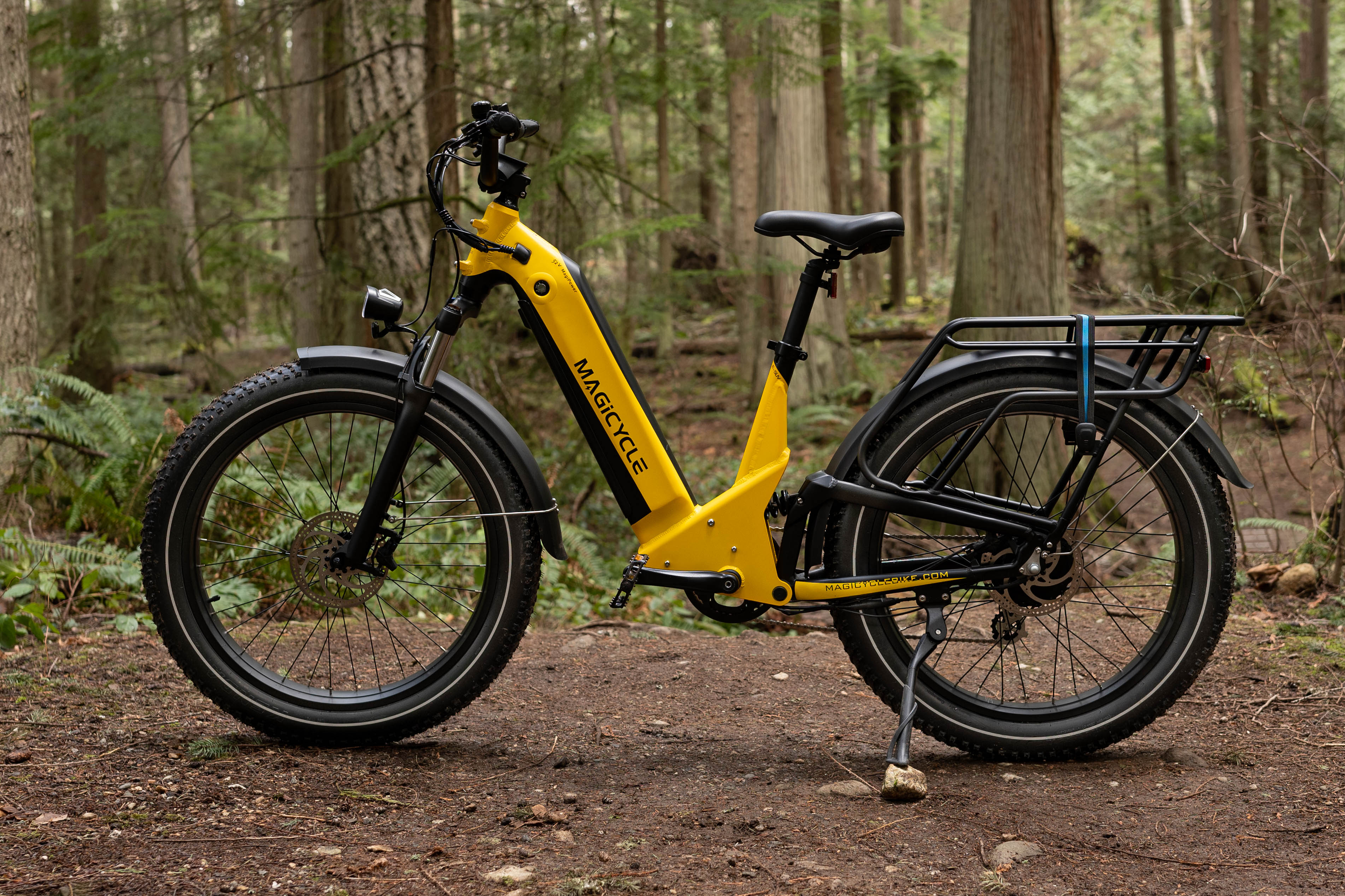

The Deer we tested is no longer in Magicycle's range, so this verdict describes the bike as we tested it. It was quick, comfortable, and well equipped, with a large battery. Against that, it covered a third of its claimed range, took longer to stop than most, and wasn't suitable for the top of its claimed height range.
The Magicycle Deer from the front three-quarter on a forest trail
The Deer in yellow.
Value verdict4/5Plenty of battery and suspension for the money, if you can live with 92 pounds.

Range (max assist)vs. 16 other fat-tire e-bikes26.66 mi32.4 mi29.6 mi
Range vs claimedvs. 17 other fat-tire e-bikes33%58%54%

Braking and safety
Brake test, 20–0 mphvs. 16 other fat-tire e-bikes27.0 ft19.8 ft19.2 ft

Battery52V 20Ah (1,040 Wh), LG 21700 cells, removable, keyed lock

Charger52V 3A
Charge time4–7 hours (6.7 hours calculated)
