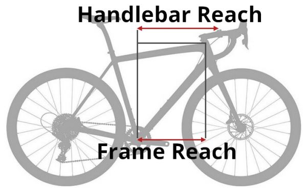

Reach
Reach relates to how comfortable you are when seated and in contact with your bike’s handlebars. Too much reach and your arms will be overextended, causing you to lean too far forward. This leads to discomfort and a lack of visibility. Too little reach and your arms will feel cramped.
If you already have a bike that fits well, you can measure the reach distances on that bike and compare them to those listed on the manufacturer’s geometry chart.
