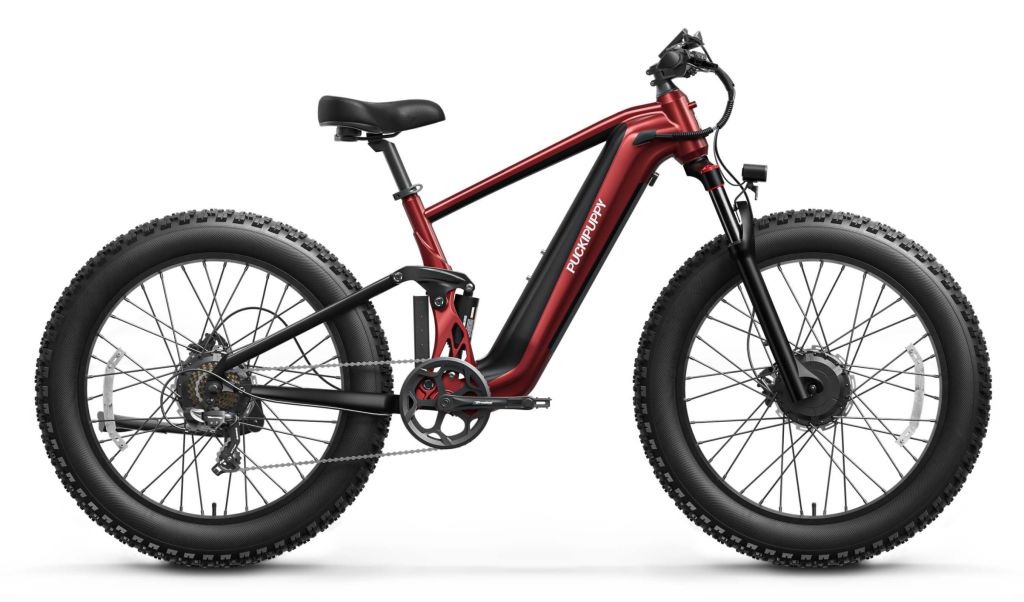

The Puckipuppy GoldenR is a full-suspension fat-tire e-bike with two motors totaling 1,250W (500W + 750W). Testers enjoy the stable handling and comfortable ride. The motors provide smooth power and, in dual motor mode, handle steep climbs with ease. Though advertised as a mountain bike, the GoldenR's size, weight, limited gearing, budget suspension and drivetrain, shuddery brakes, and uncomfortably wide saddle contradict this claim. The height range is also exaggerated. Overall, reviewers feel the GoldenR offers decent value for those who want dual motors, but its many drawbacks should be carefully considered.
76/100 based on 5 scored reviews (8 reviews in total)
Dual-Motor Performance for Under $2,000 – Puckipuppy GoldenR Review
The GoldenR is Puckipuppy’s dual-motor e-bike made to “conquer the wild” and handle “extreme” conditions.
With two hub motors and a 20Ah battery, this full-suspension e-bike should provide exciting off-road performance.
To begin the review, we describe the bike’s packaging, specs, and ride experience. Then, we reveal the pros, cons, and test results, finishing with a verdict on the GoldenR’s overall value.
Spec Run-through
The GoldenR arrives well-packed in a large bike box. Final assembly requires installing the kickstand, aligning the fork and stem, and attaching the handlebars. To finish, install the front wheel, pedals, and any accessories like lights, fenders, or racks.
Our test bike came with standard accessories like the charger, headlight, and tool kit, along with some spare bolts and brake pads and a pump.
Puckipuppy also gave us the basic accessory bundle to test. This includes a rear rack and fenders. At the time of writing, the basic bundle has been replaced by a larger “$499” bundle that’s currently being given for free, but this may change.
The GoldenR is a Class 3 e-bike with an aluminum frame. Puckipuppy markets it for off-road riding and hunting. It has a 130mm coil suspension fork, a 40mm coil shock, a Horst-style rear linkage, and a stated payload capacity of 400lb.
Puckipuppy says the single frame size fits riders from 5’4″ to 6’6″, but this isn’t true, as we discuss below.
The GoldenR has a 350W front motor and a 500W rear motor. Both are powered by a 48V, 20Ah battery. Puckipuppy says the motors have a combined peak power of 1,600W.
A selector on the left side of the handlebar allows the rider to toggle between using the rear motor alone or using both.
The thumb throttle next to the right-hand grip is limited to 20mph, but the five-level pedal assist has a top speed of 28mph. The other e-bike controls include a removable LCD mounted in the middle of the handlebar, and a five-button control pad on the left.
The GoldenR has received UL 2849 and UL 2271 certification from SGS. The bike’s IPX6 water resistance rating is solid for an off-road bike.
The GoldenR’s 26” aluminum rims are wrapped in unbranded 4” tires with a cross-country-style tread pattern. The tires are not tubeless-ready, and they don’t have puncture protection.
The drivetrain on the GoldenR is a little disappointing: bottom-tier Shimano Tourney 7-speed with a 46t chainring, and 14-28t freewheel. The Logan hydraulic disc brakes have two-piston calipers and 180mm rotors.
