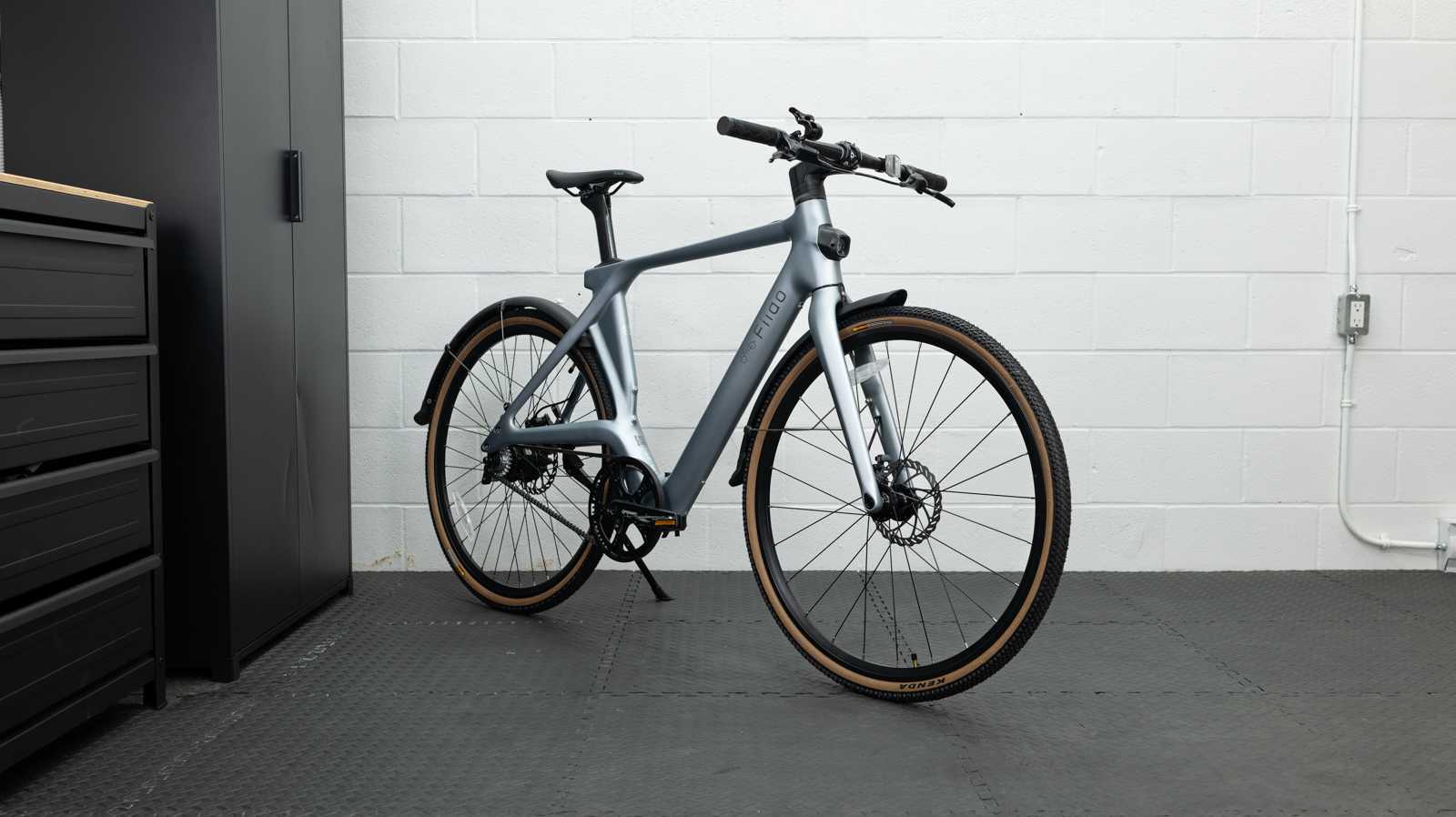

What Is the Air?

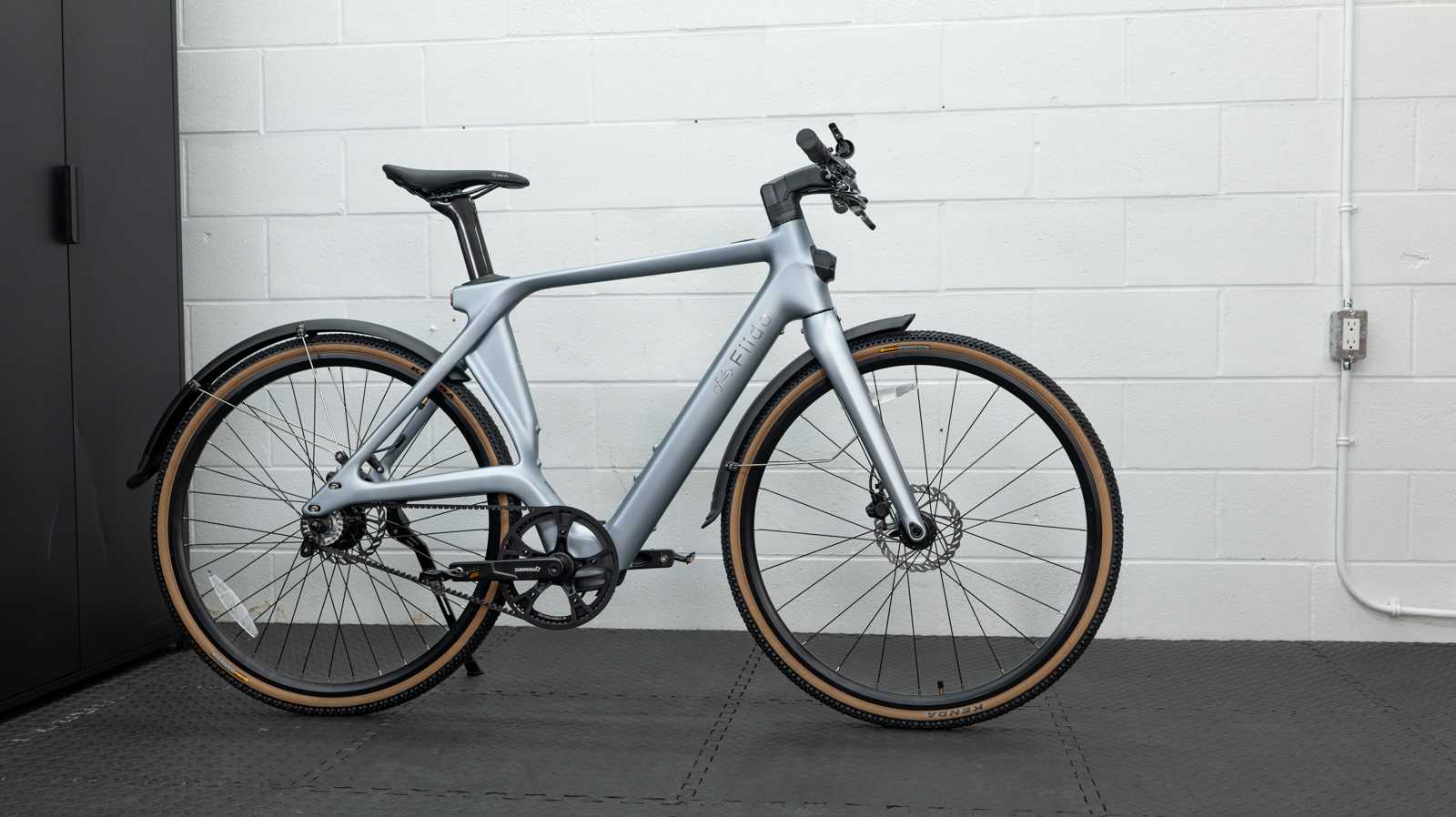

The Air is a lightweight, fixie-style city bike with a single-speed Gates Carbon belt drive, a 250W hub motor with 35Nm of torque, and a 36V, 208.8Wh battery. Without suspension, the Air relies on the carbon frameset and 700c x 40mm Kenda tires to smooth out the ride.
This e-bike only has two PAS assist levels and a max assisted speed of 15.5mph. Unfortunately, it doesn’t have a throttle, and there’s no way to increase the speed limit.
At the time of writing, the Air isn’t UL-certified, but Fiido says testing is underway, and the certification should be issued soon. The Air has a meager IP54 ingress protection rating against dust and water splashes.
Lightweight
The Air’s biggest draw is its low weight, which we measured at just 32.8lb with the optional fenders installed. This low weight makes the Air easy to pick up, carry, and transport when you’re not riding it, and it .contributes to this bike being responsive and a pleasure to ride.

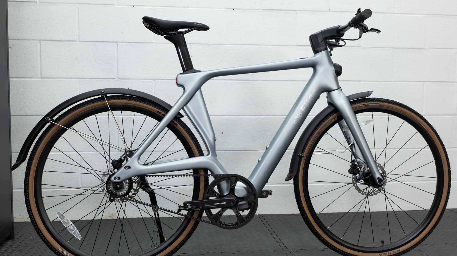

Frame and Fit
The Air is a hybrid e-bike with a sporty riding position. The bike is only available in silver, but buyers can choose from three frame sizes (M, L, XL). The frame, fork, stem, handlebar, and seatpost are all carbon fiber.
Low Weight
Fiido says the Air weighs 30.3lb, which is presumably for the smallest frame size: Medium. Our Large test bike weighs 32lb without the optional fenders. With the fenders installed, it’s 32.8lb. This isn’t as light as Fiido claims, but it’s still very light for an e-bike, especially one with 700c wheels at this price point.
The carbon construction, small motor and battery, and single-speed Gates Carbon belt drive all help keep the weight down, and Fiido says the Air can support up to 264lb.
The low weight makes the bike easy to pick up and carry. The Air is no wider than a regular bike, so it will fit anywhere most non-electric bikes will go, including almost any bike rack.

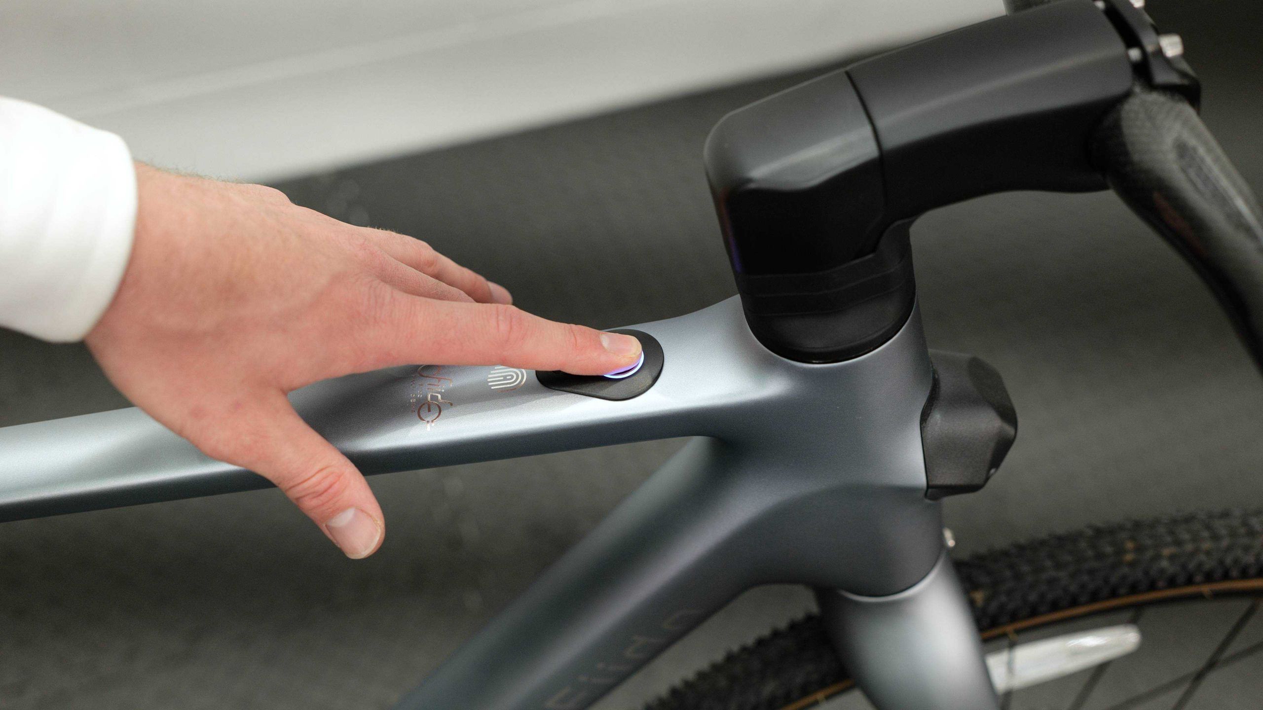

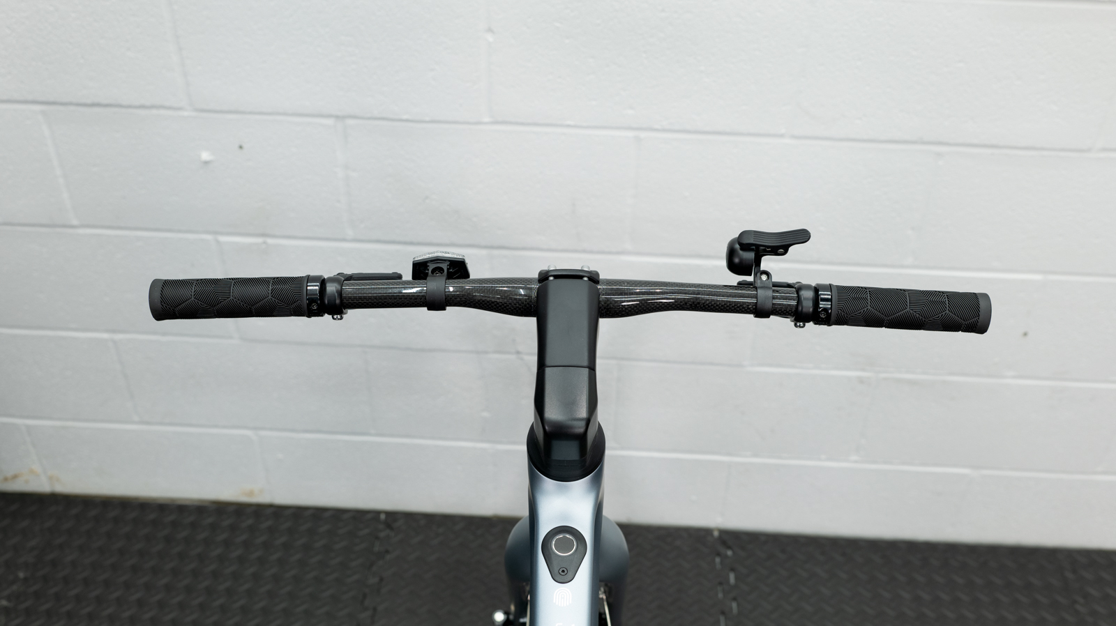

The Air’s controls are extremely simple: just a black button with a built-in fingerprint reader on the top tube and a silver power button on top of the bottom bracket. As I mentioned before, I think Fiido oversimplified things here.
As a Class 1 e-bike, the Air doesn’t have a throttle, so the motor only provides assistance when pedaling. The Class 1 speed limit in the USA is 20mph, but the Air’s motor only assists you up to 15.5mph, and there’s no option to unlock this to go faster. When you are pedaling, assistance is controlled by a Mivice S200 torque sensor.
Integration and Touchpoints
The Air has a clean front end with no display, e-bike controls, or shifter, just a set of thermoplastic rubber grips and two brake levers. That clean look is maintained by the fully integrated lighting and aero-style seatpost.
The Air comes with good-size aluminum platform pedals and the saddle is a Velo Vacuum. This is a sporty-looking number that suits the bike’s style.

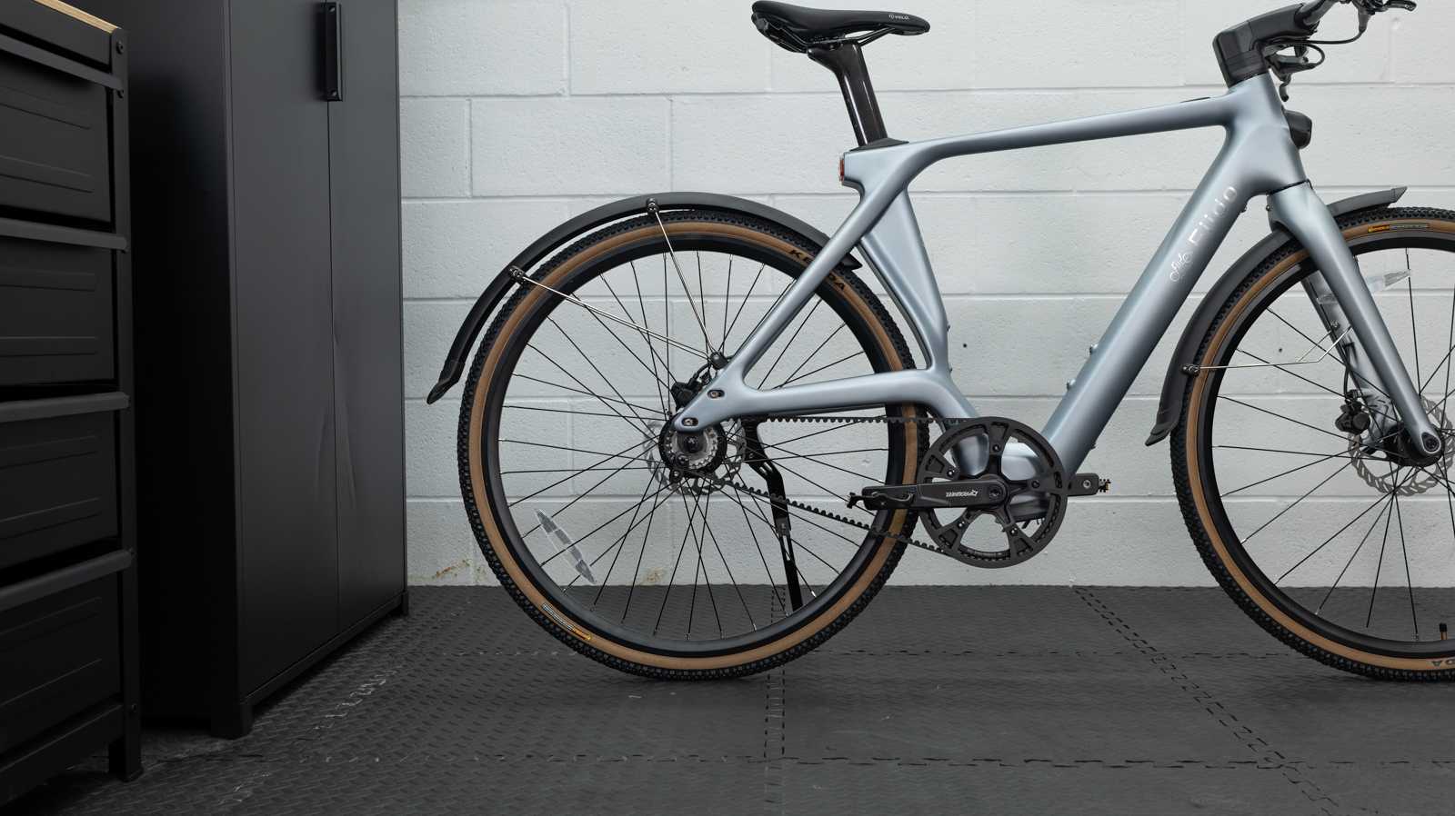

Drivetrain and Brakes

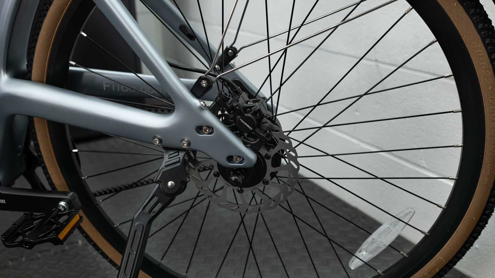

The hydraulic disc brakes and two-piston calipers provide plenty of power, and the brake levers have adjustable reach.
The single-speed belt drivetrain comprises a 60t chainring and 22t cog at the back. Belt drives are known for being durable and clean. There’s also no need to worry about cleaning and lubricating a belt drive, and they’re quieter than chain drives.
Normally, with belt-drive bikes, the frame comes apart at the chainstay to get the belt on and off. On the Air, Fiido has used a clever carrier that bolts to the chainstay, making it easy to adjust the belt tension.

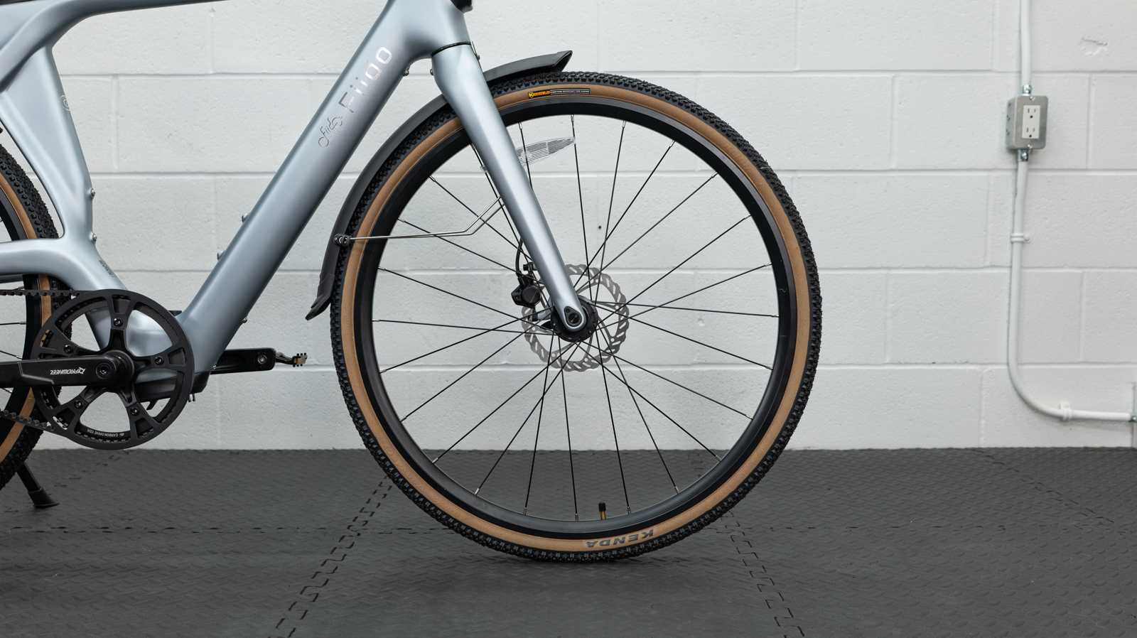

Wheels and Tires
The front wheel is secured to the fork with a 100mm x 15mm thru-axle, enhancing the front-end stiffness and making it easy to remove and refit the front wheel. The Air’s 700c double-walled aluminum rims come wrapped in 40mm tires.
Larger diameter wheels roll over bumps better than the smaller wheels found on many e-bikes, and the decently wide tires provide some insulation from road buzz and small bumps while still rolling quickly. These tires have puncture protection and a light knobby tread that Fiido says is ideal for gravel.
The frame has two sets of bottle cage mounts in the main triangle and some odd-looking rack mounts at the rear. Fiido doesn’t currently offer a rack for the Air, which may deter some commuters.
Between the weird rack mounting points, the aero seatpost, and the unusual frame design, it may be difficult to find an after-market rack that fits, and any rack that works would block the integrated rear light.

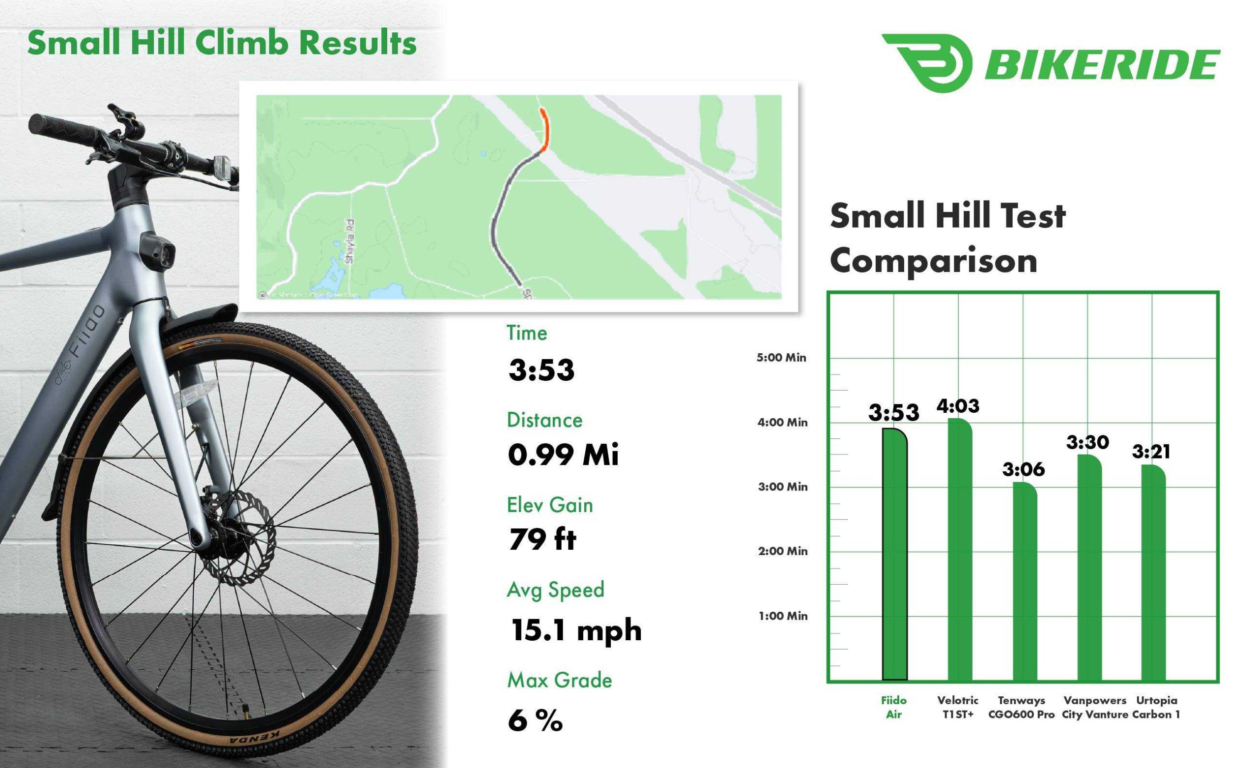

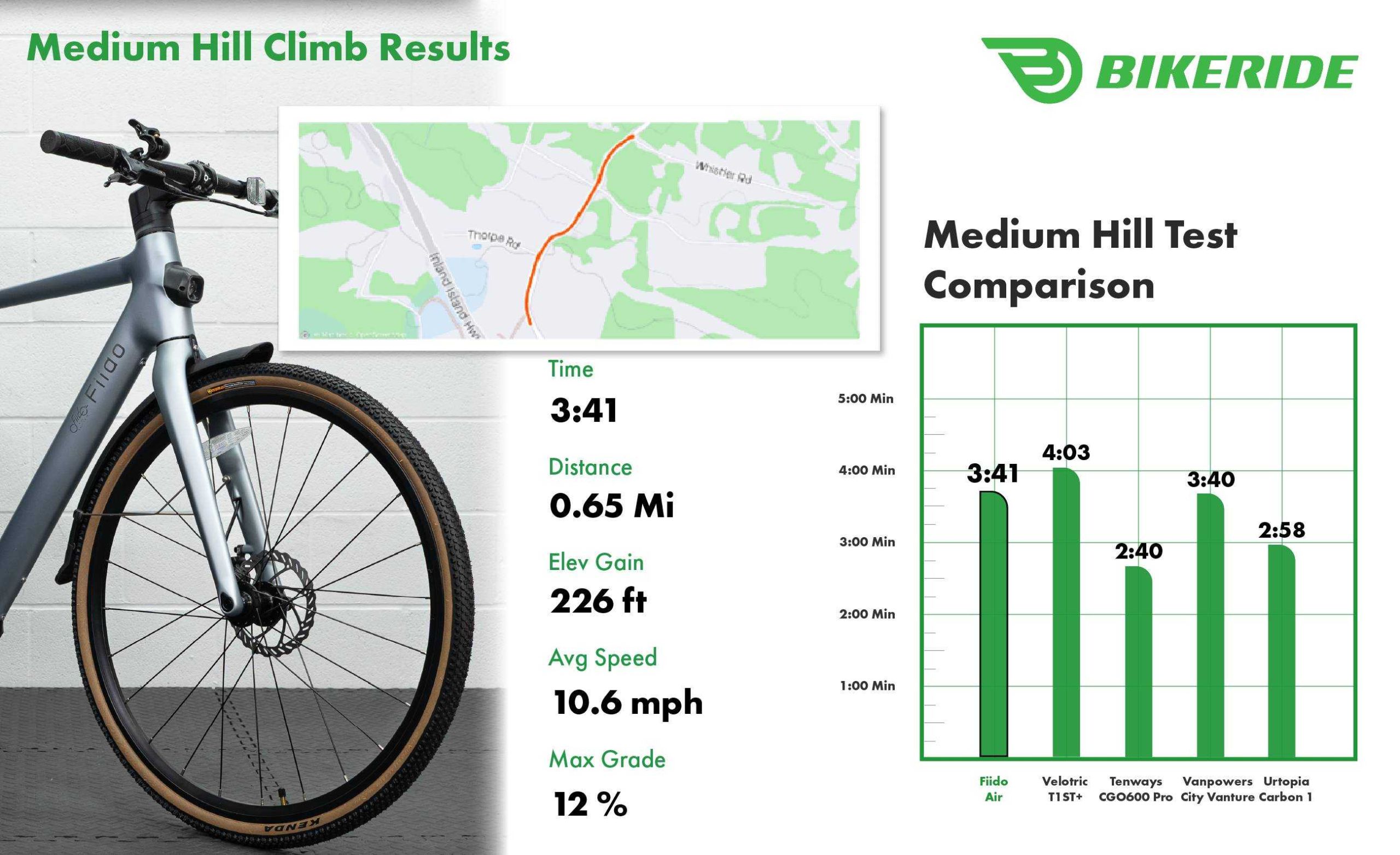

Hill Climb Tests
Overall, the Air proved disappointing in our hill-climb tests. The impressively low weight and efficient tires don’t make up for the motor’s low torque output and the lack of gears.
The Air only really has enough kick to make it up small hills. The bike accelerates slowly and struggles to maintain speed on shallow inclines. Only Velotric’s T1 ST Plus took longer than the Fiido Air.
Three of the comparison bikes, which, admittedly, have larger 350W motors, were much faster up the small hill. The single-speed Tenways CGO600 Pro completed the climb almost a minute faster.
The Air performed even worse in the steeper hill test. To keep the pedals turning over, I had to pedal out of the saddle. Like in the small hill test, the T1 ST Plus came last, but the CGO600 Pro was over a minute faster than the Air.

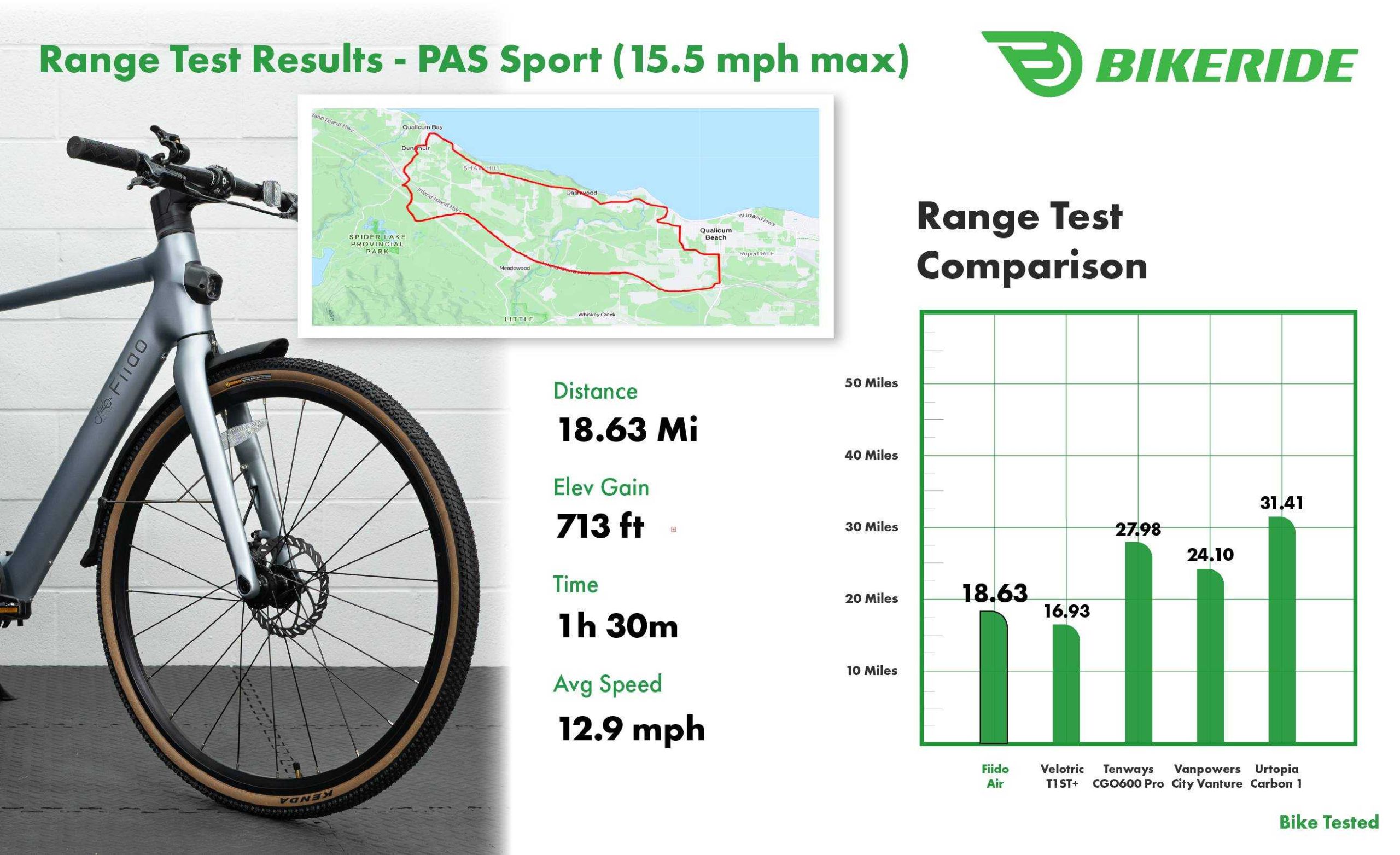

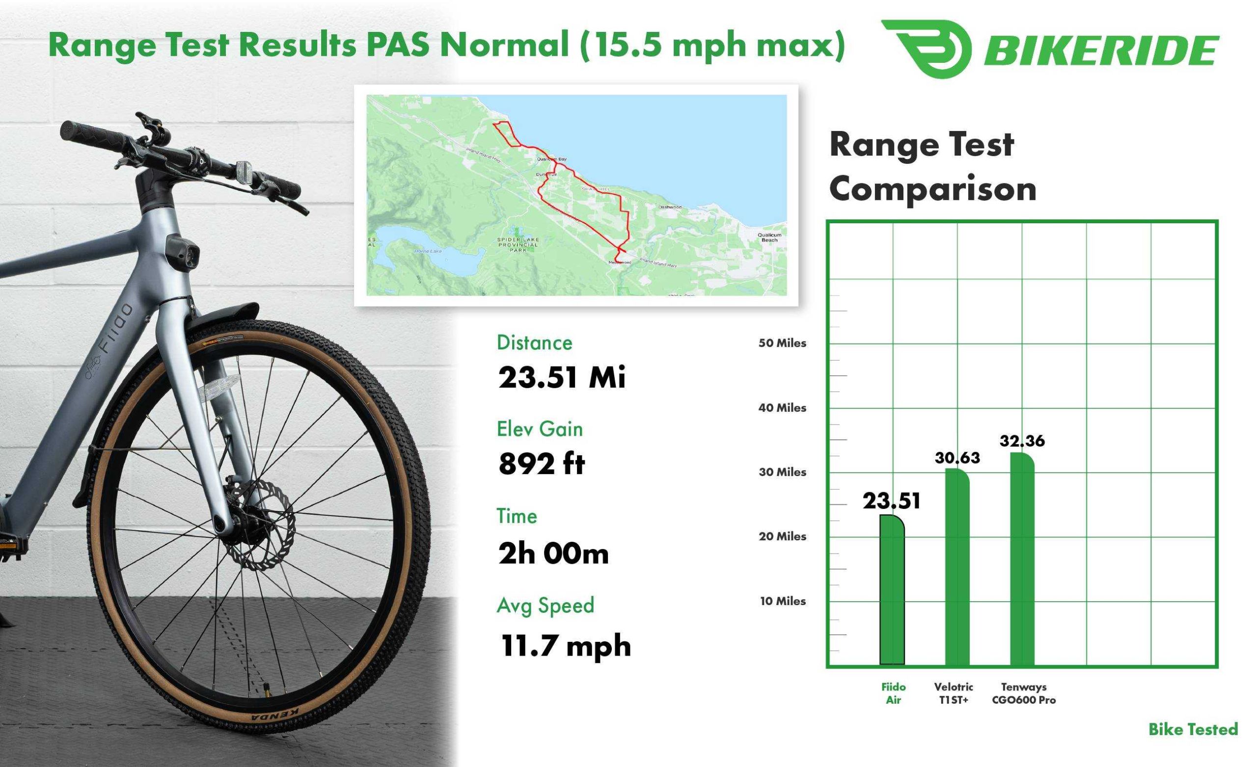

Range Tests
Unlike most e-bikes, including the comparison models we’ve chosen, the Air doesn’t have the usual five pedal assist levels. It makes do with two modes: Normal and Sport.
Using Sport mode, the Air lasted just 18.6 miles. Once again, only the T1 ST Plus did worse. The Urtopia Carbon 1 traveled almost 70% farther than the Air.
The Air’s range improves substantially in Normal mode, but it’s still underwhelming compared to the competition. In this test, even the Velotric outperforms the Fiido by quite a margin, and the Urtopia manages almost 33 miles, compared to the Air’s 23.5 miles.
The Fiido Air isn’t a great choice for those who need plenty of range, but at least it charges in less than four hours.

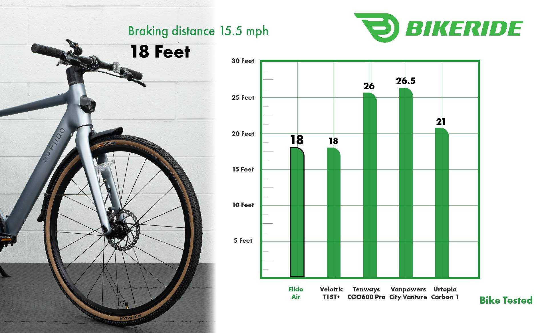

Brake Tests
Our braking tests are usually done from 20mph, but as the Air is limited to 15.5mph, we used that speed instead.
This bike took 18 feet to stop from 15.5mph. This is a longer distance than many e-bikes that completed the test from 20mph.
The three comparison bikes stopped from 20mph, and even from this higher speed, the Urtopia Carbon 1 needed only 21 feet to stop.

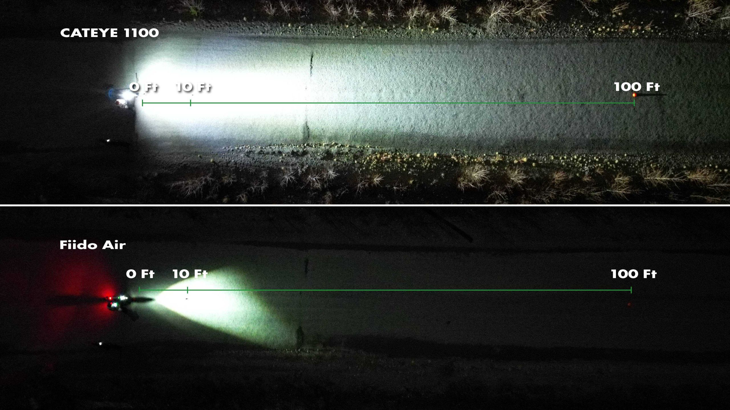

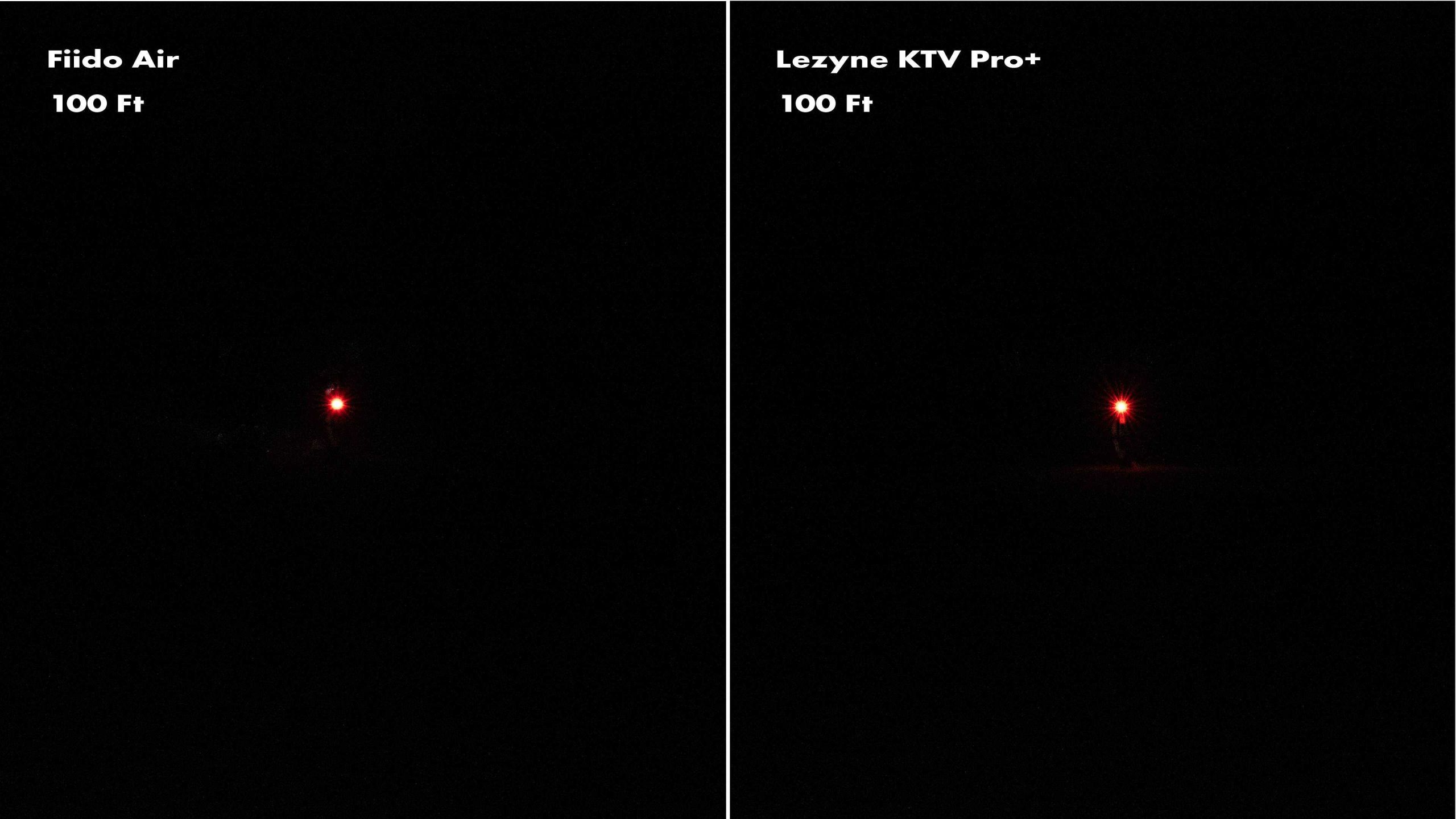

Light Tests
The Air’s fully integrated lighting seems like an attractive feature, but it’s not very functional.
The headlight is aimed down too steeply and can’t be adjusted, so it illuminates the road too close to the bike. It’s also dim. In the comparison tests, our Cateye 1100 reference light is much brighter, even at its lowest setting of 400 lumens.
The rear light is large and bright, but there’s no brake activation. This is disappointing, given the Air is supposed to be a high-tech take on the urban e-bike.
For those who plan to ride at night, we recommend adding an after-market front light to enhance visibility and to give a better view of the road ahead.

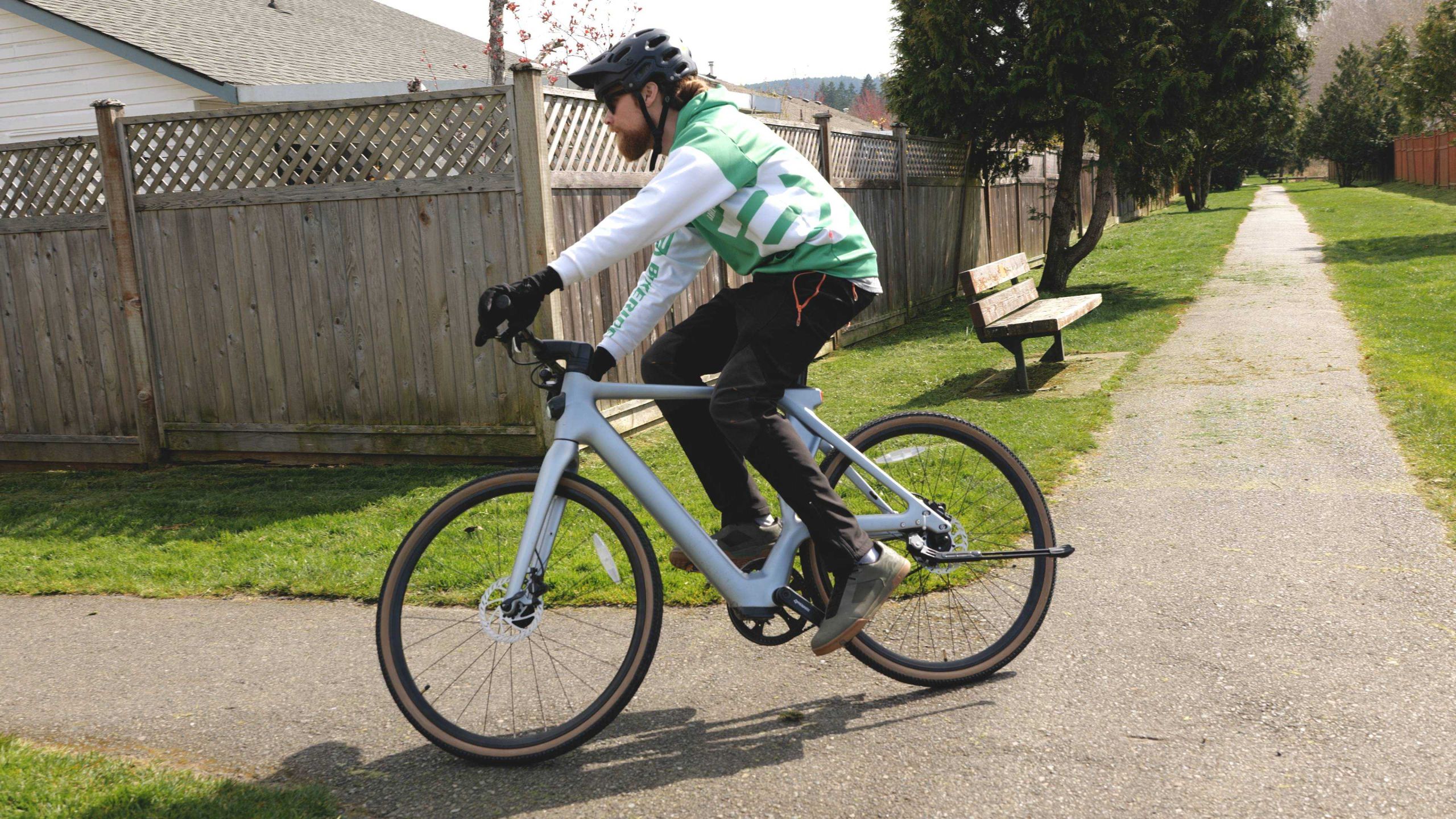

Riding the Air
The Air gets many of the basics right: it feels very light, it’s easy to maneuver, and it accelerates well over flat ground. It’s also relatively easy to pedal without assistance.
Hills are a different story. The single-speed drivetrain means climbing hills with the motor off is very hard work, and even with motor assistance enabled, the lack of torque and gearing makes steep hills and strong headwinds hard work.
The Air struggles to maintain speed when climbing hills, putting extra strain on the battery and the rider’s legs. Climbing any grade of more than around 8-10% is challenging, even with the motor giving full output in Sport mode.
In Normal assist mode, pulling away takes a lot of effort, and quick acceleration requires standing on the pedals.
The single-speed drivetrain doesn’t just handicap pedaling from a standstill, either. Trying to pedal faster than the 15.5mph PAS limit results in ghost pedaling. This and the resistance from the motor make trying to go faster a pointless endeavor.
The 40mm Kenda tires are fast-rolling, and the extra volume compared to narrower road tires provides welcome shock absorption when riding over broken pavement and extra traction on loose surfaces. The Air is also comfortable over light gravel.
The slightly aggressive riding position inspires pedaling and makes the bike easier to maneuver. Overall, the Air feels like a sporty bike and makes a decent option for getting exercise while having some assistance available to travel farther with less effort.
To conclude, the Large frame fit me well, and the grips and saddle were comfortable. The only issue was my size 13 shoes kept colliding with the kickstand and non-drive side chainstay. So, riders taller than 6’ should consider XL frame, but those with large feet should look elsewhere.

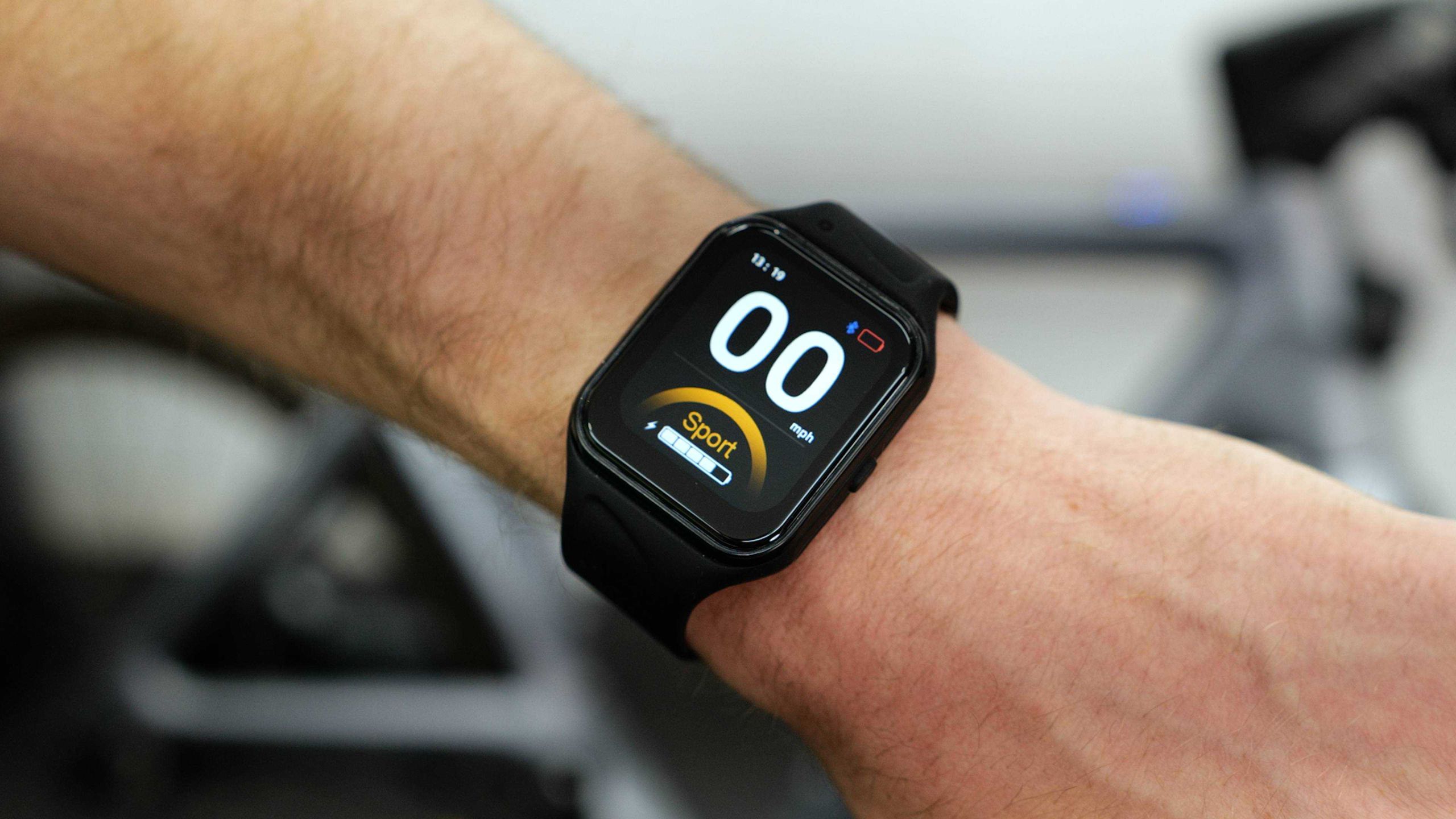

Testing the Fiido Smartwatch
The Air marks our first opportunity to test the Fiido watch. At the time of writing, Fiido is including the watch for free. If they start charging for it, but it doesn’t seem worth paying for. Even as a free extra, it’s frustrating to use.
Again, the lack of an option on the Fiido watch to choose or disable Bluetooth connections and the risk of the system getting confused and making the bike useless, at least for a few minutes. The watch also has poor battery life.
The watch has two modes: Watch and Bike. Once linked to the bike, the watch automatically enters bike mode whenever it has connected to the bike. Holding the side buttons for three seconds switches mode.
In bike mode, the watch has a simple interface that shows the time, a headlight icon (if the lights are on), a Bluetooth link icon, and a five-bar meter for the watch battery at the top of the screen.
Under this, the watch displays the bike speed, PAS level, and a five-bar meter for the Air’s battery. Tapping the PAS level area of the watch screen cycles PAS modes. Swiping left opens a detail screen showing the time, top speed, average speed, and bike odometer. Swiping left again opens the options menu with machine status, screen brightness, about device, and reset.
Machine status allows users to choose miles or kilometers per hour, disable the top speed display, and turn the lights on and off. The screen brightness option is used to adjust the watch’s backlight time-out.
In bike mode, the smartwatch data like heart rate isn’t available. It’s annoying to have to exit out of bike mode to use the fitness features of this watch, and while in bike mode, it was too easy to accidentally change PAS level by touching the screen.
Being able to monitor the bike’s remaining battery via the five-bar meter on the watch is helpful, but the battery level fluctuates a lot. When the battery is almost depleted, the battery meter on the watch turns red and the system starts to limit power to the motor. Assistance will then gradually taper off until the battery is completely dead.
My favorite part of the watch was the easy locking and unlocking of the bike, although this doesn’t always work reliably.

Range Tested (PAS 1): 23.51 miles – 892 ft. – 11.7mph avg.
Range Tested (PAS 2): 18.63 miles – 710 ft. – 12.9mph avg.
