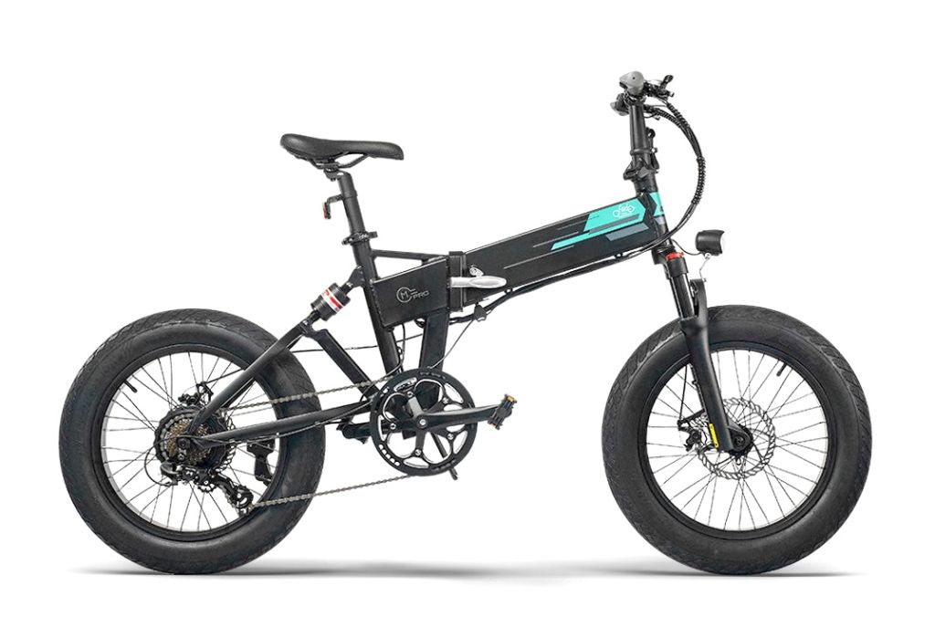

What Is the Fiido M1 Pro?
The Fiido M1 Pro is a budget folding bike. It folds at the frame, handlebars, and pedals, reducing its size considerably. This bike also has front and rear suspension, a 500W hub motor, and mechanical disc brakes.
The max pedal assist speed is approximately 15mph, which is slower than most other bikes in the category that typically reach 20mph or above. However, when speed settings are unlocked, the throttle will power you up to 20mph or 24mph.

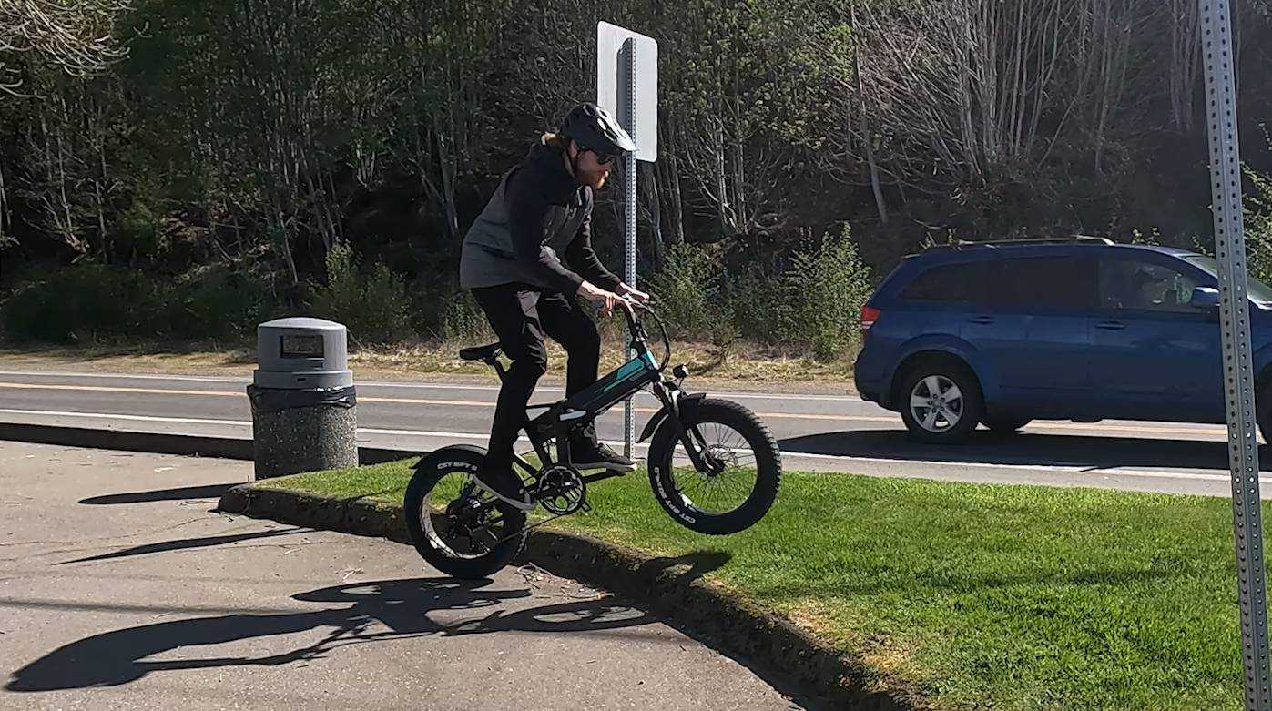

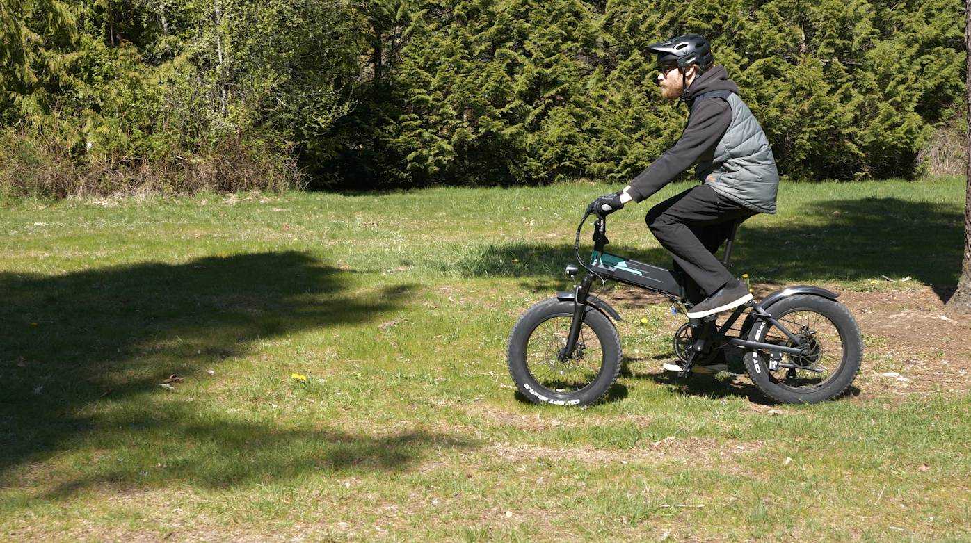

Full Suspension Ride
The M1 Pro runs a 90mm suspension fork and simple seat tube-mounted rear shock. The suspension components are cheap, but they do enhance comfort slightly.
The suspension fork lacks the high resistance common on lower-end forks and, surprisingly, absorbs some bumps. The rear shock, by comparison, is very firm and offers minimal benefit. The fat 4″ tires aid the suspension to improve ride comfort.

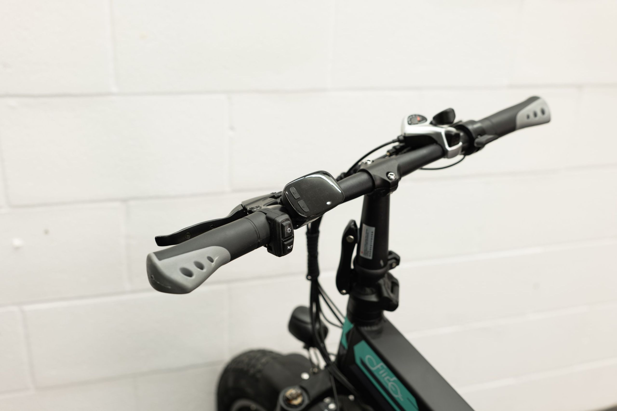

Display Visibility and Features
The M1 Pro’s display is dim and challenging to read in sunlight. The blue tone also makes it difficult to read in the dark. I constantly had to squint and shade the display with my hand in order to see it.
I was also unimpressed by the display’s features. It only shows basic information like speed, PAS level, and a five-bar charge indicator.

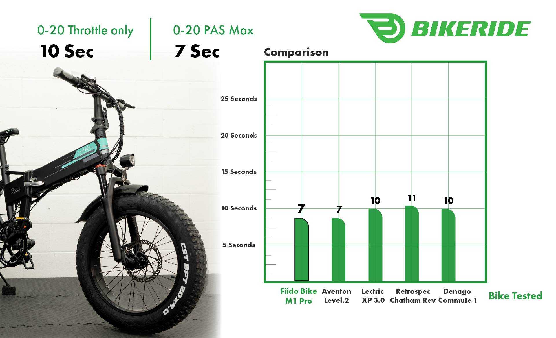

Another strength is its capable, torque-heavy 500W motor, which returned a great 0-20mph test time and above-average performance on our hill climbs.

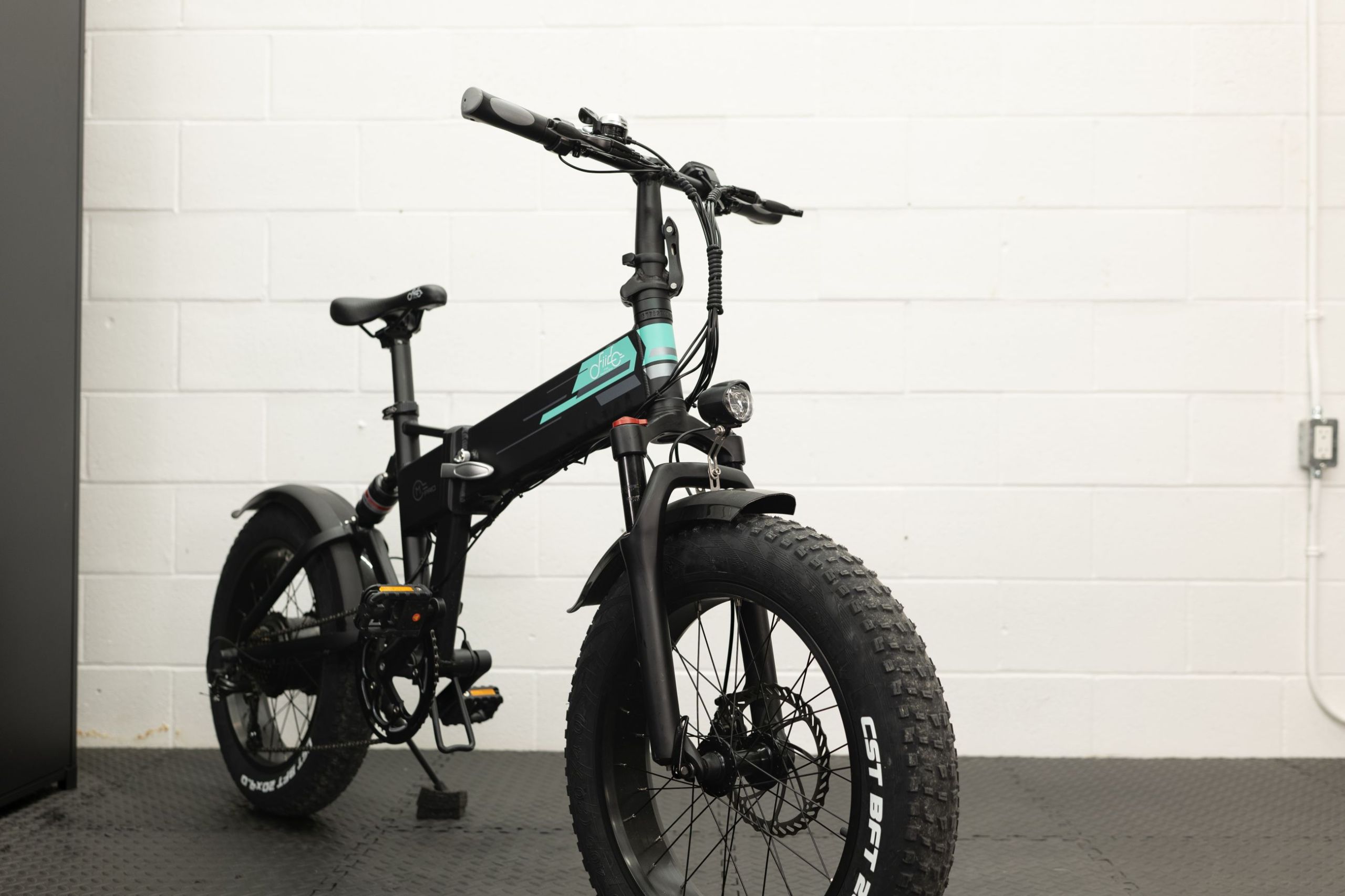

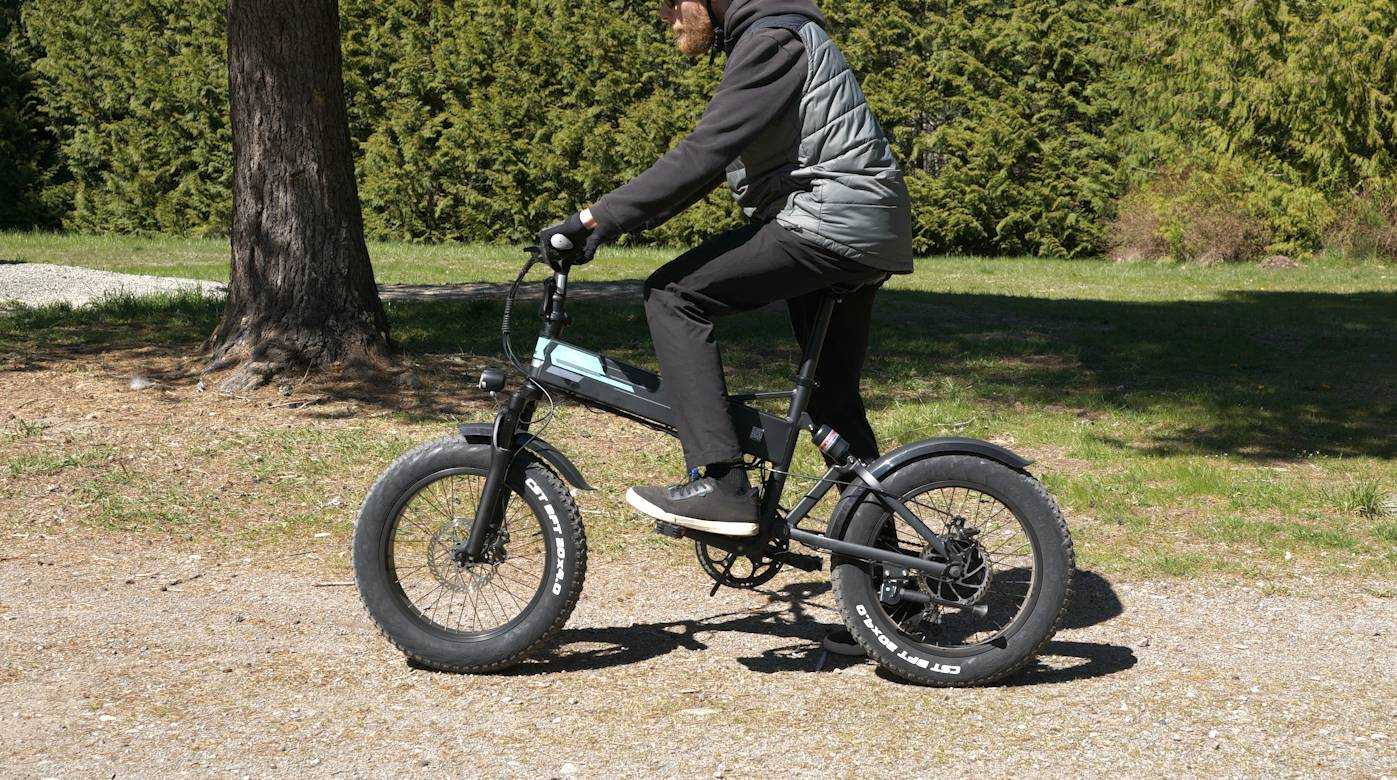

Frame and Geometry
The M1 Pro has a generic folding frame with a single rectangular tube that houses the battery. The steep head tube may cause issues for riders during turns and descents as it pulls the rider forward and causes instability in tight situations.
Overall, the frame feels solid. The locking mechanisms work well, and the 90mm fork adds some vibration damping.
Unfortunately, the handlebars aren’t height-adjustable, a common feature for this type of bike. Because of this, the bike feels slightly cramped for me at 6’0″ despite being rated for 6’5″.
I set the saddle close to its max height but would have liked to increase the handlebar height, too. Given that, I wouldn’t recommend it for anyone over 6′.

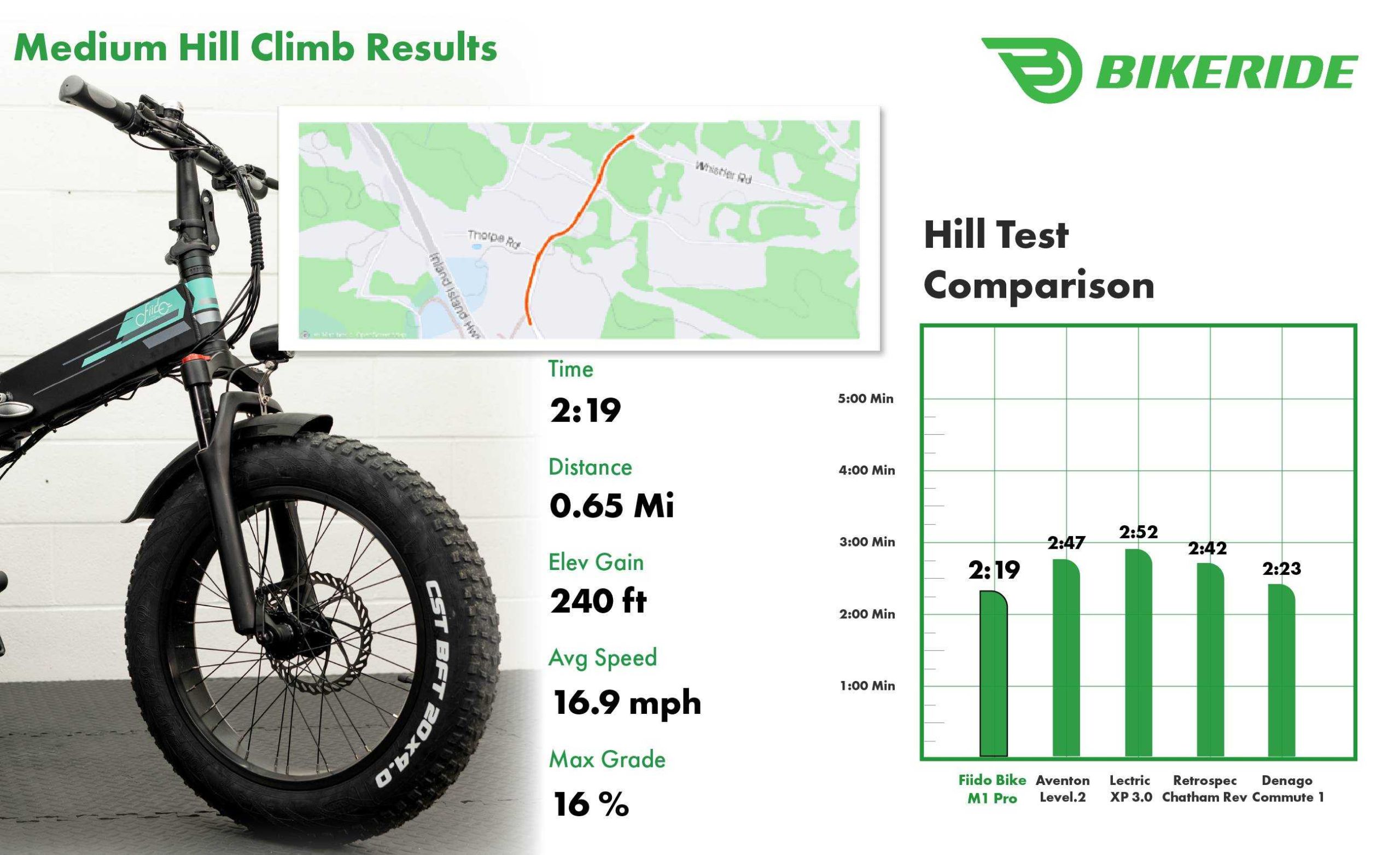

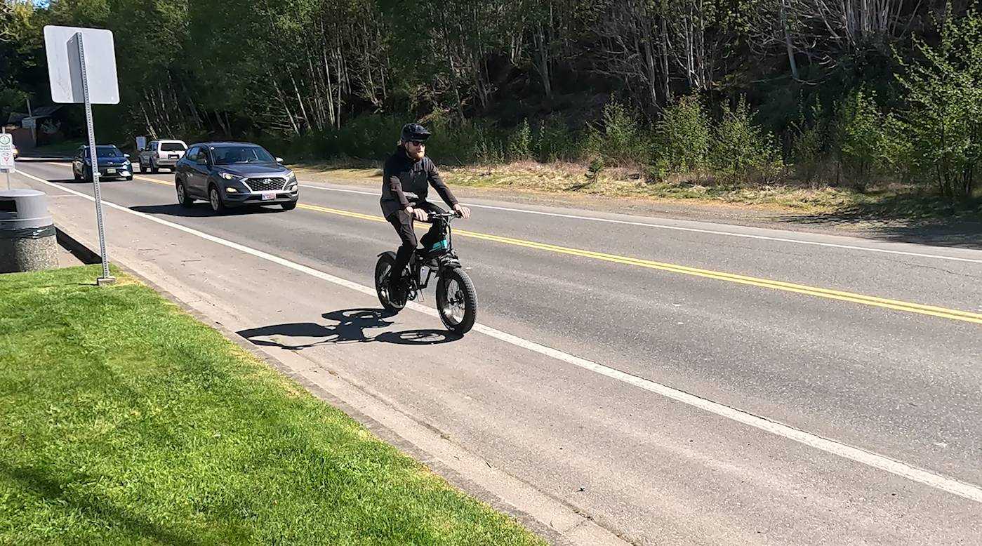

Motor
The M1 Pro has a 500W geared hub motor from Jiaxi, a Chinese producer. Its max torque output is 50Nm, which is surprising given the acceleration and hill climbing performance.
I was impressed by the motor’s performance, particularly the acceleration. The bike achieved an excellent result in our medium hill test when compared to the other 500W motors we’ve tested recently.
I was also shocked by its performance in our 0-20mph test. The M1 Pro reached 20mph faster than almost all 500W motors we’ve tested. This acceleration and ability to hold speed using the throttle are notable assets for a bike with lackluster performance in other areas.
The downside of the M1 Pro’s system is the max PAS speed of 15mph, which is low for commuter bikes. Only the throttle reaches 24mph when unlocked.

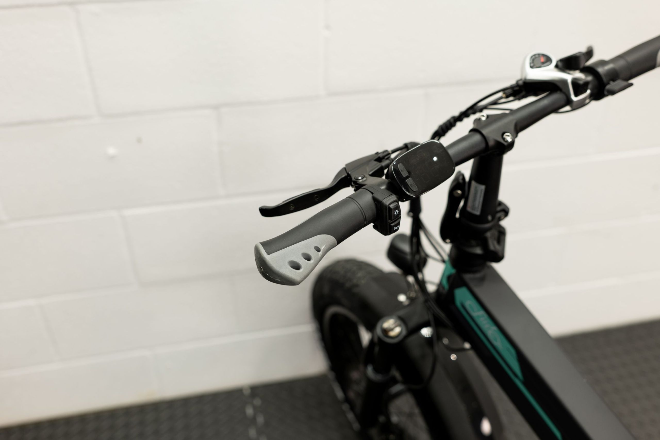

Cockpit and Control
The M1 Pro’s controls are incredibly simple. Firstly, the key must be inserted for the bike to operate.
There are dedicated buttons for the headlight and horn and two buttons on the display. The display only shows battery level, current speed, and assist level. Unfortunately, there is no odometer, range estimate, trip timer, or power output.

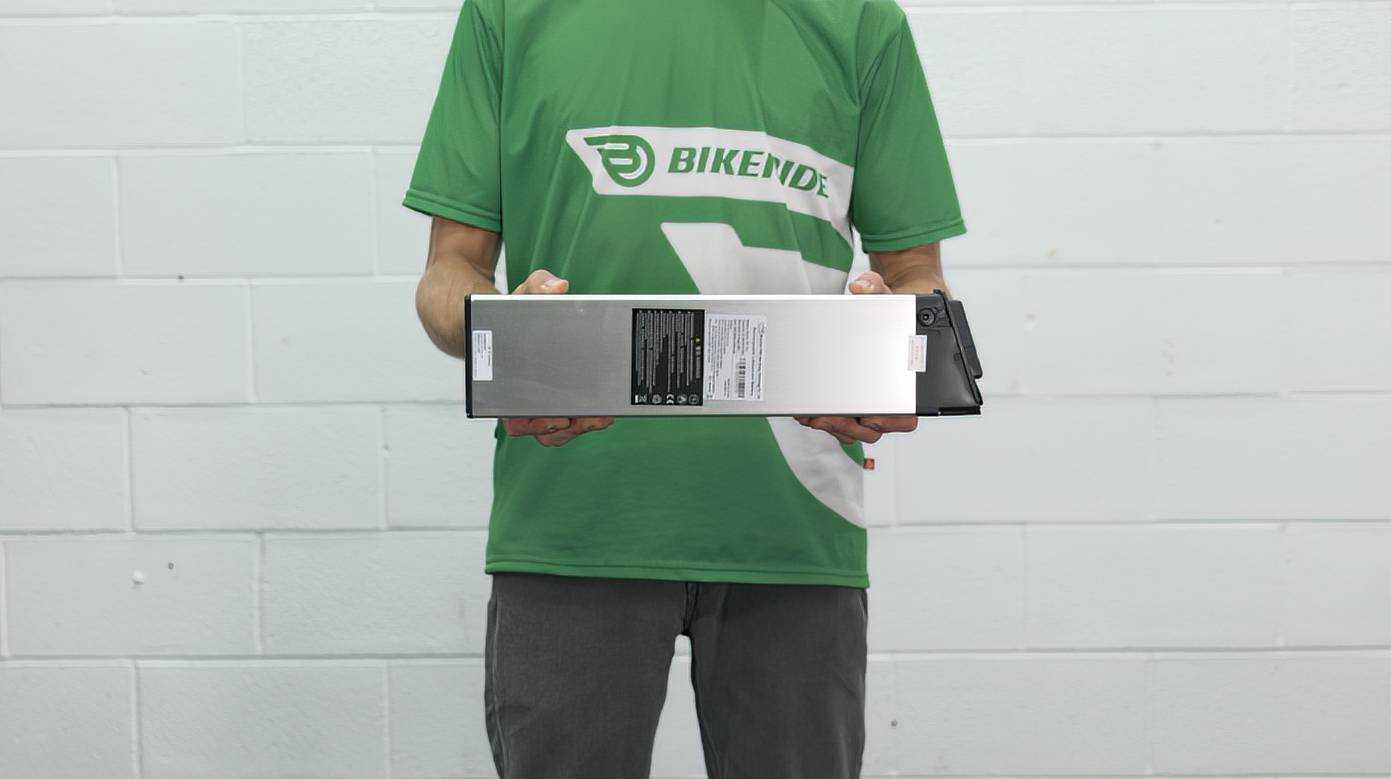

Battery
The M1 Pro is powered by a 48V 12.8Ah battery. Though smaller than average for e-bikes, it’s adequate given the price and pairing with a 500W motor.
The total distance covered in our range test was 20.5 miles, a reasonable return considering I relied mostly on throttle power for its higher unlocked assist speeds.
The battery level indicator was fairly accurate, but there was a big drop in power upon reaching the last bar, so I would treat the second-last battery bar as a low battery warning.

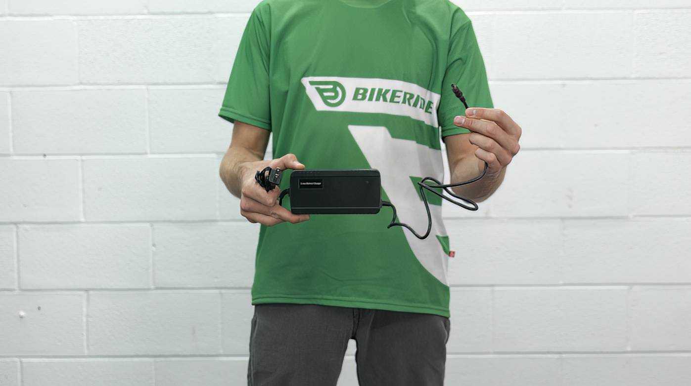

The 12.8Ah battery takes approximately seven hours to charge from empty using the 2A charger.
Charging can be done on or off the bike, but you must fold the bike to remove the battery, which isn’t very convenient.
The keyhole is located on the underside of the frame, towards the seat, directly under the locking clasp. The key must be inserted and turned to the on position for the bike to operate.

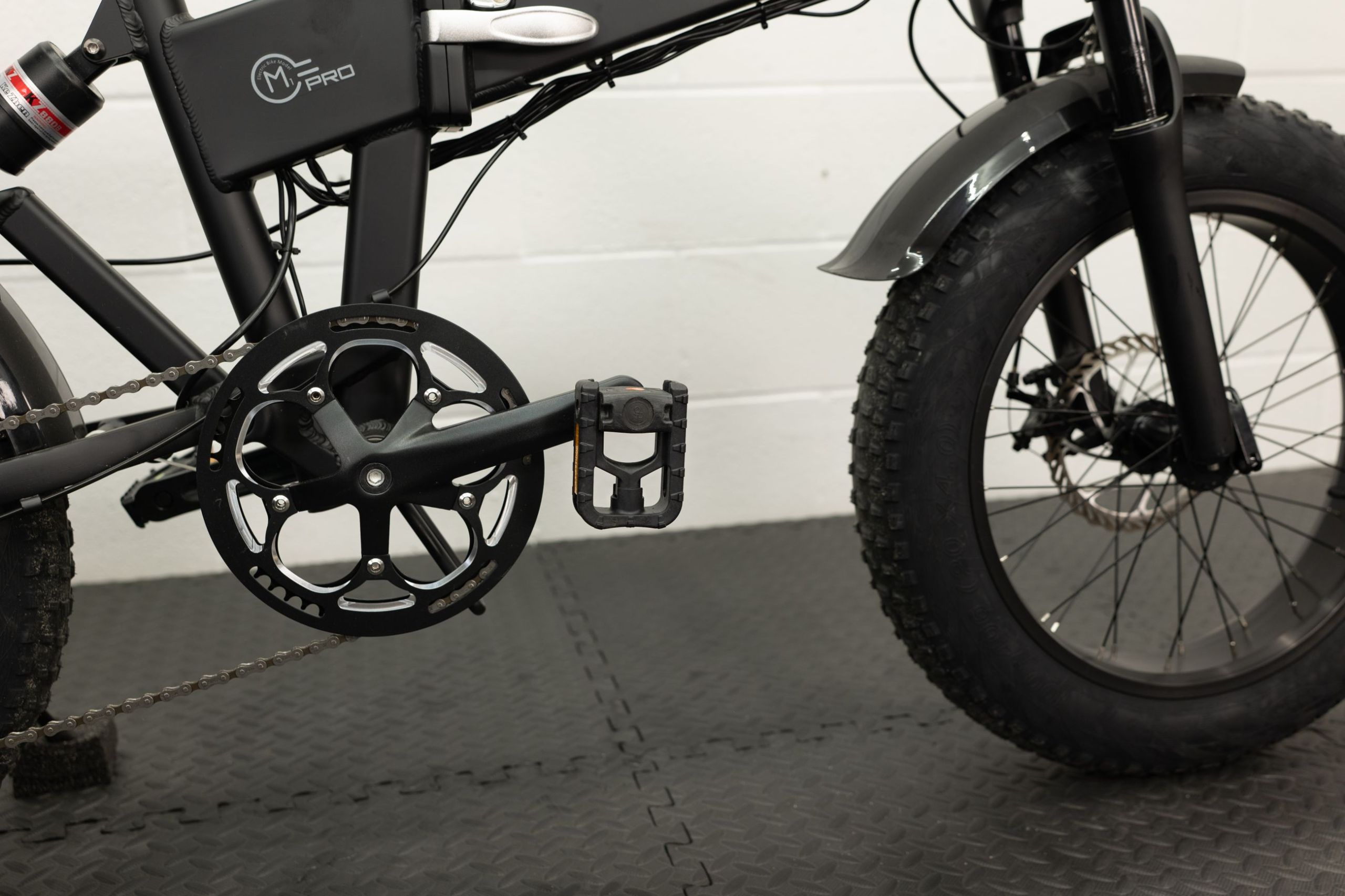

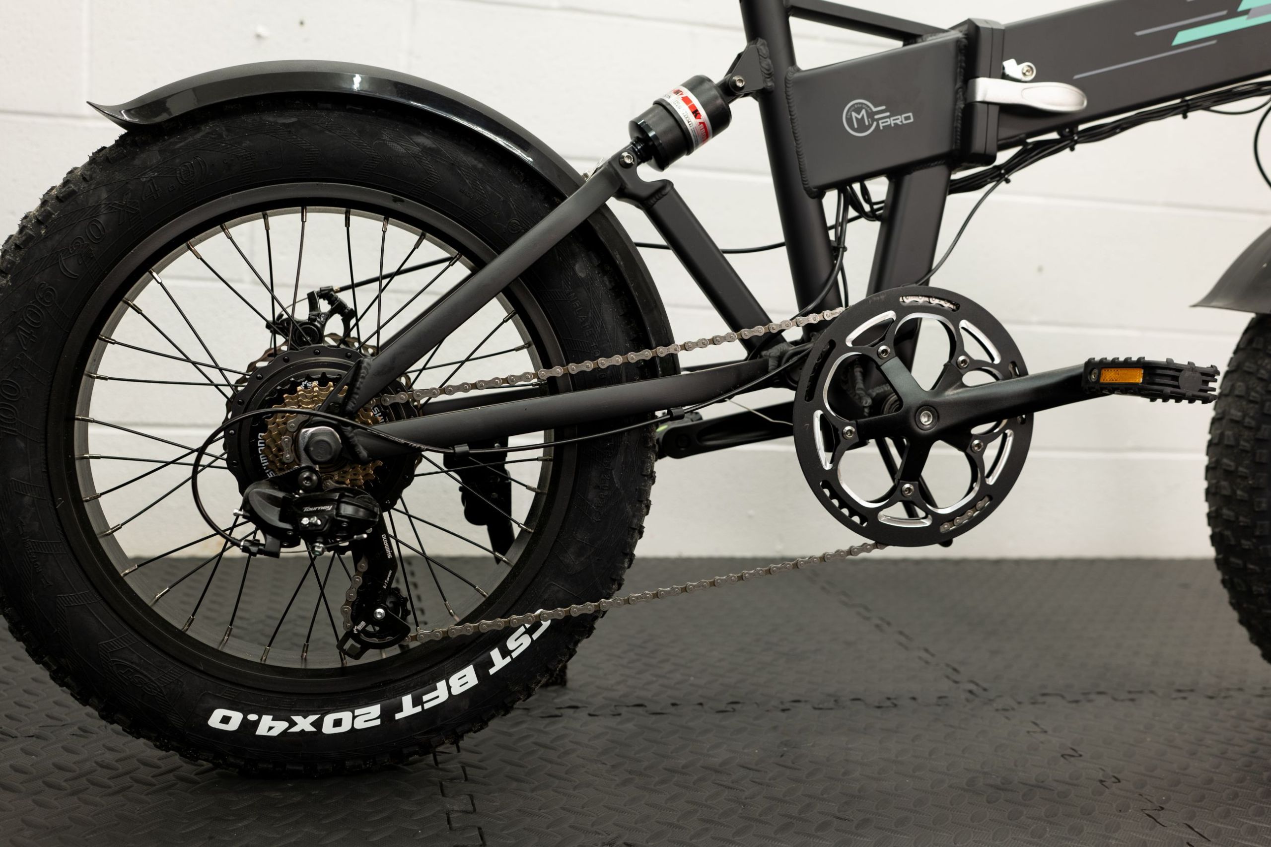

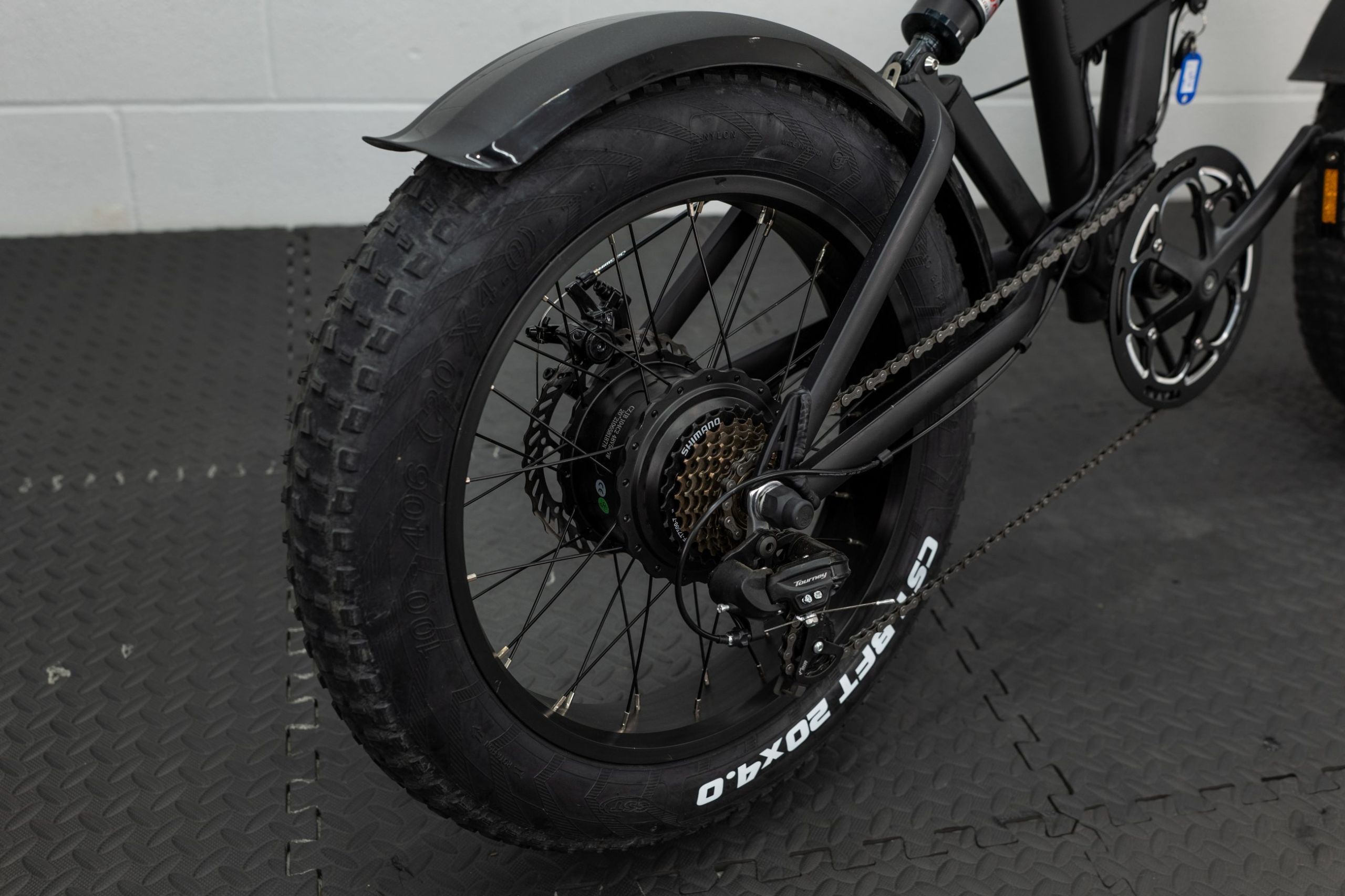

Drivetrain
The M1 Pro has a Shimano Tourney drivetrain. The TX-50 overhand shifter and Tourney derailleur are typical of this price point and offer basic functionality.
The 7-speed drivetrain comprises a large 48t crank and a 14-28t cassette, which is broad enough for the max PAS speed of 15mph. However, it leads to ghost pedaling at around 20mph (if pedaling to assist the throttle).

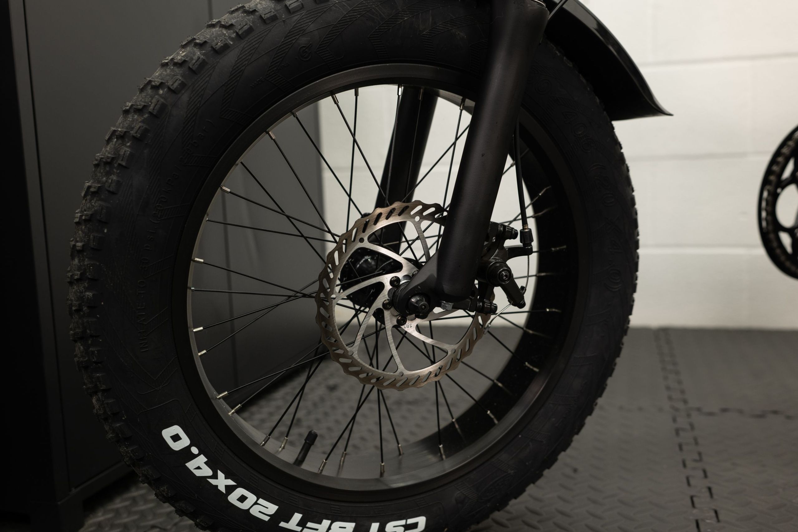

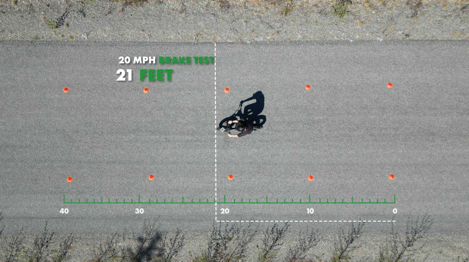

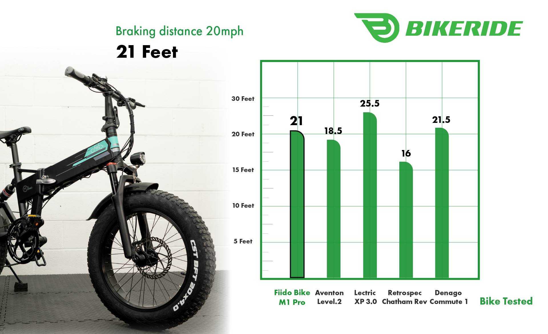

The brakes on the M1 Pro are unbranded mechanical discs with a motor cut-off switch. They require consistent tweaking to eliminate rotor rub, and even after adjustment, they squeal when braking.
The noises make me doubt their quality and long-term durability. That said, the stopping distances were acceptable, with an average stopping distance that puts the M1 Pro in the middle of the pack of recently tested e-bikes.

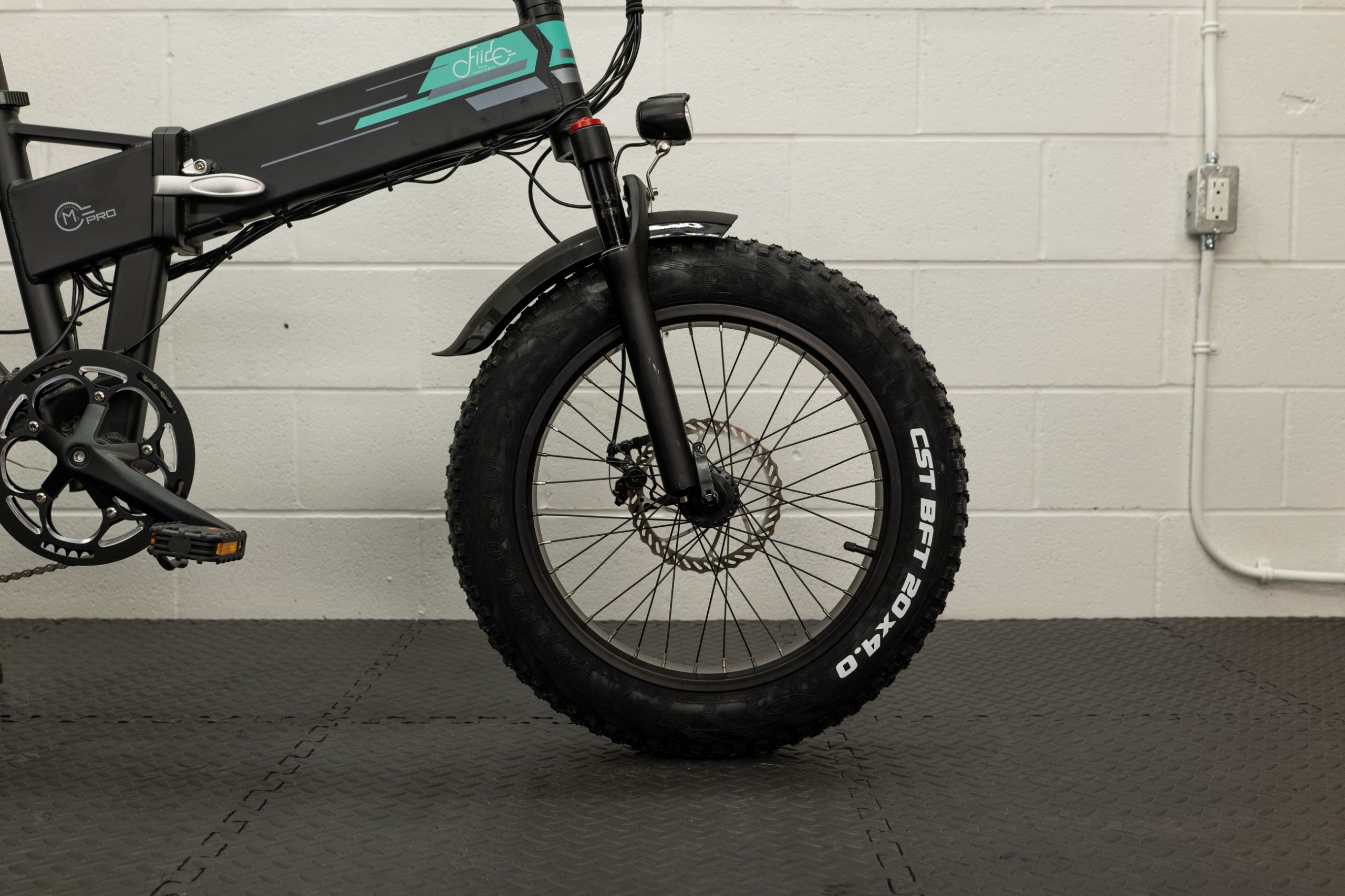

Wheels, Tires
The M1 Pro performs well on most surfaces. I tested it on loose gravel, sand, dirt, and pavement.
It rolls on 4″ CST BFT tires with 20″ alloy rims. Again, this is a typical setup for this type of e-bike. The tread offers decent grip on mixed surfaces, with large enough lugs for light off-road riding. The bike is also relatively stable at higher speeds despite its smaller 20″ wheels.
Fiido provides plastic fenders that do a good job of blocking spray from the road and trail.

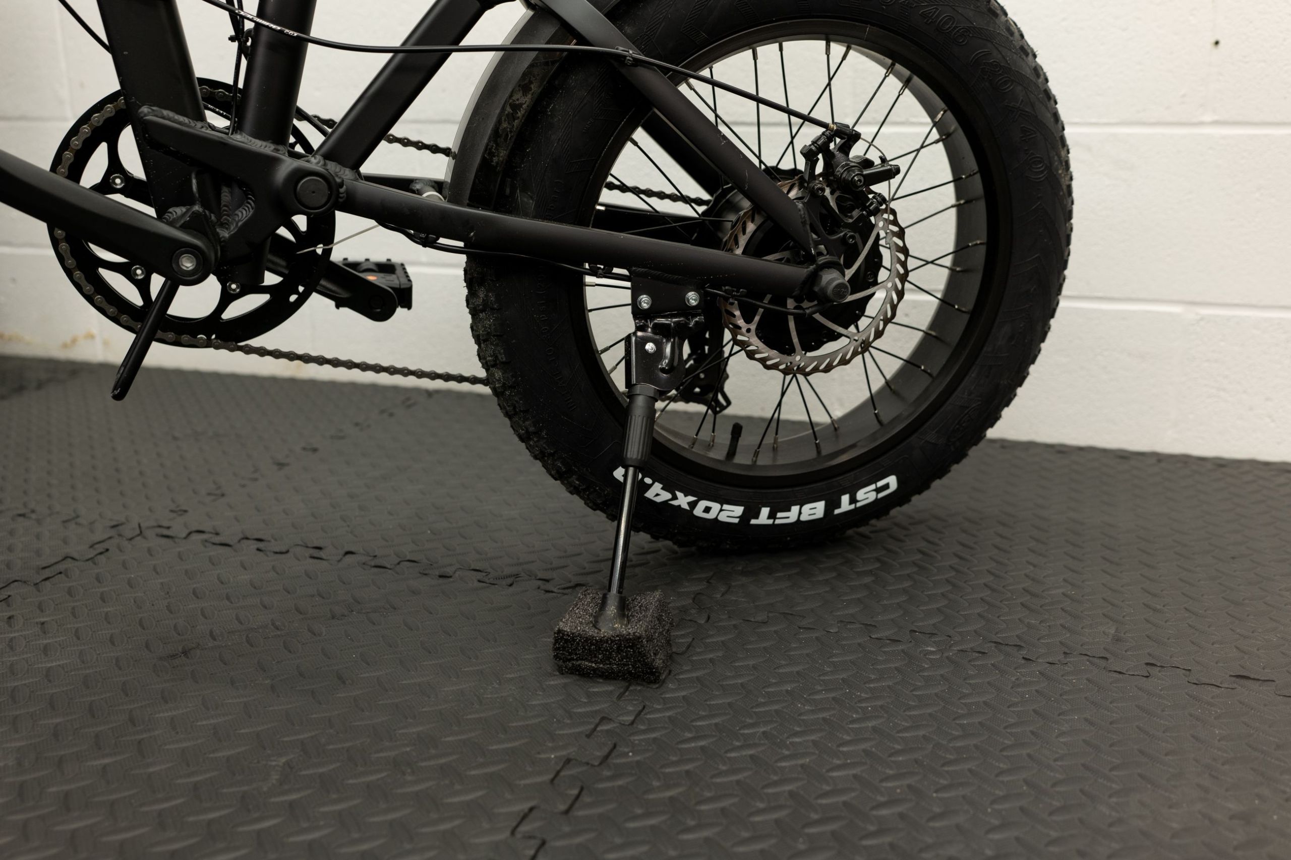

Kickstand
The M1 has a non-adjustable single-sided kickstand, which is a bit short, so the bike can fall if placed on uneven ground.
Contact Points
Grips
The grips that come with the M1 pro are basic ergonomic rubber slip-on grips. These are pretty comfortable but do not offer much traction.

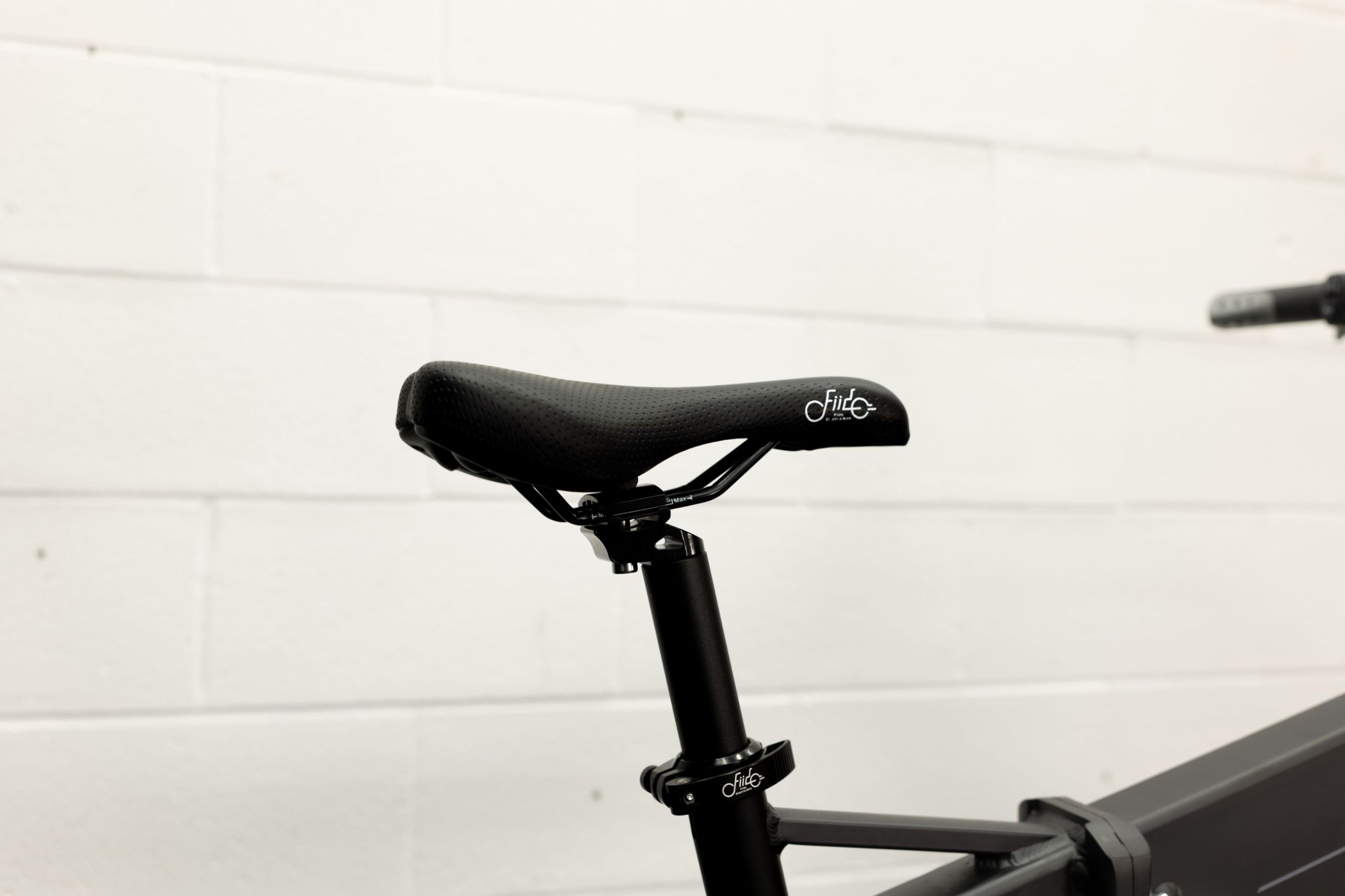

Saddle
The saddle is Fiido-branded and manufactured by K.San. It has minimal padding and feels firm, leading to minor discomfort after the 20-mile range test.
Pedals
The M1 Pro has flat plastic pedals with small plastic pegs that offer limited grip. The pedals fold to reduce the footprint by a few inches for storage or transportation.
