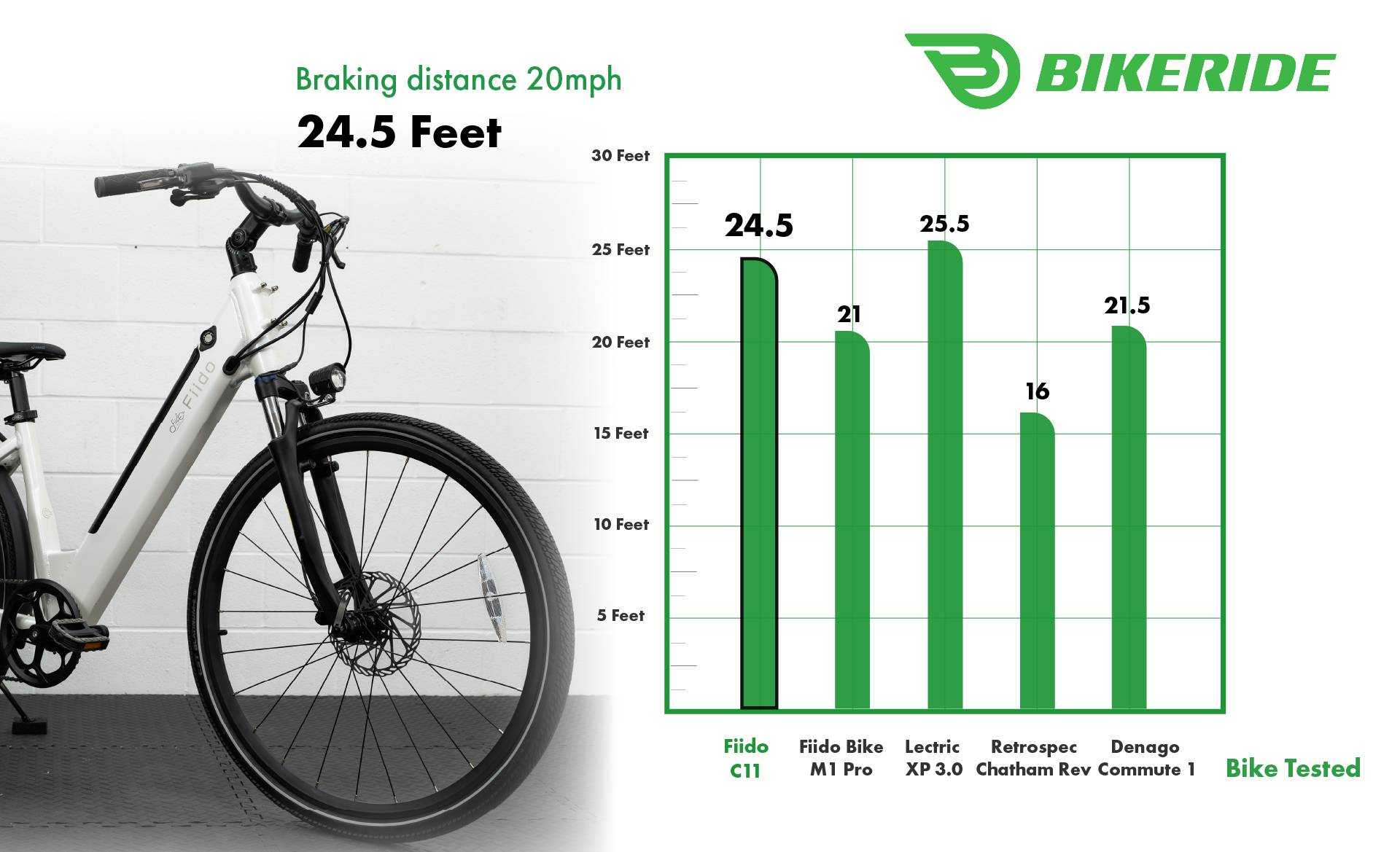

  • In one expert's standardized testing, the C11 demonstrates below-average stopping power.

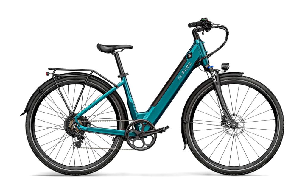

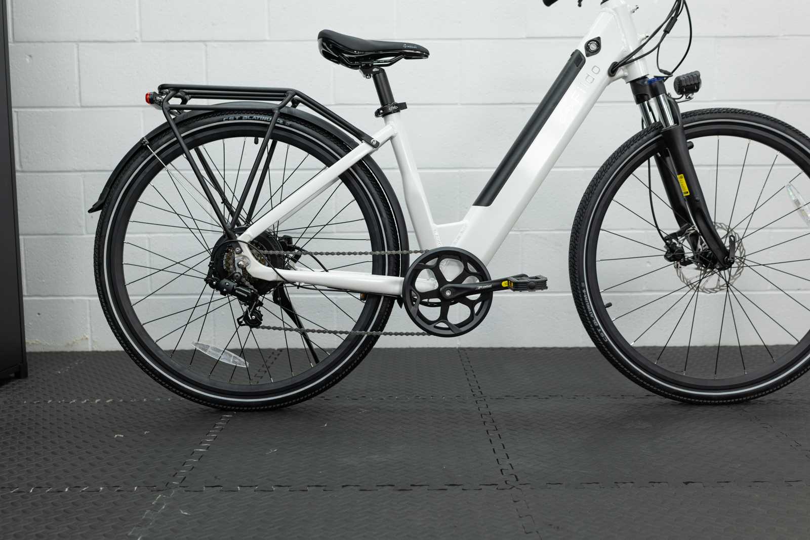

The C11 is Fiido’s new electric commuter bike. It has a low-step frame, a 500W motor, and fast-rolling 40mm tires.
In this review, we put the C11 through our standardized tests to uncover its strengths and weaknesses. These include stopping distance, acceleration, hill climbing, and range (Class 2 and Class 3).
Keep reading to find out what we liked and disliked about the Fiido C11.
What Is the Fiido C11?
The C11 has a low step-through commuter frame with a 40mm suspension fork and swept-back handlebars. It comes with a rack, fenders, lights, and additional mounting points for accessories.
This bike has a smaller-than-average 48V, 10.4Ah (499Wh) battery and an unusual 15.5mph factory-set speed limit. This is the speed limit for bikes sold in the EU and UK, both important markets for Fiido.
Owners can unlock Class 3 max speeds of 25mph, but this changes both throttle and PAS; it’s not possible to set the top speed to 20mph (Class 2).

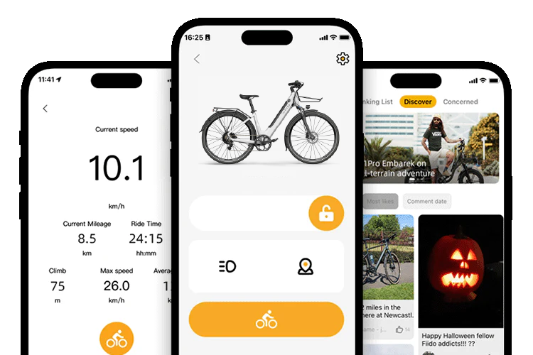

The C11 also has Bluetooth connectivity for using the Fiido app. This app offers additional features like remote locking and ride tracking.

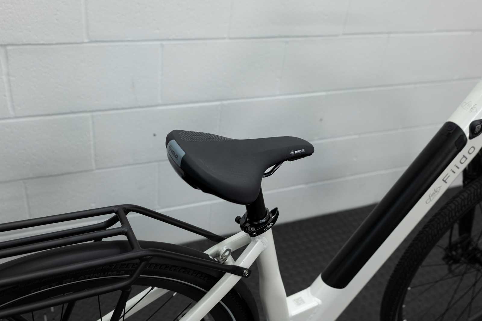

Uncomfortable Saddle
Though this is a highly personal choice, the C11’s Velo saddle feels too wide. Sitting at the back of the saddle caused the rear ridges to dig into my glutes, leading to discomfort during the range tests. While some may find the seat comfortable, I was glad to get off the bike after 30 miles.

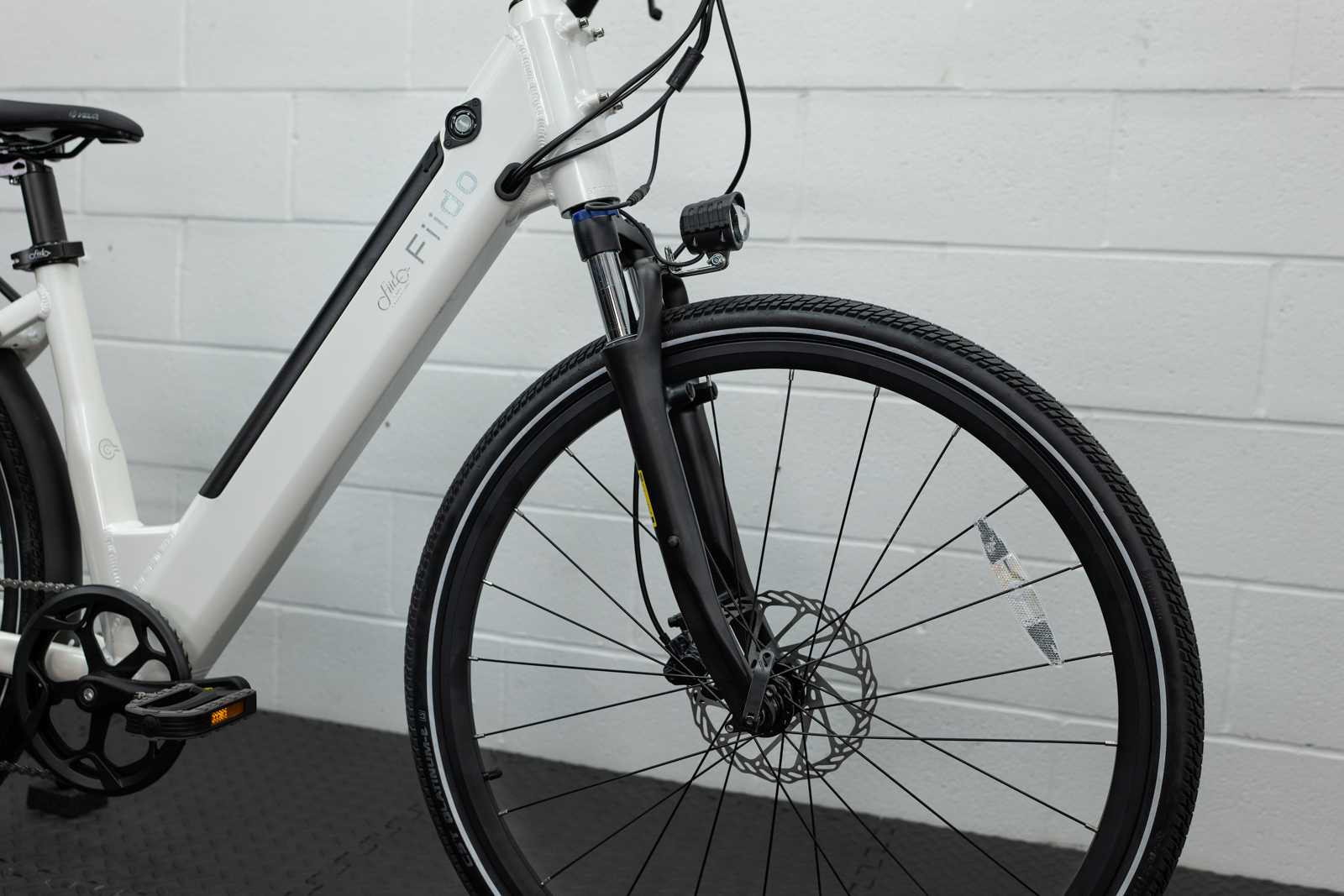

Front Fender Attachment Points
While assembling the bike, I noticed the pre-drilled holes for the front fender were incorrectly drilled, so I couldn’t install it properly. Fixing the issue would require a new fork or re-drilling the current one. This is probably a one-off manufacturing fault, which can happen with any bike and would be covered under warranty. Nonetheless, it’s frustrating when you receive a new bike.

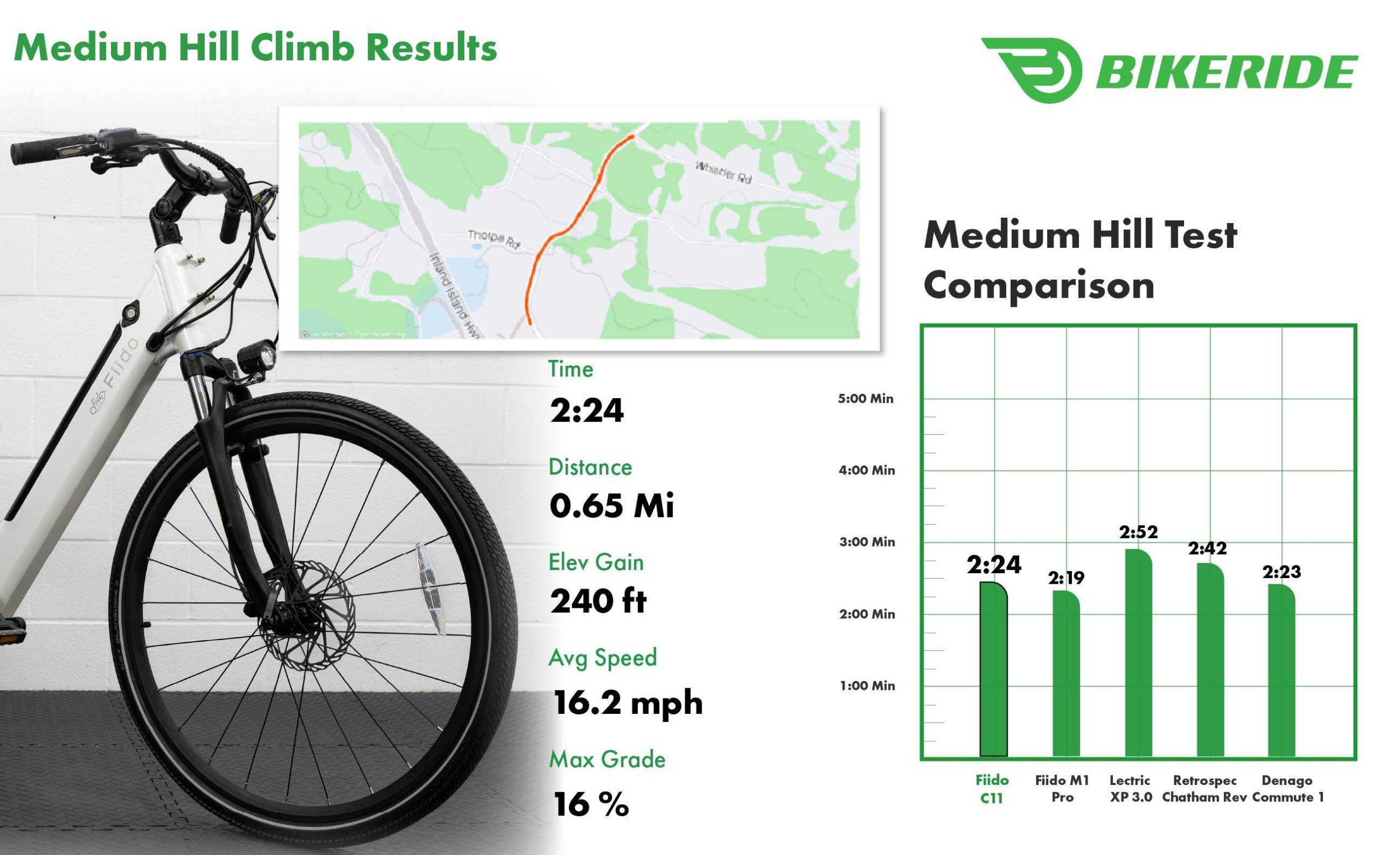

Riders seeking a fast, high-torque e-bike should look elsewhere. The C11’s motor is better for medium-distance rides at moderate speeds.

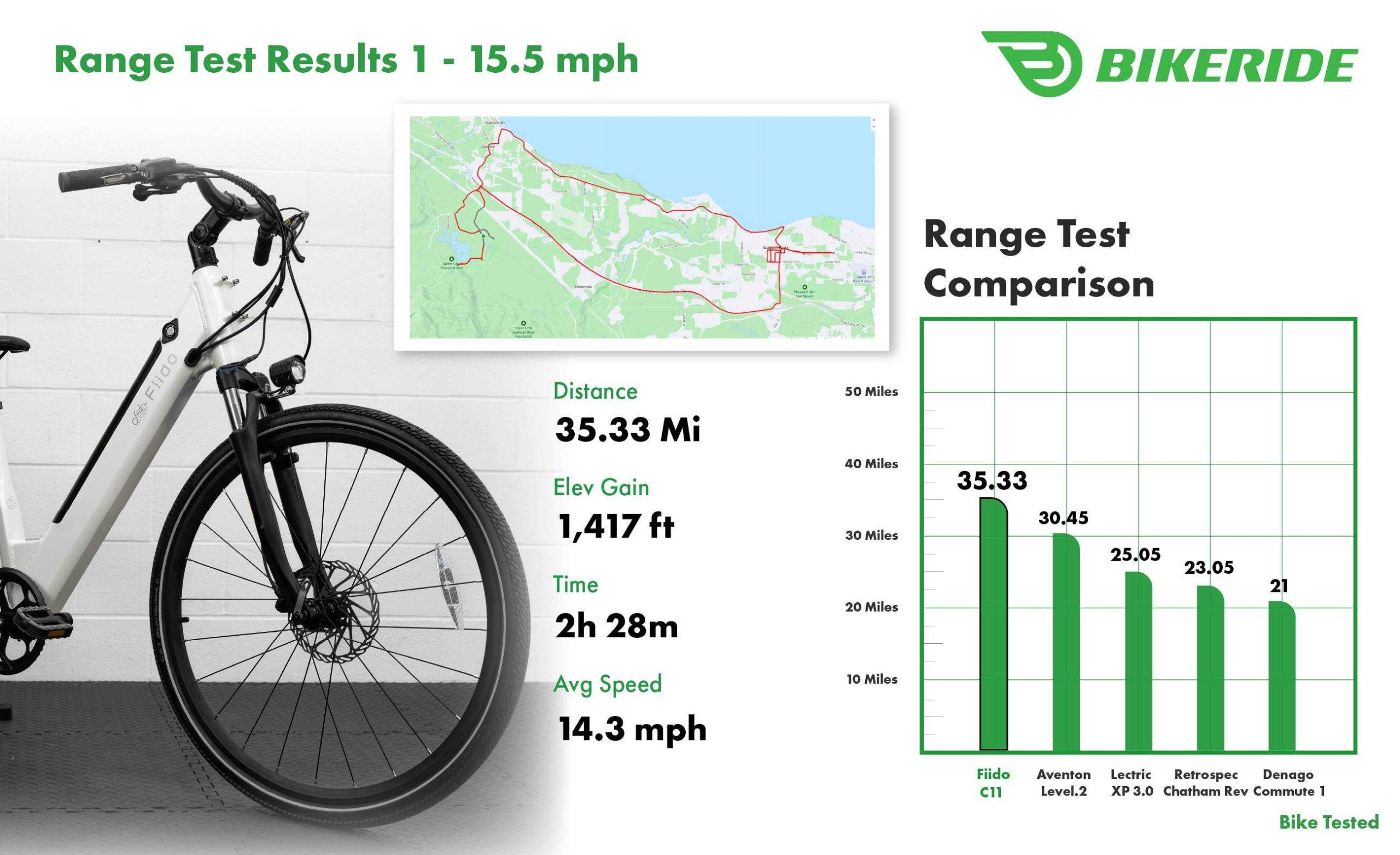

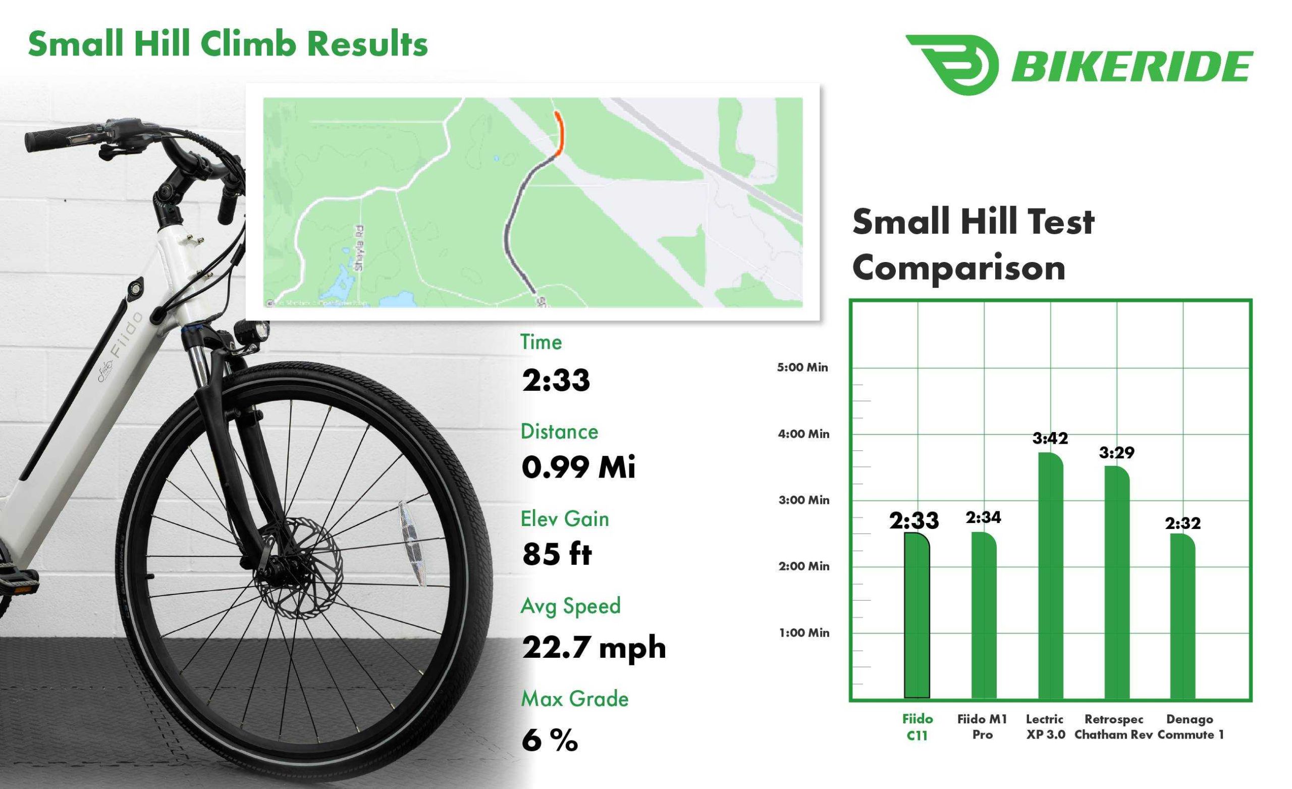

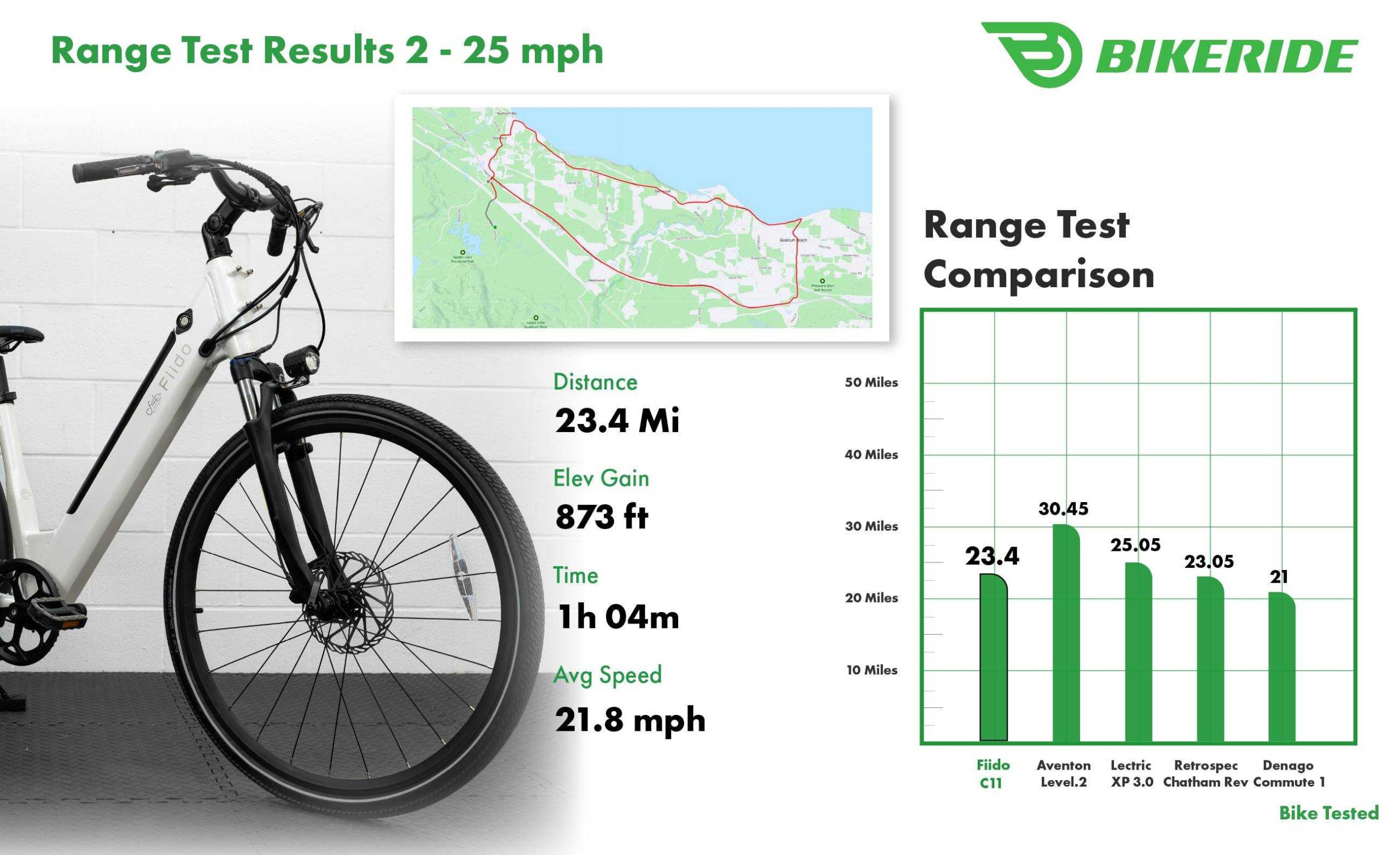

Range Tested: Test 1 (Class 2) – 35.3 miles, 1,417 feet, 14.3mph  / Test 2 (Class 3) – 23.4 miles, 873 feet, 21.8mph

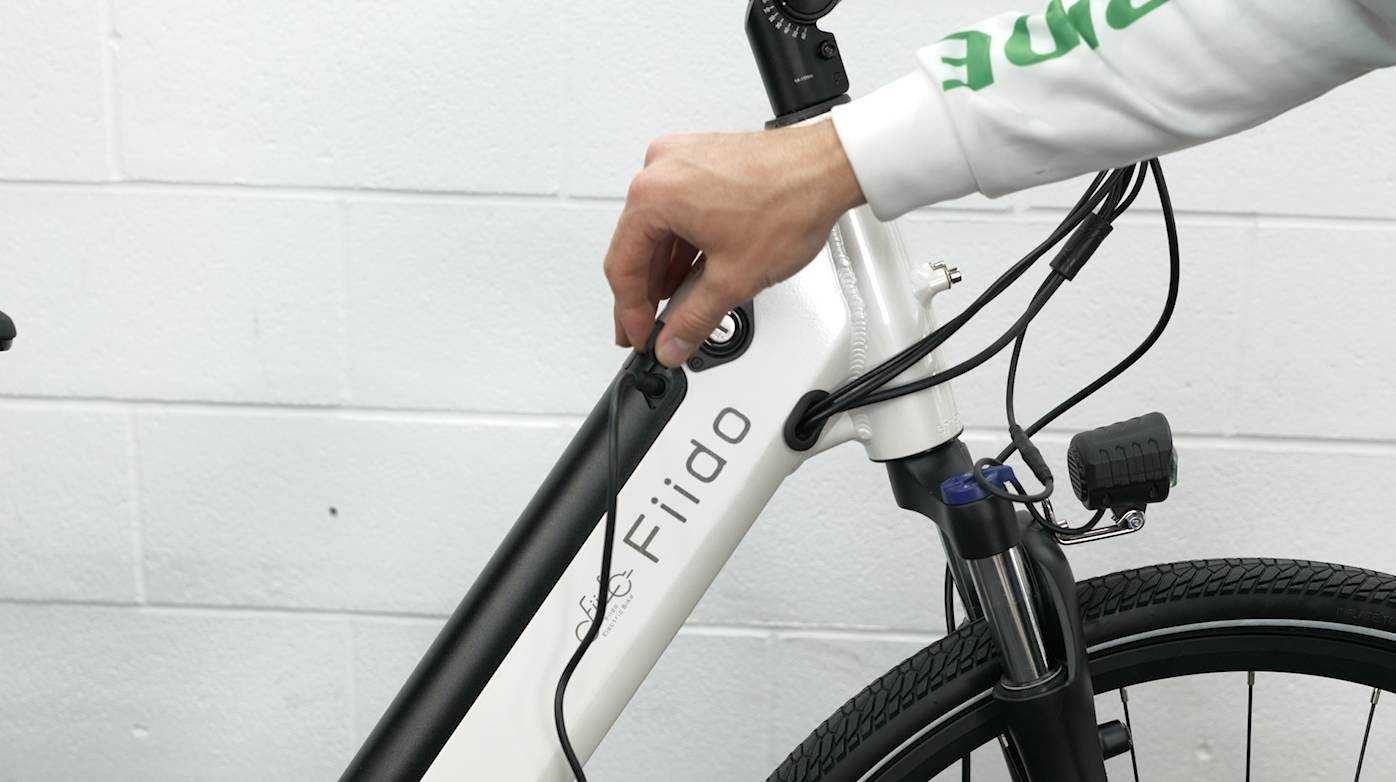

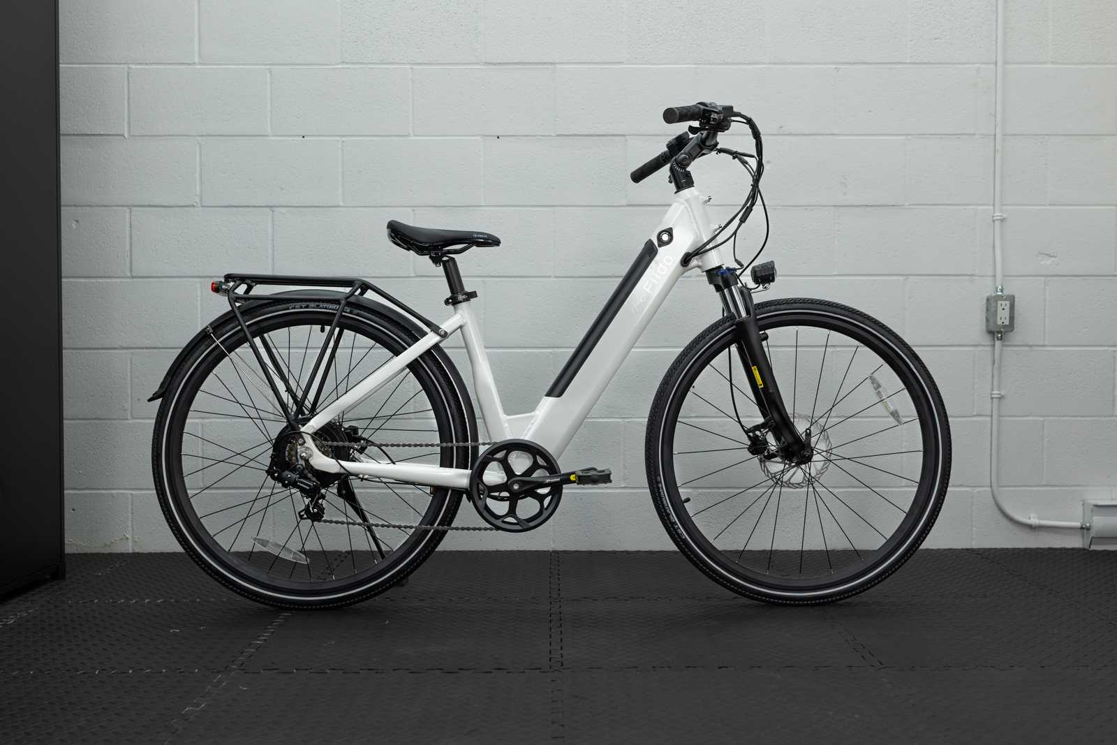

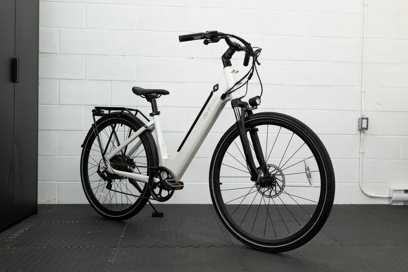

The C11 frame looks good with clean, internally routed cabling. The low step-through makes it easy to mount the bike regardless of height or flexibility. The bike has a comfortable straight-backed riding position and a wide stated height range, but riders at the low end of the range would likely struggle with the 31.1″ minimum saddle height.

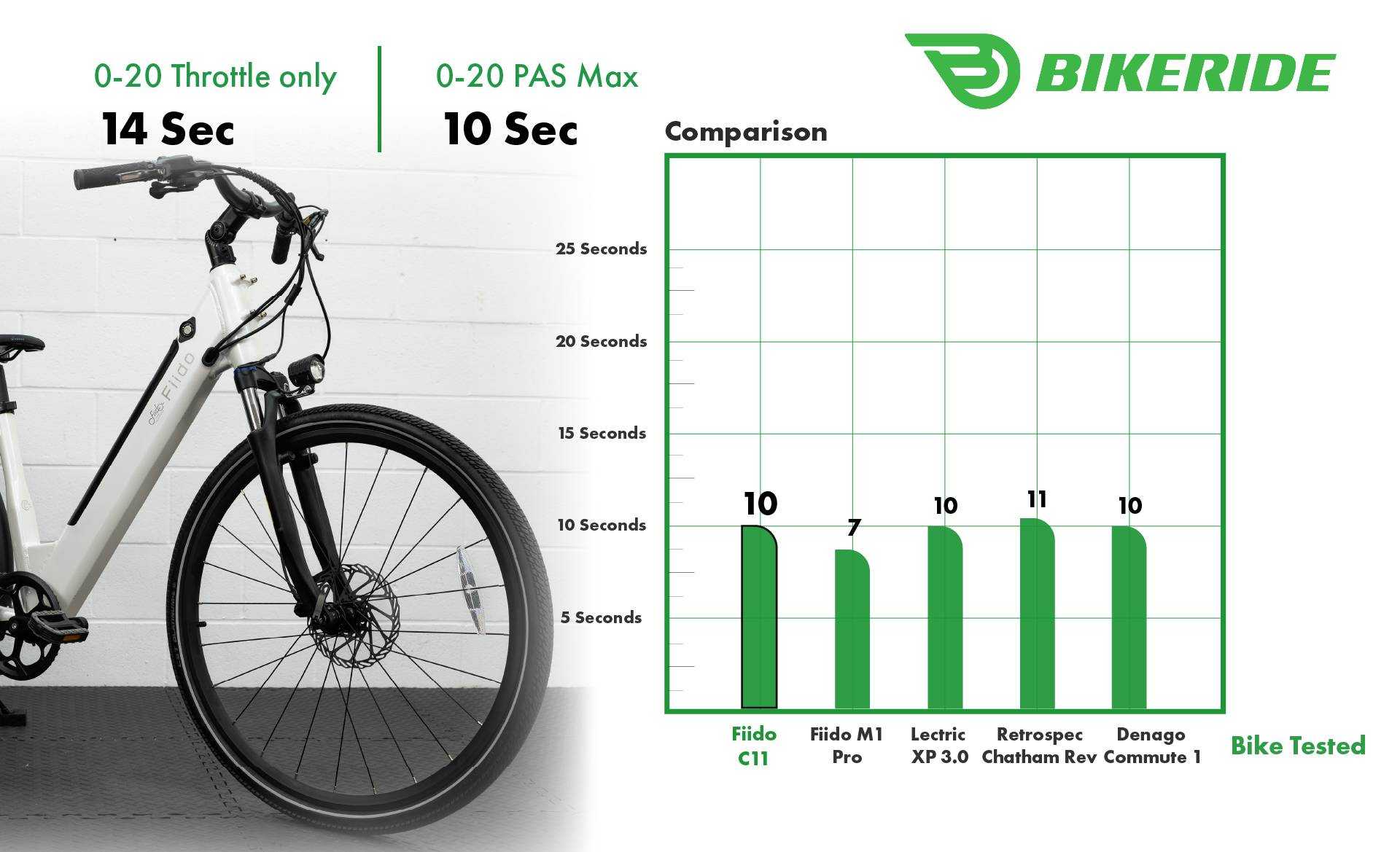

The C11 has a 48V 500W motor with a peak output of 676W and 55Nm of torque. This is a fairly standard motor size for this category, but some may find acceleration and climbing performance lacking. In both our 0-20mph acceleration and hill climbing tests, the C11’s performance puts it in the middle of the pack of 500W competitors.
These results show that the C11 packs enough punch for most urban riders, but those who want fast acceleration and speed on climbs should consider a 750W alternative.

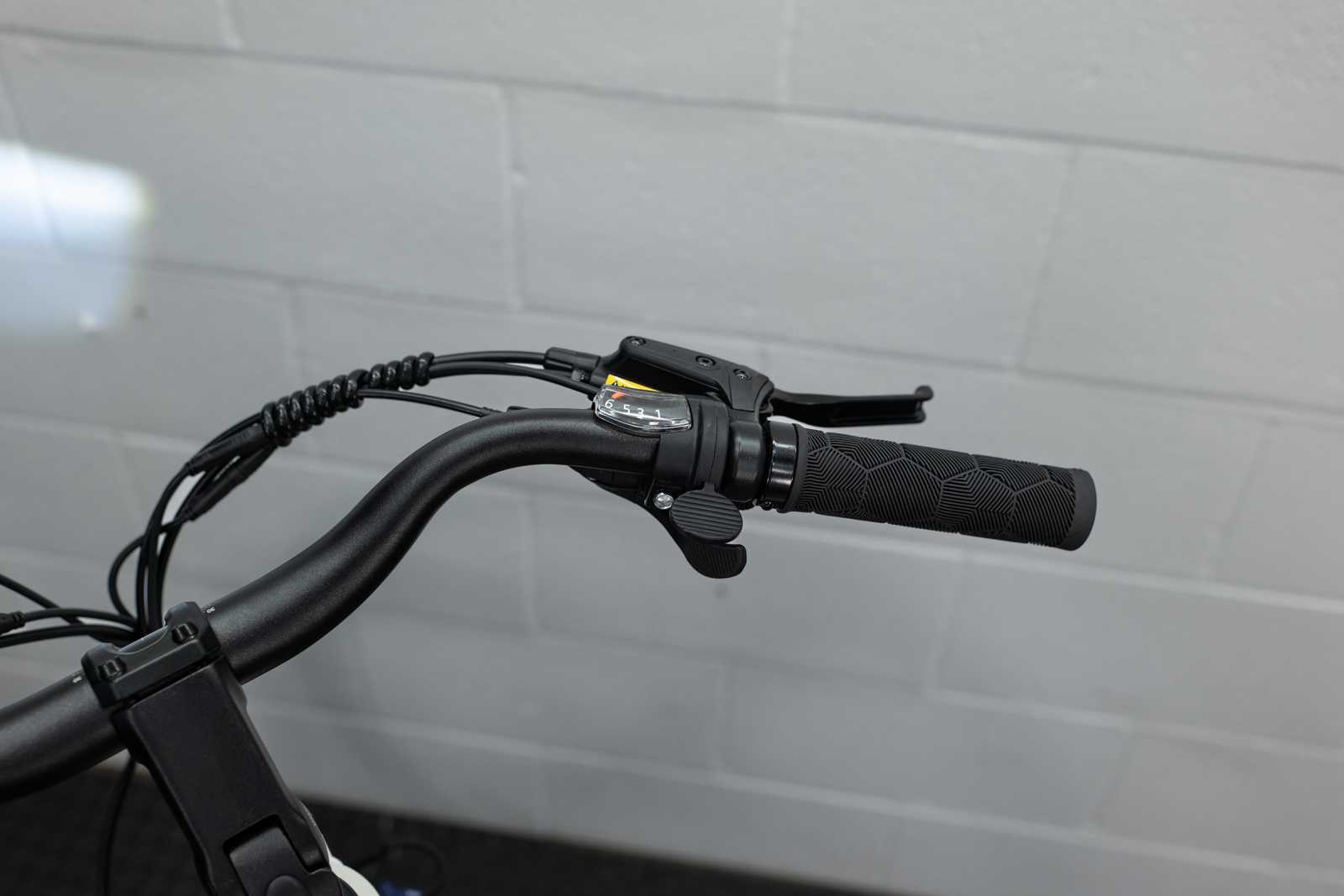

Cockpit and Control

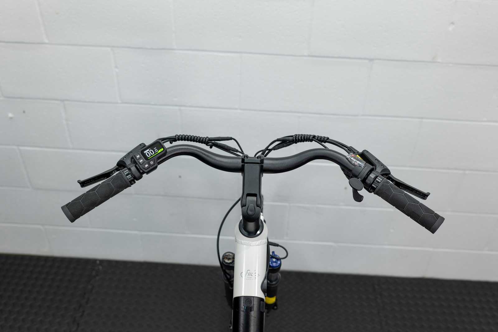

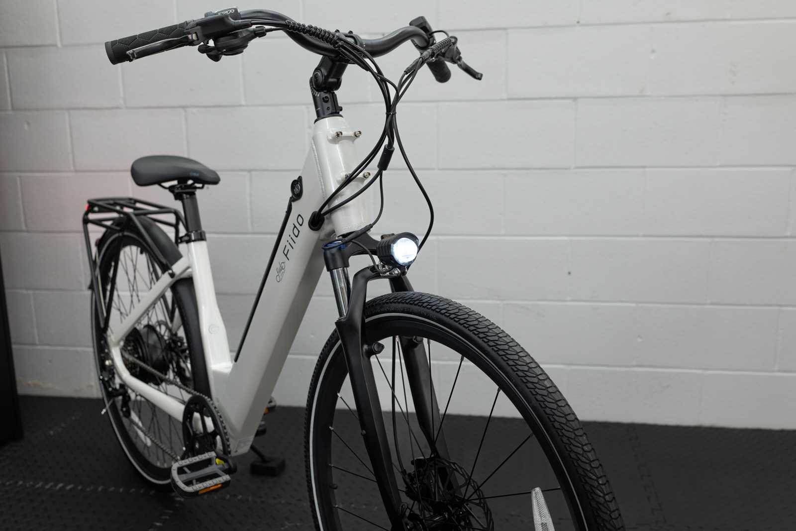

The C11’s cockpit is clean, with a small color display on the left and the trigger shifter and throttle on the right. The display is simple to operate and clear. The Fiido app offers additional features and connects to the bike via Bluetooth.
The app features include remote on/off, smart unlock, ride tracking, connection to the Fiido social network, and “Bike Guard,” which locks the bike and only allows it to be turned on through the app.
You can also change a few other settings from within the app, including the number of assist levels, activating cruise control, and toggling the display units between miles and kilometers).

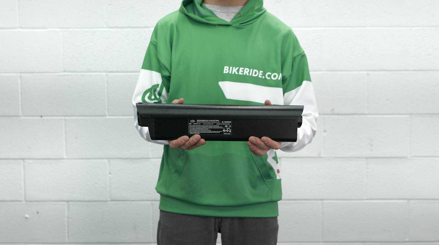

The 10.4Ah (499Wh) battery is slightly below average for this category. Despite its lower capacity, it returned a reasonable range at max power and an impressive 34-mile range in Class 2 mode.
The battery level indicator drops more quickly through the first three of the five bars than the final two. The motor continues to provide full assistance until the “low battery” warning, which comes on when the five bars are gone. The power output only starts to reduce at this point, leaving enough power to limp home.
The C11 comes with a basic 2A charger that delivers a six-hour charge time. The charge port is on the battery on the upper right side. The key slot is located beside it and is easily accessible.

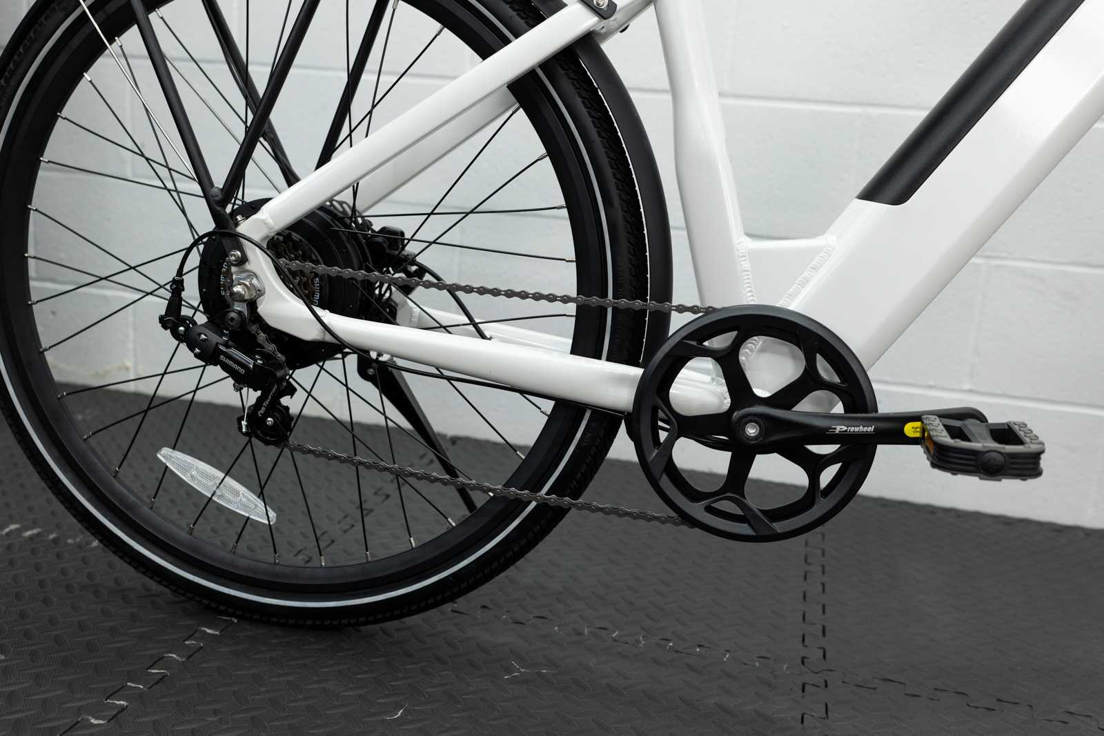

Drivetrain
The C11 has a mixed drivetrain comprising a 6-speed Tourney derailleur, a 14-28t cassette, and a DSL-D200 shifter. The shifting is a little sloppy, and while the 6-speed 14-28t gearing is suitable for pedaling at speeds up to 20mph, you’ll experience ghost pedaling at higher speeds.

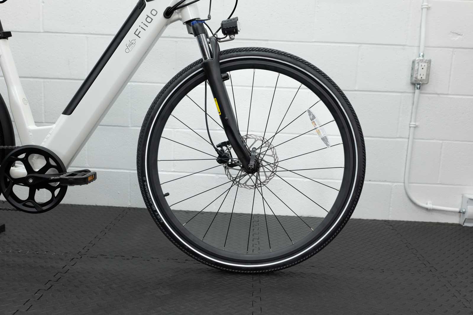

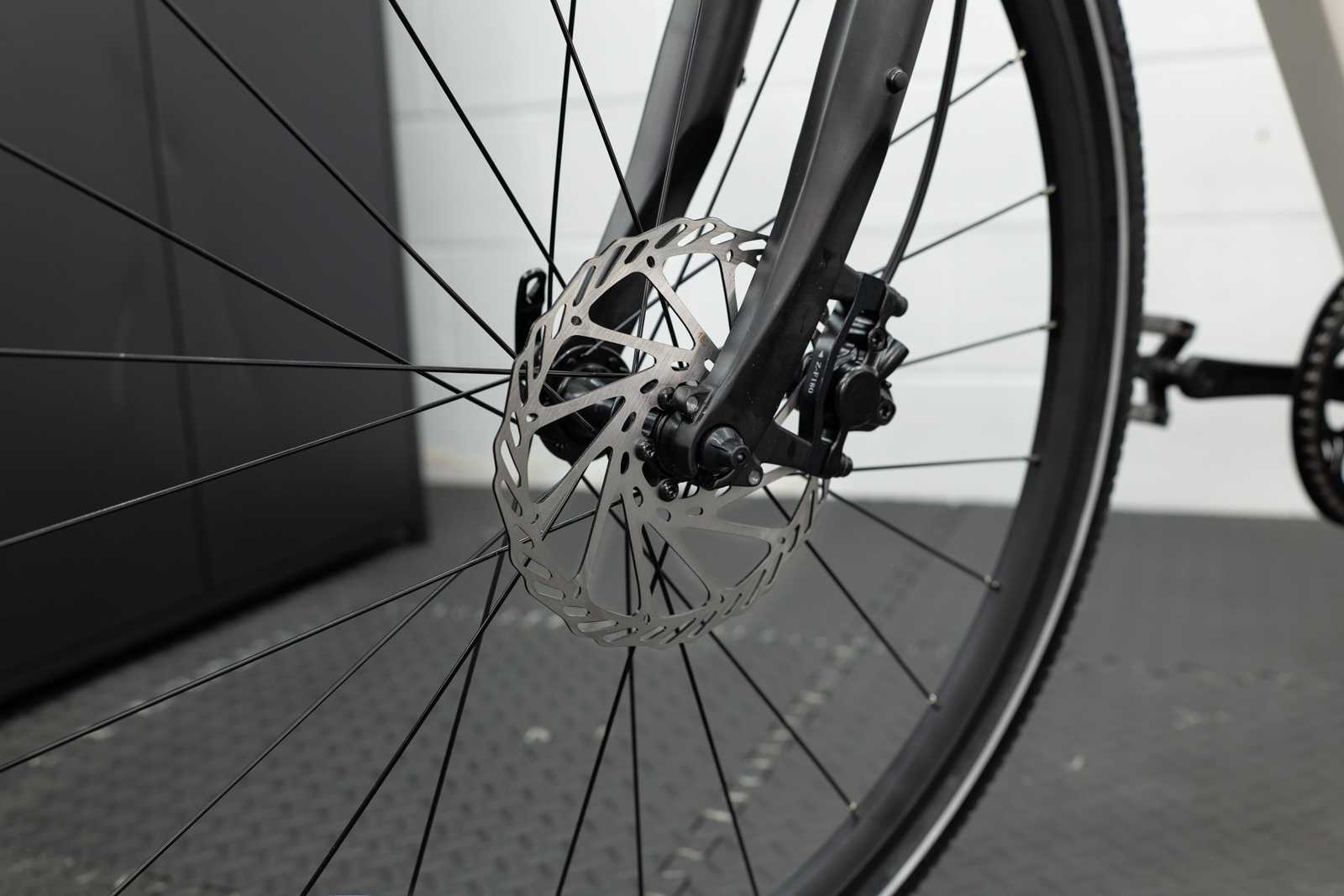

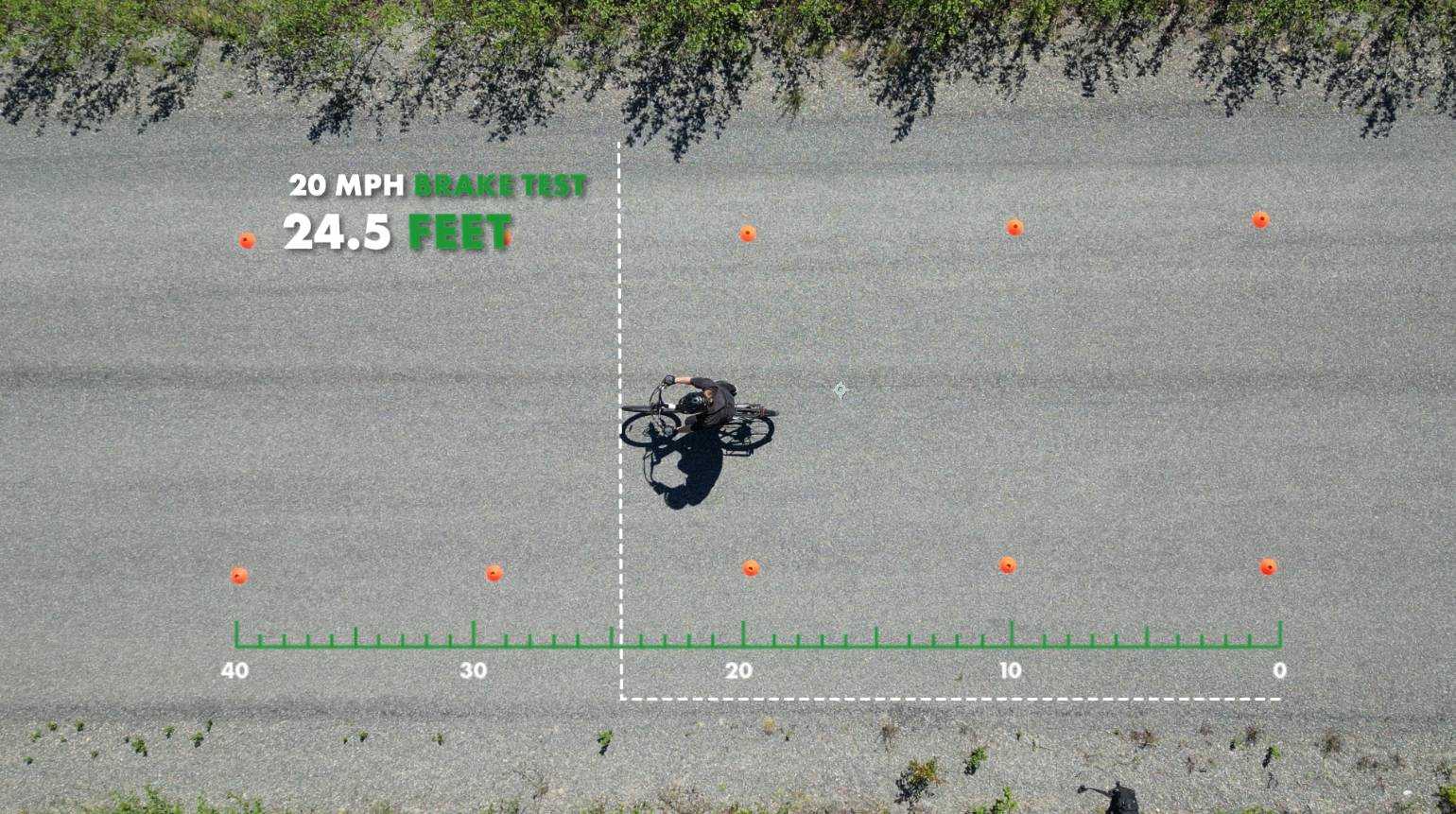

The C11 has dual-piston hydraulic disc brakes and 180mm rotors. The average stopping distance recorded in testing was 24.5 feet, which is longer than average.

This bike has a standard 700c aluminum wheelset and slick 40mm CST tires. The front wheel is quick-release, and the rear has a bolted axle.
This wheel and tire setup works best for paved riding but is also suitable for hard-packed dirt and light gravel. The narrower tires experience less rolling resistance and are easier to maneuver than the fat tires found on many cheap electric bikes.

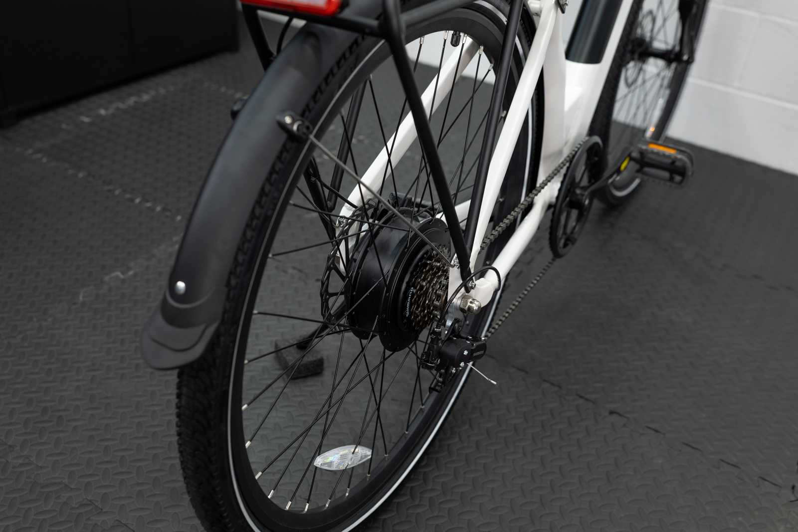

The C11 comes with front and rear fenders, but, as mentioned, I experienced an issue with the mounts that prevented me from installing the front one.

The Fiido C11 has front and rear lights with rear brake activation. The bike also has a motor inhibitor switch to cut motor power when braking.

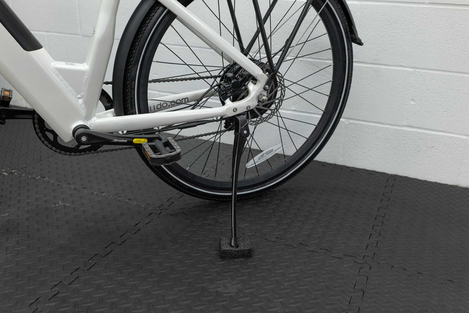

Kickstand
The C11 has a non-adjustable kickstand mounted on the left side. It’s a good length for the bike and is stable when deployed.

The C11 comes with rubber lock-on grips that offer good traction. The saddle is Velo-branded and has a wide back part that dug into my glutes, causing me to sit further forward, which was uncomfortable toward the end of the range tests. This is a personal preference; other users may find it comfortable.

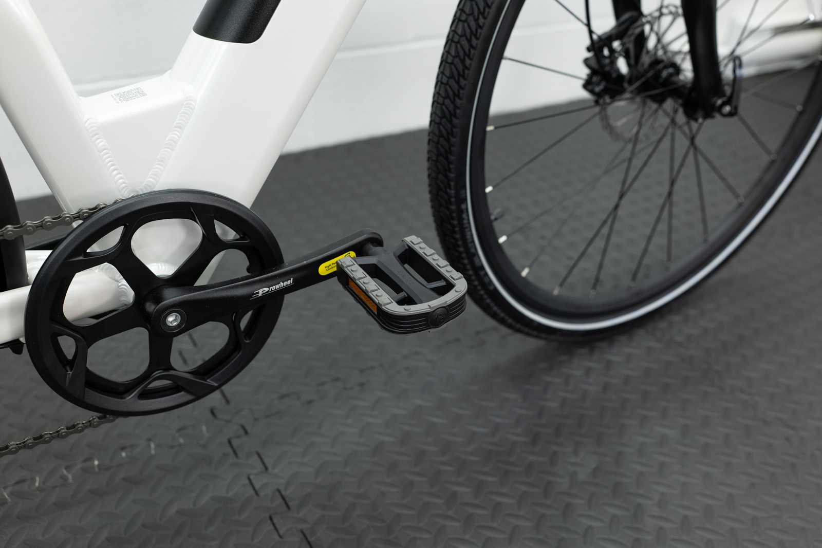

Fiido includes basic Wellgo pedals, which I found a bit slippery. Owners should consider swapping them for a grippier pedal if they plan to ride in the rain.
