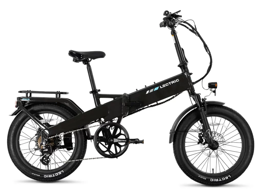

Lectric XP4 Review
Scott Clough-Carroll, Bike Testing and Video Production By Scott Clough-Carroll, updated Oct 22, 2026 | Tested using BikeRide Methodology 1.1 First-Hand Test
Our verdict
The Lectric XP4 is a folding commuter that answers the XP 3.0's complaints with a torque sensor, new hydraulic brakes, a color display and a side-access battery lock. It climbed our gradual hill in 3:02, the fastest in our folding group, and hit 20 mph in 8 seconds on pedal assist. Range was 32.76 miles at medium assist. The battery rattles in the down tube and 69 lb is heavy for a folder, but the XP4 sets the bar for budget e-folders.
  • Fastest climber in our folding group: 3:02
  • 8 seconds to 20 mph on pedal assist
  • Natural torque-sensor assist, five well-spaced levels
  • Clear color display with labeled menus
  • Lights, signals, fenders and 150 lb rack included
  • Battery rattles inside the down tube
  • Heavy for a folder at 69 lb
  • Shortest max-assist range in the group: 24.69 miles

The Lectric XP4 folded in half in the BikeRide studio, seen from the drive side with the headlight pointing up
Folded: 37" × 17" × 29" by Lectric's figures. The headlight ends up on top.
The quick-release pedals come off to reduce the bike's footprint.
Folded size:  37" × 17" × 29" (claimed)✓ Quick-release pedals✓ Removable display✓ Velcro strap and carry handleFold time:  not timed
Rated
The folding aluminum frame comes in step-over and step-through versions. We tested the step-over in Tempest Grey. It carries three sets of accessory bosses plus more on the integrated rack, and the fold points locked firmly without excessive play. The battery is the weak spot: it has a little clearance inside the down tube and rattles over broken pavement and off-road. A felt pad is an easy owner fix.
The Lectric XP4 from the non-drive side in the BikeRide studio, on its kickstand
The step-over frame in Tempest Grey. A step-through version is also sold.
