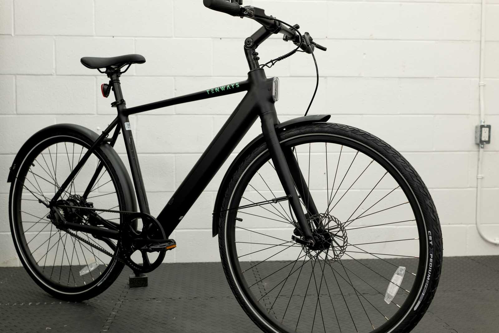

The TENWAYS CGO600 Pro is a lightweight, single-speed hybrid with a Gates Carbon belt drive and a torque sensor. It's also offered with an 8-speed chain drive (Pro-C). At 41.5 lb it is one of the lightest e-bikes we have tested, and it uses its small battery efficiently, at 12.9 Wh per mile on max assist. On the other hand, it took a lengthy 26 feet to stop from 20 mph, and its rigid frame delivers a harsh ride feel on rough pavement. Overall, the CGO600 Pro is easy to recommend for riders who want a simple, low-maintenance urban e-bike.
  • Lightweight at 41.5 lb on our scale
  • Efficient: 12.9 Wh per mile at max assist
  • Low-maintenance, grease-free belt drive
  • Responsive, well-tuned torque sensor
  • Fastest gradual-hill climb in its group: 3:06
  • Longest stopping distance in its group: 26 feet
  • Harsh ride over bumpy pavement
  • Single-speed is limiting on steep hills
  • Externally powered rear light and no rack

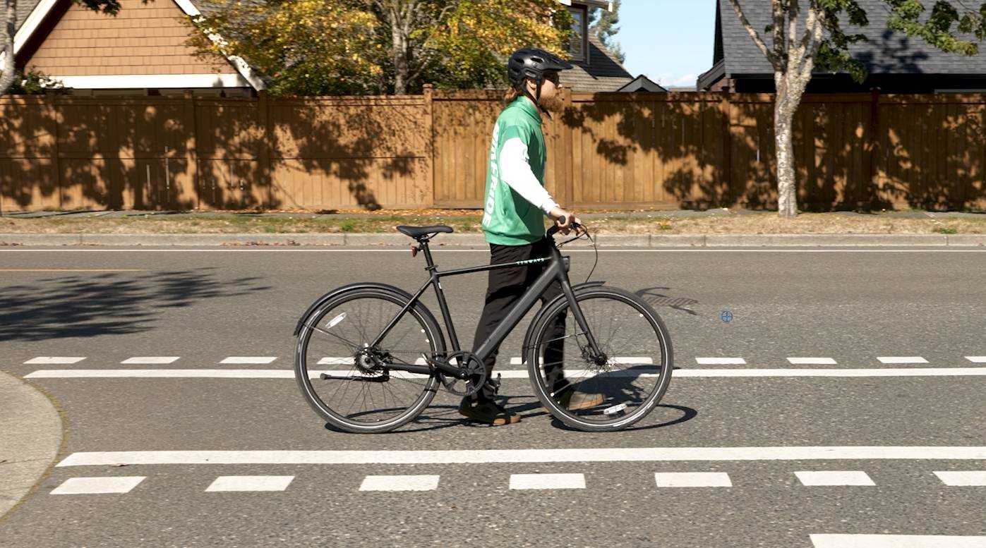

  • Riders who want an e-bike that rides like a bike. It is light, responsive, and easy to pedal, and the well-tuned torque sensor made the rear hub motor feel close to a mid-drive.
  • Commuters who want as little maintenance as possible. The single-speed Gates Carbon belt drive requires very little upkeep, and it keeps clothes grease-free.
  • Riders who have to lift or carry their bike. At 41.5 lb, with the size of a conventional bike, it is relatively easy to lift and to move through doorways and up stairs.

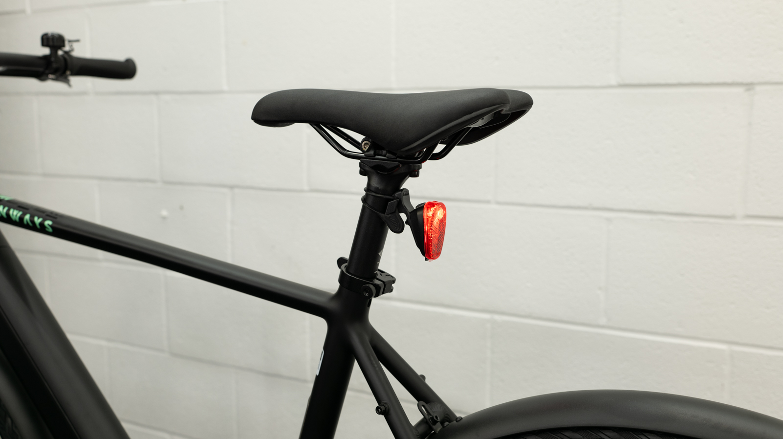

  • Commuters who carry cargo or want a brake light. No rack is included, and the battery-powered rear light doesn't light up when you brake.

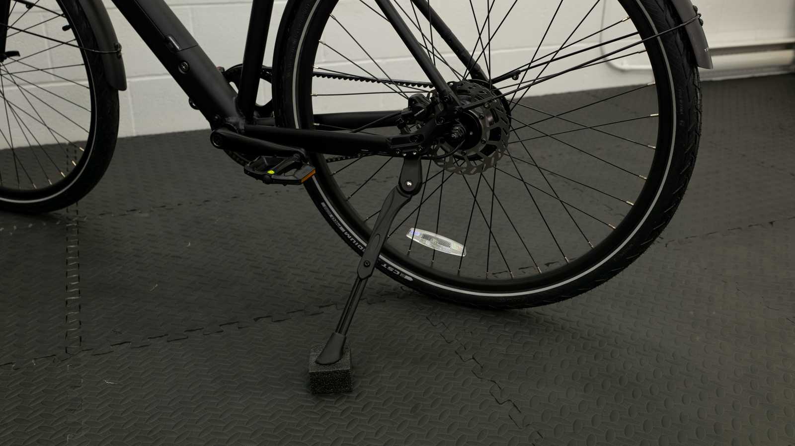

Before you buy: one gear

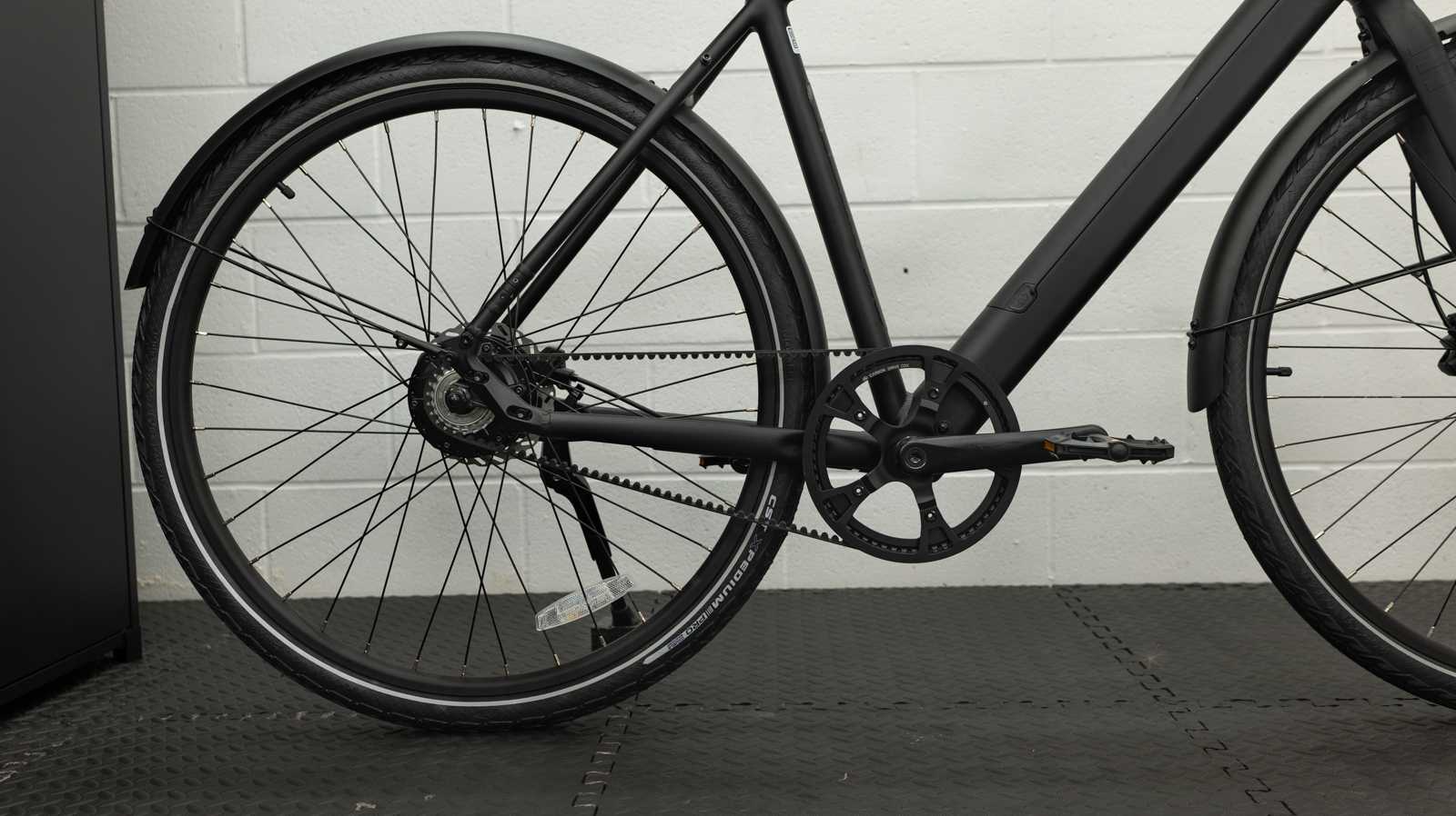

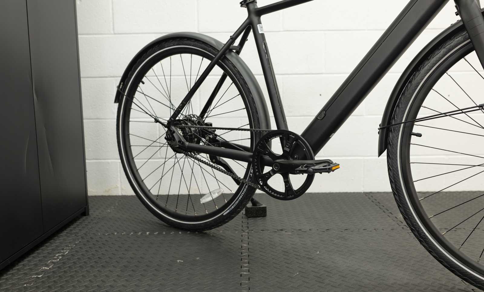

The CGO600 Pro has a single gear and a belt in place of a chain. Here is what that meant in our testing:
  • Nothing to oil or index. The Gates Carbon belt runs without lubrication, and there is no derailleur to adjust. A simple way to ride.
  • Gentle hills are easy. On grades below about 10% the motor gave enough help to stay seated, and the bike had the fastest gradual-hill time in its comparison group.
  • Steep hills mean standing. Above about 10% we had to stand to put enough force on the pedals. Even so, its 2:40 on our steep hill beat both other single-speed belt-drive bikes in the group.
  • A fast cadence at top speed. With one ratio, pedaling at the 20 mph limit felt uncomfortably fast.
If your routes are mostly flat and you like to pedal, one gear is all the CGO600 Pro needs. If you climb steep hills every day, a geared e-bike is the better choice.

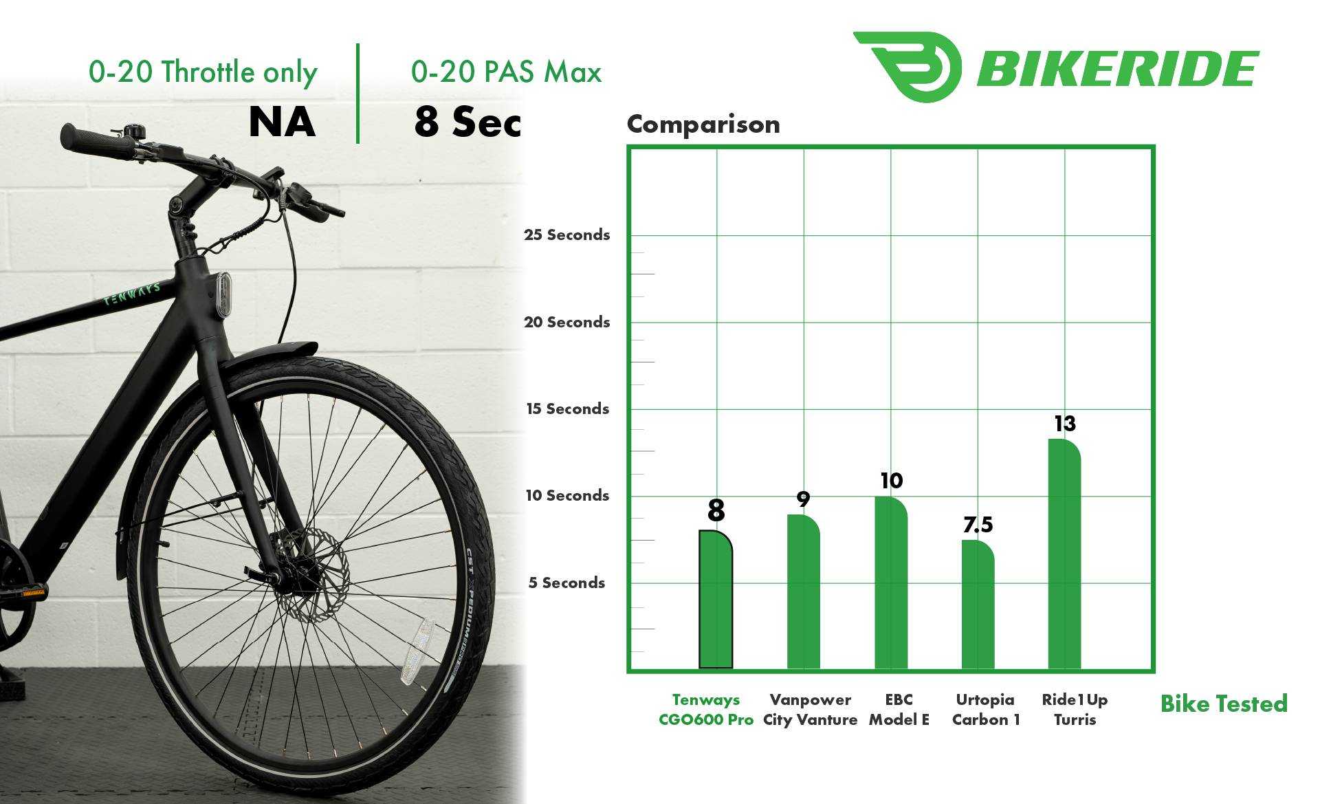

On maximum pedal assist (PAS 3) the CGO600 Pro reached 20 mph in 8 seconds. That ties it for third of the four bikes in this comparison group that we timed to 20 mph, and it is quicker than the 9.3-second average of the rear-hub e-bikes of 500W or less we have tested. As a Class 1 e-bike it has no throttle.
From the handlebar crossing a junction.
0–20 mph, max pedal assist
Seconds · shorter is faster · the Fiido Air is limited to 15.5 mph
Aventon Pace 45.0 s
Fiido Air 0–15.5 mph7.0 s
Urtopia Carbon 17.5 s
TENWAYS CGO600 Pro8.0 s
Velotric T1 ST Plus8.0 s
TENWAYS CGO600 ProComparison bikesAverage of similar bikes (9.3 s)
Max pedal assist: 8.0 sThrottle: none (Class 1)Average of similar bikes: 9.3 sTies third of four timed to 20 mph

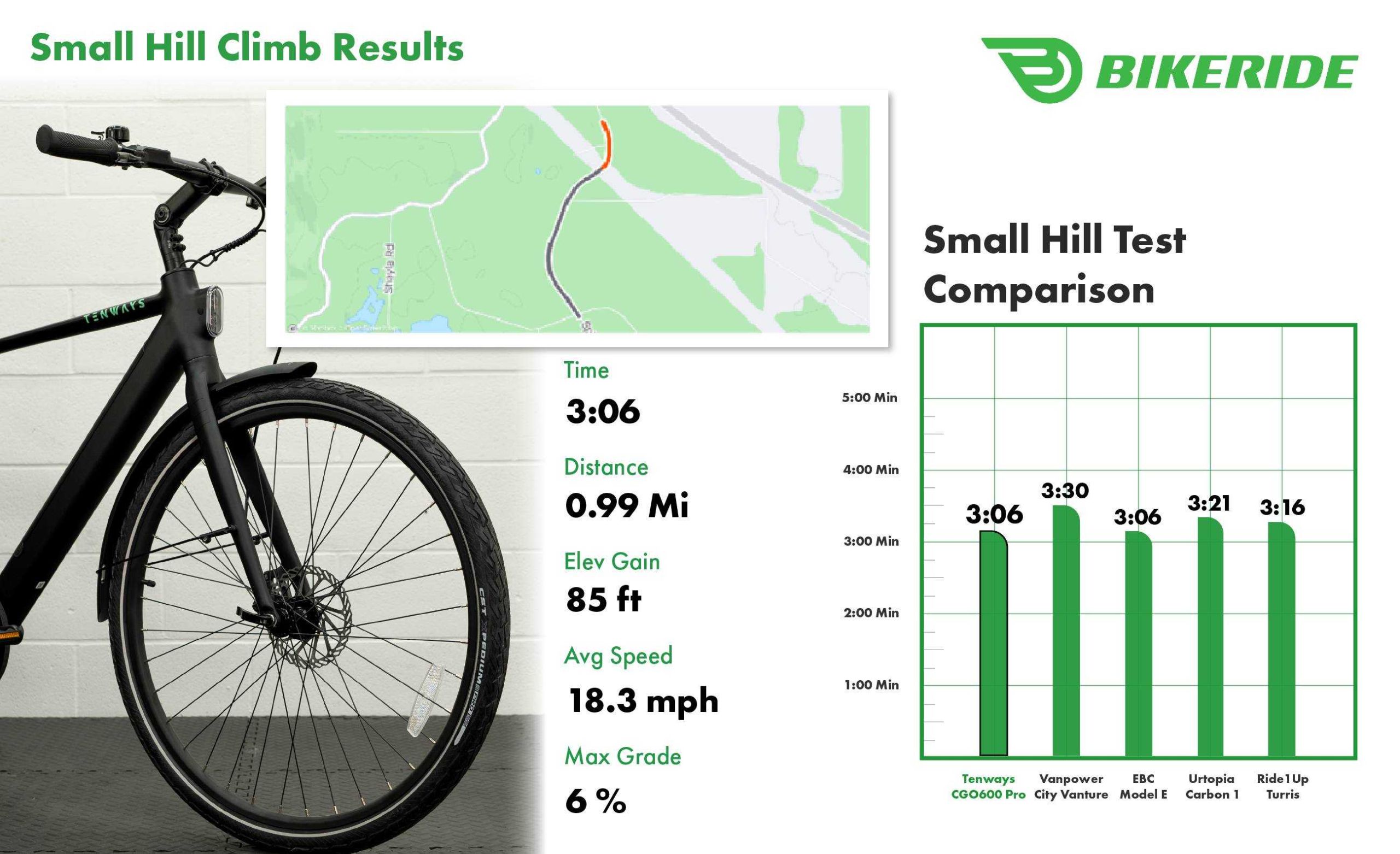

On the gradual hill (0.99 miles at up to a 6% grade) the CGO600 Pro took 3:06 at an average of 18.3 mph with its 20 mph limit. That is the fastest time in this comparison group and 23 seconds ahead of the 3:29 average of the rear-hub e-bikes of 500W or less we tested on capped runs.
Gradual hill climb, max assist, 20 mph cap
Minutes:seconds · shorter is faster · 0.99 mi · 79 ft gain · 6% max grade
TENWAYS CGO600 Pro3:06
Aventon Pace 43:13
Urtopia Carbon 13:21
Fiido Air 15.5 mph cap3:53
Velotric T1 ST Plus4:03
TENWAYS CGO600 ProComparison bikesAverage of similar bikes, capped runs (3:29)
CGO600 Pro, 20 mph cap: 3:06 · 18.3 mph avgAverage of similar bikes, capped runs: 3:29Fastest in the group

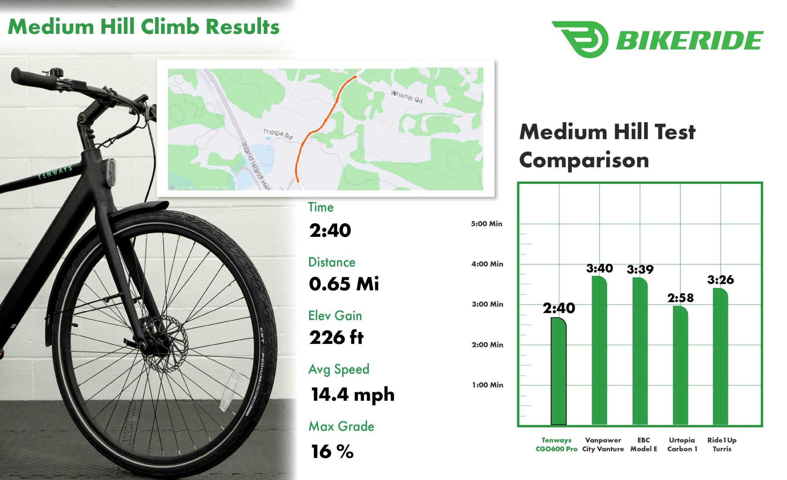

On the steep hill, 0.65 miles with 226 feet of gain and a 12% maximum grade, the CGO600 Pro took 2:40 at an average of 14.4 mph. That is second in this comparison group and 17 seconds ahead of the 2:57 average of the rear-hub e-bikes of 500W or less we have tested. With one gear and 45 Nm, we had to stand on the pedals on the steepest grades.
Climbing a residential street.
Steep hill climb, max assist
Minutes:seconds · shorter is faster · 0.65 mi · 226 ft gain · 12% max grade
Aventon Pace 42:34
TENWAYS CGO600 Pro2:40
Urtopia Carbon 12:58
Fiido Air3:41
TENWAYS CGO600 ProComparison bikesAverage of similar bikes (2:57)
CGO600 Pro: 2:40 · 14.4 mph avgAverage of similar bikes: 2:57Second of five in the group

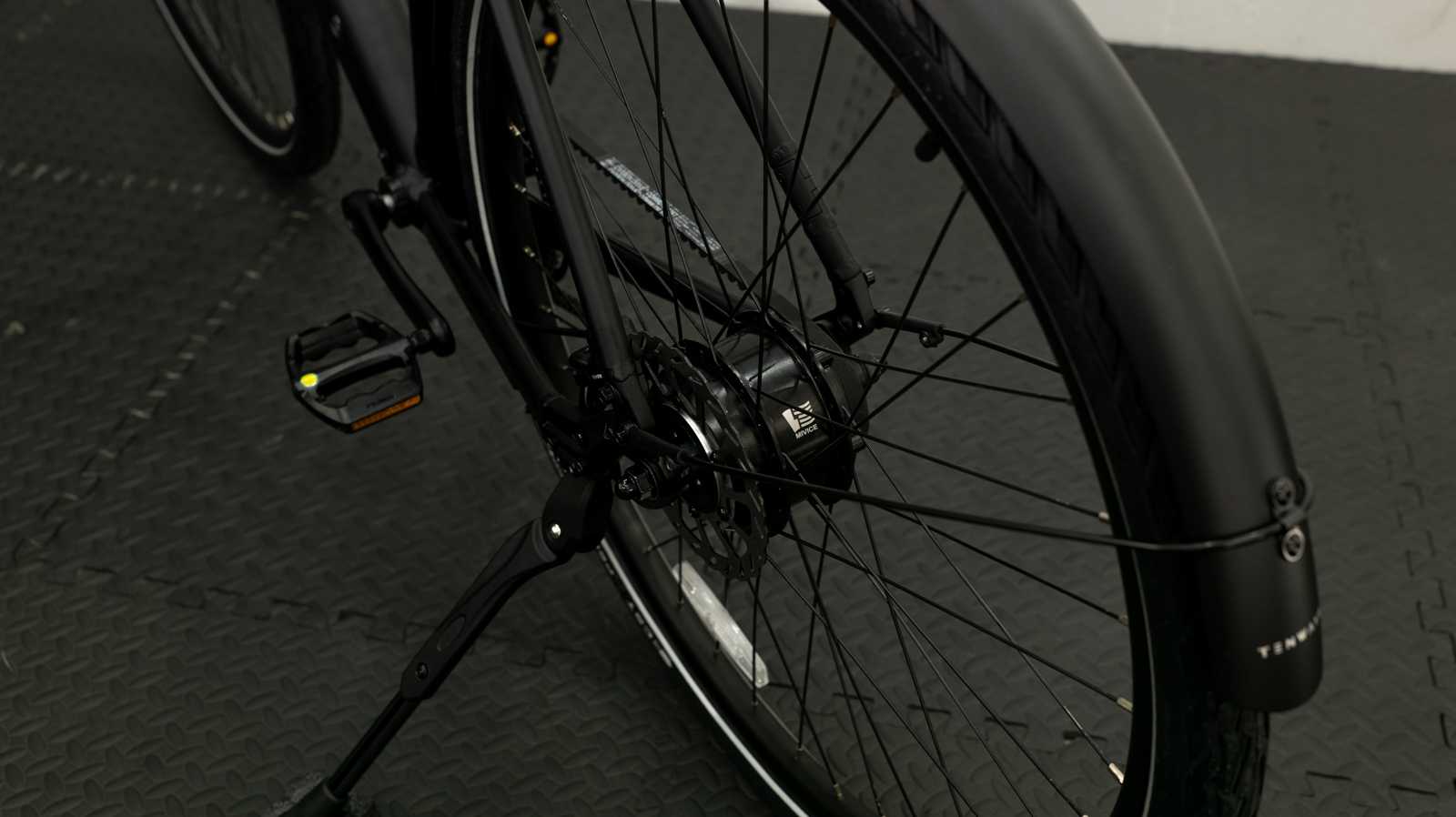

The TENWAYS CGO600 Pro's Mivice rear hub motor behind the belt sprocket, from the drive side in the studio
The Mivice M080 rear hub motor: 350W and 45 Nm, claimed.
Motor engagement5/5Responsive and well tuned, close to a mid-drive in feel.

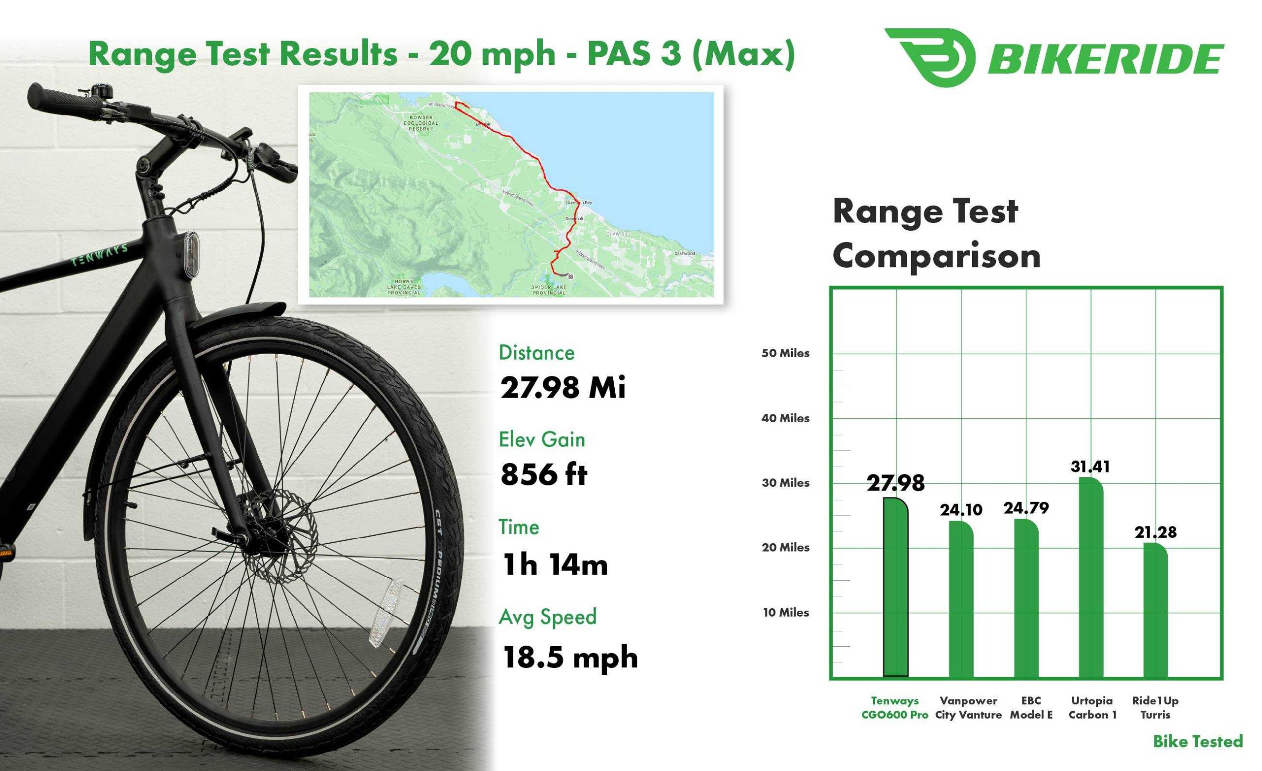

Range Test 1: Max Assist (PAS 3, 20 mph limit)
Measured
At maximum assist (PAS 3) the CGO600 Pro lasted 27.98 miles on our standard loop, with 856 feet of elevation gain, at an 18.5 mph average. That is 3% below the 28.7-mile average of the hybrid e-bikes we have tested and third of five in this comparison group.
Scott on a paved path.
Range at maximum assist
Miles · longer is better
Aventon Pace 445.24 mi
Urtopia Carbon 131.41 mi
TENWAYS CGO600 Pro27.98 mi
Fiido Air18.63 mi
Velotric T1 ST Plus Boost16.93 mi
TENWAYS CGO600 ProComparison bikesAverage of similar bikes (28.7 mi)
CGO600 Pro, PAS 3: 27.98 mi · 856 ft climbed · 1 h 31 min · 18.5 mph avgAverage of similar bikes at max assist: 28.7 mi−3% vs. similar bikesThird of five in the group
Where the CGO600 Pro sits: range

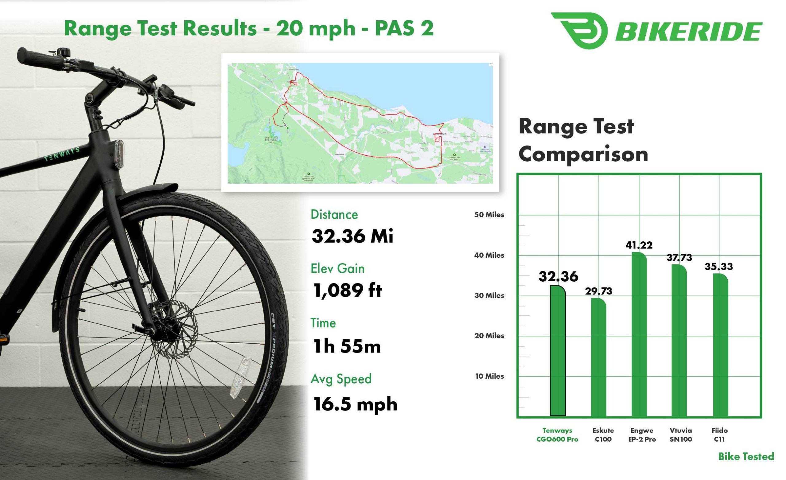

One level down, at PAS 2, the CGO600 Pro lasted 32.36 miles on the same loop, 16% farther, with 1,089 feet of elevation gain, at a 16.9 mph average. That is 13% below the 37.4-mile average of the hybrid e-bikes we have tested at medium assist and second of the four medium-assist runs in this comparison group.
Range at medium assist
Miles · longer is better · the CGO600 Pro at PAS 2 · no medium-assist run for the Carbon 1
Aventon Pace 4 Sport54.79 mi
TENWAYS CGO600 Pro32.36 mi
Velotric T1 ST Plus Trail30.63 mi
Fiido Air Normal23.51 mi
TENWAYS CGO600 ProComparison bikesAverage of similar bikes (37.4 mi)
CGO600 Pro, PAS 2: 32.36 mi · 1,089 ft climbed · 1 h 55 min · 16.9 mph avgAverage of similar bikes at medium assist: 37.4 mi−13% vs. similar bikesSecond of four in the group

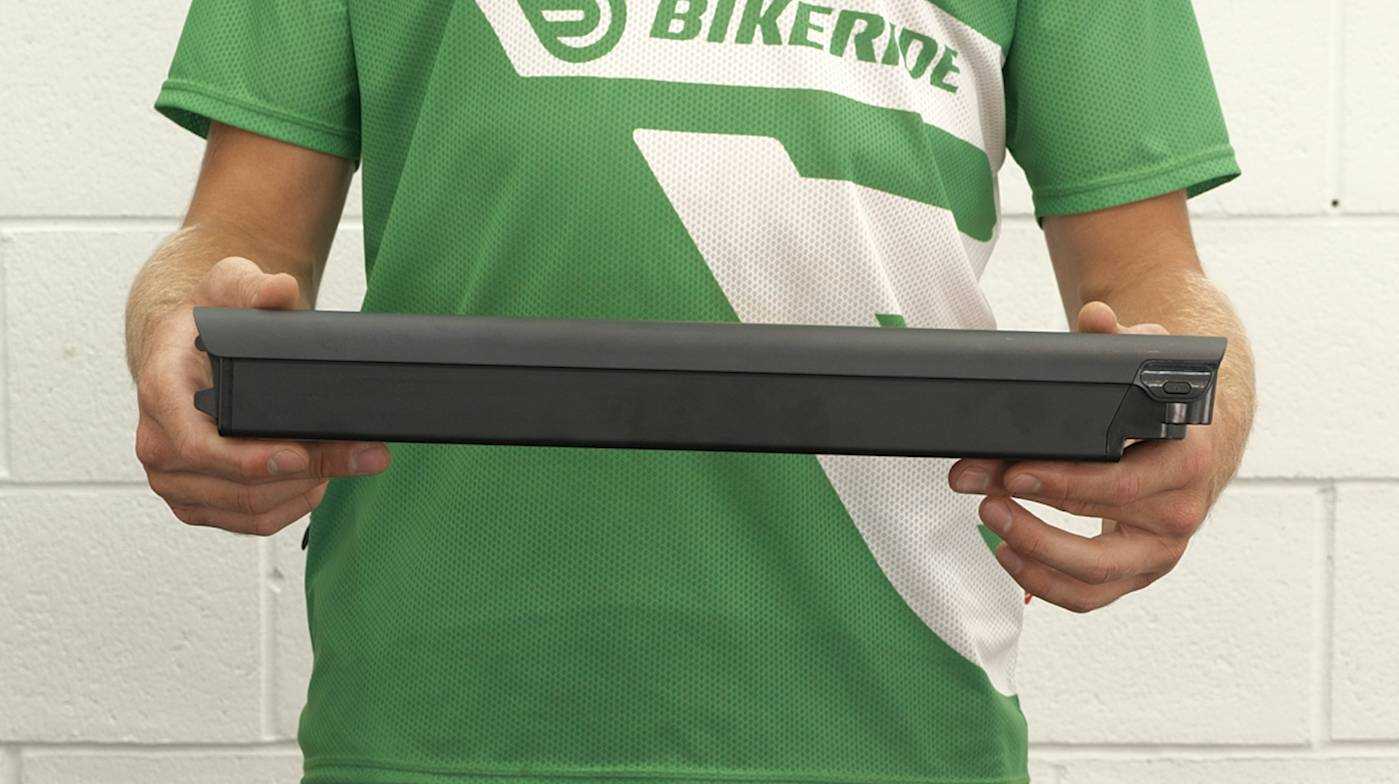

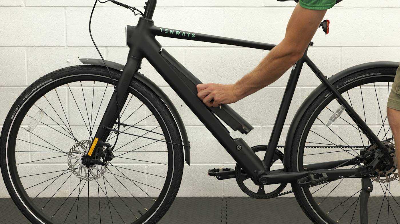

The 36V 10Ah battery (360 Wh) sits in the down tube and locks with a key on the non-drive side of the frame. Turn the key and the battery pops out and lifts away. To refit it, press it down until it clicks. It charges on or off the bike through one port on the battery, under a rubber cover.
The display shows the charge as a graphic and as a percentage, and its third screen adds a range estimate. The battery and electrical system were not UL certified when we tested the bike.
The battery slides back into the down tube and presses into place.
✓ Removable battery, key lock✓ Charges on or off the bikeCertification:  no UL certification when we tested it✓ IP65 (claimed)
Charge-gauge accuracy5/5A reliable percentage readout and a range estimate.
Battery removal and locking5/5Turn the key and the battery pops out.

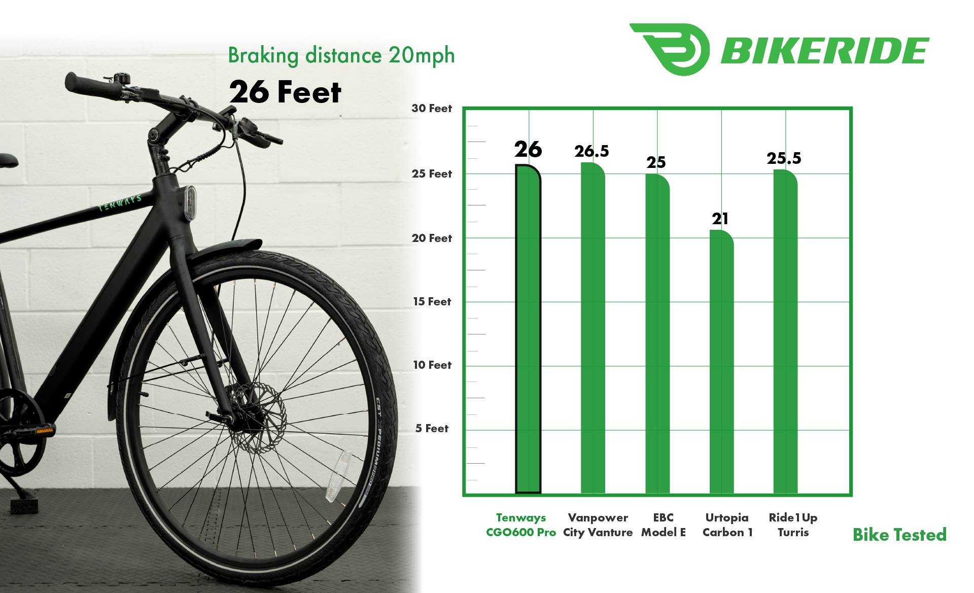

The Tektro hydraulic discs, with two-piston calipers and 160 mm rotors front and rear, stopped the CGO600 Pro from 20 mph in 26 feet. That is the longest stop in this comparison group and 5.1 feet longer than the 20.9-foot average of the hybrid e-bikes we have tested. Otherwise, the brakes worked consistently throughout testing, with a pleasant lever feel.
The full stop from 20 mph, seen from above: 26 feet.
Braking distance, 20–0 mph
Feet · shorter is better
TENWAYS CGO600 Pro26 ft
Urtopia Carbon 121 ft
Velotric T1 ST Plus18 ft
Fiido Air18 ft
Aventon Pace 418 ft
TENWAYS CGO600 ProComparison bikesAverage of similar bikes (20.9 ft)

CGO600 Pro: 26 ftAverage of similar bikes: 20.9 ftLongest in the group

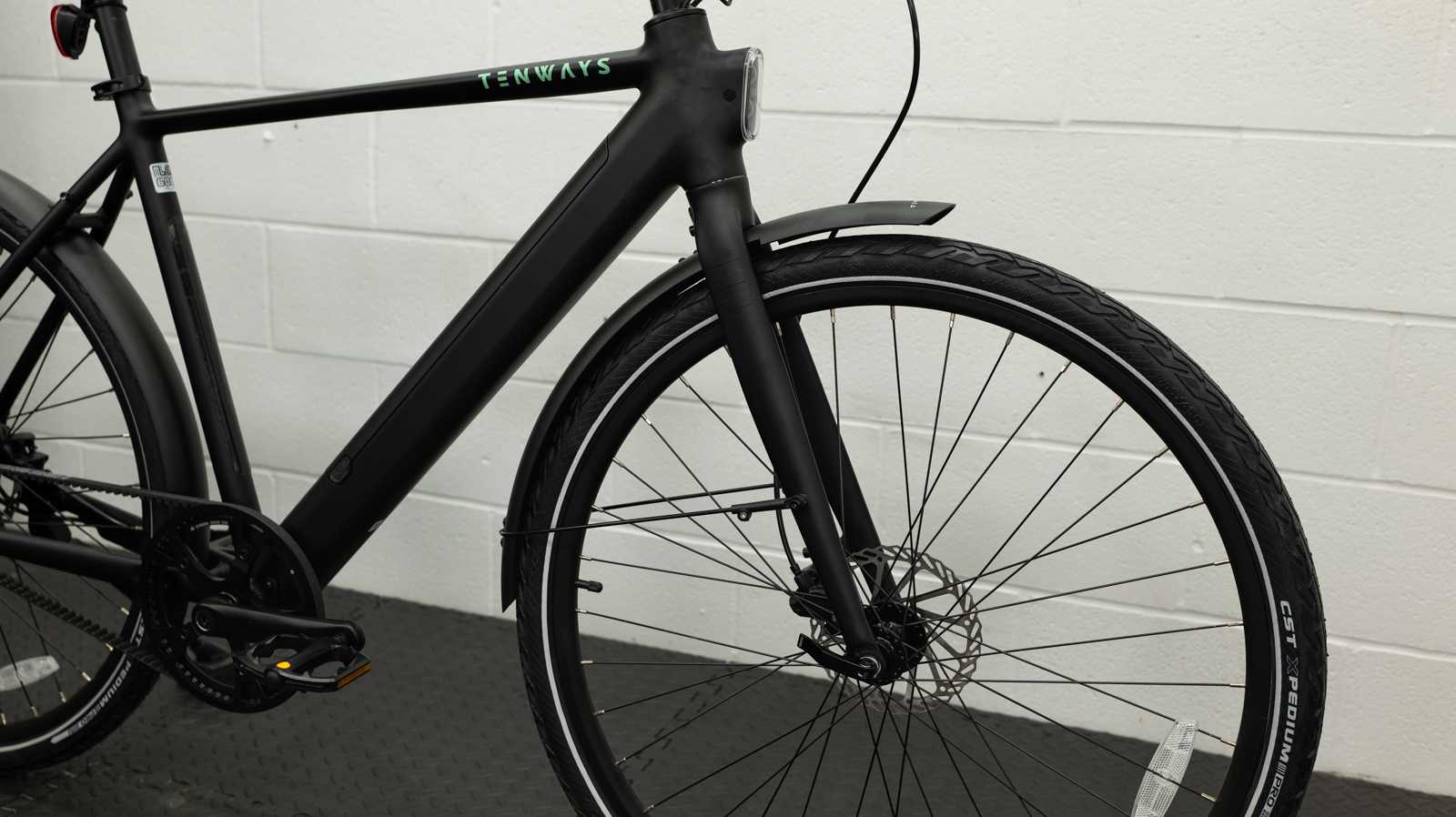

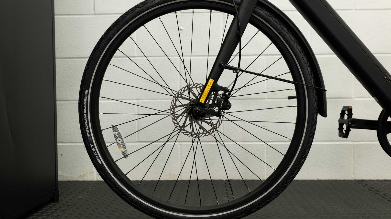

The TENWAYS CGO600 Pro's front wheel, with its 160 mm rotor and Tektro hydraulic caliper on the rigid fork
The front Tektro caliper and 160 mm rotor.
Brake feel and modulation3/5A pleasant lever feel, but a long 26 ft stop from 20 mph.

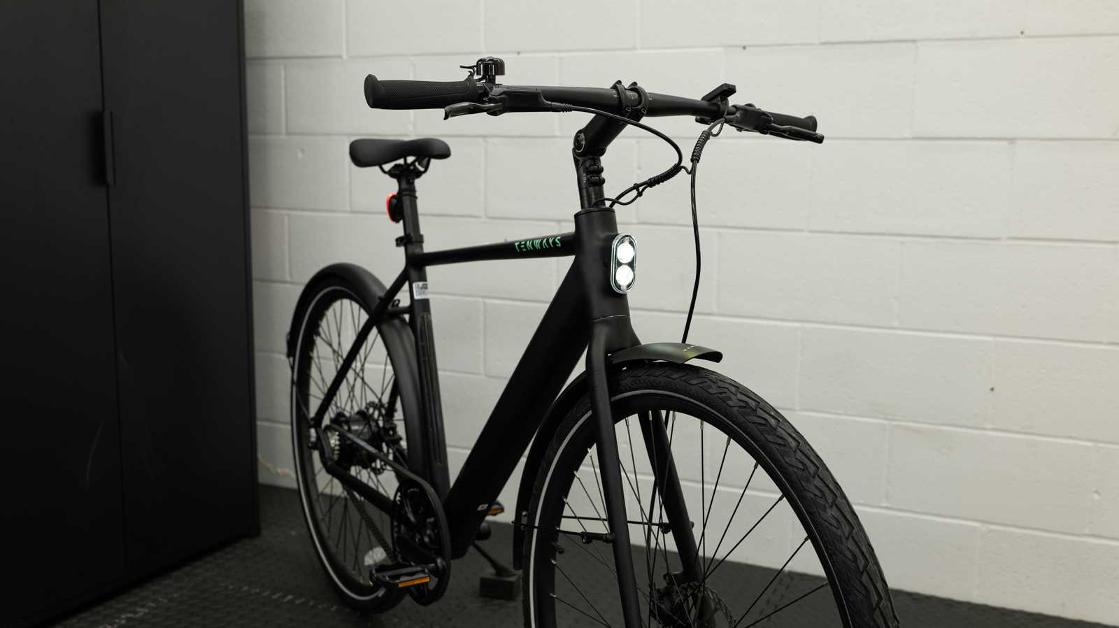

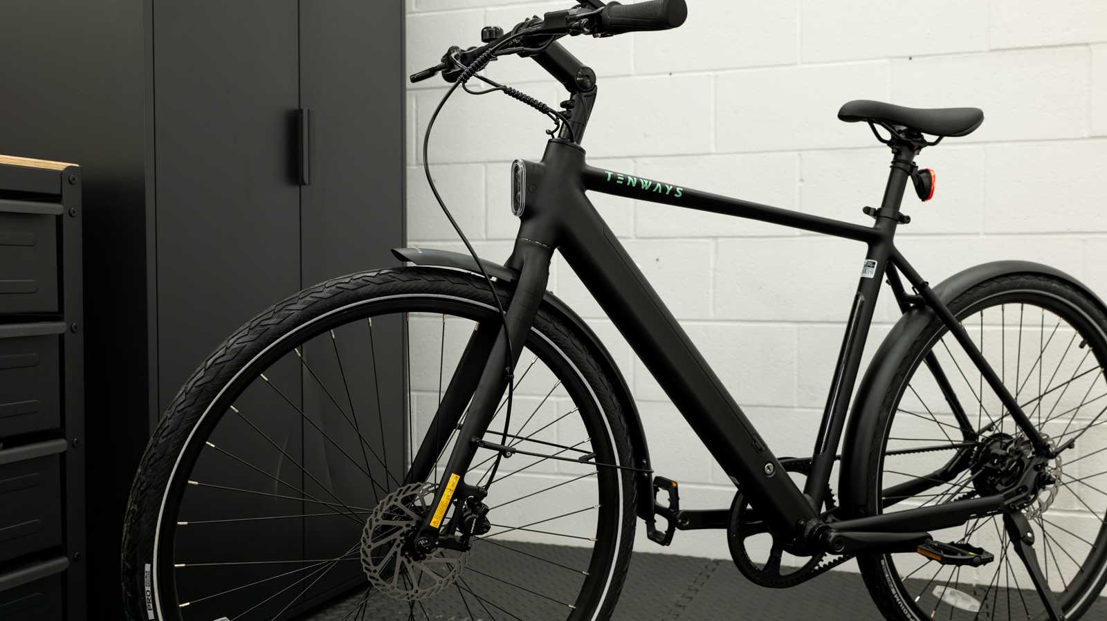

The headlight is built into the head tube, so it doesn't turn with the handlebar. It is rated at 34 lux, and as an StVZO-compliant light it has no flashing mode. The rear light is a separate, battery-powered unit on the seatpost. It has its own switch, so it must be turned on and off by hand, and it doesn't work as a brake light.
The TENWAYS CGO600 Pro's headlight, lit, in the front of the head tube, below the adjustable stem
The headlight, lit, in the head tube.
The battery-powered rear light on the seatpost.

The CGO600 Pro is light, responsive, and easy to pedal, even without assistance. It turns quickly and is easy to maneuver, and its natural ride will suit people who cycle regularly. The riding position is athletic, with the rider leaning forward over the bike.
A U-turn on a paved path.

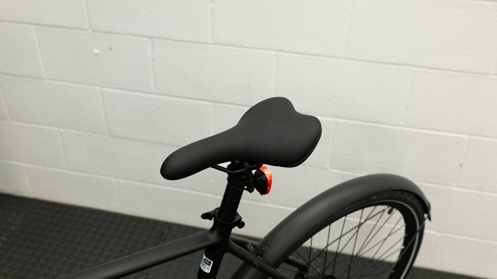

The aluminum frame and rigid fork pass on every bump in the road. On anything but smooth pavement the ride was rough, and the vibration made the fenders and kickstand rattle. We ran the tires at 60 psi. They are rated for 50 to 75 psi, so a lower pressure would soften the ride a little.

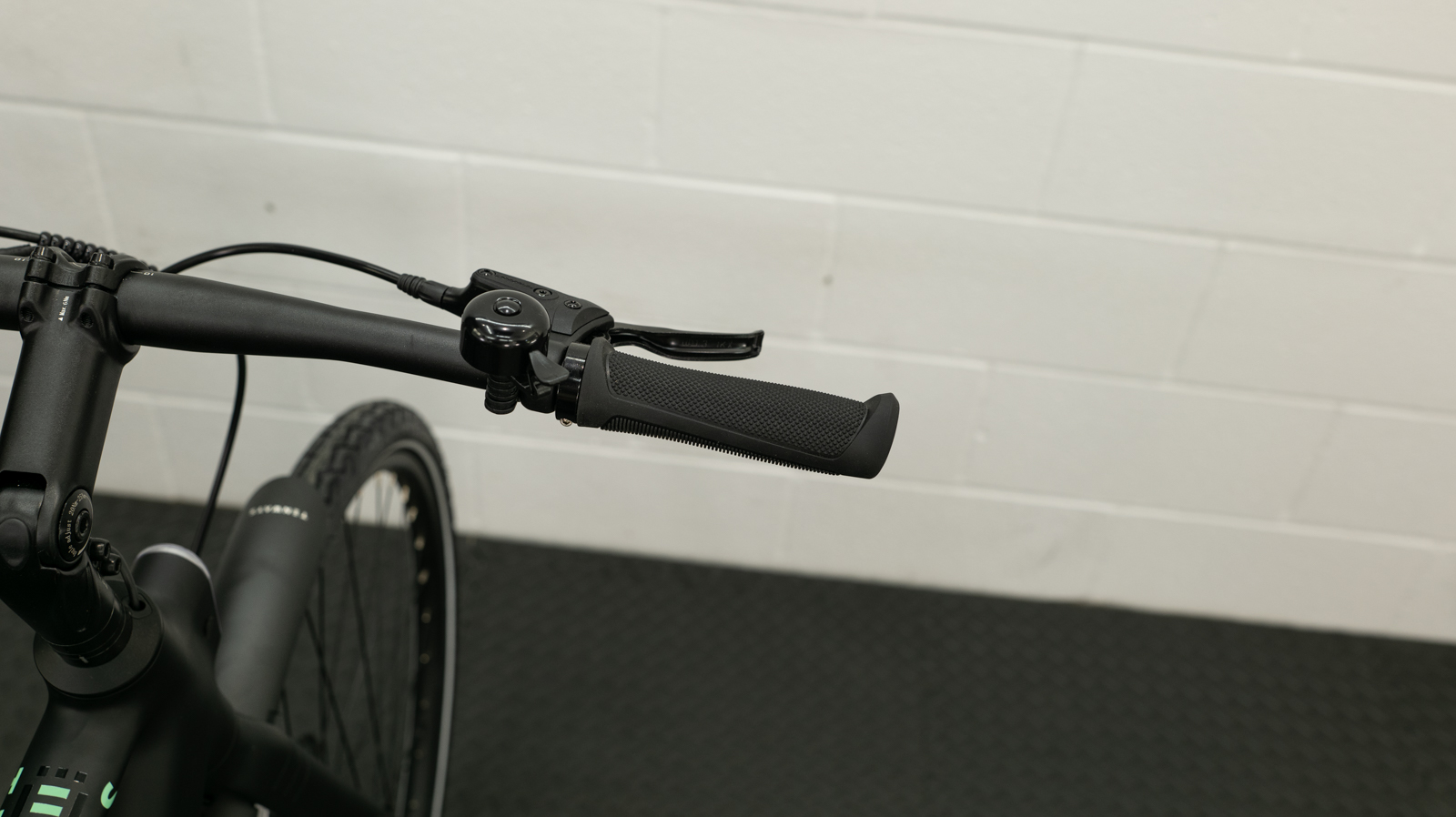

The rubber lock-on grips flare at the ends, were comfortable, and didn't slide. The saddle is narrow and lightly padded. It was comfortable on shorter rides but felt hard by the end of a long ride.
Scott on a gravel path.
The TENWAYS CGO600 Pro's narrow saddle from the side, with the red rear light on the seatpost below it
The narrow, lightly padded saddle.
Saddle comfort4/5Comfortable for shorter rides, but hard by the end of a long ride.

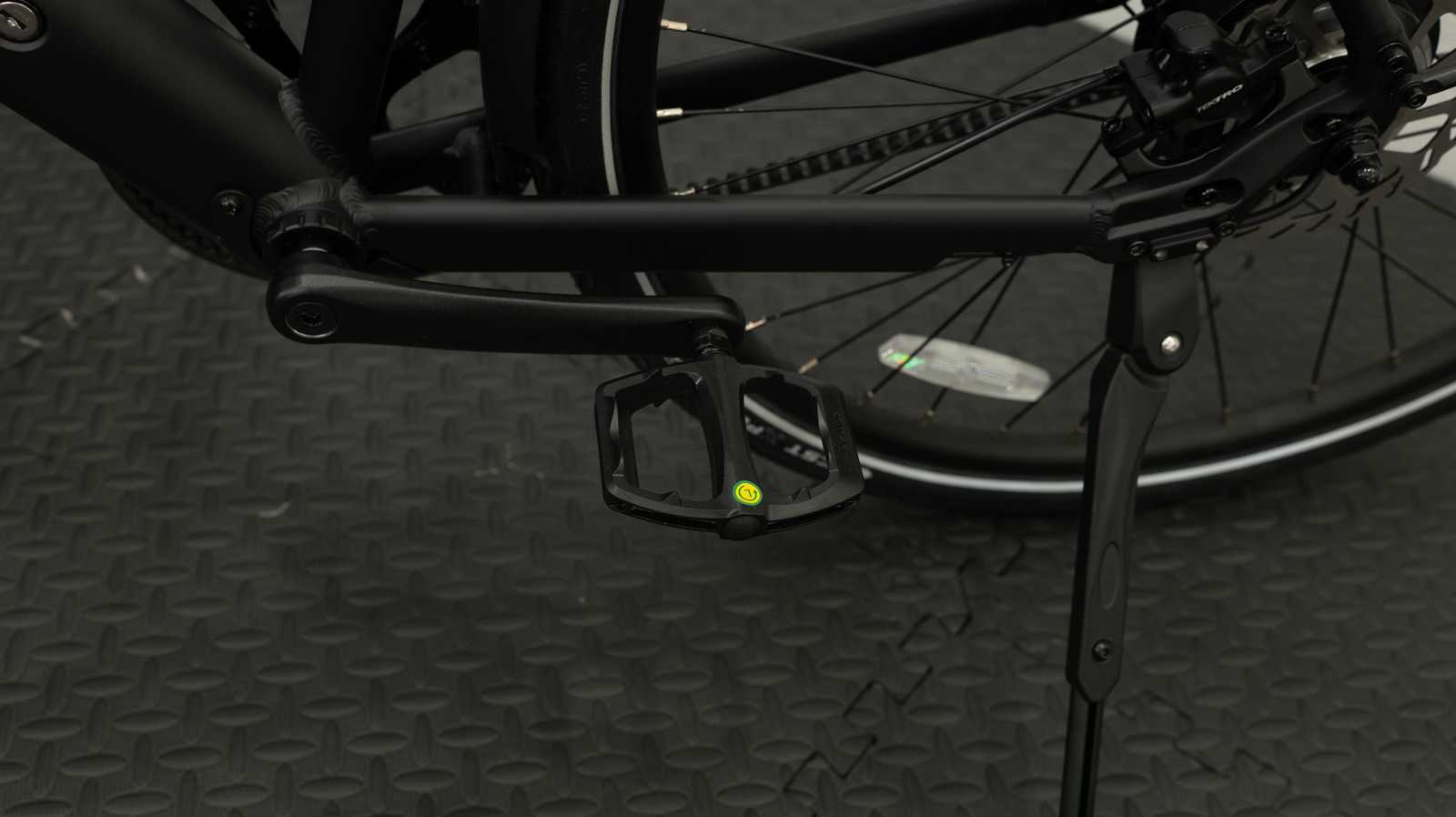

Grips and pedals3/5Comfortable grips, but the plastic pedals felt a bit slippery.

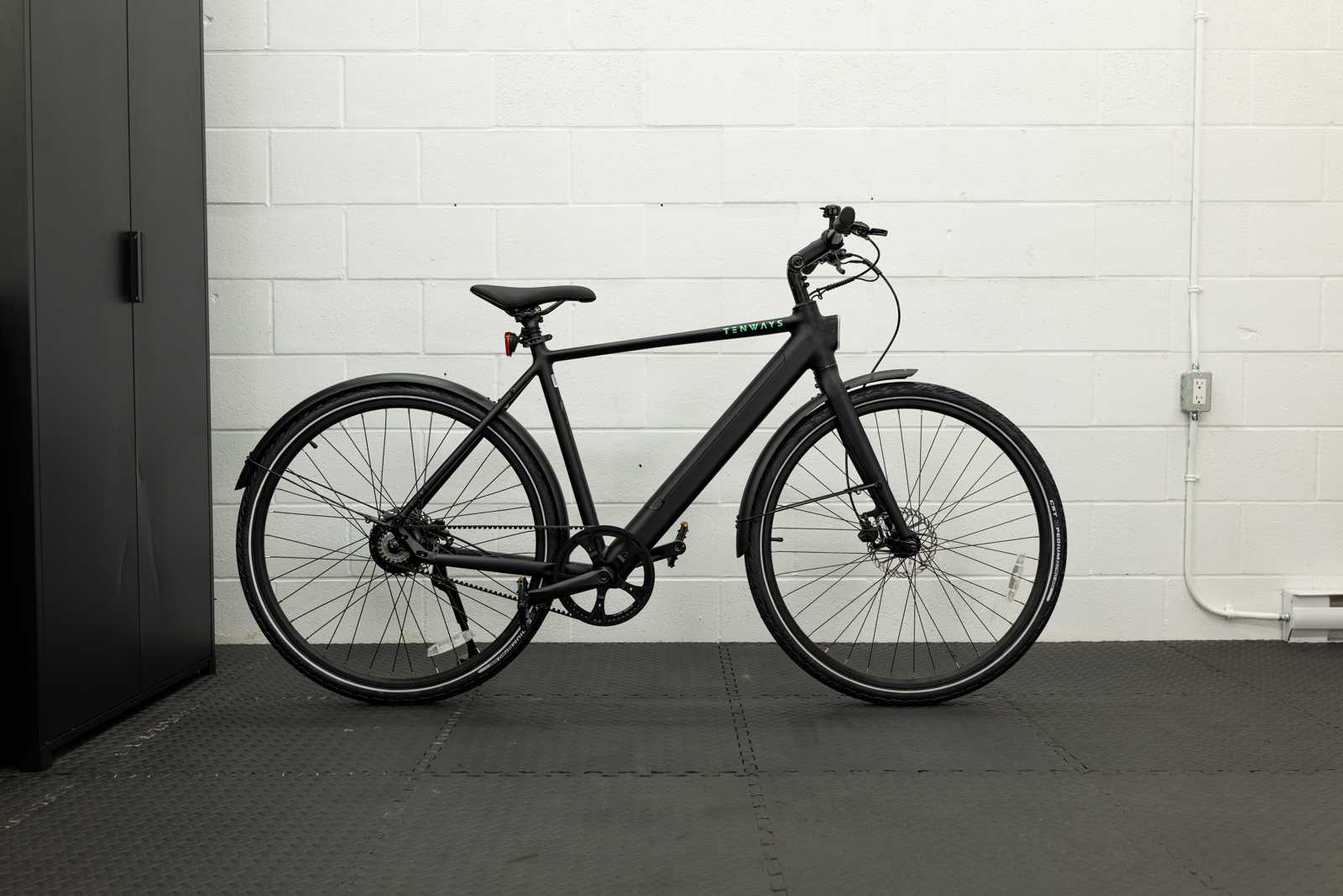

Weight, verified
Measured
TENWAYS lists the CGO600 Pro at 41 lb with accessories. Our scale read 41.5 lb with the accessories fitted, 1.2% over the 41 lb figure and inside our tolerance. That is second-lightest of the four bikes we weighed in this comparison group, 7.2 lb under the 48.7 lb average of the hybrid e-bikes we have weighed, and fourth-lightest of the 75 e-bikes we have weighed.

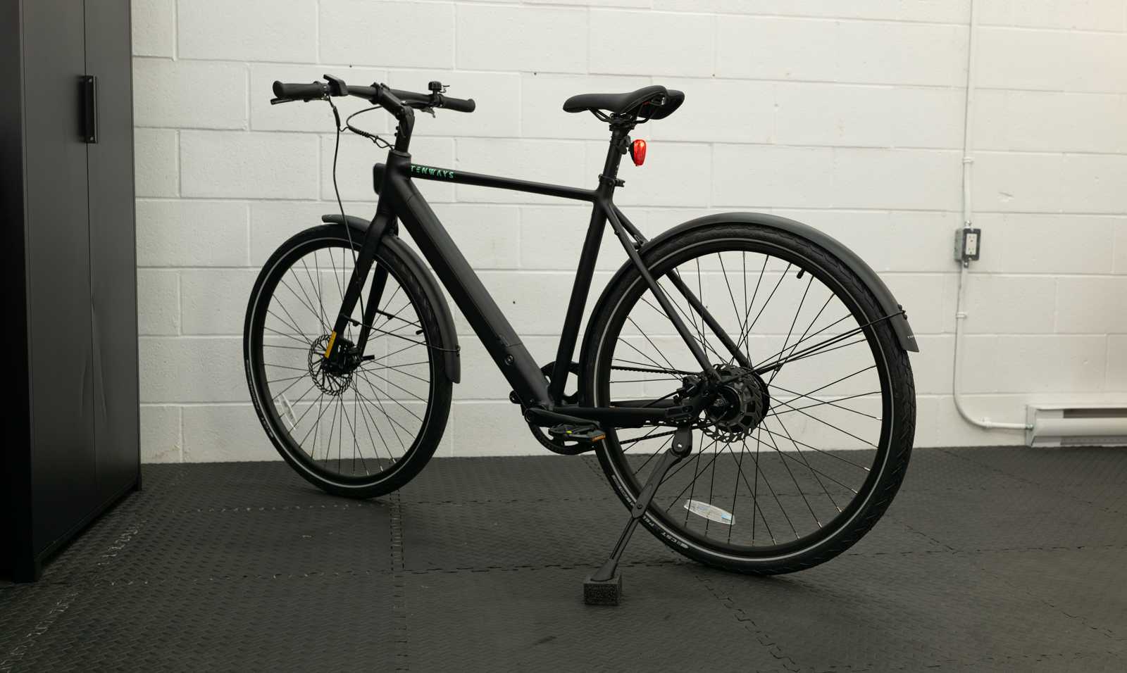

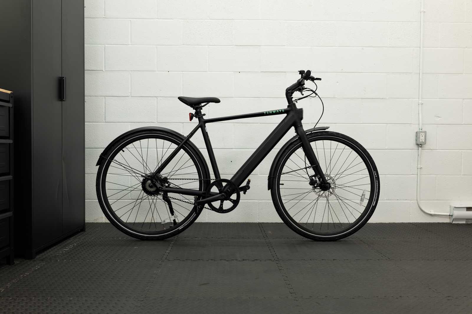

The frame and fork are 6061 aluminum, with a sleek, minimalist shape. TENWAYS offers four colors, and our test bike was Midnight Black. The frame has mounts for a rear rack but none for a bottle cage.
The TENWAYS CGO600 Pro's matte black aluminum frame and fork from the drive side, with the TENWAYS name on the top tube
The aluminum frame in Midnight Black.

The single-speed Gates Carbon belt drive runs without oil and is quiet, and it should last far longer than a chain. With no gears there is nothing to shift. The trade-offs of one gear, on steep hills and at top speed, are covered in Before you buy.
The TENWAYS CGO600 Pro's Gates Carbon belt and crankset from the drive side
The Gates Carbon belt and crankset.
✓ Gates Carbon belt drive, no lubricationGears:  one

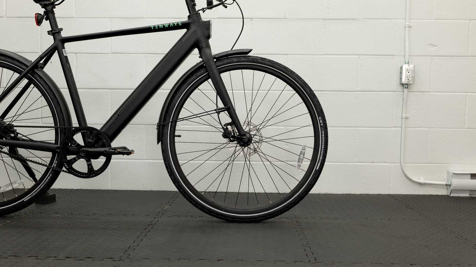

The 700×45C CST Xpedium Pro tires have puncture protection and a good mix of traction and rolling speed. They suit dirt paths and light gravel, though the rigid frame makes that terrain uncomfortable.
Our test bike had full-coverage fenders and a single-sided kickstand, which held the bike without trouble. No rear rack is included. TENWAYS sells one separately.
The TENWAYS CGO600 Pro's front wheel with its 700×45C CST tire, disc rotor and fender
The 700×45C CST tire.
The TENWAYS CGO600 Pro's rear wheel with its full-coverage fender, from the drive side
The full-coverage rear fender.
Tires5/5A good mix of traction and rolling speed, with puncture protection.

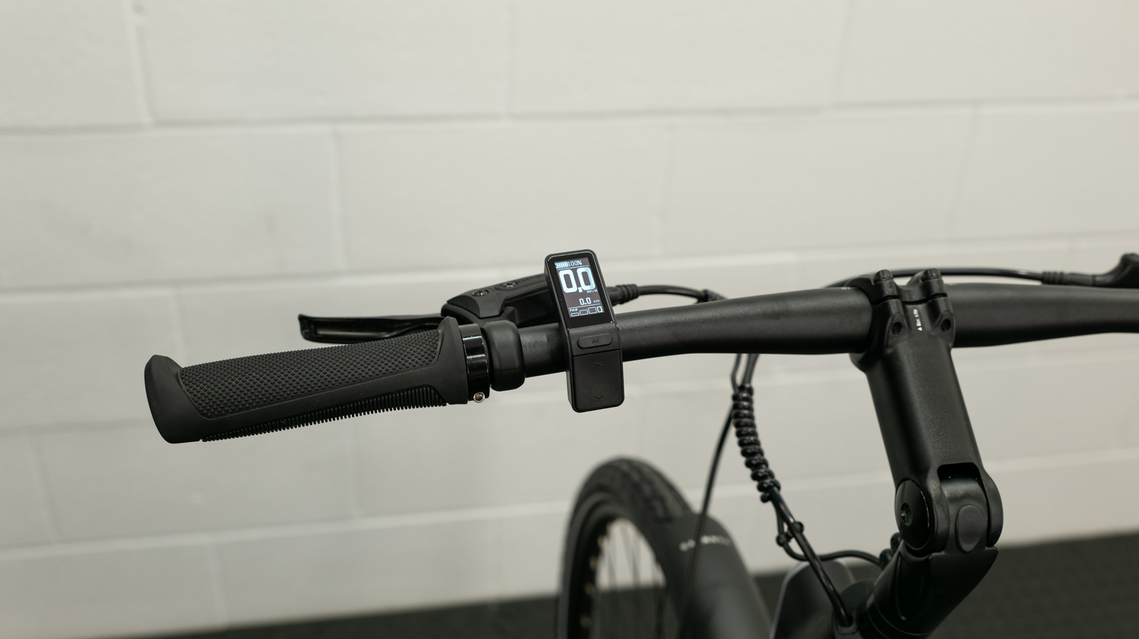

The small display is built into a four-button pad on the handlebar.
Holding M opens the settings menu, which was easy to reach and use. Its items have plain, descriptive names, not the number codes of many e-bike menus.
Holding the up button switches on the headlight.
The settings menu.
Display readability3/5Small but clear.
Controls5/5A simple four-button pad and a plainly worded settings menu.

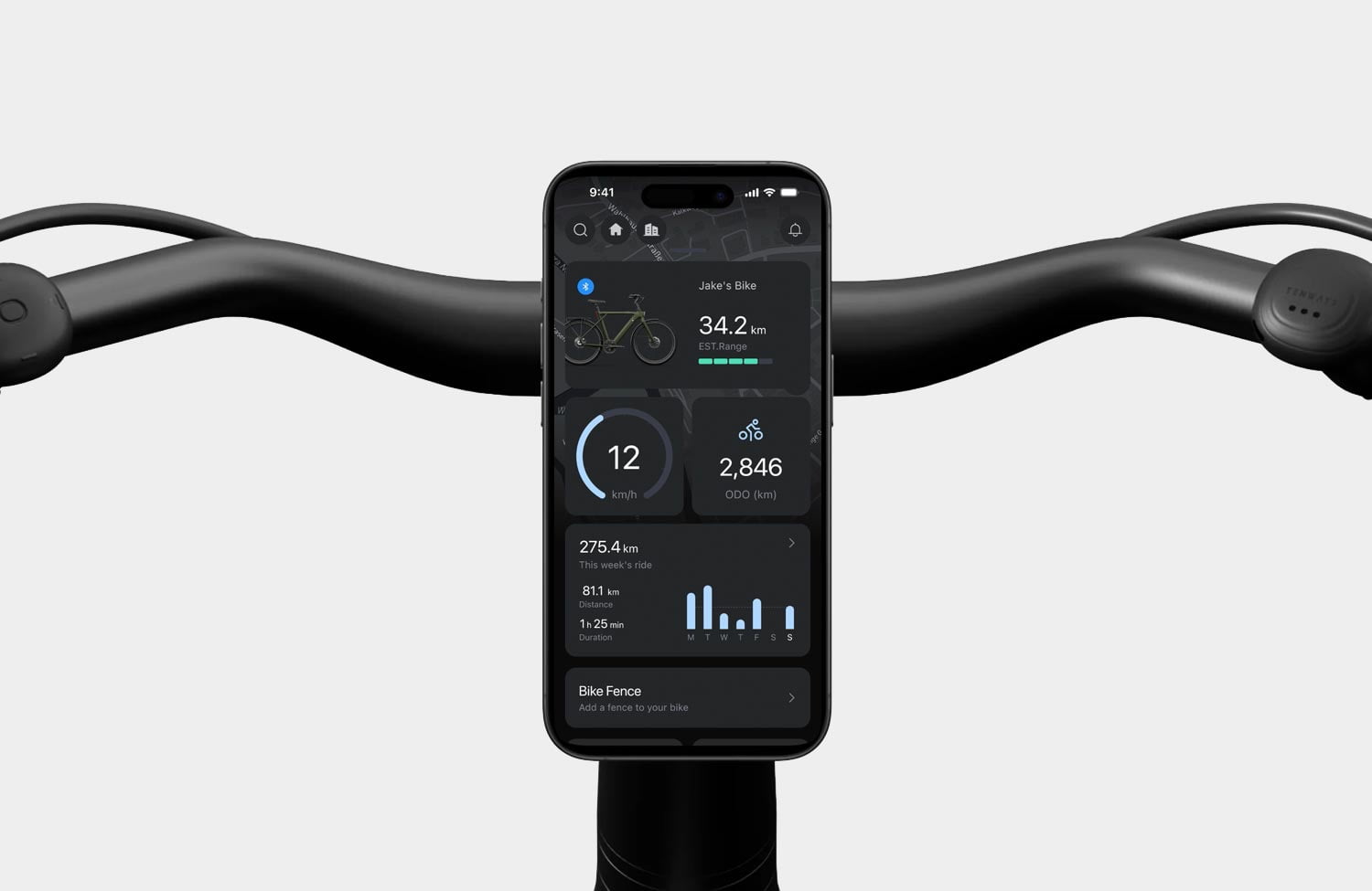

The TENWAYS app connects to the bike by Bluetooth. It tracks rides and mileage, shares them on social media, and helps with troubleshooting and customer service. It adds little beyond that: every setting we needed was easy to reach on the display.
✓ Ride trackingSettings:  on the display, no app needed
Companion app3/5Ride tracking and support, but little the display doesn't already do.

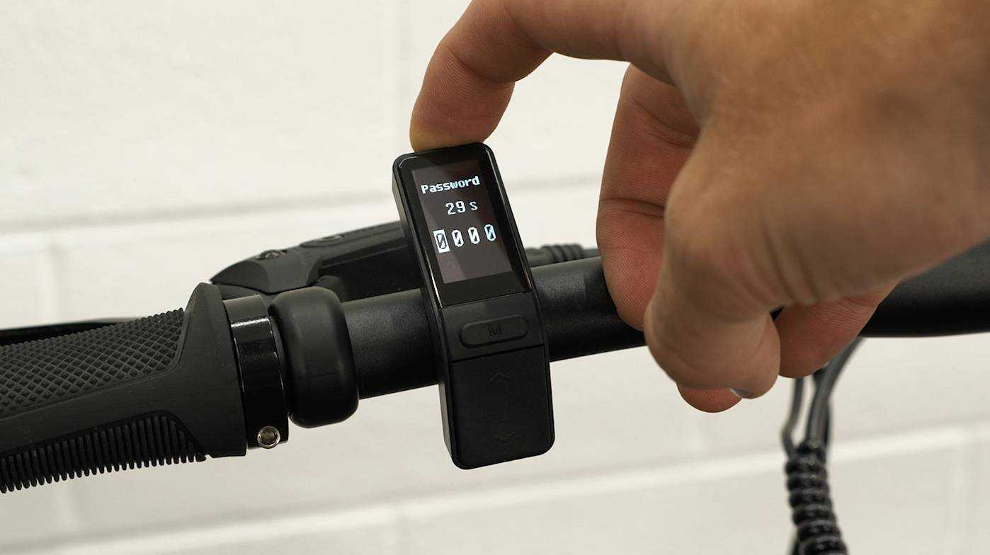

By default the display asks for a four-digit PIN at power-on before the bike can be used. The PIN can be changed or switched off in the settings menu.
Switching on: the display asks for the PIN.
✓ Four-digit PIN at power-on✓ Key lock on the battery

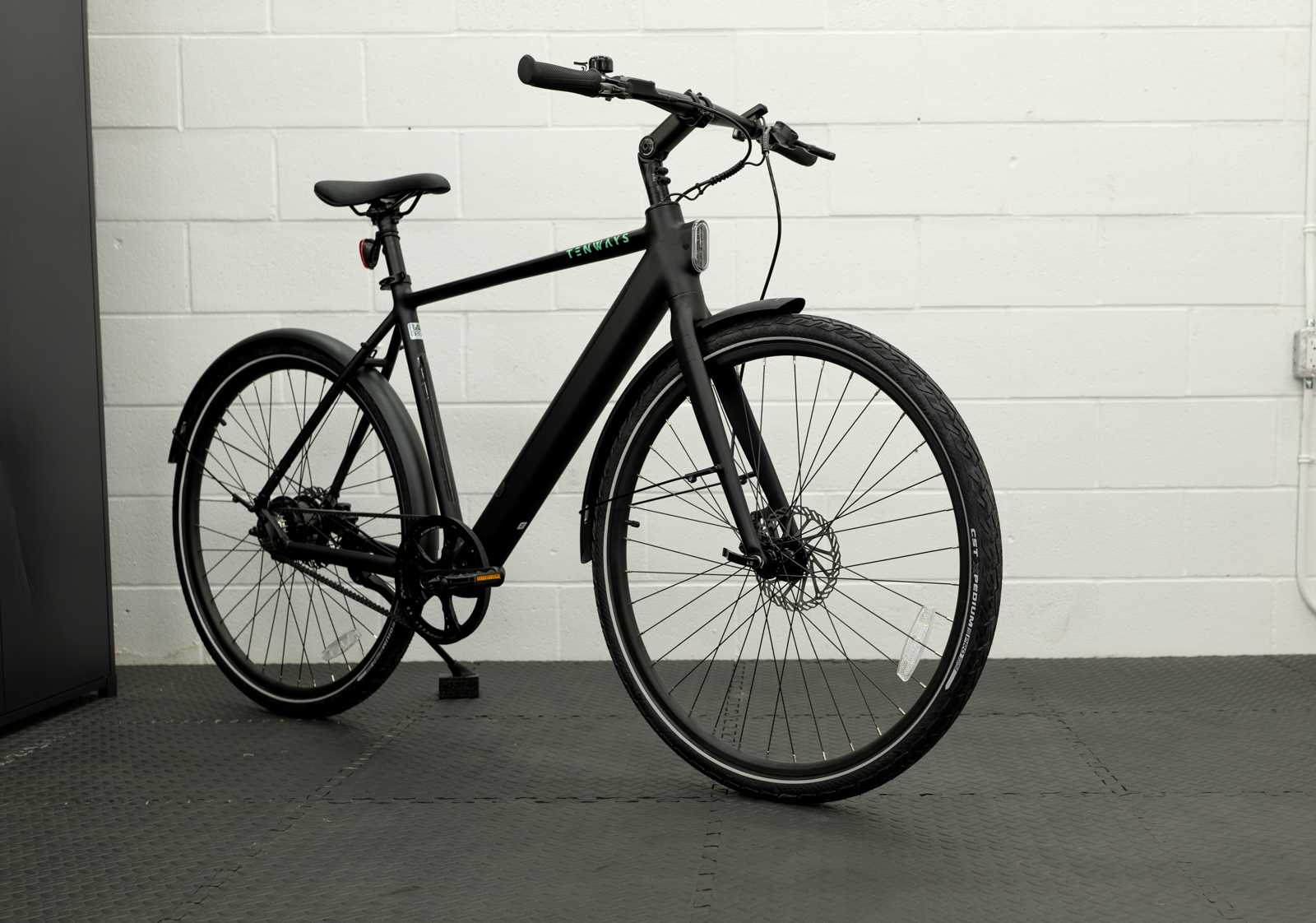

We weighed everything we measured against the price at the time of publication. The CGO600 Pro is light and efficient, quick on gentle hills, and needs very little maintenance. Against that, it took the longest in its comparison group to stop and rides harshly on rough pavement.

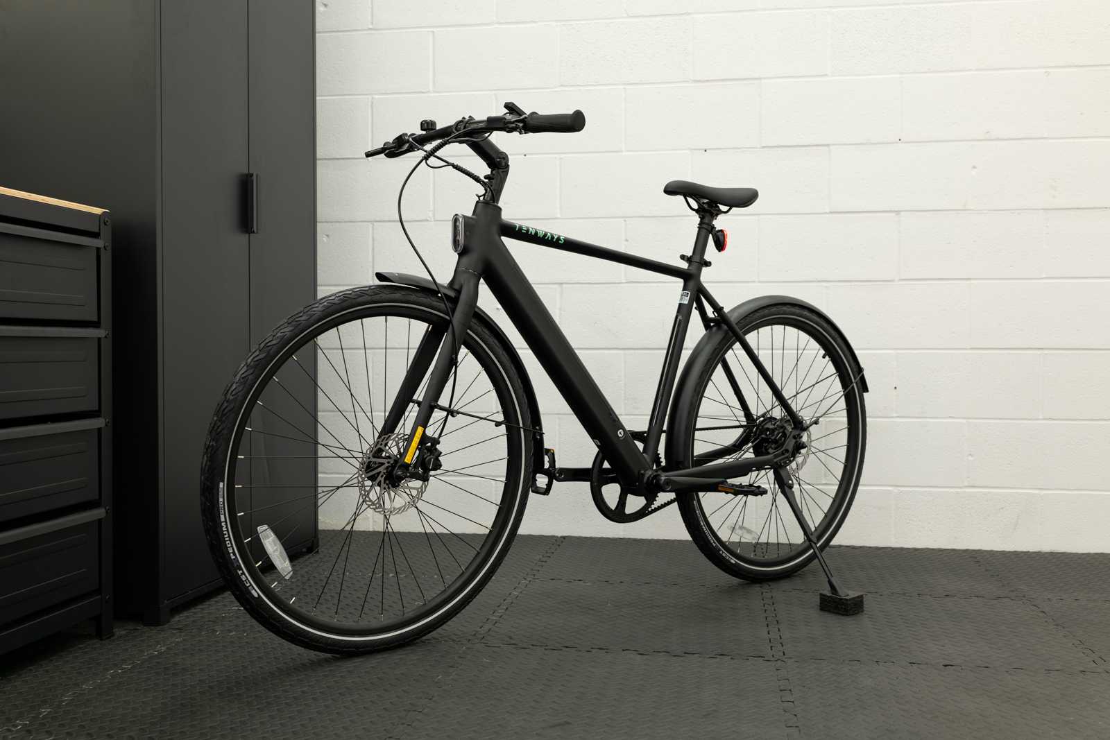

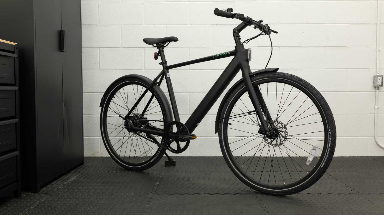

The TENWAYS CGO600 Pro from the front three-quarter, drive side, in the BikeRide studio
The CGO600 Pro in Midnight Black.
Value verdict4/5Good overall value.

0–20 mph, max pedal assistvs. 29 other rear-hub e-bikes, 500W or less8.0 s9.3 s8.4 s
Gradual hill climb, 20 mph capvs. 26 other rear-hub e-bikes, 500W or less3:063:293:18
Steep hill climbvs. 28 other rear-hub e-bikes, 500W or less2:402:572:36

Range (max assist, PAS 3)vs. 8 other hybrid e-bikes27.98 mi28.7 mi29.6 mi
Range (medium assist, PAS 2)vs. 5 other hybrid e-bikes32.36 mi37.4 mi39.5 mi
Range vs claimedvs. 8 other hybrid e-bikes61%57%54%

Brake test, 20–0 mphvs. 8 other hybrid e-bikes26.0 ft20.9 ft19.3 ft
