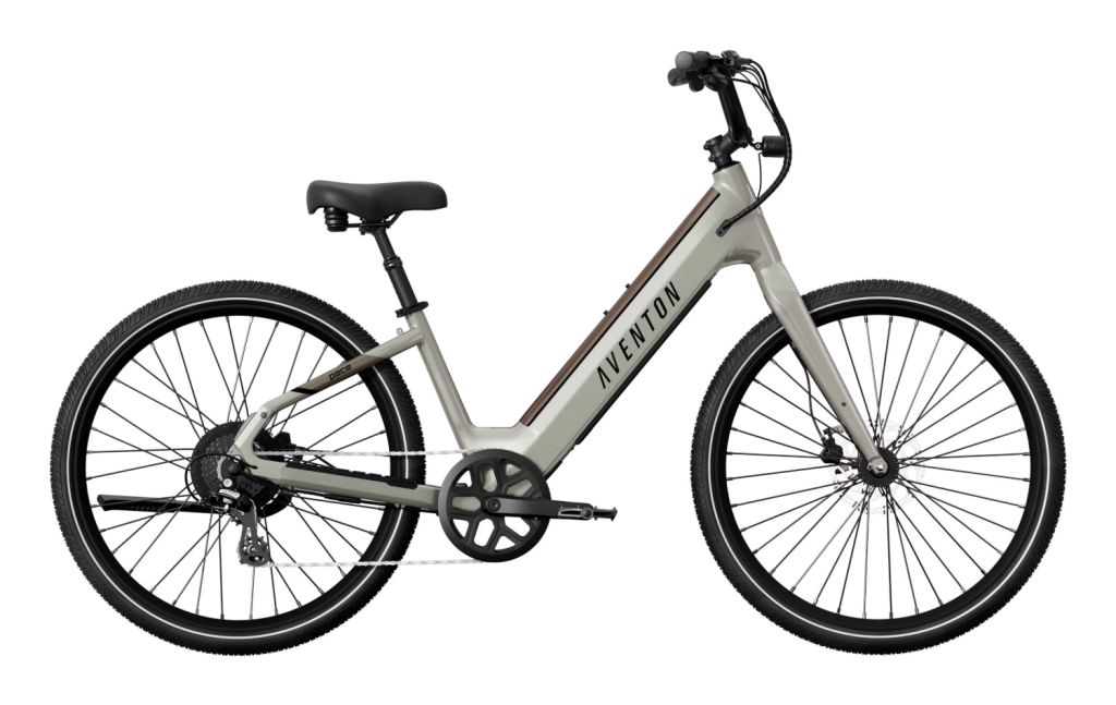

The Aventon Pace 4 is a step-through e-bike with a 500W motor and 715.7Wh battery. It comes in two sizes and earns praise for its mostly smooth ride, well-tuned power delivery, "outstanding" range, and effective brakes. The small display, harsh front end, and lack of included accessories disappoint some, but the customizability and security features enhance the owner experience, and overall, experts feel the Pace 4's offers excellent value.

The Pace 4 has a rigid aluminum step-thru frame available in three colors and two sizes: regular and large. The regular should fit riders from 4’11” to 5’7”, and the large 5’ 7” to 6’1”. The large size weighs 58.2lb and both can carry 300lb.
The Pace 4’s clean lines and high-quality finish give it a more refined look than many of the other beefy e-bikes flooding the market.
The bike ships as Class 2, with the option to unlock Class 3. It has a light-duty 36V electrical system that includes a 500W, 60Nm rear hub motor and a 20Ah (733Wh) battery. Aventon has standardized this battery across its latest models, so chargers and batteries can be swapped between the Pace 4, Aventure 3, and Level 3.
The Pace 4 can reach 20mph using the thumb throttle. The three PAS levels are modulated by switchable torque and cadence sensors, and the pedal assist top speed can be set at 20mph or 28mph.
The integrated display and five-button control pad sit on the left side of the handlebars. The display is unobtrusive but bright and easy to see.
The Pace 4 is packed with tech features, and the controls are clearly explained in the user manual. In the display, clear item descriptions and on-screen prompts make the settings menus easy to use.
The Pace 4 is certified to meet the UL 2849 standard, and the battery is certified for UL 2271. The bike has an IPX5 rating for water resistance, and its components are rated IPX6. These ratings provide peace of mind for riding in the rain.
The Pace 4’s wheelset includes 27.5” aluminum rims with nutted axles and 2.1” tires with a smooth city tread.
The 8-speed drivetrain comprises a 48t chainring and 12-32t cassette, a Shimano trigger shifter, and an Altus derailleur. The brakes are Tektro hydraulic discs with motor cut-off and 180mm rotors.
The Pace 4 comes with a 720mm BMX-style handlebar with lock-on ergonomic grips. The Aventon comfort saddle sits on a 50mm suspension seatpost, providing some cushion.
For accessories, Aventon only includes front and rear lights and a kickstand. The taillights are built into the seatstays, and they include turn signals and brake activation. Fenders, racks, bags, a phone holder, a lock, and spare batteries can be added, but cost extra.
