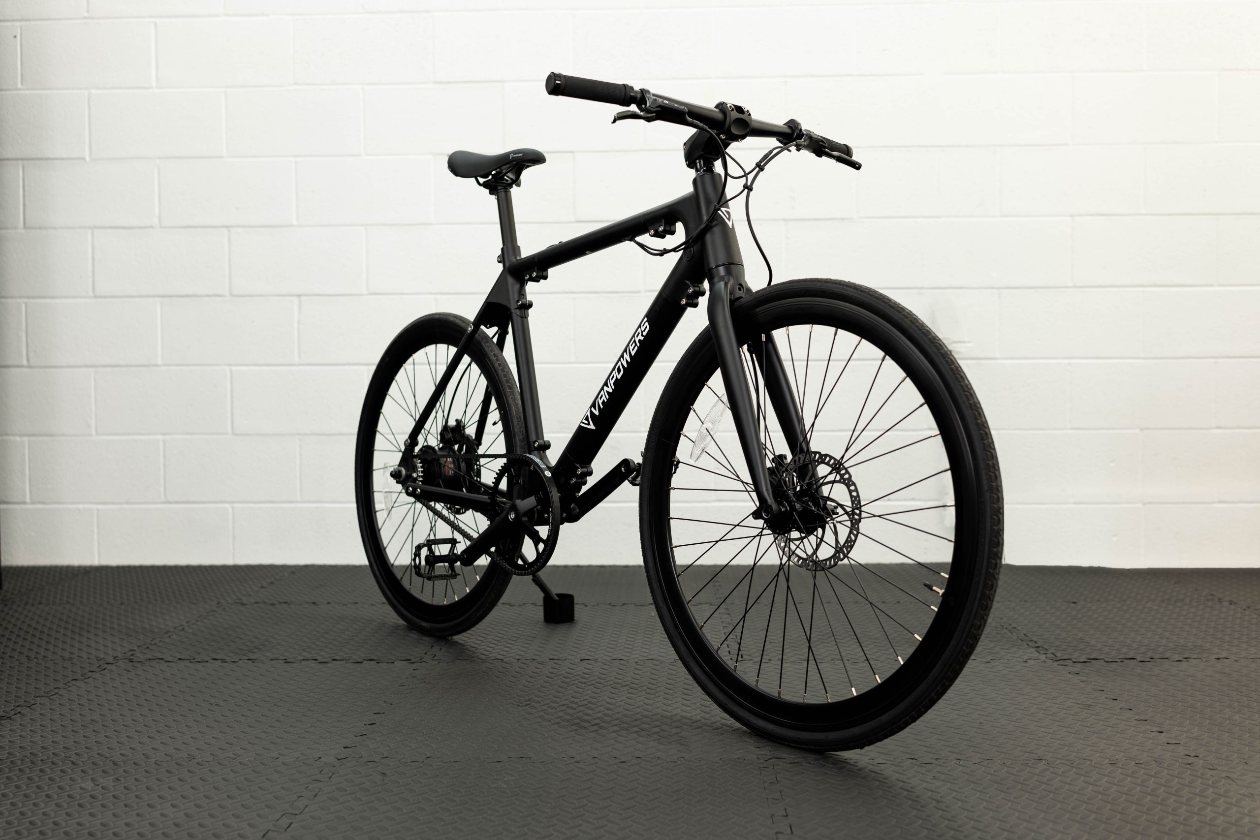

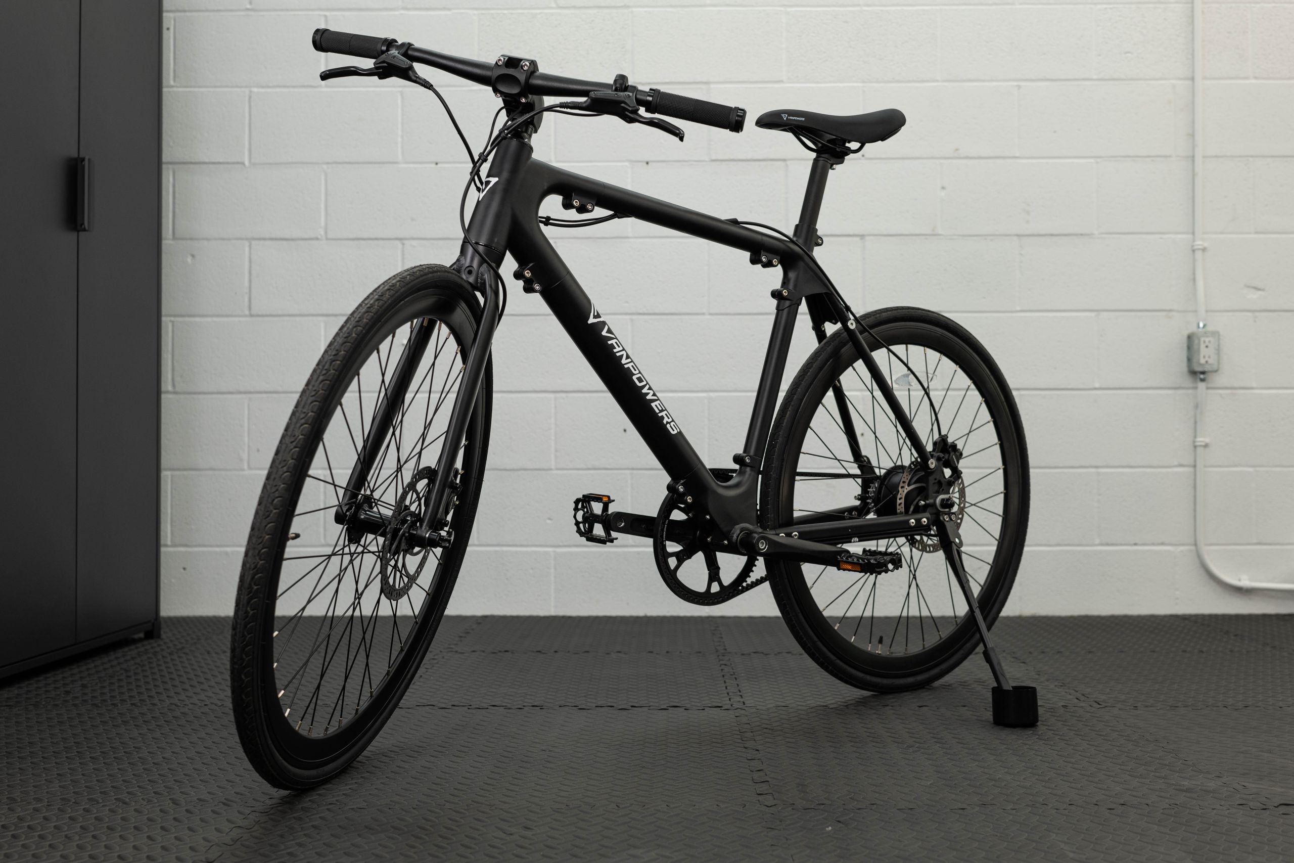

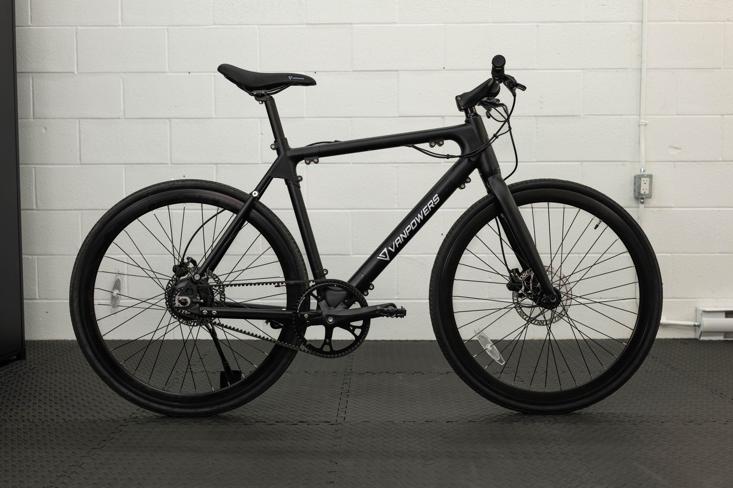

What Is the Vanpowers City Vanture?
At first glimpse, the City Vanture’s sleek profile doesn’t reveal the hidden electronics that power it. A small battery pack integrated into the downtube and a tidy 350W rear hub motor hardly give it away.
The bike is also lightweight at 40lb, thanks to its slim aluminum frame, similar to modern entry-level road bikes. It also has 700c wheels, high-pressure 28mm tires, agile handling, and hydraulic disc brakes, so it’s fast and maneuverable with the stopping power to slow down quickly in urban traffic.
The City Vanture also has a Gates Carbon CDX belt drive, which vastly reduces maintenance and has a much longer lifespan than traditional drivetrains. We’ve seen similar models from other brands, and the City Vanture is competitively priced in comparison.
Now, let’s discuss the pros and cons and see how it stacks up against the competition.
Lightweight and Maneuverable
The first things I noticed about the City Vanture were its slim footprint and low weight. In a world of monster e-bikes, it’s refreshing to ride a model that offers similar qualities to a traditional bike, just with extra power.
It’s pretty light at 40lb, with a low-profile frame and slim tires on 700c road rims. These attributes make it feel like a standard bike, one you can lift onto a rack or carry up stairs.
When you start riding, the same lightweight attributes deliver an excellent ride quality on pavement and hardpacked gravel, quickly accelerating, with the ability to dip and weave around obstacles or through traffic; the City Vanture is fast and fun to ride.

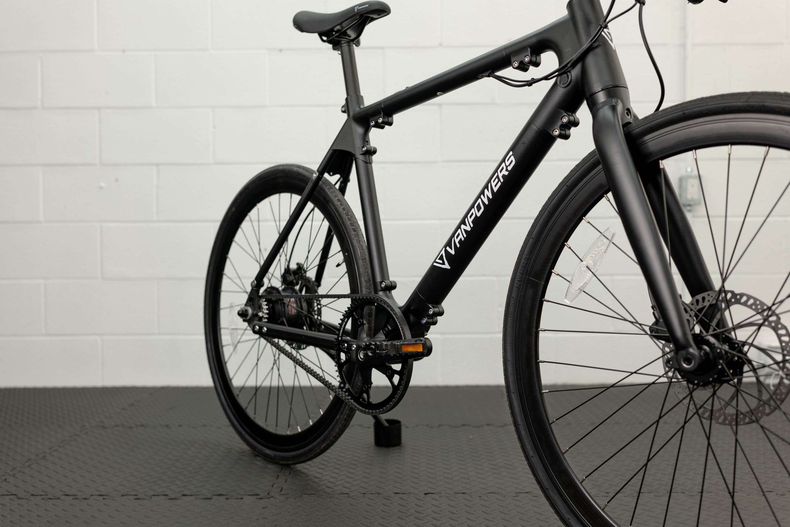

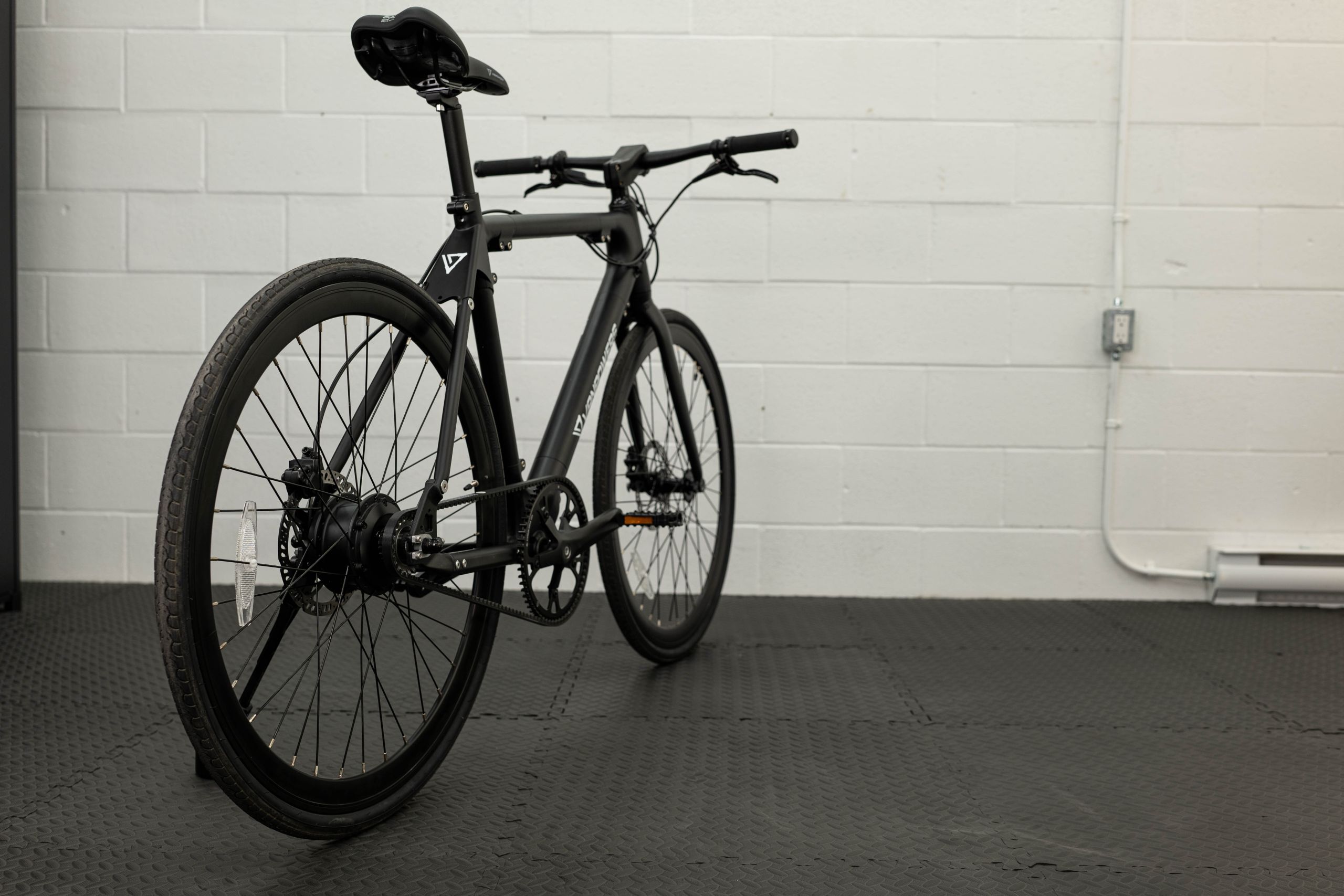

Stylish and Discreet
The City Vanture’s minimalist design looks good and draws admiring glances on the road. I love the hidden battery, which gives the bike a sleek and discreet appearance. This stealthy, non-electric bike look may help keep it safe from thieves.
Overall, I was impressed with the aesthetic of the bike and how the touchpoints blend well with the image and operate seamlessly. I also appreciate the option to add a second battery disguised as a water bottle. Again, stylish and discreet.

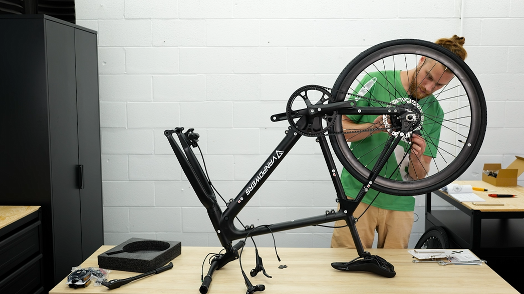

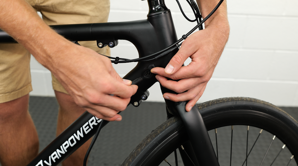

Unboxing and Assembly
The City Vanture can be sent to you in a flat-pack box, requiring complete assembly, or, for $50, you can receive it mostly assembled. We received the disassembled version and took on the challenge. Be sure to check out the full video to follow along.
The bike is labeled well and stored in a box with protective material. It comes with complete instructions and the tools needed for the job. I completed the assembly in about an hour. Assembly required simple Allen keys and wrenches and is relatively straightforward despite having over 25 steps.
The assembly would be easy for anyone with experience using tools or working on bikes. Whether or not it’s worth the $50 is up to you. By assembling the bike, you learn how it is built, and if you ever have a problem, you will likely know how to fix it.

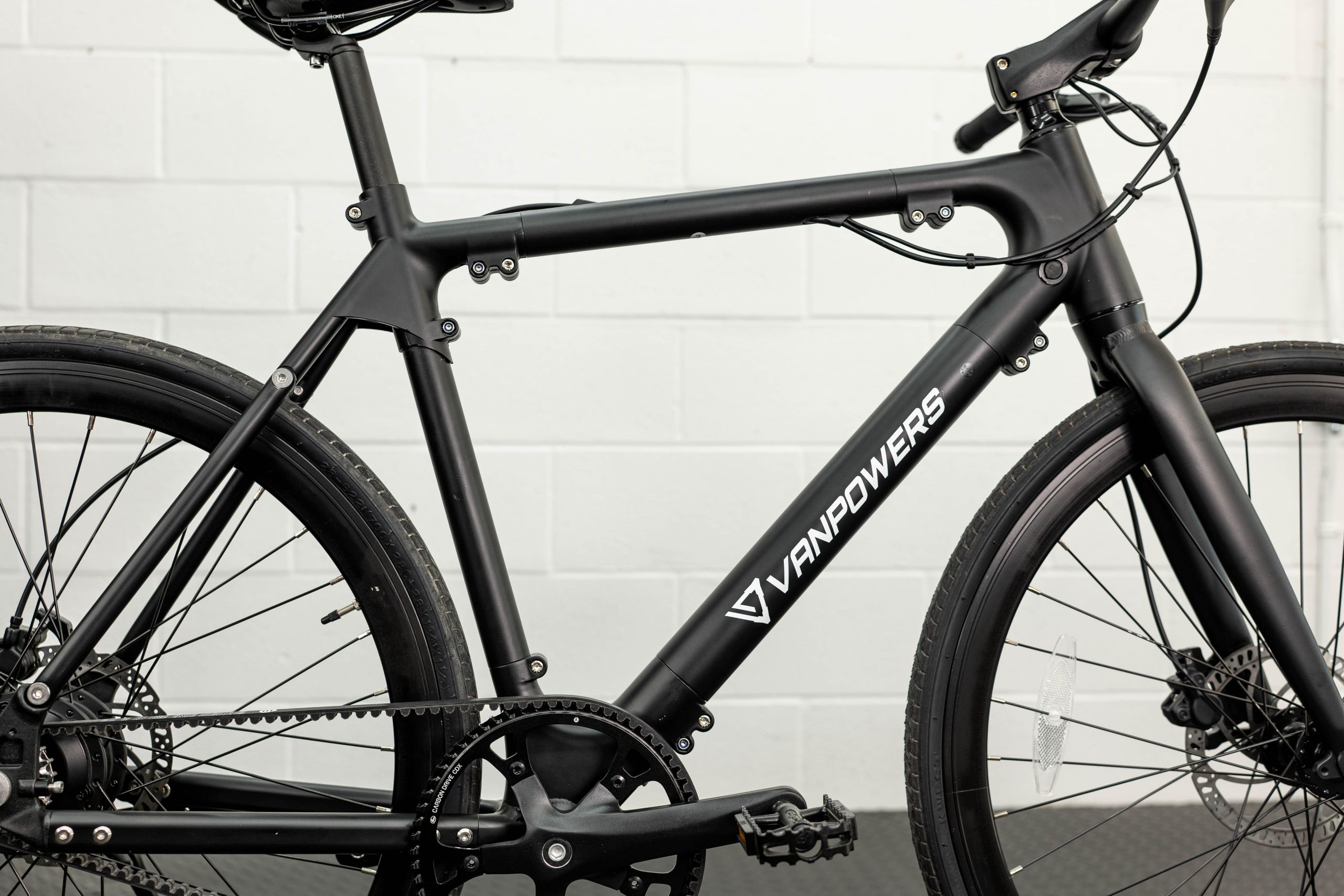

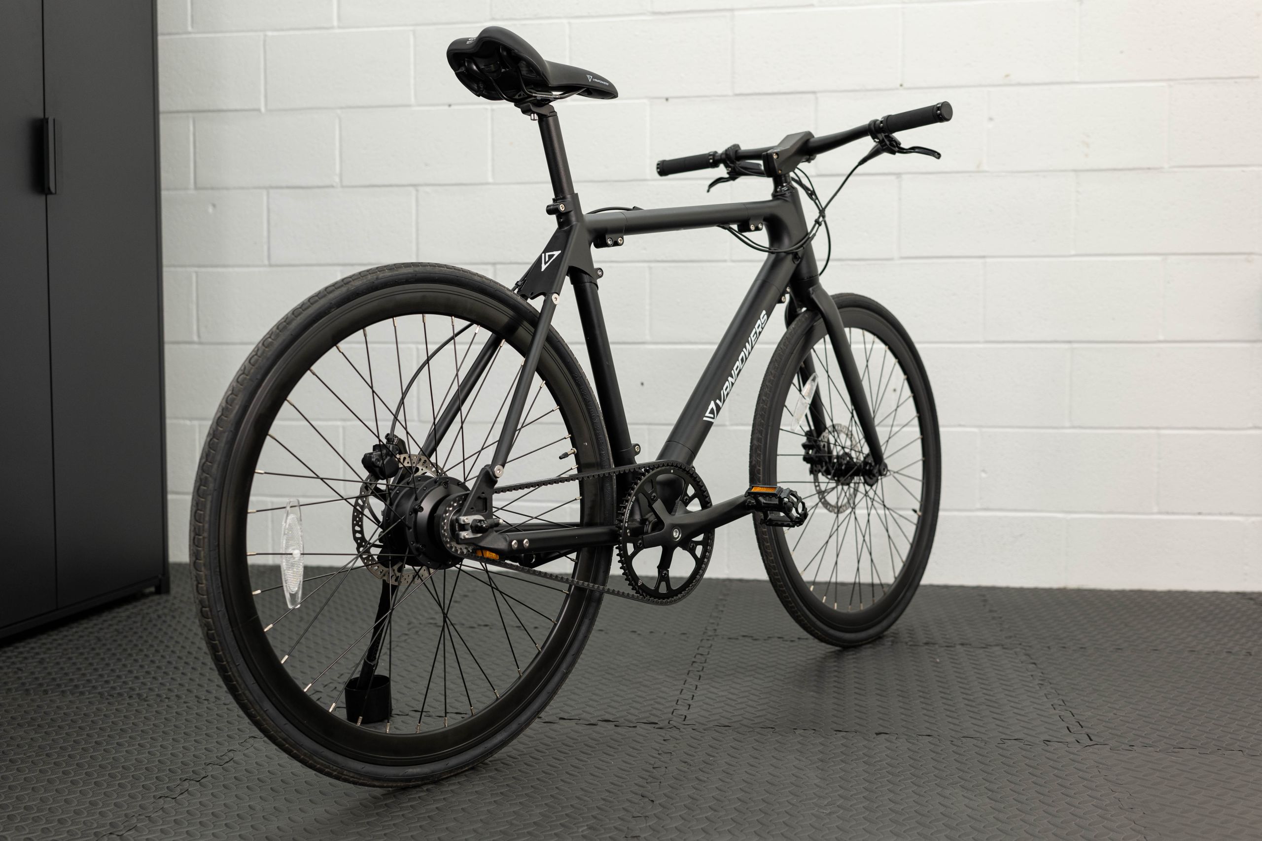

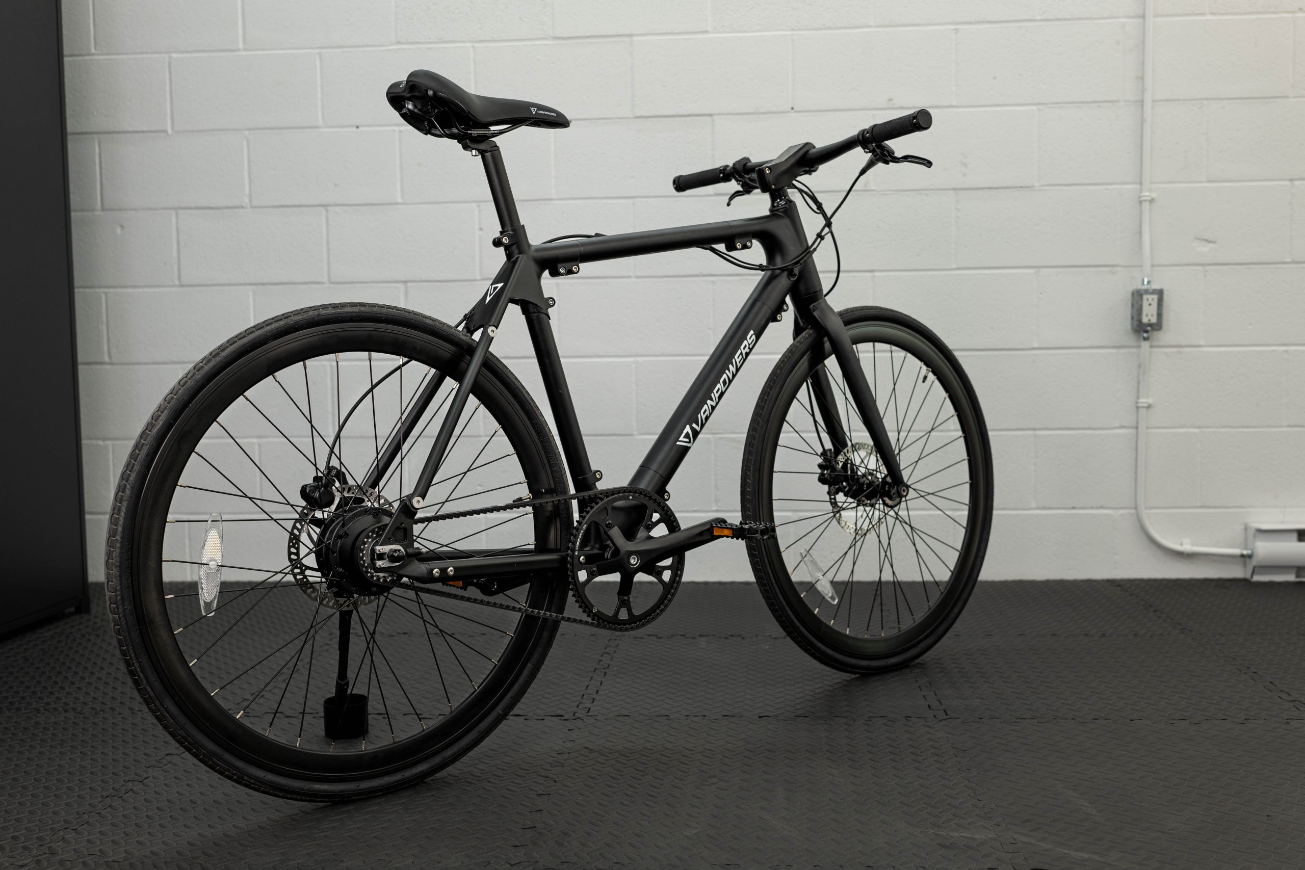

Frame and Geometry
The City Vanture frame uses mortise and tenon joints for its construction. Vanpowers claims this reduces the number of frames that are rejected in the construction process and offers superior durability. It also means they can deliver the bike in a smaller package for you to assemble at home.
The assembly would be straightforward for those with advanced knowledge about bikes. When assembled, it’s solid and feels as secure as a traditional welded frame.
While testing the bike, I didn’t encounter any issues with the construction style or its ability to withstand the abuse of riding. The bike is light and performs well in its intended environment, so the design gets a thumbs up.

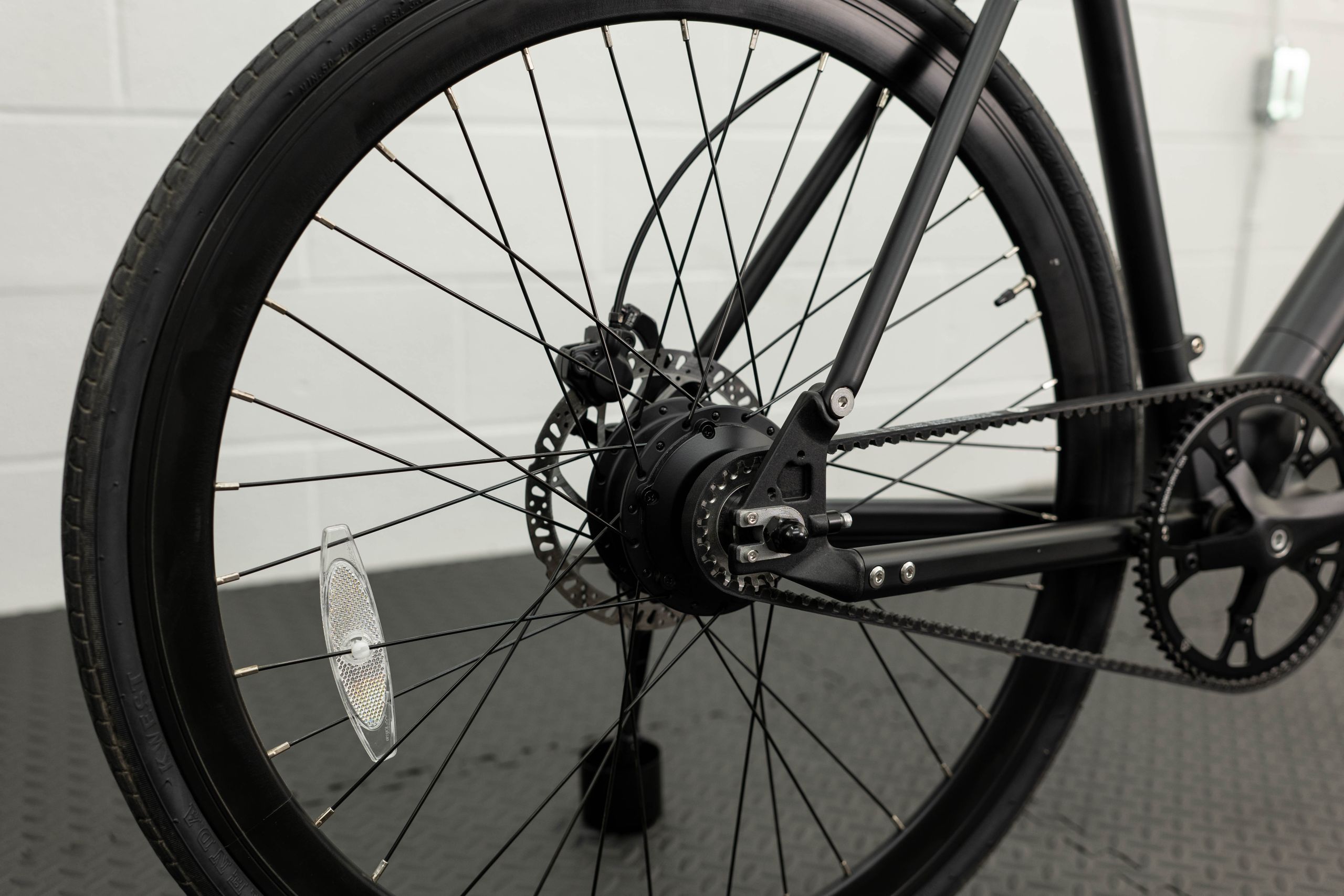

Motor

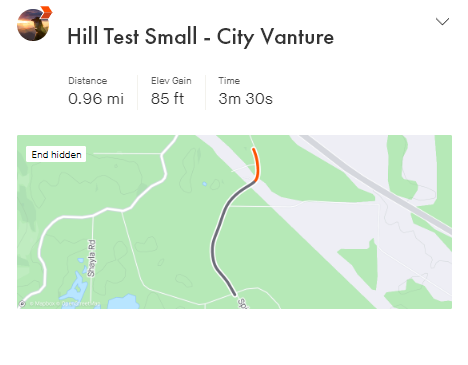

The 350W rear hub motor lacks the power and torque to climb hills efficiently, given the inclusion of a single-speed drivetrain.
The tuning means the beginning of your rides will be peppy, but the City Vanture disappoints over distances as the motor quickly loses the initial kick as the battery voltage drops. On flat ground and mellow hills, it operates just fine, but when you hit a serious incline, you will quickly discover the bike’s limits.
Short Hill Climb Details
Short Hill Climb:
  • Time: 03:30
  • Distance: 0.96 mi
  • Elevation Gain: 85 ft.
  • Max grade: 6%
  • Avg. Speed:  16.6mph

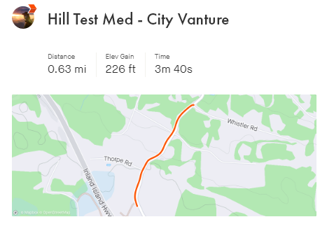

Med Hill Climb Details
Medium Hill Climb:
  • Time: 03:40
  • Distance: 0.63mi
  • Elevation Gain:  226 ft.
  • Max grade: 16%
  • Avg Speed:  10.4mph

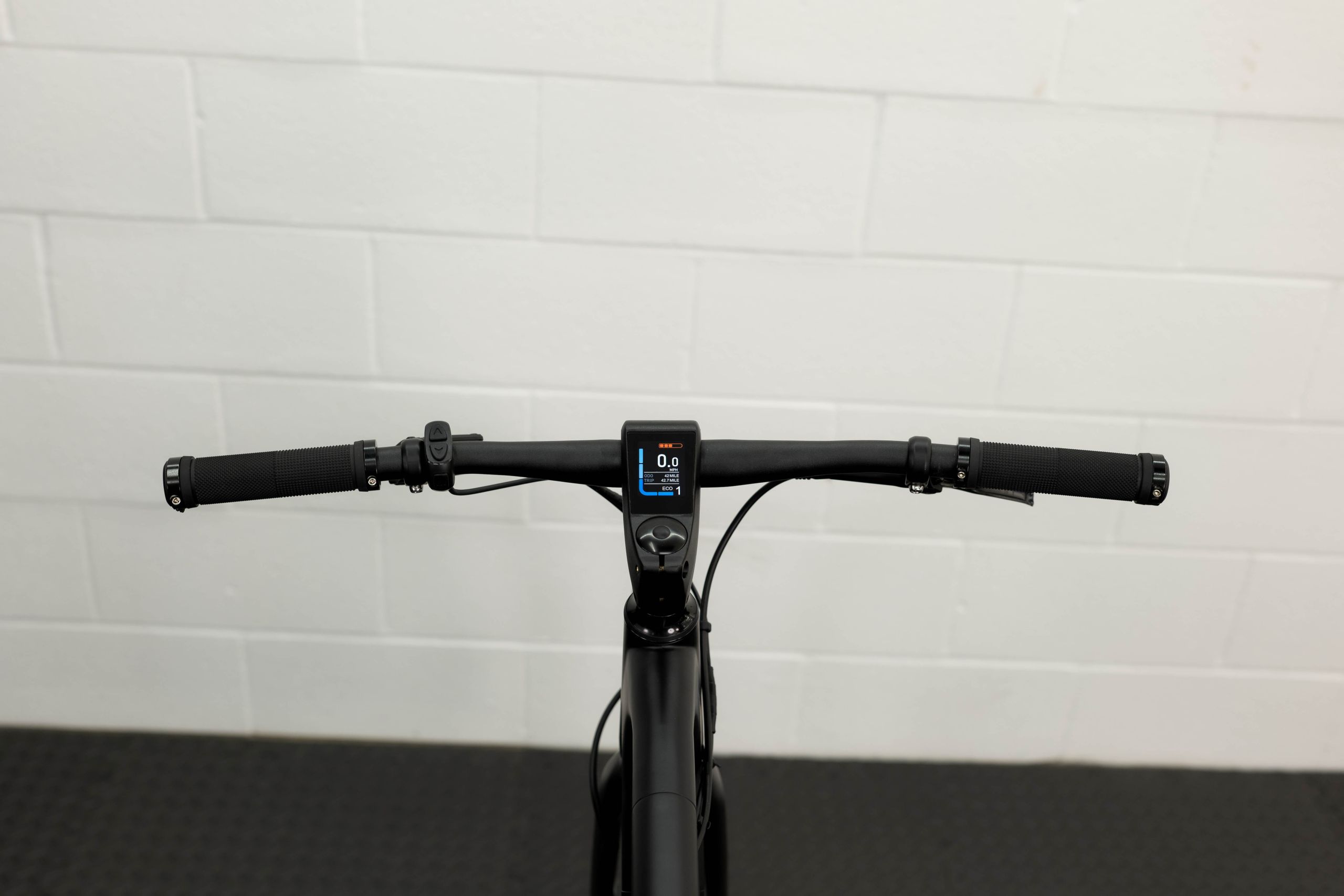

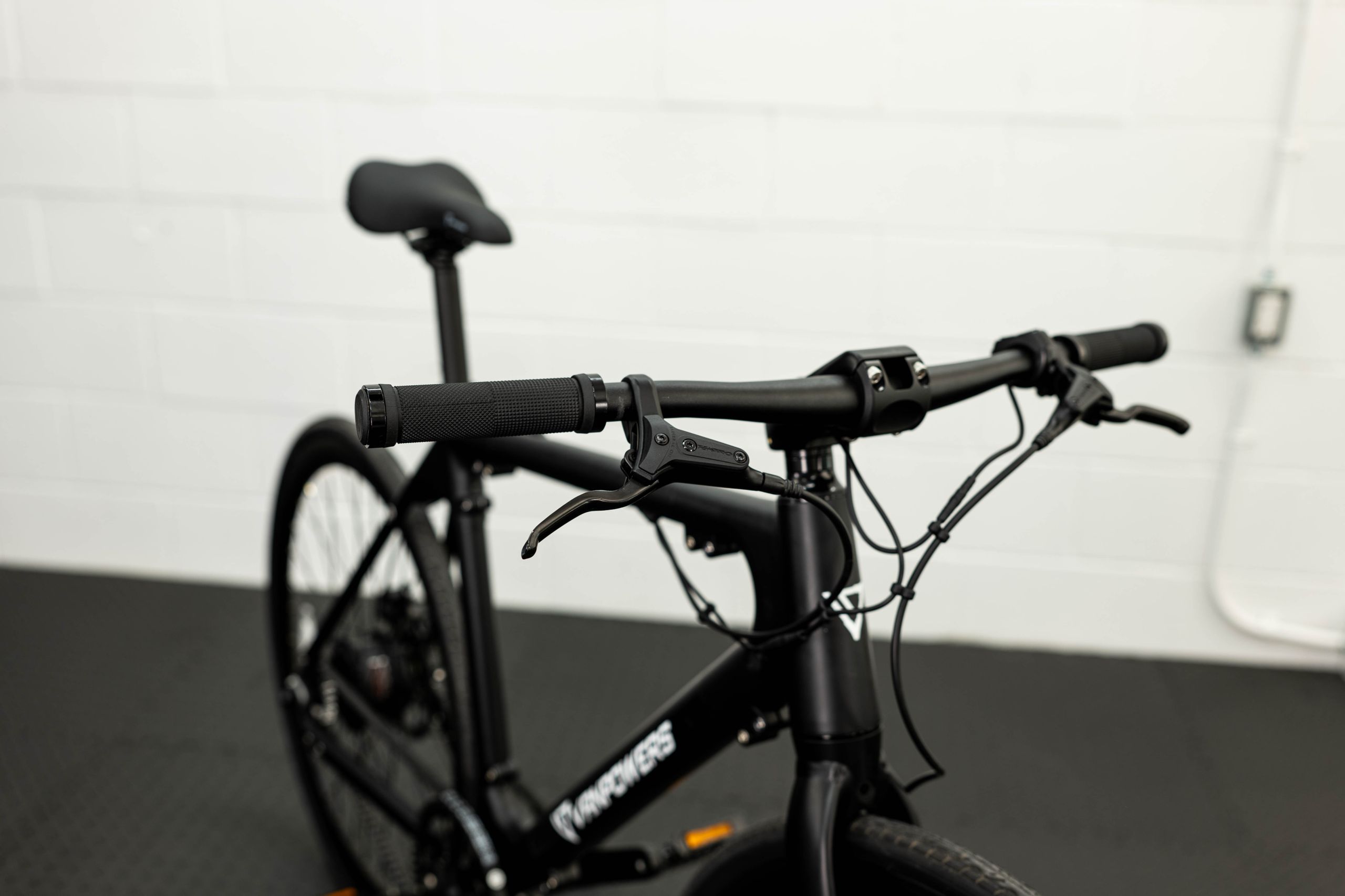

Cockpit and Controls

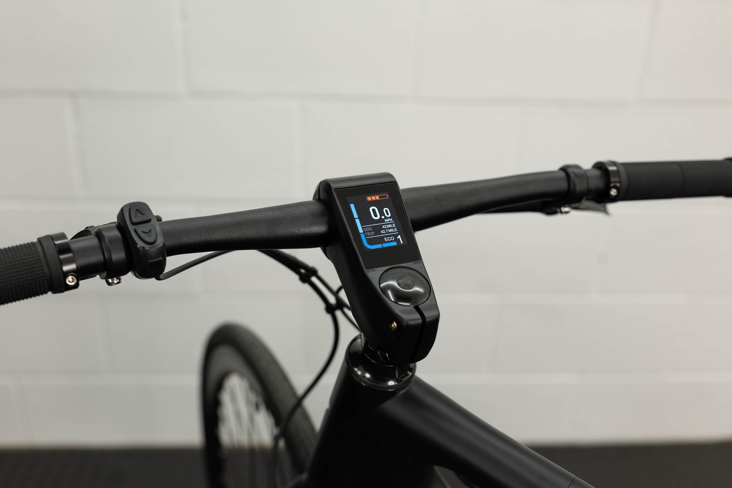

Minimalist is the word that arises when looking at the cockpit of the City Vanture. The brake levers, straight lock-on grips, and three-button control pad are simple and functional.
The color display is also minimalist. It’s small yet readable and integrated into the stem. It has an odometer, trip info, and current assist level, with a simple five-bar battery in the top corner. You can cycle through three trip information screens with the ‘M’ button and move through assist levels with the up and down buttons. The bike also has some advanced settings.

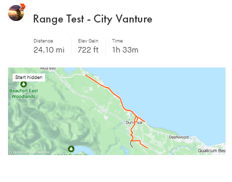

The City Vanture has a relatively small 7Ah (252Wh) battery with LG cells. This battery is concealed in the downtube and installed on the bike semi-permanently. Removal would require disassembling the entire bike, which is time-consuming.
Vanpowers claims the bike can travel up to 50 miles on a single charge. Our range test showed slightly less than half that (24 miles) on max assist for 24 miles. Given the bike only travels approximately 18mph with the assist set to level five, I don’t foresee many owners willingly riding the bike in the low assist levels (1 or 2) to stretch out that range to the claimed 50 miles.
I also experienced range anxiety due to the battery level indicator. Overall, the battery was underpowered, and unless you intend to add the optional second battery, this bike is dedicated to commutes of around 20 to 25 miles round trip.
Range Test Image
Range Test:
  • Distance: 24.10 mi
  • Time:  1:33
  • Elevation: 722  ft.
The charger has a 2A output, which fills the battery from empty in around three hours. The short charge time is due to the small battery size rather than a rapid charger.

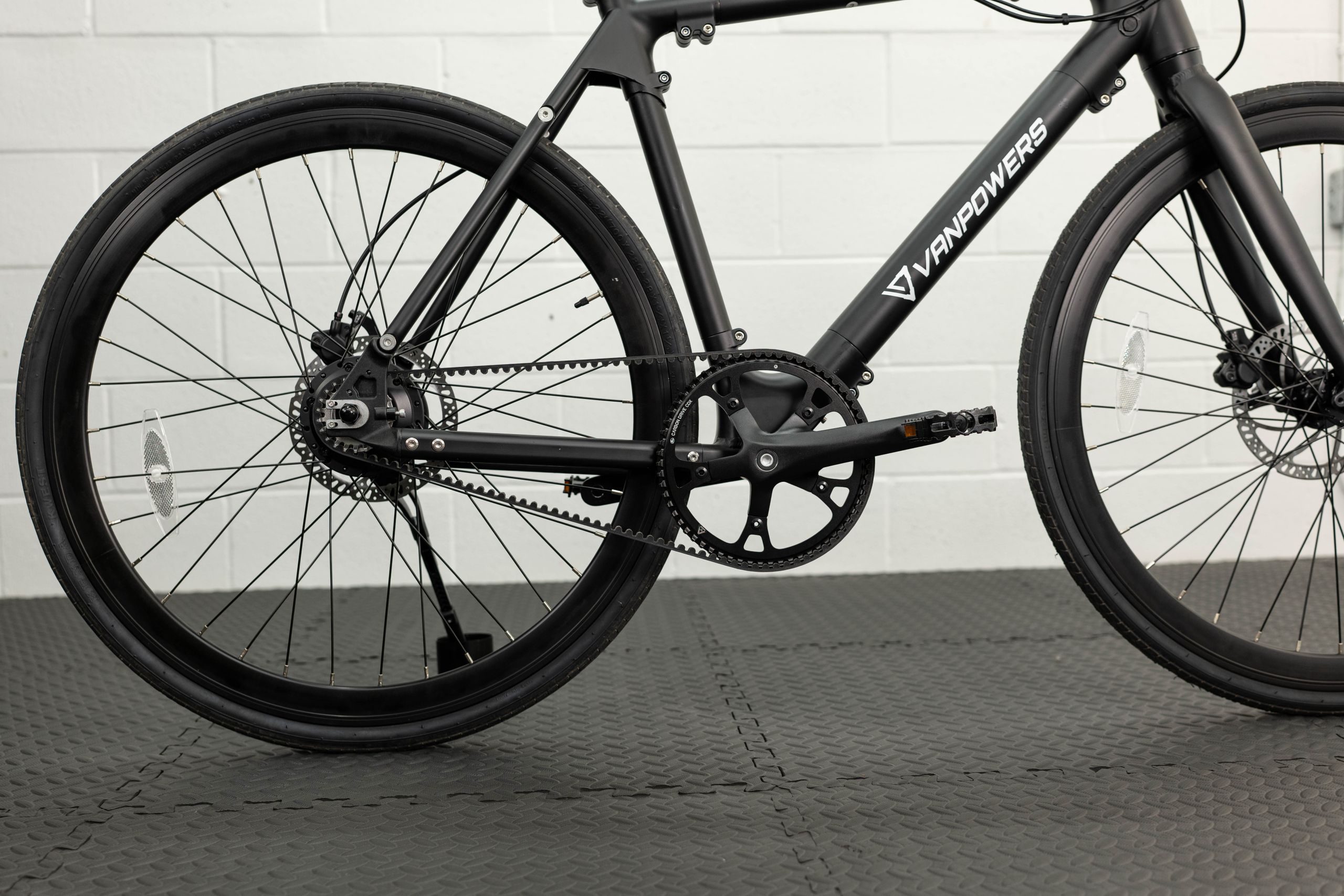

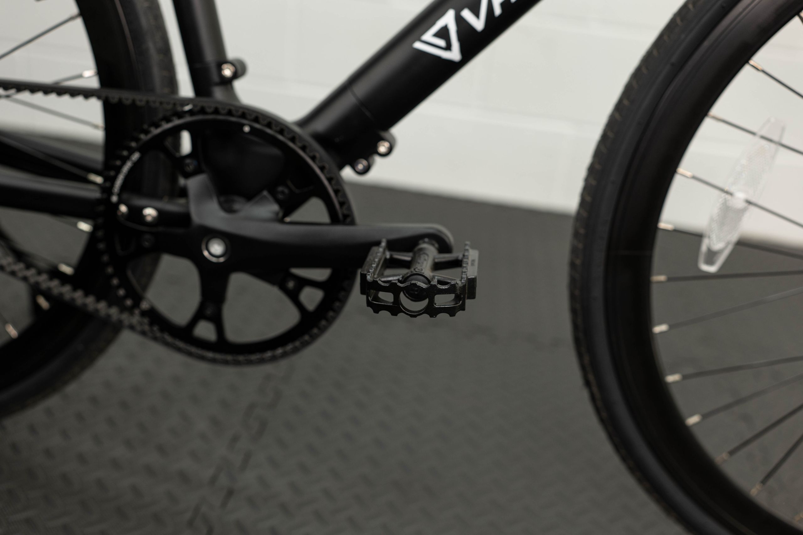

Drivetrain
The key benefits of a belt drive system like the Gates Carbon belt drivetrain used here are reduced maintenance, no noise, and no grease.
The drivetrain is a single-speed, with a geared rear hub motor and cadence sensor. The City Vanture operates well within the speed limit of 20mph on flat ground. It’s also quick to accelerate and pleasant underfoot.

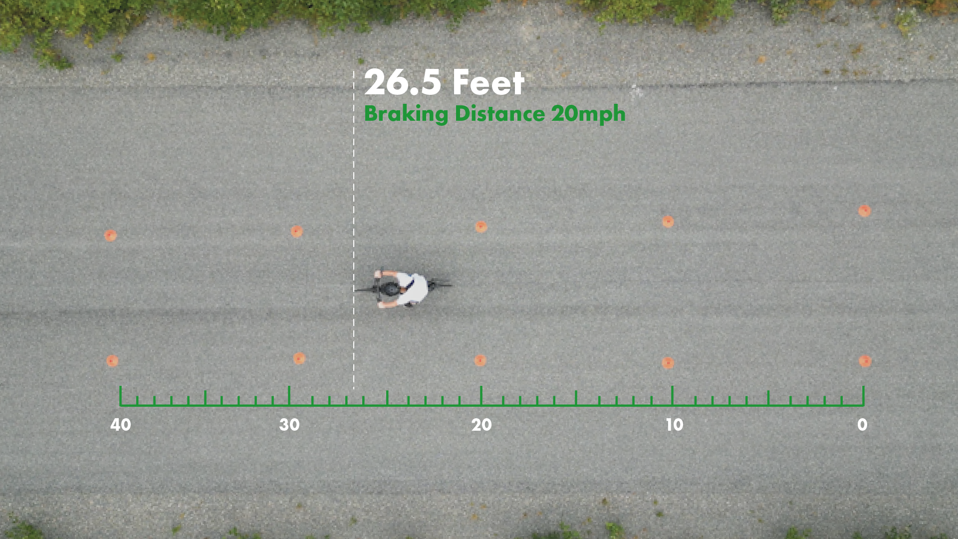

The Tektro M-285 hydraulic disc brakes equipped on the bike are reliable. The bike stops quickly with the help of 180mm rotors, which is important for urban roads where conditions change rapidly.
The bike was slower to stop in our braking tests, but this probably has more to do with the reduced tire footprint than the heavy fat tire bikes we usually test.
Overall, the brakes on our test unit worked well and complimented the bike’s performance.
Braking Distance Results

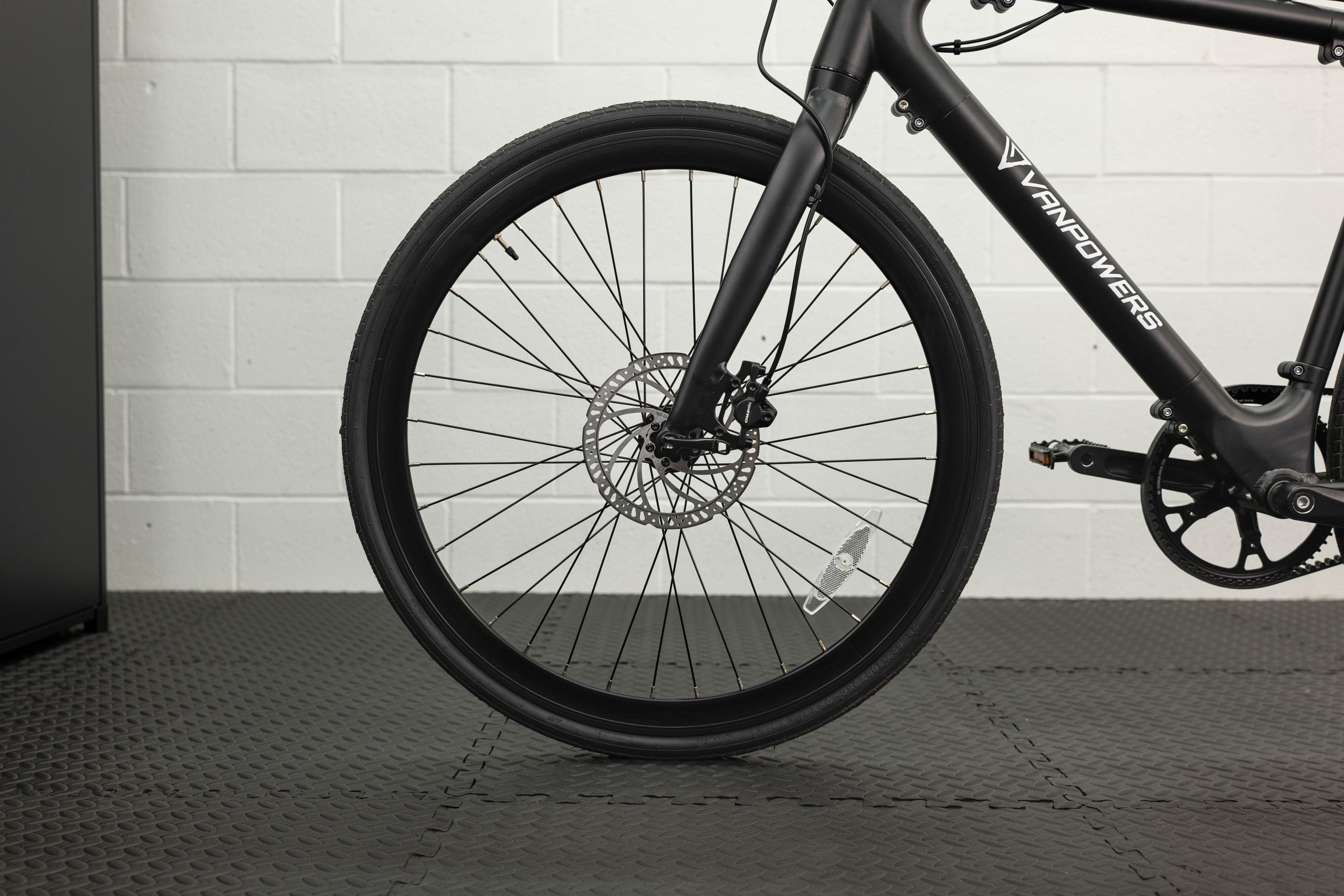

WheelSet
Wheels and Tires
The City Vanture features 700c aluminum alloy rims and 28mm Kenda tires. This setup will be familiar to anyone accustomed to road bikes.
Narrow, high-pressure tires like these are pleasant to ride on pavement and hard-packed gravel and capable of high speeds. However, maintaining traction is more difficult than with the wide, plus-size tires we often see on e-bikes.
The benefits of speed and maneuverability are easy to feel immediately and more than enough to compensate for the few restrictions. The bike and its wheels are intended for pavement, and I can see them struggling to maintain traction in wet conditions, but we did not have the chance to test that out.

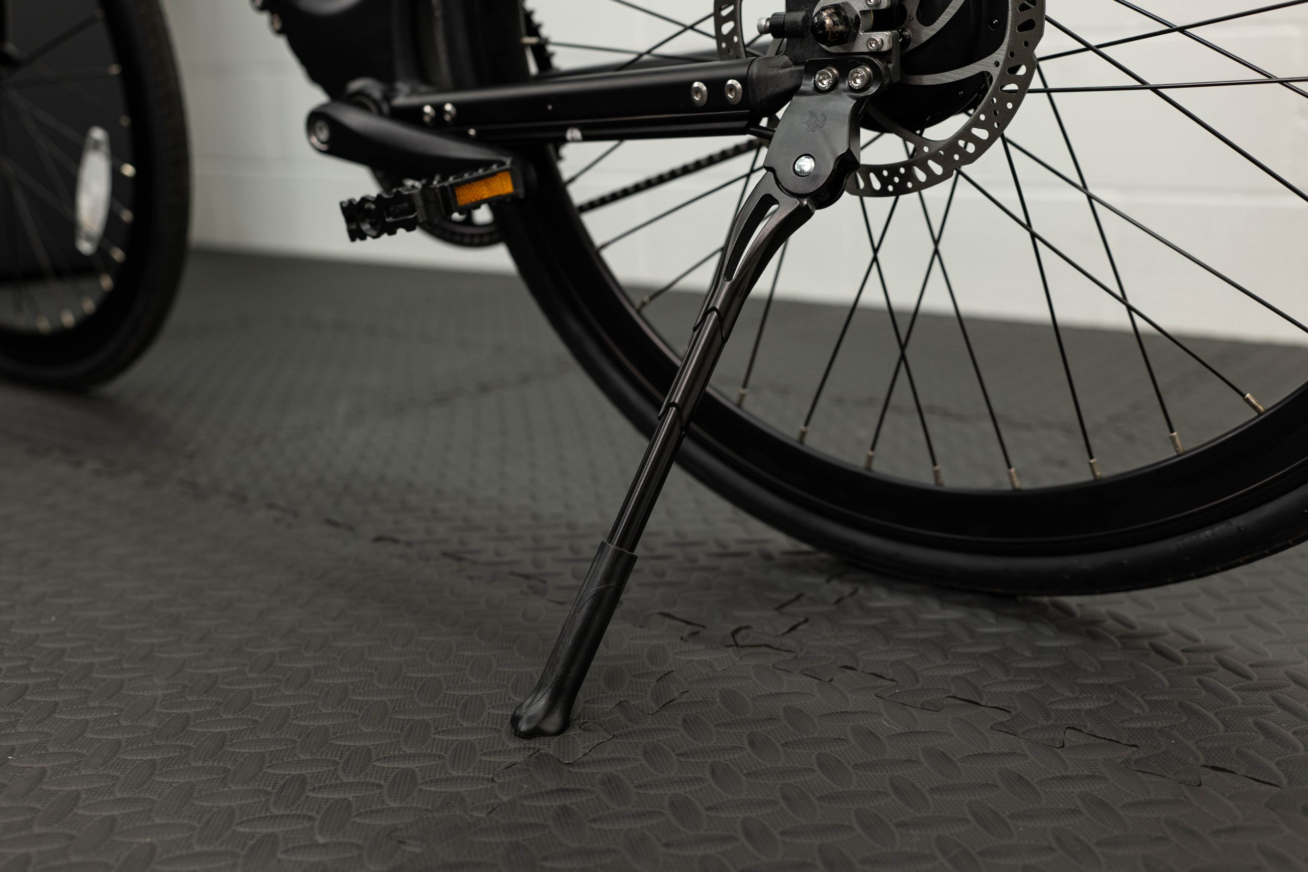

Kickstand
Kickstand
The bike features the standard single-sided kickstand, which operates without issue.

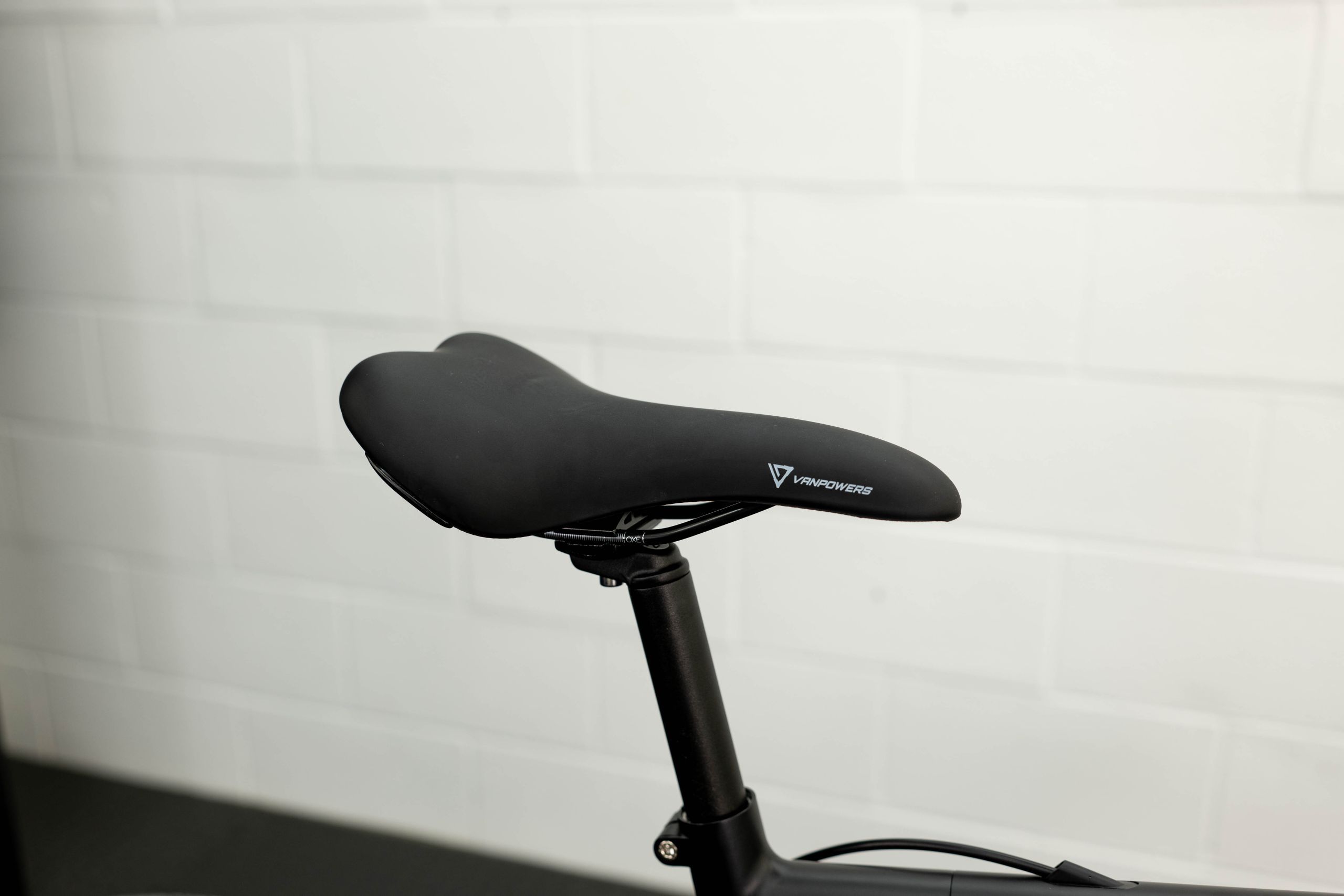

Seat
Saddle
Our black City Vanture came with the matching black Selle Royal saddle. It is a simple and comfortable seat for short to mid-length trips. It gave no trouble or discomfort on our range test and is a good match for the bike.
Pedals
Pedals
The City Vanture ships with a simple set of Wellgo platform pedals. They offer reasonable traction but less than pedals with pegs. Again, these pedals are a budget item that could be swapped for more traction.
