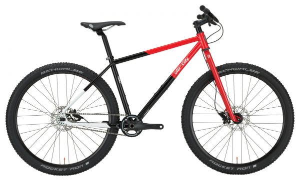

It would be remiss to overlook the dedicated following that single-speed mountain biking has enjoyed. This type of riding can be highly demanding, especially in mountainous areas.

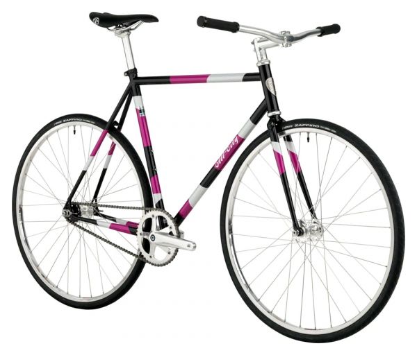

A majority of new single-speeds are urban bikes that are built with geometry similar to road bikes or touring bikes. Tubing is often a little heavier, sturdier and thicker than on road bikes. This is to cut down on price, but also to assist with resilience on day-to-day commutes in urban areas.
‘Track Fork Ends’ are usually integrated into single-speed frames, where the rear wheel attaches to the rear triangle of your bike. This is the main structural difference between most single-speed and geared frames. These ‘rear-facing fork ends’ allow single-speed owners to easily adjust the tension of their chain, by moving the rear wheel forward and backward. On a geared bike, the rear derailleur continually adjusts tension across shifting gear ratios. Geared bikes use a vertical ‘dropout’.
Horizontal fork-ends are used on most single-speed frames Vertical dropout on a geared bike

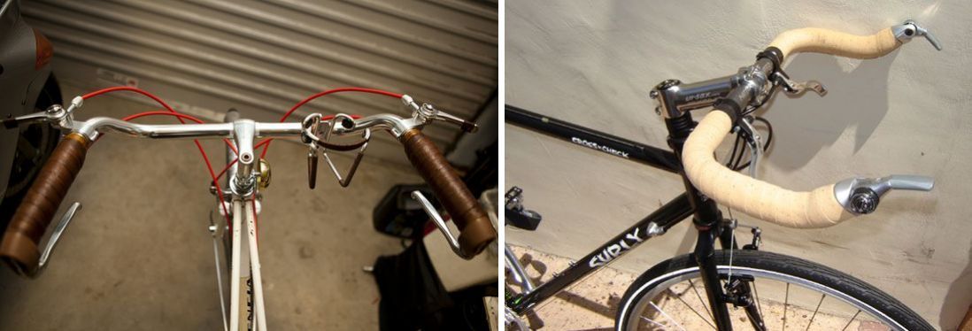

Single-speed bikes can use any type of handlebars. Most often, they have flat bars to allow the rider to maintain an upright stance. These bars have two main benefits:
  • Comfort. Riders avoid the ‘hunched’ posture of the road cyclist.
  • Visibility. Riders sit upright, maintaining visibility through traffic.
Shorter bars can help with negotiating traffic. It’s advised to keep them no narrower than shoulder width, to maintain ergonomic comfort.
Flat bars for visibility Drop bars for speed

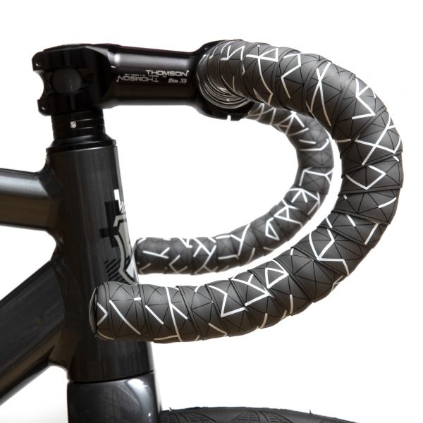

Some riders prefer drop bars. This reduces upright visibility but aids speed. Track frames are built to be ridden with drop bars, on a velodrome.
A variety of ‘swept-back’ and angled bars are available. These can be easier on the wrists or offer a more casual ride position. North Road bars are a popular urban style that uses sweep.
North-road bars are ergonomic and ‘upright’ Bull-horns aid climbs and sprints
Another style that you’ll see on single-speeds are bull-horns. These offer a flat surface for upright urban riding, along with curved ends. These curved ends allow riders to move their weight forward on climbs and to gain speed in a pursuit stance.

Disc Brakes
Disc brakes slow the bike by squeezing pads onto a disc, which is attached to the wheel hub. Discs cost more than rim brakes, but are now more affordable than they have ever been. They are more powerful than rim brakes, especially in wet weather. They allow for the use of wide tires and don’t wear down your rims. Many single-speeders are attracted to simplicity, frugality and a low total weight. For this reason, discs are less common on urban single-speed bikes.
The power offered by disc brakes is more applicable to off-road use. It isn’t uncommon to see them used on single-speed mountain bikes.
Disc brakes add weight to your bike. They are also more complicated than rim brakes; as pertains to maintenance, adjustment and repair.
There are two types of disc brake: hydraulic and mechanical. Hydraulic brakes provide greater stopping power and use brake fluid to transmit force. They are more costly than mechanical discs and trickier to maintain.
If you live in a drier climate, you might consider cutting costs and using rim brakes. But if your priorities are performance and all-weather resilience, discs could be your preferred option.

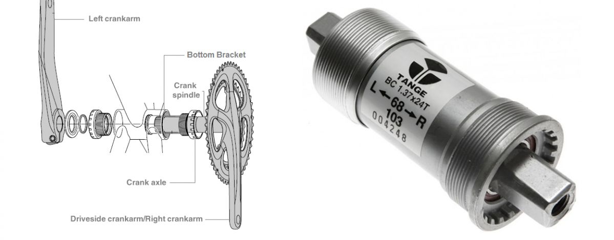

Bottom Brackets
The bottom bracket sits between your cranks and is attached to the frame. It allows the cranks to rotate. The modern standard is a sealed cartridge bottom bracket with BSA thread. 68mm is the standard on road-going bikes and will be the easiest to upgrade and replace. Very low-end bikes may still use loose-bearing bottom-bracket systems. If the manufacturer does not specify a sealed cartridge bottom-bracket, be wary. The bottom-bracket takes the brunt of a cyclist’s force.
Where a bottom bracket fits into your bike – and what it looks like
A 73mm bottom bracket is more common on a mountain bike. For mountain bikes, they may use a variety of types, including press-fit bottom-brackets and models with external bearings. These are usually more varied, specialized and higher-cost than basic urban models.

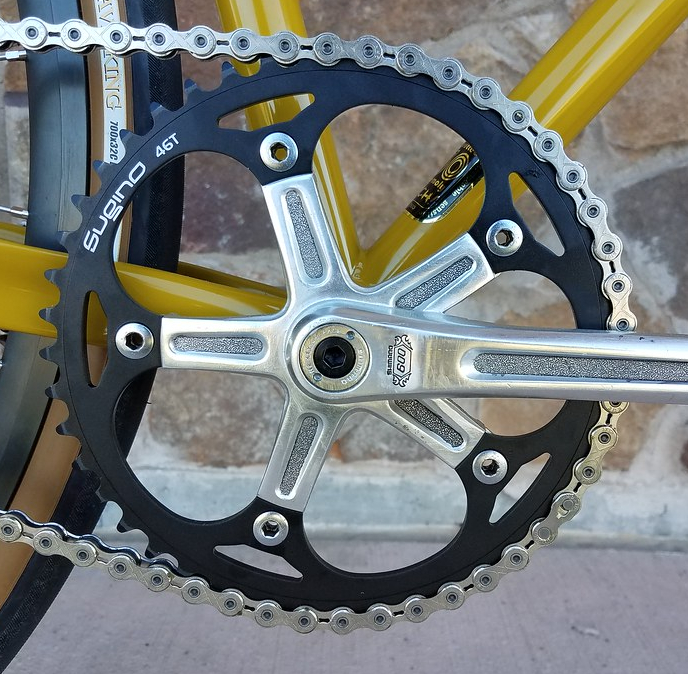

A 46-tooth chainring in place
Chainring
Your single chainring is the only sprocket being continually worked, day-in and day-out, whenever you ride. Traditionally, single-speeds used a 1/8” width chainring that was wider and tougher than the 3/32” chainrings used on geared bikes. These days, 3/32″ can be more than ample. Look for reliable brands. These include Shimano, FSA, Sugino and Miche. You don’t need the best on a new bike, as you can replace it. But it should be straight and strong, to be safe.

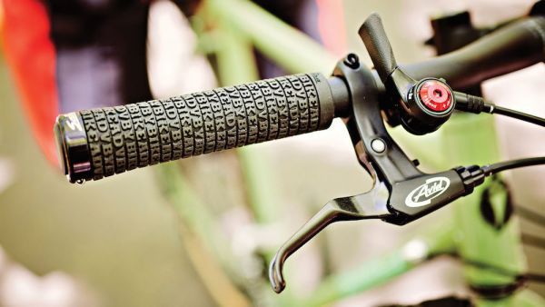

Good Grips contribute a lot to comfort. Thin or uncomfortable grips can result in soreness or fatigue. Cheap grips can be made of poor material that wears out quickly. Some riders are partial to ergonomically shaped grips. Again, it’s easier to know what works for you by getting your hands on some examples at your local bike shop.

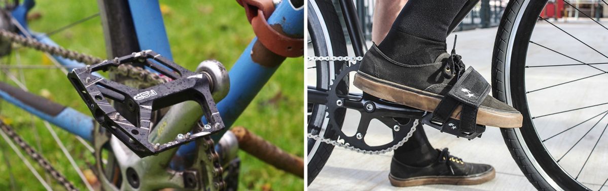

Pedals
If you’re lucky, your new bike will arrive kit with decent pedals. Most likely though, pedals will be the first thing you’ll replace. Even high-end bikes can come with cheap plastic pedals intended for temporary use. Some of the best single-speed bikes are not supplied with pedals at all. Why is this? Pedal preference is very personal and manufacturers expect you to customize them.
Also, what’s the deal with cycling shoes? Are they necessary?
Flat (or ‘platform’) pedals can be made of plastic or metal and usually have some level of grip. You can easily move your feet from the pedals to the ground and back again, without having to ‘clip’ in and out. With flats, you can wear your everyday shoes and there’s no need to carry or store a spare pair at your destination. The main drawback is that they are less efficient than other pedals, particularly on climbs.
Flat pedals are stable Pedal Straps use your existing flat pedals
Pedal Straps attach to your flat pedals. They are an alternative to clipless pedals and cycling shoes. Pedal straps became popularized during the spike in interest in fixed gear cycling, where they’re useful for skid-stops. For single-speed riders, they offer lift on the upstroke, while being comfortable and easy to wear with casual shoes.
‘Clipless’ Pedals require cycling shoes to use. There is a ‘cleat’ on the sole of cycling shoes, that requires riders to ‘click’ in and out of pedals when removing their foot from them.
There are different systems of clipless pedal, with the most common being Shimano’s ‘SPD’. ‘Time’ pedals are also highly suited to commuting as they allow the rider to quickly click their shoe out to the side of the pedal.
‘Time’ clipless pedal Shimano ‘SPD’ clipless pedal and shoe
Clipless pedals increase efficiency, especially on climbs, as they pull the pedals on the upstroke. This is particularly useful on a bike with only one gear. Some cyclists see clipless pedals as daunting, but it takes a very short amount of time to become familiar with them. Once you’re accustomed to clipless, using them soon becomes second nature. You can even buy cycling shoes with recessed cleats. You can walk comfortably in them, without ‘clip-clopping’ along.
Toe Clips let you wear your own shoes
Toe Clips are the precursor to clipless. They feature a ‘cage’ over the pedal that allows you to insert any shoe and achieve a similar upstroke pull to clipless pedals. They aren’t quite as efficient as clipless and can be more difficult to use. They need to be snug, but riders also need to slide their shoe backward out of the pedal cage before stopping. A number of cyclists are still dedicated to these pedals.

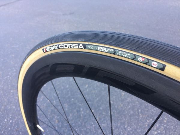

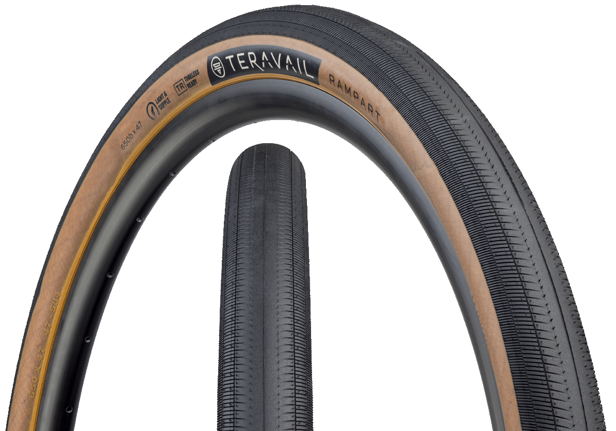

Single-speed tire sizes on 700c wheels can vary a lot.They’ll usually sit between 23c and 35c, for an urban bike. These sizes are designated as ‘23c’ and ‘35c’. Anything over 35c can get heavy. Less than 28c is intended primarily for speed and will be firmer, less forgiving and more susceptible to punctures. On 650b tires, sizes between 42c and 47c are popular on city bikes, as they give a similar circumference to a 700 x 28c to 700 x 30c tire.
Sizes are written in the format: ‘700x25c’, where ‘700’ refers to the wheel size (700c) and ‘25c’ describes the tire circumference (in this case, approximately 25mm). You’ll find this sizing written along the side of the tire.
For 700c and 650b, tire sizes are written in millimeters (ie 28c, 35c, 47c). For mountain bike wheel sizes (29”, 27.5”, 26”), they are usually written in inches (1.75”, 1.95”, 2.30”). History has left us with a mess of conflicting sizing standards that can become complicated. There is a more precise, universal reference standard known as E.T.R.T.O., which may either enlighten or confuse you.
Never fear, because we have a breakdown of…
Single-Speed Tire Sizes and Widths
700c
Racier single-speeds will have similar tires to a road bike. The standard is a 23c width.
If you’re a casual city rider, tires 28c and wider will provide more comfort and give you added protection against punctures and curb hits.
Some single-speeders like to rock a combo, with a speedy 23c in the front and a tougher, wider 25 or 28c in the rear.
32c is reasonable as a large size. The upper limit would be about 35c, before tires become heavy and slow. Town bikes and cruisers may have tires as wide as 42c.
Anything narrower than 28c is fast, but more susceptible to punctures and pinch-flats.
29” (29 Inch)
This BMX Cruiser uses slick 29 x 2.5″ tires!
29” is the mountain bike version of 700c. You’ll find these on single-speed mountain bikes and 29” BMX cruisers.
A majority of 29” tires are knobbly mountain bike tires. But slick varieties are also available. 29” wheels will use wider rims than most 700c wheels and wider tires are safer on these rims. These fatter tires will be comfortable and tough, but heavier than narrower 700c options.

If you’re using 27.5” tires, you’re probably referring to a single-speed mountain bike. These rims are the same circumference and diameter as 650b. They are usually wider than most 650b rims and suit a wider minimum tire size than that which can be fit to a 650b rim.
26”
In the single-speed world, 26” tires are mostly seen on single-speed mountain bikes. On roads, they are used by some cruisers and town bikes. 1.5” to 1.9” are some of the narrowest widths available, but these result in a somewhat rigid ride and a slower, smaller diameter wheel. Some 26” rims are not built to handle the high pressures of narrower tires.
The safest tires to use are most likely 1.95” to 2.125” in slicks or semi-slicks.
Anything up to 3.0” can be used on single-speed mountain bikes.

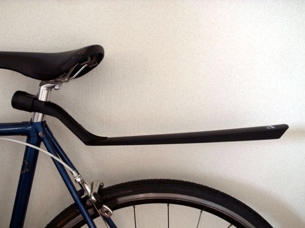

Seatpole-mounted fender
Fenders. A seasonal essential. If you have mount-points on your bike, you can attach rigid fenders and leave them there all winter. Quite a few single-speeds don’t, but you can buy a removable fender that attaches to your seatpost.

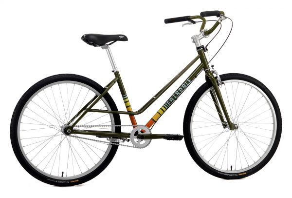

Step-through bikes suit casual dress
Saddle height will be easy to adjust if you purchase a bike with an appropriately-sized frame. If the frame is undersized, you may not be able to raise the seat up high enough because you’ll run out of seatpost. If the seatpost is raised past its ‘maximum insertion level’, it can fatigue, bend or break. If your frame is too big, you won’t be able to lower the seat enough and your standover will be nonexistent, exposing you to potential groin injury. Yowch.
A ‘step-through’ style bike suits riders who prefer to wear dresses, skirts or jeans while riding, or anyone who wants an easier time of swinging a leg over the top tube.

Tires
Tires on these bikes are wider and tougher than on urban single-speeds. 30c to 35c is a decent average size.
Tire Clearance
Clearance is more generous than on urban and race single-speeds. Maximum clearance is around 38c to 45c, allowing you to fit cyclocross and gravel tires for off-road use.

Fixed Gear Bikes – “Fixies”
Track bike Flat-bar on track frame Single or Fixed with a flip-flop hub
Build
Fixed gear bikes can use any frame that is used by a single-speed. Track bike frames are more commonly used by fixed gear riders than by single-speeders in general (see above). Track frames do not feature mount points to attach brakes, as they are built for velodrome use.
Use
Fixed gear bikes can be ridden by many cyclists over shorter distances or in flatter areas. Otherwise, they suit riders who possess an extra level of fitness or are looking to gain it.
Ride Position
Ride positions are similar to those found on singlespeeds.
Weights are comparable to those of singlespeed bikes.
The same frame materials are used for singlespeed and fixed gear bikes.
Wheels
Wheels are almost always 700c. A small number of riders experiment with 650b wheels.
Tires
Tires are similar in size to those used on singlespeeds. As the rear tire is ‘skidded’ to brake, it’s a good idea to have a tough, high quality rear tire. A wider tire can provide a large contact patch for stopping.
Tire Clearance
Tire clearances are similar to those of singlespeeds. True track bike frames are designed to use tires between 19c and 22c, but ‘street track’ frames may allow for rubber up to 25c.
Mounts
‘Fixie’ frames may or may not have mounts or bosses for racks, fenders or bottle cages. Many track frames have none of these mounts.
Drivetrains
Most drivetrains are external, with one chainring and a single cog that is fixed onto the rear hub. This means that the rear wheel keeps moving as long as the pedals rotate. They move in unison, linked by your chain. You can’t coast on a fixed gear bike.
Ratios
Fixed gear ratios tend to be higher than on your average single-speed. Because you will be continuously pedaling on descents, it’s more comfortable at a lower cadence. 2.75:1 is a good starting point.
The maximum number of rim brakes used on a fixed gear is usually one. This is a front brake. The rear fixed cog acts as a brake but this technique takes some effort to master. Some skilled riders (including bike messengers) use only the rear fixed hub to stop. This is illegal in many areas and does not provide instant braking. It’s more of a skid and can be dangerous if a chain were to break. A front brake is encouraged.
Distance
For most people, fixed gear bikes suit short to medium rides and flatter terrain. If you are a stronger cyclist or looking to become one, you might consider a fixed gear bike for longer jaunts. The need to ‘always be pedaling’ can be tiring if your quads aren’t up to snuff.

Town Bikes
A Hi-Tensile, 26″ step-through with rack mounts & U-brakes
Build
‘Town bikes’, ‘City Bikes’ and ‘Dutch Bikes’ are heavy, solid, upright and casual. Classic, sweeping shapes with step-through frames are popular. They have a low standover height and suit wearing dresses, skirts and casual clothing.
Use
These bikes suit short, cruisy commutes.
Ride Position
You sit very upright on these bikes. They often have wide, swept-back bars that leave the arms akimbo.
There’s no getting around it. Town bikes are almost always heavy.
Frames are usually steel (and frequently heavy, jouncy, high-tensile steel at that). Sometimes, aluminum.

Single-Speed Mountain Bikes
A rigid, 27.5″ single-speed MTB
Build
Tough.
Use
They’re made for off-road use.
Ride Position
Varies, but a slack top tube allows a lower saddle height to keep weight toward the rear on descents. Flat handlebars keep you upright.
Heavier than a single-speed road or track bike. However, with high-end and lightweight steel and aluminum tubing, they can be of similar weight to many urban single-speeds. 20 to 28lbs.
High-end Chromoly steels and Aluminum are common.
Wheels
Strong alloy wheels in 29”, 27.5” and 26”.
Tires
Wide tires for off-road use, roughly 1.95” up to 3.0”. Anything wider is difficult to push with one gear.
Tire Clearance
A maximum clearance of at least 2.4”. Clearances may reach 3.0”.
Mounts
Single-speed mountain bikes will probably have bottle cage bosses. They may or may not have mounts and eyelets for fenders and racks.
Drivetrains
Drivetrains usually use a chain and may use either a freewheel or a single-speed conversion kit on a freehub.
Many single-speed mountain bikes are run rigid (no suspension fork), to cut weight and maintain simplicity. Other single-speeders do choose to use a suspension fork. Hyper-niche, full-suspension single-speeds are rare.
Ratios
1.8:1 to 2.0:1 is a common range for new models. (32:16 to 32:18 is common).
Brakes are mostly discs. V-brakes and cantilevers are more common on older bikes.
Distance
Mountain bikes are heavy and suit trail jaunts, but you can ride single-speed all day if your quads are buff.
Cost
These are specialist items. But without incorporating gearing (and often suspension), they can be had for a lot cheaper than a mountain bike of similar quality. Entry-level: $350-$700. Mid-level: $1500-$2000. Belt-drive and full-suspension: $2800 and up.
Strengths
  • Strength and Durability. Tougher than any other single-speed.
  • All-Weather Capability is provided by a stable frame and disc brakes.
  • Comfort. Laid-back geometry and fat tires for that ‘couchy’ ride.
Compromise on…
  • Weight. SS mountain bikes can tire the fittest rider. They’re overkill for cities.
  • Speed. Fat tires are heavy and slow on-roads.
  • Price. Entry-level models are rare. Some specimens are boutique items.
  • Versatility. SS MTBs have a defined niche: ‘less-mountainous mountain-biking’.
