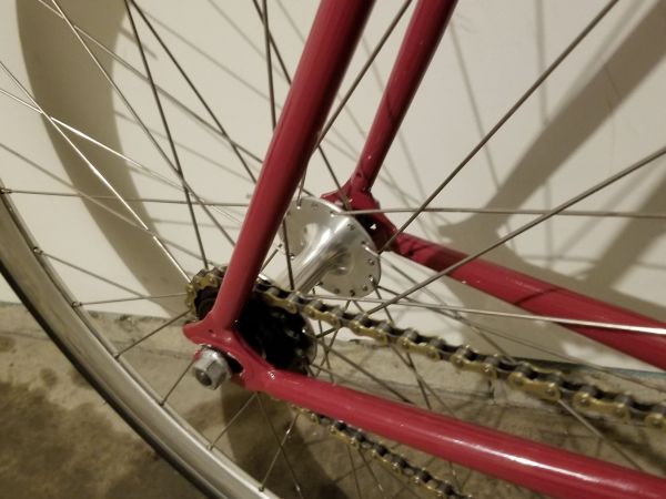

I should disclose that I initially transferred the “stock” wheels from this Retrospec and used them on another, far more expensive bike. It was definitely an upgrade for that bike. The hubs are loose ball, which is good for me, as I enjoy spending quiet time with grease and wrenches.  Believe me, I have those wheels very well-greased and adjusted for a very low rolling resistance.
Freewheel
16 tooth generic that made sounds like popcorn popping and had a dangerous tendency to occasionally not engage while riding in very cold weather. I replaced this freewheel with a new Shimano FS 1200.

Rear triangle could have been better aligned.
Stem too short for frame size.
Freewheel was noisy.
