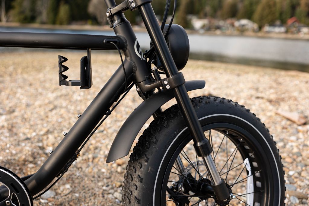

  • An inverted moto-style suspension fork helps iron out bumps on the Rhino.

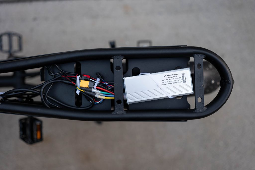

Potential Problem
Here at BikeRide.com we like to ride bikes. It’s our role to put them to the test so you know what you are about to buy. But sometimes, during testing, things don’t go quite how we expected. The Zugo Rhino had an unanticipated issue that we need to address, before we continue.

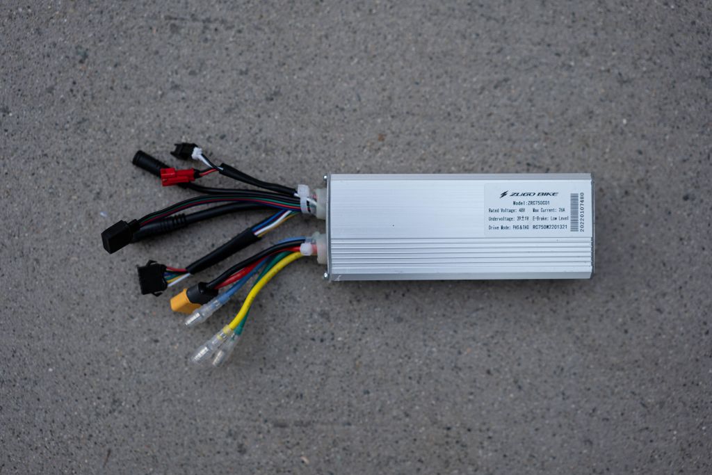

Issue: After powering on the unit, the throttle and pedal assist are unresponsive, resulting in no motor power. The usual troubleshooting steps do not fix the issue.
Mileage Covered: 100 mi
Cause: Faulty controller
Fix: Replacement of controller (covered by warranty)
Controller on bike
One day, after turning the bike on, the display functioned normally but the throttle and PAS gave no motor response. No troubleshooting items resolved the issue and eventually, after working with Zugo, we determined it was the controller. The ‘fix’ was a replacement of the entire controller. The replacement process only required us to remove the seat and snip some zip-ties (while being careful to avoid wires!) We could then disconnect all the connections and connect the new controller. It took us less than an hour in total.
After the fix, we also received a second Zugo Rhino, for ‘double the fun’(?) In our case, this resulted in double the problem. In an unfortunate turn, the second bike suffered the same failure, only this time it occurred after only two miles, following our first test ride.
After these failures, we started looking to see if other users had the same experience, but we could not find many and it seems ours is an isolated incident. We are in the process of completing a long-term test on the new controller and will report back at higher mileages to let you know how it’s going! Fingers crossed, this was a supply chain issue and not evidence of an issue with the controllers in general.
It was a sad way to end a test that, in every other respect, was a total success. The Rhino is a fast and fun e-bike and we would love to give it a glowing review. But with faulty controllers on two units, consumers should be wary. Any purchase will need to be made with the knowledge that you might make a warranty claim.
So far, the company has not reported on the issue or issued a statement.

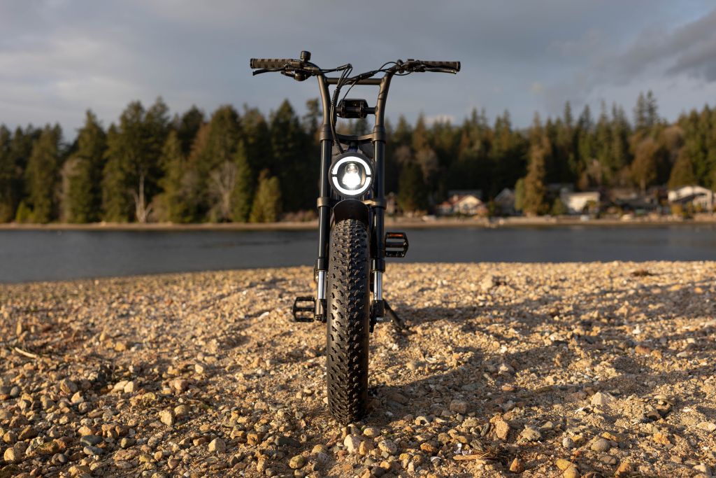

Zugo Rhino Straight view
With that out of the way, let’s take a closer look, because the Zugo Rhino has a lot to like. With this controller issue resolved, the bike has the potential to fulfill the needs of many riders. The Zugo Rhino is worth a look.

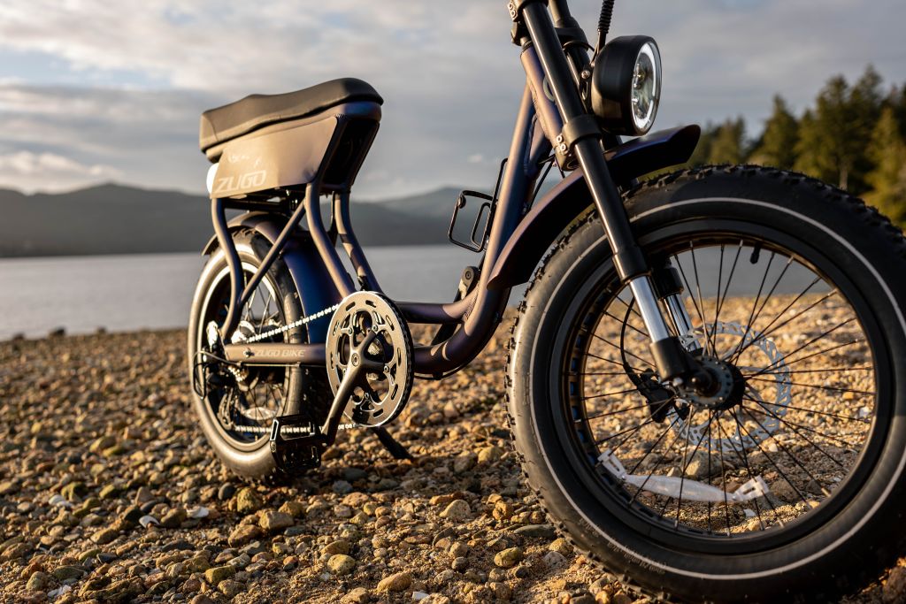

On the other hand, the step-through or low-step version is more reminiscent of a moped. The open frame allows you to mount and dismount easily and the cup holder is relocated slightly. The remaining features are the same between models, including the elongated padded seat, beefy 4” tires and a triple-tree, moto-style, dual crown, inverted suspension fork. All in all, it looks more like a motorcycle than a bike, and provides a similar feel once you hop into the saddle. The only thing really bringing that ‘bike vibe’ is the crankset and seven-speed drivetrain (with Shimano components).
Wugo rhino lowstep Side view
Coming in at 65 lb, it is a lot of bike. With a 750W motor and 750Wh battery, the Zugo Rhino backs up its image with power and speed. Speaking of speed: as shipped, the Zugo Rhino is a Class 2 e-bike with a 20 mph speed limit. However, it also offers the option to unlock it, turning it into a Class 3 e-bike (28 mph pedal assist). So, can you guess what we did as soon as we got it out of the box?

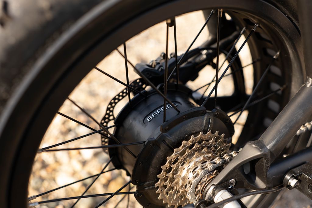

Hub Motor
Powerful Motor
The Zugo Rhino’s 750W Bafang rear hub motor is powerful and well suited to the bike. With a torque output of 85 Nm, it conquers hills without issue. This motor pleasantly offsets the geometry of the bike. With lots of pick-up and go, it ensures you are not putting in too much power with your legs. The throttle and pedal assist offer good torque off the line.

Controller Failures
As we mentioned in the introduction, we suffered a major issue with the Zugo Rhino in the form of two failed controllers. The issue presented itself in a strange way. The bike was functioning normally, then after powering it on one day it just did not respond to the throttle or pedal assist. This happened at 100 miles on the first bike, and at only two miles on the second, leading us to think there must be an internal issue with the controllers.
We have been in contact with the brand and they helped us to quickly and efficiently fix the first bike. They have not had other reports, and we could not find many other user reviews or reports that had a similar issue with the controller. The company has not issued a statement or report on the problem, yet.
It’s strange that it happened twice in a row, and we are looking into the issue further. We are testing the new controller over a longer period of time, so look out for our update on the status as we rack up the miles. For the time being, users should be aware that there seems to be an issue, and be ready to contact warranty claims to receive a replacement part.

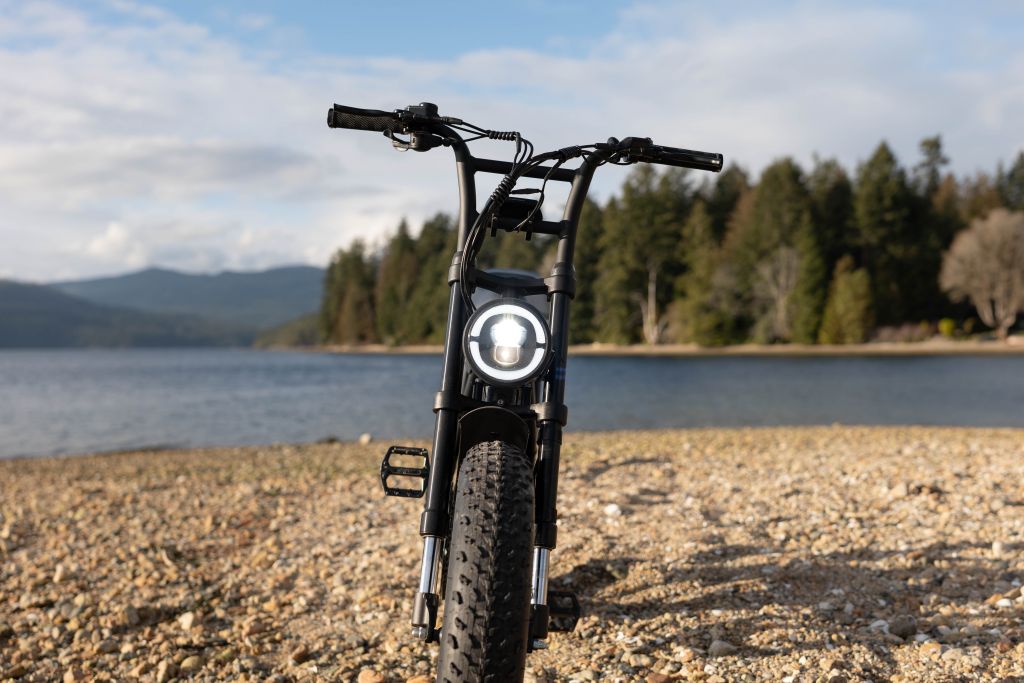

Zugo Rhino Straight View
Reasons to Look Elsewhere?
Aside from a faulty controller, users that enjoy a traditional bike style may not enjoy the style and weight of this e-bike. Those accustomed to small, nimble tires and quick turning may find this bike to be cumbersome. Additionally, consumers who require their bike to be brought indoors (e.g. apartment dwellers), may also want to look elsewhere. Due to the weight of the bike, ground-level storage space is most suitable.
Sizing could be an issue for some too. The seat sits 32” from the ground and is not adjustable. The front bars do adjust from 44” to 49” from the ground. Accordingly, short people may wish to look at the step-through model, which reduces standover height from 30″ (on the step-over Rhino) to 15.5″ (on the step-through Rhino), or swap to road tires, which will shave two to three inches from the total height.

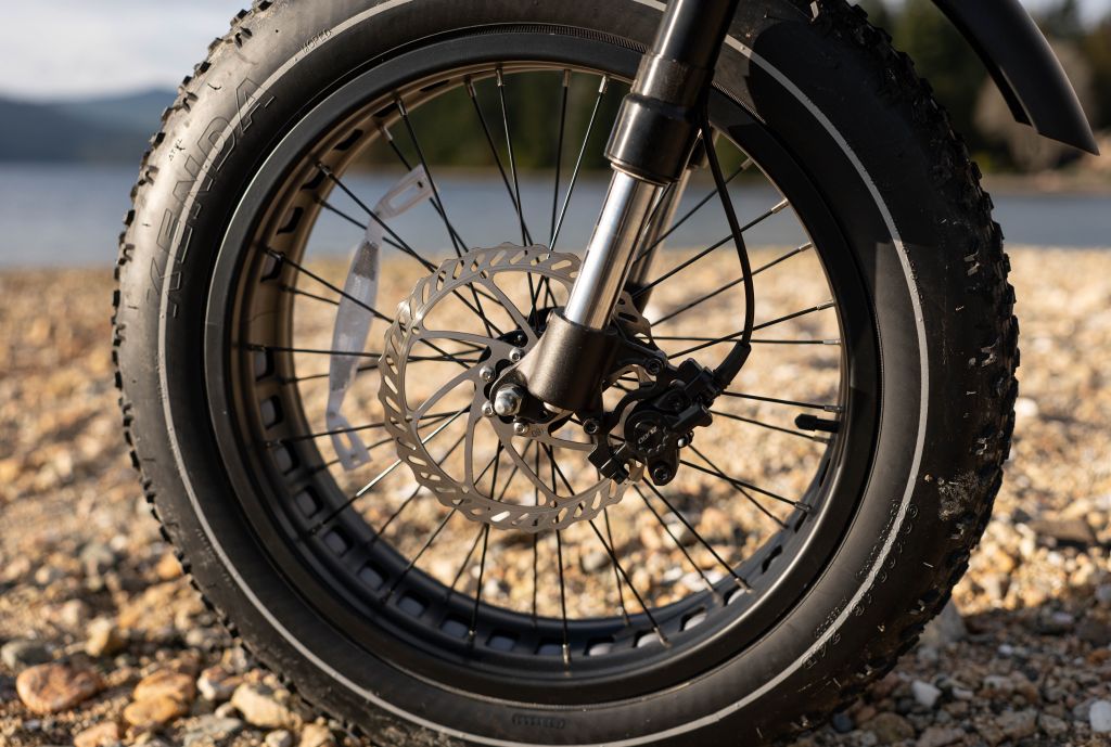

Rims: 20”, double-wall, punched-out
Tires: 20”×4”
Fenders: Metal, front and rear included

The motor is a Bafang 750W, 48V, gear-driven rear hub motor (RM G062.750.DC). It puts out 85 Nm of torque and is a reliable and powerful motor for the unit. The bike powers uphill, even on steep and repetitive ascents, and hits its top speed easily (0-28 mph in 10.5 s.) The 48V controller and 12-point pedal position sensor allow for good motor response to input, for a unit with no torque sensor. The motor offers responsive acceleration. When reaching its top speed, it maintains between 28 and 29 mph without feeling the need to pedal hard to maintain speed. I found no issues with motor performance and could travel on any route I chose, regardless of hills.

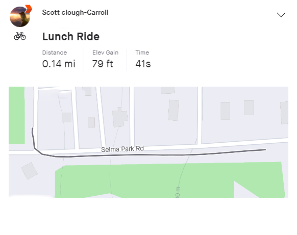

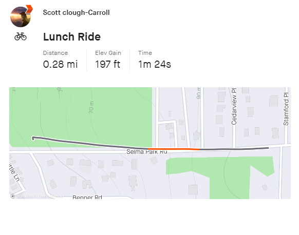

Hill Climb Results:
Hill Climb Info
Short Hill Climb:
  • Time: 41 s
  • Distance: 0.14 mi
  • Elevation Gain: 79 ft
  • Max. Grade: 18%
Hill Climb Info
Long Hill Climb:
  • Time: 1 m 24 s
  • Distance: 0.3 mi
  • Elevation Gain: 200 ft
  • Max. Grade: 18%

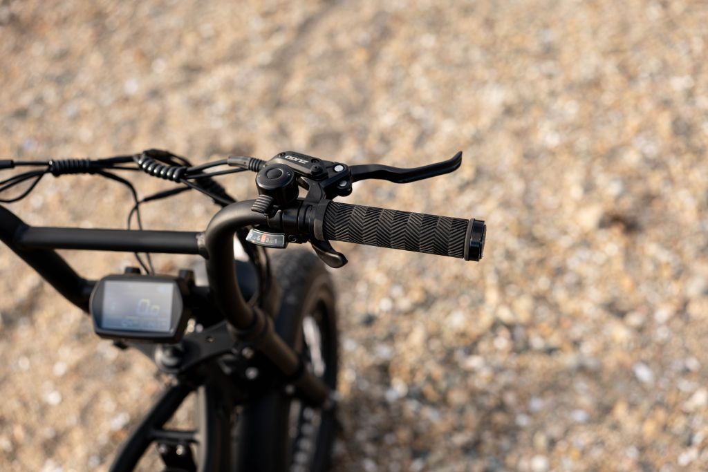

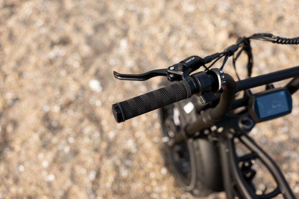

Cockpit Left
Cockpit and Control
The Rhino’s cockpit features a set of straight bars, offering a straight-backed riding stance that maintains the motorcycle feel. The handlebars allow adjustments in height from 44” to 49” off the ground.
It offers a thumb-switch-style throttle on the left side next to the pad control.
The control pad features four push buttons and a USB port under the unit. The USB charges very slowly but is sufficient enough to maintain a phone battery while using GPS.
The bike is turned on and off by pressing and holding the power button. A single press of the power button is used to turn the headlight on and off.
Single clicking the ‘+’ and ‘–’ buttons toggles power levels from 0 to 7.
Single clicking ‘m’ will turn the USB charger on or off. Holding ‘m’ enters the ‘unlock’ mode, where you enter a code to unlock your Zugo from Class 2 to Class 3.
The display shows basic info: five-bar power level, mph, assist level, headlight, USB, distance and speed. The unit cycles between the life/trip odometer and average/maximum speeds of the current trip, automatically, on screen.
The unit is simple and easy to read, though it is limited, with no options available other then the unlock screen.

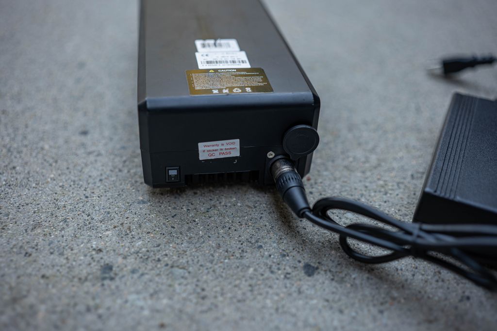

Battery

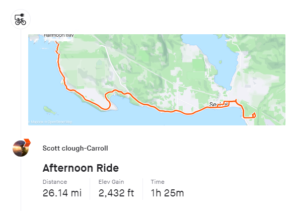

Zugo offers two battery options: 48V 15.6Ah (750Wh) or 48V 21Ah (1kWh). The test model we received had a 750 Wh battery with a claimed 30 to 60 mile range. The battery weighs 9 lb 3.3 oz.
In our range test, the bike traveled exactly 30 miles. This included a total elevation gain of 2,432 ft while riding at power assist levels in the ‘turbo’ range (5-7). The bike also completed a large hill climb with a maximum grade of 18% at one battery bar, to return to its home point, proving reliable on its claimed range.
Range Test Data
The battery features an on/off switch on the battery unit – keep this in mind if you get no power when turning the bike on – and a charge port protected by a rotating cover. The battery is easily removed for charging or it can be charged on the bike itself. On-bike charging requires the user to reach through the frame and under the seat to plug in. I found this to be an annoyance and would recommend removing the battery for charging.
The battery is nicely concealed inside the frame of the bike, so much so that you may struggle to find the socket, battery power switch and keyhole.
Battery Compartment
The keyhole is tucked beneath the battery panel on the left side of the bike, mid-length down the seat. After locating, unlocking is easy, and the battery removes with a firm tug. It slides back in to lock with a confident click. The battery features an integrated brake light and an on/off switch.
The charger is a standard 2-amp, 120-volt, US plug model. Charge time is six to eight hours with the 750Wh battery option. You can also opt to purchase a 4-amp fast charger.

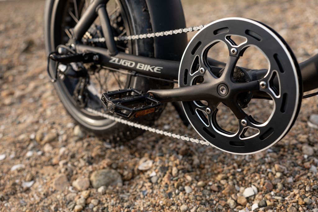

Drivetrain
Drivetrain

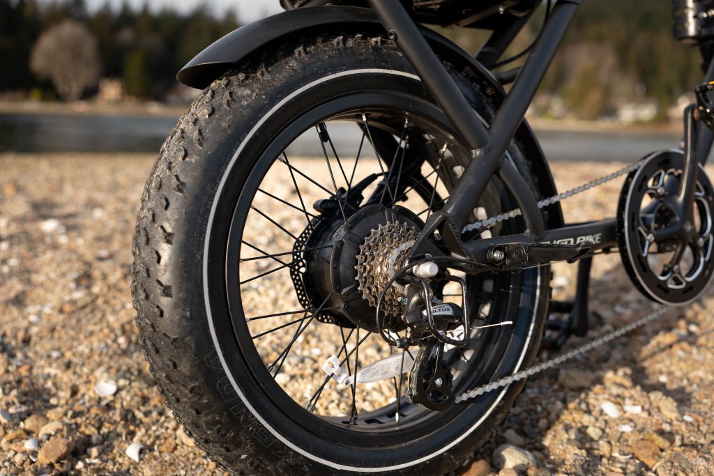

the Zugo Rhino features a 7-speed, 11-28t cassette with a Shimano Altus derailleur and shifter. The gearing matches the speed and range of the bike and provides reliable shifting. It also features a large front chainring, in an attempt to offset the geometry of the bike and provide a better pedal experience. This results in surprisingly good pedaling on level ground with no power. Despite this, you will not want to pedal long distances or up inclines without power. It’s a 65 lb motorcycle-style bike and is definitely meant to be powered.
When under power from the motor, the bike climbs and performs well, showing no hesitation on hills and allowing you to easily climb steep inclines in the highest two gears.

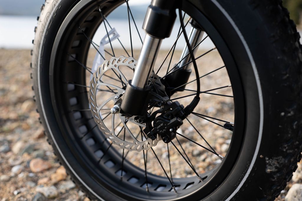

Front Brakes and Caliper
The bike features Zugo-branded hydraulic disc brakes with dual-piston calipers, aluminum levers (without reach adjustment), a 160 mm rear rotor and 180 mm front rotor. In a brake test on dry pavement, the Zugo Rhino performed well.

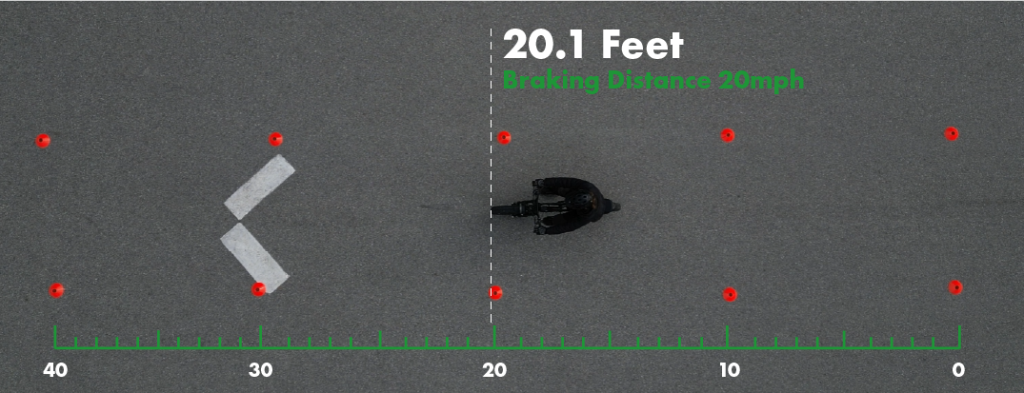

Brake Test Results:
20 mph: 20.1 ft
Brake test 20 mph

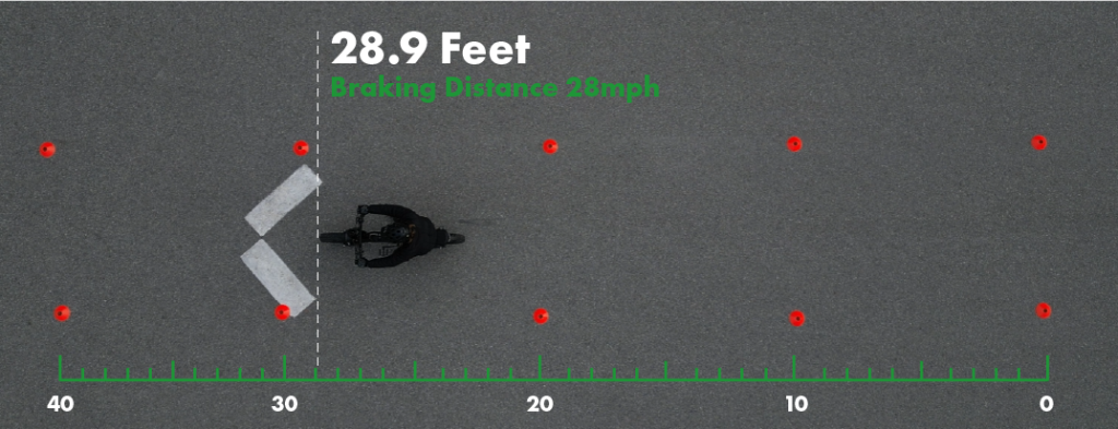

28 mph: 28.9 ft
Brake test 28 mph
Wheels, Tires and Fenders
The Zugo Rhino rides on a set of 20”, double-wall rims with punched-out holes to reduce weight.
Connecting the rim to the ground are knobby 4” wide tires that feature a reflective halo for visibility. The tires also feature puncture protection. This is a nice touch to ensure you are not servicing the wheels frequently.
Rims
The Zugo Rhino comes with painted, metal front and rear fenders attached. They do a good job of keeping the elements and road debris from reaching the rider. They appear durable and aesthetically match the finish of the bike.
A street tire is also available for purchase from Zugo’s Website.

Grips
Contact Points
Grips
The Rhino has lock-on MTB-style grips that are simple and… grippy. I personally enjoy simple grips in this style and the rubber pattern offers a good grip on both bare hands and gloves.

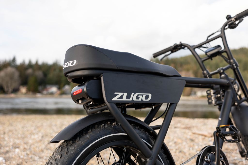

Seat
Seat
The seat is long and cushioned, allowing the rider to position themselves for better pedal positioning during rides. The seat sits approximately 32” from the ground and is not adjustable. However, the company notes that swapping to street tires will drop the overall height by a few inches. The seat is long enough to fit a second person, but this does shorten the driver’s seat position, so long legs will feel cramped with two on the bike. Sitting solo on the bike is comfortable, in motion and when stopped. That being said, after riding for upwards of an hour, the ergonomics of the bike begin to take a toll.
