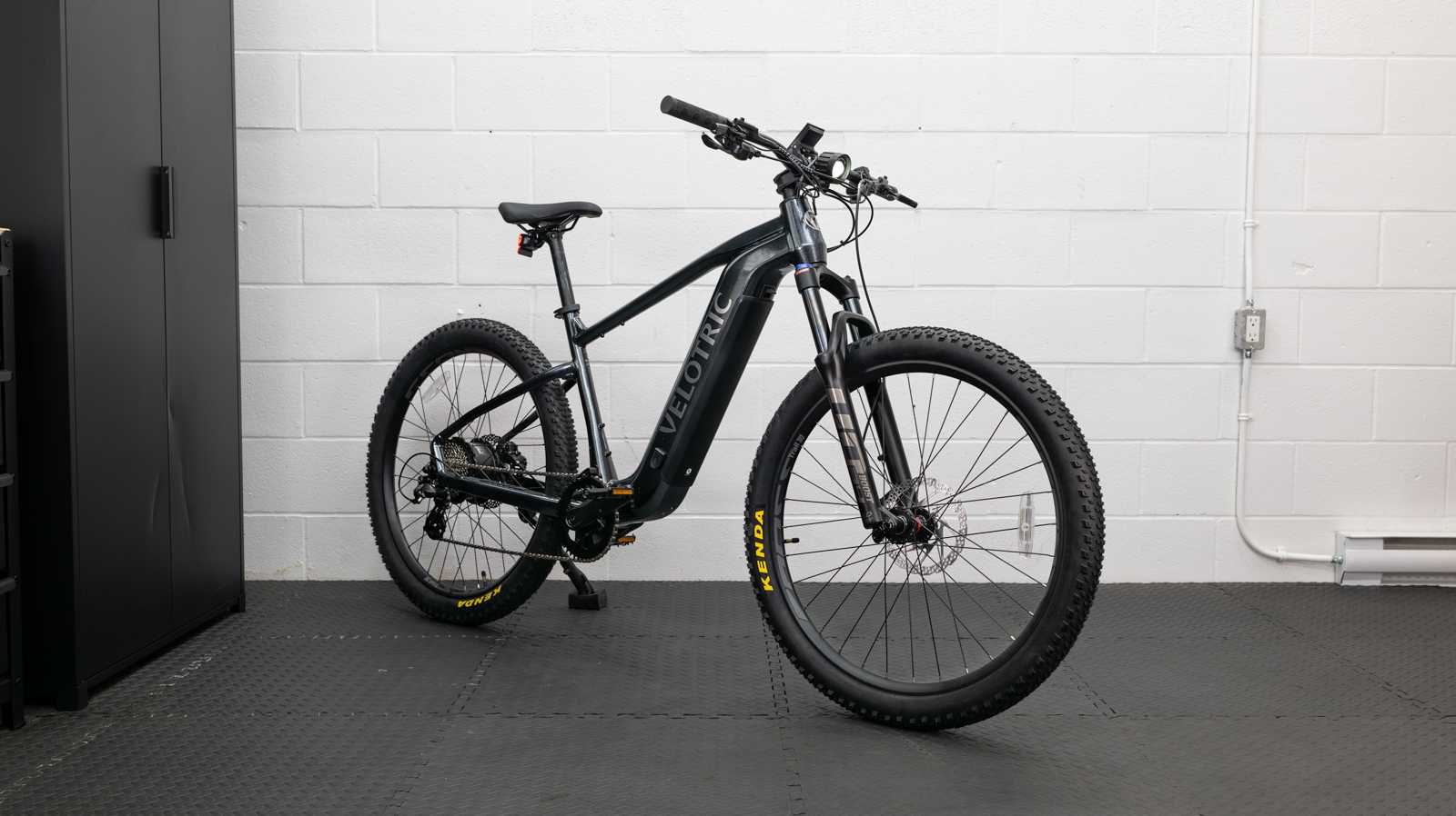

The Velotric Summit 1 is a 750W hub-drive hybrid with the look and geometry of a hardtail mountain bike. It reached 20 mph in 6 seconds, went 46.63 miles in Trail mode, and stopped from 20 mph in 14.5 feet, the shortest of any hybrid e-bike we have tested, and no bike in our comparison group beat it on acceleration, capped climbs, range, or braking. On real trails its 11–32t gearing, stiff fork, and 64.6 lb weight soon show their limits. For riders who want a fast, well-made commuter that can handle light trails, it is easy to recommend.

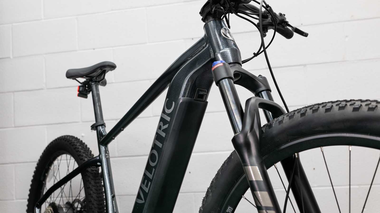

  • Stiff fork with no adjustment but a lockout
  • Heavy at 64.6 lb, 4% over the claim

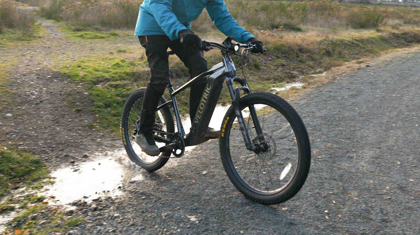

Scott on the Summit 1 on a paved path.

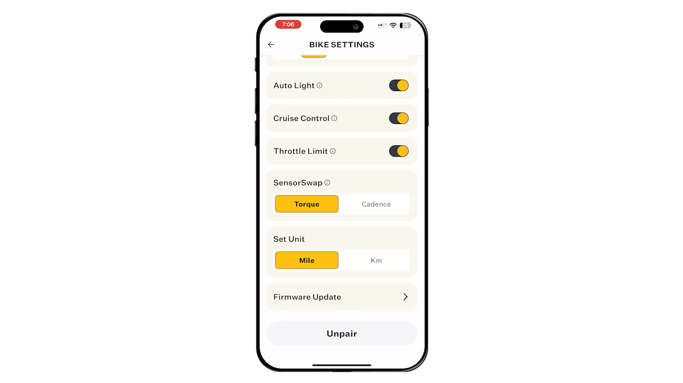

  • Riders who switch between torque and cadence assist often. The app is the only way to change the sensor, so it can't be done on the fly.

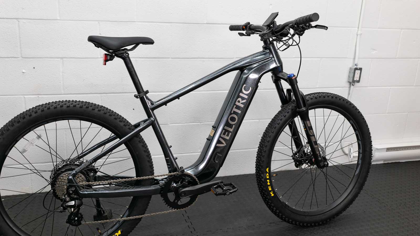

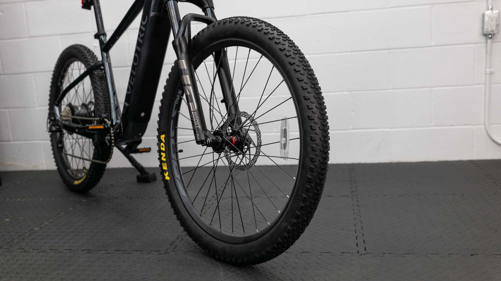

With its beefy hardtail frame, relatively slack head angle, 120 mm fork, wide bar, and 2.6" knobby tires, the Summit 1 looks like an electric mountain bike, and the frame even takes a dropper post. Velotric markets it as a hybrid for mixed-terrain riding. Our trail riding showed why:
  • The gearing. First gear on the 11–32t cassette is too high for slow, technical climbs, so you lean on the motor, and even with the torque sensor selected the rear tire can lose grip on slippery sections.
  • The fork. The 120 mm hydraulic fork has a lockout and nothing else. It is very stiff: it resists bottoming out, but it also doesn't absorb the big roots and rocks of blue-rated trails.
  • The weight and balance. At 64.6 lb with a rear hub motor, the Summit 1 is clumsy on trails and hard to lift at the front.

The Velotric Summit 1 from the drive side in the BikeRide studio, with the optional fenders and rear rack fitted

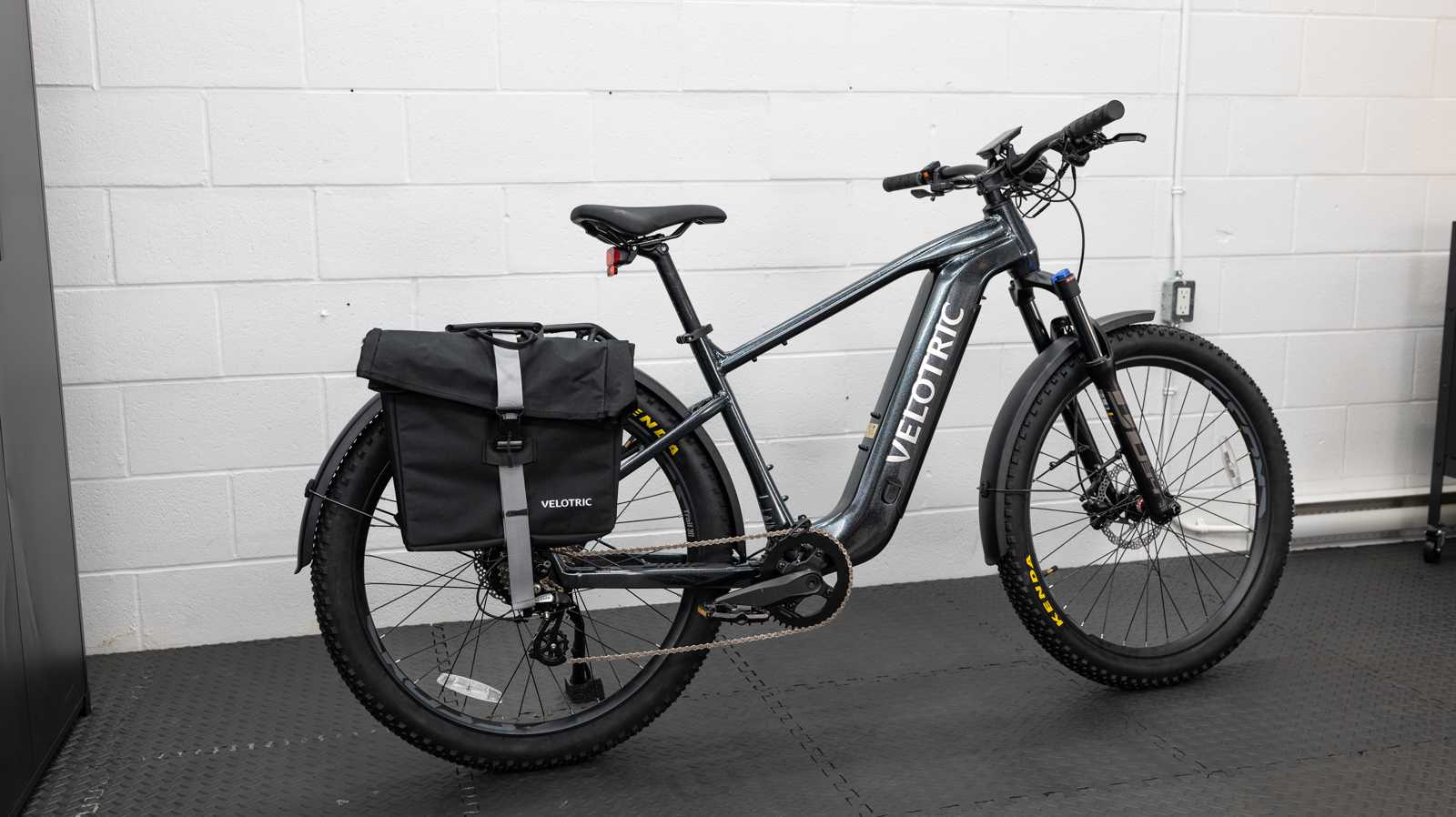

The Summit 1 with the optional fenders and rack, the way our test bike came.

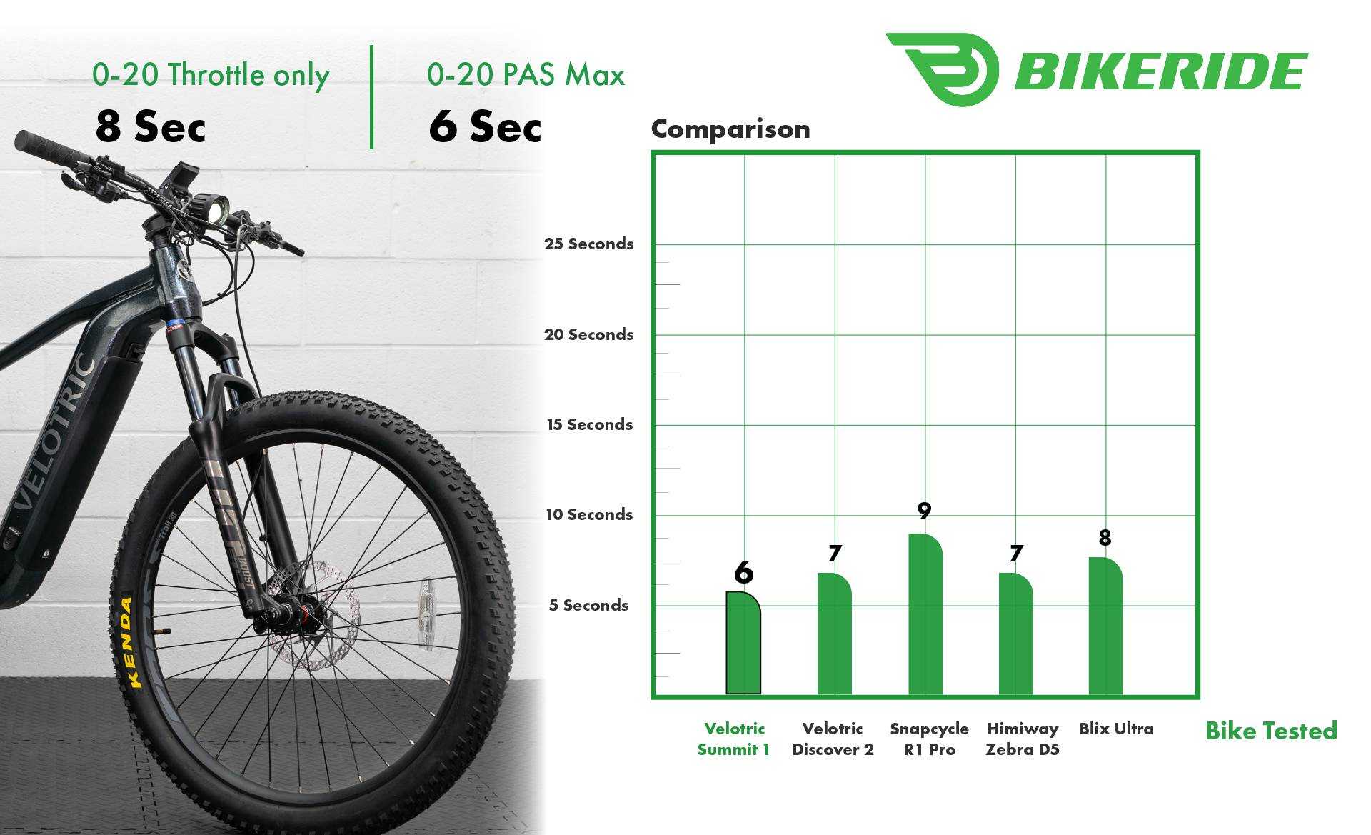

Acceleration 0–20 mph
Measured
On maximum pedal assist (Boost, PAS 5) we measured 6 seconds to 20 mph, tied for fastest in this comparison group with the mid-drive Ramblas ADV and 2.1 s quicker than the 8.1 s average of the 750W hub-drive e-bikes we have tested. On the throttle alone it took 8 seconds, the fastest throttle time in the group. The motor responds crisply, and the thumb lever gives good control over its output.

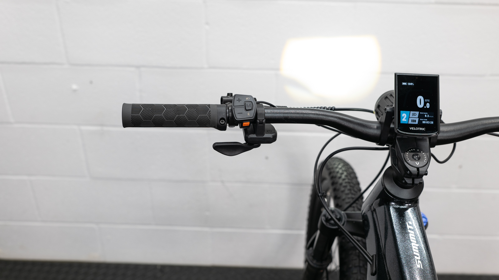

The thumb throttle at the left grip. It can give full power or be limited to the selected assist level.
0–20 mph, max pedal assist
Seconds · shorter is faster
Velotric Summit 16.0 s
Aventon Ramblas ADV6.0 s
Velotric Discover 27.0 s
n+ Mercedes-AMG9.0 s
Velotric Summit 1Comparison bikesAverage of similar bikes (8.1 s)
0–20 mph, throttle only
Seconds · shorter is faster · the Ramblas ADV has no throttle
Velotric Summit 18.0 s
Velotric Discover 29.0 s
n+ Mercedes-AMG11.0 s
Velotric Summit 1Comparison bikesAverage of similar bikes (9.6 s)
Max pedal assist: 6.0 sThrottle only: 8.0 sAverage of similar bikes: 8.1 s pedal assist · 9.6 s throttleTies fastest in the group on pedal assist

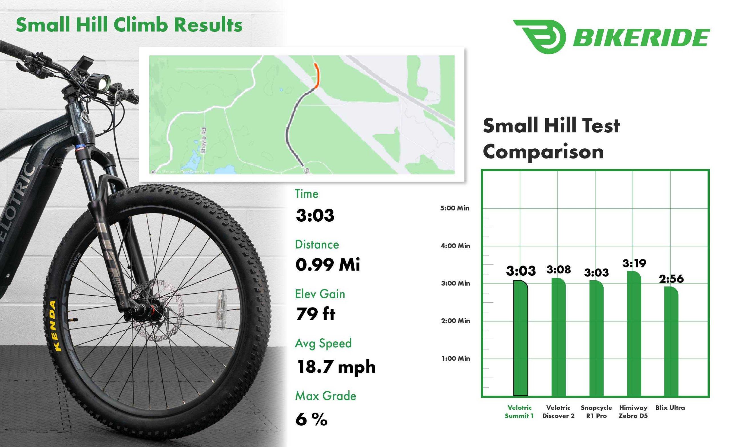

On the gradual hill (0.99 miles at up to a 6% grade) the Summit 1 finished in 3:03 at an average of 18.7 mph with the 20 mph limit. That ties the Mercedes-AMG for the fastest capped run in this comparison group and is 6 seconds inside the 3:09 average of the 750W hub-drive e-bikes we have tested. The Ramblas ADV's Class 3 run, at 2:56, is the only quicker time in the group.
Scott on the Summit 1 on a residential road.
Gradual hill climb, max assist, 20 mph cap
Minutes:seconds · shorter is faster · 0.99 mi · 79 ft gain · 6% max grade
Velotric Summit 13:03
n+ Mercedes-AMG3:03
Velotric Discover 23:08
Aventon Ramblas ADV3:19
Velotric Summit 1Comparison bikesAverage of similar bikes, capped runs (3:09)
Summit 1, 20 mph cap: 3:03 · 18.7 mph avgAverage of similar bikes, capped runs: 3:09Ties fastest capped run in the group

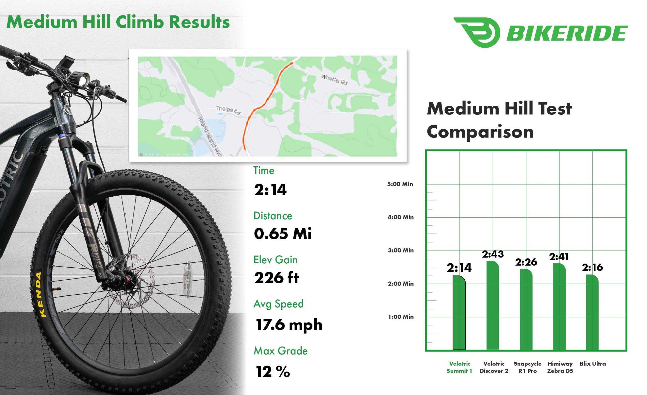

Climbing Test 2: Steep Hill
Measured
On the steep climb, 0.65 miles with 226 feet of gain and a 12% maximum grade, the Summit 1 reached the top in 2:14 at an average of 17.6 mph. That is the fastest time in this comparison group, 14 seconds ahead of the Ramblas ADV, and 14 seconds quicker than the 2:28 average of the 750W hub-drive e-bikes we have tested. Steeper hills needed at least Trail mode and PAS 4 or 5.
Steep hill climb, max assist
Minutes:seconds · shorter is faster · 0.65 mi · 226 ft gain · 12% max grade
Velotric Summit 12:14
Aventon Ramblas ADV2:28
n+ Mercedes-AMG2:31
Velotric Discover 22:43
Velotric Summit 1Comparison bikesAverage of similar bikes (2:28)
Summit 1: 2:14 · 17.6 mph avgFastest in the comparison groupAverage of similar bikes: 2:28

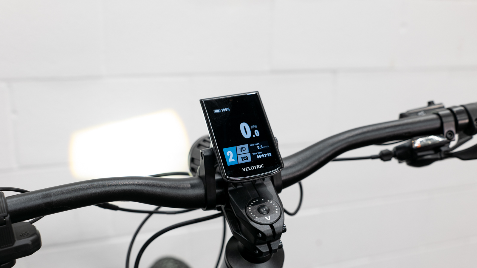

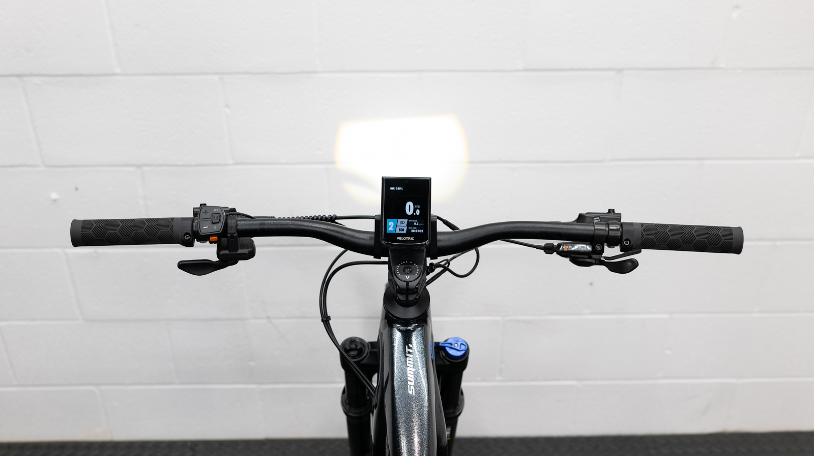

The Summit 1 ships with a 20 mph limit, and the display sets it anywhere from 12 to 28 mph in 1 mph steps. With the throttle fitted it is a Class 2 e-bike, with the throttle removed a Class 1, and at 28 mph a Class 3. Set to 28 mph it was easy to ride in traffic, with very little ghost pedaling. Boost mode suited the road and the steepest paved climbs, Trail mode the trails.
Riding in town with the limit set to 28 mph.
✓ Class 1, 2, or 3 from the display and a removable throttleTop speed:  20 mph as shipped, 12–28 mph adjustable (claimed)Assist levels:  Eco, Trail, and Boost, five PAS levels eachThrottle:  thumb lever, full power or limited to the PAS level
Class 3 e-bikes are limited to 28 mph on pedal assist and 20 mph on the throttle. Many trails and multi-use paths restrict Class 3 access, so check local rules before riding there.

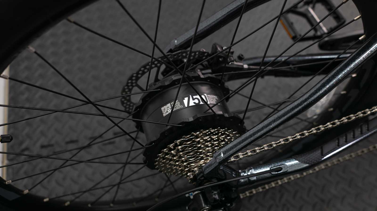

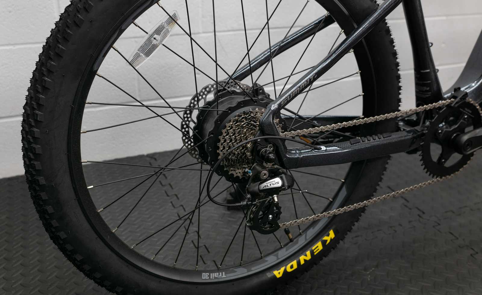

The Velotric-branded rear hub is rated at 750W nominal, 1,300W peak, and 90 Nm, and it can run on a torque sensor or a cadence sensor. Power ramps up nicely through the five PAS levels and three ride modes, with plenty of torque at the top of the range. Velotric calls this E-series drive one of the quietest torque-sensing hub motors, and it was quieter than the other 750W, 90 Nm hub motors we have tested.
The Velotric Summit 1's Velotric 750W rear hub motor behind the cassette, close up in the studio
The 750W rear hub motor: 1,300W peak and 90 Nm, claimed.

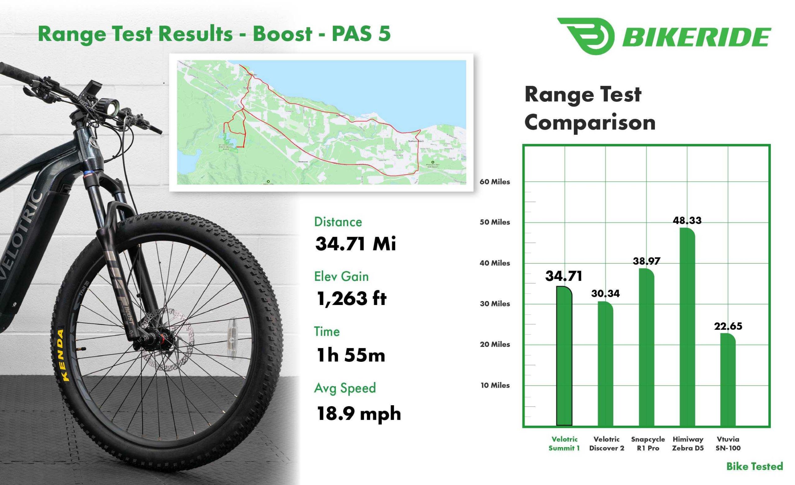

Range Test 1: Max Assist (Boost, PAS 5, 20 mph limit)
Measured
On our standard loop at maximum assist (Boost mode, PAS 5) the Summit 1 lasted 34.79 miles with 1,243 feet of elevation gain, at an 18.9 mph average. That is the longest of the three max-assist runs in this comparison group and 21% above the 28.7-mile average of the hybrid e-bikes we have tested, second only to the Aventon Pace 4 among them.
Rider's view on a wet road.
Range at maximum assist
Miles · longer is better · the Ramblas ADV has no max-assist run
Velotric Summit 134.79 mi
n+ Mercedes-AMG32.41 mi
Velotric Discover 230.34 mi
Velotric Summit 1Comparison bikesAverage of similar bikes (28.7 mi)
Summit 1, Boost: 34.79 mi · 1,243 ft climbed · 18.9 mph avgAverage of similar bikes at max assist: 28.7 mi+21% vs. similar bikesLongest in the group

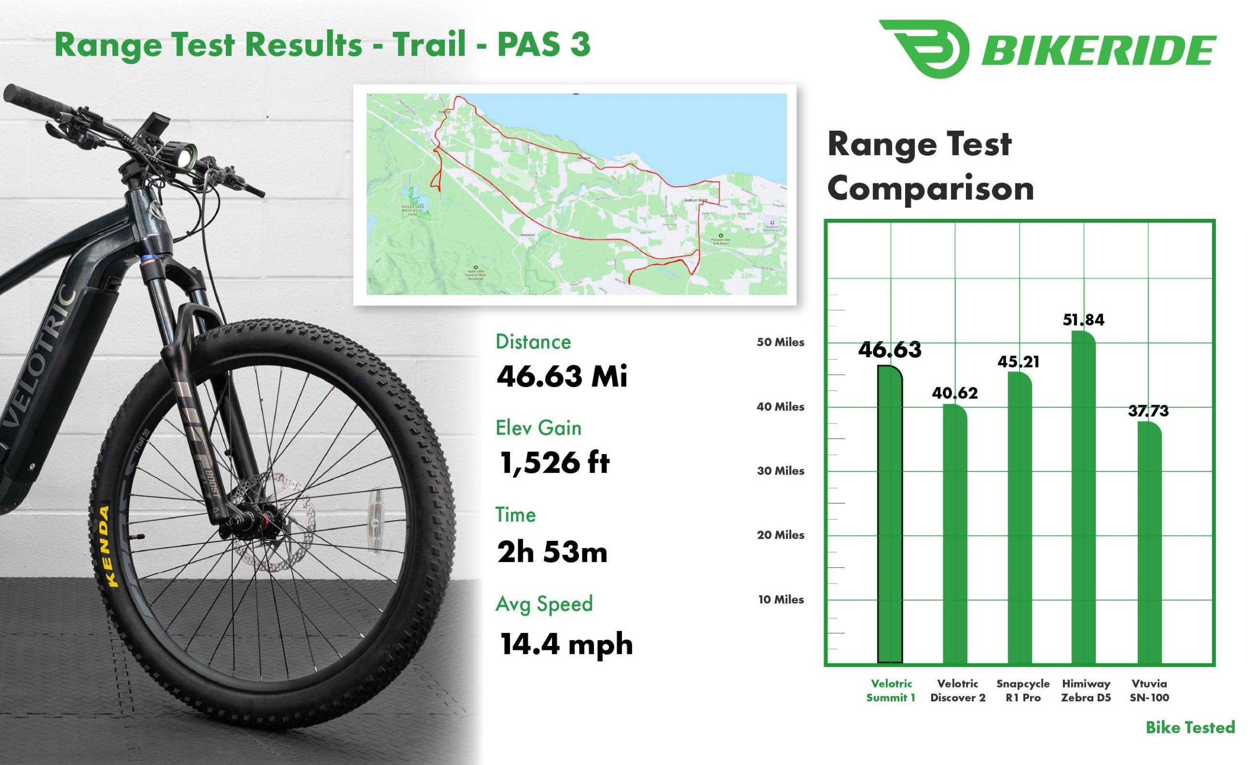

In Trail mode at PAS 3 the Summit 1 lasted 46.63 miles on the same loop, with 1,526 feet of elevation gain, in 2 hours 53 minutes at a 16.2 mph average. That is the longest medium-assist run in this comparison group, just ahead of the Ramblas ADV, and 25% above the 37.4-mile average of the hybrid e-bikes we have tested at medium assist.
Scott on a gravel road through a logging clearing.
Range at medium assist
Miles · longer is better · the Mercedes-AMG has no medium-assist run
Velotric Summit 146.63 mi
Aventon Ramblas ADV Trail mode46.38 mi
Velotric Discover 240.62 mi
Velotric Summit 1Comparison bikesAverage of similar bikes (37.4 mi)
Summit 1, Trail: 46.63 mi · 1,526 ft climbed · 2 h 53 min · 16.2 mph avgAverage of similar bikes at medium assist: 37.4 mi+25% vs. similar bikesLongest in the group

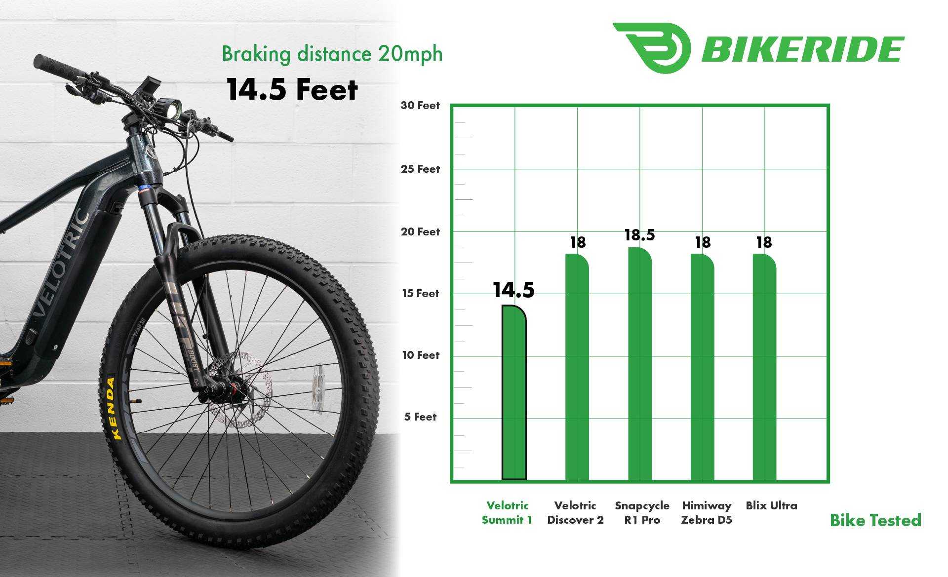

Brake test: 20 to 0 mph
Measured
The Shimano MT200 two-piston hydraulic discs, with 180 mm rotors front and rear, stopped the Summit 1 from 20 mph in 14.5 feet. That is the shortest stop in this comparison group, the shortest of any hybrid e-bike we have tested, and 6.4 feet shorter than their 20.9-foot average. The brakes are powerful and quiet, on the road and on trails, and lever reach adjusts with a small hex key.
The full stop from 20 mph, seen from above: 14.5 feet.
Braking distance, 20–0 mph
Feet · shorter is better
n+ Mercedes-AMG20 ft
Aventon Ramblas ADV19.5 ft
Velotric Discover 218 ft
Velotric Summit 114.5 ft
Velotric Summit 1Comparison bikesAverage of similar bikes (20.9 ft)
Where the Summit 1 sits: braking distance
Compared to the 9 hybrid e-bikes we have tested
Summit 1
14.5 ft (best hybrid result, the Summit 1)Braking distance26.5 ft (longest)
Summit 1: 14.5 ftAverage of similar bikes: 20.9 ftShortest of the hybrid e-bikes we have tested
The Velotric Summit 1's front Shimano MT200 caliper and 180 mm rotor on the suspension fork
The front Shimano MT200 caliper on its 180 mm rotor.

The Summit 1's geometry feels like a mountain bike's, and the long wheelbase gives confidence at speed and on descents. On pavement and light trails it handles well and is plenty of fun, with ride quality much like other hardtail mountain bikes we have ridden. On real trails the weight makes it clumsy and hard to move around, and the rear hub motor upsets the balance, limiting how far you can pop the front wheel or jump the bike.
Rider's view on forest singletrack.
Overall comfort and composure4/5Composed on pavement and light trails, clumsy on technical ones.
Cornering and agility4/5Good handling and cornering for a hybrid, but unsuitable for technical trails.
Descending confidence4/5The long wheelbase provides stability on descents.
Riding unpowered3/5Manageable on the flat.

The Velotric Summit 1's cockpit from the rider's side: the left grip with the control pad and throttle, and the 2.8-inch display by the stem
The cockpit from the saddle: control pad and throttle at the left grip, the display by the stem.
Cockpit adjustability4/5A standard-size bar and stem make the cockpit easy to swap or upgrade.

The aluminum hardtail frame has a nice shape and smooth welds. Our Space Black test bike looks more like dark gray, with a metallic finish that catches the light. Sunrise Orange and Royal Blue are the other colors. The cables, including the taillight's wiring, run inside the frame. There are fender mounts, three sets of bosses in the main triangle, and, Velotric says, clearance for 3" tires. A dropper post fits, but then the taillight's wiring runs partly outside.
The Velotric Summit 1's head tube, top tube and down tube from the drive side, with the fork's lockout dial and the internal cable ports
The frame from the drive side: internal cables, smooth welds, and a metallic Space Black finish.
Frame welds and finish5/5A nice shape, smooth welds, and a metallic finish that catches the light.
Cable and wire integration5/5Internal routing, including the taillight's wiring.

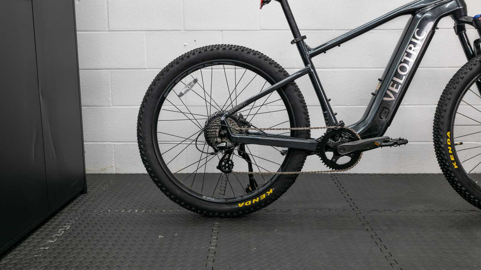

Drivetrain and shifting
Rated
The Shimano Altus 8-speed drivetrain pairs a 44t narrow-wide chainring with an 11–32t cassette. Shifting was fairly clean, typical of Altus: a step up from Tourney, though not as crisp as higher-end groupsets. The low end is the problem: first gear is too high for slow technical sections and steep climbs, so you rely on the motor, and the rear wheel is more likely to lose traction. For the multi-terrain city riding Velotric markets, the gearing is acceptable.
The Velotric Summit 1's Shimano Altus rear derailleur and 11–32t cassette, close up in the studio
The Shimano Altus derailleur and the 11–32t cassette on our test bike.
Shifting performance3/5Little ghost pedaling at 28 mph, but the 11–32t gearing is too tall for technical climbs.

The 27.5" wheels run a Novatec front hub and 2.6" Kenda tires. The tires carry Kenda's product codes for the Honey Badger XC but none of its graphics, and nothing on them confirms the puncture protection Velotric claims. The chunky XC tread gripped well on pavement, dirt, and gravel. A single-sided kickstand, lights, and a bell come with the bike. The fenders and MIK-HD rack are sold separately, and the fenders on our test bike worked well on wet roads.
The knobby tread of the Velotric Summit 1's 27.5×2.6-inch Kenda front tire and the suspension fork, in the studio
The 27.5×2.6" Kenda tires: an XC tread with good grip on pavement, dirt, and gravel.
The optional rear rack and fender on the Velotric Summit 1, with the saddle-mounted taillight above
The optional rack and fender. Both cost extra.

The 2.8-inch color display stands upright in the middle of the bar. It is bright, easy to read, and logically laid out, with a battery graphic and percentage, and a USB-A port underneath for a phone. The control pad at the left grip has power, plus, minus, and M buttons. The power button cycles the ride modes, plus and minus step through the PAS levels, a long press of plus works the lights, and holding minus engages walk mode.
A long press of M opens the advanced menu, where the speed limit, throttle limit, taillight mode, and auto light are set.
Stepping through the menu with the left-hand control pad.
The Velotric Summit 1's 2.8-inch color display above the stem, showing speed, assist level and battery percentage
The 2.8-inch display: speed, assist level, ride mode, and the battery as a percentage.
Display readability5/5Bright, easy to read, and logically laid out.
Controls5/5The menus are easy to understand.
Companion app
Rated
The Velotric app delivers over-the-air updates by Bluetooth and is the only way to switch between the torque and cadence sensors. The display handles every other setting but not this one, so there is no practical way to change sensors on the fly. Velotric says a firmware update cannot fix this and has supplied upgraded displays for some bikes, but it had not decided how to handle it when we tested the Summit 1.
✓ Over-the-air updates by BluetoothSensor switch:  app only✓ Speed limit and other settings on the display
Companion app4/5Handles the sensor switch and updates, and mirrors the display's settings.

0–20 mph, throttle onlyvs. 33 other 750W hub-drive e-bikes8.0 s9.6 s10.7 s
0–20 mph, max pedal assistvs. 34 other 750W hub-drive e-bikes6.0 s8.1 s8.4 s
Gradual hill climb, 20 mph capvs. 21 other 750W hub-drive e-bikes3:033:093:18
Steep hill climbvs. 31 other 750W hub-drive e-bikes2:142:282:36

Range (max assist, Boost)vs. 8 other hybrid e-bikes34.79 mi28.7 mi29.6 mi
Range (medium assist, Trail)vs. 5 other hybrid e-bikes46.63 mi37.4 mi39.1 mi
Range vs claimedvs. 8 other hybrid e-bikes67%57%54%

MotorVelotric-branded rear hub, 750W nominal, 1,300W peak
