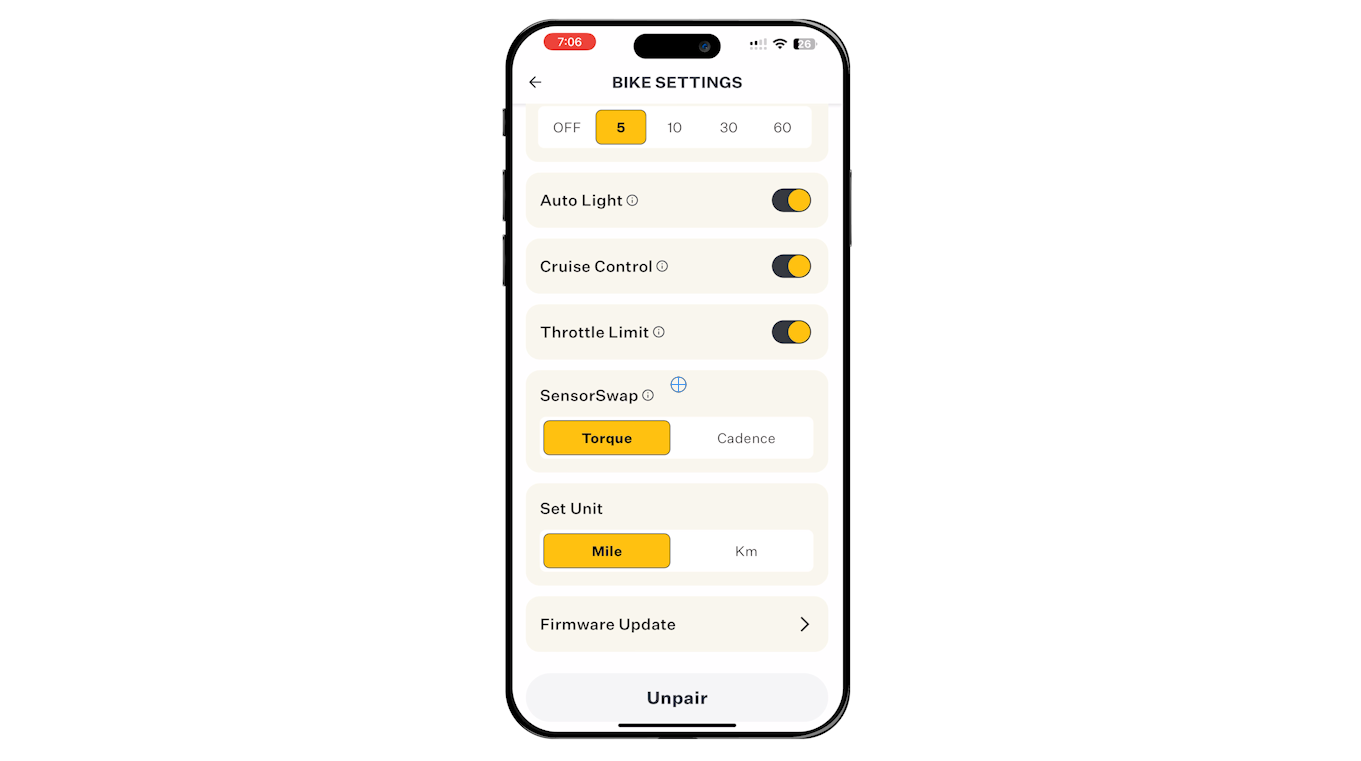

  • Switching sensors needs the app

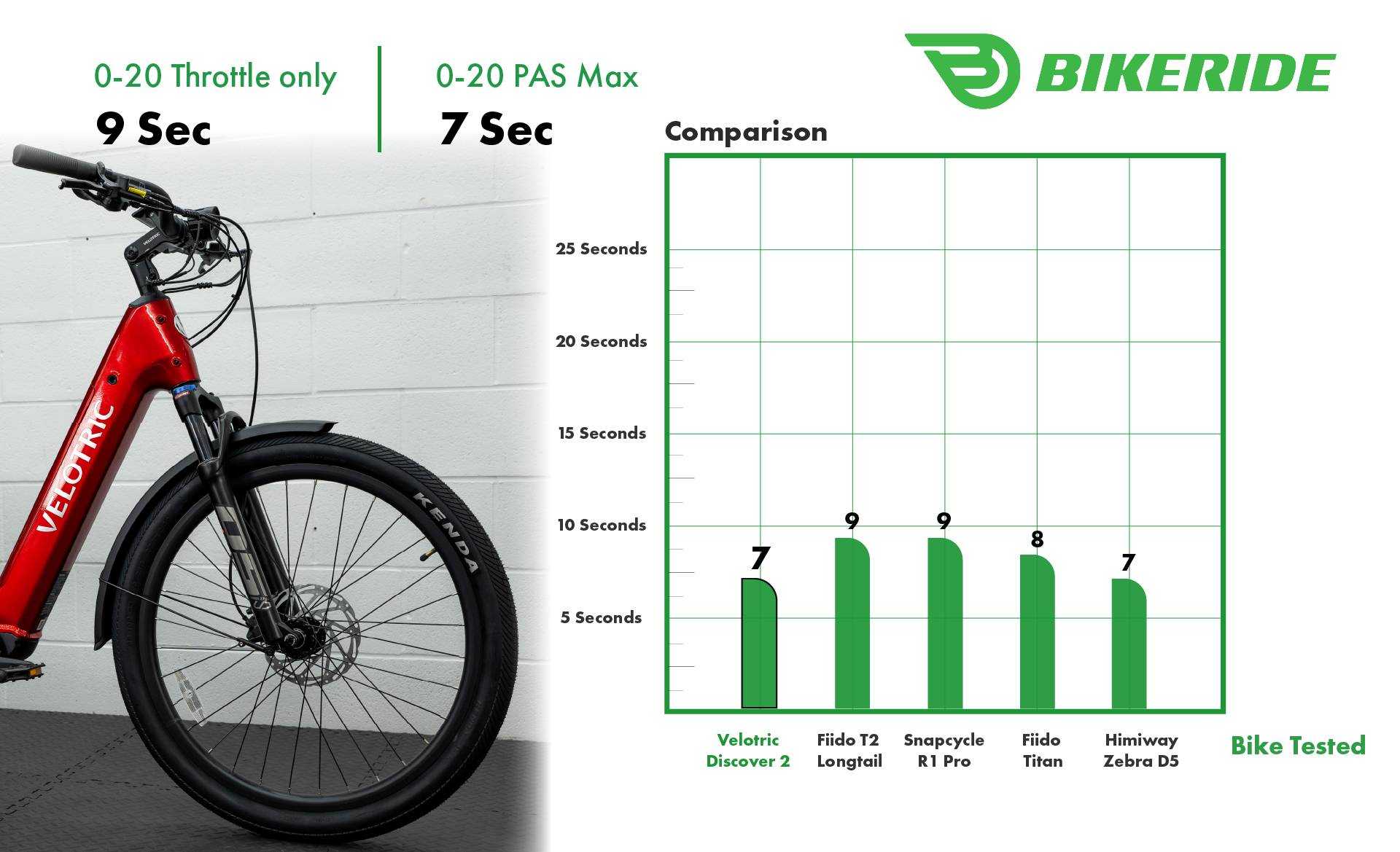

Acceleration 0–20 mph
Measured
On maximum pedal assist (Boost mode, PAS 5) we measured 7 seconds to 20 mph, 1.1 s quicker than the 8.1 s average of the 750W hub-drive e-bikes we have tested and tied-second in the comparison group. On the throttle alone it took 9 seconds, third of the five.
Scott pulling away from a standstill on a gravel path by the shore.
0–20 mph, max pedal assist
Seconds · shorter is faster
Aventon Level 4 REC6.0 s
Velotric Discover 27.0 s
Heybike Hybrid7.0 s
Lectric XPress 7507.0 s
Himiway A78.0 s
Velotric Discover 2Comparison bikesAverage of similar bikes (8.1 s)

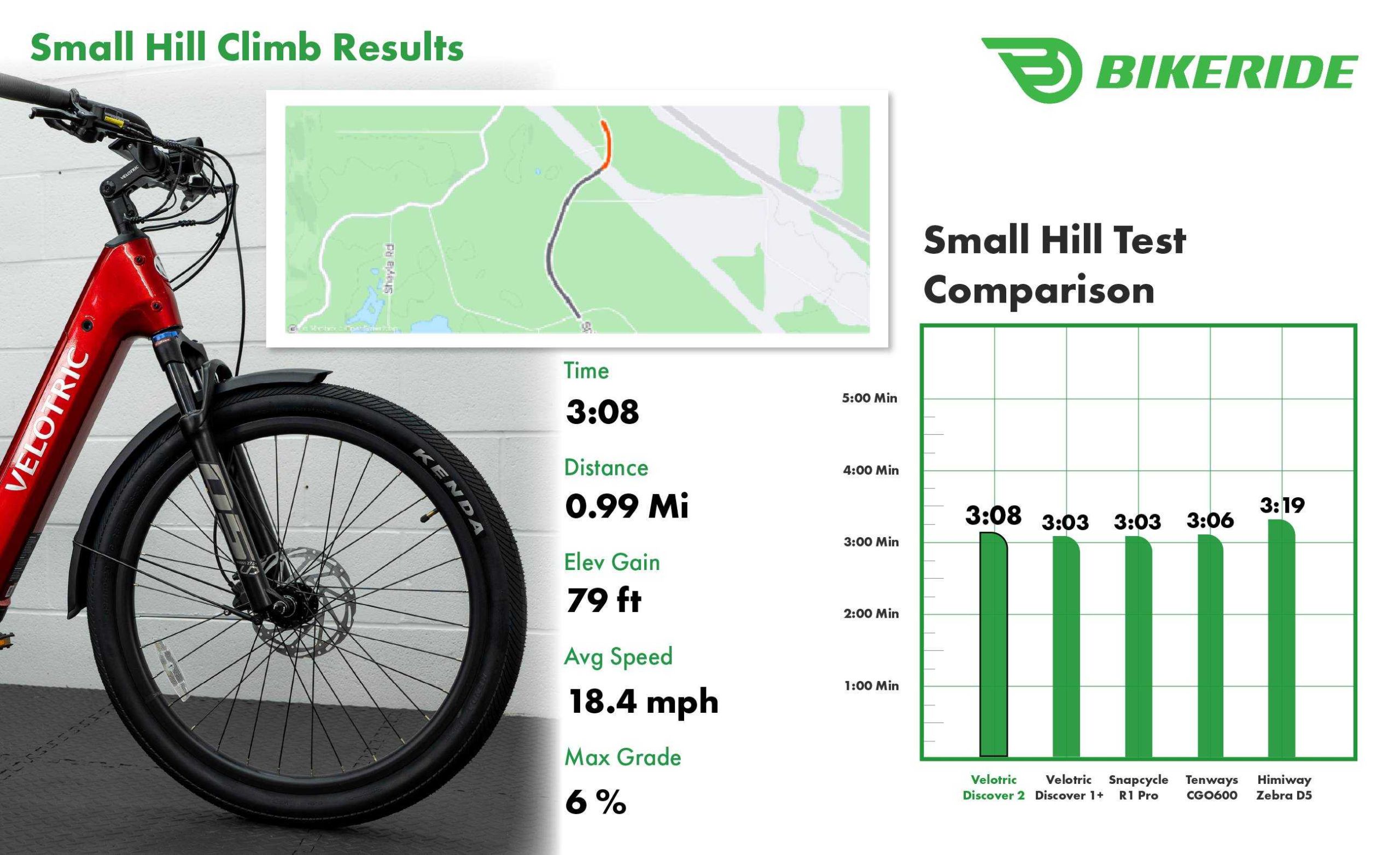

Climbing Test 1: Gradual Hill
Measured
On the gradual hill (0.99 miles at up to a 6% grade) the Discover 2 finished in 3:08 at an average of 18.4 mph with the 20 mph limit, 1 second inside the 3:09 average of the 750W hub-drive e-bikes.
Scott on the Discover 2 on a gravel park path.
Gradual hill climb, max assist, 20 mph cap
Minutes:seconds · shorter is faster · 0.99 mi · 79 ft gain · 6% max grade
Himiway A72:54
Aventon Level 4 REC3:02
Lectric XPress 7503:04
Velotric Discover 23:08
Heybike Hybrid3:08
Velotric Discover 2Comparison bikesAverage of similar bikes, capped runs (3:09)
Discover 2, 20 mph cap: 3:08 · 18.4 mph avgAverage of similar bikes, capped runs: 3:09Ties slowest capped run in the group

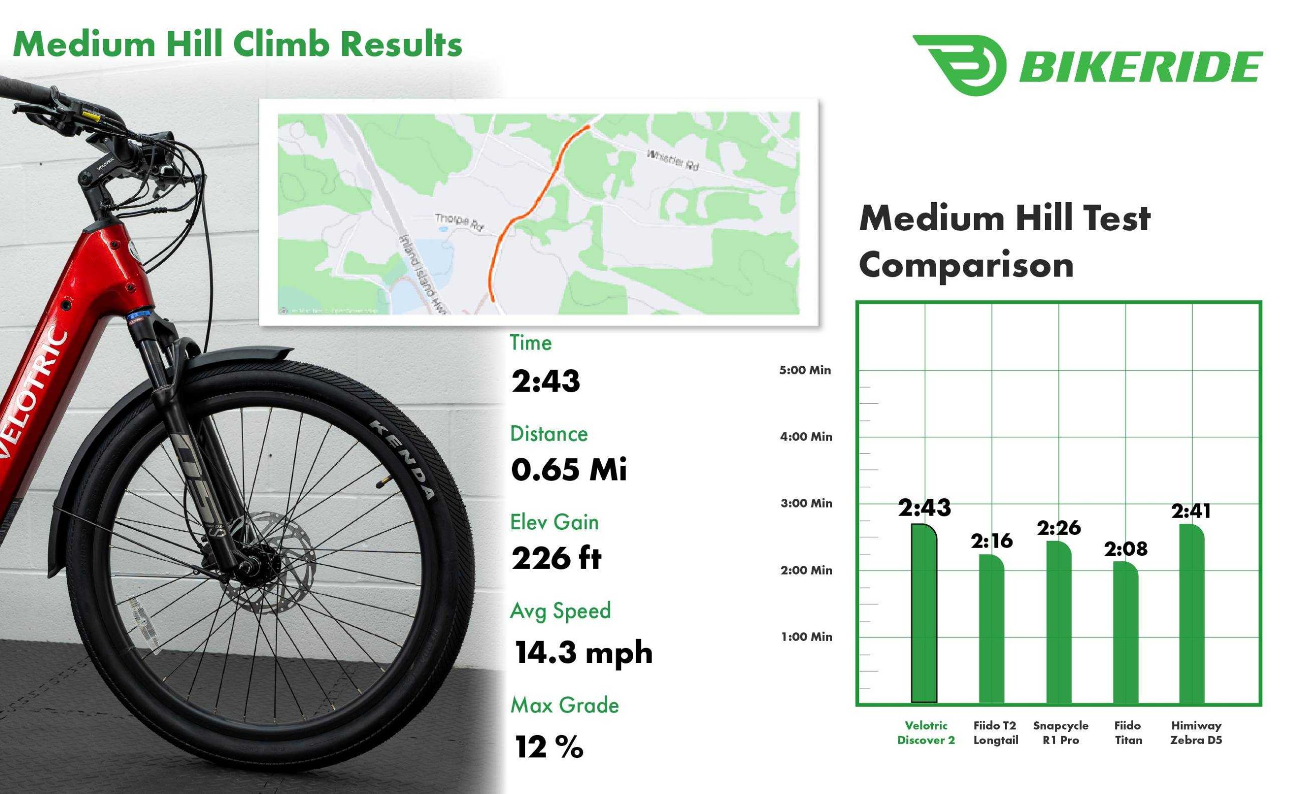

On the steep climb, 0.65 miles with 226 feet of gain and a 12% maximum grade, the Discover 2 reached the top in 2:43 at an average of 14.3 mph. That is the slowest time in this comparison group, and 15 seconds slower than the 2:28 average of the 750W hub-drive e-bikes we have tested. Even so, it climbs steep hills with minimal pedal effort.
Steep hill climb, max assist
Minutes:seconds · shorter is faster · 0.65 mi · 226 ft gain · 12% max grade
Aventon Level 4 REC2:13
Heybike Hybrid2:21
Lectric XPress 7502:22
Himiway A72:39
Velotric Discover 22:43
Velotric Discover 2Comparison bikesAverage of similar bikes (2:28)
Discover 2: 2:43 · 14.3 mph avgSlowest in the comparison groupAverage of similar bikes: 2:28

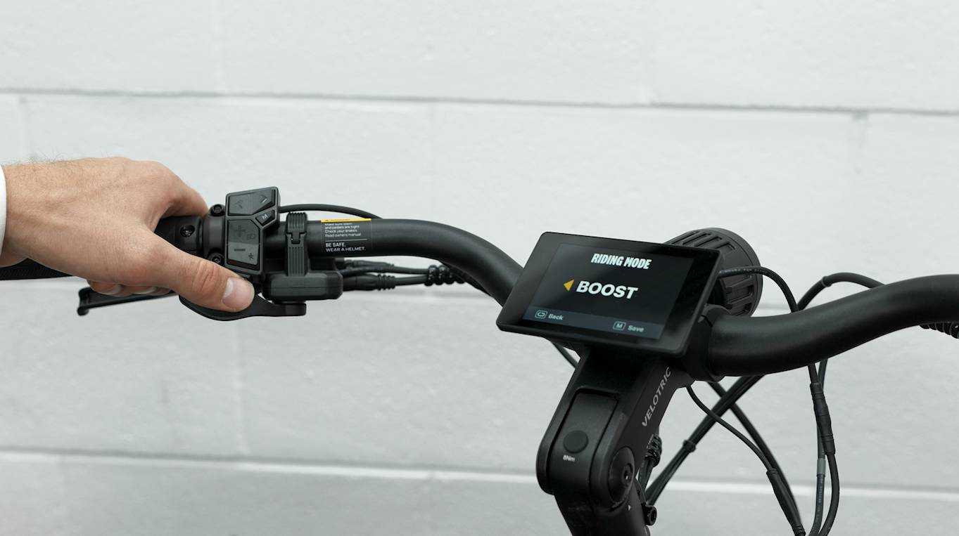

Speed settings and e-bike class
Fact check

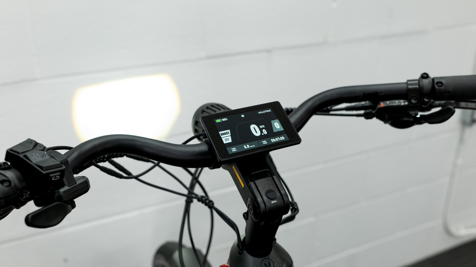

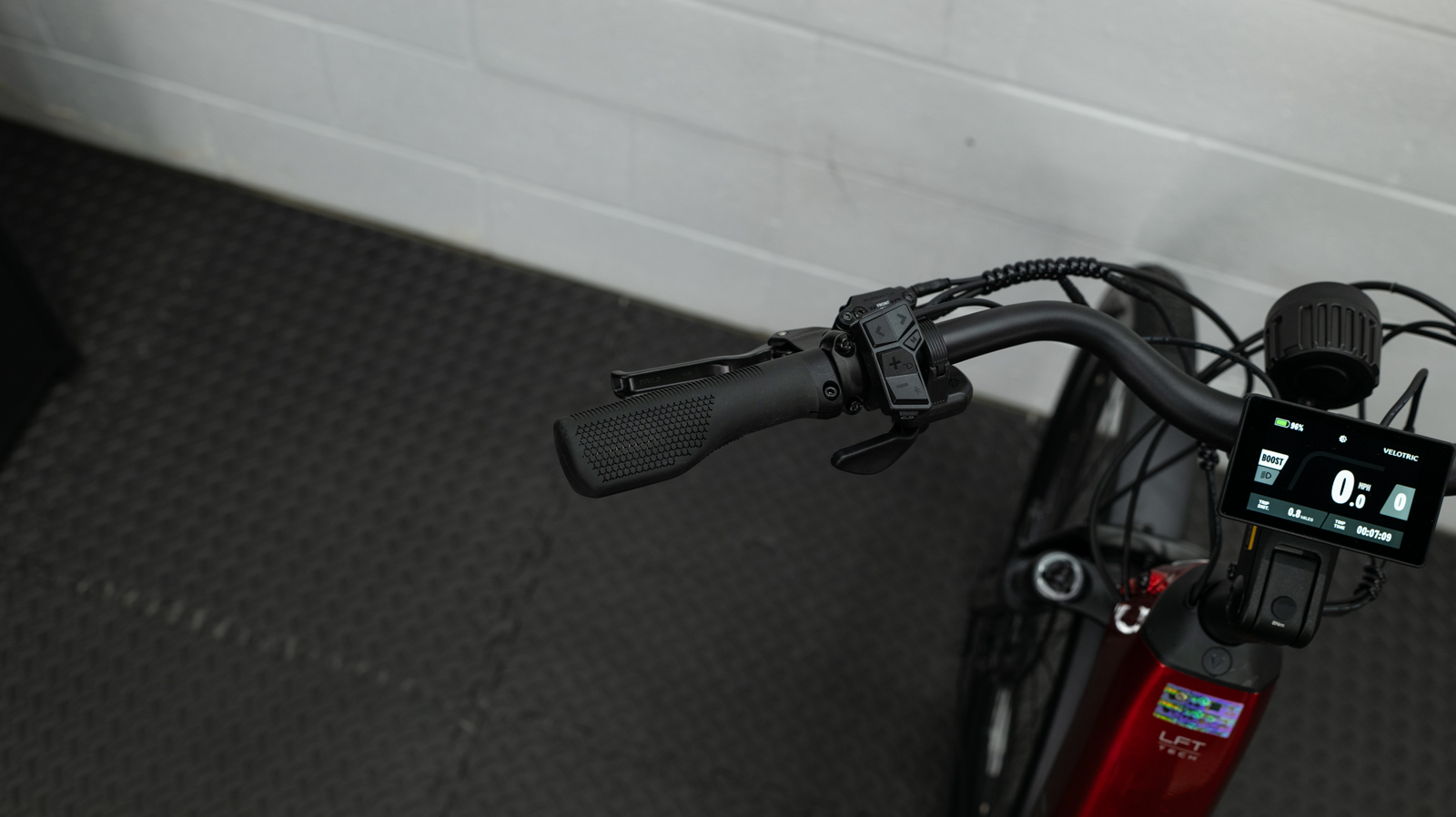

The Discover 2 ships with a 20 mph limit, and it can be set from 12 to 28 mph in 1 mph steps. With the throttle fitted, it is a Class 2 e-bike. Remove the throttle, and it is a Class 1 at 20 mph or a Class 3 at 28 mph. Velotric's instructions explain each setup, and class stickers for the frame come in the box. Changing the speed limit means stopping to open the advanced settings.

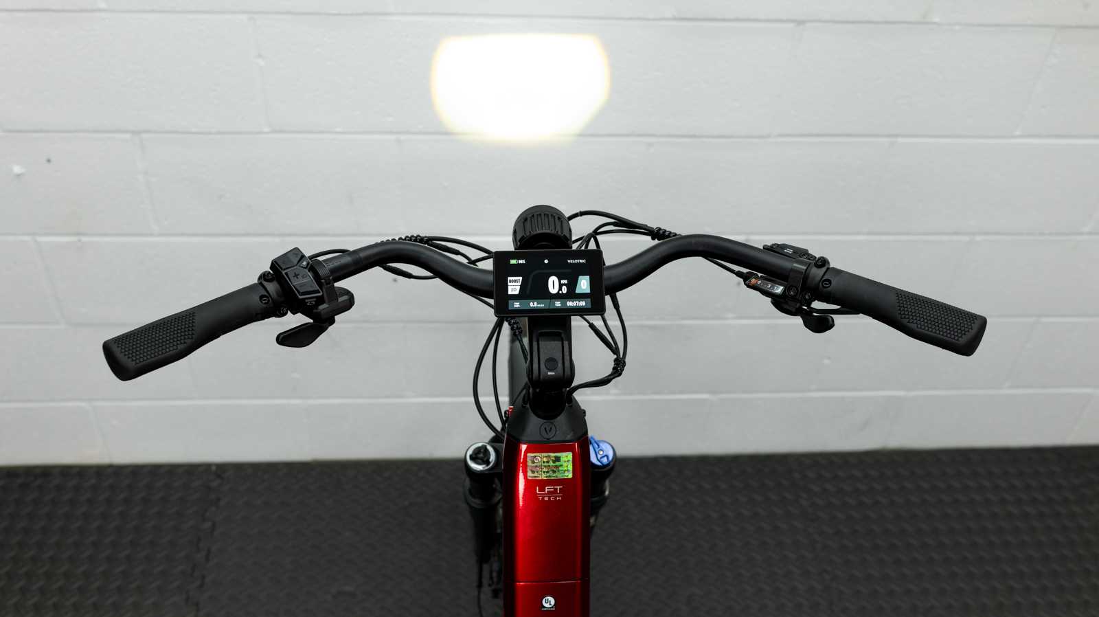

The Velotric Discover 2's left grip with the control pad and the thumb throttle, and the color display above the stem
The left grip: the control pad, with the thumb throttle below it.
✓ Class 1, 2, or 3 from the display and a removable throttleTop speed:  20 mph as shipped, 12–28 mph adjustable (claimed)Assist levels:  Eco, Trail, and Boost, five PAS levels eachThrottle:  thumb lever, full power or limited to the PAS level
Class 3 e-bikes are limited to 28 mph on pedal assist. Many trails and multi-use paths restrict Class 3 access, so check local rules before riding there.

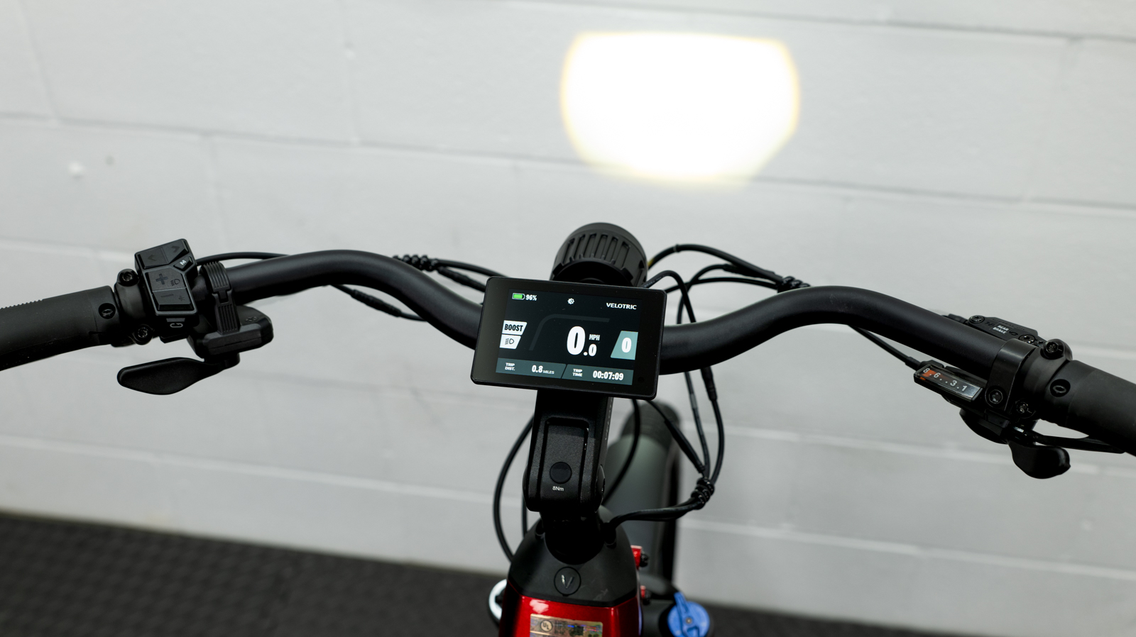

Assist engagement and cutoff
Rated
The Discover 2 can run on a cadence sensor for an easier ride or a torque sensor for a more natural pedaling feel and a better workout. Cruise control, set with the ride-mode button, can be switched off in the settings.

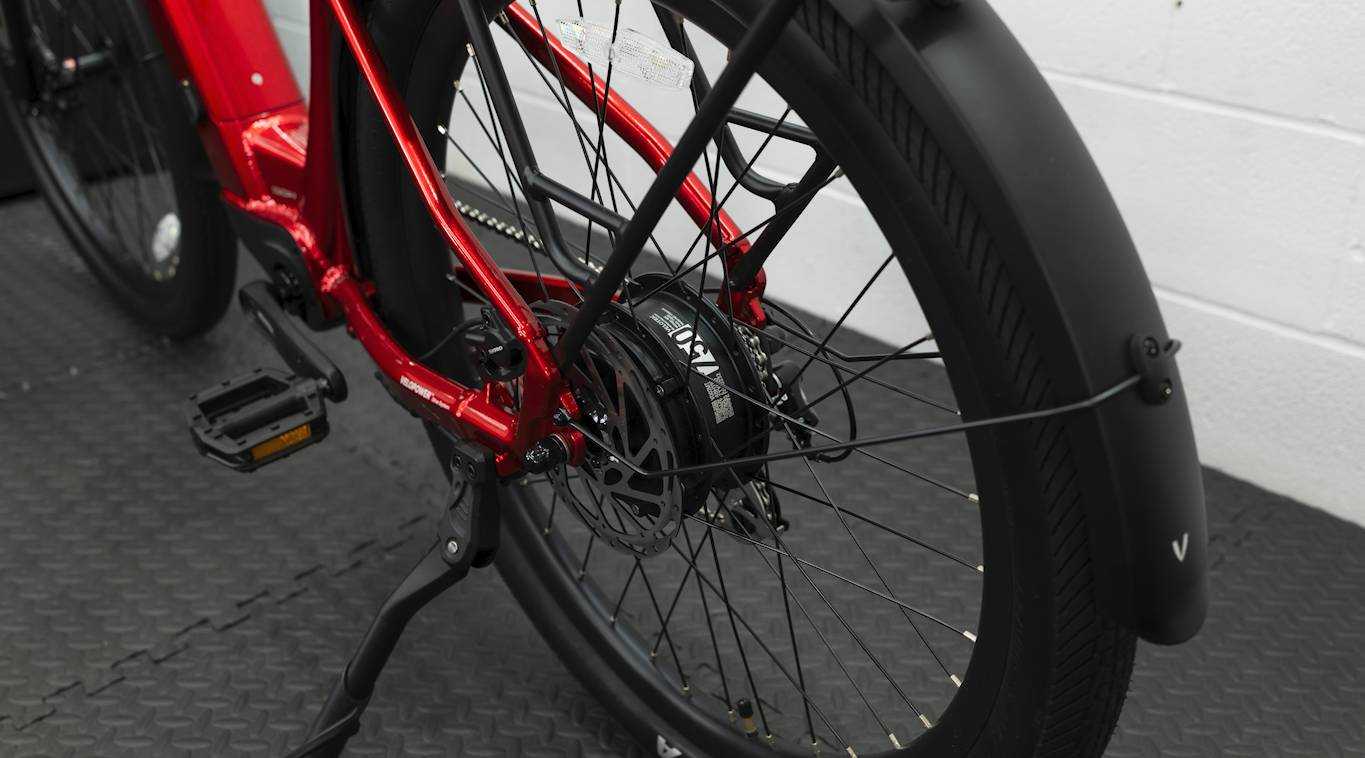

The Velotric Discover 2's 750W rear hub motor behind the cassette, close up in the studio
The 750W rear hub motor: 1,100W peak and 75 Nm, claimed.
Motor engagement5/5Quick to respond from a standstill in torque mode.
Assist cutoff behavior5/5A smooth, unobtrusive taper at the speed limit.

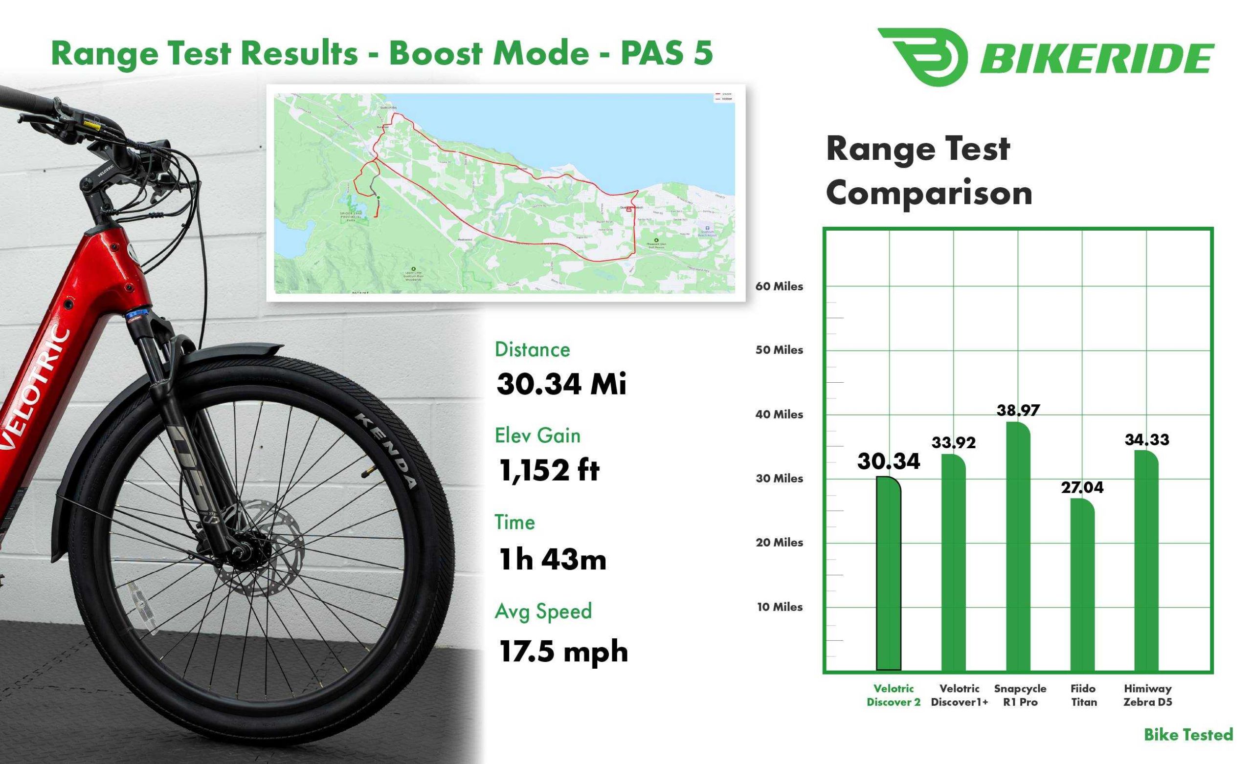

Range Test 1: Max Assist (Boost, PAS 5, 20 mph limit)
Measured
On our standard loop at maximum assist (Boost mode, PAS 5) the Discover 2 lasted 30.34 miles with 1,152 feet of elevation gain, in 1 hour 43 minutes at a 17.5 mph average, and it held its speed well to the end. That is 2% above the 29.7-mile average of the commuter e-bikes we have tested and fourth of the five max-assist runs in this comparison group.
Scott on a paved road below the mountains.
Range at maximum assist
Miles · longer is better
Aventon Level 4 REC44.20 mi
Himiway A739.17 mi
Heybike Hybrid32.45 mi
Velotric Discover 230.34 mi
Lectric XPress 75028.36 mi
Velotric Discover 2Comparison bikesAverage of similar bikes (29.7 mi)
Discover 2, Boost: 30.34 mi · 1,152 ft climbed · 1 h 43 min · 17.5 mph avgAverage of similar bikes at max assist: 29.7 mi+2% vs. similar bikesFourth of five in the group

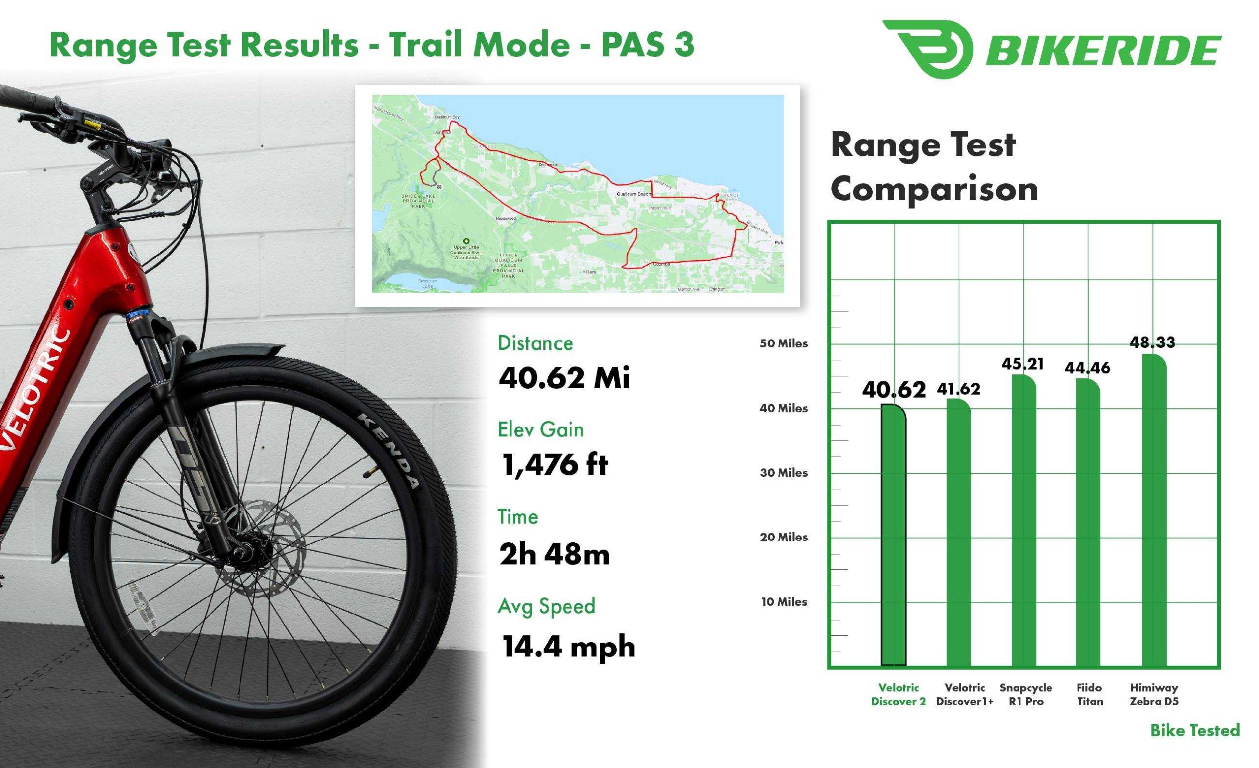

Range Test 2: Medium Assist (Trail, PAS 3, 20 mph limit)
Measured
In Trail mode at PAS 3 the Discover 2 lasted 40.62 miles, with 1,476 feet of elevation gain, in 2 hours 48 minutes at a 14.4 mph average. That is about ten miles more than at maximum assist, 6% below the 43.2-mile average of the commuter e-bikes we have tested at medium assist, and second of the three medium-assist runs in this comparison group.
Scott on a dirt path through the forest.
Range at medium assist
Miles · longer is better · the Level 4 REC and the Heybike Hybrid have no medium-assist run
Himiway A7 PAS Tour45.77 mi
Velotric Discover 240.62 mi
Lectric XPress 750 PAS 328.56 mi
Velotric Discover 2Comparison bikesAverage of similar bikes (43.2 mi)
Discover 2, Trail: 40.62 mi · 1,476 ft climbed · 2 h 48 min · 14.4 mph avgAverage of similar bikes at medium assist: 43.2 mi−6% vs. similar bikesSecond of three medium-assist runs in the group

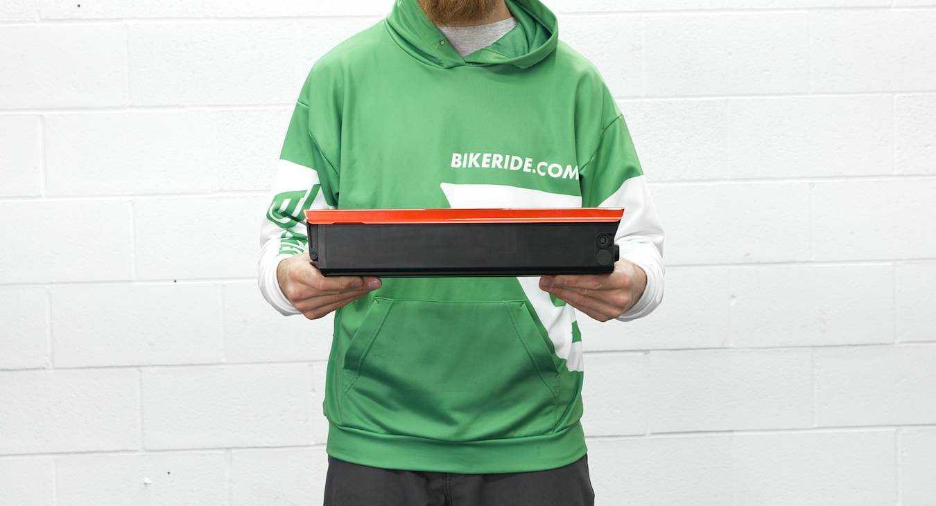

The color-matched 48V 14.7Ah battery (705.6 Wh) is a bit small for a 750W motor, but the range is still good. Turn the key and it pops up and lifts out, with a flip-out handle for carrying. Refitting it is easy, and the key isn't needed to lock it in. The display shows the charge as a percentage, which proved accurate in our testing, and the motor gave full power down to 0%, then another half mile of assistance.
Once unlocked, the battery pops up and lifts out of the top of the down tube.
✓ Removable battery, key lock✓ Charges on or off the bike✓ UL 2849 electrical system, UL 2271 battery✓ IPX6 bike, IPX7 battery
Charge-gauge accuracy5/5An accurate percentage readout, and full power down to 0%.
Battery removal and locking5/5Turn the key, the pack pops up, and it lifts straight out.

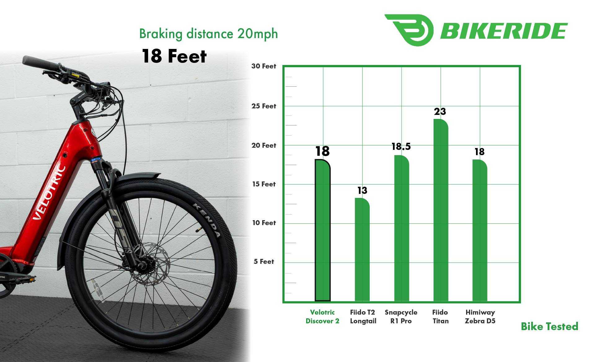

Brake test: 20 to 0 mph
Measured

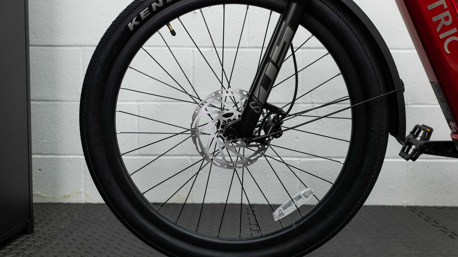

The Tektro hydraulic discs, with two-piston calipers and 180 mm rotors, stopped the Discover 2 from 20 mph in 18 feet. That is 1.9 feet shorter than the average of the commuter e-bikes we have tested and second in this comparison group. The brakes needed no major adjustment out of the box and stopped with plenty of power.
The full stop from 20 mph, seen from above: 18 feet.
Braking distance, 20–0 mph
Feet · shorter is better
Himiway A723 ft
Aventon Level 4 REC22 ft
Lectric XPress 75020 ft
Velotric Discover 218 ft
Heybike Hybrid17.5 ft
Velotric Discover 2Comparison bikesAverage of similar bikes (19.9 ft)
Where the Discover 2 sits: braking distance
Compared to the 23 commuter e-bikes we have tested
Discover 2
16.5 ft (best commuter result)Braking distance25.5 ft (longest)
Discover 2: 18 ftAverage of similar bikes: 19.9 ftSecond-shortest in the group
The Velotric Discover 2's front Tektro caliper and 180 mm rotor on the suspension fork, with the Kenda tire
The front Tektro caliper on its 180 mm rotor.
Brake feel and modulation5/5Plenty of power and good modulation, with no major adjustment needed out of the box.

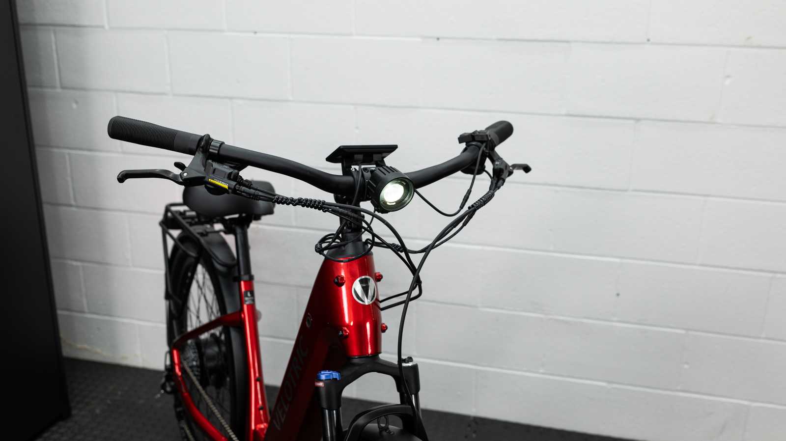

The integrated headlight is rated by Velotric at 130 lux. The taillight, built into the rear rack, runs steady or flashing, with an optional brake light and built-in turn signals, and an icon on the display shows when a signal is on. An auto-light function switches the lights on and dims the display when it gets dark.
The taillight is built into the rear rack.
The Velotric Discover 2's cockpit seen from the saddle with the headlight on, its beam lighting the studio wall ahead
The headlight on, seen from the saddle. Velotric rates it at 130 lux.
Brake light: YesTurn signals: YesAuto light: Yes

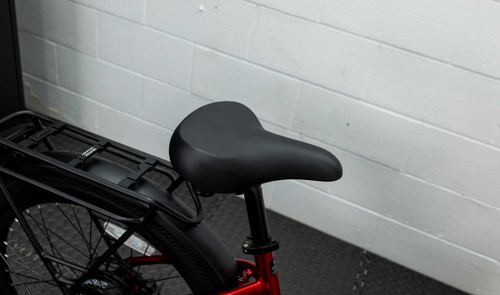

The Velotric Discover 2's wide, padded saddle from the side in the studio
The wide, well-padded saddle.
Saddle comfort5/5Wide, well padded, and comfortable.

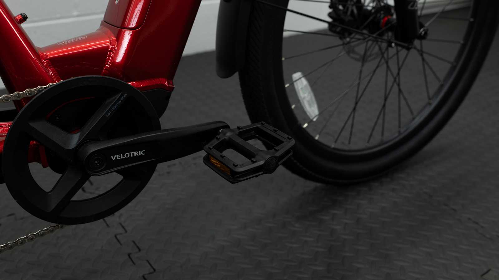

Grips and pedals4/5Comfortable lock-on grips, and wide plastic pedals with good grip.

The swept-back bar is 700 mm wide on the Large (680 mm on the Regular), on a 90 mm stem with 60 degrees of angle adjustment.
The Velotric Discover 2's adjustable stem and swept-back bar from the side, with the display mounted above the bar
The angle-adjustable stem and swept-back bar, with the display mounted above them.
Cockpit adjustability5/5A stem with 60 degrees of angle adjustment.

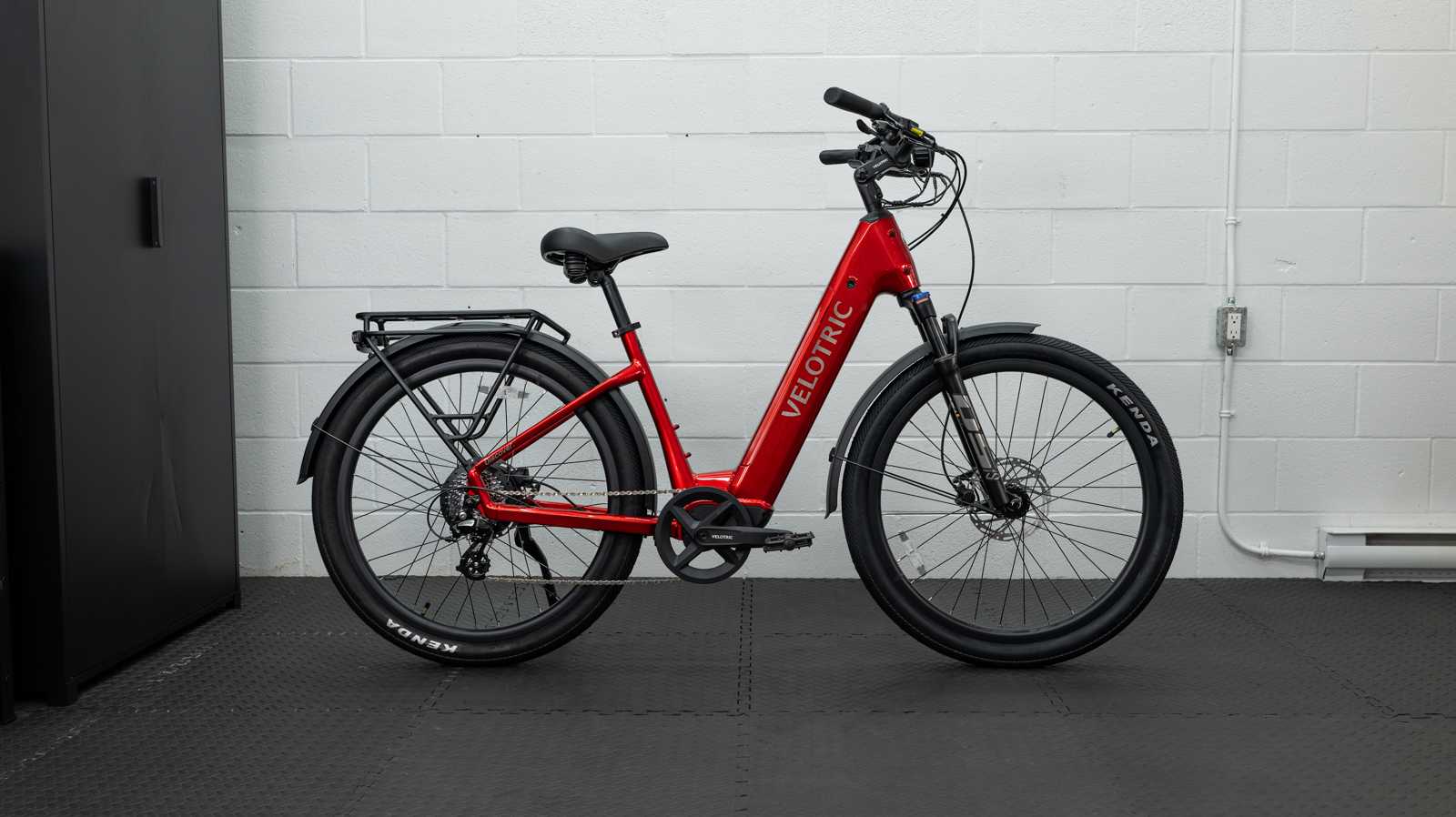

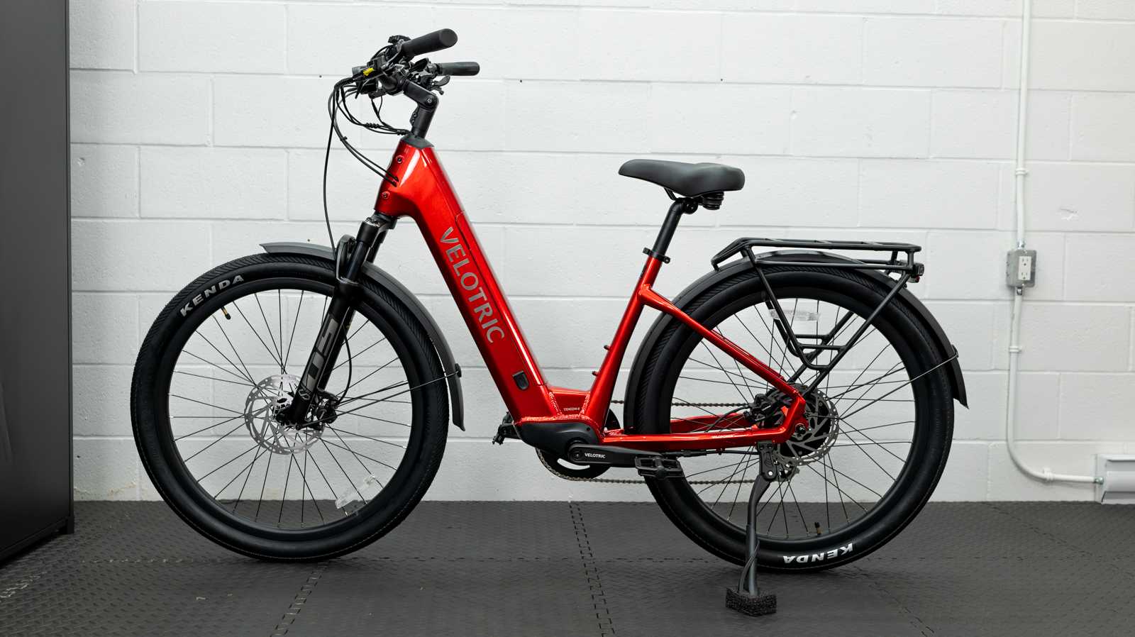

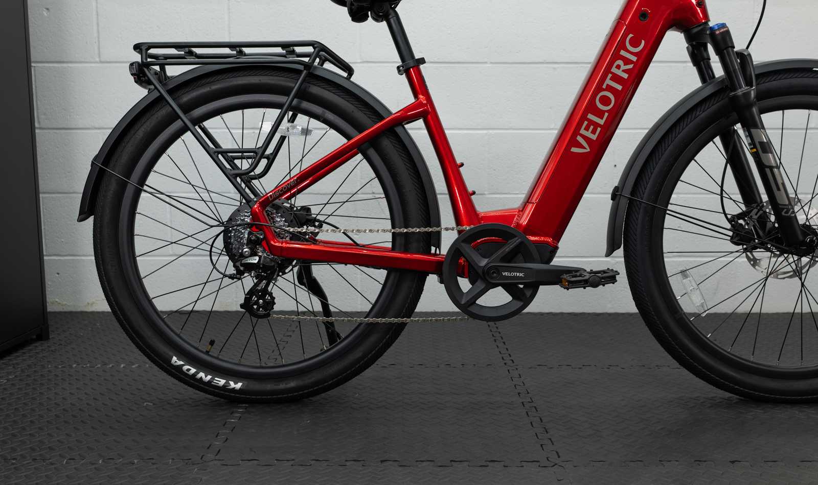

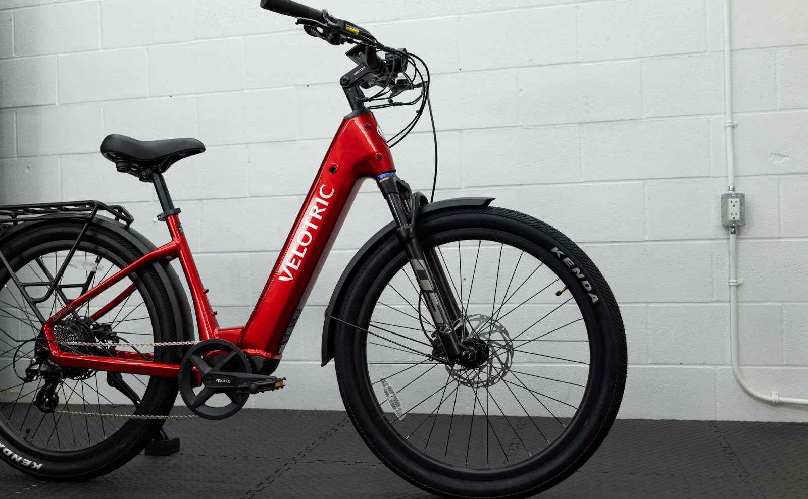

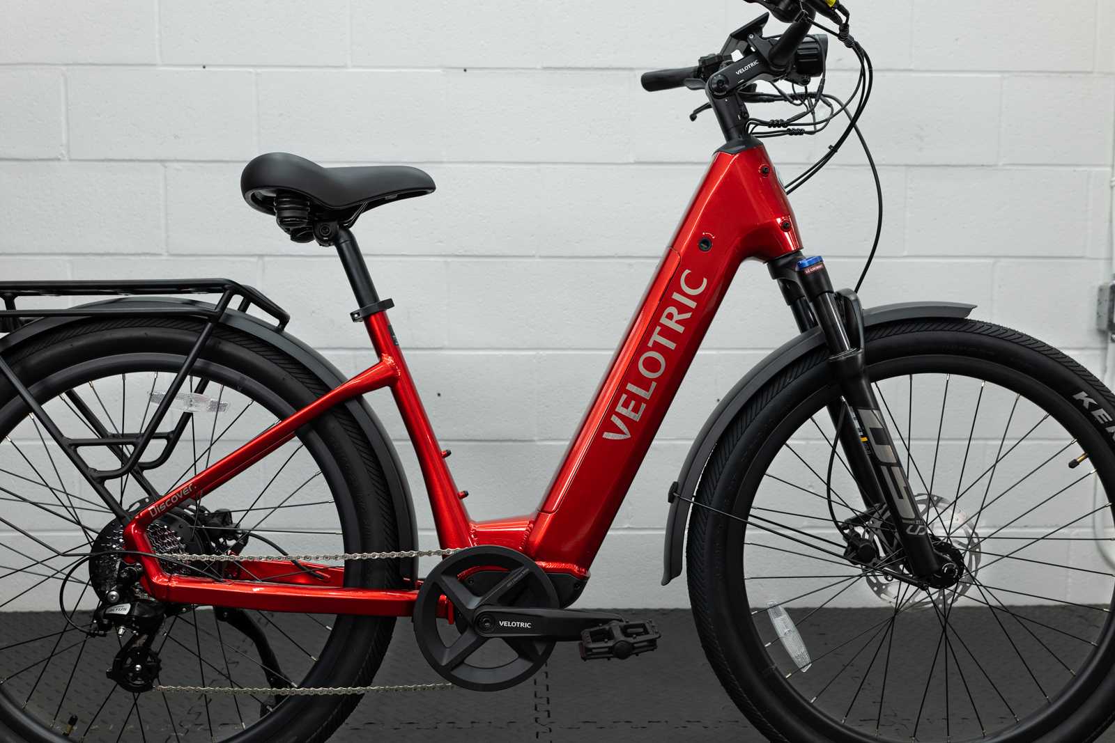

The 6061 aluminum step-through frame feels robust despite its very low step-over, and it is nicely finished, with really nice paint in four colors. Our test bike is Cherry Crimson, with the battery color-matched to the frame. There are four mounts on the head tube for Velotric's front rack and a set of bottle-cage bosses on the seat tube.
The Velotric Discover 2's step-through frame in Cherry Crimson from the drive side, with the color-matched battery in the down tube
The step-through frame in Cherry Crimson, with the color-matched battery in the down tube.
Frame welds and finish5/5Robust and nicely finished, with really nice paint.

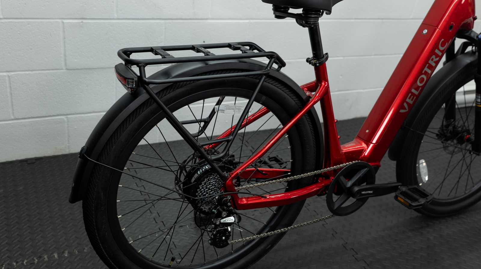

Velotric rates the rack for 66 lb, and it takes MIK HD accessories, from panniers and cargo boxes to child seats. The bike can carry 371 lb of rider and cargo, but with the rack limited to 66 lb few riders will come close.
The Velotric Discover 2's rear rack with the built-in taillight lit, above the full-coverage rear fender
The rear rack, with the taillight built in, over the full-coverage fender.

The large, full-color 3.5-inch display sits in landscape format a few inches above the middle of the bar. It shows a lot of information, but it is nicely organized and easy to see in a range of lighting conditions. Each of the seven buttons on the control pad at the left grip has icons for its main and long-press functions, such as the lights and walk assist.
Ride mode and assist level are easy to change on the fly. The advanced settings have clear names and are easy to adjust, and the manual explains each of them in detail. A USB-C port sits under the control pad, behind a plastic cover.
The seven-button control pad at the left grip, next to the display.
Display readability5/5Large, well organized, and easy to see in a range of light.
Controls5/5Clear icons on every button, and sensible, well-named menus.

Pairing the Velotric app is simple: choose Connect to App in the advanced menu and scan the QR code on the display. Apple Find My pairs just as easily, and a firmware update through the app took 10 minutes. The app is nicely laid out and easy to use. The display doesn't allow you to switch between the torque and cadence sensors, only the app.
Three screens of the Velotric app: the home screen, the bike settings with Sensor Swap, and the firmware update page
The Velotric app: the home screen, the bike settings with Sensor Swap, and a firmware update.
✓ Over-the-air updates by BluetoothSensor switch:  app only✓ Speed limit and other settings on the display
Companion app4/5Easy to pair and a pleasure to use, but needed for the sensor switch.

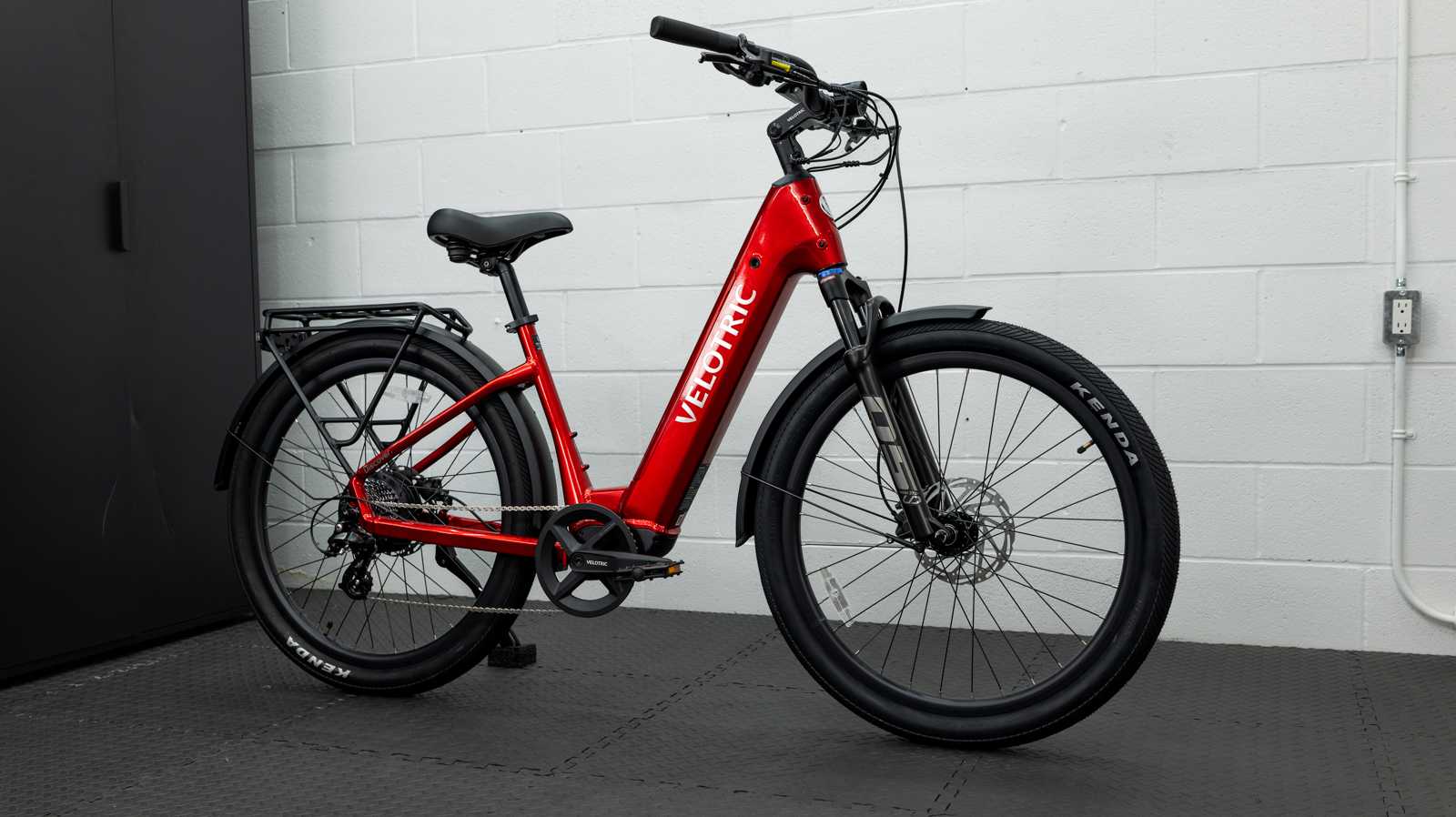

The Velotric Discover 2 from the front three-quarter in the BikeRide studio
The Discover 2 in Cherry Crimson, one of its four colors.

0–20 mph, throttle onlyvs. 33 other 750W hub-drive e-bikes9.0 s9.6 s10.7 s
0–20 mph, max pedal assistvs. 34 other 750W hub-drive e-bikes7.0 s8.1 s8.4 s
Gradual hill climb, 20 mph capvs. 21 other 750W hub-drive e-bikes3:083:093:18
Steep hill climbvs. 31 other 750W hub-drive e-bikes2:432:282:36

Range (max assist, Boost)vs. 22 other commuter e-bikes30.34 mi29.7 mi29.6 mi
Range (medium assist, Trail)vs. 12 other commuter e-bikes40.62 mi43.2 mi39.5 mi
Range vs claimedvs. 21 other commuter e-bikes54%60%54%

Brake test, 20–0 mphvs. 22 other commuter e-bikes18.0 ft19.9 ft19.3 ft
