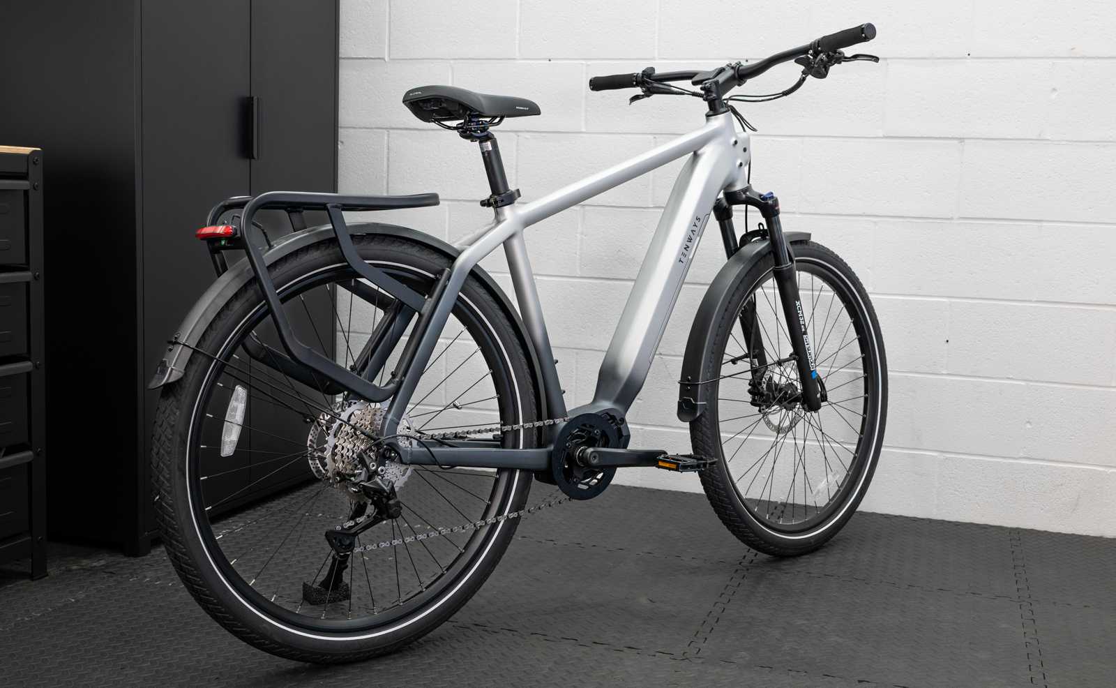

What Is the Tenways AGO X?
Tenways calls the AGO X a real all-rounder for daily errands and off-road leisure rides. As a Class 1 e-bike there’s no throttle, and assistance is limited to 20 mph. It has a 250W mid-drive Bafang motor with 80 Nm of torque, and a 504Wh battery.
Add a Shimano Deore 10-speed drivetrain, 29” by 2.25” CST tires, and Suntour suspension fork, and this thing looks set to be fun.
Tenways says the motor is optimized for fast acceleration, carrying heavy loads, and climbing steep slopes. It also claims the AGO X offers the same performance as bikes costing twice as much.
So, does the AGO X deliver?

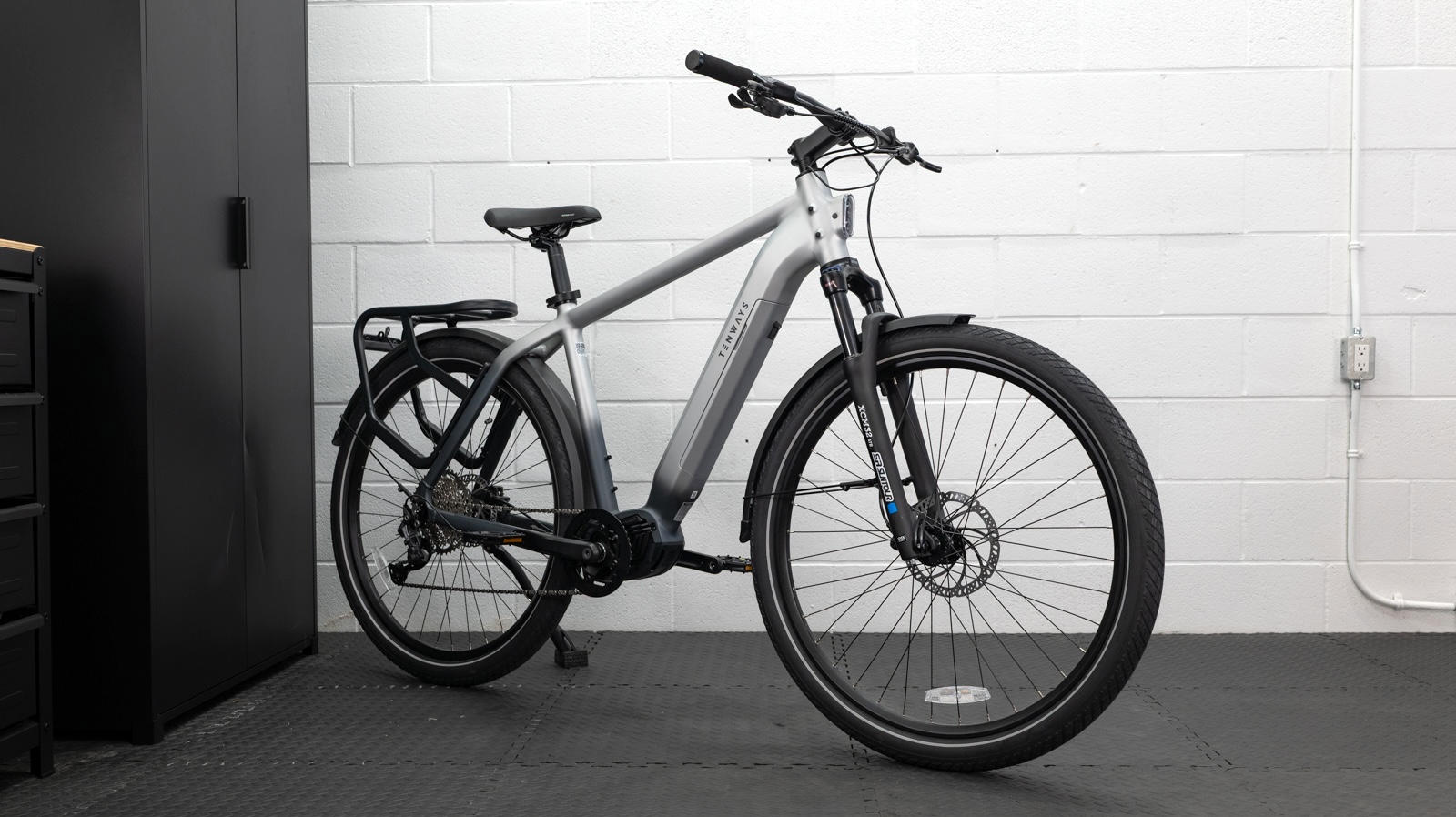

Appearance

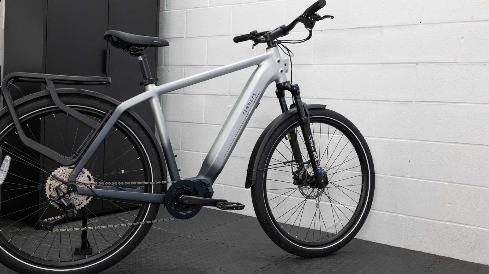

The bike’s stylish appearance turns heads on the road. While I was testing it, several passers-by complimented the design. The sleek paint and clean welds, combined with a pleasing frame design, immediately inspire a feeling of quality.
The finish features a stunning fade from silver up top to a darker tone lower on the frame. The motor and battery are integrated nicely into the frame.

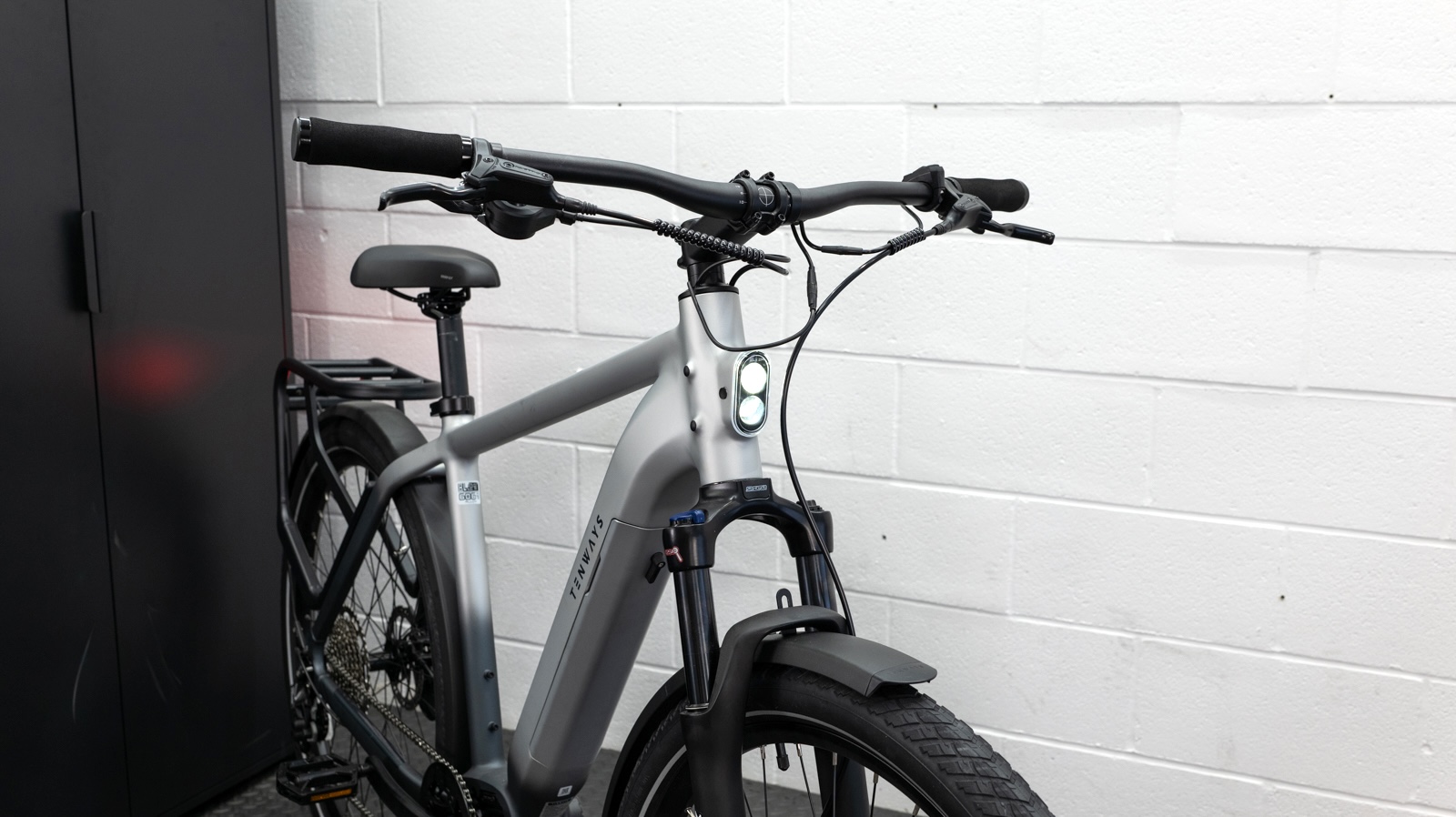

The AGO X features an integrated headlight at the front.

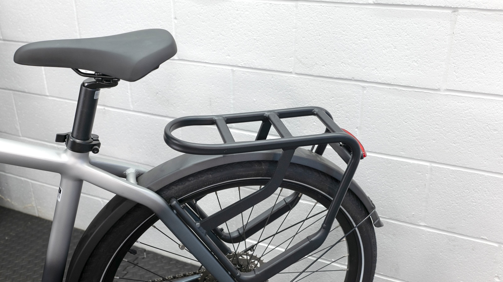

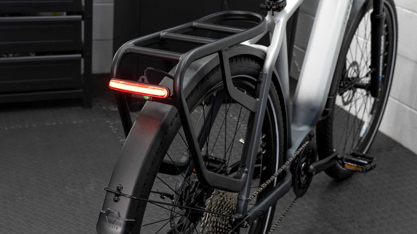

At the back, an unobtrusive, integrated tailight is mounted on a stylish rear rack, which is fixed to the seat stays in a visually appealing manner.

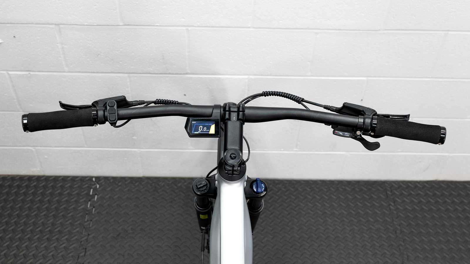

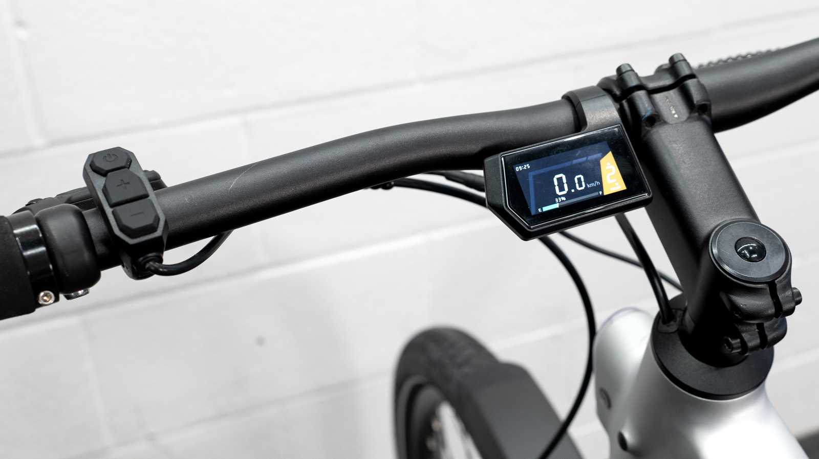

The display and 3-button control pad are streamlined and unobtrusive, but offer plenty of information in an easy-to-access format.
The advanced menu is easy to use, with clear item names and descriptions. You won’t need a manual to understand what you’re tweaking, and you can access the advanced menu from the bike’s main display without needing the app.
The AGO X also has a four-digit PIN code to prevent unauthorized use, and you can use the app to upload navigation directions via Bluetooth to the onboard display for easy navigation.
I love this feature, as it lets you keep your phone in your pocket and guides you to your destination in a non-distracting manner.

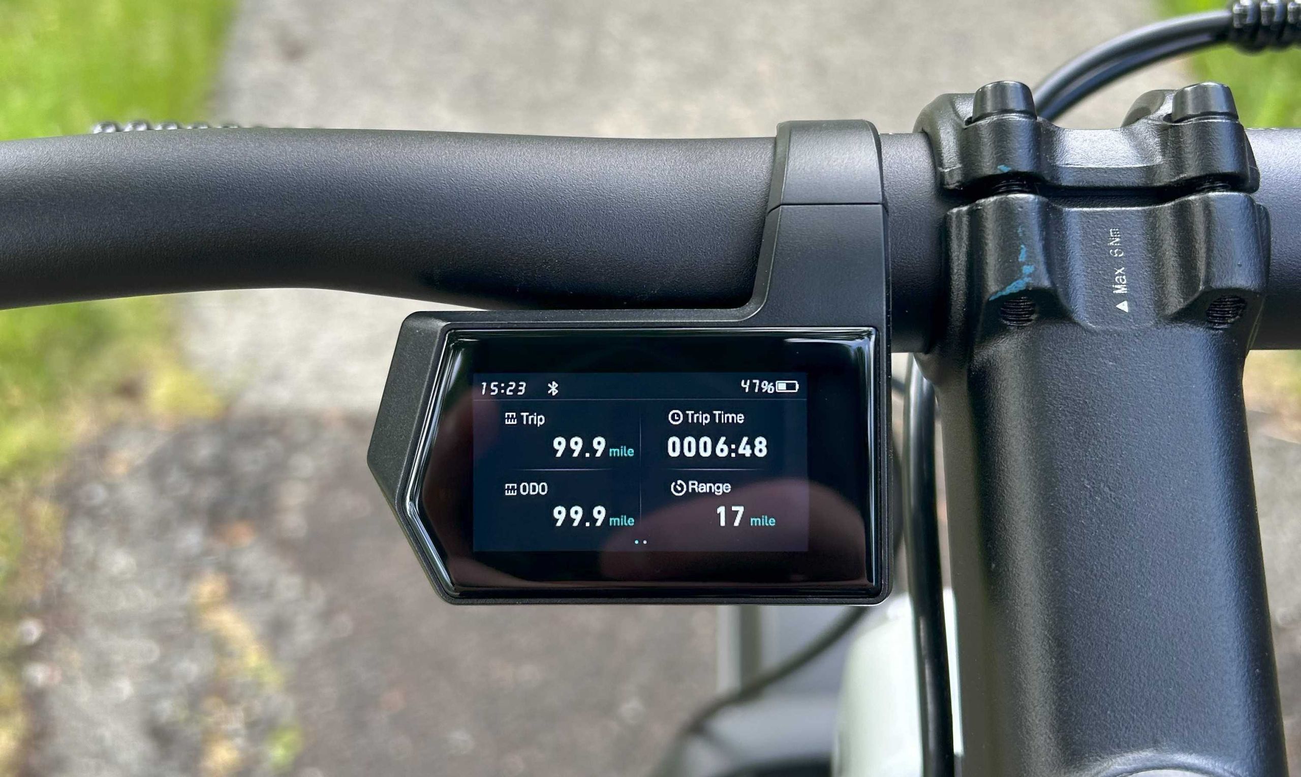

The included estimated-range display is a nice feature, but in my testing, it was so inaccurate that it was of little use. Worse still, it overestimated the range.
During the PAS 5 range test, with battery charge at 75%, the display said the bike could travel another 28 miles, but in the end, it managed only 18.5 miles. The total range reached during the test was 28 miles, so the estimate was off by a huge margin.
When battery charge was high, the display gave a hopelessly ambitious range, and even though it improved as battery charge fell, it would be much more useful to have a more realistic idea of range, especially when first heading out.

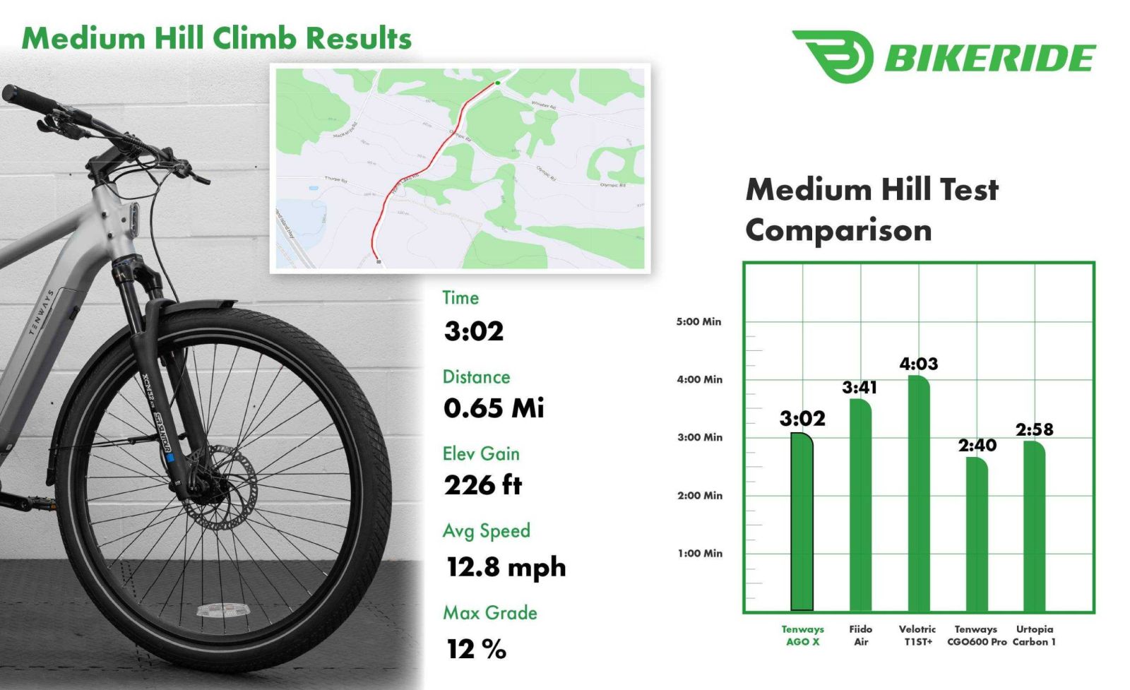

Steep Hills
Tenways says the AGO X and its Bafang M410 mid-drive motor are “tailor-made for steep slopes and heavy loads.” With a 250W mid-drive motor and 80Nm of torque, I expected it to trounce other e-bikes with similar specs but less torque.
While it did outperform the Fiido Air and Velotric T1ST+ on both hill climbs. I was surprised when Tenway’s own CGO600 Pro, with its 350W, 40Nm rear hub motor and single-speed drivetrain, easily conquered both the small and medium elevation climbs between 15-20 seconds faster.
The Urtopia Carbon 1, with its 250W – 35Nm rear hub motor and single-speed drivetrain, matched the Tenways AGO X on the medium elevation hill and beat it over the small elevation climb by a few seconds.
Mid-drive motors with higher torque outputs should outperform rear hub motors on hill climbs. However, single-speed bikes with less torque matched or beat the AGO X, with its greater torque and 10-speed drivetrain. I was disappointed by this performance.
I should mention that the Tenways’ performance is far from the worst we’ve recorded. It managed to shave a full minute off the times of our worst-performing test bikes on both climbs. So, it’s not incapable of climbing 12° slopes in a reasonable time, it just takes some extra effort.
However, considering Tenway’s claims and the motor specs, I was not overly impressed with its ability to climb steeper hills.
Anyone hoping to climb steep hills a little faster may prefer the CGO600 Pro, which is both cheaper and lighter, but doesn’t have a cargo rack or suspension fork.

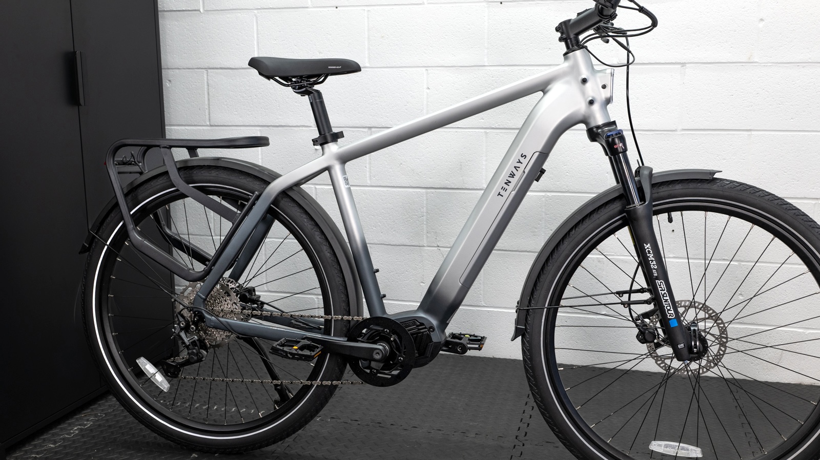

The AGO X has a stylish aluminum frame, which comes in three sizes for riders from 5’3” to 6’5″, according to Tenways. I tested the XL frame, which is supposed to fit riders from 5’11 ” to 6’5”.
This bike appears to be well made, with an excellent finish, and a nice, clean appearance, thanks in part to internal cable routing. Of course, hiding the cables inside the frame can make servicing the bike more difficult, but it does protect the cables and enhance the bike’s looks.

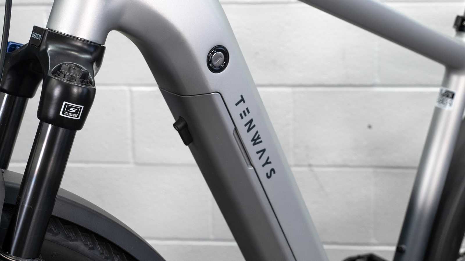

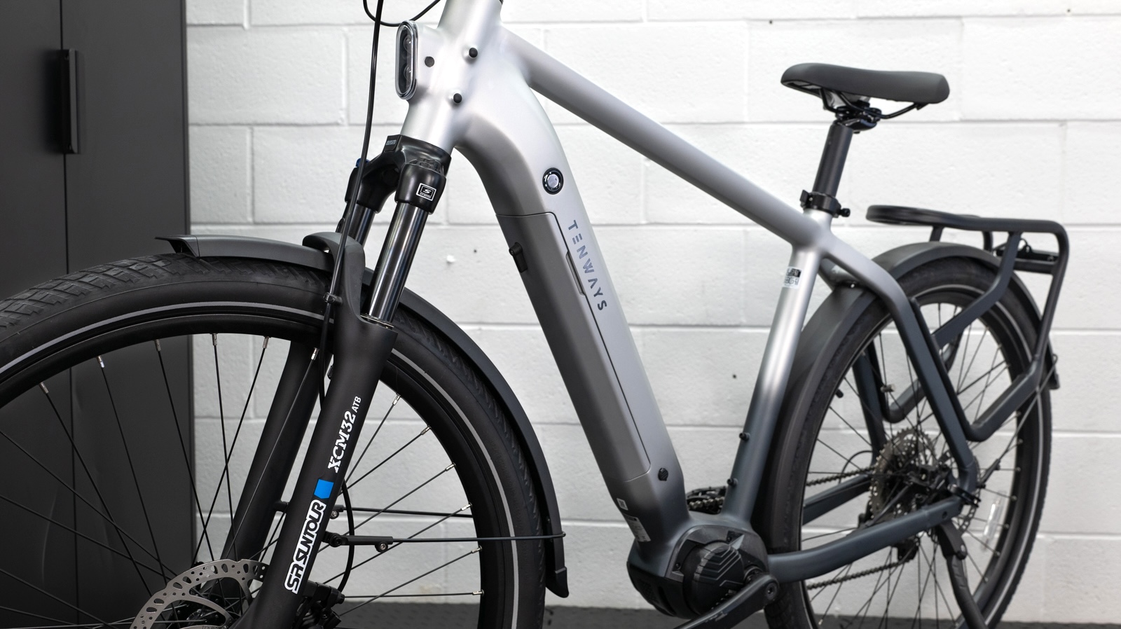

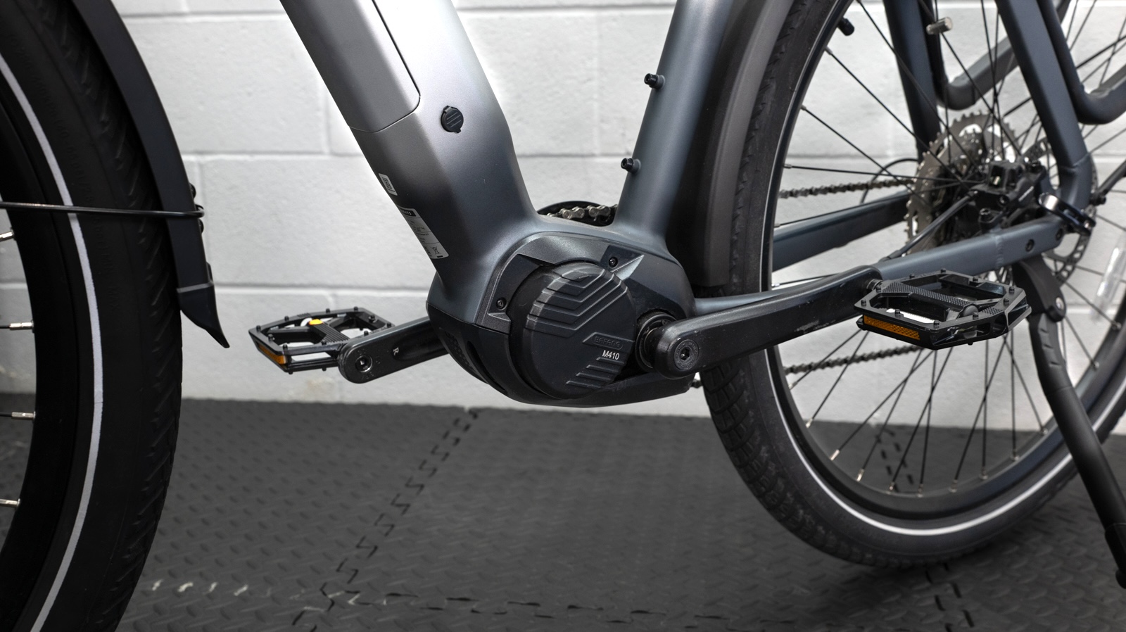

In the middle of the frame, we find the Bafang M410 mid-drive motor, rated for a nominal 250W of power and 80Nm of torque.
That motor output is modulated by a torque sensor that’s integrated in the motor. The bike operates at 36V, with a removable 14 Ah, or 504 Wh, battery, which is paint-matched to the frame and sits inside the bottom of the downtube, with a key-operated lock keeping it secure.

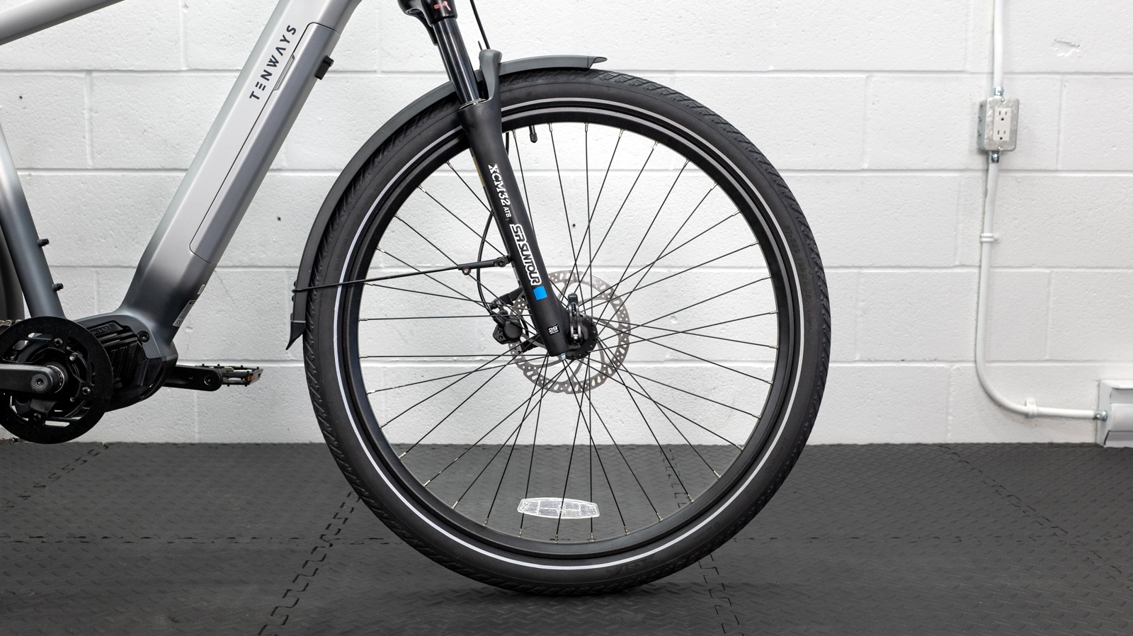

Suspension and Wheelset

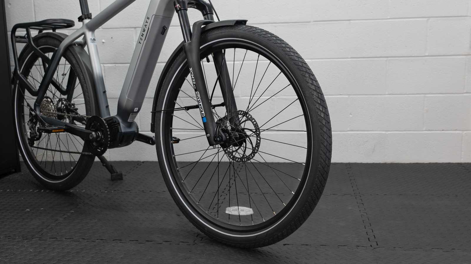

Up front, there’s a 110mm Suntour suspension fork with preload adjustment and a lockout.
The AGO X has 29” spoked aluminum rims, which wear 2.25” CST tires. The tires have a light, city-style tread pattern and feature puncture protection. Quick-release axles at both ends make removing the wheels a simple, tool-free process

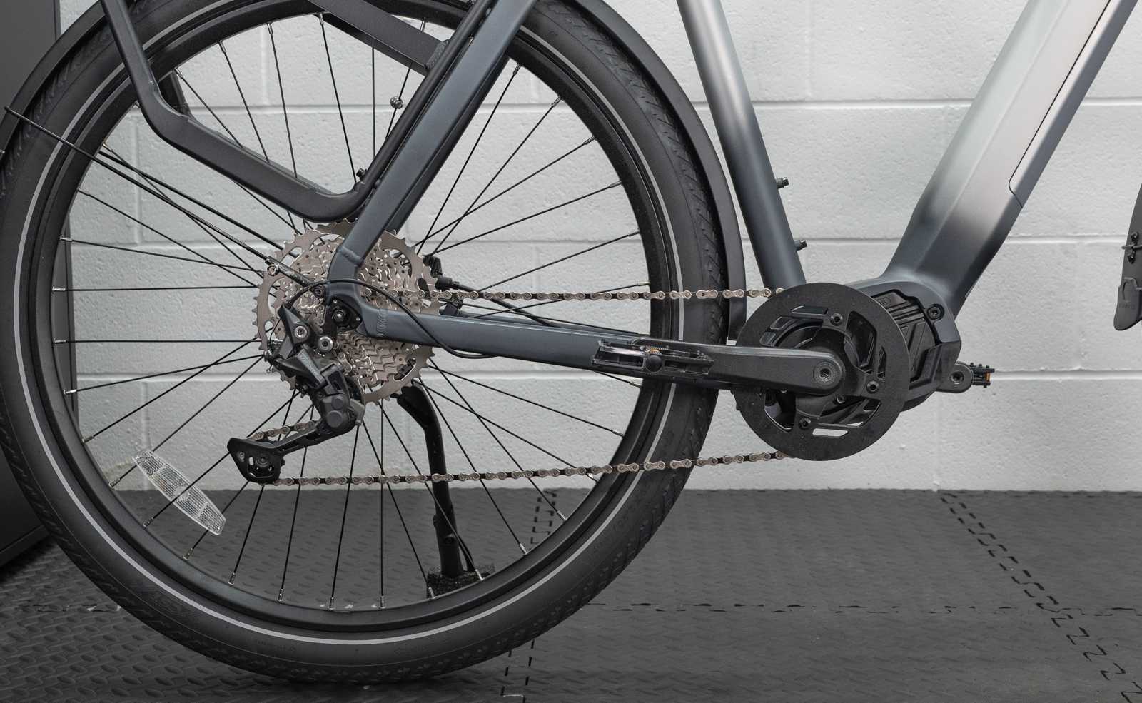

Drivetrain and Brakes

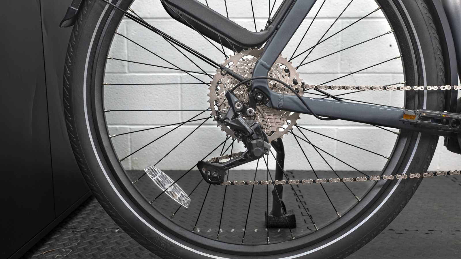

The Shimano Deore 10-speed drivetrain has a 38T chainring with a single-sided guard at the pedals and a 11-46T cassette at the back. This combination provides a wide gearing range of 100% to 430%, and is an impressive step up from the 7-speed setups I see so often.

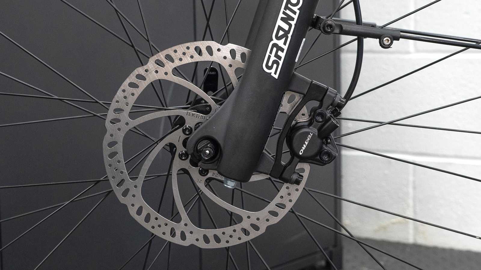

Stopping power is provided by Tektro HD-M275n hydraulic brakes, with a 180mm rotor up-front and a 160mm rotor at the back, but there’s no motor cut-off, so e-bike newbies must remember to stop pedaling when they brake.

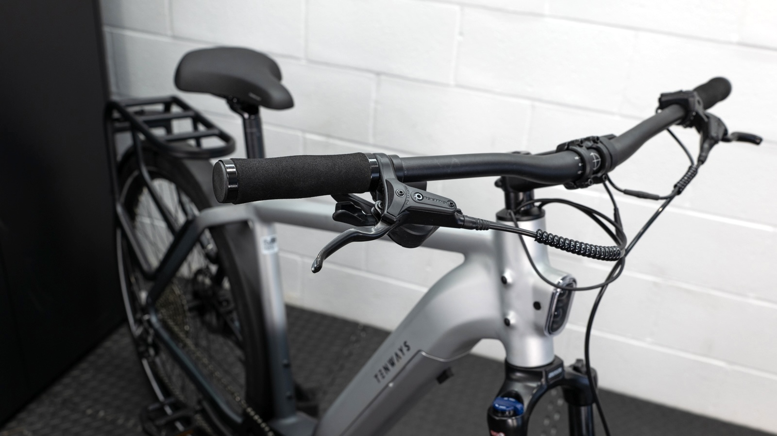

Cockpit and Touchpoints
The 760mm-wide riser bars have a slight back-sweep and are fitted with lock-on grips. There’s a streamlined 3-button control pad next to the left grip, and a 2” TFT LCD mounted in landscape format just to the left of the stem.
_S1P4516
Next to the right grip, we find a Deore trigger shifter, which has an indicator showing which gear you’re in. The other touch points are a Selle Royal ESSENZA+ saddle and a pair of plastic platform pedals.

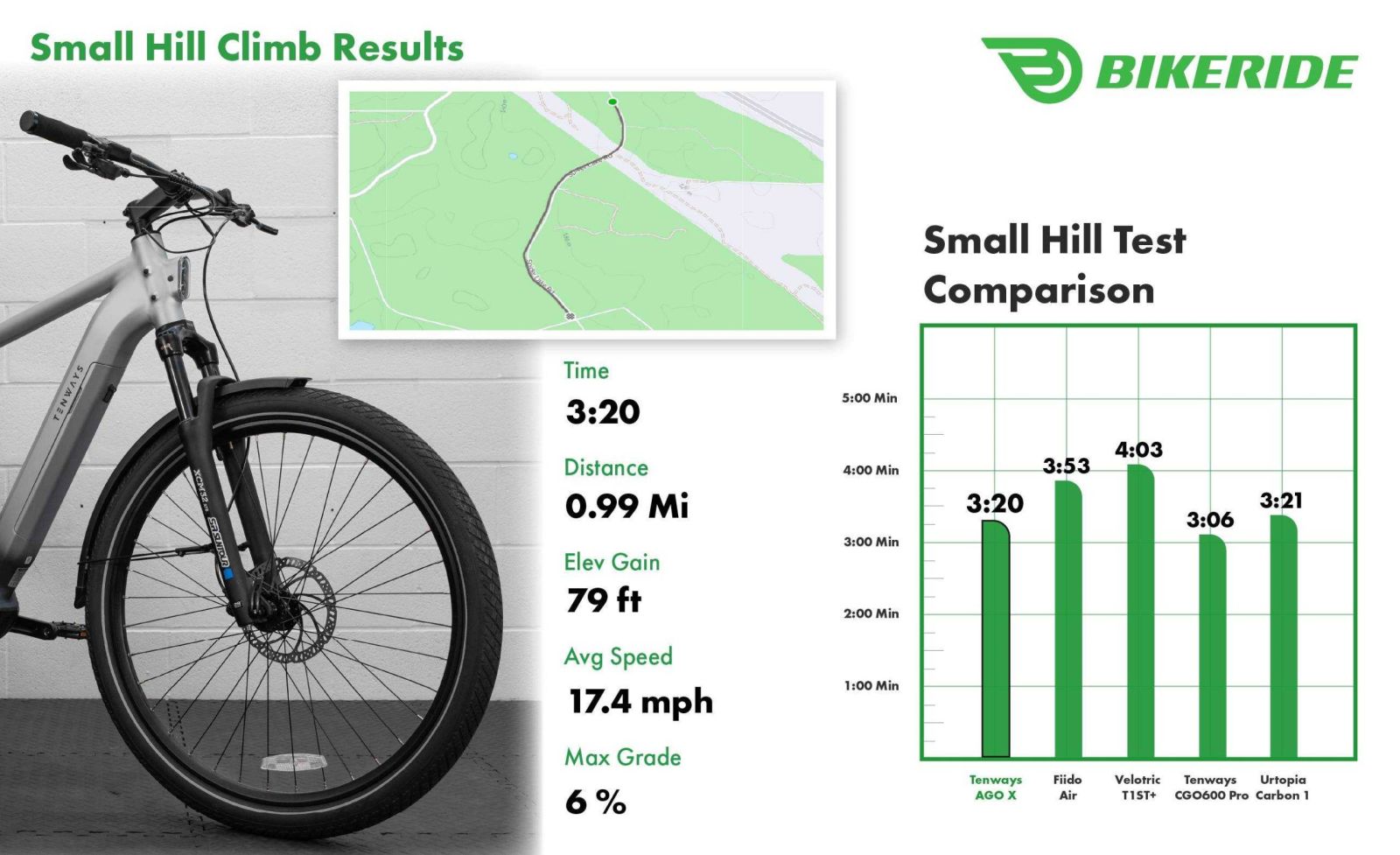

Tenways AGO X - Hill Climb Small
On our small-elevation hill test, the AGO X landed firmly in the middle of the pack, along with the Urtopia Carbon 1. The AGO X’s time of 3:20 is far ahead of the Fiido Air and Velotric T1ST+ but lags behind Tenway’s own CGO600 Pro by 14 seconds.
Tenways AGO X - Hill Climb Medium
The medium-elevation hill climb produced similar results. The AGO X easily outperformed the Fiido Air and T1ST+ by 40-60 seconds. Its ability to climb the hill a full minute ahead of the T1ST+ impressed me, but I was surprised by how hard I had to pedal, given the motor’s 80Nm of torque. I found climbing the 12° slope far from effortless. Up this hill, the Urtopia Carbon 1 beat the AGO X by 4 seconds, and the CGO600 Pro was 22 seconds faster.

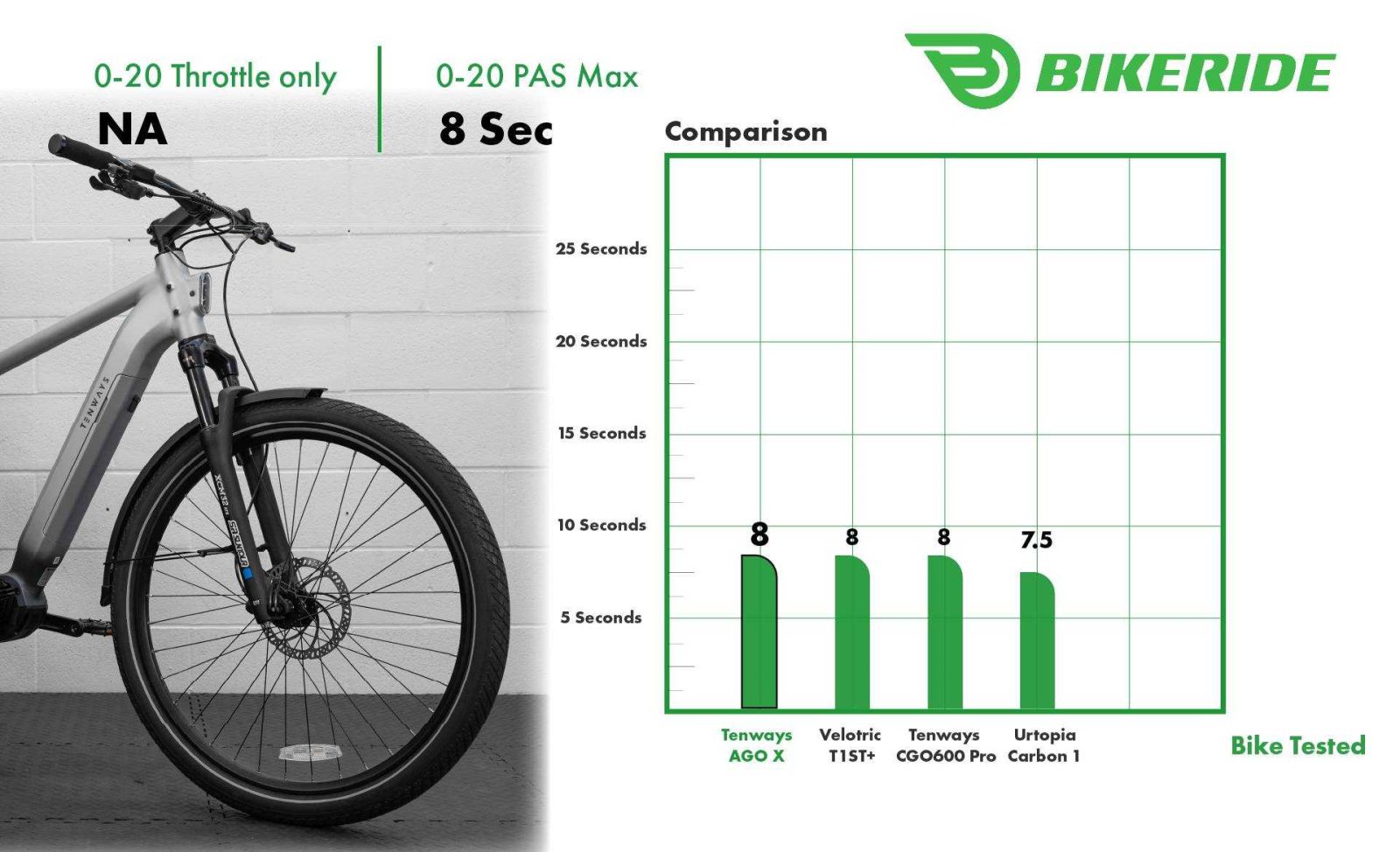

Acceleration Test
In the pedal-assist acceleration test, all of the test bikes hit 20 mph in about 7.5 to 8 seconds, and the AGO X took 8 seconds. As the AGO X has no throttle, throttle acceleration wasn’t tested.

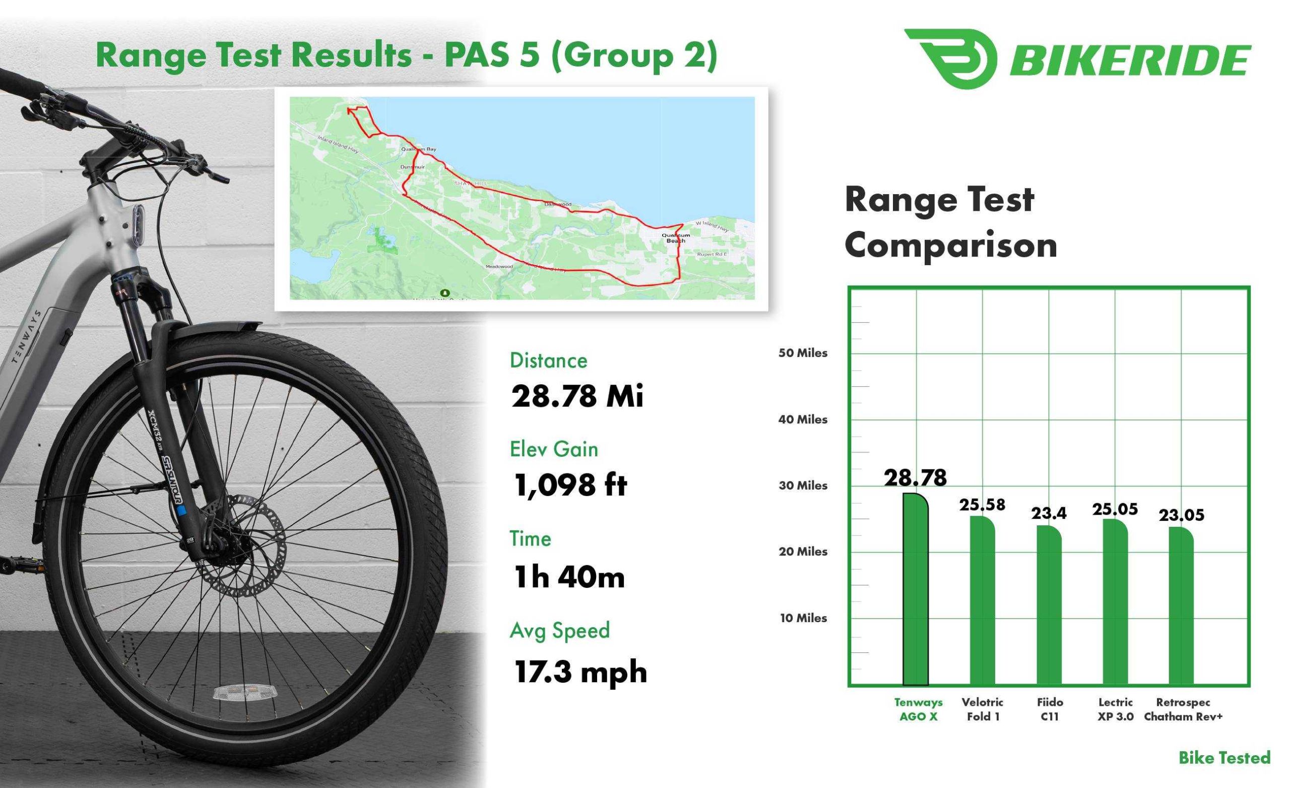

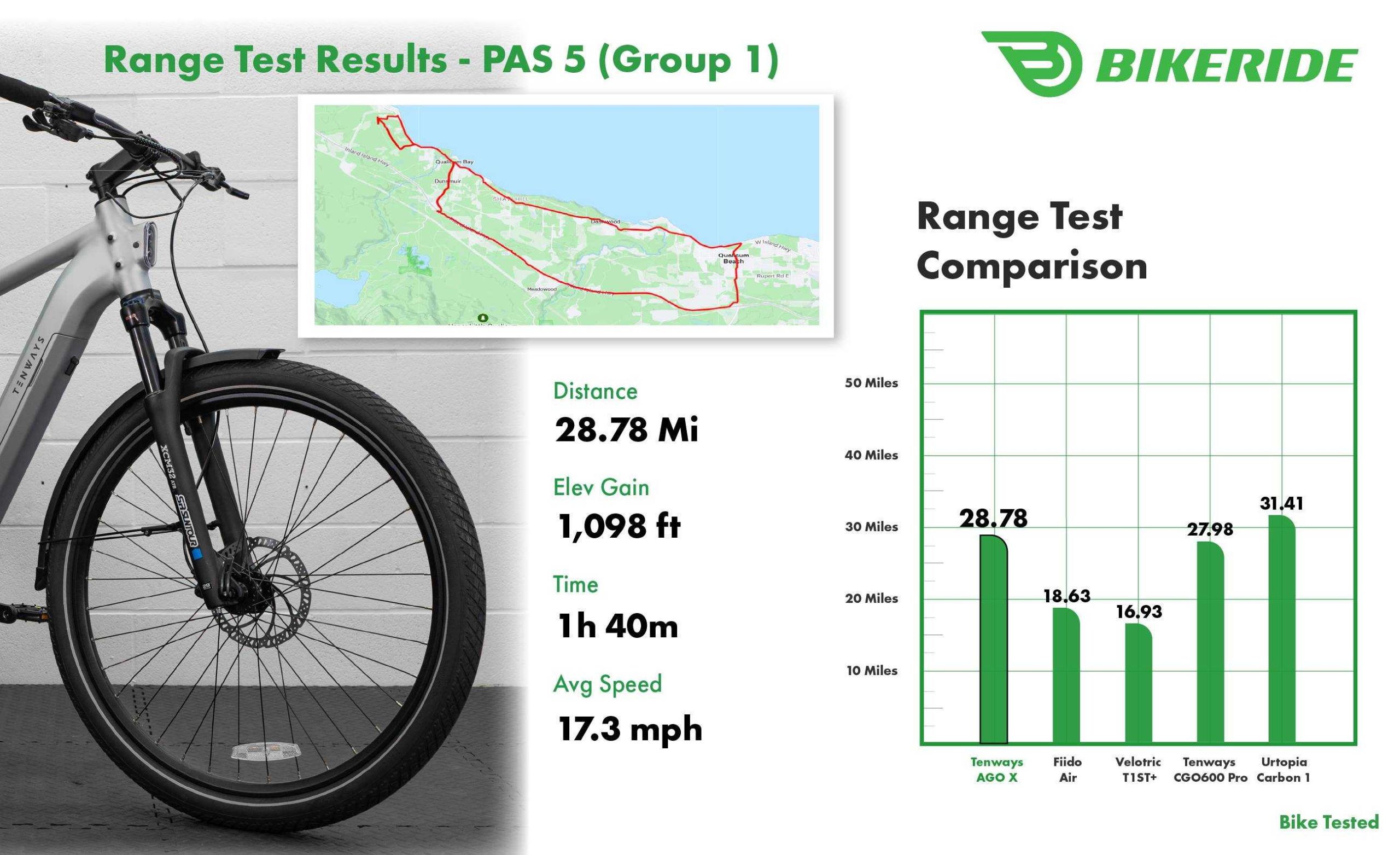

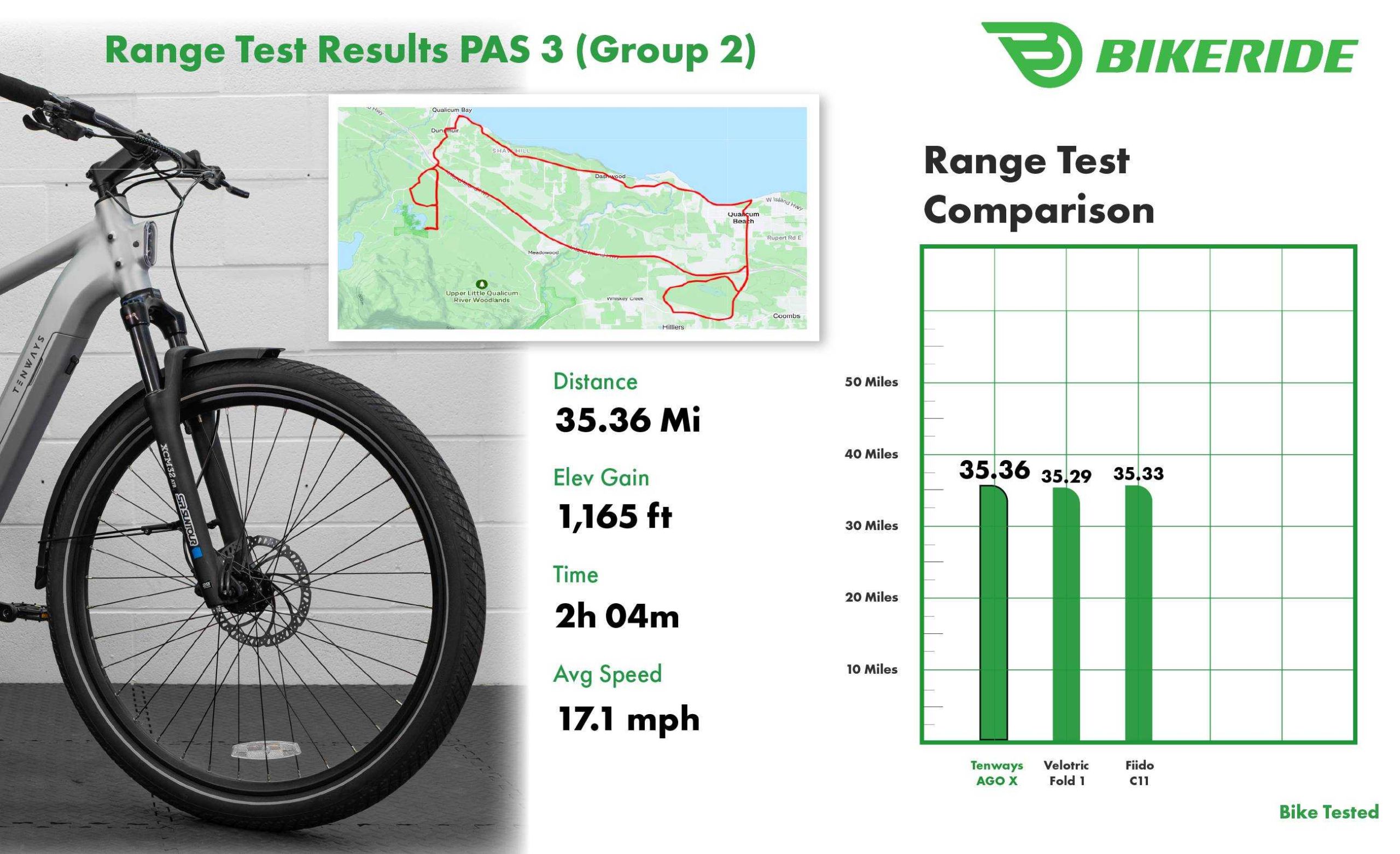

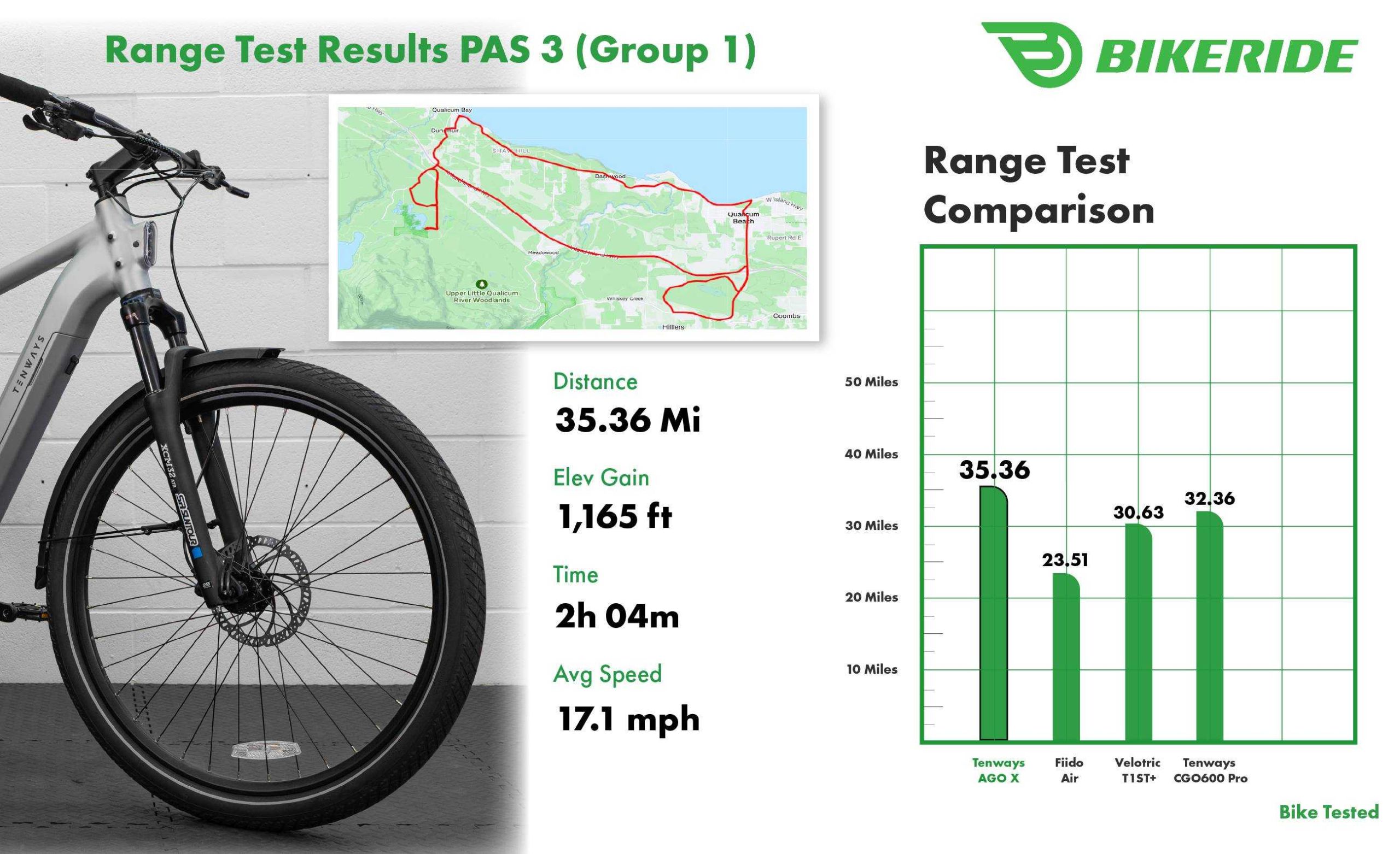

Range Test 1 (PAS 5)
When compared to the bikes with similarly powerful motors but smaller batteries, the AGO X soars past the short ranges of the Fiido Air and T1ST+, which have significantly smaller batteries.
Tenways’ own CGO600 Pro came within a mile of matching the AGO X, and surprisingly, Urtopia’s Carbon 1 managed to go 2.5 miles farther, despite its battery being 4Ah smaller.
Compared to bikes with similar-size batteries, the AGO X is the clear winner, with a range of 28.78 miles and 1098 feet of elevation gained over a two-hour ride.
Range Test 2 (PAS 3)
The AGO X can hit 20 mph in PAS 3, which makes the PAS 3 range test feel similar to the PAS 5 test.
The most notable difference was when climbing hills, where the motor provided noticeably less power than in PAS 5. This lower assist level increased the range by approximately 22%, resulting in a total distance of 35.56 miles.
The AGO X performs well compared to the group-one bikes. The only bike to come close was the CGO600 Pro, which managed 32.36 miles. It’s followed by the T1ST+, at 30.63 miles.
When compared to bikes with similar battery capacities, the AGO X is in the same ballpark, with both the Velotric F1 and Fiido C11 achieving 35 miles.
The AGO X gets good range overall. If the range estimates given by its display were more accurate, it would be a fine companion.

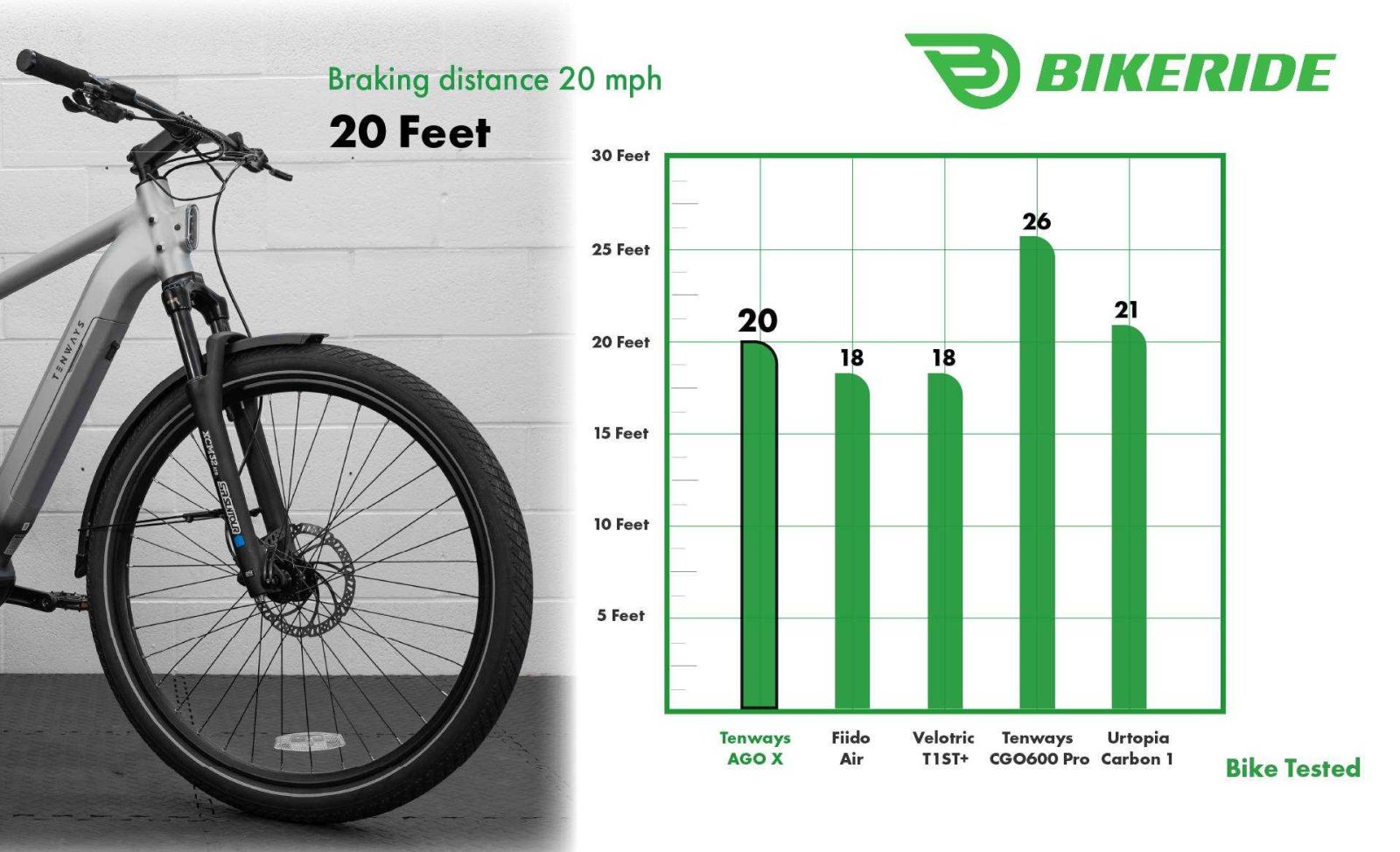

Tenways AGO X - BrakeTest Page
Brake Tests
The AGO X’s 20-foot stopping distance is fine for safety and sits in the middle of our test results. The Fiido Air and T1ST+ managed 18 feet, and the Urtopia required 21 feet. The worst performer was the CGO600 Pro, which needed an extra 6 feet to stop from 20 mph.

Assistance varies usefully across the 5 PAS levels, with the bike easily reaching the 20 mph limit in levels 3, 4, and 5. As is typical of this type of mid-drive setup, acceleration and speed are controlled mostly by pedal cadence and effort. The mid-drive motor was responsive and quick to accelerate or climb mild to moderate slopes.
The bike is also very quiet, the most noticeable noise being a slight rattle from the aluminum mudguards. The motor is nearly silent and does not detract from the ride experience.
The tires have a smooth, city-style tread pattern, which I found to be fast-rolling and pleasant on pavement. In tighter turns on gravel, however, I experienced some loss of grip, especially at the front, so you would probably want to fit tires with a more aggressive tread if you planned to ride this mostly on gravel trails.
Conclusion
The Tenways AGO X is a fun and intuitive bike to ride. It easily lives up to the majority of Tenways’ claims about its abilities and build quality.
The bike’s only shortcoming was its surprising lack of ability to climb steep inclines, where I felt the 80 Nm mid-drive motor could have provided a bit more pep. Still, with results firmly in the middle of our test bikes, the AGO X is far from a slow poke.

Motor Brand: Bafang M410
Motor Type: Mid-Drive
Motor Nominal Output: 250 W
Max Torque: 80 Nm
Battery: 36V – 14Ah (504 Wh)
Range Claimed: up to 62 miles
Range Tested (PAS 3): (Test 2 PAS 3) 35.36 mi – 1,165 ft – 2h 4m
Range Tested (PAS 5): (Test 1 PAS 5) 28.78 Mi – 1,098 ft – 1h 58m
Speed: 20 mph
Throttle: No
Pedal Assist: 5 level
Charger: 42V – 3A
Charge Time: 4 hours
Display: 2” TFT LCD display
Frame: 6061 Aluminum
Fork: SR Suntour XCM 32 ATB – 110mm travel
Brake Levers: Tektro HD-M275n Hydraulic
Brake Calipers: 2 piston Tektro hydraulic
Brake Rotors: 180mm Front – 160mm Rear
Crankset: Aluminum – 170mm – 38T
Derailleur: Shimano Deore
Shifter: Shimano Deore
Cassette: 11-46T 10-speed

Rack Capacity: 22 lb (10 kg)

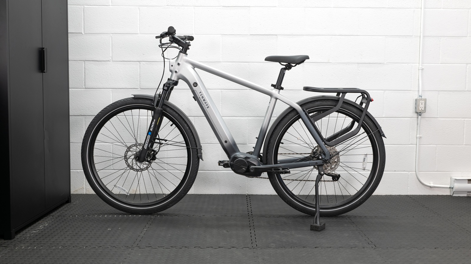

Geometry Details
Seat Tube: 19.68“ (500 mm)
Reach: 17.5” (432 mm)
Stack: 27” (689 mm)
Stand Over Height: 33.34” (847 mm)
Virtual Top Tube Length: 24.60” (625 mm)
Min Saddle Height: 35” (889 mm)
Max Saddle Height: 43” (1092 mm)
Wheelbase: 45.11” (1146 mm)
