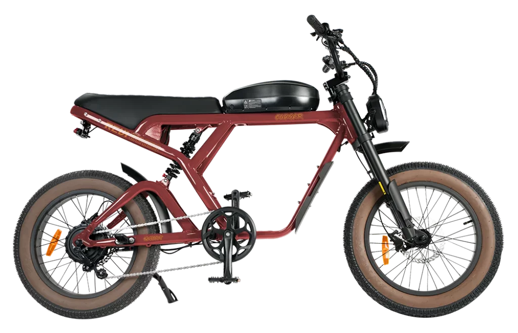

The Revibikes Cougar is a motorcycle-style e-bike with full suspension. It's available in two builds: standard (52V) or Pro (60V). Testers praise the quick acceleration and stable handling. Unfortunately, the high weight, street tires, single-speed gearing, and clunky suspension mean it cannot handle anything more than smooth off-road terrain, despite Revibikes' marketing claims. A test bike's noisy, vibrating motor causes concern. As is common at this price point, the Cougar has a long list of drawbacks that limit its appeal.

The Cougar Pro has an aluminum full-suspension frame, and my first impressions of the overall build quality were good.
Revibikes says the bike should fit riders between 5’1″ and 6’6″, but I think riders at the low end of that range will struggle to get on and off due to the 33” seat height.
The long seat and included footpegs make it possible to carry a passenger once the total payload (rider, passenger, cargo) stays within the 350lb limit.
The Cougar Pro runs an inverted coil suspension fork and a coil rear shock. Revibikes lists 60mm of fork travel, though it seems closer to 65mm.
