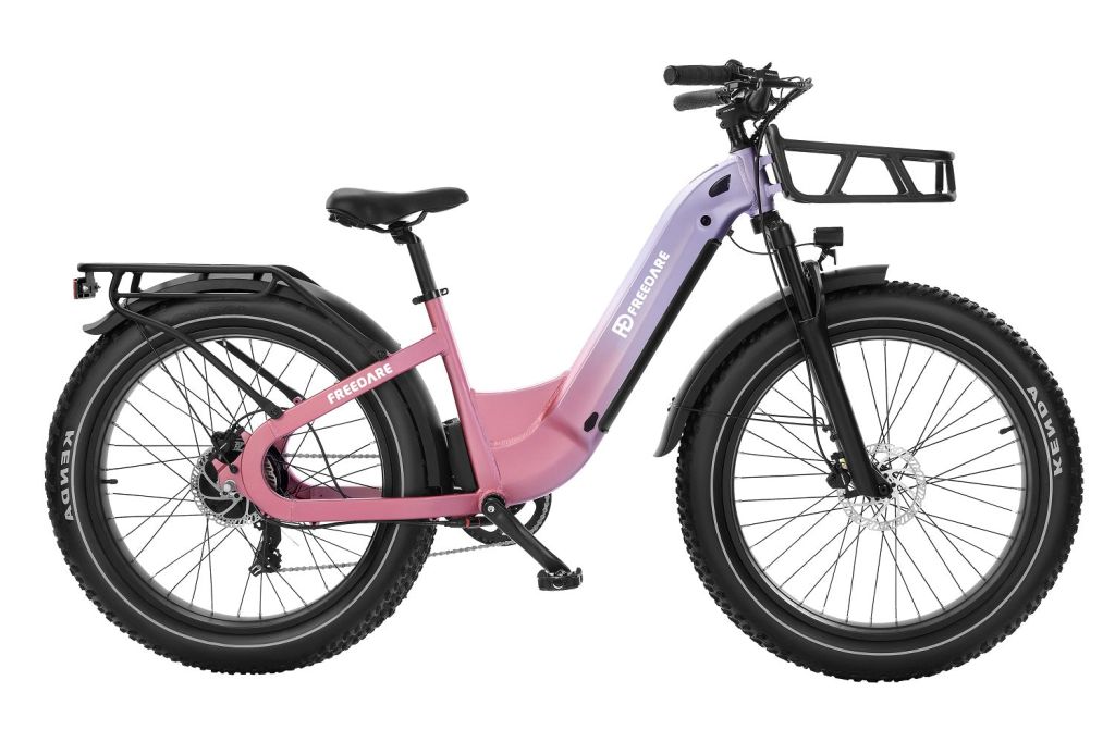

We have read all expert and user reviews on the Freedare Eden. In summary, this is what cyclists think. Published Jun 27, 2024 by Reda Ashour.
  • Testers laud the relaxed and comfortable upright riding position.
  • Reviewers appreciate the high-quality molded foam packaging.
  • An expert praises the tidy cable management and welds.
  • Testers say the Tektro hydraulic brakes perform very well.
  • Two experts estimate a 45-mile real-world range.
  • Freedare’s companion app offers anti-theft alerts and GPS tracking.
  • One reviewer compliments the gentle, predictable acceleration.
  • The Eden includes fenders, lights, and front and rear racks.
  • A reviewer enjoys the comfort afforded by the 26” x 4” Kenda Krusade tires.
  • Users can quickly switch between three modes on Freedare’s app: Eco (12mph), Normal (20mph), and Sport (28mph).
14 reasons not to buy
  • The externally powered taillight and lack of bottle cage bosses disappoint testers.
  • Testers report lagging power from both pedal assist and throttle engagement.
  • A tester finds the throttle lacks power when set to normal mode. In Sport mode, throttle speed exceeds 20mph, breaking e-bike speed laws in most states.
  • Experts say the motor is noisy.
  • At 84.2lb, the Eden is a heavy e-bike.
  • A reviewer experiences ghost pedaling before the 28mph top speed due to low gearing.
  • Several testers say the cables rub the front basket.
  • Reviewers and owners recommend replacing the “uncomfortable” saddle.
  • The bike is rated for 5’5” to 6’5”, but two testers (6’4” and 6’5”) say the max saddle height is too low to achieve a comfortable pedaling position.
  • The 32.2” minimum seat height is likely too high for those under 5’8”
  • Reviewers say the anti-theft sensor is too sensitive. One sets it off by walking past the bike on a hardwood floor.
  • After setup, a tester and owner both experience the same battery issue, requiring correspondence with Freedare to troubleshoot.
  • An expert reports app connectivity issues.
  • The display is dim and difficult to see according to reviewers.
The Freedare Eden is a fat-tire e-bike with a 750W motor, 960Wh battery, and Tektro hydraulic disc brakes. Experts praise the relaxed upright riding position, handy companion app, anti-theft features, and solid riding range. However, inaccurate sizing, delayed motor response, high weight, a noisy motor, and lack of gearing range disappoint. Reviewers also agree the uncomfortable rear end would benefit from a better saddle or suspension seatpost. Despite these considerable issues, reviewers still feel the Freedare Eden offers good value.
