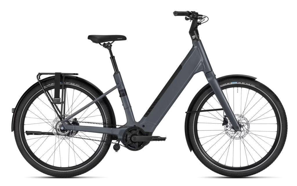

  • Canyon’s Precede:ON Comfort is available in two builds: Comfort 5 (10-speed, chain- drive) and Comfort 7 (belt drive, 5-speed hub).
  • Experts say the upright riding position remains comfortable over long rides.
  • The Bosch mid-drive motor delivers instant, smooth, and quiet power.
  • A 200lb reviewer of the Comfort 7 gets 64.7 miles using maximum assist.
  • A reviewer praises the above-average stopping power shown in a standardized test.
  • The Comfort 7's belt drive and hub drivetrain run quietly, shift at a standstill, and require minimal maintenance.
  • The Bosch app allows users to tune motor power and response for each assist mode and adds navigation and security features.
  • The Comfort 7 comes with fenders, a rear rack (55lb capacity), bright lights, a kickstand, a bell, and a folding lock.
  • In testing, the 2.15" Schwalbe tires help cushion bumpy pavement and grip well on wet and dry roads.
  • Reviewers praise the stable handling and confident cornering.
  • This bike pedals easily with assistance turned off.
  • A tester says assembly is simple, with only three bolts to tighten.
  • Canyon backs its own components with an above-average six-year warranty.
  • Reaching the 28mph assist limit takes hard pedaling; a tester manages around 26mph.
  • One tester notices slight play in the suspension seatpost.
  • Reviewers report big jumps between the Comfort 7's meager five gears.
  • The Nexus hub on one test bike occasionally skips a gear.
  • Two reviewers find the battery awkward to remove.
  • The Comfort 7’s below-average 2A charger takes around nine hours to fill the battery.
  • The Comfort 7’s rear light doesn't activate on braking.
  • The one-piece handlebar and stem can't be adjusted.
Canyon's Precede:ON Comfort is an upright city e-bike sold in two builds. The higher-end Comfort 7 comes fully equipped with commuter accessories and a low-maintenance drivetrain, but reviewers are disappointed by the hub's limited 5-speed gearing and clunky shifting. Testers praise the comfort, range, braking, and smooth, quiet assist that’s fully customizable through the app. Most reviewers rate the Precede:ON Comfort highly and deem it worth considering for relaxed urban rides and commuting.
