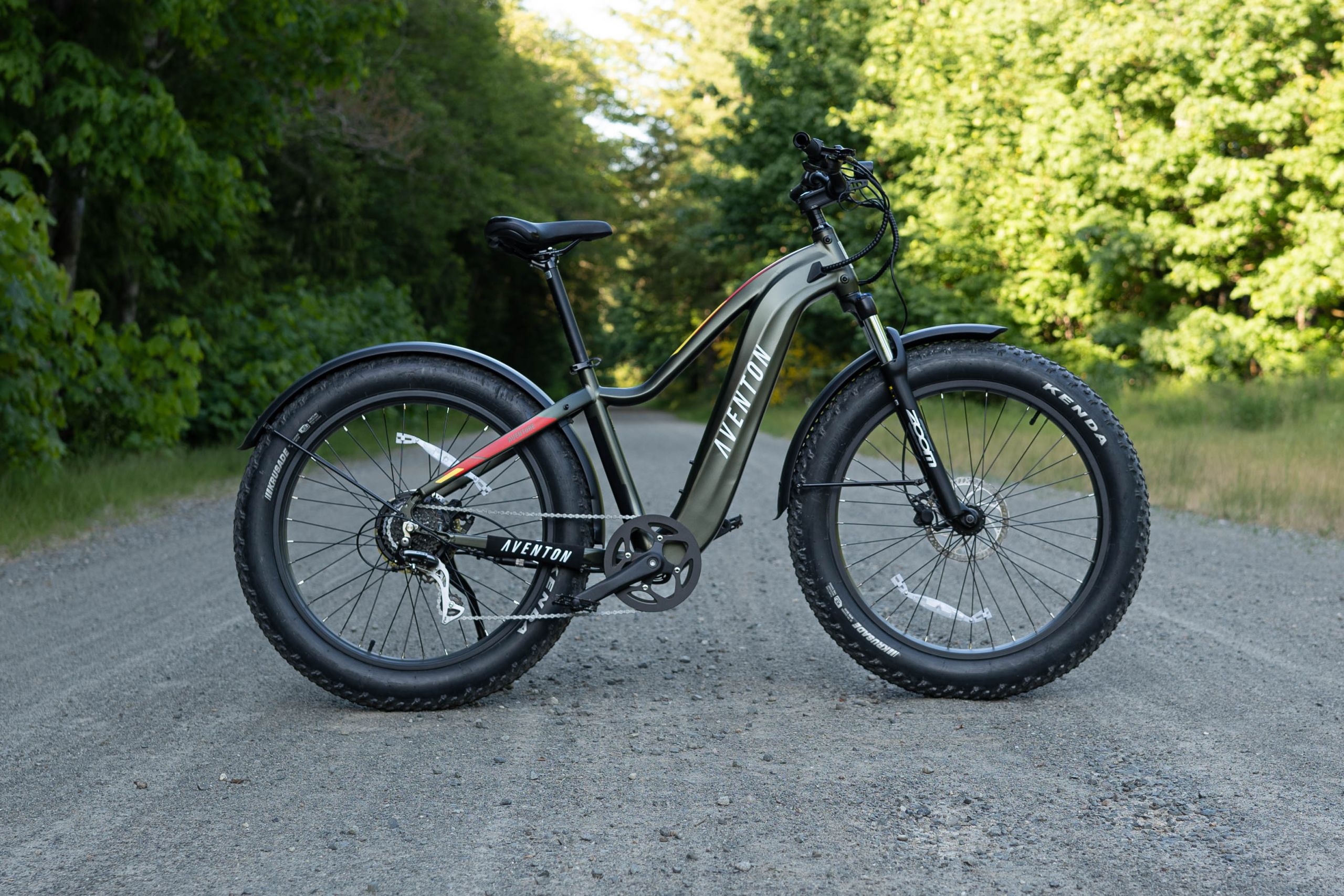

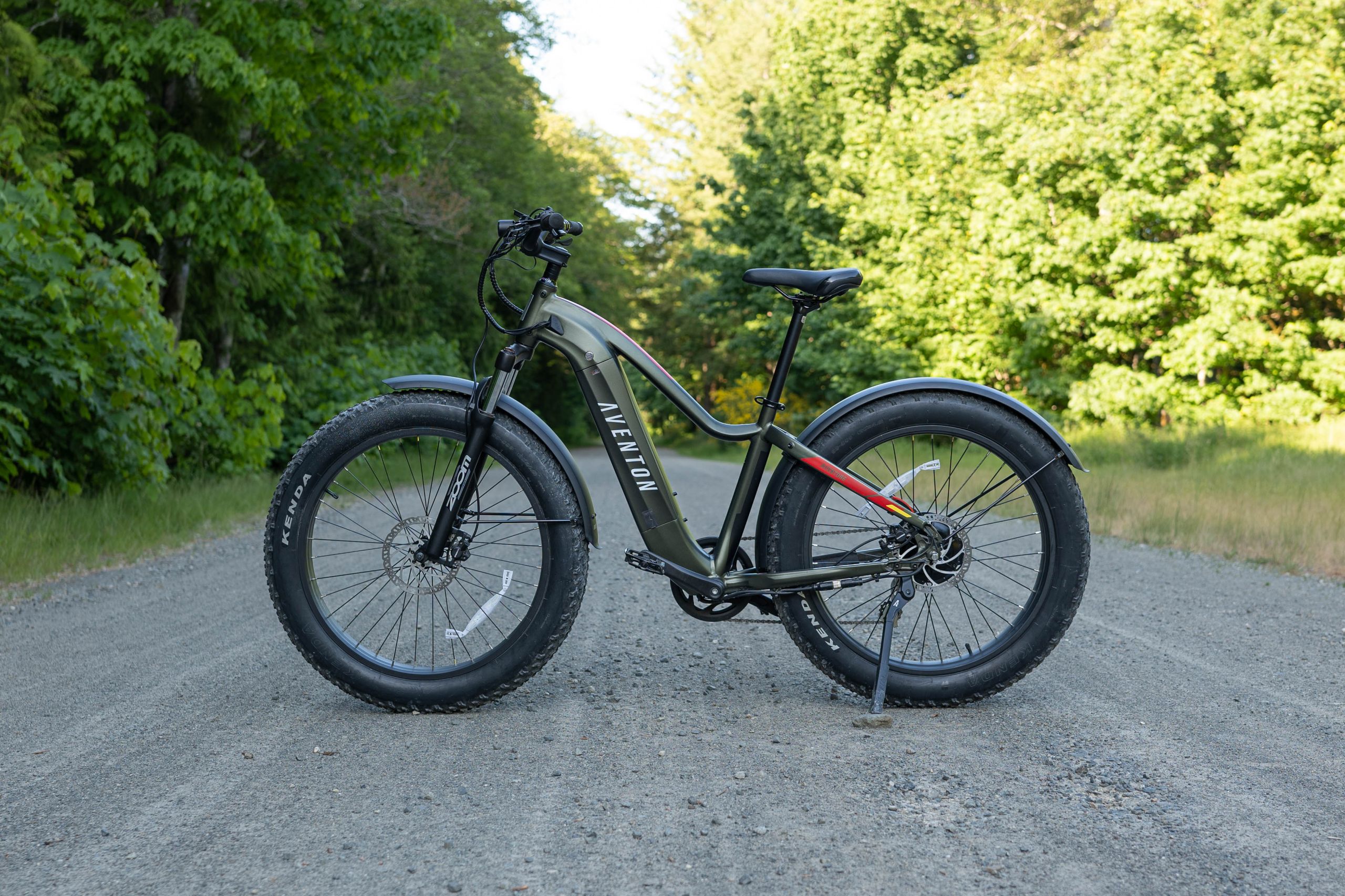

I heard the name ‘Aventon’ before I laid eyes on one of their bikes. As I tend to be skeptical of things I have not seen for myself, it was a hard sell at first. Speaking with e-bike sales teams, I was told that people seemed to be looking for these bikes. What I heard sounded good, but I also knew that before the Aventure, Aventon had not made a full-size fat-tire e-bike. Is it really possible they scored a hole-in-one? Is this a great build, worthy of consumer praise right out of the gate?

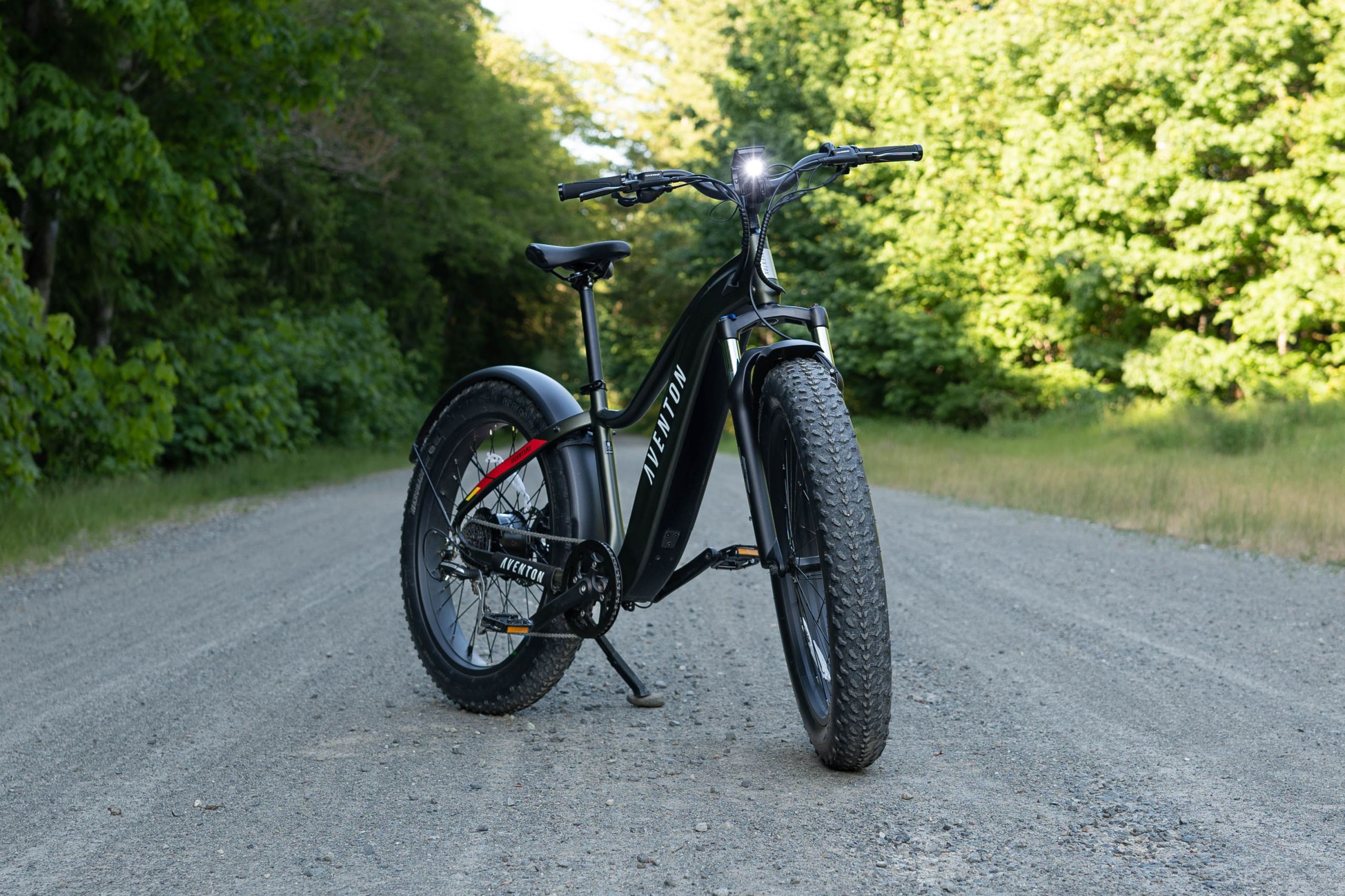

Angle View
We had the chance to get our hands on a few bikes from the Aventon family, and the Aventure was among them! At first glance, I could see what the fuss was all about. The Aventure is a nice-looking bike and my first ride reinforced this impression. Aventon also broke the mold by offering some very specific ‘real-world’ performance metrics. It’s nice to see the exact range distances for different assist levels listed on their website. But this also presents Aventon with a challenge.
The bike is built for adventure, so why not put it through its paces and see exactly how it fares against Aventon’s numbers? I have a monster commute, 24 miles each way for a grand total of almost 50 miles. We will go over all the real-world data and see if we can replicate those numbers. Will the Aventure go the distance, or will it leave me stranded, calling for a ride home‽

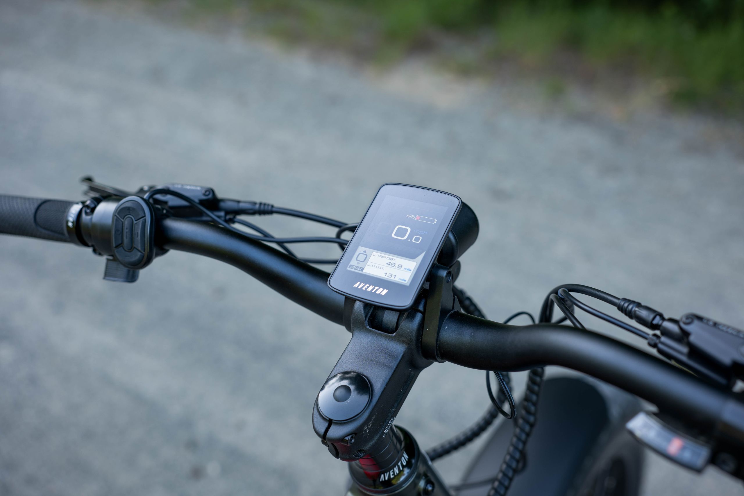

Display
Great Full-Color Display With App
The display is easy to see, with a control pad that’s nicely shaped and pleasant to use. The fact that it is full-color and backlit sets it apart from other units. The brand has focused on small details such as showing the battery as a percentage rather than just 4-5 bars, which really adds to the riding experience. The display can also show you some cool info, including how much carbon you have saved and how many trees that is equal to. This may be somewhat of a novelty metric, but it’s a fun feature that carries over to the app, allowing you to brag to your friends.
When linking to your phone app via Bluetooth, the display packs a lot of functionality, including extra features, such as the ability to unlock the Aventure as a Class 3 e-bike capable of 28 mph. The app is very versatile, allowing you to track and plan your rides, interact with other users, and to view all the information from your Aventure display on your device. You can even control your lights and settings from the app. It was easy to use and pair, and I love the added ability to change the bike’s speed limit.

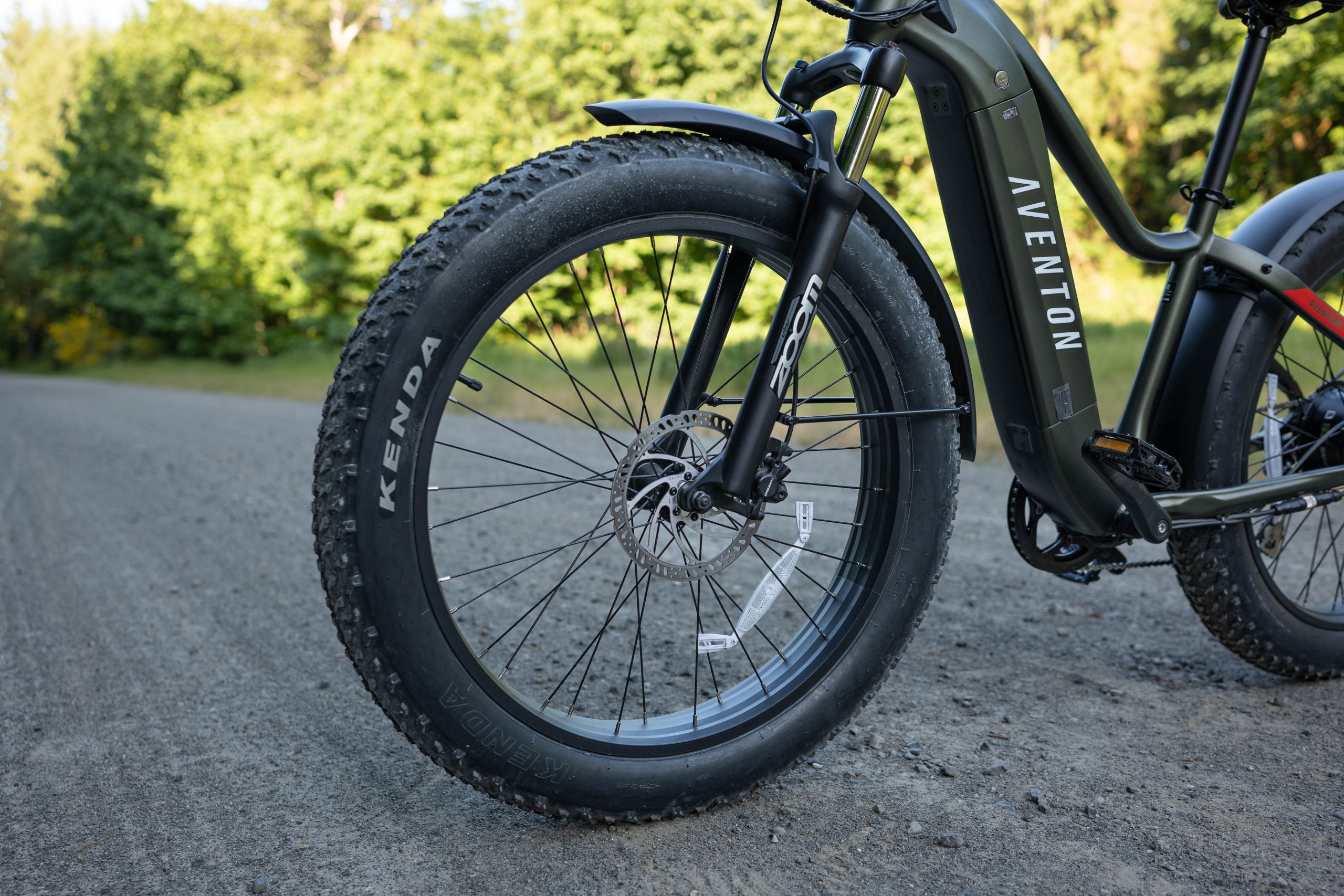

Front bike

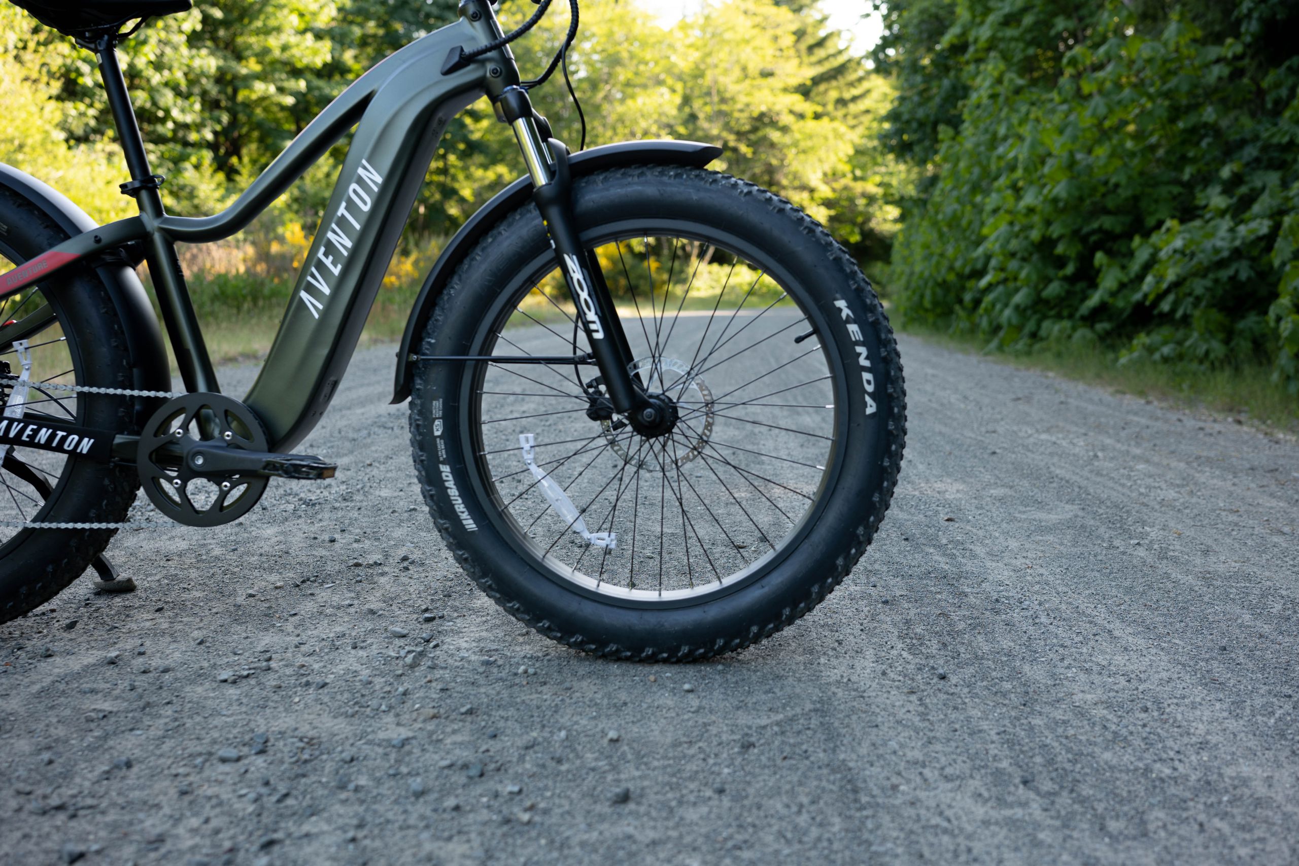

Heavy With Large Tires
There is no denying that the Aventure is highly capable, but it also packs some serious weight and a large set of tires. At 75  pounds and with 4.0” tires, the bike is heavy, limiting its options for mobility both on and off a vehicle. It’s not easy to lift solo, and maneuvering it up more than a couple of stairs is tough. So keep these factors in mind when thinking about your needs. The total weight, combined with large 4.0” tires, is also going to limit your options for bike racks. Make sure you choose a rack that will accept the weight of the bike and the total width of its tires.

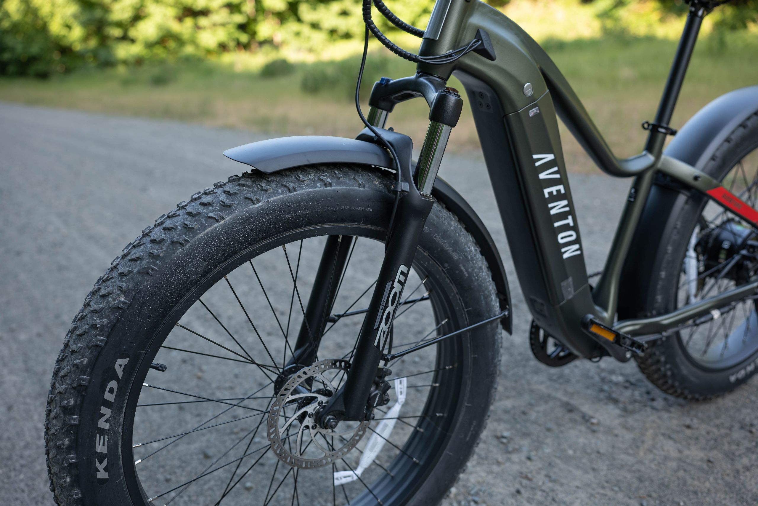

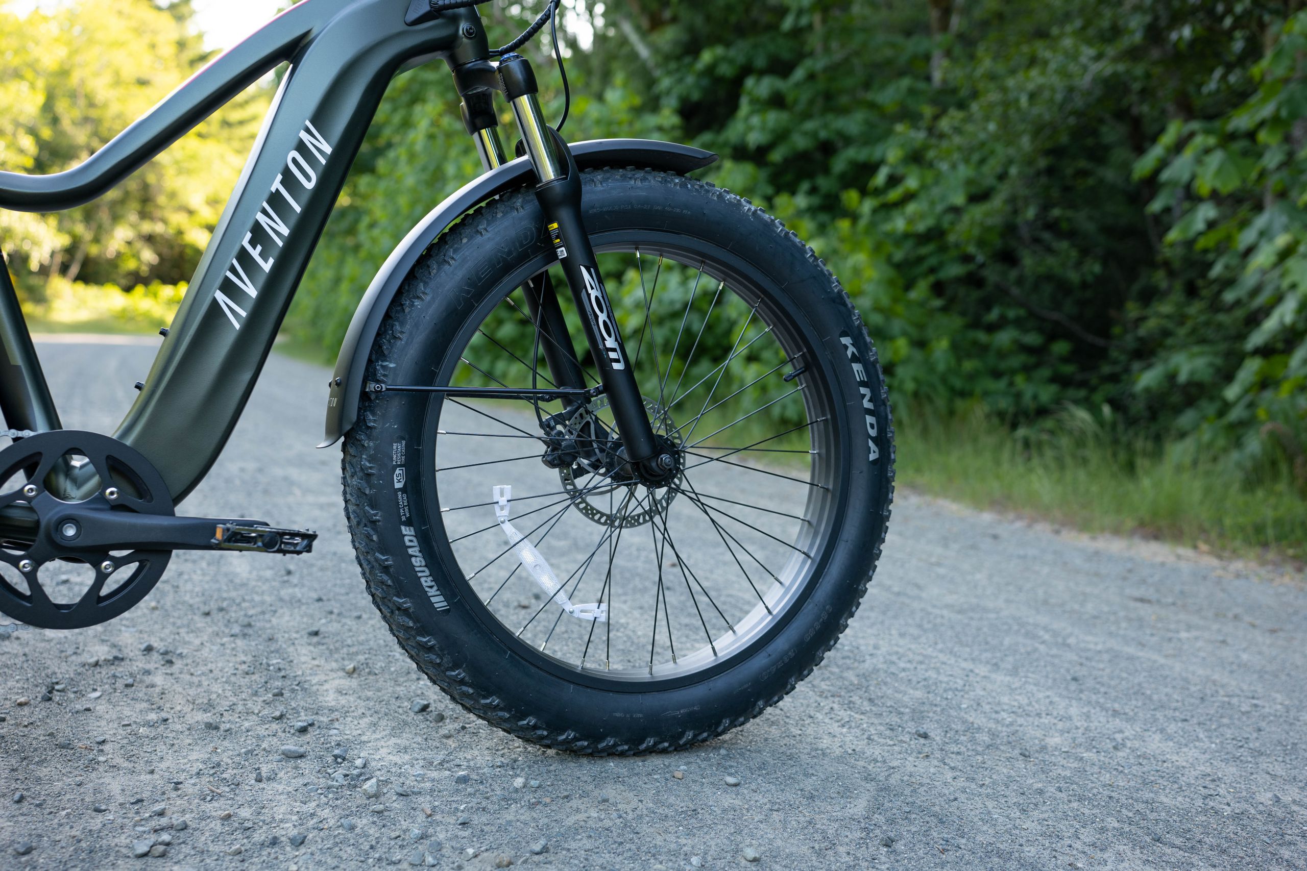

Suspension fork
Suspension Fork is Clunky With Limited Travel
I was not impressed with the Zoom suspension fork on the Aventure. It would have been great to see something with air suspension instead of a coil suspension fork. Given the price of the bike, I know this is a lot to ask for. Still, the Zoom coil fork felt clunky and unresponsive. I found that it would get a little stuck, halfway through its travel, before clunking back out to full travel when the front wheel became unweighted. While it was offering some assistance, the fork’s noises combined with its sticky, clunky travel to offer an experience that was less than plush.

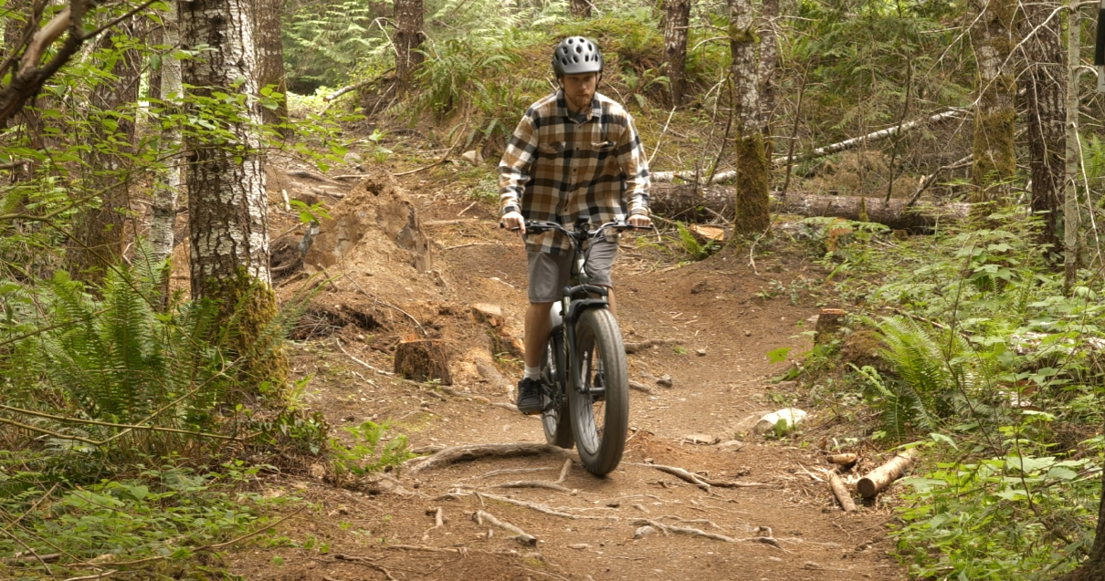

Cornering
Wide Cornering at speed, Limited Maneuverability in Tight Spaces
I want to commend Aventon for not claiming that the Aventure is a ‘mountain bike’ or ‘goat’. Rather, it’s a fun and capable adventure e-bike for a variety of terrains. This description rings true, so long as the places you ride are wider than singletrack. The heavy frame has no rear suspension and a rough front fork that suffers on rooty and bumpy terrain.
The bike is powerful and comfortable to pedal. Large tires and a considerable weight give it a great sense of stability at speed, but also come into play in tight spaces and when cornering. The bike corners in a wide arc, as you would expect with 4.0” tires. Carving is slow, so you won’t be making any sharp turns with this bike. In confined spaces, the total weight can make it challenging to maneuver if you are unable to maintain sufficient speed.
The bike is not wonderful over bumps, roots and rocks. An appropriately low tire pressure can help, but lacking rear suspension and a torque sensor, the bike bumps and pushes through rough terrain in a less than comfortable manner. You really feel that 73-pound weight in the rough stuff. So keep this bike in the open, and let that 28 mph top speed take care of the work!

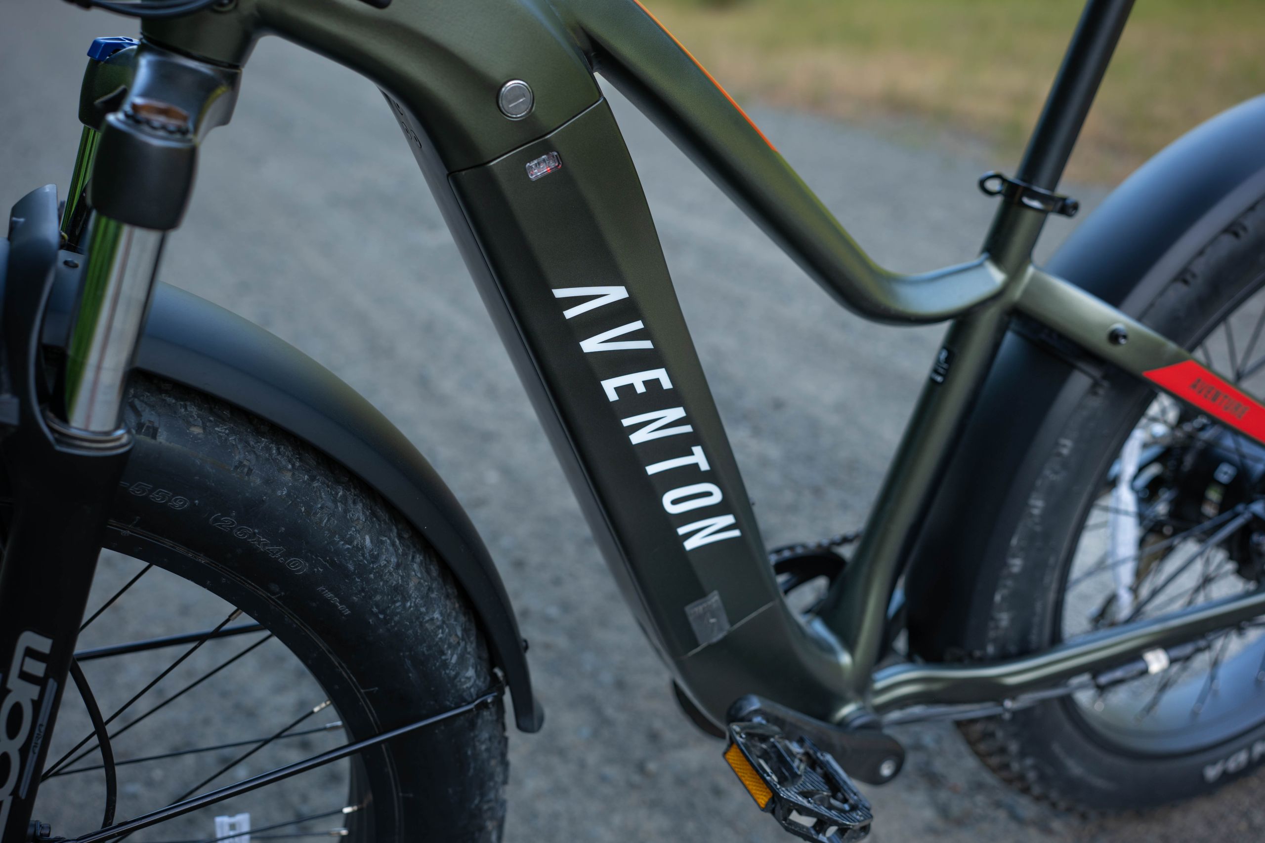

The Aventure is a nicely designed bike and at its core is this great frame. Overall, the look is clean, with geometry that comes across as modern. The battery is integrated beautifully. I love that it comes out to the side, making it the easiest battery to change. The top tube has this steep slope that’s giving us a nice low standover height. The reach on this bike is pleasant. The riding position is a mix where you are in a slightly sloped over position, so it’s a more athletic position than on a straight-backed bike. It’s great for getting some power to the pedals or maneuvering, and then it’s still really easy to go sit up if you are pedaling for some period of time.
Featuring a sturdy aluminum frame, it’s built to last. But with a total weight of 73 pounds, it is also pretty heavy. That said, it’s packed with great features like battery placement, internal cable routing, and nice fender/attachment points for accessories. Plus, check out the placement of the rear brake light, integrated into the left seat stay. It’s a perfect position for driver visibility. Functional and fine-looking, it’s really a great package from the get-go.

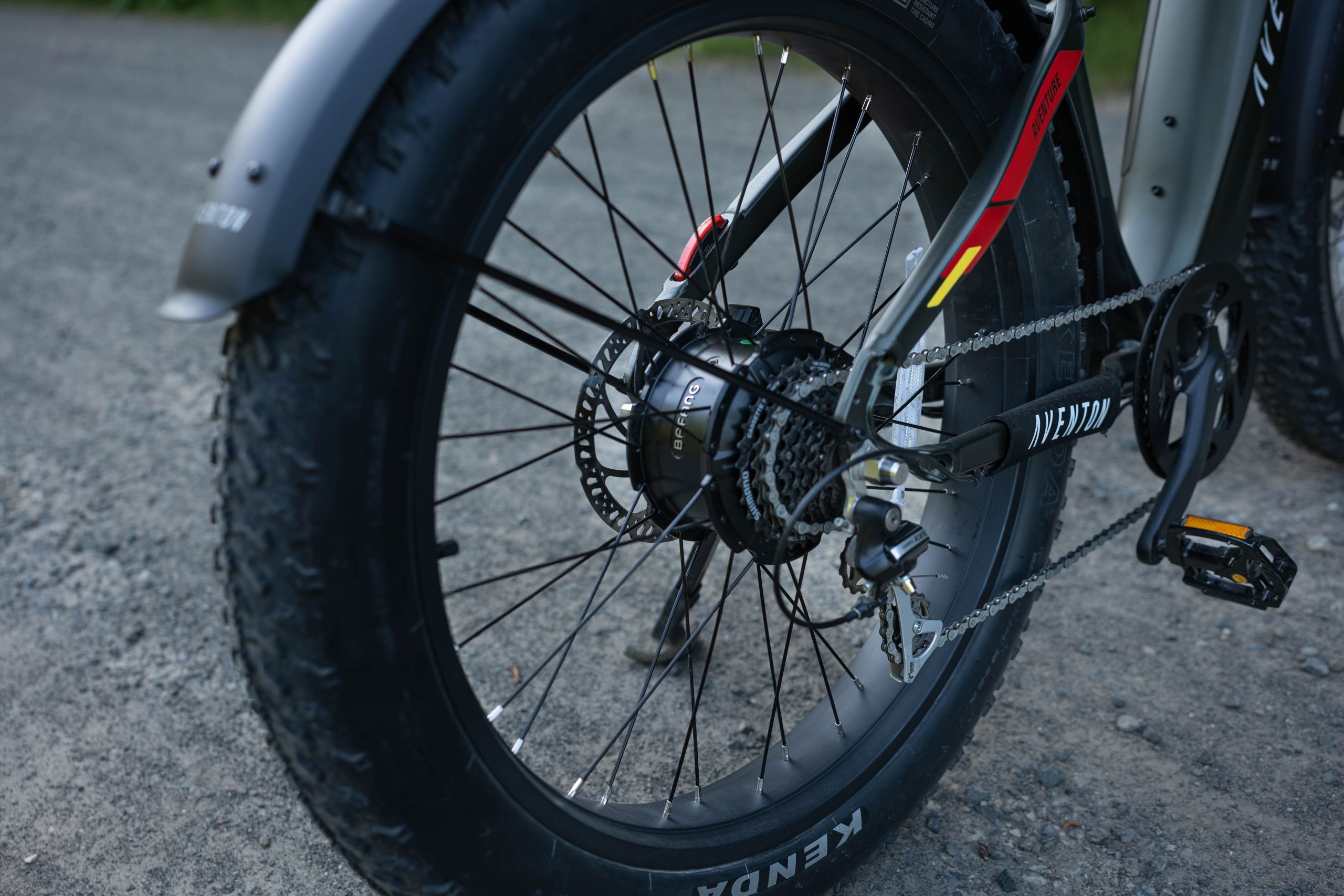

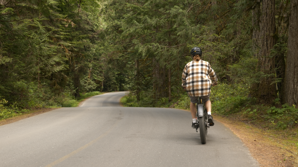

Motor
Powering the Aventure, we have the Bafang 750W rear hub motor. We see this unit on lots of fat-tire bikes. It’s a well-configured motor, with a rated output of 750W and a maximum torque of 80 Nm. That translates into plenty of power at the wheels, and Aventon has maximized this with a well-tuned controller. Offering the ability to choose a speed limit in the app, the bike is easily set as a Class 2 bike peaking at 20 mph or as a Class 3 rig topping out at 28 mph. The five pedal assist settings are well-staged, and alter the application of torque as well as the top speed. The bike is comfortable to ride in traffic or pedestrian areas at its lower settings, with brake cut-off switches easily cutting power as needed.
On the open road, accelerating to 28 mph is fast and smooth. The motor really pulls away quickly. The bike is exhilarating and easy to control, ramping up to speed in a smooth but powerful way that is pleasant when trying to take-off and keep up with traffic. The motor maintains 28 mph well, without making you work hard to maintain that speed and power. When faced with a hill it’s no problem, as the bike can easily climb even steep slopes, with minimal decrease to its speed. So no complaints about the motor. It is powerful and well-paired with the controller.

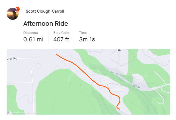

18%-20% Hill Climb:
  • Time: 3 minutes 1 second
  • Distance: 0.61 miles
  • Elevation Gain: 407 feet
  • Maximum Grade: 20%

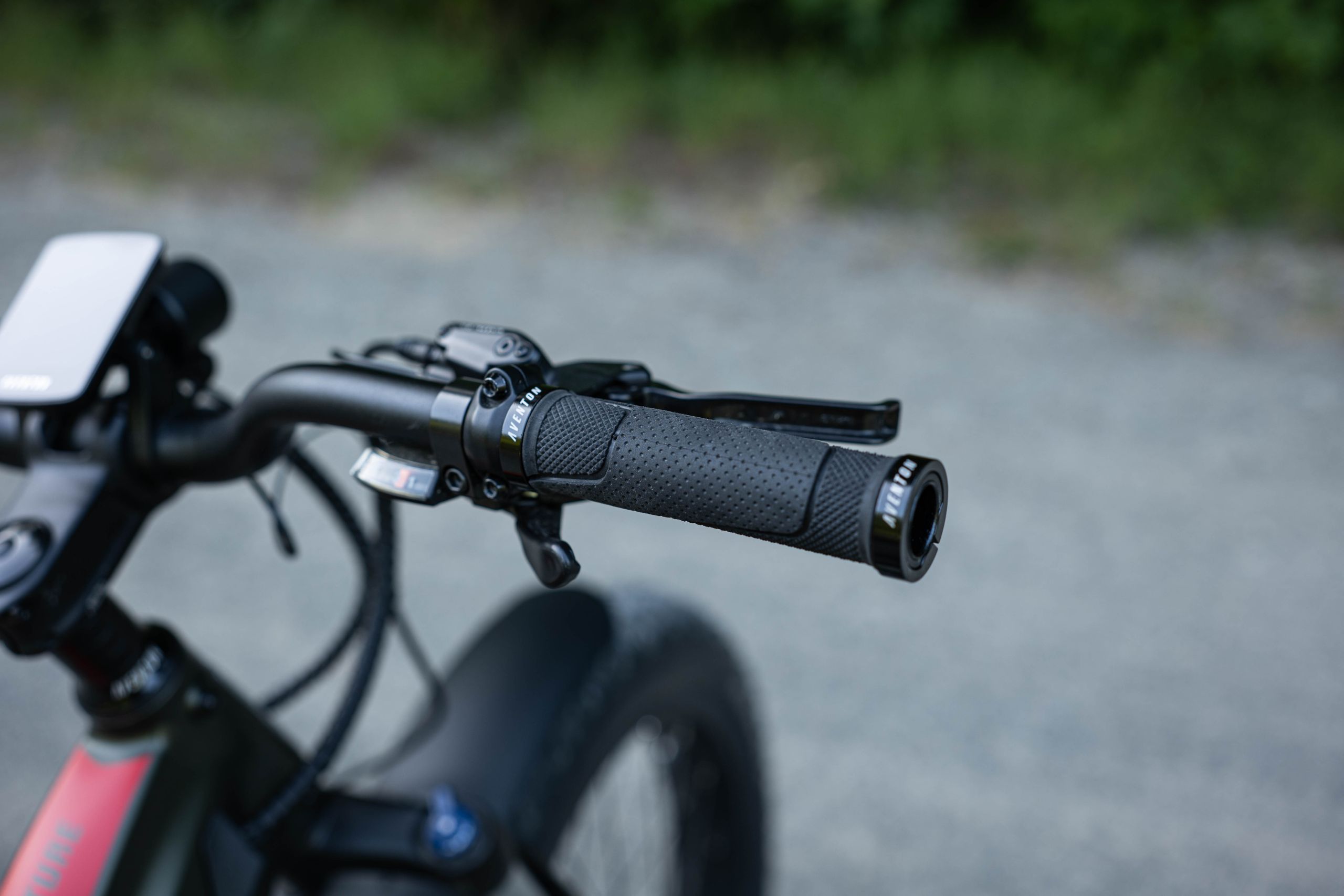

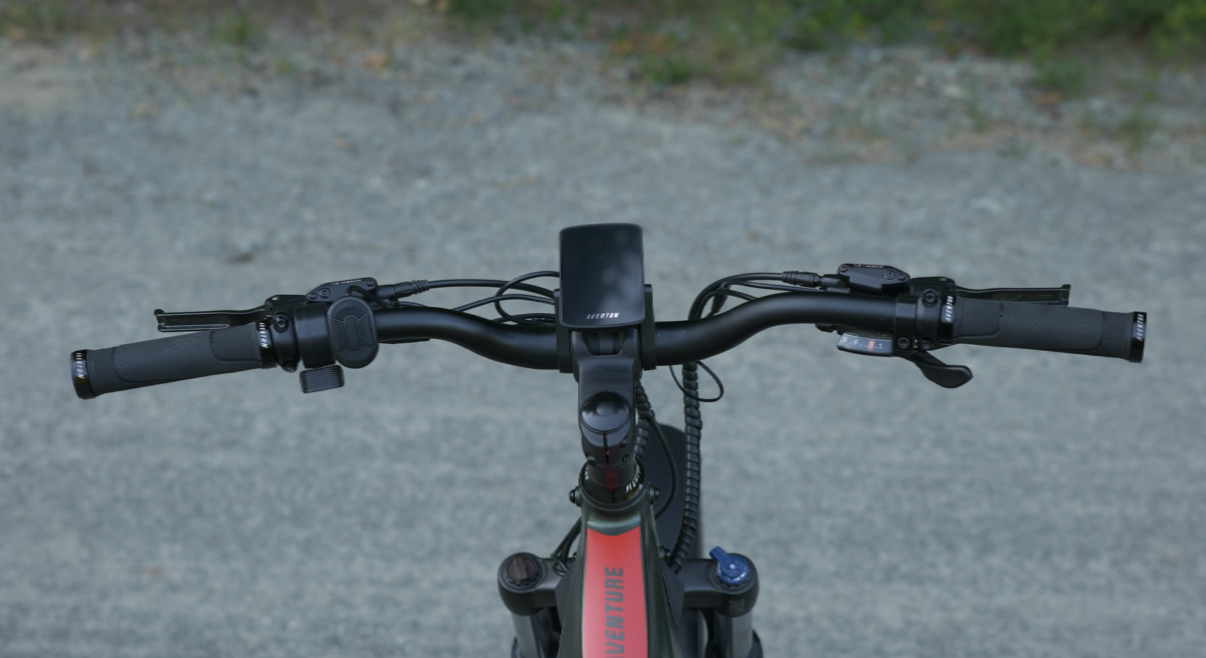

Cockpit and Control
Aventure riders are greeted by a well-laid-out cockpit. 680 mm riser bars are adorned with Tektro aluminum levers, Aventon branded lock-on grips, a Shimano shifter and a very nice display/control pad combo. Power can also be applied with the thumb switch throttle. The full-color LCD backlit display is great to use. Along with the ergonomic control pad, it’s a simple and highly functional combo. The five-button layout is clear, with dedicated buttons for functions like the light and changing the information display. The integrated app makes this display even better, allowing you to see all the same info and access all the controls and functions from your own device. Pleasant to use and look at, the cockpit is a definite win.

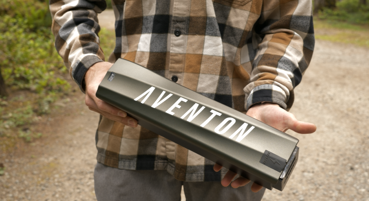

Battery

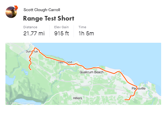

The 48V 15Ah (720Wh) battery is well paired with the 750W motor. It is capable of running the bike at approximately 28 mph for a little over an hour, or long enough to cover almost 22 miles at top speed. Take that down to assist level two, and the battery will power you for over 47 miles! It’s a great range that’s made even more impressive by the fact it actually beats the specs set out by Aventon, rather than falling short, as is the case with so many other brands. It was great to see some real-world testing numbers right on the company website and this was a test the bike beat with flying colors, so it gives me faith in some of the other specs. Looking at those range tests (below), we have some pretty impressive numbers.
Range Test 1
Range Test 1:
  • Distance: 21.77 miles
  • Time: 1 hour 5 minutes
  • Elevation: 915  feet

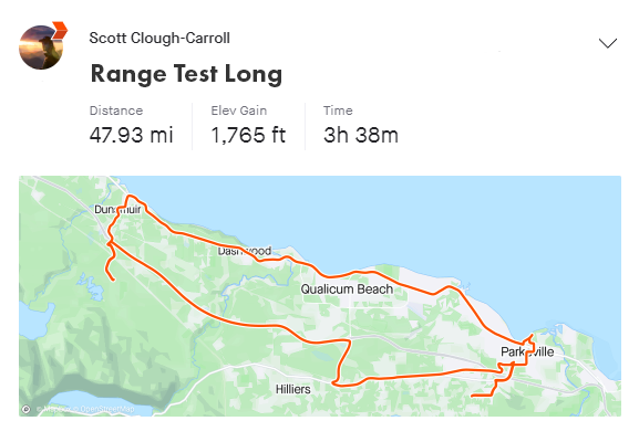

Range Test 2
Range Test 2:
  • Distance: 47.93 miles
  • Time: 3 hours 38 minutes
  • Elevation: 1,765 feet
The way this battery is installed and removed is truly unique, which is a feature I love about the Aventure. Rather than the bottom of the downtube, the battery is installed and removed from the side. This makes it just so easy, as you don’t have to worry about your fork and fender. Both the key and battery are removed from the same side. It’s just so easy!
The 48-volt 3-amp charger is also a nice upgrade. This 3-amp supply can be considered a ‘fast charger’ (compared to a standard 2-amp charger), and will fully charge the battery in four to five hours. Finally, we have that little bit of flair, with an Aventon branded key. The brand really knows how to get the name out and you will find the name and logo nicely integrated into a bunch of little features on this bike.
Drivetrain
We are seeing a pretty typical gear range on the bike: a 12-32 tooth rear cassette combined with a 46 tooth front chainring. The drivetrain does sport a modest upgrade over some other models, in the form of an eight-speed Shimano Acera groupset, which is better than the seven-speed setup we often see on more budget-minded builds. Overall, the drivetrain is good on the bike, offering crisp shifting. The additional gear is pleasant, as I found I would need to move through my gears frequently when traveling in stop/go traffic, as the bike requires a little torque to get moving from a dead stop.

Wheels, Tires
26” wheels with Kenda Krusader rubber connect you to the ground, which is a suitable tire choice for the bike. The tire is not the most aggressive, but it’s a good mix for all surfaces and offered performance that matched the bike’s capabilities. They feature puncture protection, probably ideal for thorns but not enough for the two inch nail that got our tire while out on a ride. Still, with a fresh tube, the tires performed just fine on mixed off-road terrain. Comfortable over sand, gravel, pavement, and dirt, the large 4.0” tires provide good cushioning at the right tire pressure. The large tire is a stable base and is comfortable to ride on the road for extended periods. With their large size, they make for some wide turns at speed.

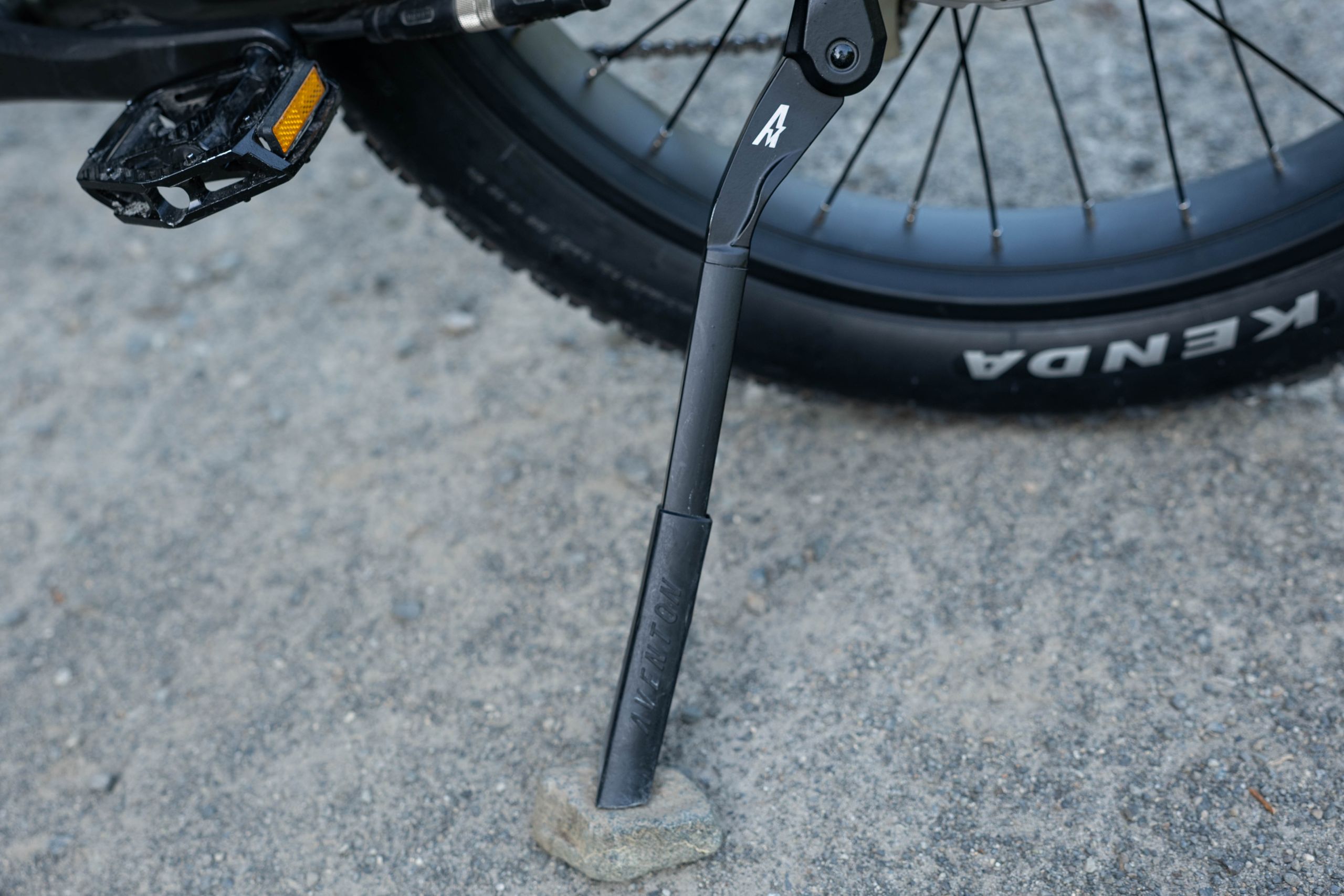

Kickstand
We have a single-sided kickstand, similar to the type we would see on most e-bikes. Aventon has gone the extra mile with this for branding purposes, customizing the shape and adding not just one logo but two. Stuff like this has no performance value at all, but it does add to the overall aesthetic and having all the details buttoned-up like this makes you feel like the rig is premium.
Contact Points
Easily overlooked on many builds, I was a big fan of the contact points that Aventon has chosen on this bike. Starting with the very nice lock-on rubber grips. These are the style of grip you would see on a mountain bike, and they are comfortable with great traction. The Aventon branding is a nice second touch. I was happy to see no ergonomic flares or faux leather stitching in the cockpit of the Aventure.

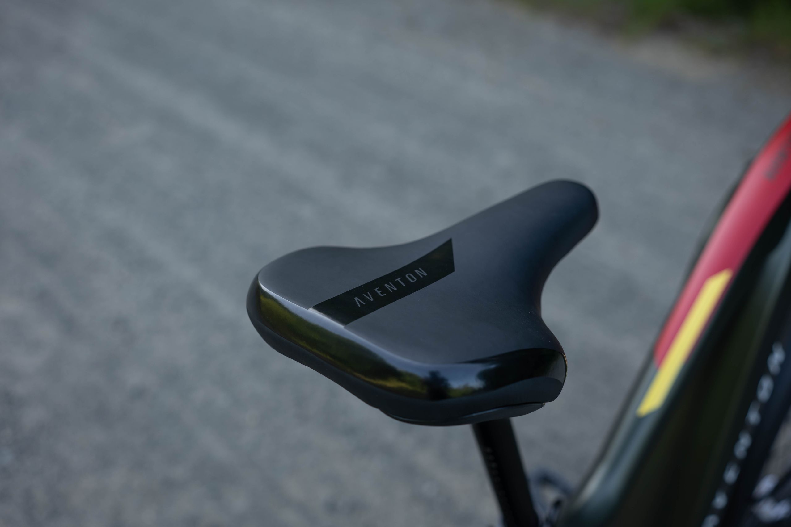

The seat offered another branding opportunity, and the “custom” Aventon seat (made by Velo) is reasonably comfortable. After the 48-mile range test, I was ready to run away from it, but for the first 20 miles? It’s a pretty comfortable seat, miles better than some of the stock options I have seen on other bikes.

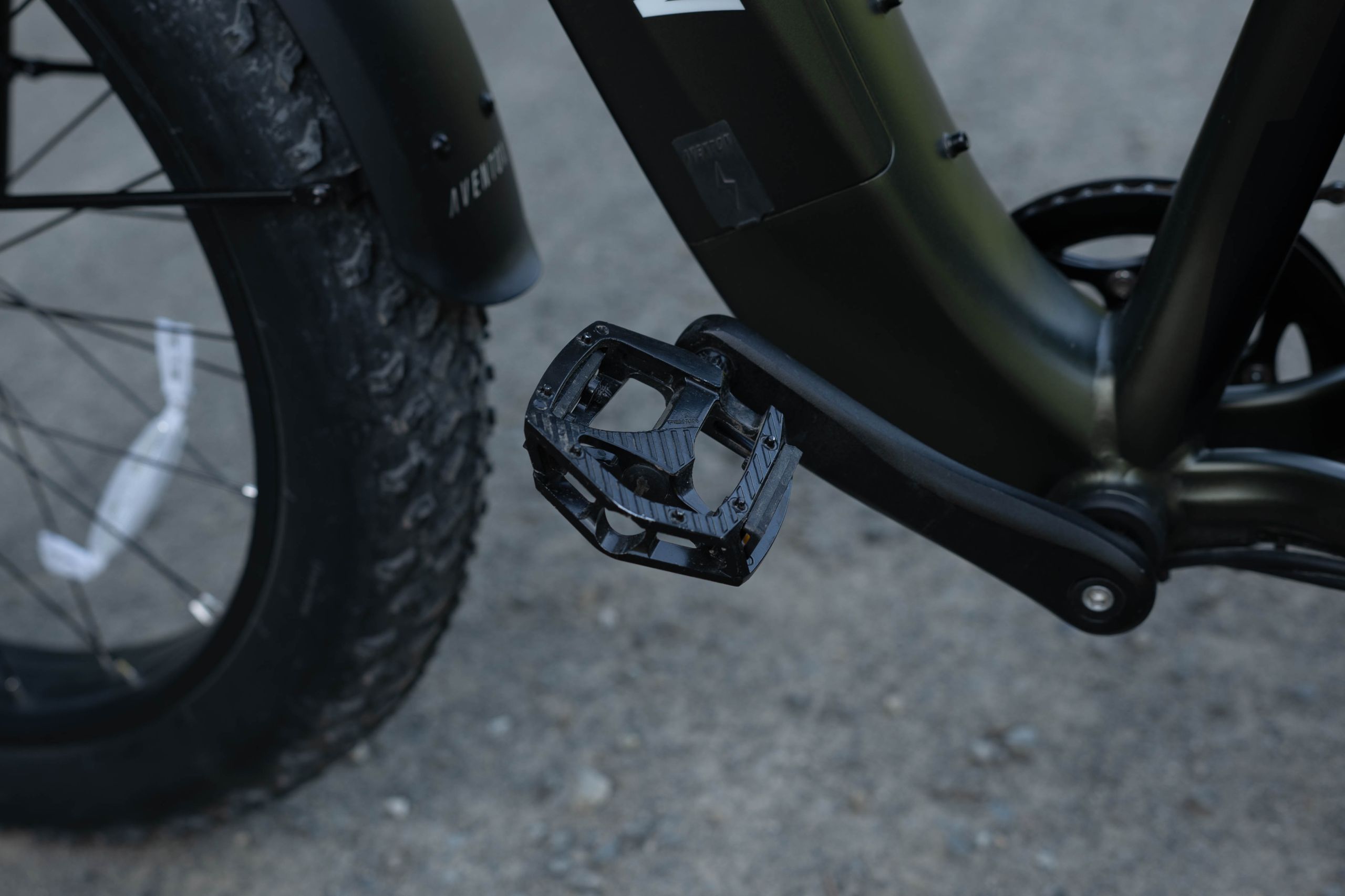

Last, the pedals. So, being accustomed to a set of Wellgo pedals that grace most bike builds, I was shocked to see a different shape. The Feiman platform pedals offer fine grip and worked well for me. They have a shape to them that matches the design of the bike, and I found the pegs grippy enough that I had no issue.

The biggest drastic difference at the back of the bike is this motor… the Aventure is much more powerful. There’s no denying it. They are both 750W e-bikes however not all 750W e-bikes are created equal. The RadRover peaks at 750W. The Aventure’s motor peaks at 1130W.
