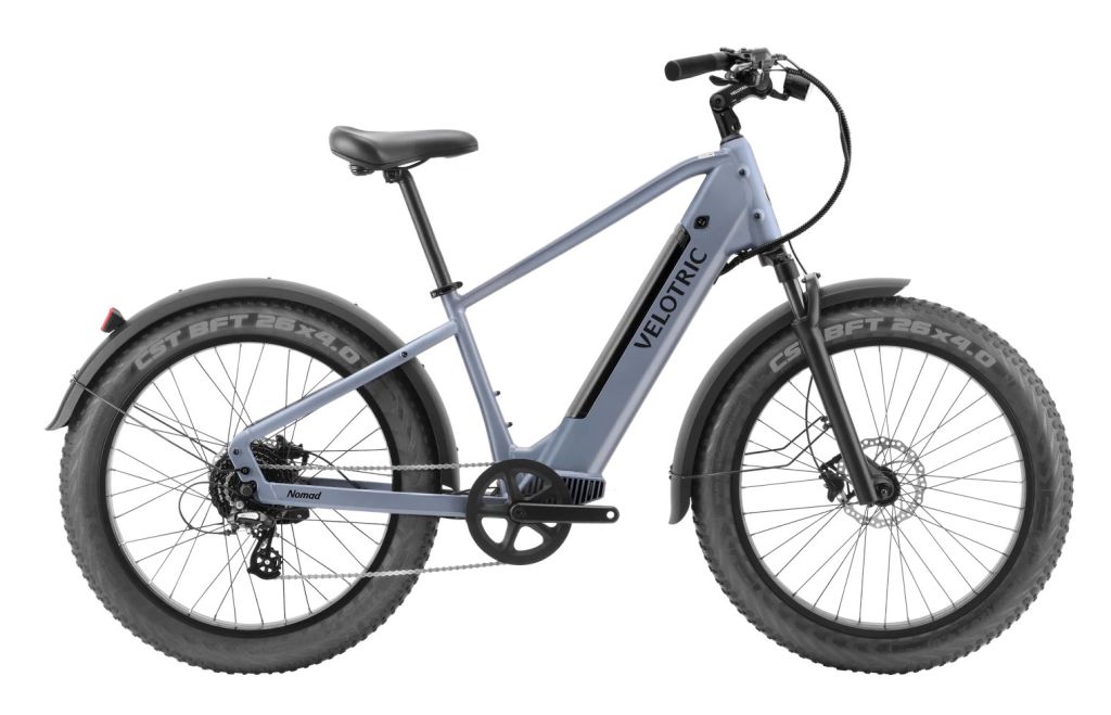

Velotric's Nomad 1 Plus is a 750W fat-tire e-bike available as a step-through or step-over. The latest "Plus" version has a slightly modified frame with fewer color options, a higher top speed, less aggressive acceleration, and an adjustable stem. The comfortable ride, solid climbing performance, high payload capacity, responsive pedal assist, and stopping power impress testers. Most complaints are minor, but buyers should be aware of the high weight, slightly below-average range, illegal top speeds when unlocked, and limited off-road capability. Overall, experts consider the Nomad 1 Plus competitively priced and a solid option in the fat-tire category.

The Nomad 1 Plus is a comfort-focused e-bike with a 750W rear hub motor, a 691 Wh battery, and 26″ wheels wearing fat 4” tires. It can be configured for full compliance with e-bike class 1, 2, or 3.
The Nomad 1 Plus has a hardtail frame with an 80mm suspension fork, and is available as a step-through or a high-step. I tested the step-through version.

The Nomad Plus 1 In Detail
With its powerful motor and claimed range of up to 55 miles, the Velotric Nomad 1 Plus is positioned as a “go anywhere adventure bike”.
Frame and Fit
The bike has a pleasant appearance with good curb appeal. It looks capable and burly, with big tires sporting a prominent XC tread pattern. The paint has a pleasing semi-matte finish, and is less metallic and fancy than the vibrant, shiny red on the Discover 2 I tested.
The bike has an aluminum frame, which comes as a step-thru or high-step, but in only one size each. Both frame styles are hardtails, with an 80mm suspension fork that has preload adjustment and a lockout—pretty typical for bikes in this price range.
The bike has a total payload capacity of 440lb for rider and cargo. The optional rear rack that came with our test bike can carry 55lb. Velotric also sells a front rack for this bike that’s rated for 33lb. On my scale, this bike weighs 72.4lb without the rack.
The Nomad 1 Plus has swept-back bars, and an adjustable stem with 60° of adjustment, allowing most riders to make the most of the straight-backed riding position.
However, I found the stated rider fit to be unrealistic. Velotric says the step-thru fits riders 5’1” – 6’4” and the high-step fits riders 5’6” – 6’9”. I’m 6’ tall and I only just fit this step-through frame, so riders taller than me might find it cramped.
E-Bike System, Controls, and Classification
The Nomad 1 Plus uses a 48V electrical system, with a 14.4Ah battery powering the Velotric-branded rear hub motor. That battery sits in the downtube and is secured with a keyed lock. Velotric includes a 3A charger, and the battery can be charged on or off the bike. The charging port is located on the upper side of the battery, on the drive side of the bike.
The motor uses a cadence sensor to detect rider input and also has a thumb-style throttle, which can be removed if you need to comply with Class 1 or Class 3 e-bike regulations in your area. Also, the speed limit can be adjusted between 12-28 mph. The 3-button control pad sits by the left grip, and there’s a 3.5” backlit LCD display in the middle of the bars.
Safety Certifications and Weatherproofing
As I mentioned earlier, the Nomad 1 Plus complies with a range of safety and performance standards, including UL2849, UL2271, and ISO 4210. The bike has IPX6-level weather protection, and the battery is IPX7-rated.
Suspension and Wheelset
The Nomad 1 Plus rolls on 26” spoked aluminum rims, which wear 26X4” CST BFT tires. These tires have an XC-style tread and include puncture protection, but they aren’t tubeless ready. Both wheels use nutted axles.
Drivetrain and Brakes
The drivetrain is well suited to the bike’s high-speed capability and aids in hill climbing. Its 8-speed Altus derailleur and trigger-style shifter are mated to an 11-32T freewheel at the rear. It uses 170mm aluminum cranks, and a 46T chainring, with a single-sided guard to keep your clothes out of the chain.
When it comes time to stop, the Nomad 1 Plus has unbranded hydraulic disc brakes with dual-piston calipers and 180mm rotors. Those brakes are controlled by aluminum brake levers with reach adjustment.
Cockpit and Touchpoints
The cockpit also has lock-on grips, the aforementioned thumb-style throttle and three-button control pad, a bell, and a trigger shifter. Other touch points include the Velotric Urban comfort saddle and plastic platform pedals.
The bike has a 60-lux front light and a rear light with brake activation. The Nomad 1 Plus comes with fenders, but the rear cargo rack seen on our test bike costs extra.

The more laid-back riding position on the Nomad 1 Plus is made possible by the swept-back handlebars and adjustable stem. If those are things you value right from the start, it makes the Nomad 1 Plus a compelling option.
