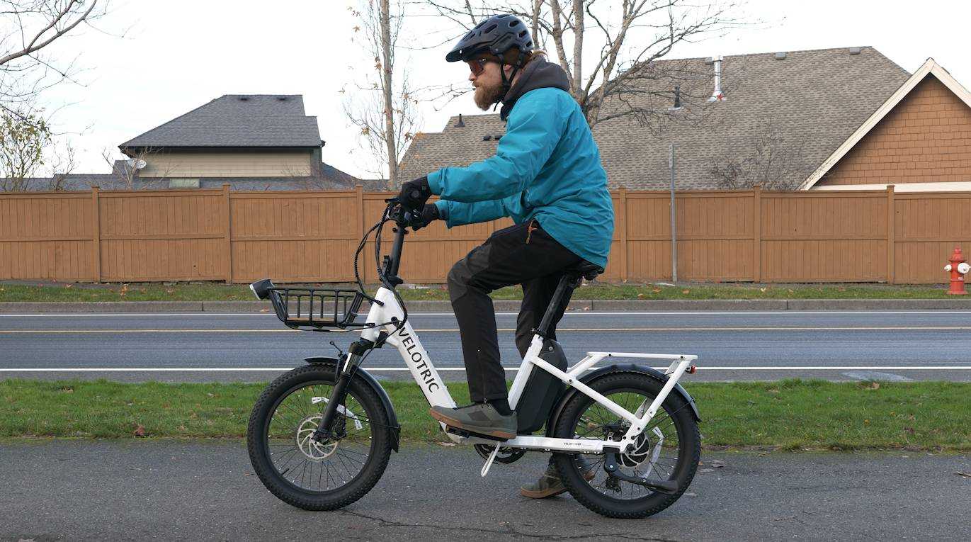

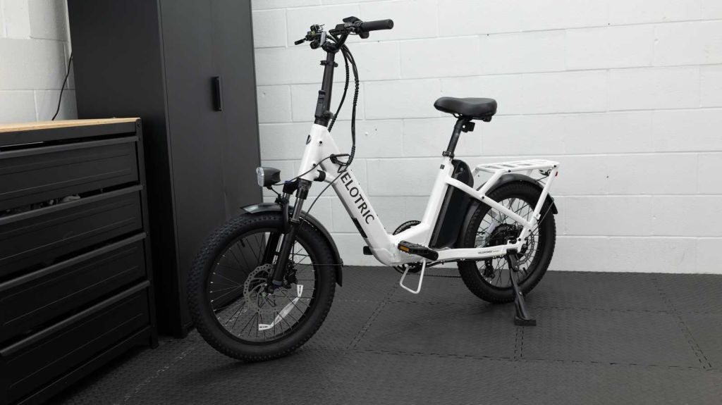

What Is the Fold 1?
This is a step-through folding e-bike that folds in the usual way, with one hinge in the middle of the frame and another above the head tube. The pedals also fold to reduce the folded footprint, and Velotric provides a basic Velcro strap to secure the bike when folded.
The Fold 1 is supposed to fit in any car, SUV, RV, or apartment, and at 65.8lb, most people should be able to lift it into a trunk. However, carrying it is challenging. We were able to fit the bike in an SUV, but we didn’t test putting it in a regular sedan.
Velotric says the folded bike is 33″ high, 38″ long, and 19″ wide, but we measured 40″ long. The other two dimensions are accurate.
The Fold 1 is only available in one size, but handlebar and seat height can be adjusted to achieve a better fit. The bike comes in three colorways: Stone Grey, Electric Blue, and the glossy Pearl White we tested.
The 750W rear hub motor peaks at 1,050W and has 70Nm of torque. The 7-speed drivetrain is typical budget Shimano with an Altus trigger shifter next to the right grip and a Tourney rear derailleur. This setup operated fine throughout testing. Like most budget folding e-bikes, the Fold 1 uses a cadence sensor.
Other standout characteristics of this bike are its 440lb weight capacity, good acceleration and hill-climbing performance, and great brakes. It also has a sturdy integrated cargo rack rated for 120lb. Velotric offers a good range of bags, baskets, and other accessories to install on the generous mounting points.

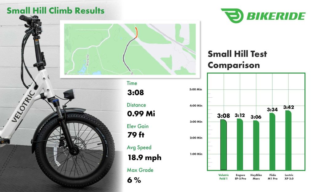

Velotric Fold 1 - Hill Climb Small
Powerful Motor
The Fold 1 is powerful and peppy, with good acceleration thanks in part to the responsive pedal assist. There’s plenty of power for hills, and the bike easily maintains 20mph.

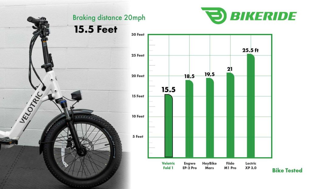

Velotric Fold 1 - Brake Test
Great Brakes
The Fold 1’s brakes are excellent. Many budget folding bikes make do with mechanical brakes, but the Fold 1 has two-piston Tektro hydraulic discs.
The brakes were quiet throughout testing, and they stopped the Fold 1 from 20mph in an impressive 15.5 feet, several feet shorter than competing bikes we have tested.

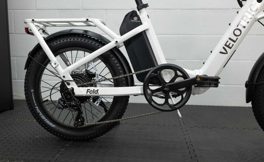

Frame and Geometry
The aluminum step-through frame is available in three colors. However, it comes in only one size, which Velotric says fits riders from 4’9″ to 6’5″. As explained, this height range isn’t accurate, and this bike doesn’t suit riders taller than about 6′ or with inseams greater than 32″.
Handlebar height can be modified using the stem’s 80mm of adjustability, but there’s no way to alter reach.
The Fold 1’s dimensions match those Velotric lists, except for the folded length, which Velotric puts at 38″, but we measured at 40″.
The Fold 1 has a budget 60mm coil suspension fork that feels better than most other cheap suspension forks, with no clunk or harsh bottoming out.
Suspension Fork
The bottom bracket on this bike is press-fit, so most owners will need a professional mechanic if it needs servicing.
This bike is rated to carry 440lb of rider and cargo and up to 120lb on the rear rack. There are lots of places to mount accessories, and Velotric offers many accessories, such as bags, baskets, and seat pads.

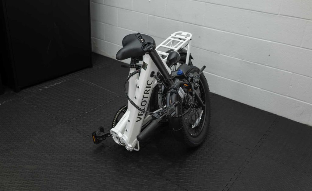

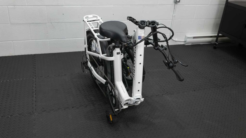

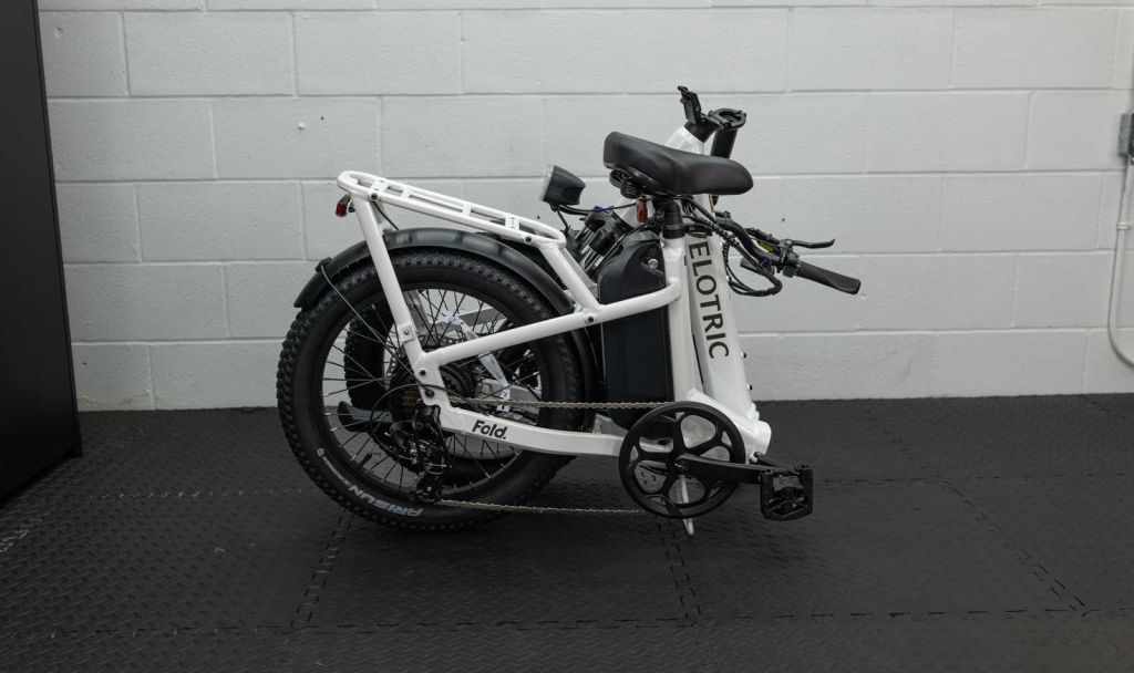

The bike folds in three places: at the top of the head tube, in the middle of the frame, and at the pedals. The frame and head tube hinges are secured by a spring-loaded clasp, with a thumb-operated locking lever that prevents users from unintentionally opening the clasp.
The hinges worked smoothly throughout testing and were secure when closed. Despite these folding points, the bike felt solid, with no shimmy.

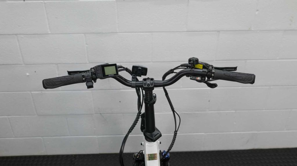

Fold 1 display and controls

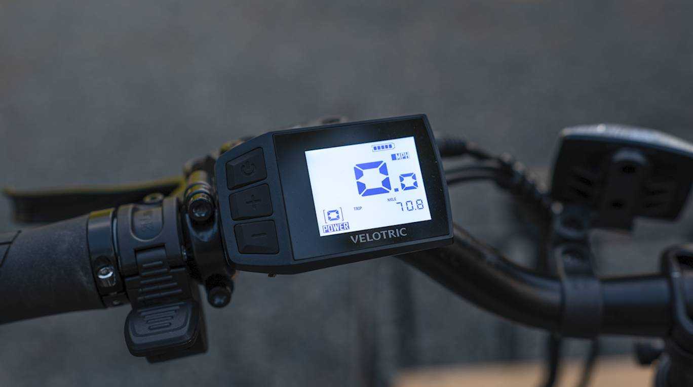

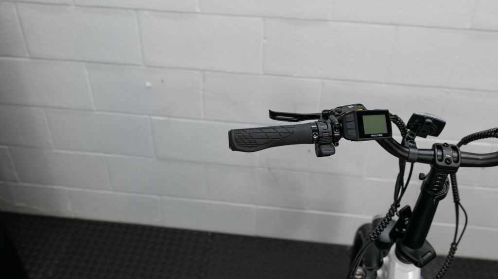

Display and Control
The Fold 1 has a basic 1.8″ black-and-white display mounted in landscape orientation. It also has a 3-button control pad and a USB port for charging a phone. The USB port is the older Type-A style, not the current Type-C.
Several Velotric bikes, including the Fold 1, don’t have a key-operated lock or display lock to secure the bike and prevent the display from being powered on.
The display has a simple five-bar battery indicator with no percentage readout, making it hard to estimate remaining range.
The screen has icons for light, walk mode, error, battery, current speed/units, PAS level, riding data, and power output.
The Fold 1’s display doesn’t have an advanced settings menu but lets you customize some display settings.
The Fold 1’s speed limit can be adjusted by pressing the power and minus buttons for 20 seconds when the bike is turned off. This brings up a screen showing the speed setting. Powering the bike off saves the new setting.

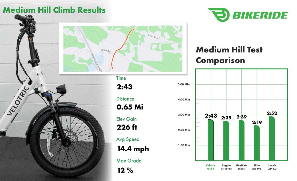

Velotric Fold 1 - Hill Climb Medium

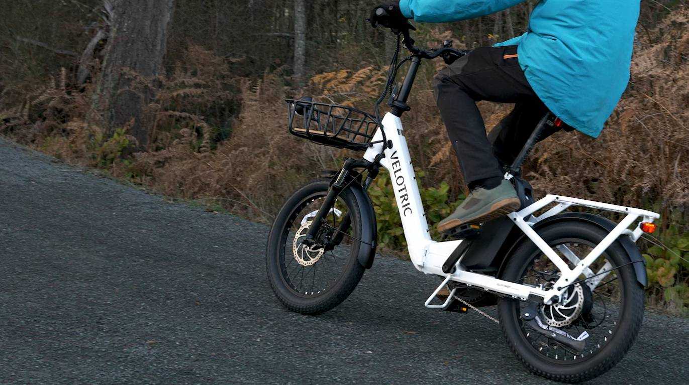

Motor
The Fold 1 has a 750W Velotric-branded motor in the rear hub. It produces 70Nm of torque and a peak power of 1,050W.

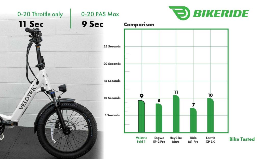

The cadence sensor is well-tuned, and when riding, the bike feels powerful and peppy, whether using pedal assist or throttle.
In testing, the Fold 1 demonstrated better motor response and quicker acceleration than Velotric’s already impressive Discover 1 Plus, which also uses a cadence sensor.
Velotric Fold 1 - 0-20 Test
The thumb-style throttle works nicely and is good for maintaining higher speeds, though this obviously uses more battery than pedal assist. The throttle provides power in line with the selected PAS level.
The Fold 1’s performance test results put it in the middle of the pack of the folding e-bikes we’ve reviewed for most metrics. The one place where it was a bit slower was in the climbing tests.

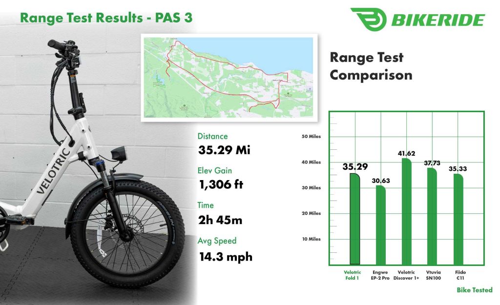

Velotric Fold 1 - Range Test Results PAS 3
Battery and Charger
The Fold 1 has a 48V 12.6Ah battery. At 608Wh, it’s quite a bit less than we’d like to see with a 750W motor, but in range tests, the Fold 1 generally performed on par with the competition.
As with all Velotric e-bikes, the battery and electrical system are UL-listed. The 2A charger is on the small side, so charging takes up to six hours.

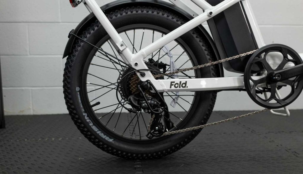

Drivetrain Fold 1
Drivetrain
Like so many entry-level e-bikes, the Fold 1 has Shimano 7-speed gearing, in this case, a 52t chainring with a single-sided aluminum chain guard and a 14-28t cassette at the rear. While this gearing is fine for pedaling at speeds up to 20mph, ghost pedaling starts above that speed.

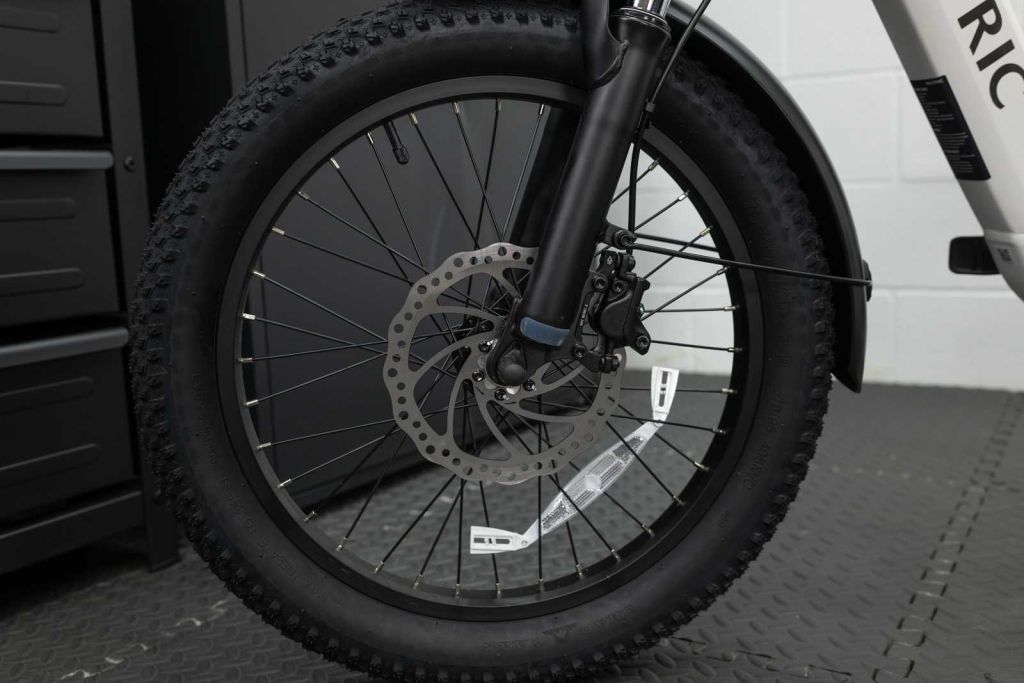

Brakes Fold 1
The Fold 1 has hydraulic disc brakes with Tektro two-piston calipers and 180mm brake rotors. The brake levers have set screws that allow you to adjust the lever reach.
The brakes are responsive and quiet. In testing, the Fold 1 took just 15.5 feet to stop from 20mph. This is substantially shorter than competing bikes we’ve tested.

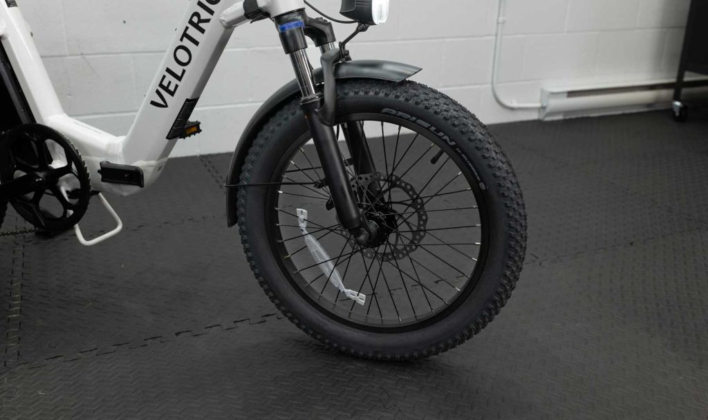

Wheels, Tires, Fenders

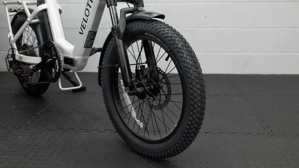

The Fold 1 rolls on 20″ aluminum alloy wheels and 3″ wide Chaoyang Arisun tires. The combination of width, light off-road tread pattern, and Chaoyang’s K-RUBBER compound provides a nice mix of traction and ride comfort for urban rides and light trails.

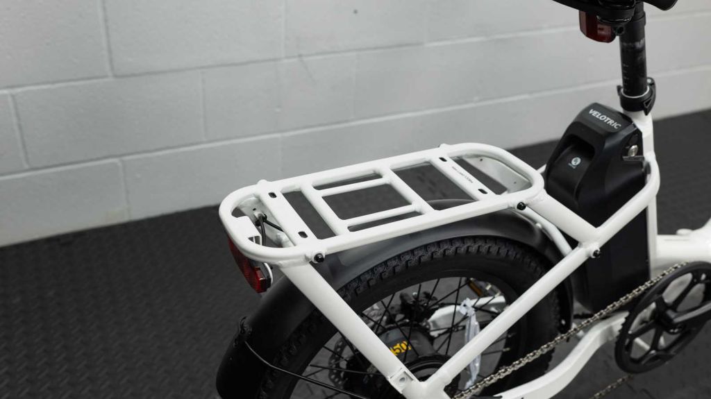

The integrated rear rack is rated to carry 120lb, and Velotric offers optional own-brand and aftermarket baskets, bags, and other accessories for customizing the bike.
The head tube has dedicated mounting points for Velotric’s front rack, and there are two sets of bosses on the down tube for bottle cages and other accessories.

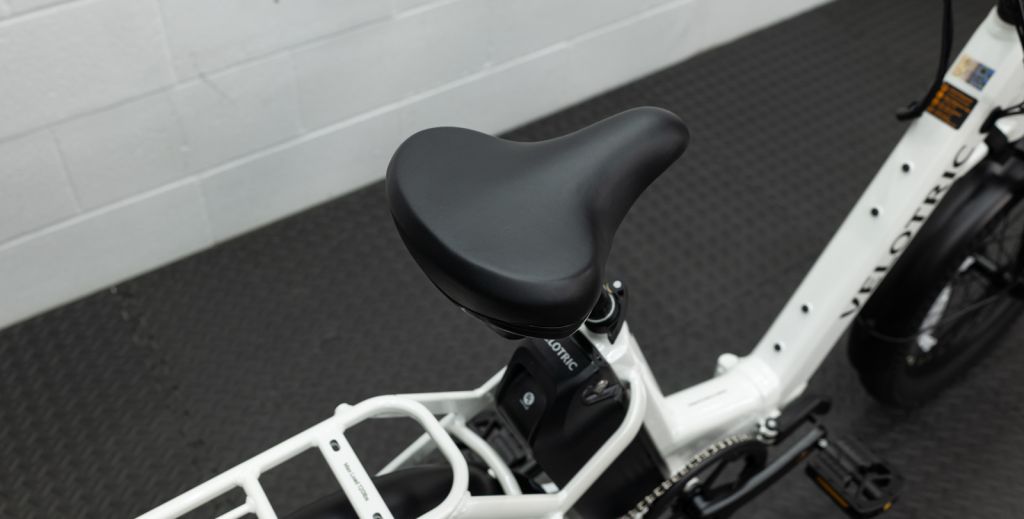

The Fold 1’s saddle is the same urban comfort unit found on many Velotric bikes. It offers plenty of cushion and is wide enough to provide good support without getting in the way of pedaling. The saddle was comfortable for longer rides.
