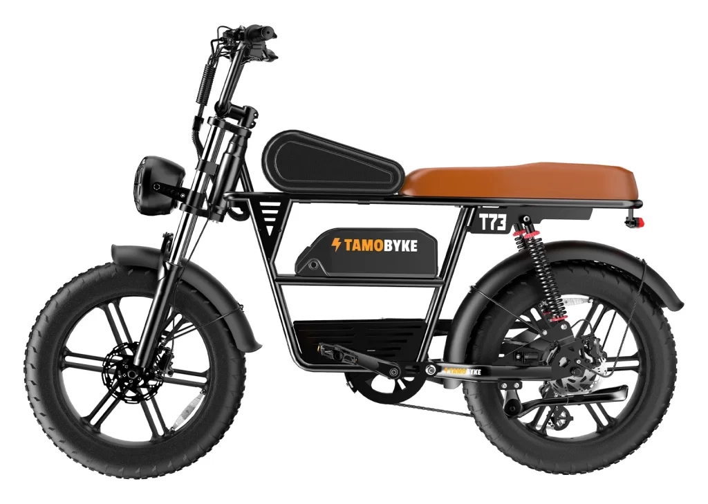

We have read all expert and user reviews on the Tamobyke T73. In summary, this is what cyclists think. Published Jan 21, 2026 by Reda Ashour.
  • This bike is available in three builds: the T73, T73 Max (two batteries), and the T73 Pro Max (two batteries and motors).
  • All builds come with a headlight, a taillight with turn signals and brake light, fenders, passenger foot pegs, and an in-frame storage basket.
  • Reviewers praise the stopping of the Logan hydraulic disc brakes.
  • A tester of the standard build appreciates the gradual throttle acceleration.
  • Testers and owners are pleased with the rapid acceleration and high top speed (37mph) of the T73 Pro Max.
  • The dual-battery builds come with two chargers.
  • Reviewers say the T73 Pro Max handles steep hills well.
  • A 300lb tester of the T73 Pro Max gets 34.5 miles of range from both batteries in dual-motor mode.
  • Reviewers say the full suspension and fat tires absorb road vibrations well.
  • A tester enjoys the upright, comfortable seating position.
13 reasons not to buy
  • The T73 doesn't have UL safety certification.
  • The product specifications are inaccurate, and Tamobyke doesn’t confirm nominal motor wattage when asked.
  • Two reviewers say their T73 Pro Max test bikes do not have 41.6Ah battery capacity, as advertised.
  • With a fixed seat height of 32.28”, riders at either end of the 5’3” to 6’ height range are unlikely to fit.
  • Buyers and reviewers find the seat too firm.
  • The suspension fork isn't adjustable, and some reviewers say it bottoms out easily. The rear shock is also considered too stiff.
  • A tester can’t use the passenger footpegs because they are too close to the pedals.
  • An expert is disappointed in the T73 base model’s poor climbing ability and range.
  • A reviewer says the instruction manual lacks important information.
  • At 99.42lb to 115.57lb, the T73 is very heavy.
  • The charging times of all builds are lengthy.
  • When using the throttle, the front motor (T73 Pro Max) always gets full power, meaning the front wheel loses traction easily.
  • The T73 exceeds the maximum legal speed of 28mph in all builds.
The Tamobyke T73 is a budget-friendly motorcycle-style e-bike available in three builds. Reviewers enjoy testing the blisteringly fast dual motors of the T73 Pro Max. The base model’s top speed impresses as well, as do the strong hydraulic disc brakes on all builds. Testers wish for more comfort from the seat and suspension, but appreciate having full suspension at this price. Other noted concerns include specification discrepancies, inaccurate sizing, and high weights. In all, the T73 builds are recommended for their low cost, but other Tamobyke owners complain of poor customer support and warranty fulfilment.
