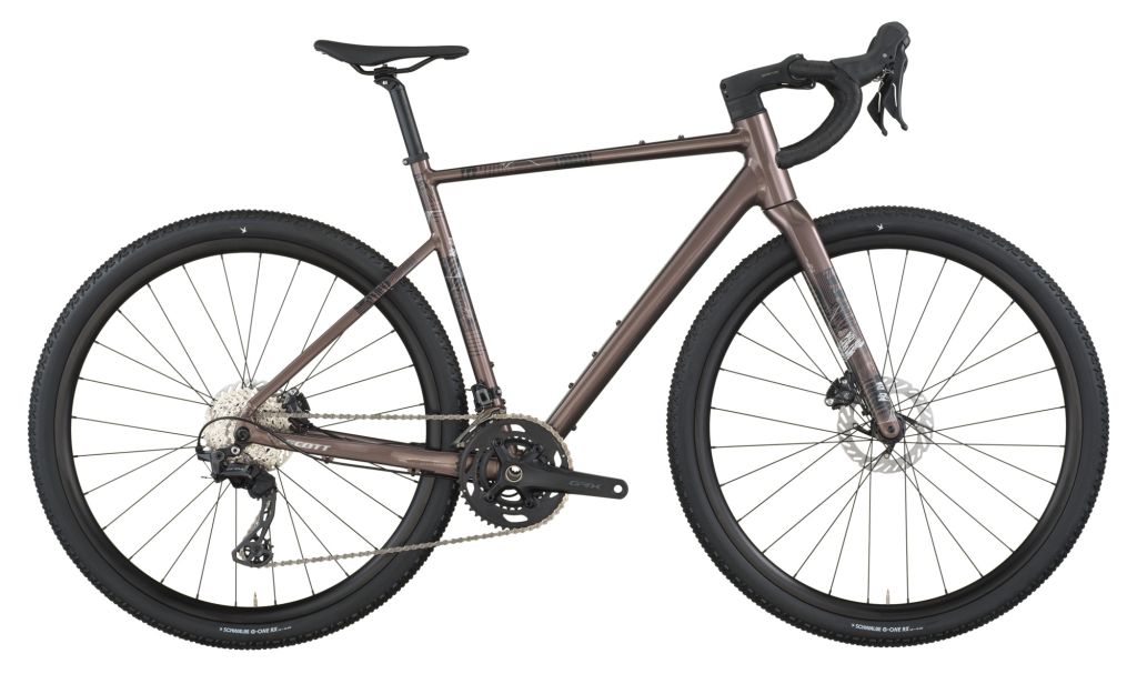

Bike Description
The Speedster Gravel line has been around for a few years. The 2025 builds are a mix of 1x and 2x, with four options from the Team at the top to the Speedster Gravel 30 at the bottom.
Our Speedster Gravel 40 is 2x and comes from the 2024 generation. In the past, the Speedster Gravel 40 sat below the 40 EQ and above the 50EQ, 50, and 60. SCOTT no longer offers those four builds, but they might still be available from some retailers.
The Speedster Gravel 40 only comes in one color but is available in an above-average seven sizes from XXS to XXL. The dark Mastaphora Grey with gold accents looks great.
The bike has an aluminum frame and fork and weighs 25.13lb in size Large. It has a weight capacity of 265lb.
The Speedster Gravel 40 rolls on aluminum Race X25 Disc rims from SCOTT’s in-house component brand, Syncros. These 28-hole rims have an internal width of 25mm and pair with Formula Team II CL hubs.
The tires are 45mm Schwalbe G-One Bite Performance. This version of these tires is tube-only, which is disappointing, as the aftermarket version is tubeless-ready.
At 2,050g, the wheelset is an obvious area to cut some weight from this bike, especially for riders who want to run narrower rims and tires for lighter gravel road riding.
The groupset is 2×10 Shimano Tiagra with Tiagra 4700 shifters and derailleurs, a 50/34t crankset, and an 11-34t Shimano cassette. This combination provides gearing ratios from 1.0 to 4.55. The lowest gear is okay for moderate climbs, but steeper ones will require getting out of the saddle, which isn’t ideal if trying to maintain traction on a loose or wet surface off-road surface.
Braking is handled by Shimano BR-RS305 mechanical disc brakes with centerlock 160mm rotors.
The cockpit includes a Syncros Creston 2.0 Alloy handlebar and 103mm stem. Cables enter the frame below the stem and are fully internal from that point. This gives the Speedster Gravel a clean look and protects the cables, but complicates servicing. The Gravel 40 also comes with a Syncros Tofino Regular 2.5 endurance saddle.
With bento-bag mounts on the top tube, a pair of bottle-cage mounts on the seat tube, three bosses on the down tube, and another pair under the down tube, the Speedster Gravel is nicely set up for bikepacking. Unfortunately, however, there aren’t any mounts on the fork, and there’s no way to mount regular fenders to the seatstays. Syncros sells direct-fit fenders for the Speedster Gravel line, but they only appear to be compatible with the 10, 20, 30, and 50 models; the fork on the 40 doesn’t have the hole for fitting the front fender.
Overall, the Speedster Gravel 40 is a good-looking bike with a decent component specification for an entry-level bike, and comfortable geometry that should allow for easy all-day riding on gravel terrain.
