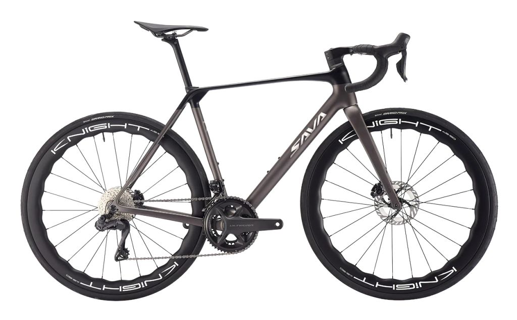

Is This Chinese Aero Road Bike Good Value? SAVA AeroX SLR8 Review
The AeroX SLR8 is a slick aero road bike with a full carbon build kit, a premium groupset, and a surprisingly low price tag, so we were excited to see how it would perform in real-world testing.

The AeroX’s elegant lines, dark colors, and an attractive metallic black and grey finish give it a sleek, premium look. The aerodynamic frame is made from T800 carbon fiber, with T1000 reinforcement. The frame has fully internal cable routing and tapered aero shapes.
Fully assembled, the bike weighs 16.64lb in size large (7.54kg). For comparison, the $6,599 Trek Madone SL 7 Gen 8 is heavier at 17.36lb. The AeroX frame comes in three colors and five sizes from XS to XL. I’m testing the size L (540) frame.
I inspected the inside of the steerer tube and frame using a borescope, and the interior of the frame looks well finished, with no noticeable inconsistencies or red flags, such as peeling carbon fiber. The steerer was also fairly well finished, though there are a few ridges and seams that I have not seen on more expensive carbon forks. To the naked eye, the quality of the carbon appears to be good.
SAVA offers the AeroX as an SLR8 with Ultegra Di2, which we’re testing, or SLR7 with Shimano 105 Di2. The Ultegra version comes standard with W45 carbon wheels. Buyers can also choose Shimano’s Dura Ace C60 wheels at checkout, but this raises the price considerably.
The W45 wheels are labeled with Knight stickers, but these have nothing to do with Knight Composites in the USA. These are YiHang carbon rims with a wavy profile, and the hubs are unbranded. The front wheel has a 45mm depth, and the rear 50mm.
The wheels are wrapped in 28mm Continental Grand Prix tires, the ‘endurance’ version of the GP 5000 racing tire. The wheelset weighs 1,595 grams, 706 grams for the front wheel, and 889 grams for the rear. The tires weigh 285 grams each, the tubes 89 grams.
