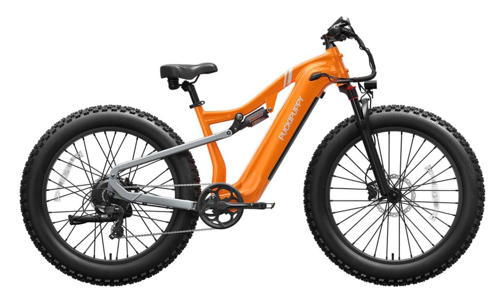

The Puckipuppy Labrador Pro is a full-suspension e-bike with fat tires, a 750W motor, and a 960Wh battery. Puckipuppy claims it's an e-MTB: it's not. The company also says it's "powerful, and built for any mountain adventure..." but the cheap suspension provides little benefit, even over light off-road terrains, and the bike is very bulky and heavy. Two testers seek professional tuning to get the bike running smoothly, and the height range is exaggerated, among other issues. While the camouflage Labrador Pro may look the part, it falls laughably short of Puckipuppy's bold claims.

Specifications
The Labrador Pro arrives well-packed in a typical cardboard bike box. The package includes the 2A charger, headlight, and tool kit. Puckipuppy also provides a pump and spare bolts and brake pads, a nice touch.
Puckipuppy offers a few different accessory bundles that can be purchased with the bike. Our test bike came with accessories like a rear rack and fenders.
Assembling the bike requires installing the kickstand, aligning the fork and stem, and attaching the handlebars. To finish, buyers must install the front wheel, pedals, and any other accessories purchased.
The Puckipuppy Labrador Pro has an aluminum frame, a suspension fork, and a shock with a 40mm stroke. Puckipuppy claims the fork has 130mm of travel, but the fork on our test bike measures just 110mm. The company confirmed that the bike should come with a 130mm fork, but offered no explanation of why ours doesn’t.
The Labrador Pro has a 48V electrical system with a 750W rear hub motor powered by a 20Ah battery. Pedal assist is managed by a torque sensor and powers the bike to 28mph. The thumb throttle stops assisting at 20mph.
The Labrador Pro comes in a choice of four frame colors but only one size, which Puckipuppy says fits rides from 5’4” to 6’6”, which is exaggerated. Puckipuppy says the bike can carry up to 400lb.
The Labrador Pro has been certified for UL 2271 compliance with SGS and UL 2849 compliance testing is in progress at the time of writing. We had to ask about the bike’s water ingress resistance rating, as this isn’t listed on site. The bike has an above-average IPX6 rating.
The 26” wheels have spoked aluminum rims, and the 4″ tires have a cross-country tread pattern. The drivetrain comprises Shimano Altus shifting, a 46t chainring with single-sided chainguard, and an 11-32t cassette. The brakes are Logan hydraulic discs with 180mm rotors.
The e-bike controls include a 2.7″ LCD display and five-button control pad with dedicated buttons for the lights and electronic horn. The battery life is displayed as a six-bar graphic.
