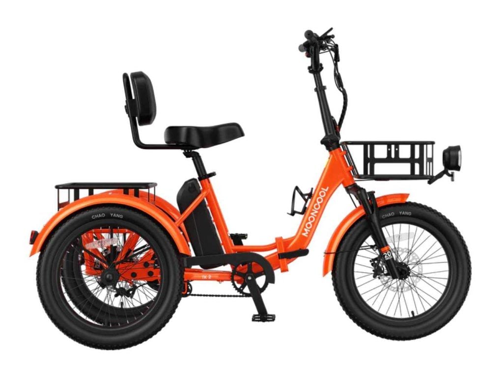

  • The Mooncool TK2 comes with front and rear baskets, fenders, a bottle cage, a headlight, brake-activated taillights, and turn signals.
  • Experts appreciate the comfort provided by the upright riding position and the padded saddle with a backrest.
  • Testers praise the smooth and gradual throttle acceleration.
  • A 210lb reviewer gets a range of 36.8 miles using max assist on a flat, paved route.
  • The Star Union hydraulic brakes deliver above-average stopping power in testing.
  • A 200lb tester climbs a 20% grade using only the throttle.
  • This trike has parking brakes and reverse mode.
  • Experts say the knobby 3" wide tires grip well over pavement, grass, and gravel.
  • The telescopic stem allows quick fit adjustments.
  • Reviewers find the TK2 stable and less “tipsy” than other e-trikes.
  • The color display is easy to read in daylight and includes a USB-C charging port.
  • Experts say assembly is easy.
  • The TK2 is available in six colorways.
10 reasons not to buy
  • Testers report uncomfortable ride over bumpy pavement, and recommend adding a suspension seatpost.
  • The front suspension is too stiff, according to reviewers.
  • The single-speed gearing results in ghost pedaling at 12mph.
  • Mooncool recommends this trike for riders 5’-6’3”, but a 5’1” tester struggles to find a comfortable riding position.
  • At 95.7lb, this trike is difficult to lift and carry, limiting the practicality of the folding design.
  • The backrest’s lack of fore-aft adjustment disappoints reviewers.
  • The slow 2A charger makes for long charging times.
  • The battery percentage changes in 20% steps and the readout is unreliable, say experts.
  • One reviewer laments the lack of cruise control.
  • A tester experiences brief, unexpected drops in motor power.
Mooncool's TK2 upgrades over the previous version with a reverse function, a backrest, an improved display, and a slightly bigger battery capacity, but it no longer has cruise control. The gradual acceleration, solid range, reliable brakes, and climbing ability earn praise. Reviewers also appreciate the trike’s stable handling in turns, upright riding position, and easy assembly. Complaints include poor ride comfort over bumpy pavement, ghost pedaling, and an inaccurate battery readout. The high weight also makes the folding feature impractical. Nevertheless, at this price, reviewers consider the TK2 good value.
