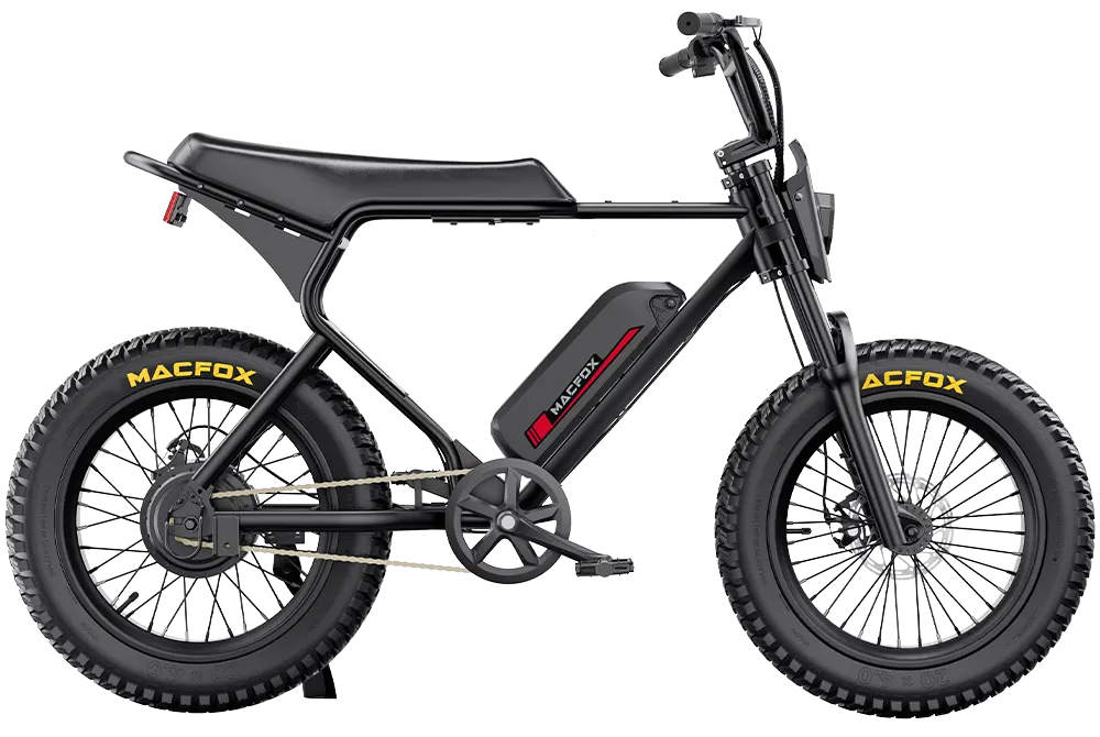

The Macfox X1S is a motorcycle-style e-bike with a 500W motor. It's available in two colorways and the choice of one or two 1,000Wh batteries. The sole reviewer praises the headlight and comfortable seat but laments the very bumpy ride, lack of grip off-road, ghost pedaling over 15mph, and cheap brakes. Though the bike only reaches 22mph in testing, this is still higher than legally allowed using a throttle. The X1S lacks fenders, a rear light, and UL certification. Many buyers complain of broken bikes. All things considered, Macfox's X1S is best avoided.

The X1S in Detail
The Macfox X1S is described as a Class 2 e-bike, but the stated top speed of 25mph using throttle or pedal assist means it doesn’t actually comply with US e-bike rules. No e-bike should exceed 20mph using the throttle.
The regular X1S comes in an all-black colorway or a Bs.zay collab edition, which is finished in an eye-catching mix of purple and white. The Bs.zay edition has an upgraded fork and display.
The X1S comes in one size, and Macfox says it fits riders from 5’3″ to 6’6″, but the non-adjustable, 33” seat height means this stated height range isn’t realistic.
With only a basic 120mm coil suspension fork and no rear shock, the X1S is only suited to paved surfaces and very light off-road trails.
The small 2A charger takes five to six hours to charge the 10.4Ah battery. There are three PAS levels, and assist is modulated by an insensitive cadence sensor.
The X1S’s 20” wheels have alloy rims and nutted axles. They come fitted with 4” fat tires with an off-road tread. There’s no indication of the tires having puncture protection or being tubeless-compatible.
The best thing about the single-speed drivetrain is that it should require less maintenance than one with a derailleur. However, the gearing provided by the 42t chainring and 16t sprocket makes it hard to pull away, climb hills, or pedal at speeds over 16mph.
Braking is handled by mechanical disc brakes and 180mm rotors. Considering most budget e-bikes have hydraulic brakes, this is another letdown.
The cockpit has a backlit LCD screen that shows the speed, which pedal assist level is selected, and the battery charge as a five-bar readout. There’s a twist throttle and controls for the headlight.
The seat is 24” long, the grips are hard plastic, and the pedals are a standard aluminum platform-style. So far, this bike’s basic specification, lack of adjustability, cheap components, and unclear safety and water resistance raise big questions, but does the Macfox X1S deliver where it matters most?
