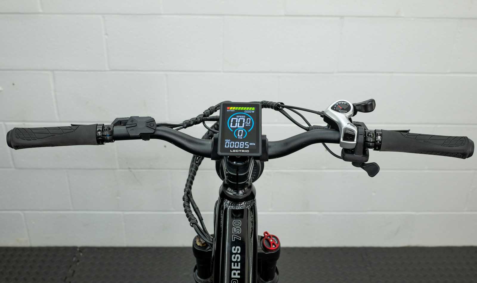

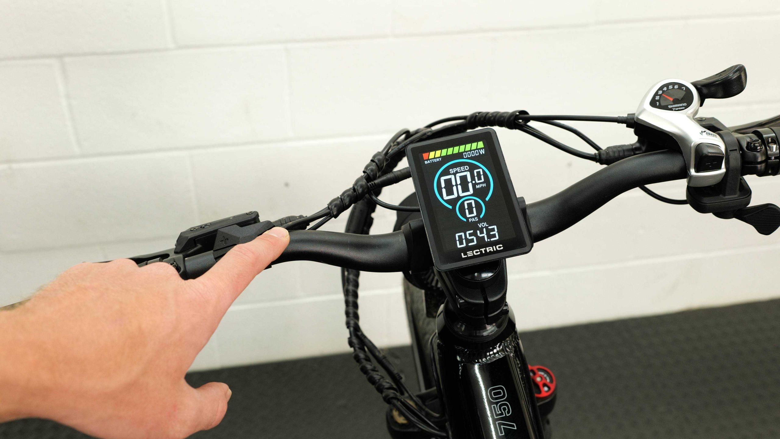

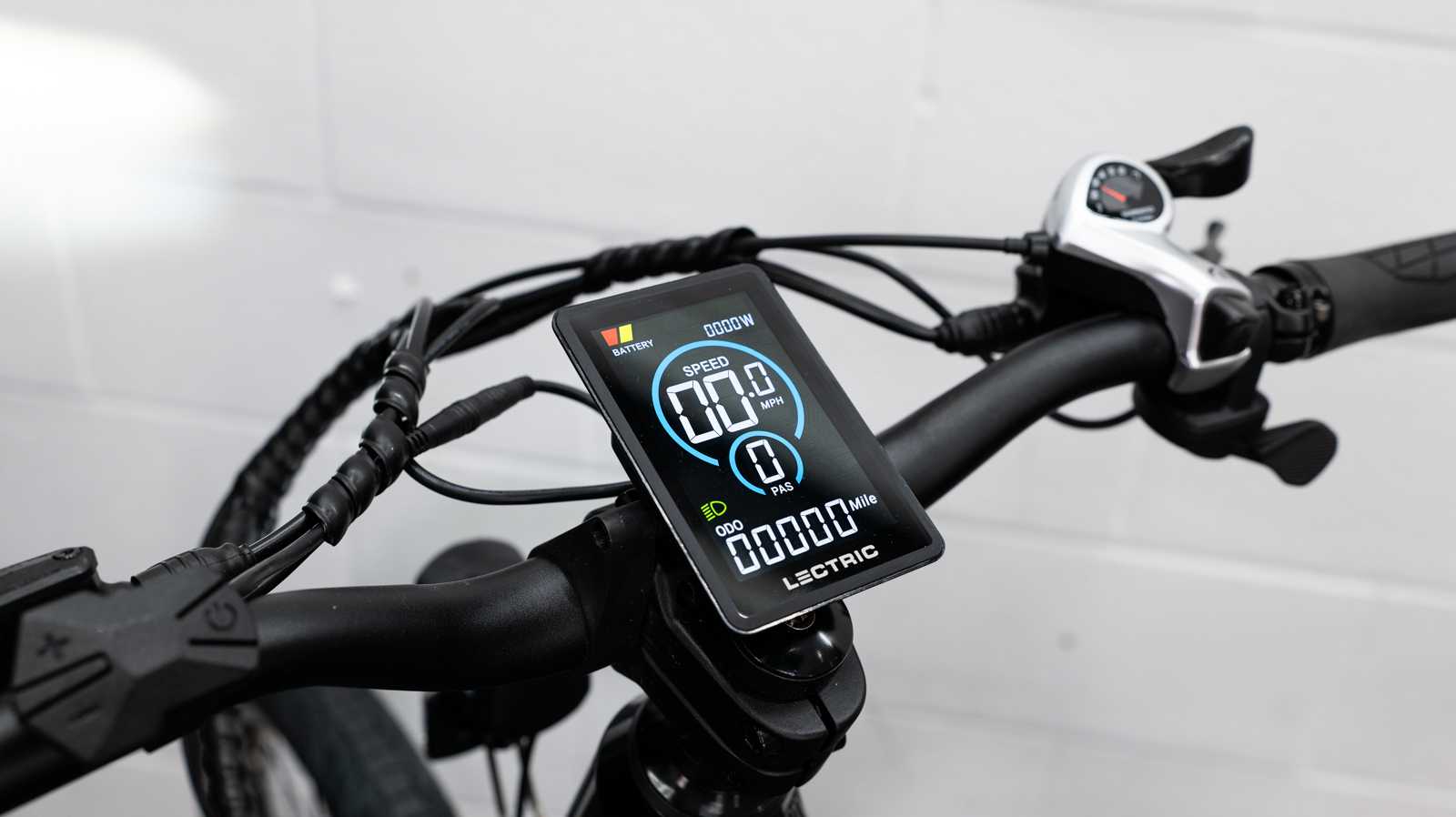

The display is big and bright and has simple controls, but the battery meter is inaccurate, which we will discuss further in the cons.

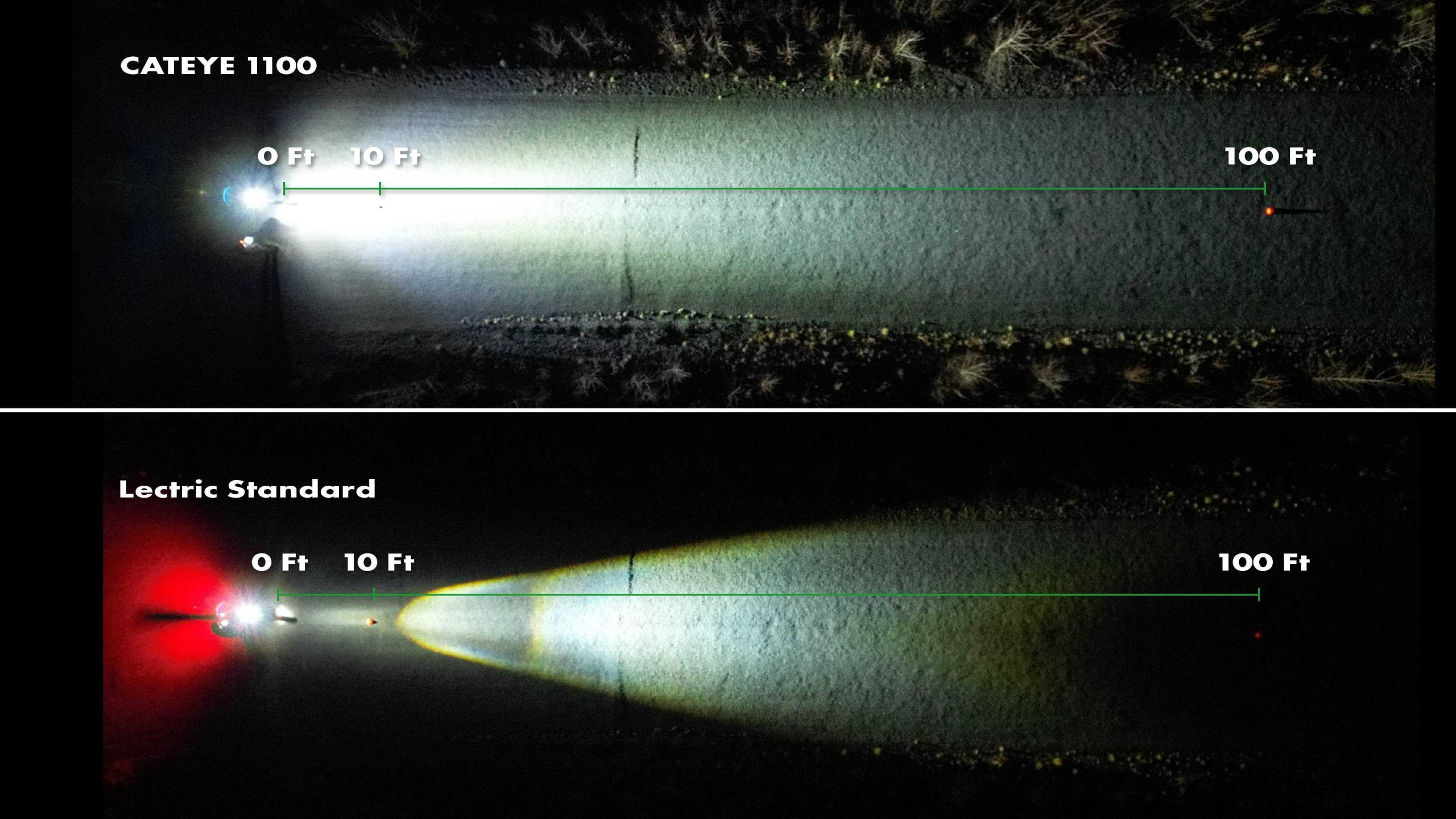

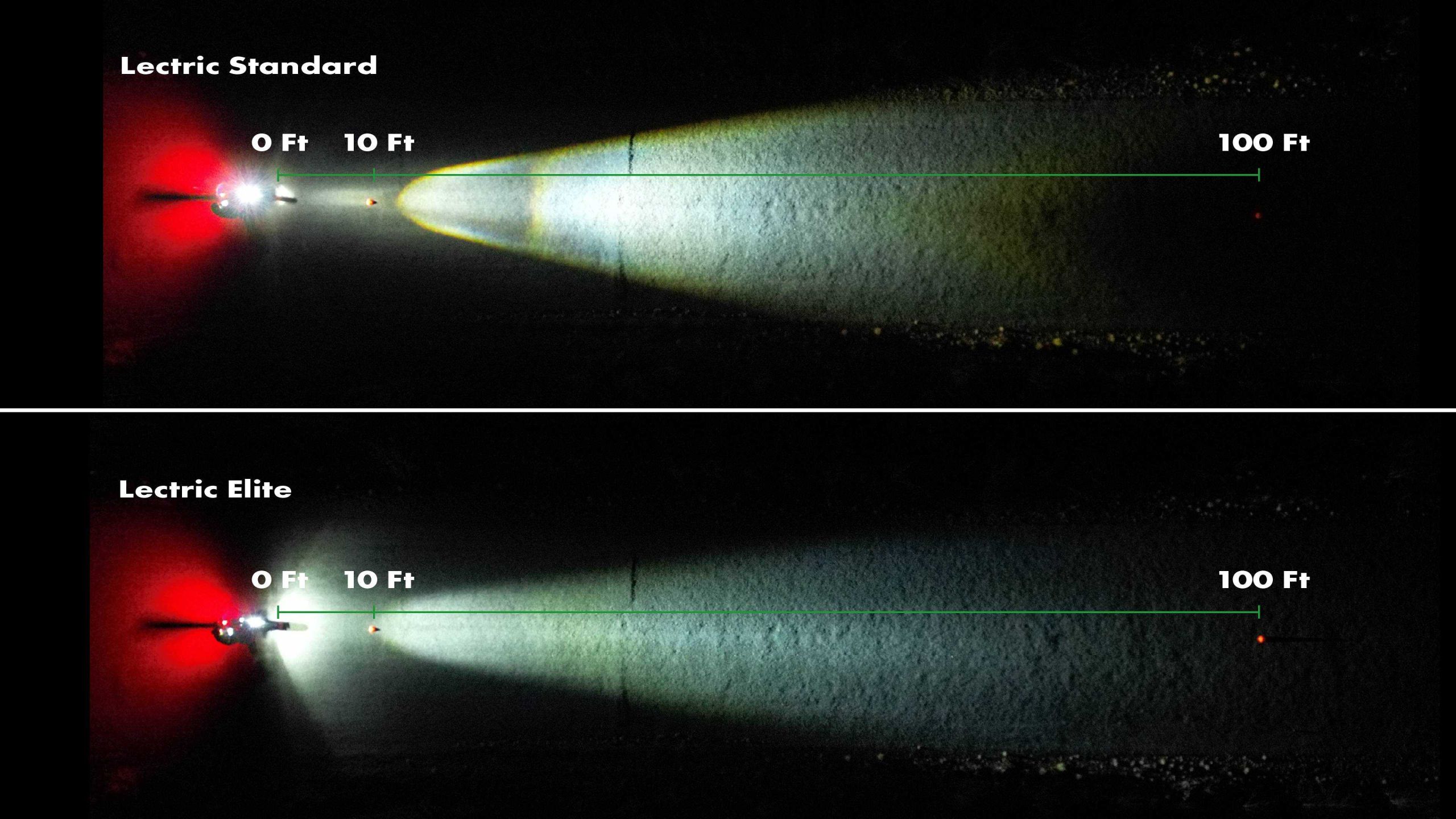

Poor Lights
In addition to this bike’s standard front light, Lectric included its Elite headlight for testing. This light has a stated output of 850 lux, four times that of the standard light, but it costs extra.
In testing, both the standard light and the Elite were dim and inadequate. While the Elite illuminates a traffic cone at 100 feet, it doesn’t provide sufficient peripheral lighting.
Neither of these lights is adequate for standalone use at night. In addition, the rear light has no flashing modes or brake activation. Overall, the included lighting is disappointing.

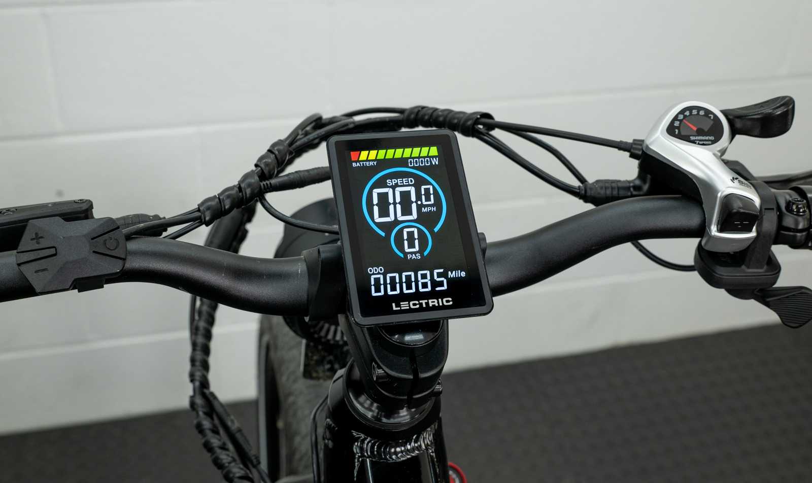

Erratic Battery Indicator
This bike’s ability to estimate remaining battery is abysmal. The battery has 10 bars: seven green, two yellow, and one red. This is double the typical five-bar indicator, but it manages to be less accurate, and the bike causes severe range anxiety.
After 12 miles into the PAS 5 range test, the meter was still full. Just one mile later, after climbing a large hill, the bars started falling like dominoes. After another five miles, the battery meter showed just five bars, but once back on level ground, the gauge rose again to six bars.
At this point, I stopped to swap camera batteries, and after a few minutes idle, the bike automatically powered off. When I restarted the bike a few moments later, the battery level was back at full bars. Of course, the bars soon began dropping again. In the end, I used the voltage display to monitor the battery charge.
Eventually, the battery meter falls to the last bar, and then this red bar starts flashing to say the voltage is very low. If the voltage falls below 40.8V, the screen starts flashing the E-006 error code. However, true to this bike’s nature, even this error code is erratic. By reducing pedal pressure for a few seconds, the error code disappears, leaving just the flashing red bar on the battery meter.
While the bike displays the flashing red bar and the error code, the motor provides minimal power from the throttle. However, there’s still plenty of pep from the pedal assist, with up to 500W output showing on the display and the bike reaching up to 16mph.
In the second range test, using PAS 3, even with a better understanding of how the battery meter behaves, the bike still surprised me and left me stranded. While climbing a hill, the meter fell to four bars. It rose again to nine bars after five minutes on level ground and then fell back to four bars on the next hill. Because of the fluctuations and uncertainty, I was two miles from home when the battery died.

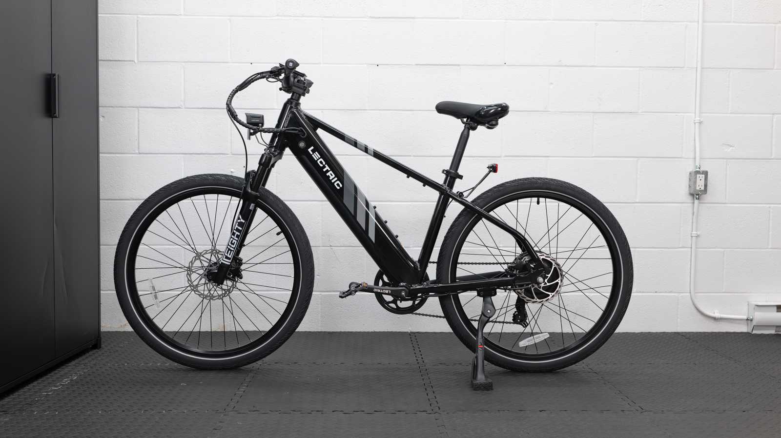

Frame and Fit

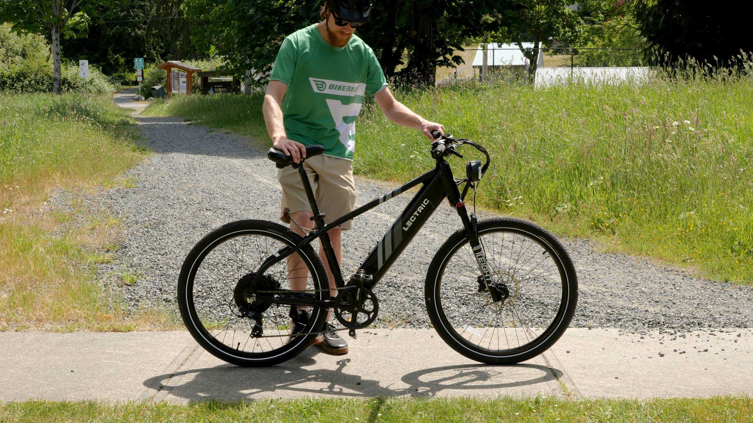

The Lectric XPress is a hybrid commuter bike with an aluminum frame and 80mm TC Eighty coil suspension fork with lockout and preload adjustment. The bike is available as a black step-over or a white step-through. The frame can accommodate riders up to 330lb.
Each frame style comes in only one size, with a stated fit range of 5’2” to 6’3” for the step-through and 5’4” to 6’4” for the step-over. The riding position on the step-over is slightly aggressive. The step-through appears to have a more relaxed, upright position.

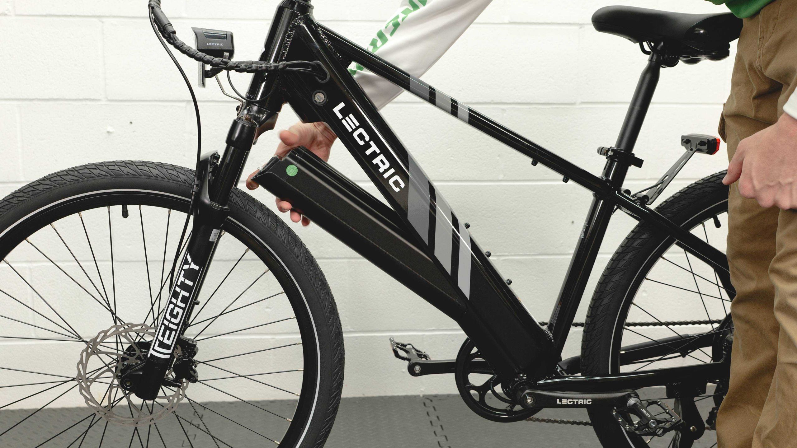

The battery on both frames mounts in the underside of the down tube and is secured with a keyed lock. The battery can be charged on or off the bike, and the charge port is protected by a rubber cover. The included 2A charger takes around seven hours to charge the battery fully.
The XPress has a torque sensor and thumb-style throttle. A three-button control pad sits next to the left grip, and a 4” color LCD screen is mounted in portrait format in the middle of the bars. The display’s angle can be adjusted by loosening the two screws that secure it to its mount.
The XPress arrives set up for Class 2, with both throttle and PAS limited to 20mph. The PAS speed limit can be unlocked to 28mph, but the throttle stays at 20mph. The throttle can also be removed to meet Class 1 or Class 3 regulations.

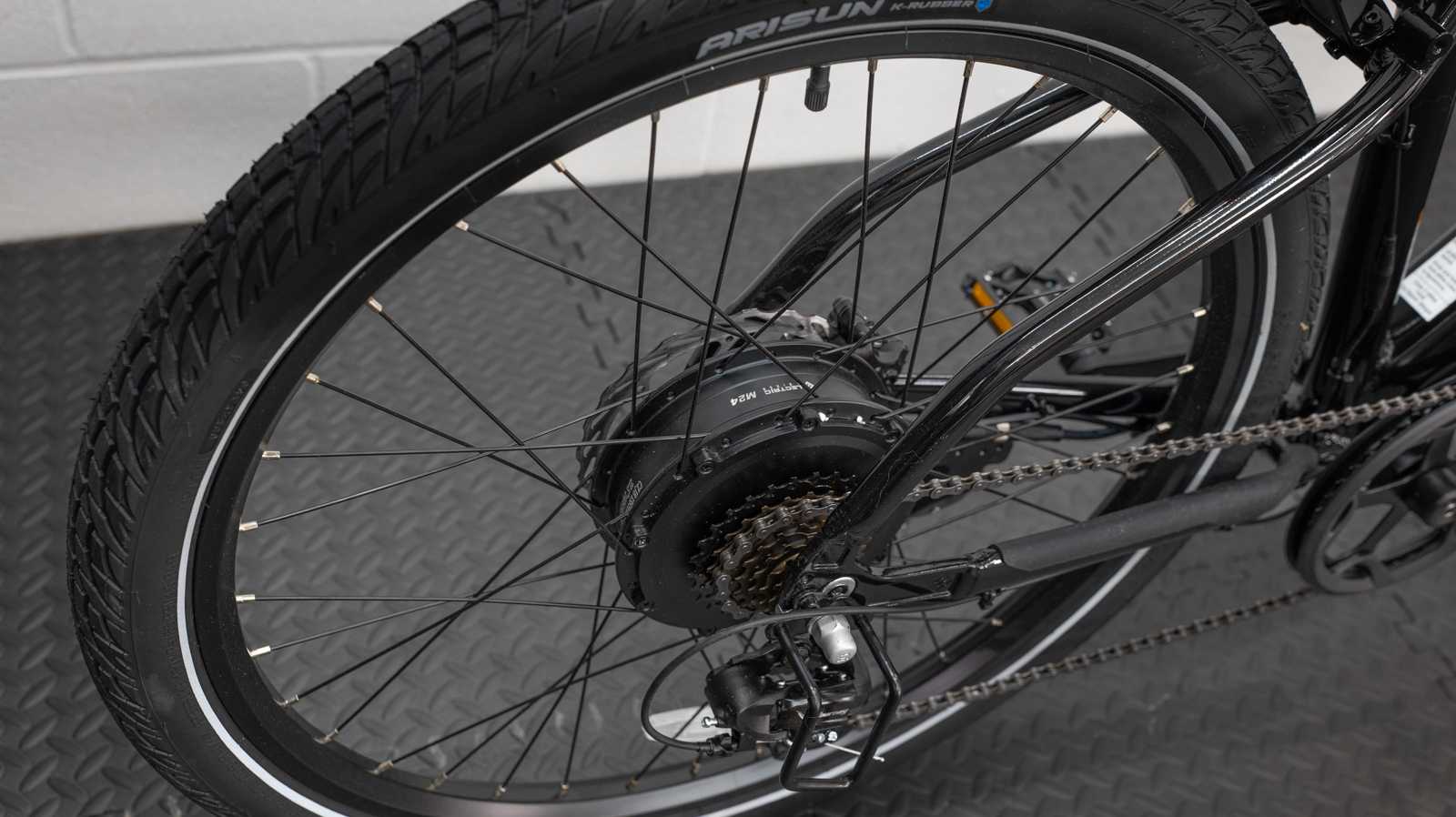

The XPress rolls on 27.5” spoked aluminum wheels and 2.1” wide Chaoyang Arisun tires with smooth, city-style tread and puncture protection. Lectric includes Slime sealant for extra protection against flats, which is a nice touch. The bike has a quick-release front axle and nutted rear axle.
Drivetrain and Brakes
Pedal power goes through a 46t chainring with a double-sided aluminum guard to a 7-speed, 11-28t freewheel at the back. The derailleur is Shimano Tourney, and the TX-50 shifter next to the right grip has an indicator that shows what gear you’re in.
The brakes comprise unbranded dual-piston hydraulic pistons with 180mm rotors and aluminum levers with reach adjustment.

The 700mm-wide handlebar has a 40mm rise and is bolted to a 40mm stem. In addition to the aforementioned brake levers, control pad, and center-mounted display, there’s a bell, and a pair of rubber lock-on grips with ergonomic wings designed to reduce hand pressure.

As mentioned, the XPress comes with integrated front and rear lights, which are disappointing. The XPress has a bottle cage mount under the top tube and a triple mount on the down tube. It also has mounts for fenders and a rear rack. Both fenders and the rack are sold separately, but Lectric often runs promotions that include fenders and a rack. Hopefully, those promotions will continue because, without fenders and a cargo rack, the bike’s value as a commuter is significantly reduced.

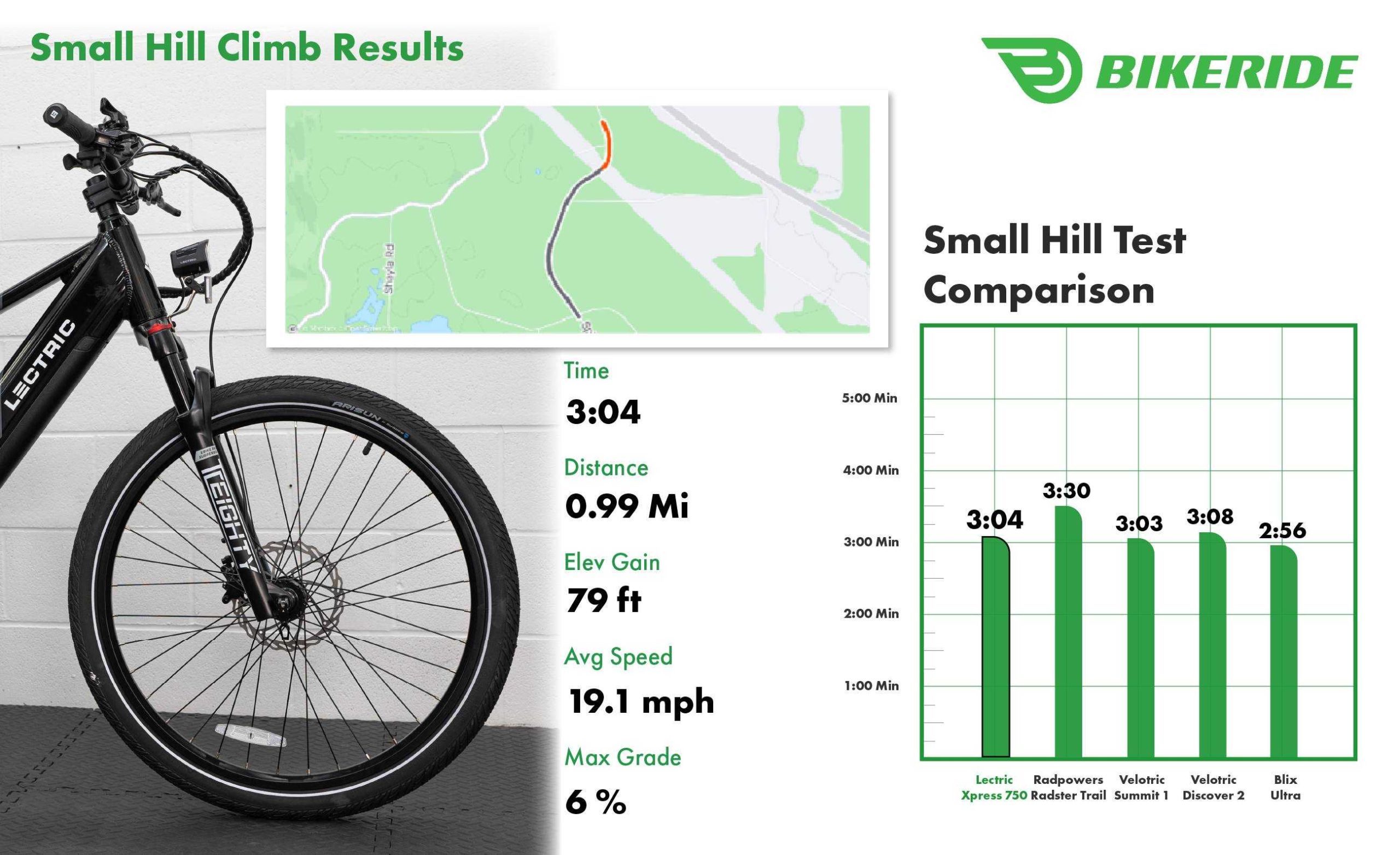

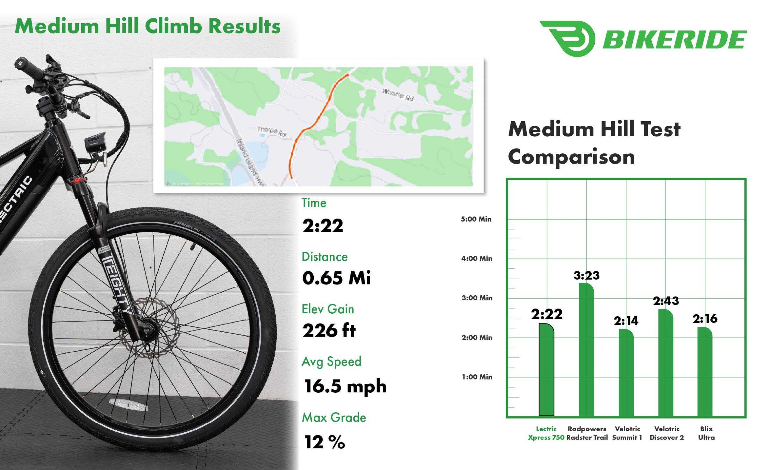

Hill Climb Tests
The XPress 750 climbed our small hill in 3:04 seconds at 19.1mph, putting it among the best performers in this test, ahead of the Radster Trail and Velotric Discover 2 and just one second behind the Velotric Summit 1. The Blix Ultra dominated this group with a time of 2:56.
The bike produced similar results in the medium elevation hill climb test. At 2:22 and 16.5mph, the XPress was one of the top performers. The Summit 1 was one second faster up this hill, and the Blix Ultra was six seconds faster. The Discover 2 was well behind at 2:43, and the Radster Trail was left in the dust, a full minute slower than the XPress.

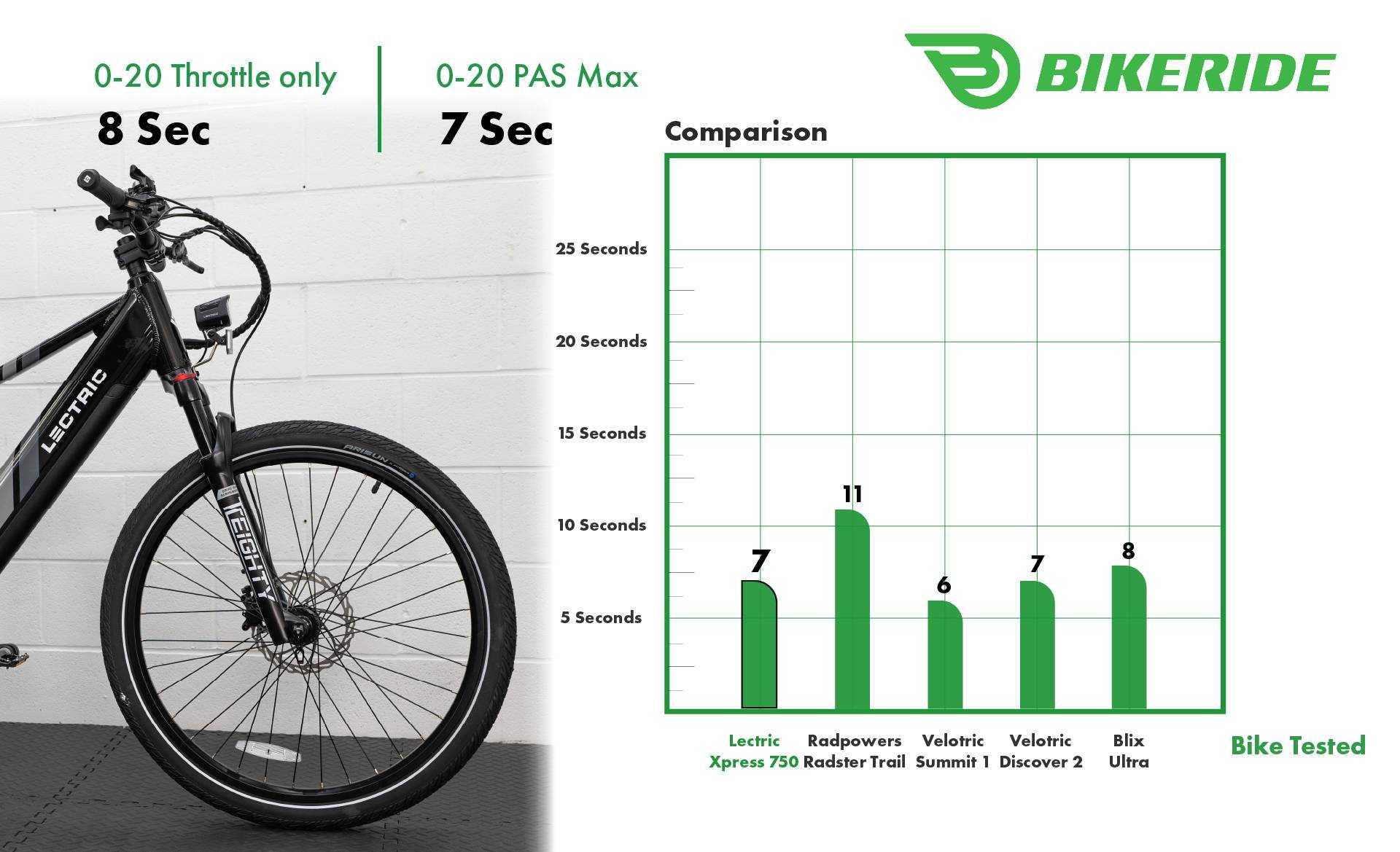

Acceleration Tests
The XPress 750’s motor continued to shine in our acceleration tests, where it hung with the best in the group. The only bike to beat the XPress 750 was the Summit 1, and even that was only in the PAS test, where it beat the Lectric by one second. Both bikes took eight seconds under throttle power. Using PAS, the Discover 2 set the same time as the XPress.

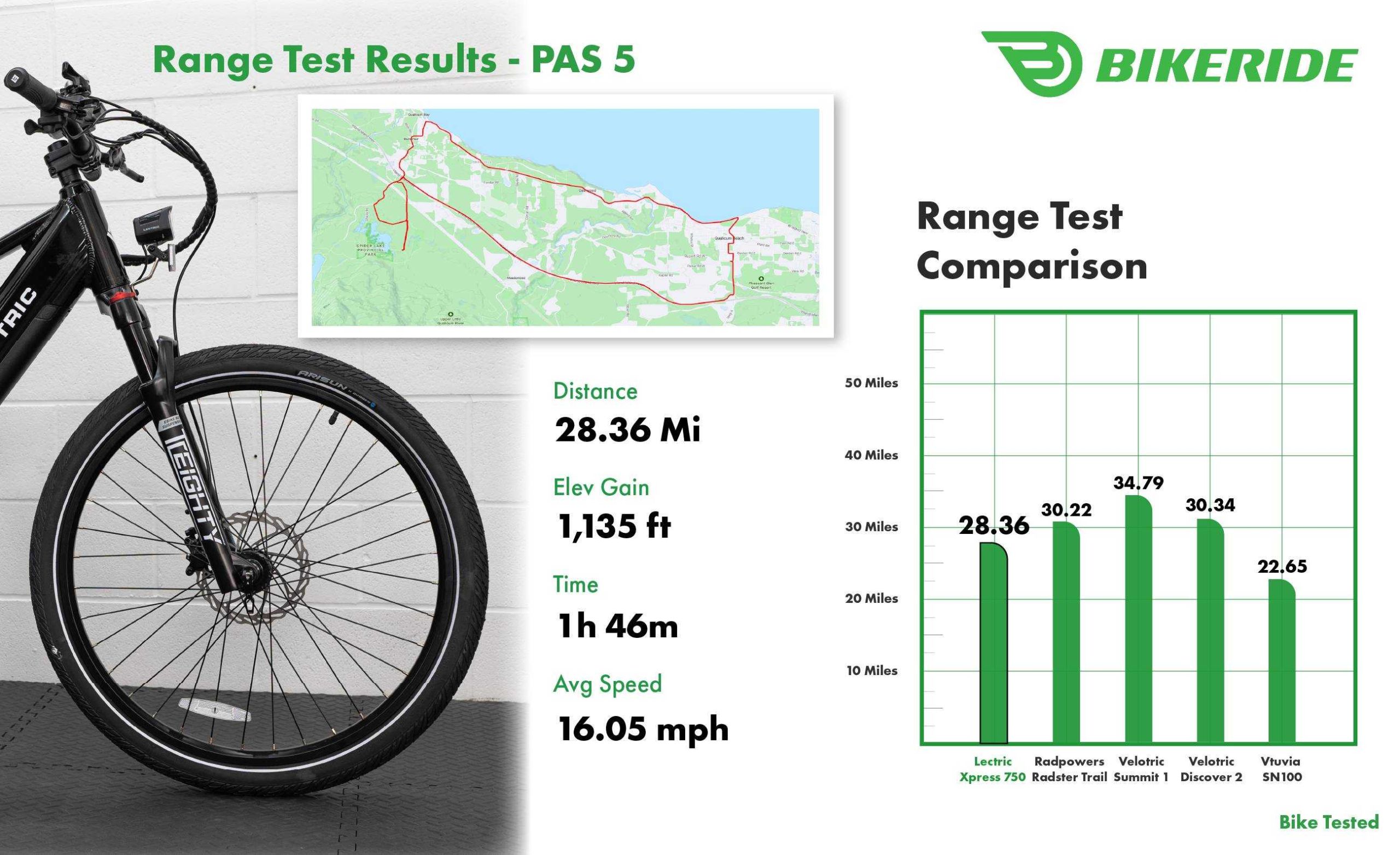

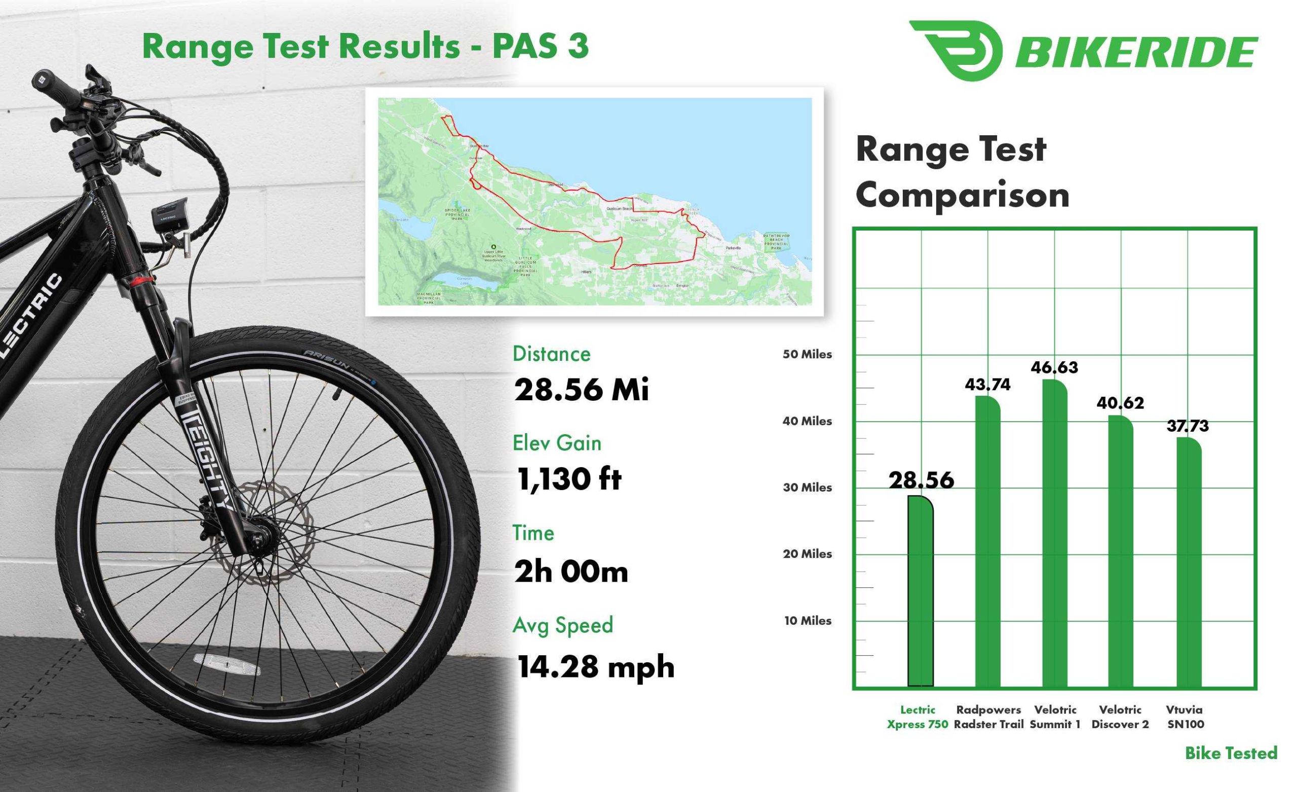

The range test proved disappointing for a couple of reasons. The first was the inaccurate battery meter. The second disappointment is this bike’s range. In the PAS 5 test, the Lectric 750 was at the back of the pack, managing just 28.36 miles. Only the Vtuvia SN100, with 22 miles, fared worse. All the other bikes with 750W motors and 14Ah batteries traveled farther, beating the Lectric by 1-6 miles.
The second range test was even more disappointing as the XPress 750 traveled just 350 yards more than in the PAS 5 test. This result puts the XPress 750 way behind in the PAS 3 test.
In general, bikes last 5 to 15 miles longer in the PAS 3 test than in the PAS 5 test. Diving into the settings, we can see that PAS 1 is limited to 9mph and PAS 2 is limited to 15mph, but PAS levels 3, 4, and 5 all have the same 20mph speed limit.

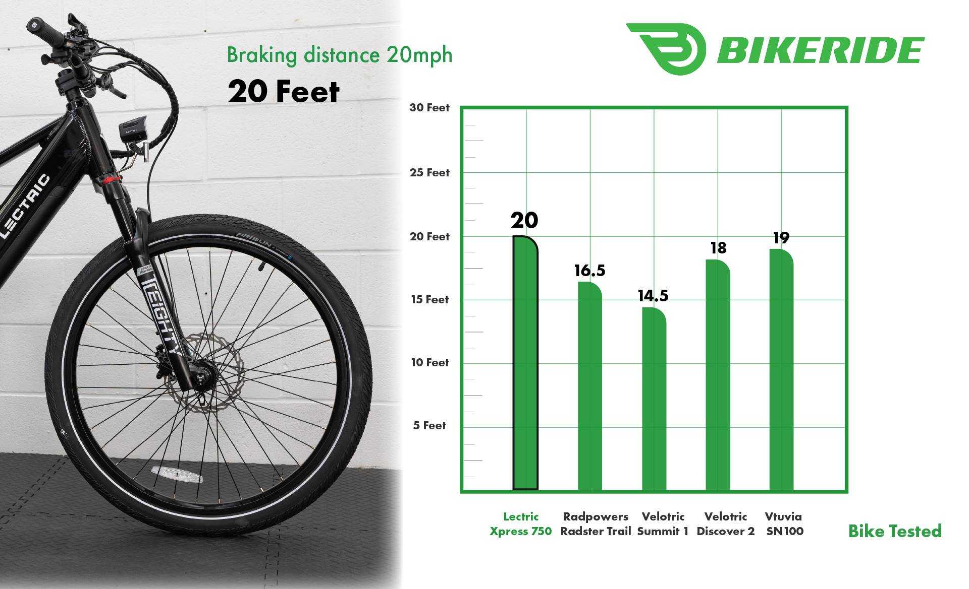

In the braking test, the XPress 750 needed 20 feet to stop from 20mph, which is between 1 and 6.5 feet more than the other bikes we’ve included in this review. Overall, however, the Lectric’s braking performance was roughly on par with most bikes we’ve tested.
The biggest limiting factor for the XPress 750’s braking was the lack of grip from the tires’ smooth tread, which resulted in the brakes easily locking up on any surface. This tire has probably been designed with efficiency and durability in mind, and the brakes do have plenty of power, so tires with more grip in the center of the tread would probably shorten the braking distances.

Range Tested (PAS 3): 28.56 mi – 1,130 ft. – 14.28mph avg.
Range Tested (PAS 5): 28.36 mi – 1,135 ft. – 16.05mph avg.
