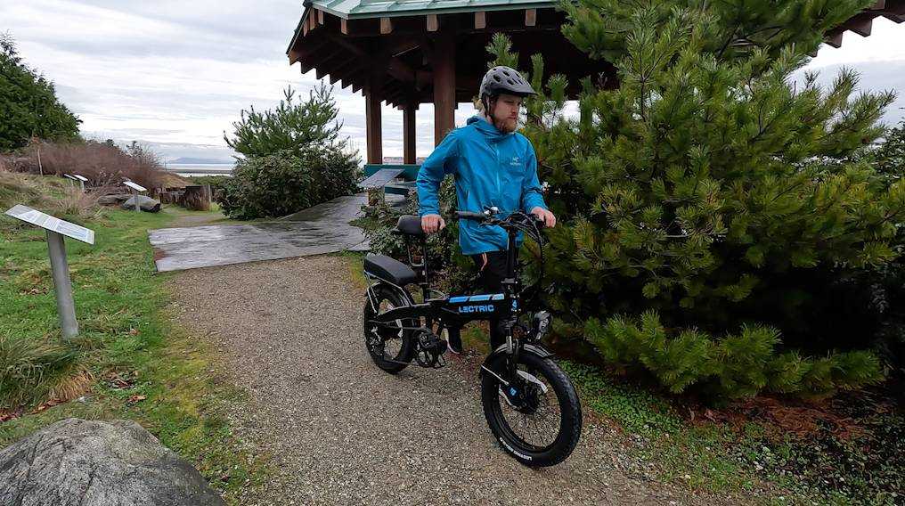

XP Bike Side shot
What Is the Lectric XP 3.0?
The XP 3.0 is a folding commuter e-bike, a category loaded with options and one of the most popular for urban travel.
Lectric has built on the successes of its previous models, upgrading and changing components to improve performance while maintaining its noteworthy value.
The upgraded XP 3.0 has hydraulic brakes, a more powerful motor, and improved controller programming over the model’s original release.
The ride is smooth and comfortable, thanks to the 3″ tires, suspension seatpost, and 50mm suspension fork. This bike also has all the accessories required for commuting.
The feature-rich design and low price make the Lectric XP 3.0 stand out in a crowded segment.

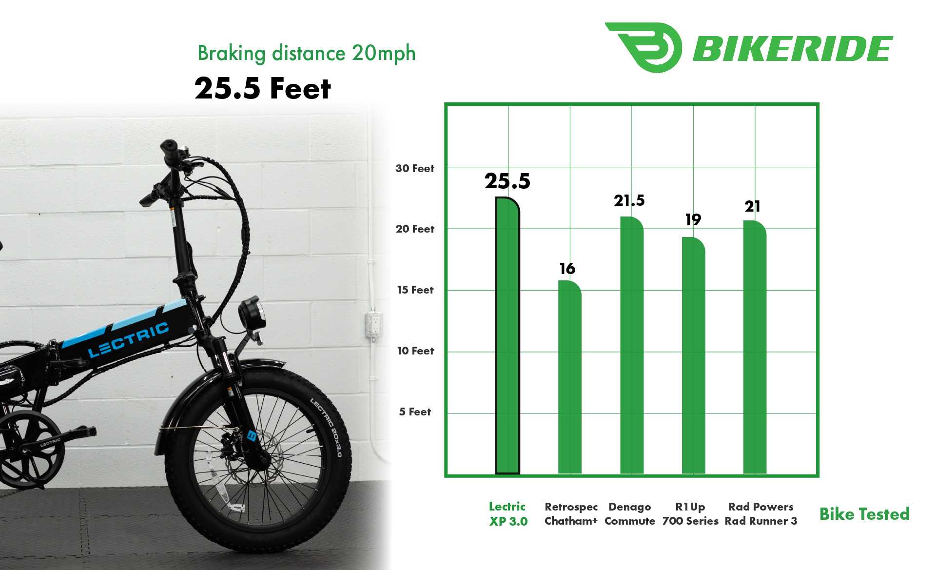

Braking Distance
The XP 3.0 recently received an upgrade to its braking ability with a change from mechanical to hydraulic disc brakes. However, the stopping distance is still longer than average.

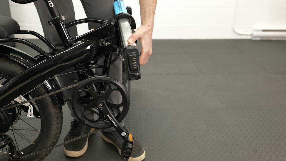

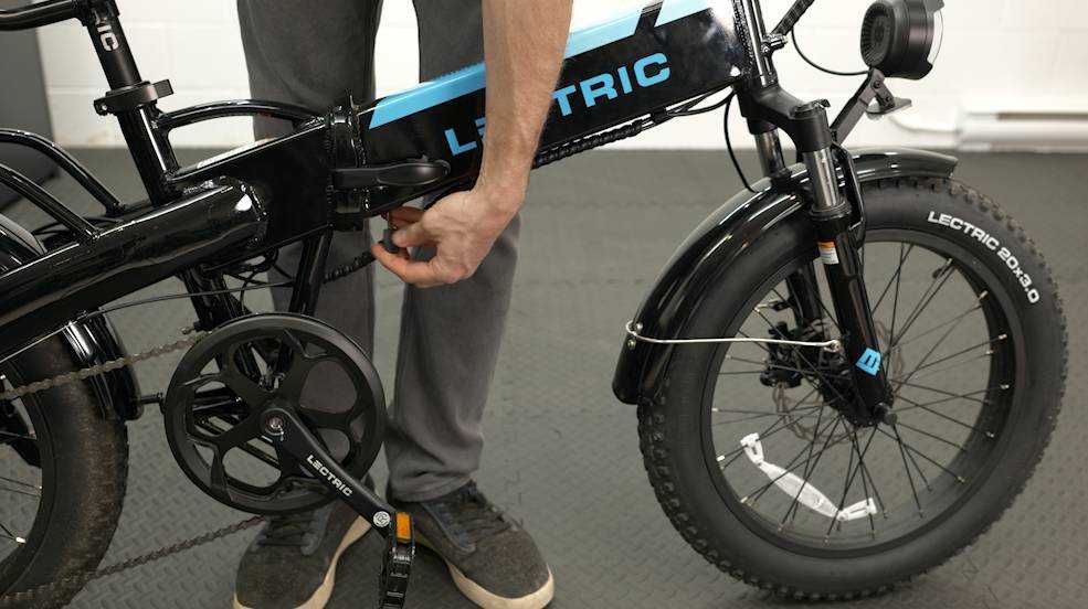

The battery is integrated into the frame and can be removed when the bike is folded. The frame, pedals, and handlebars fold, allowing the bike to fit in most car trunks or a closet at home.
The three-step folding process is easy. Start with the pedals, which fold up or down. Next, the handlebars fold down by unclipping the latch on the stem. Finally, release the frame latch to complete the process.
Unfortunately, there is no mechanism to keep the bike closed after folding, but a bungee cord would suffice.

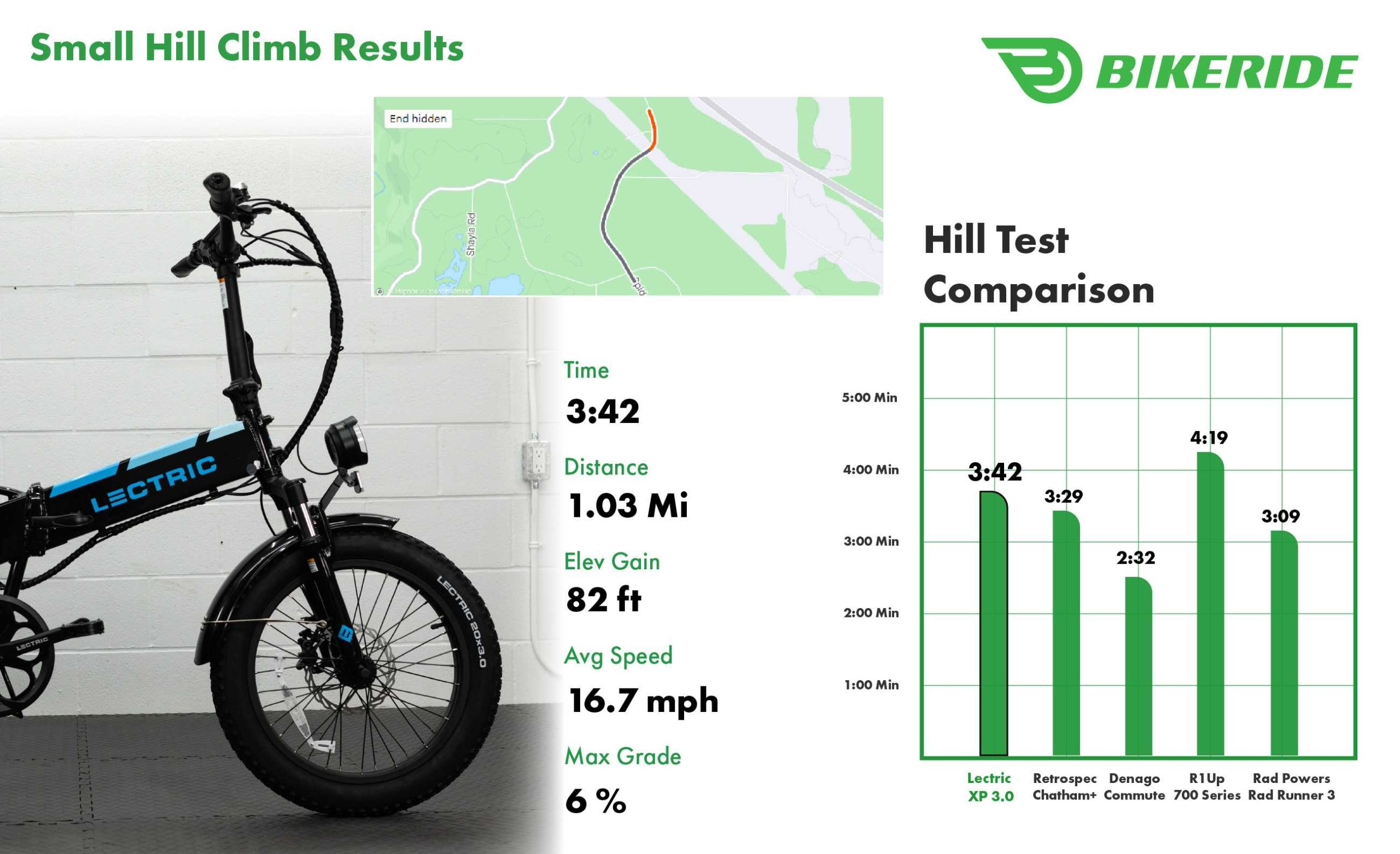

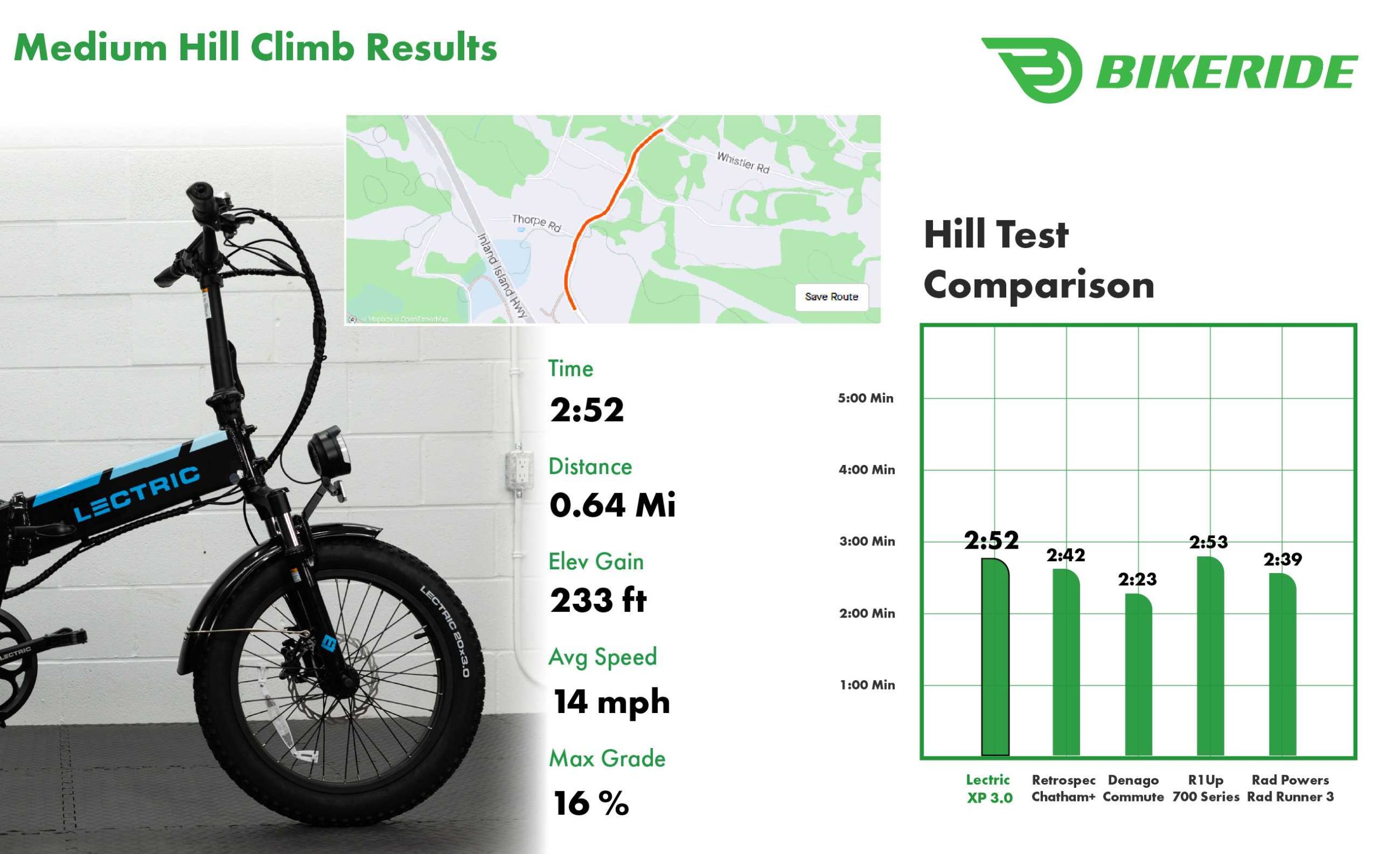

The 500W Lectric-branded motor has a max torque of 55Nm and a peak power of 1000W. The power is impressive with a full battery (high battery voltage).
I enjoyed the acceleration and speed on flat pavement and found the motor capable of handling gradients of up to 16%.
Though performance was good at high battery levels, I found this diminished as the charge dropped. The top speed reduces to 16mph or below when the battery falls below 60%. This controller programming helps extend battery life but will also slow your commute.

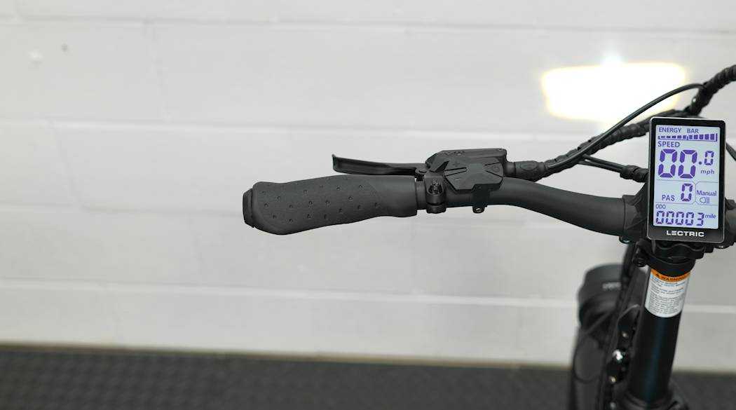

Cockpit and Control
For the XP 3.0 to function, the key needs to be inserted. This is one of the only bikes we’ve reviewed with this requirement.
The key has two functions depending on how you turn it after inserting it: starting the bike or unlocking the battery for removal.

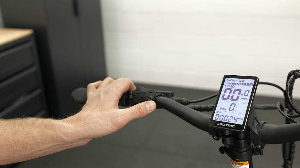

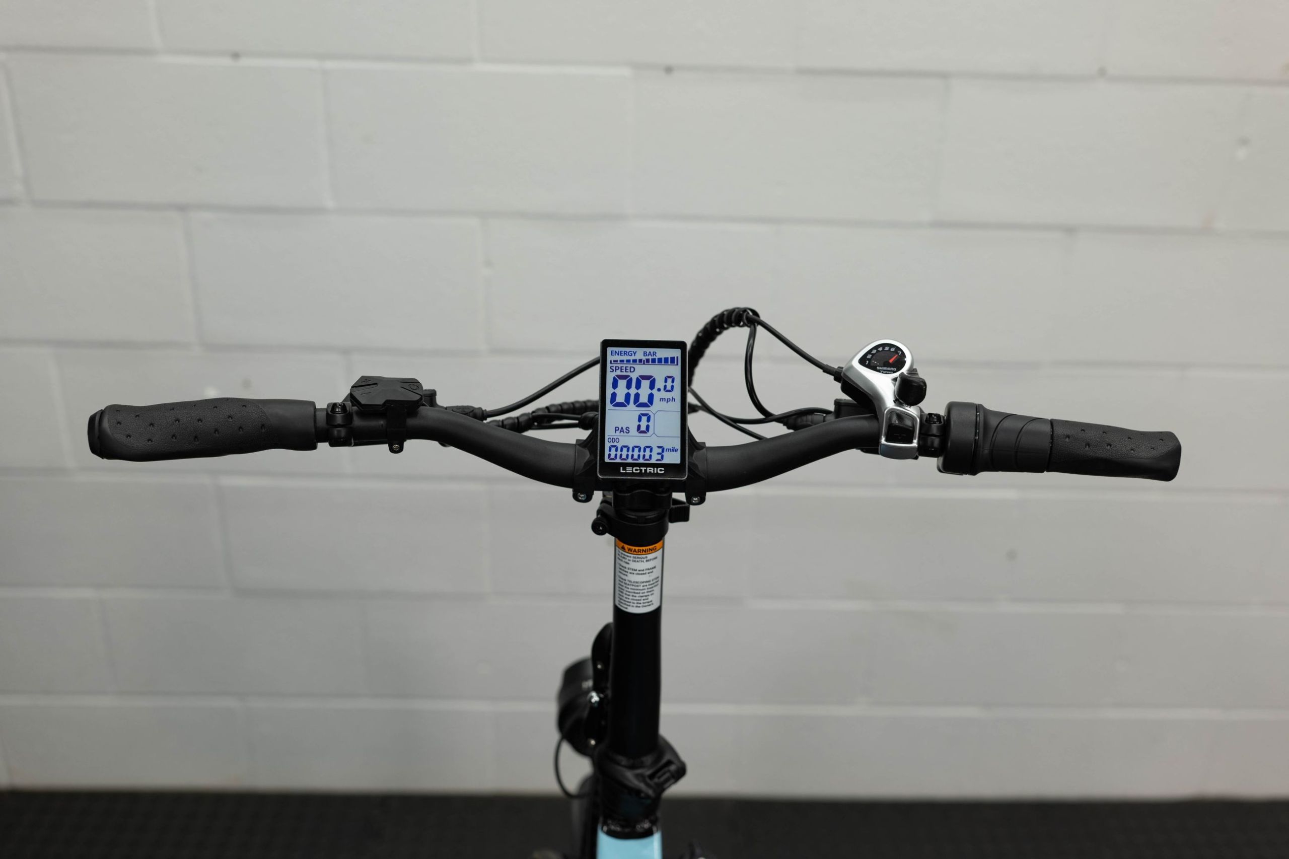

The cockpit is uncomplicated and easy to use. A large backlit display takes center stage, showing speed, battery level, pedal assist level, and an odometer. Owners can cycle through additional metrics using the control pad.
The control panel is a simple three-button touchpad. Holding the ‘plus’ button turns the integrated lights on and off. Holding the ‘minus’ button activates Walk Mode. Holding down the power button turns the bike on and off.
The XP 3.0 has a half-twist throttle on the right side and a TX-50 trigger shifter beside it. This is a beginner-friendly shifter that shows the selected gear.

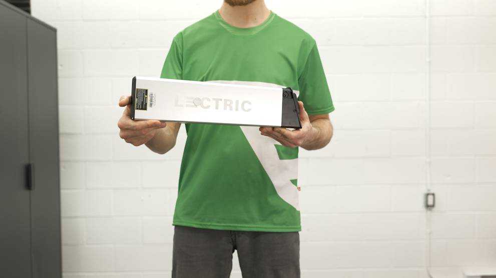

The 10.4Ah internal battery is integrated into the frame and locked with the key. Lectric also offers a 14Ah battery, “Long-Range” XP 3.0.

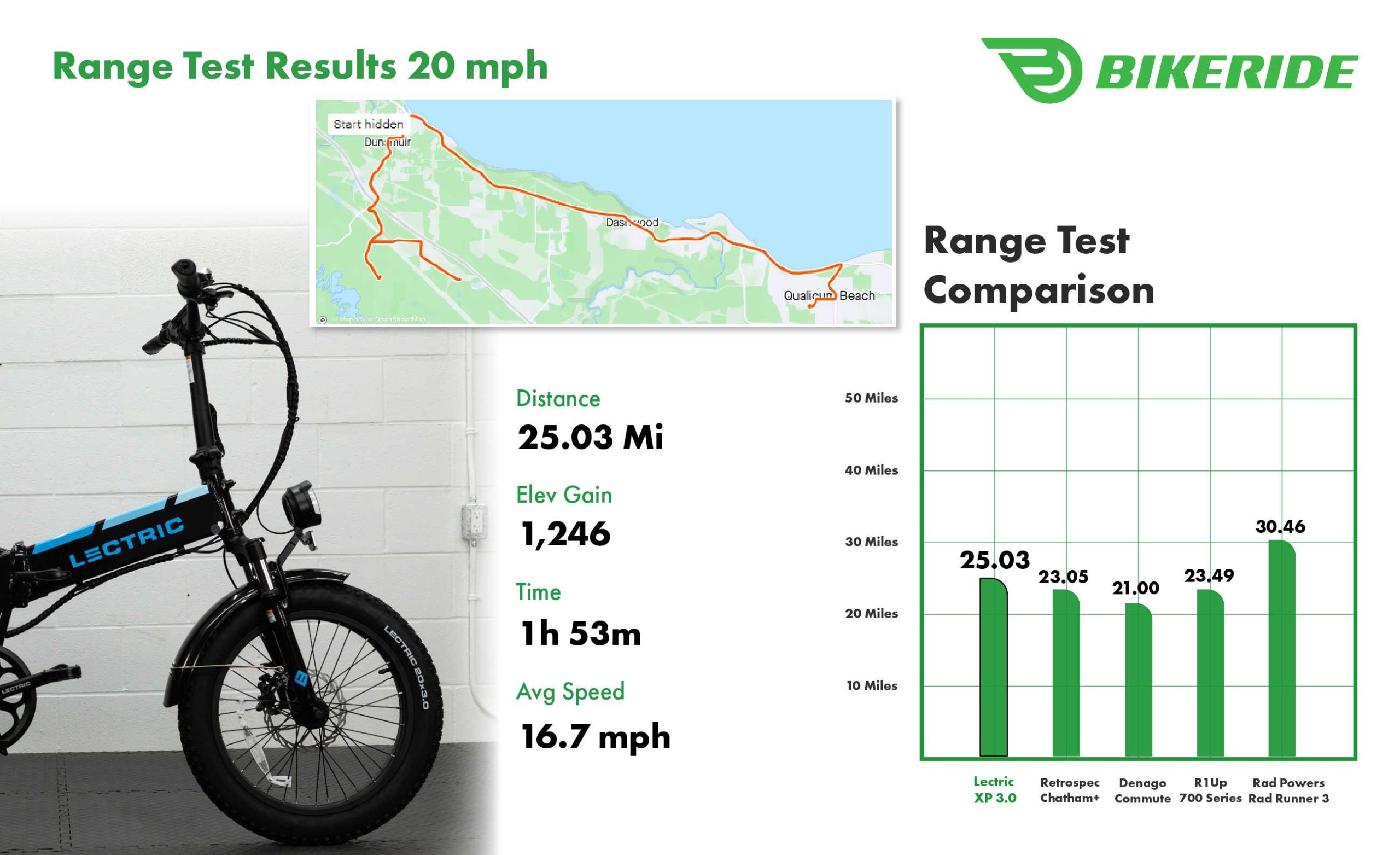

The XP 3.0 hit 25 miles at max pedal assist in our range test, exceeding the brand’s stated range for its maximum assist level of 17 miles.
It’s great to see Lectric offering realistic range estimates, and I feel confident they are accurate after testing.
The XP 3.0 must be folded to remove or install the battery, but it can also be charged via the external charge port on the frame.
Once folded, the battery must be unlocked with the key. Ensure the locking pin is disengaged so it can slide out. The key slot for locking and unlocking the battery is located on the underside of the frame.

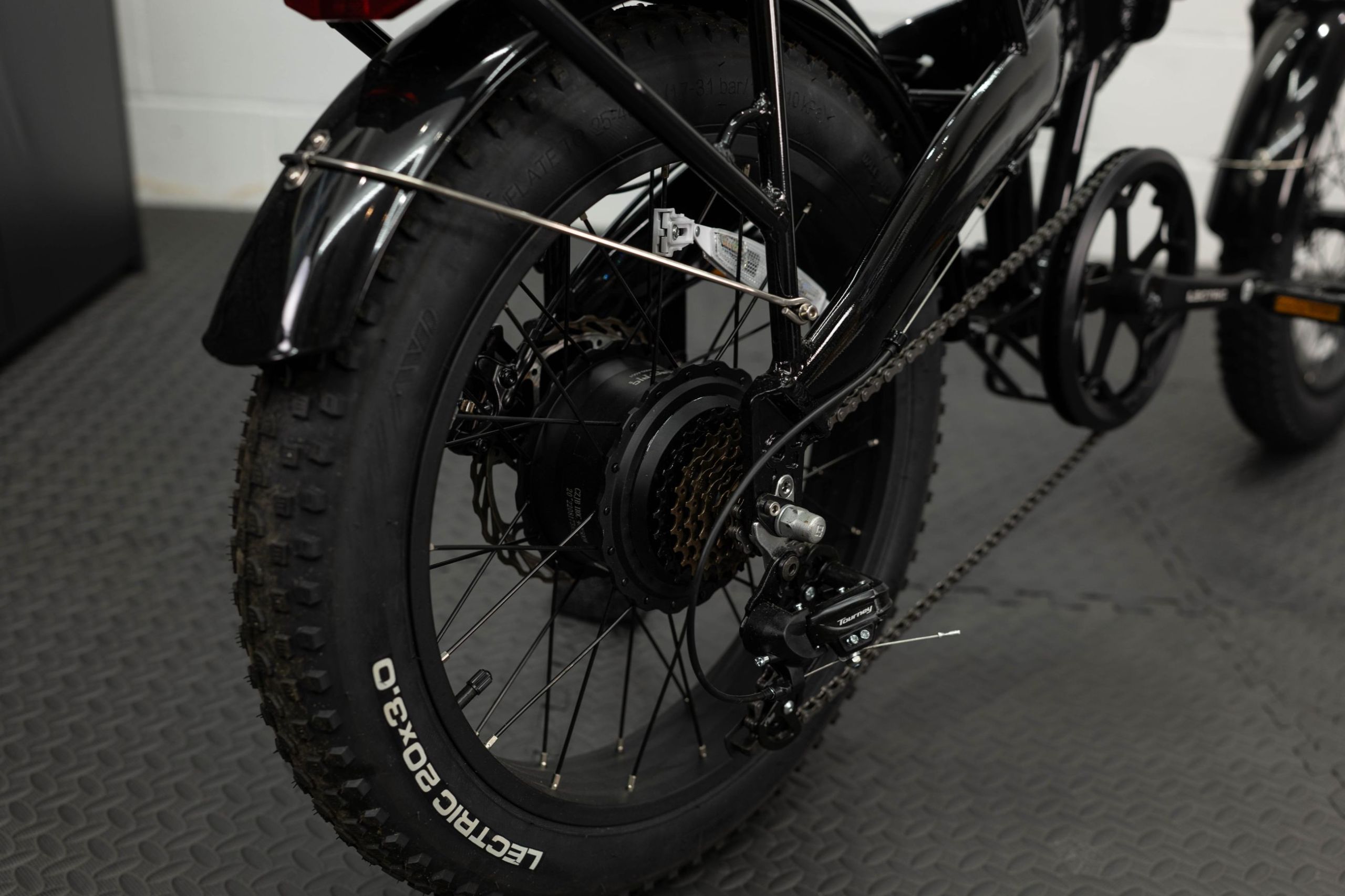

The XP 3.0 has a Shimano Tourney drivetrain. The 11-28t cassette and large chainring are adequate up to the Class 2 max speed of 20mph, but traveling at over 20mph results in ghost pedaling.
The basic shifter and derailleur result in clunky shifting at times, but overall, they should be functional for most users.

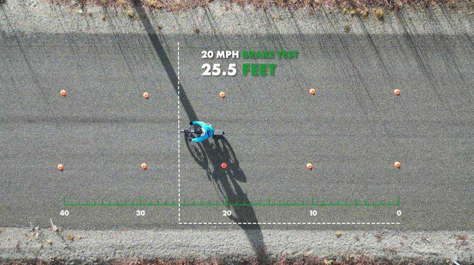

The XP 3.0’s most recent update swapped mechanical disc brakes for improved 2-piston hydraulic discs with 180mm rotors.
Despite this upgrade, the bike demonstrated below-average stopping power during our braking test.

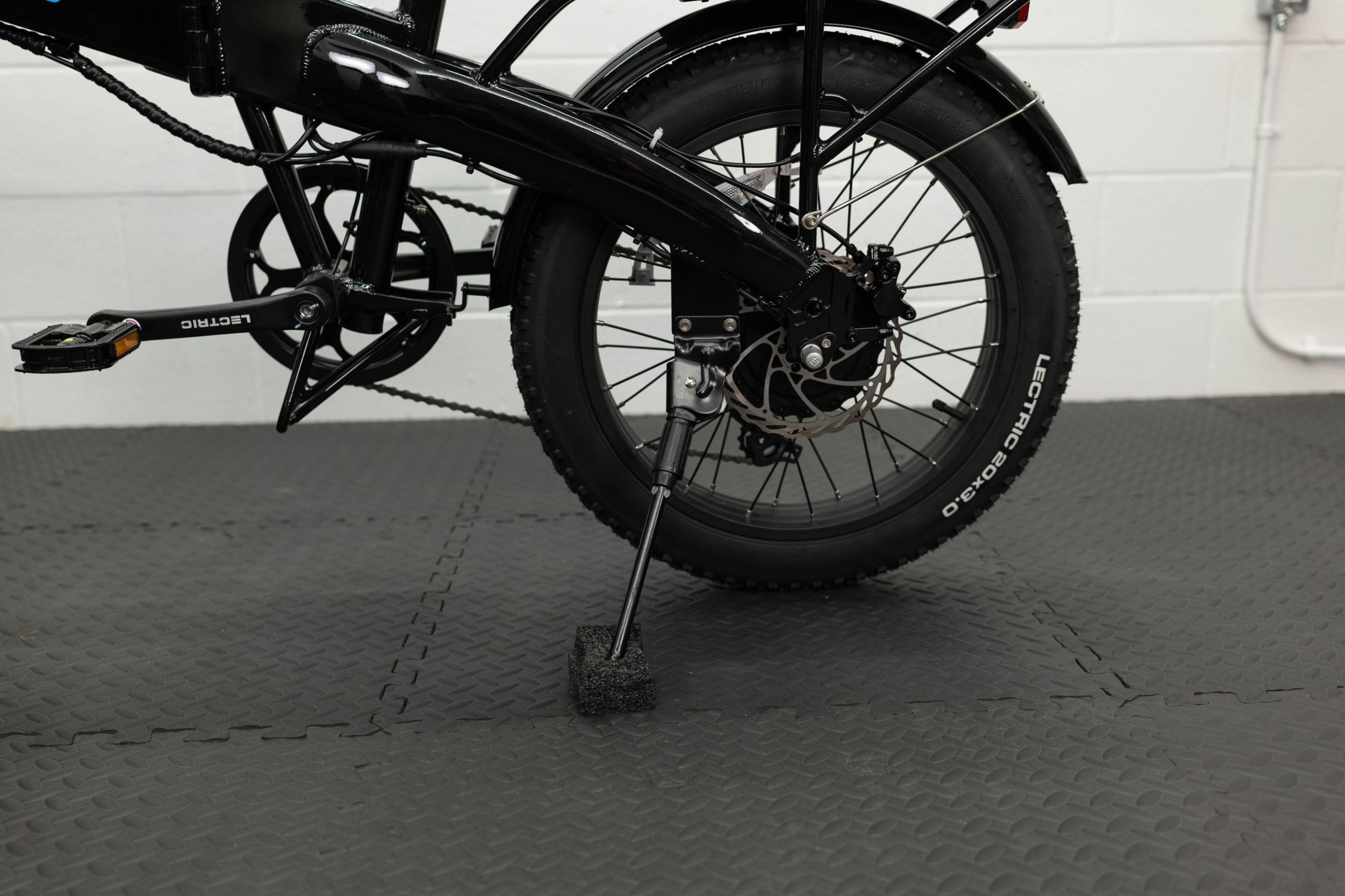

Kickstand
The XP 3.0 has a standard single-sided kickstand, which I found slightly less stable than other stands with a larger foot.

Grips
The rubber grips are pleasant and cause no problems. However, they could slip on the bars as they are not locked.

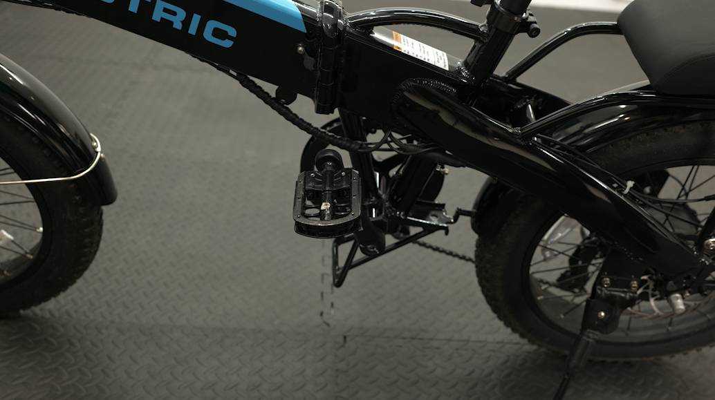

Pedals
The XP 3.0 has standard platform pedals that fold to reduce the footprint further. These can be slippery in wet conditions because of their small pegs.

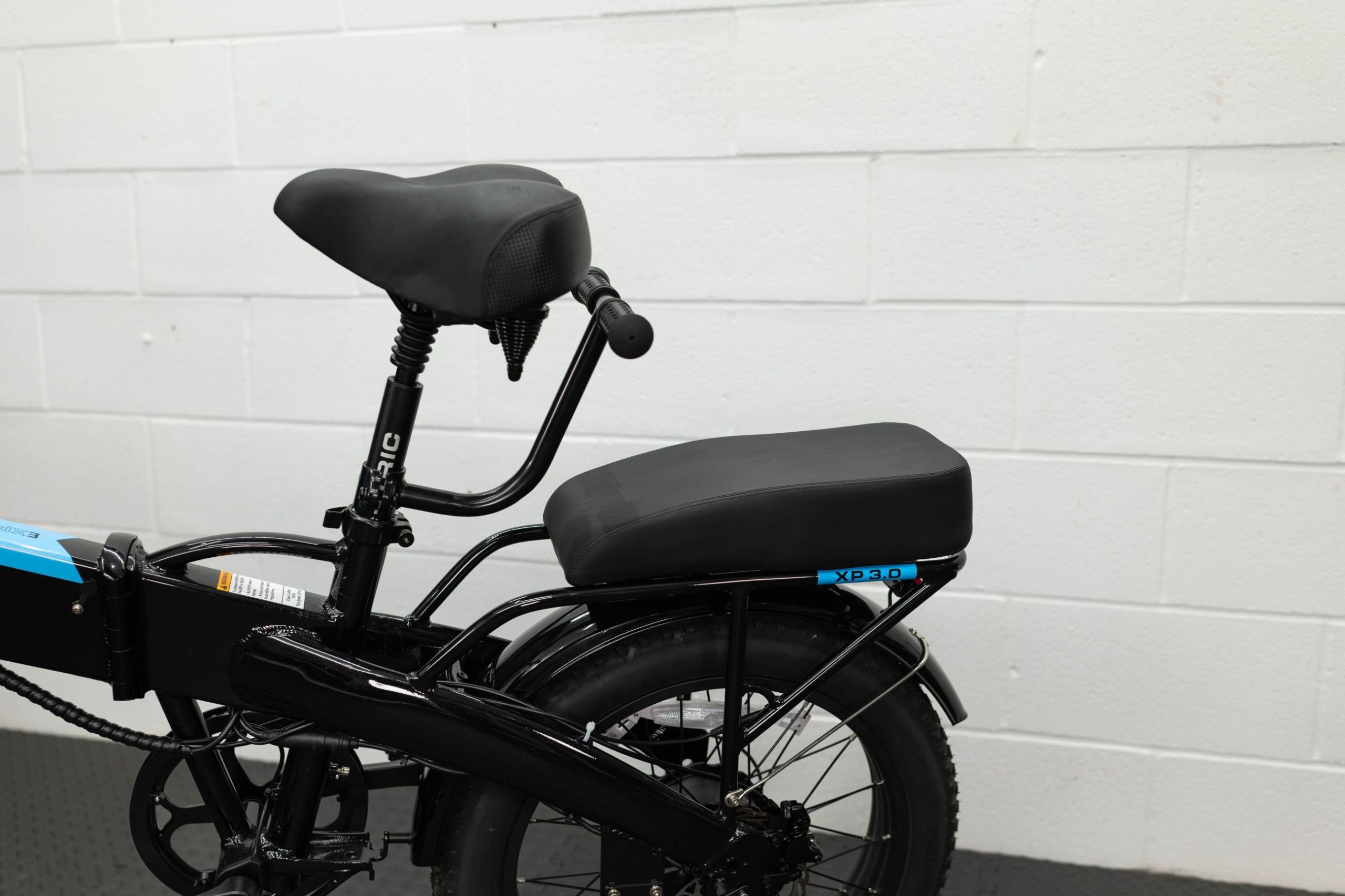

Our test model came with an upgraded headlight, a rear rack with a passenger seat and hand, fenders, and a lock. These are just a few of the accessories available from Lectric. There are even more options available from the Lectric store.
The XP 3.0 has a range of attachment points for fitting the various accessories.

It was a 21° hill. We pushed the limits, we tested the bike, and it showed up. It really showed up.
Lenscaping Maine
Lectric XP 3.0 – Is It Worth It if You Live Where There Are Large Long Hills? Let’s Find Out!!!!!!!!
I haven’t met a hill yet that I can’t climb, which is unbelievable. Out of a 1 to 10 scale, 10 being I highly recommend it and 0 being I don’t recommend it, I’m gonna give it a 9.
