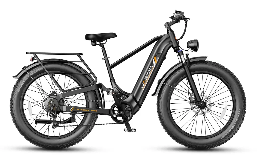

Our verdict
The Jasion Thunder Pro ST is a well-equipped full-suspension cruiser that delivers real performance for its price. It reached a GPS-verified 35 mph and posted the fastest hill climbs in our comparison group. However, its real-world range was just 28.4 miles, and the budget suspension isn't suitable for the "rough terrain" that Jasion claims. The 500 lb payload rating is, in the brand's own words, a 270 lb riding limit. Overall, it's a powerful and comfortable e-bike, just with exaggerated marketing.
  • GPS-verified 35 mph top speed
  • Fastest hill climbs in the comparison group
  • Impressive 0–20 mph acceleration on throttle
  • Solid accessory package included
  • App fixes the assist tuning and adds control that's uncommon at this price
  • Stable at high speed
  • Full suspension and fat tires smooth broken pavement
  • Display is readable in direct sunlight
  • 500 lb payload claim is really a 270 lb riding limit
  • Claimed 5'5" to 7'2" height range doesn't match our fit testing
  • 98 lb as tested, making it heavy, even for this category
  • Among the worst range test results of fat-tire e-bikes
  • Longest brake distance in comparison group
  • Poor stock assist tune and cadence lag from a standstill
  • Roughly 10-hour charge, IPX4, and a battery gauge that sags under load
