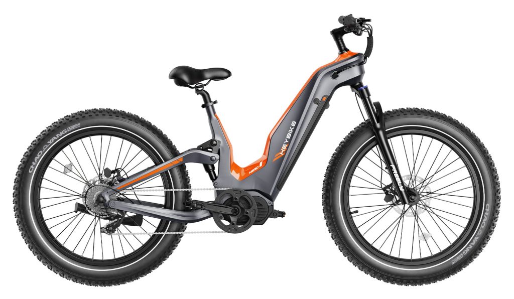

What Is the Heybike Hero?
Heybike calls the Hero the “Ultimate electric all-terrain bike.” At first glance, it looks like it could be up to the task. The Hero has beefy 26” x 4” tires, a 120mm hydraulic coil suspension fork, and a rear air shock. Heybike offers buyers the choice of an unrestricted 1,000W rear hub motor or a 750W mid-drive motor.
The Hero has a thumb throttle with a speed limit that can be adjusted up to 35mph. Both versions of the Hero use a 48V system with an 864Wh battery housed within the frame. This combination of a throttle, powerful motor, and high top speed means the bike cannot be ridden legally on public roads or trails in most places.
Heybike states on its website that the Hero’s battery is certified for compliance with UL 2849. However, UL 2849 applies to an e-bike’s entire electrical system, not the battery. Batteries are typically certified for UL 2271.
When queried, Heybike said the UL 2849 certification is in progress, not complete, and they couldn’t provide a timeline for completion. Given the Hero was launched over a year ago and Heybike states that the bike is UL 2849-certified, this raises serious doubts over the reliability of Heybike and the Hero.
The Hero has IPX4 weather protection, which means it’s protected against water splashes from any direction, but this is insufficient for heavy rainfall, which isn’t what one would expect from the “Ultimate electric all-terrain bike.”

The Heybike Hero in Detail
Clearly, the Hero is intended to be an off-road bike, and Heybike makes some bold claims about its capabilities, most of which have been contradicted by our testing.
Frame and Fit
The Hero has a step-through frame and comes in only one size, but it is available in two colors: the Tangerine of our test bike or Lime Yellow. Heybike claims the Hero fits riders from 5’3 “to 6’6”, which is undoubtedly exaggerated. The riding position will vary from slightly bent and athletic to straight-backed, depending on your height. I was fairly straight-backed at 6′ tall.
The Hero is a full-suspension bike with a 120mm hydraulic coil fork and a Horst-link rear suspension with an air shock. The fork has adjustable preload and lockout, and the shock’s air pressure can be tuned, but it doesn’t have rebound adjustment.
The shock arrived set to 99.5 PSI. I reduced it to 92.5 PSI to achieve an approximate 30% sag with my 175lb weight.
E-Bike System and Classification
The 1,000W motor on our test bike pairs with a torque sensor to detect rider input, and the Heybike app provides the option to adjust its sensitivity along a four-step sliding scale. The bike also has a thumb-style throttle, which can be unlocked to power the bike up to its 35mph limit. The throttle’s max speed and speed limits in each PAS level can be adjusted in the app.
Both motor options are powered by an 864Wh battery that sits in the down tube and is secured with a keyed lock. The battery can be charged on or off the bike using the same charge port and the supplied 4A charger, which provides a full charge in about five hours.
Wheelset
The Hero rolls on spoked 26” aluminum rims and 4” Chaoyang tires with a knobby tread and puncture protection. The bike has nutted axles at both ends.
Drivetrain and Brakes
The drivetrain has a 48t chainring with a single-sided aluminum guard, 9-speed 11-32t cassette, and Shimano Alivio derailleur. The trigger shifter is located on the right side of the bars and features a gear indicator.
Braking is handled by aluminum brake levers with reach adjustment, RSX four-piston calipers, and 180mm rotors. The Alivio derailleur lacks a clutch, which is a fundamental omission on a bike allegedly designed to go off-road, and means the bike suffers from heavy chain slap.
Cockpit and Touchpoints
The cockpit is fairly streamlined, with an integrated color display in the middle of the 700mm flat bars. The bars are adorned with lock-on faux-leather grips, a thumb-style throttle on the left next to the three-button control pad, and an underslung trigger shifter.
The final touch points are the QBP KNUS cruiser saddle and aluminum platform pedals.
The Hero’s headlight is integrated into the bars and offers high and low beams. The rear light is integrated into the seatpost. It can be set to steady or flashing but has braking function. Using a different seatpost will require purchasing a new taillight.
