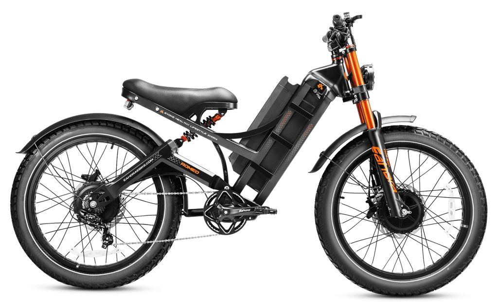

At first glance, one could easily mistake our test bike, the Romeo Ultra II, for a motorbike. It’s certainly a lot of e-bike.
This monster packs 5,000W of power. Each of the wheels contains a 2,500W hub motor, giving the Romeo Ultra II significantly more power than anything we’ve tested. The 60V electrical system includes a 41A controller and 80Ah (4,800Wh) battery.
According to Eahora, the Romeo Ultra II can hit 50mph and last up to 235 miles. If true, those figures are incredible, but such power does have its downsides.
We weighed this huge bike at a staggering 177.8lb, 3.6lb heavier than the claimed weight of 174.17lb. The high motor power and top speed also mean it’s not actually an electric bicycle under the law, so a license, insurance, and possibly registration are required to use it on the road.
Despite the Romeo Ultra II’s price, it has some disappointing components, such as an entry-level Shimano Tourney derailleur. On the other hand, most buyers probably don’t expect to pedal a bike like this.
Maintaining the moto style, the Ultra II rolls on beefy 4” tires and full suspension. Now, let’s take a look at the headline pros and cons.

This is a large and heavy bike. The battery weighs more than some complete e-bikes at 40.5lb. And, with its hub motor, the front wheel is 30lb, so very few people will be capable of lifting this bike, and forget about taking it upstairs. A truck with a ramp or rack designed for dirt bikes is required just to transport it.
The immense mass and bulk make low-speed maneuvering a challenge, and turns have to be taken in wide, sweeping arcs. Riders familiar with motorbikes will feel more at home on this bike.
The Romeo is also hard to push and a real handful when leaned over, so most maintenance is going to be a major pain. Those who are set up for motorcycle maintenance will be able to handle it, but anyone coming from a cycling background will struggle.
