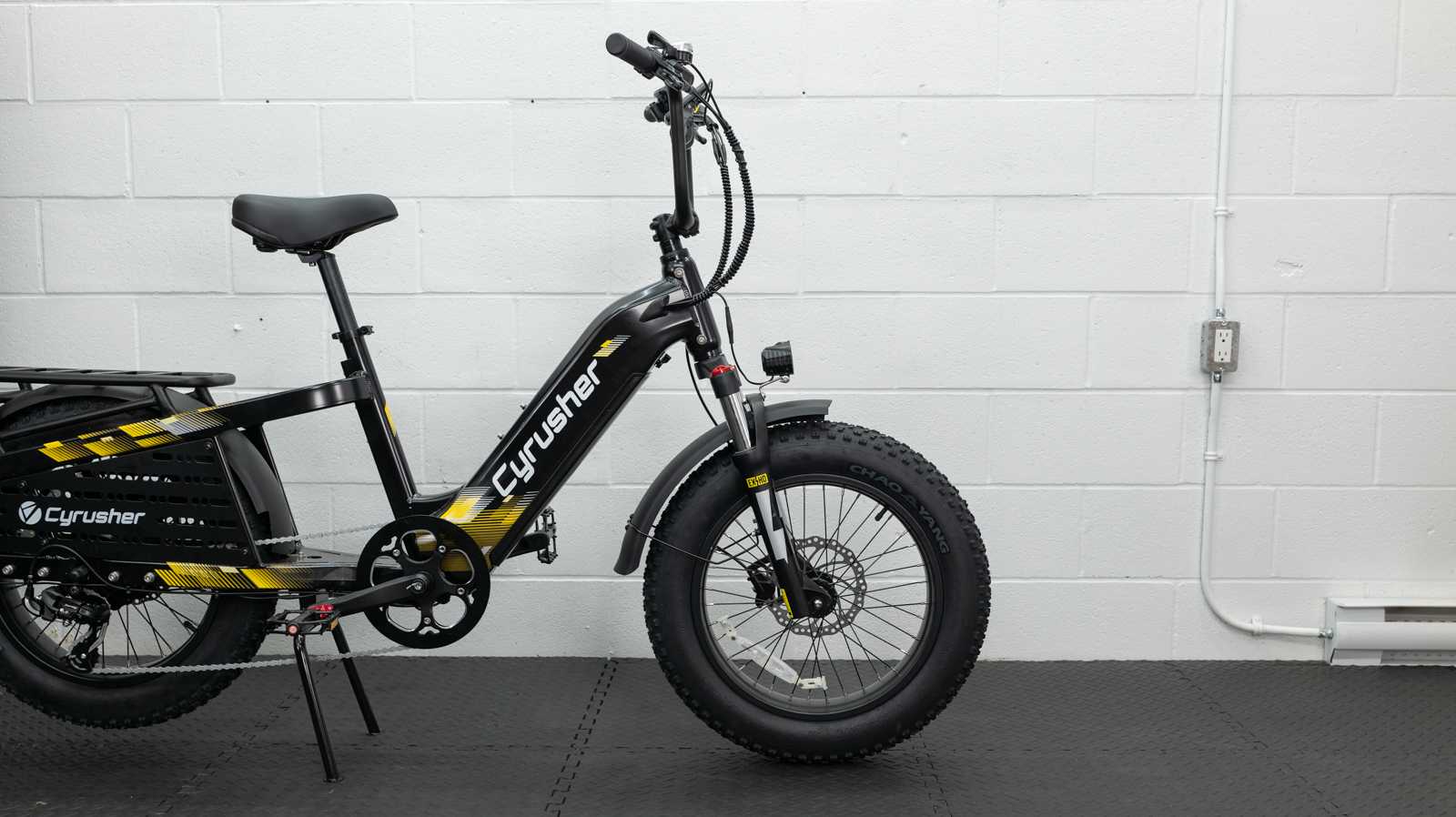

What Is the Cyrusher Glider?
Cyrusher calls the Glider a cargo e-bike suitable for cargo carrying, making deliveries, commuting with kids, or hauling gear on outdoor adventures. In truth, its compact size and unremarkable payload capacity make it more of a utility bike than a true cargo machine.
The Glider has an aluminum frame, a 90mm coil suspension fork, and 4” fat tires. It comes in a single frame size with three color options: orange, blue, or black. The single frame size is claimed to fit riders from 4’11 to 6’3″.
Cyrusher lists the bike’s capacity at 440lb, but this includes the bike’s weight, so the actual payload capacity is just 348.5lb.
The Glider has a 52V electrical system that includes an 811Wh battery and a 750W motor with 80Nm of torque. The included accessories are fenders, passenger footrests, lights, and a rear rack, but there is a wide range of accessories available for purchase, some of which were provided for testing.

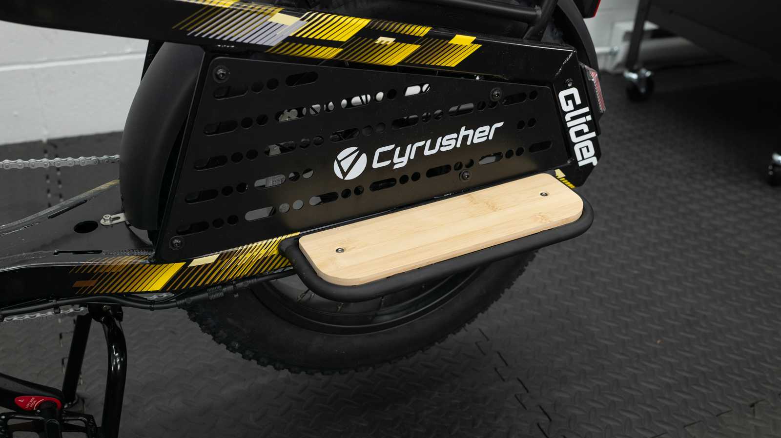

Ill-fitting Footboards
Some of the accessories that Cyrusher provided for testing didn’t fit correctly. The worst offender was the drive-side passenger footrest. Installing it means bending the rear derailleur cable, which results in poor shifting. Unfortunately, I couldn’t find a fix for this issue.

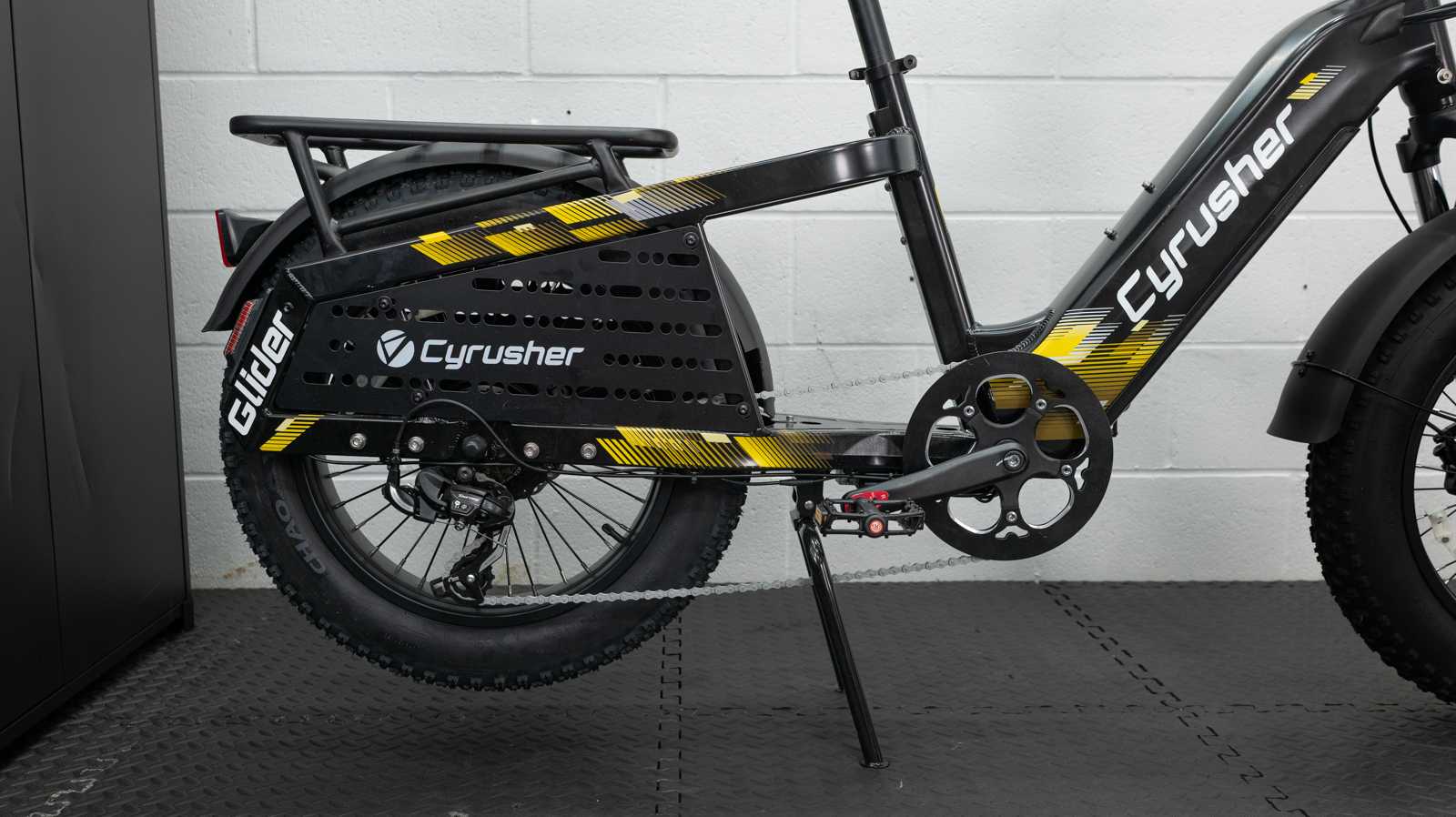

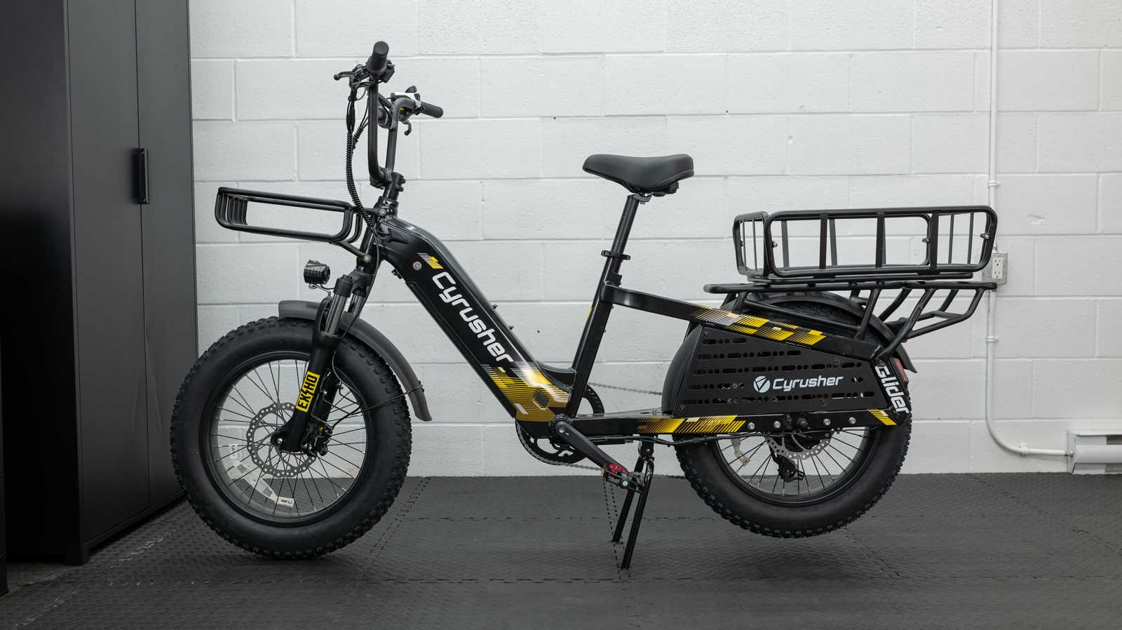

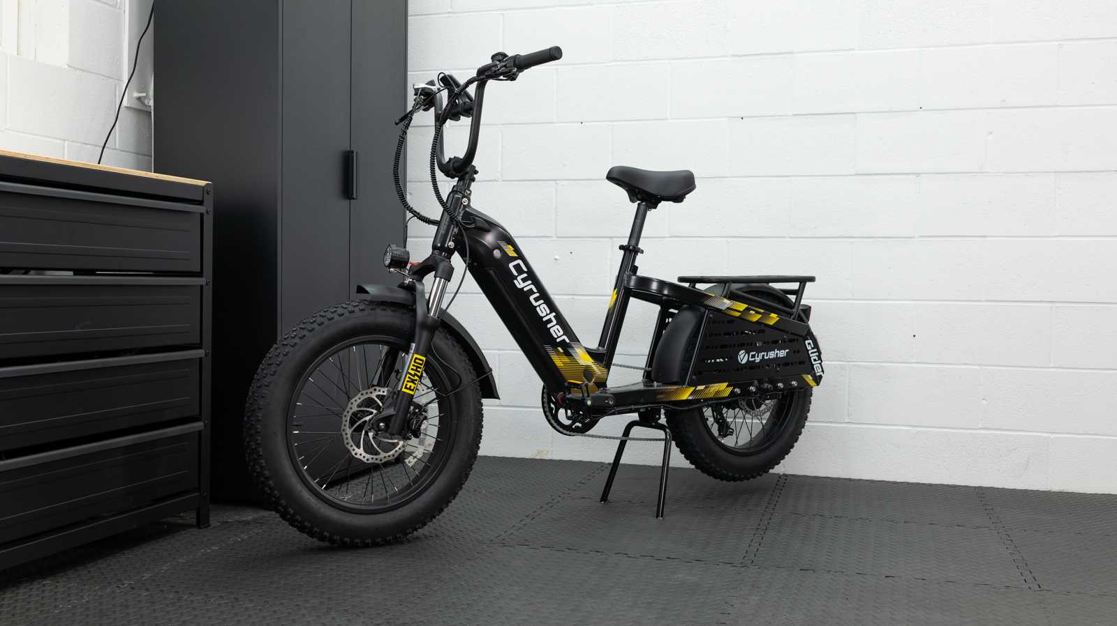

Poor Kickstand Design
The double-sided kickstand lifts the rear wheel high off the ground. Its relatively forward positioning and length means it acts like a see-saw, so when I put weight on the rear rack, it tips backward quite aggressively so the front wheel is lifted into the air.
The lateral stability of the bike is fine, but I would feel uncomfortable loading kids or delicate cargo onto this bike with it moving so much while on the kickstand. This problem could be corrected if the stand didn’t lift the rear wheel as high or if it were placed further back on the frame.
I also noted that the return spring for stowing the stand when not in use started to get stuck halfway, requiring me to push it up manually.

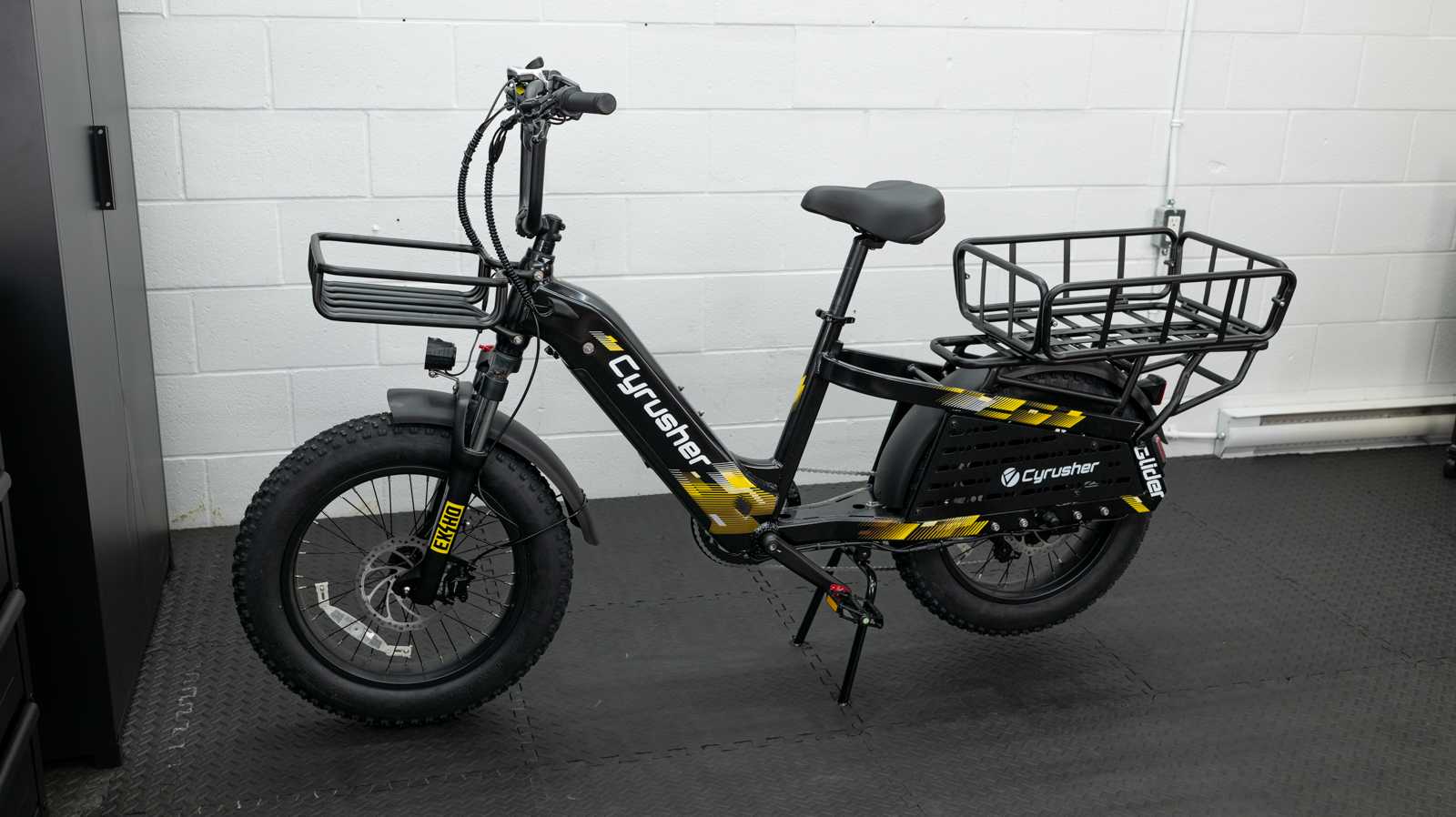

Cargo Capacity
The Glider weighs 91.5lb, and the payload capacity for rider and cargo is just 348.5lb. The frame-integrated rear rack supports 60kg of cargo, and the optional front rack adds another 20kg.
The short-tail rear rack and limited rack weight capacity make Cyrusher’s “cargo e-bike” label seem like a stretch. We think the Glider is more accurately described as a utility e-bike.

Drivetrain, Brakes, and Wheelset
The Glider has a set of Logan hydraulic brakes with two-piston calipers and 180mm rotors. The drivetrain is a basic Shimano Tourney setup with a TX-50 shifter, 14-28t 7-speed freewheel, and a 52t aluminum crank covered by a single-sided guard. The bike doesn’t have a chain tensioner or guide despite the long chain line, meaning there’s a lot of chain slap on rough terrain.

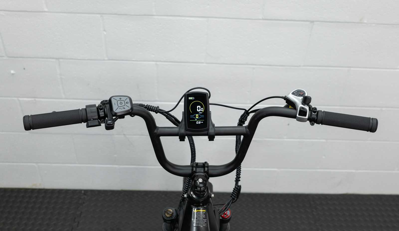

The Glider’s handlebars come with locking rubber grips, a thumb-style throttle, a horn button, a five-button control pad, a centrally mounted display, and the TX-50 shifter. The other touchpoints include a large padded saddle and aluminum platform pedals.

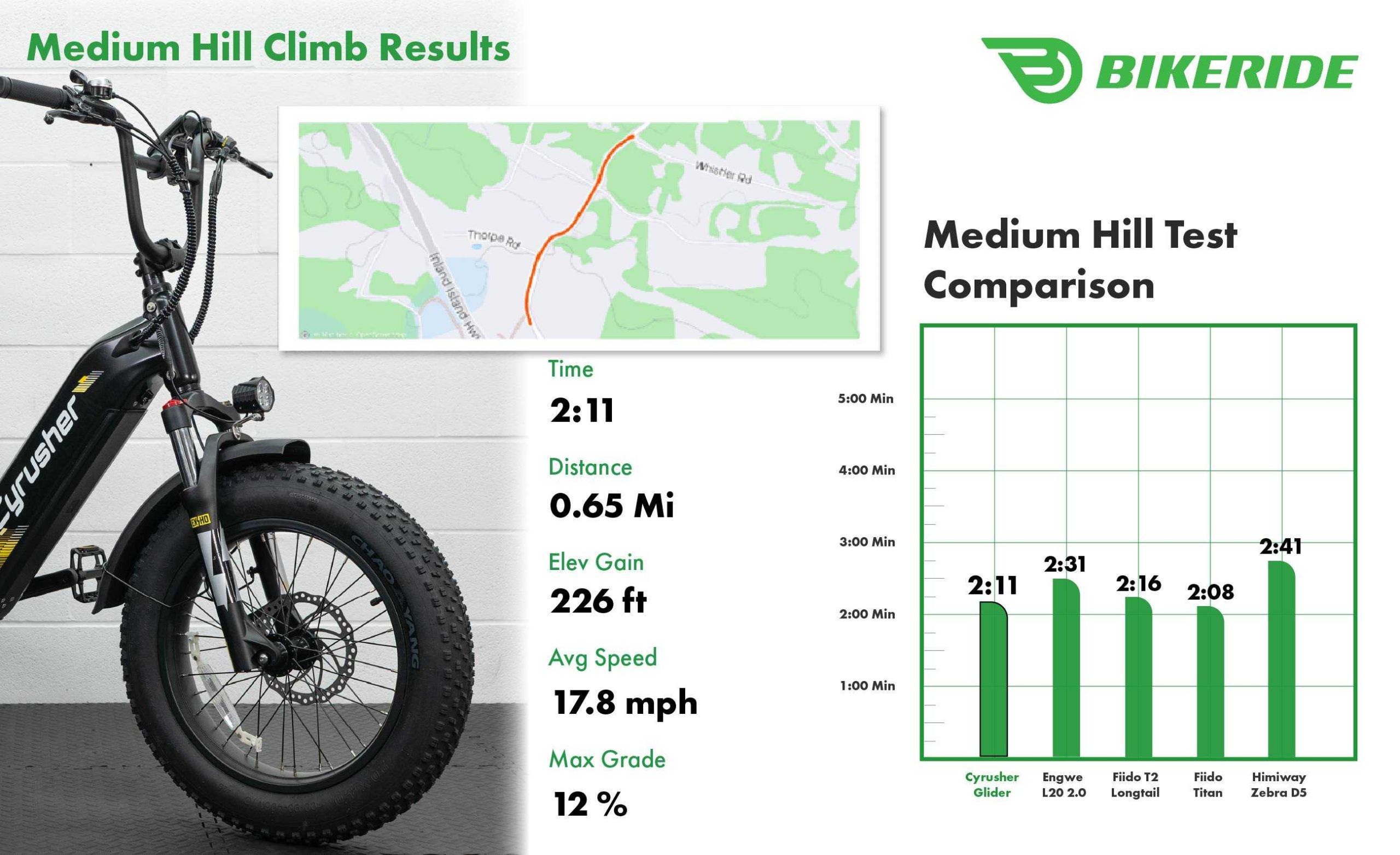

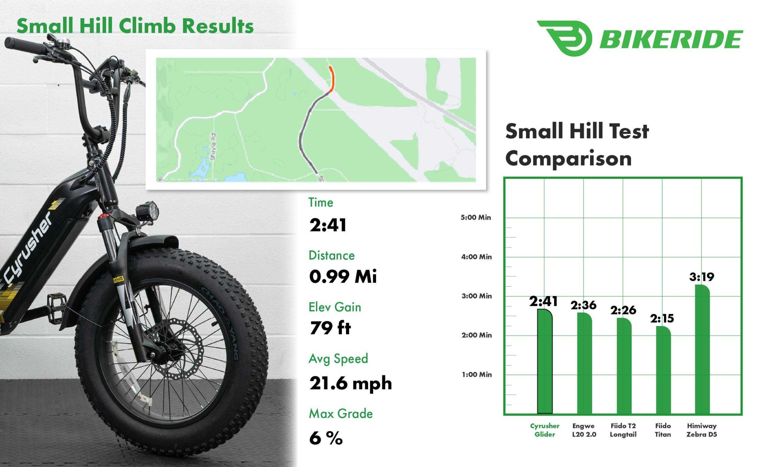

Hill Climb Tests
The Cyrusher Glider produced a fast time of 2:41 in the longer, less steep hill climb, maintaining reasonable assistance throughout. However, compared to other Class 3, 28mph models, the Glider only beats the Himiway D5. This is likely down to the bike’s weight.
The Cyrusher is also limited by its gearing, which results in ghost pedaling at speeds over 20mph, so the torque sensor cannot be taken advantage of fully. The Cyrusher isn’t a slow bike or a slow climber, but it’s not quite as fast as some other models we’ve tested, at least on this type of climb.
In the shorter, steeper climb, the Glider was only outpaced by the Fiido Titan, holding a rapid 17.8mph average speed. This is an impressive result, considering the bike’s high weight.

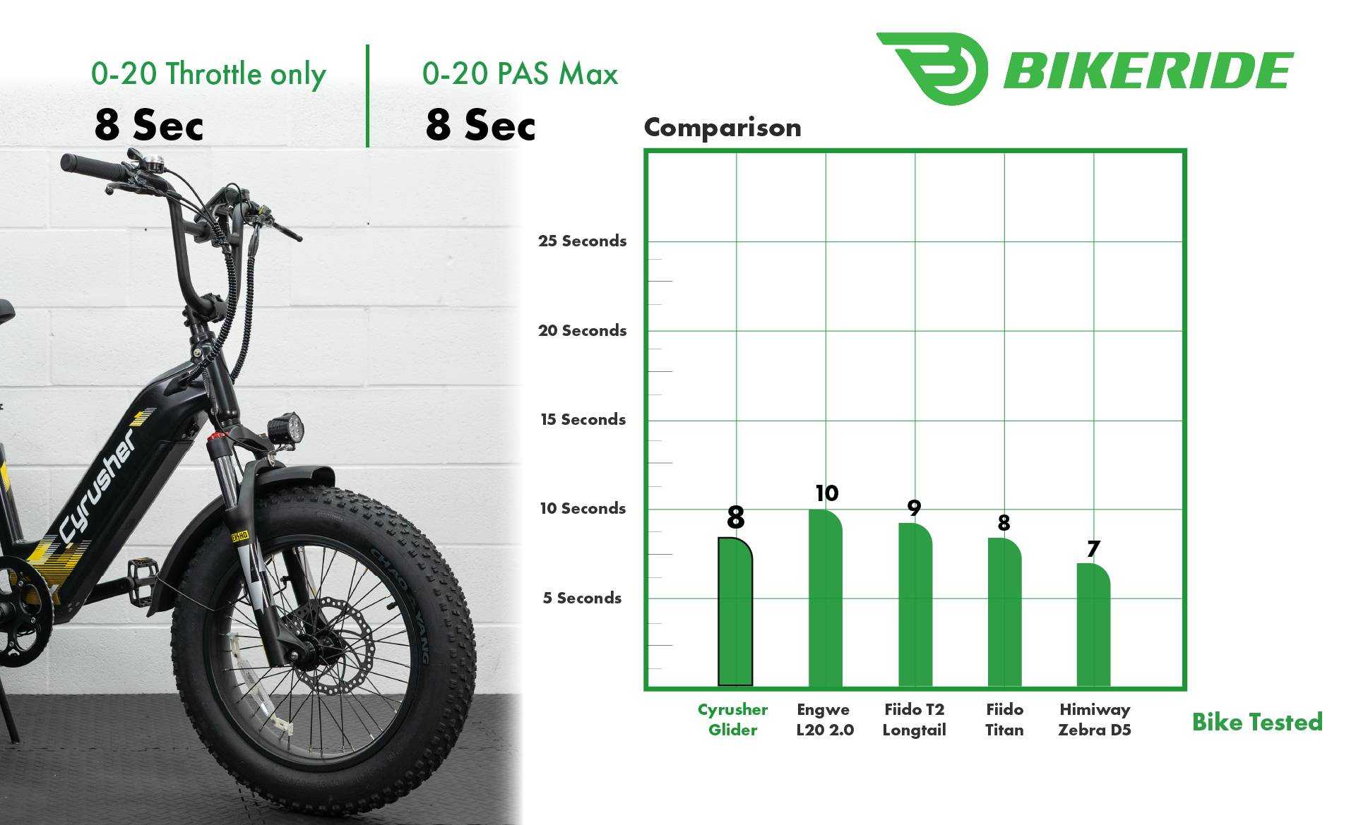

Acceleration Tests
As mentioned in the first pro, the Glider’s acceleration is excellent, taking just 8 seconds to reach 20mph from a stop whether using the throttle or PAS level 5. This is the fastest throttle acceleration result we have recorded, matching other powerful bikes like the Velotric Summit 1, the Himiway Cobra, and the QuietKat Lynx.

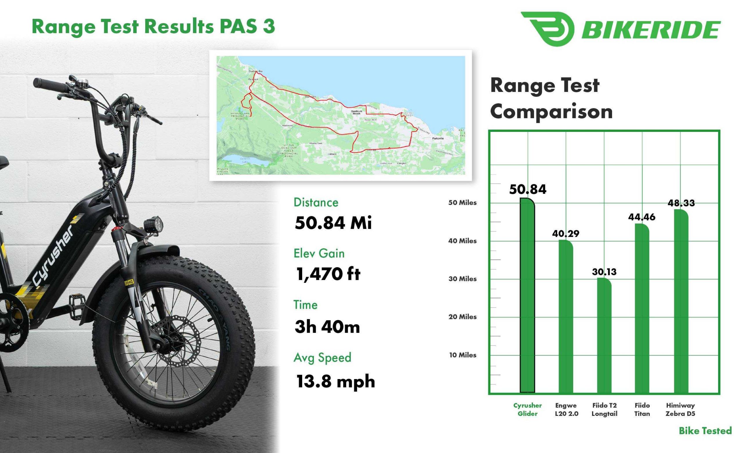

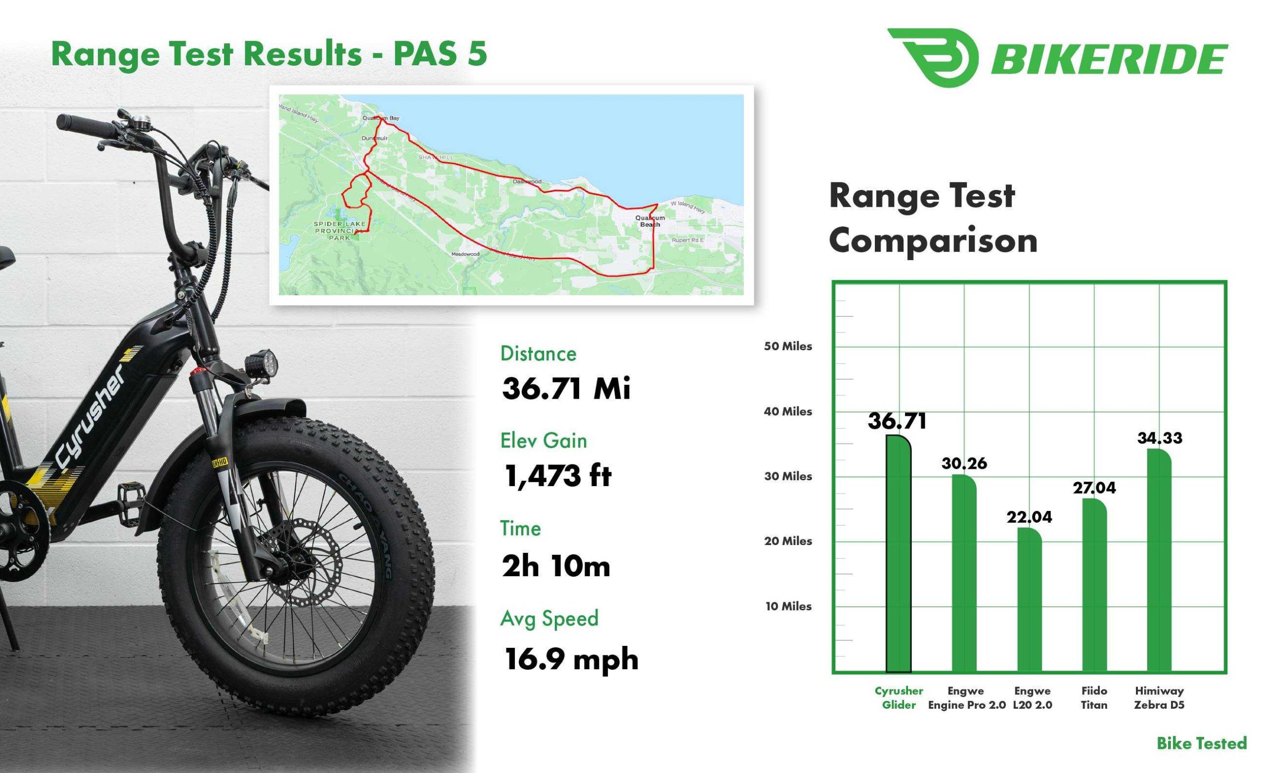

Range Tests
The Glider delivered impressive range in both tests, covering almost 37 miles with 1,473 feet of elevation in the max assistance test and roughly 51 miles with the same elevation gain in the real-world PAS 3 range test.
The only downside is that PAS 3 is a little underpowered, especially for hills, so the average speed during the test was just 13.5mph. This meant briefly using PAS 4 and 5 on some of the steeper sections of the test course.
Another pleasant feature of the Glider’s battery is that the five-bar battery indicator didn’t fluctuate. Each bar was used consistently and reliably, making it easy to gauge remaining range.

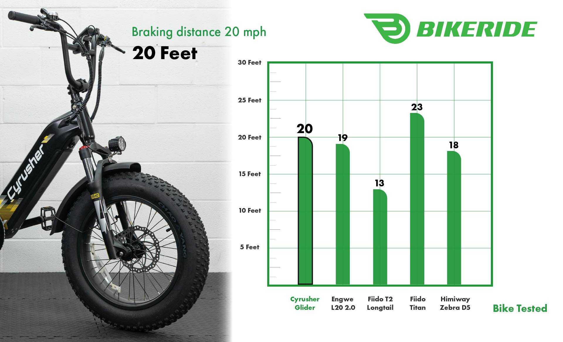

Brake Tests
The Glider’s stopping distances, while within a safe range, are longer than average. From our comparison bikes, only the Fiido Titan took longer to stop. The Fiido T2 long-tail cargo e-bike, with similar wheels, took just 13 feet.

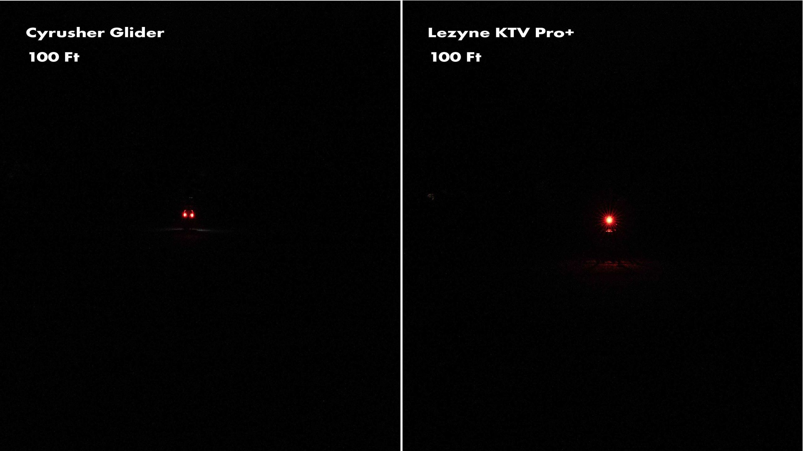

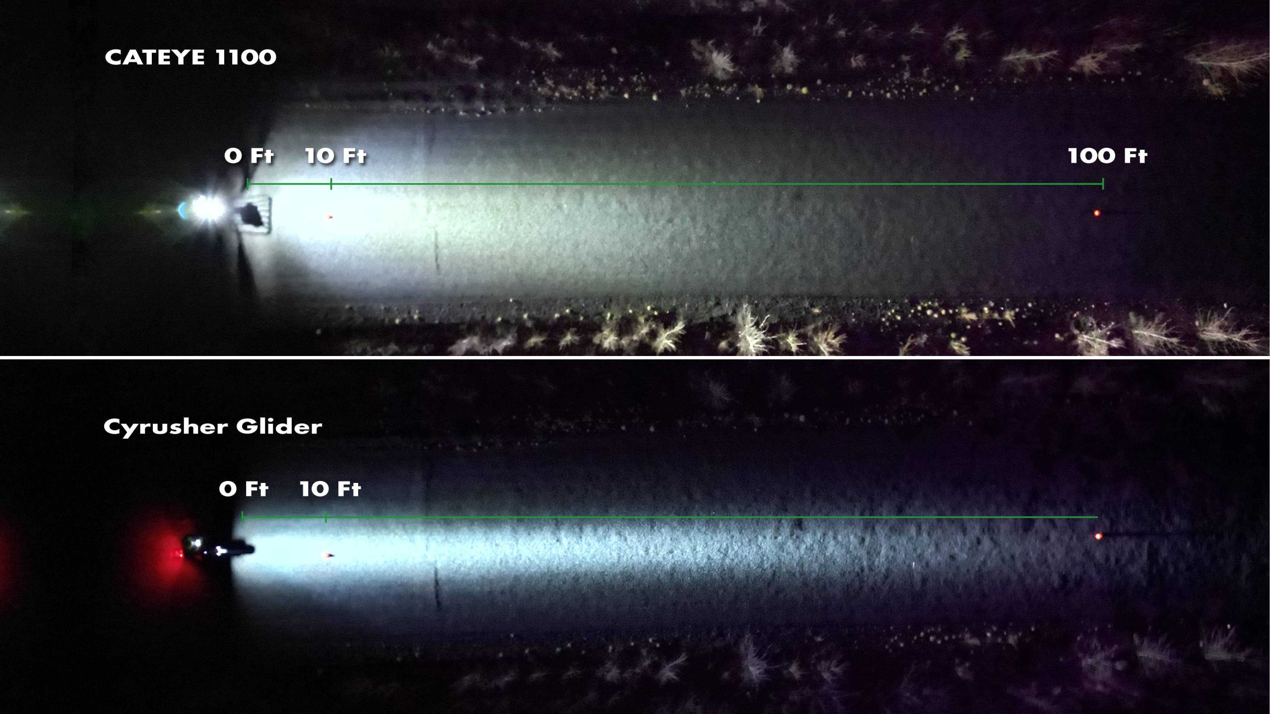

Light Tests
The Glider comes with a bright front light that easily illuminates a set of cones 100 feet away. The beam reach is almost as good as our Cateye AMP1100 1,100-lumen test light, but looking at the beam from above, you can see that it’s narrower and doesn’t illuminate the peripherals as well. That said, this is a great light for a bike at this price point, and the Glider could be ridden night without an additional front light.
The two rear lights are also bright when viewed from 100 feet away, as is the brighter braking indicator. However, the Glider’s taillights are not quite as bright as the 150-lumen Lezyne KTV Pro+.

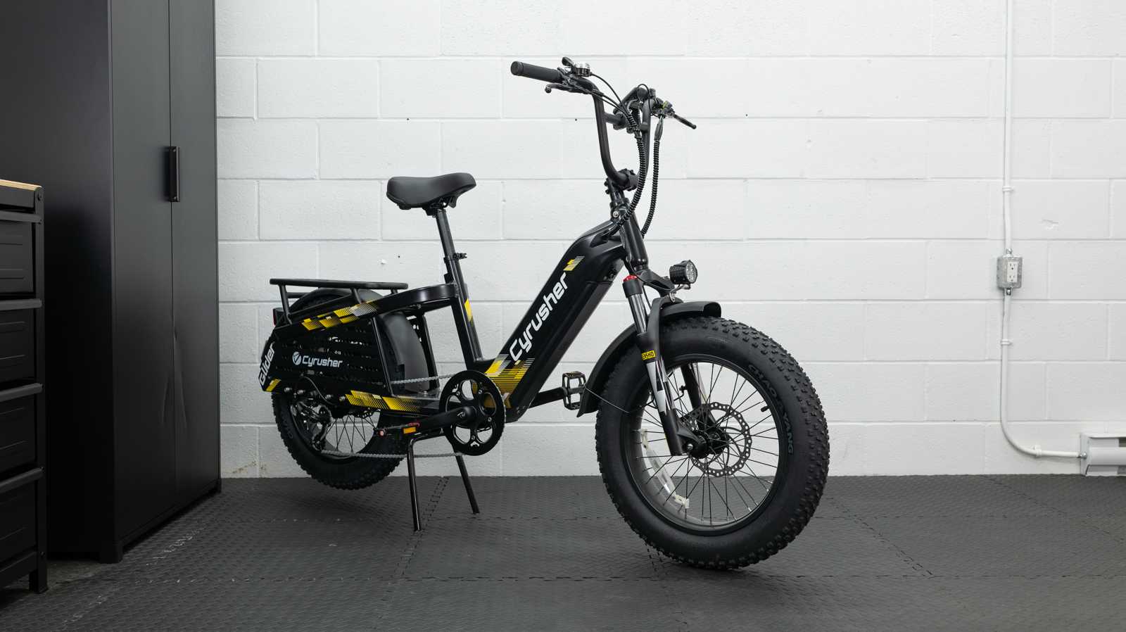

Riding the Glider

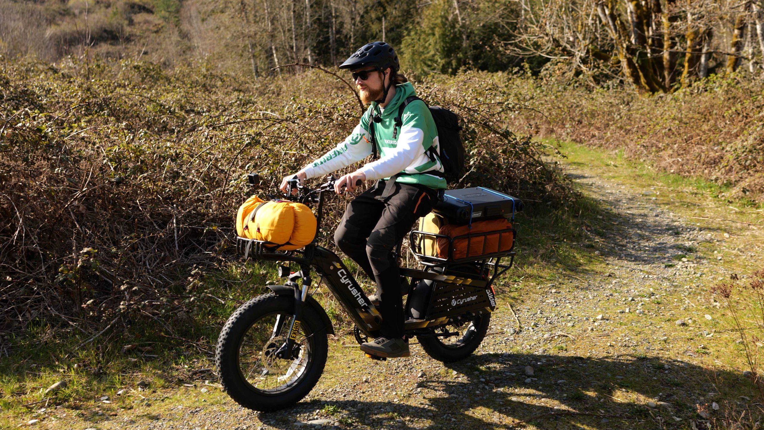

The Glider’s overall bulk and weight (91.5lb) isn’t very noticeable when riding with assistance, and the bike maneuvers well for its size. It was also comfortable throughout both range tests, and it rides well when loaded with cargo.
At 6’, the bike fits me well, though I have to use the full seatpost extension, so riders taller than 6’ or with inseams greater than 32” are unlikely to fit.
The Glider is a good option for running errands or doing deliveries thanks to the comfortable ride over pavement, responsive throttle and pedal assist, and solid battery range. However, the 80lb cargo capacity is a possible limitation.
The throttle’s power is linked to pedal assist, so adjusting PAS level changes the throttle’s output. Selecting PAS 5 gives access to the throttle’s top speed. In PAS 3, the throttle maxes out at 13 to 14mph.

Range Tested (PAS 3): 50.84 miles – 1,470 ft. – 13.8mph avg.
