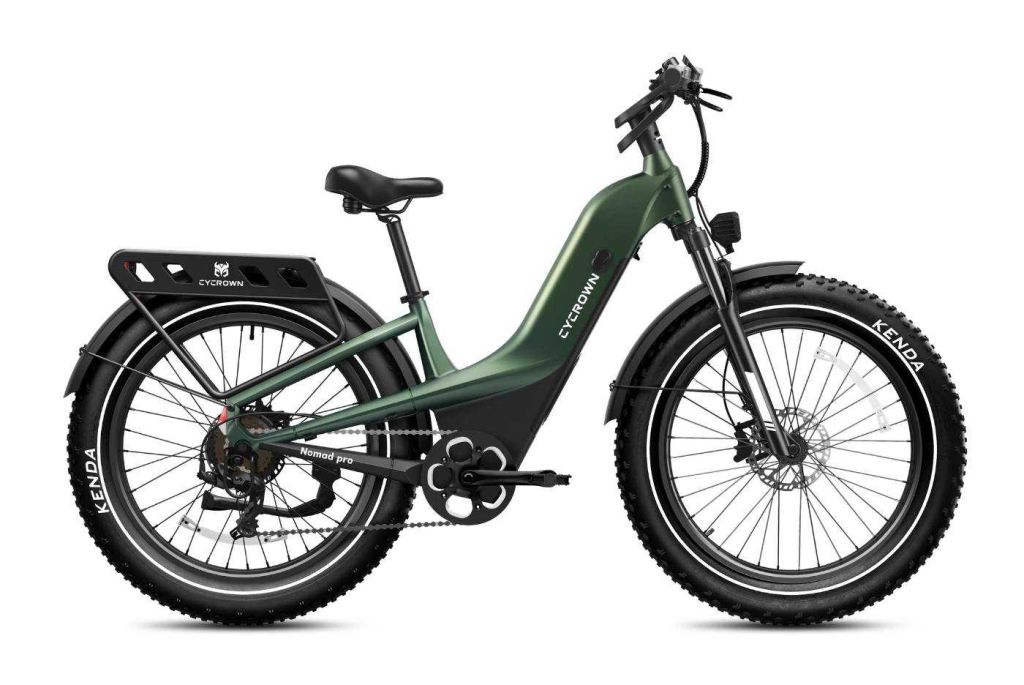

CYCROWN Nomad Pro Review
Scott Clough-Carroll, Bike Testing and Video Production By Scott Clough-Carroll, updated Oct 28, 2026 | Tested using BikeRide Methodology 1.1 First-Hand Test
Our verdict
The CYCROWN Nomad Pro is a quick, comfortable fat-tire commuter with more tech than most at this price: a color display, NFC unlocking and GPS tracking. It tied for the fastest 0–20 mph time in our group (7 seconds) and has the brightest headlight we've measured to date. The trade-offs are a short medium-assist range (36 miles, 40% of the claim), high weight of 93 lb, and UL 2271 battery certification still in progress. A good buy for commuters who can live with the weight and the tech quirks.
  • Quick off the line: 7 s to 20 mph
  • Brightest headlight we have measured: 1,593 lux
  • Responsive, controlled pedal assist
  • Comfortable on rough pavement and light trails
  • Support replied within 2 hours
  • Fenders, rack, brake light and signals included
  • UL 2849 came after our test, UL 2271 (battery) still in progress
  • Short medium-assist range: 36.33 miles
  • Heavy at 93.2 lb
  • NFC card only: no key or power button
  • Dim display that scratched within days
  • Throttle runs to 28 mph in Class 3 mode

CYCROWN claims 93.7 lb. Our scale read 93.2 lb. That makes the Nomad Pro the heaviest bike in this comparison group, and the third-heaviest of the 18 fat-tire e-bikes we have weighed, 7.8 lb above their 85.4 lb average. CYCROWN rates the payload (rider + cargo) at 330 lb on its product page and the maximum load at 440 lb in its manual.
93.2 lb on our scale, half a pound under CYCROWN's claim, but heavy.
Measured weight, as shipped
Pounds · lighter is better
CYCROWN Nomad Pro93.2 lb

The aluminum frame comes in one size and carries the 960 Wh battery inside the down tube. Over rough ground the chain slaps loudly, and there is no chainstay protector to quiet it or protect the frame.
The CYCROWN Nomad Pro from the non-drive side in the BikeRide studio, on its kickstand
The one-size aluminum frame, with the 960 Wh battery integrated into the down tube.
