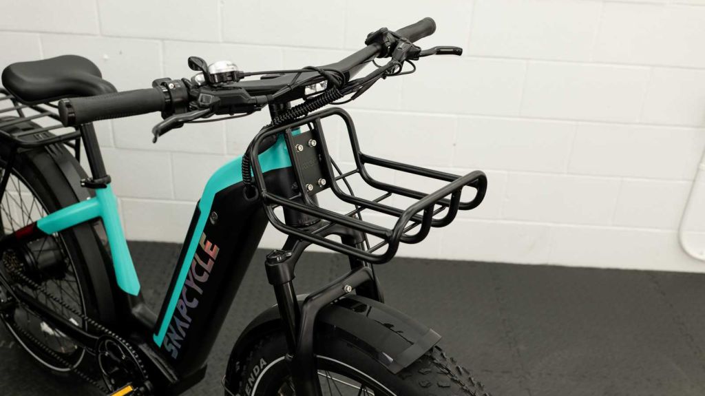

The R1 Pro is an adventure-style fat bike with an aluminum frame and a suspension fork. A 960Wh battery powers a 750W hub motor, and a torque sensor manages pedal assist.

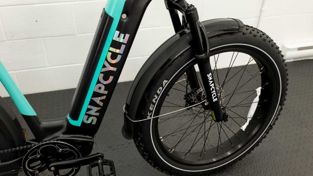

The R1 Pro comes with fenders, a rear rack, and nicely integrated front and rear lights—all standard accessories for this category. However, it has a few noteworthy extras.
The headlight has switchable high and low beams, and the taillight has brake activation and turn signals. Both features should improve safety on the road. Our test bike came with a front rack, but this costs extra.

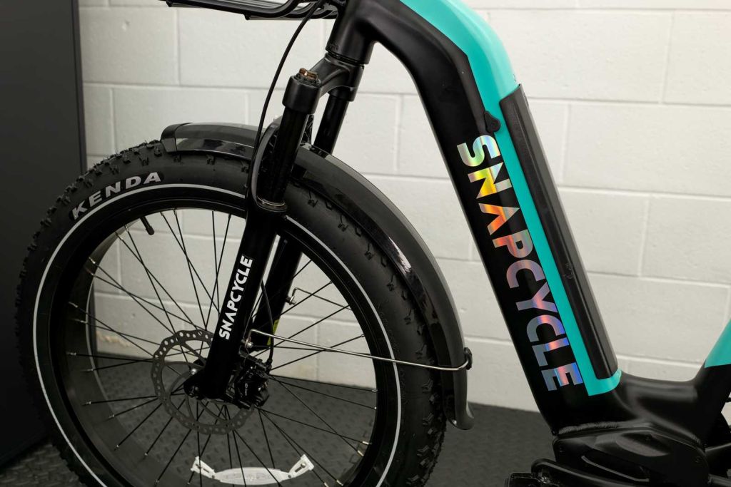

The headlight is neatly integrated into the handlebars. Similarly, the display is embedded in the stem portion of the one-piece cockpit. The cables are tidy, and they disappear into the frame behind the head tube.
This integration makes the bike look neat but adds work when servicing or replacing these components.

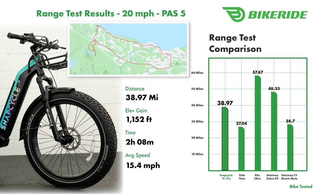

In testing, the 20Ah battery lasted almost 40 miles in Class 2 mode on PAS 5, the highest pedal assist level. Dropping down to PAS 3, the range topped 45 miles at an average of 15.5mph.
Some credit for the good range must go to the torque sensor, which manages motor power well, conserving battery by never giving more power than needed. Battery voltage also tapers off smoothly, so there’s no sudden drop in performance.

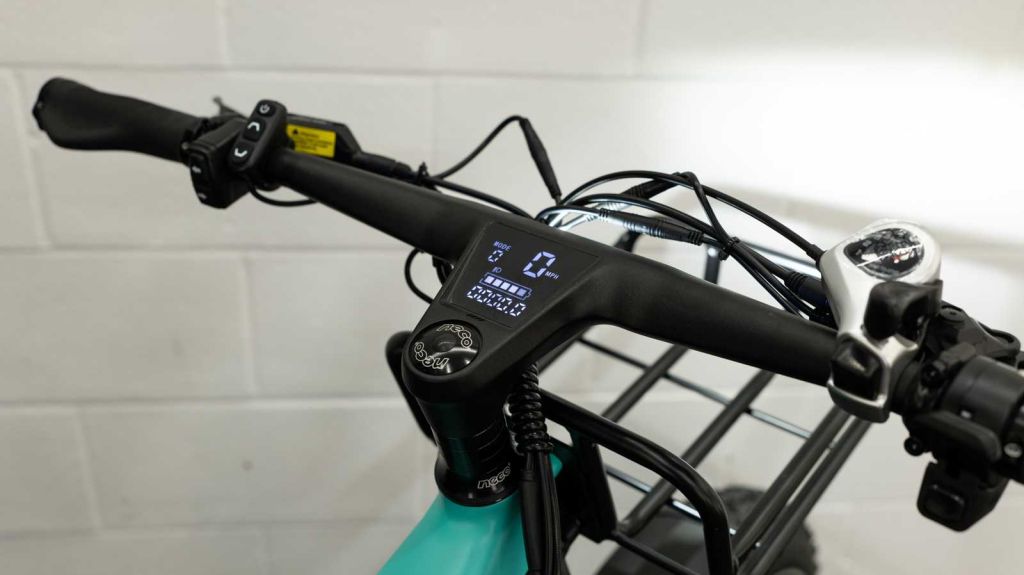

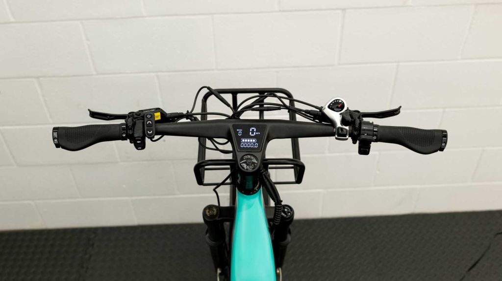

Display and Control
The color display is small and simple. The readout shows speed, pedal assist level, and battery level. There’s a trip meter but no odometer to show total distance traveled. A ride timer is also missing.
There’s no option to monitor battery voltage, and during testing, the five-bar battery meter fluctuated up and down by one bar, depending on how hard the motor was working.
Battery range dropped consistently, making it easy to estimate remaining range. When the battery level was on the third bar, the range was 50%. At two bars remaining, the readout turned yellow, and at one bar, it turned red.
The 12 advanced menu options can be accessed by pushing the up and down buttons together. A notable omission is the lack of a USB port to charge a phone.

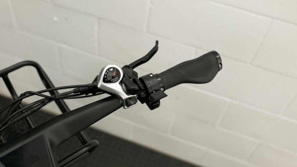

The simple e-bike controls are on the left side of the handlebar, next to the mechanical bell. There’s a three-button control pad for the bike and a pair of buttons for the turn signals. These units are separate and can be rotated to suit personal preferences. Clicking the power button toggles between high and low beams if the headlight is on.
The turn signals must be turned on and off manually. There is no auto-cancel, timer, turn signal icon on the display, or audible warning if you forget to cancel the signal.

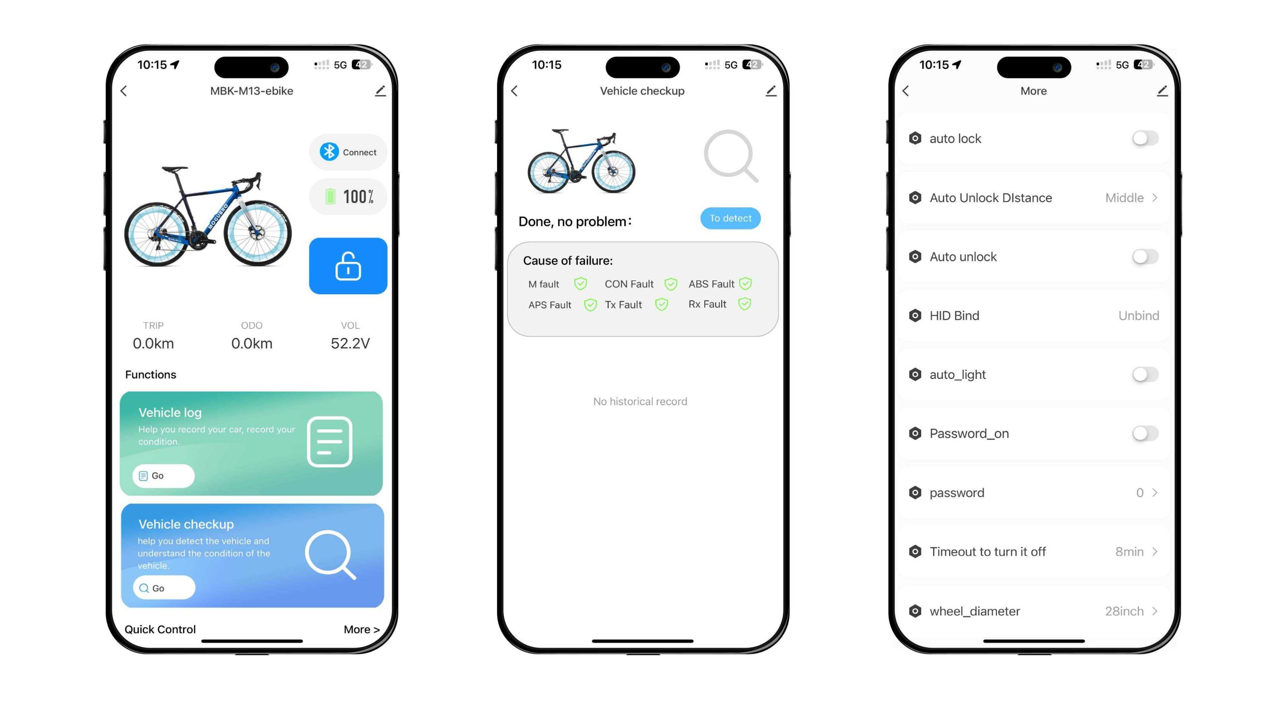

App
The first time using the app, I couldn’t get it to pair with the bike. The process outlined in the manual didn’t work because the auto-pairing function couldn’t find the bike.
I contacted Snapcycle, who provided a reset procedure, but this should be included in the manual. After I reset the bike, the pairing worked without any problems.
Snapcycle uses the generic Smart Life app by Tuyo, which is available for both Android and iPhone.
A generic app deprives Snapcycle of the opportunity to provide bespoke features. Overall, the Smart Life app’s functionality is underwhelming, with only basic options and no ride tracking. The only real use for this app is for managing a handful of options, Bluetooth keyless locking, and maybe troubleshooting.
Given this bike’s price and lack of a USB power port and phone mount, the underwhelming generic app and basic display are disappointing.

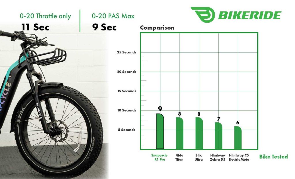

Snapcycle R1 0-20 Page
This R1 Pro’s acceleration is good but slightly slower than competing models. It reached 20mph from a standstill in nine seconds using pedal assist and 11 seconds using the throttle.
PAS 5 provides plenty of assistance and makes it easy to maintain high speeds without breaking a sweat. Climbing hills is also made easy by the motor’s 85Nm of torque.

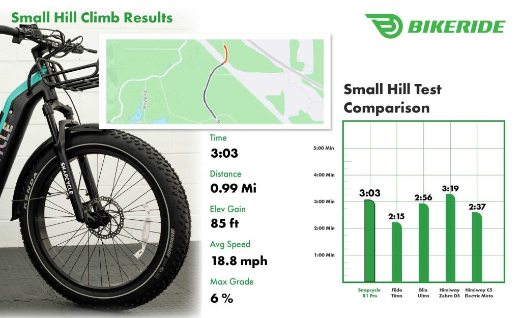

Snapcycle R1 Hill Climb Small
The R1 Pro’s climbing performance is also solid. The small hill test tends to reward bikes with less torque and higher top speeds and represents the kinds of hills the average rider is likely to encounter. The medium hill has a 12-degree incline, which is close to the steepest most e-bike riders will face.

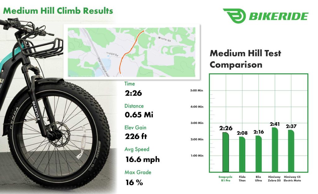

Snapcycle R1 Hill Climb Medium
The R1 Pro climbed the medium hill in 2 minutes and 26 seconds, averaging 16.6mph. It tackled the small hill in 3 minutes and 3 seconds, averaging 18.8mph. Overall, the R1 Pro’s hill climbing and acceleration are similar to competing bikes.

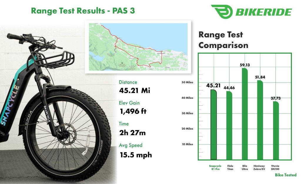

Snapcycle R1 Range Test Results PAS 3
In the max pedal assist range test, the R1 Pro covered 39 miles and 1,152 feet of elevation gain. With assist turned down to level 3 (our real-world test), the R1 Pro covered 45.2 miles with 1,496 feet of elevation. Both tests were done at an average speed of around 15.5mph.
The charger puts out 3 amps and provides a full charge in around seven hours, according to Snapcycle. The battery can be removed and charged off the bike, and a key-operated lock secures it in the frame.

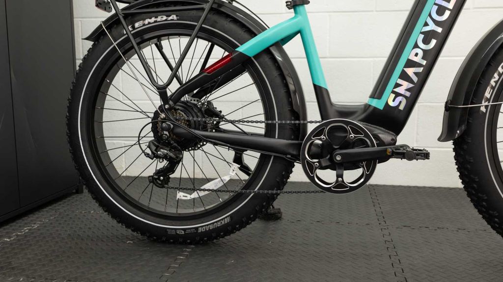

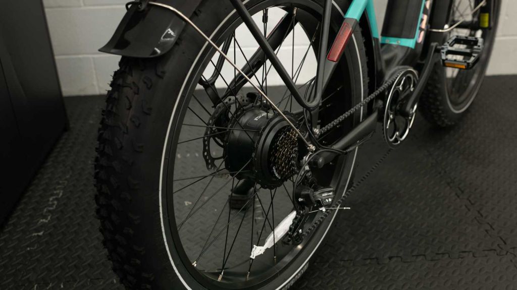

Drivetrain
The R1 Pro’s drivetrain is a typical collection of budget components. There’s the ubiquitous Shimano Tourney 7-speed derailleur, paired with a corresponding Tourney TX50 on the right handlebar.
At the rear, gearing is provided by a 14-28t cassette, and the pedals are attached to 170mm cranks driving a 48t chainring. A double-sided guard protects the chainring from foreign objects and clothes from the chain.
The gearing is fine for speeds up to 20mph, but ghost pedaling becomes a problem above that. As noted before, there’s a lot of chain slap when riding over bumpy terrain.

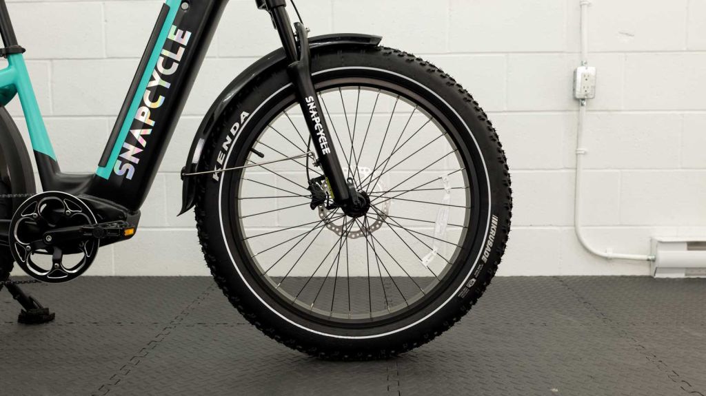

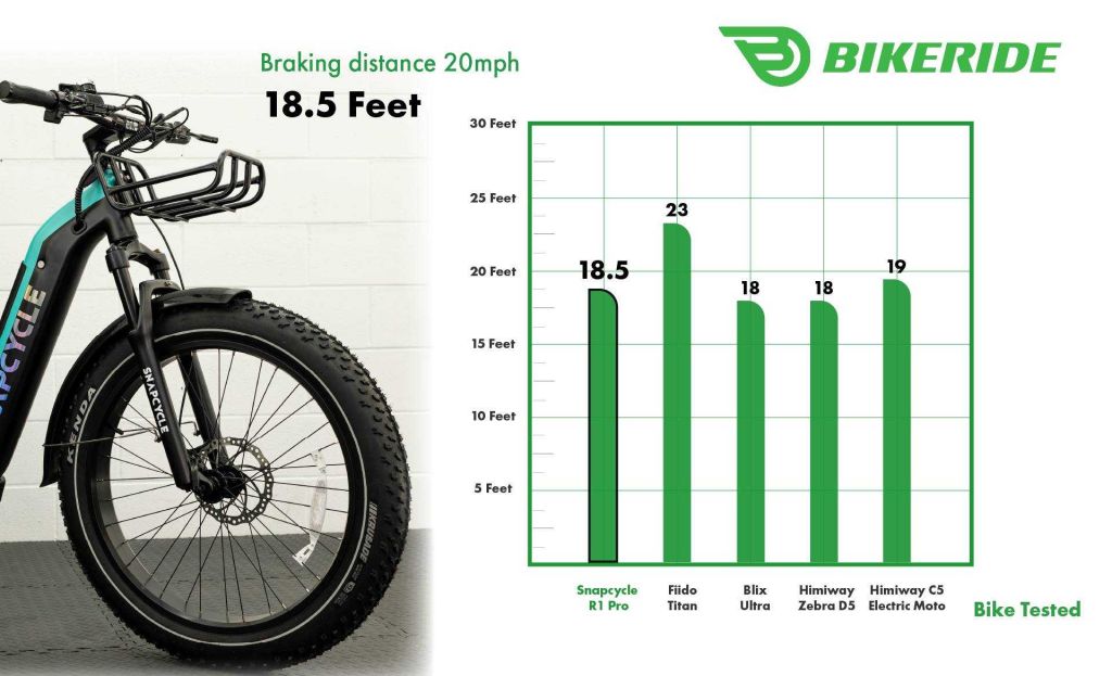

The R1 Pro I received from Snapcycle has generic Logan hydraulic brakes with 180mm rotors. Confusingly, the Snapcycle website says the bike comes with ZONGLUN brakes and 160mm rotors. When asked about this, Snapcycle seemed to say that most R1 Pros now come with the Logan brakes and bigger rotors, but there’s a risk that buyers could end up with the ZONGLUN brakes and 160mm rotors. The Logan brake levers have adjustable reach.
In testing, the Logan brakes performed well, coming to a complete stop from 20mph in 18.5 feet, which is almost as good as the best results from the bikes we’ve tested, which are under 18 feet.
Snapcycle R1 Brake Test

The R1 Pro comes with a reasonable set of accessories, but it doesn’t have mounts for a bottle cage.
The fenders are useful on the road but make too much noise off-road, and the rear rack provides good carrying capacity. The headtube has mounting points for the optional front rack included with our test bike.
The R1 Pro has integrated lights. The headlight has switchable high and low beams, and the frame-integrated rear lights function as turn signals and brake lights, meaning they light up when you pull the brake levers.

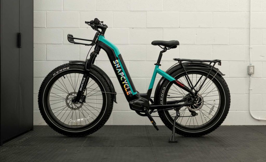

The bike has a heavy-duty single-sided kickstand. This operated fine throughout testing. Snapcycle offers extra batteries, frame and saddle bags, and some replacement parts.

The included lock-on grips are ergonomic and made from rubber. They were comfortable, offered good grip, and didn’t move on the bars. The saddle is padded and wide. I found it to be comfortable throughout testing. Finally, the aluminum platform pedals are typical for this kind of bike. They have small alloy pins for grip.

The Snapcycle R1 Pro is another big fat-tire e-bike. The torquey motor copes well with hills, and the well-tuned torque sensor combines with the motor’s 750W to provide smooth, responsive pedaling at low speeds and plenty of power for higher speeds.
Thanks in part to the torque sensor, the large 20Ah battery returned 39 to 45 miles of range with plenty of elevation gain while maintaining good average speeds of 15.5mph.

It’s a good-looking bike, but it won’t suit shorter riders, the brakes, fenders, and chain slap make it noisy, and the companion app is useless.
