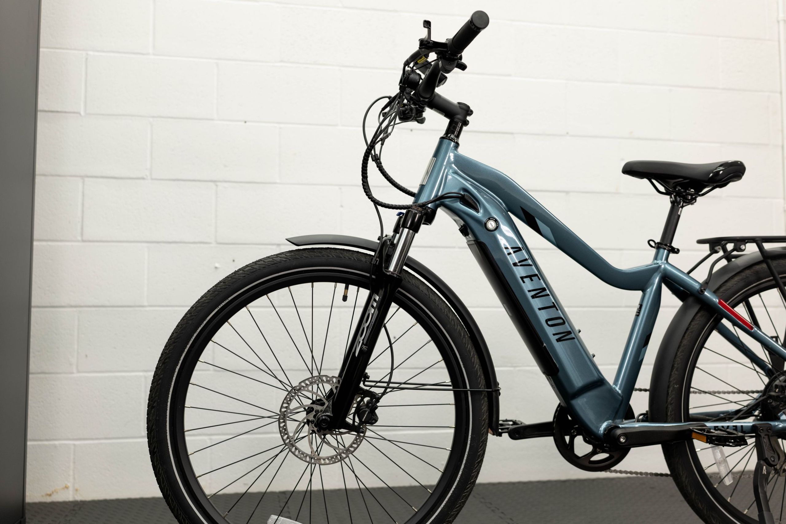

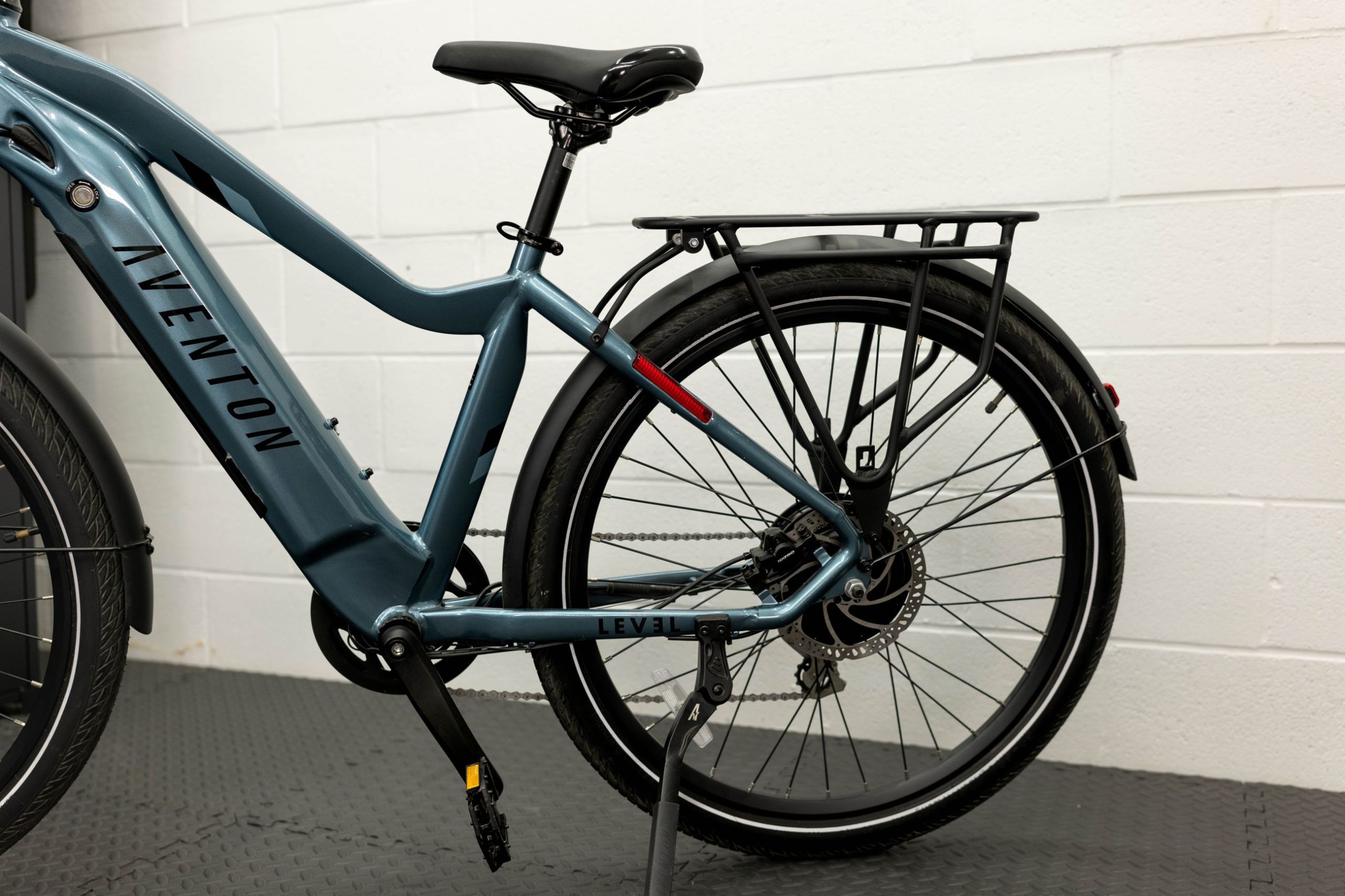

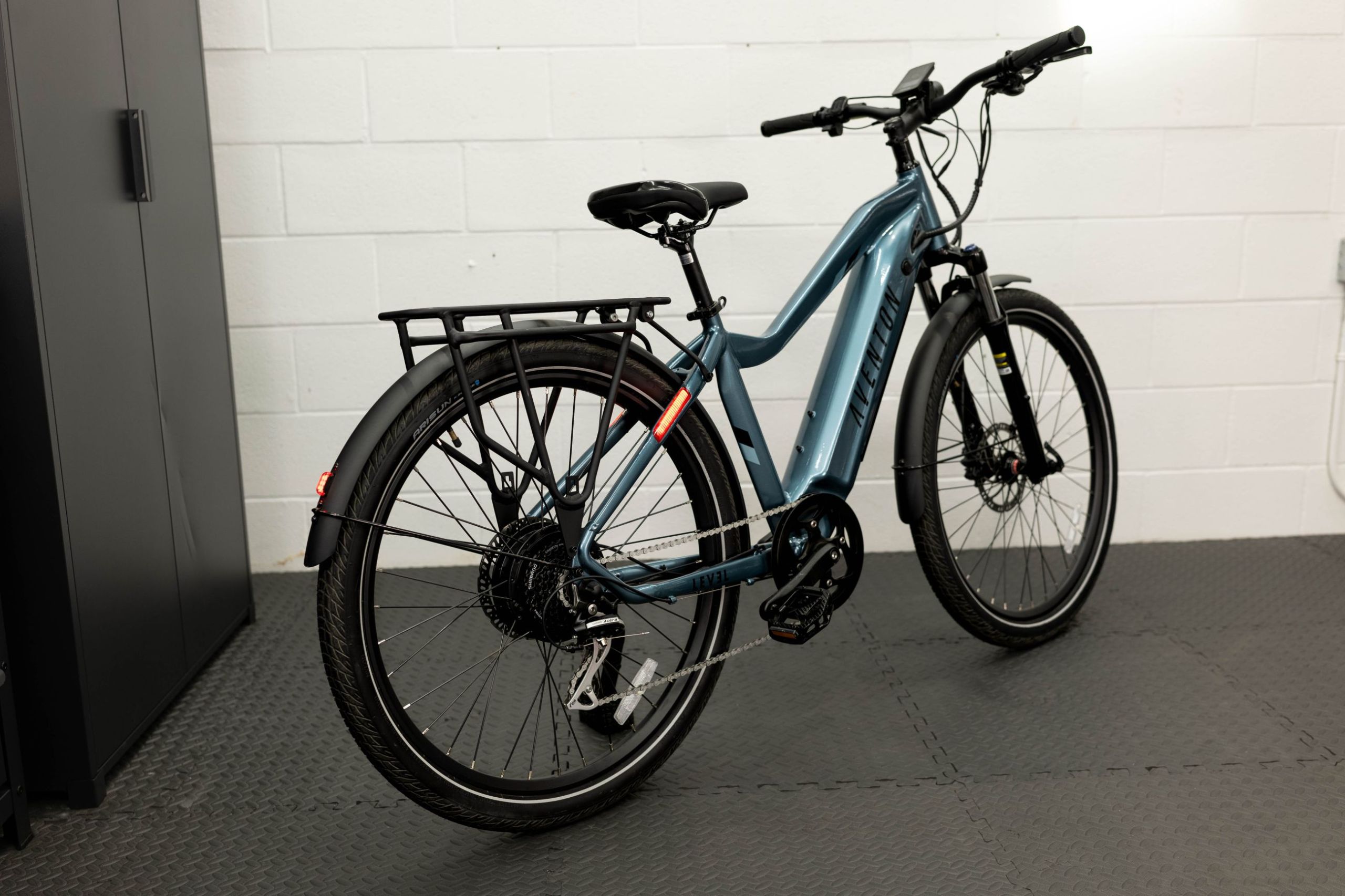

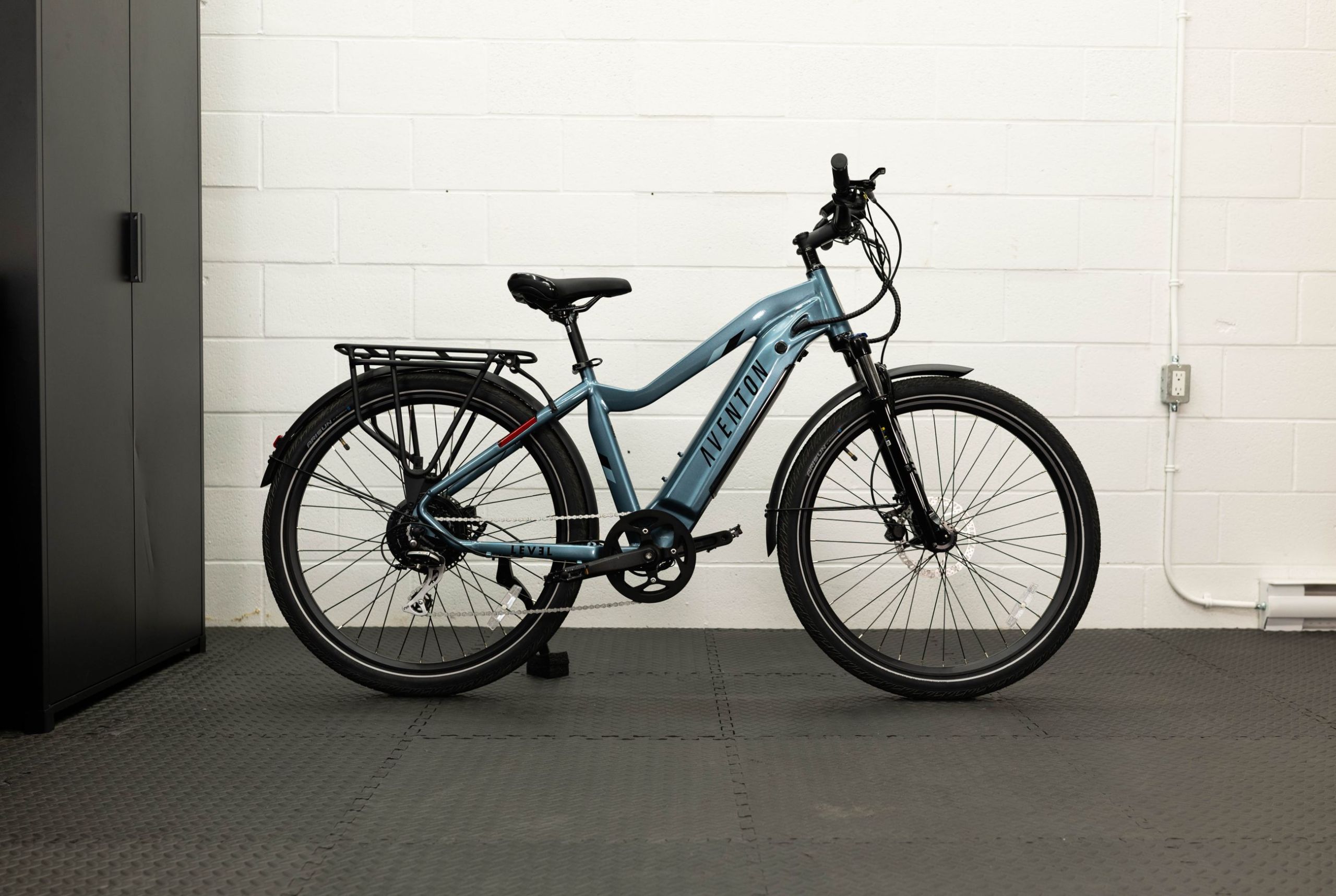

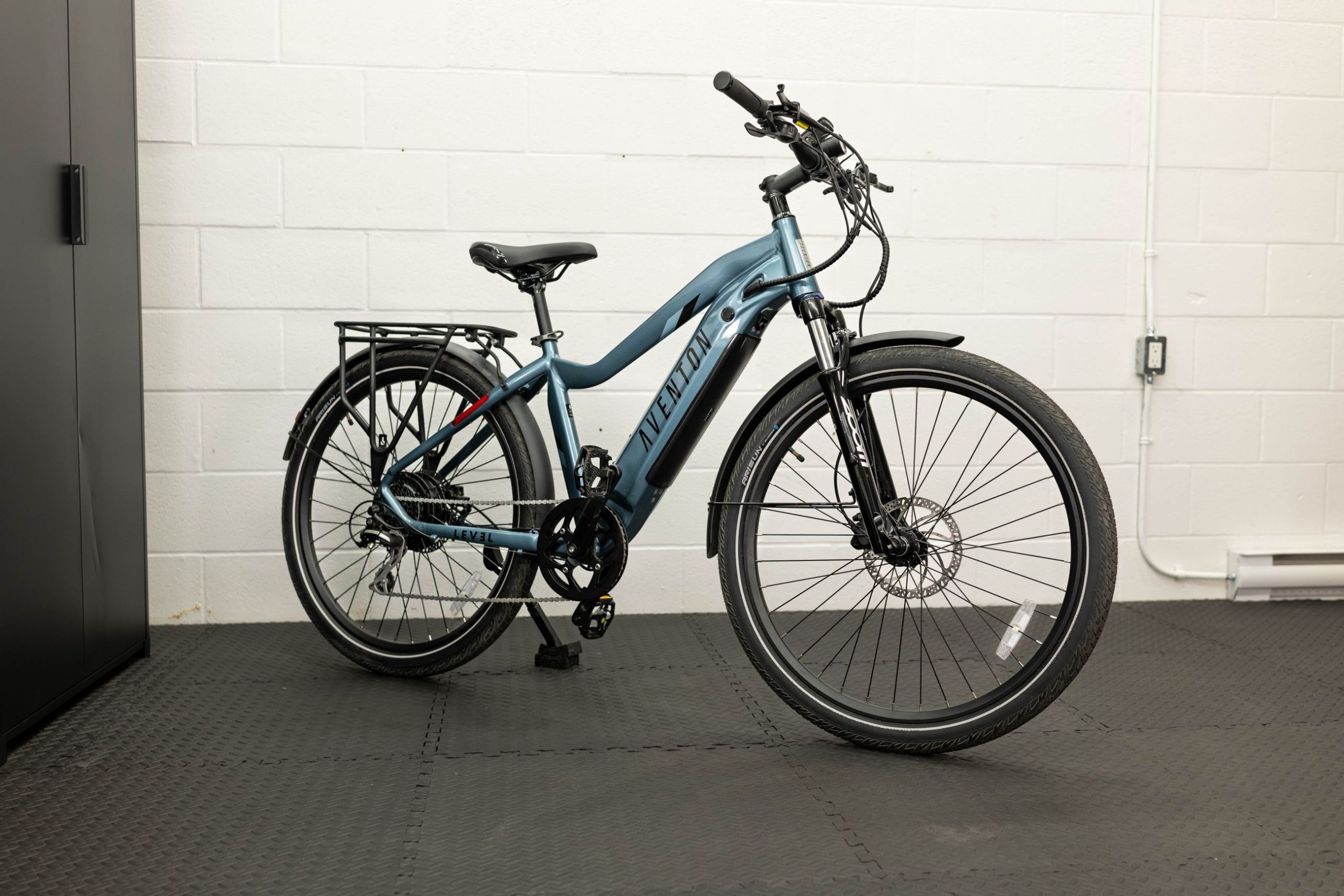

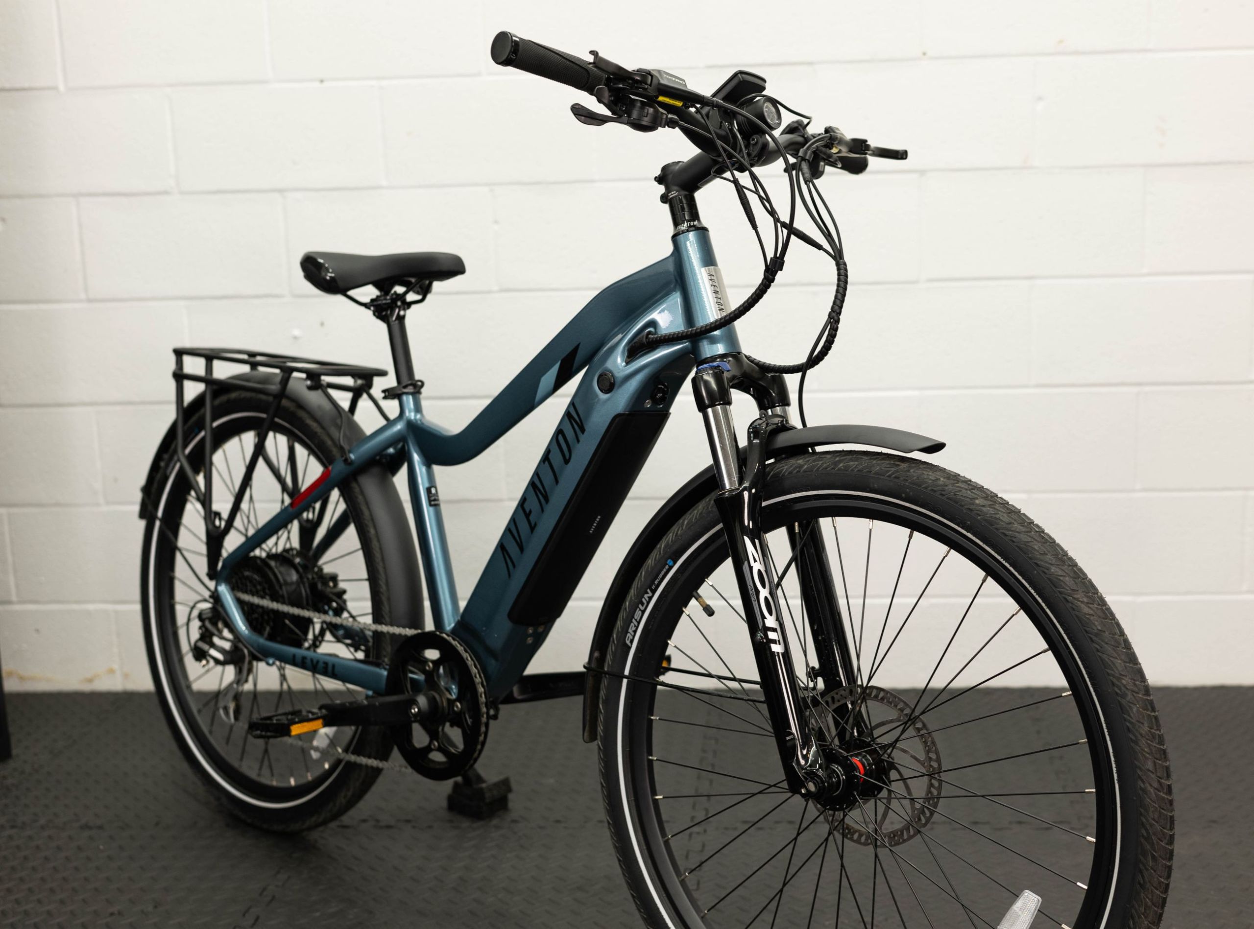

Frame and Geometry
The Level.2 is a conventional-looking e-bike with a great paint job and tidy welds. The sloping top tube dips towards the seat to reduce standover height and make the frame more accessible.
The geometry is relatively sporty for a commuter bike, making it easier to apply power when pedaling. However, it’s also comfortable.

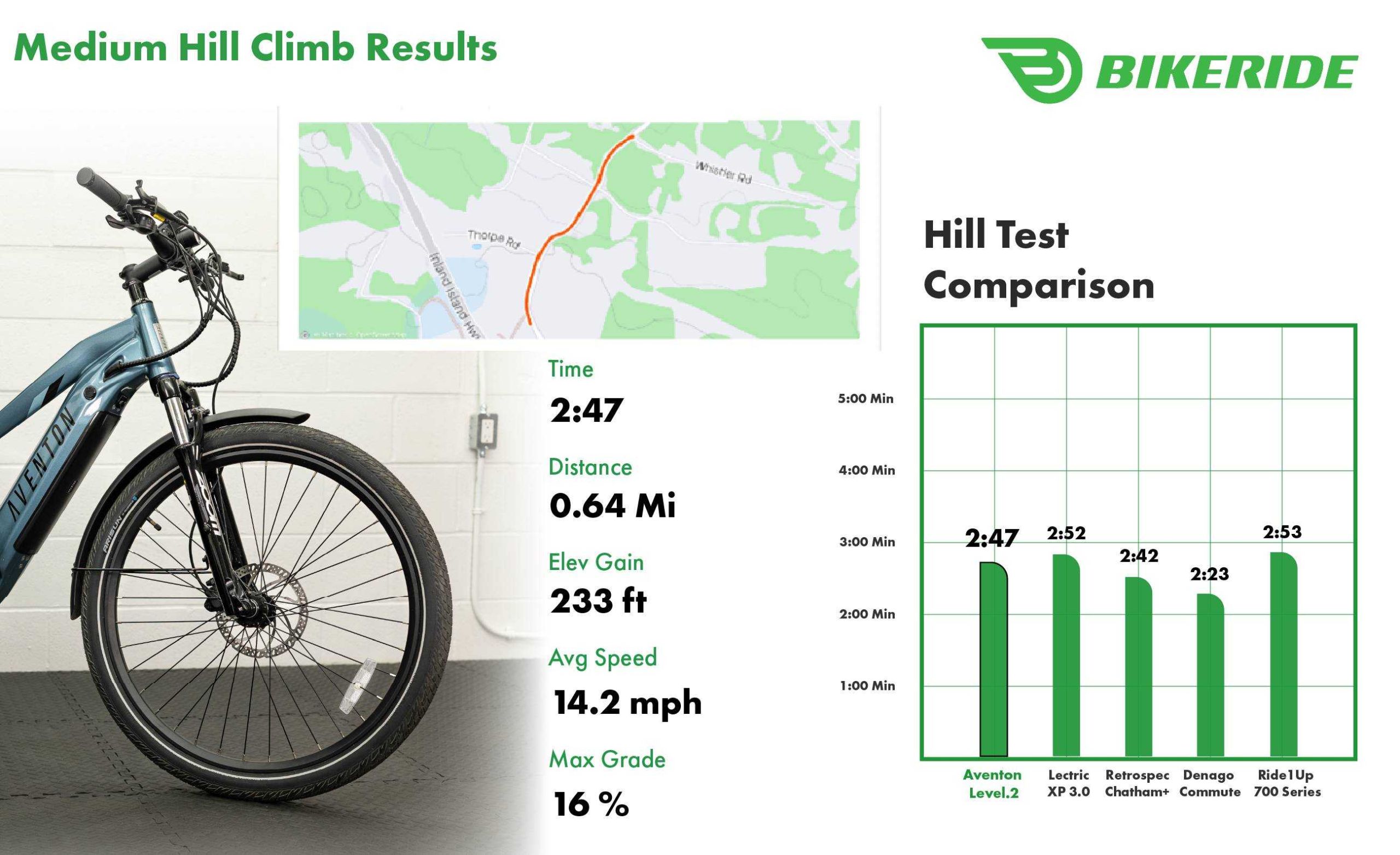

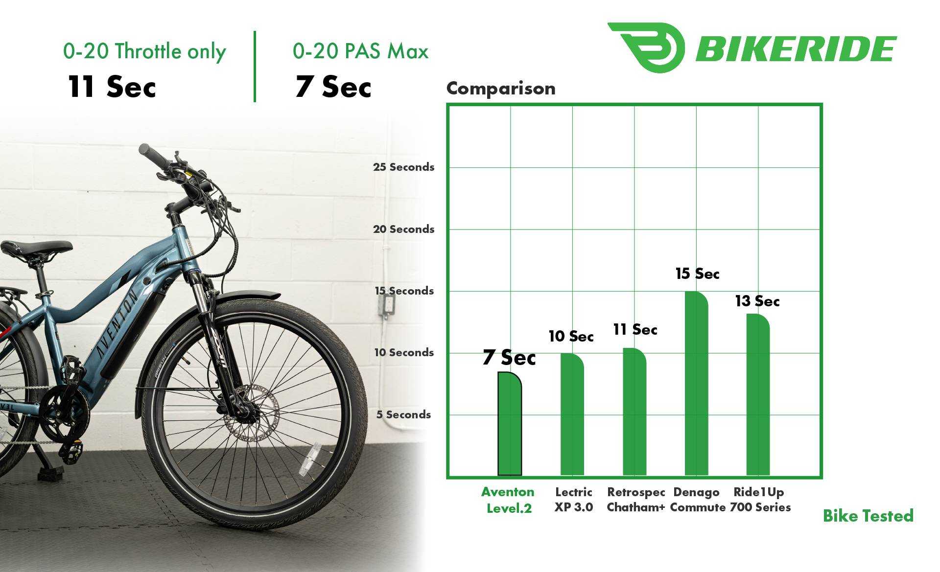

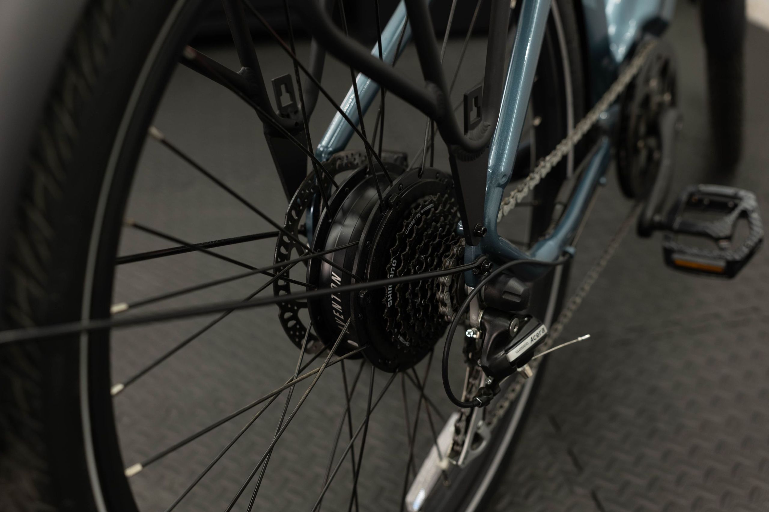

Motor
This bike has a 500W Aventon-branded hub motor capable of 750W at peak output. The motor’s torque output isn’t provided by Aventon, but similar motors are typically in the 50Nm to 65Nm range.
This motor is repsonsive and provides ample power at higher voltages (full battery). The bike easily reaches its top speed and has good acceleration when using the throttle.
The motor did struggle on steep and repetitive hills, showing its size on inclines of 16 percent, overcoming these climbs at a slow pace.

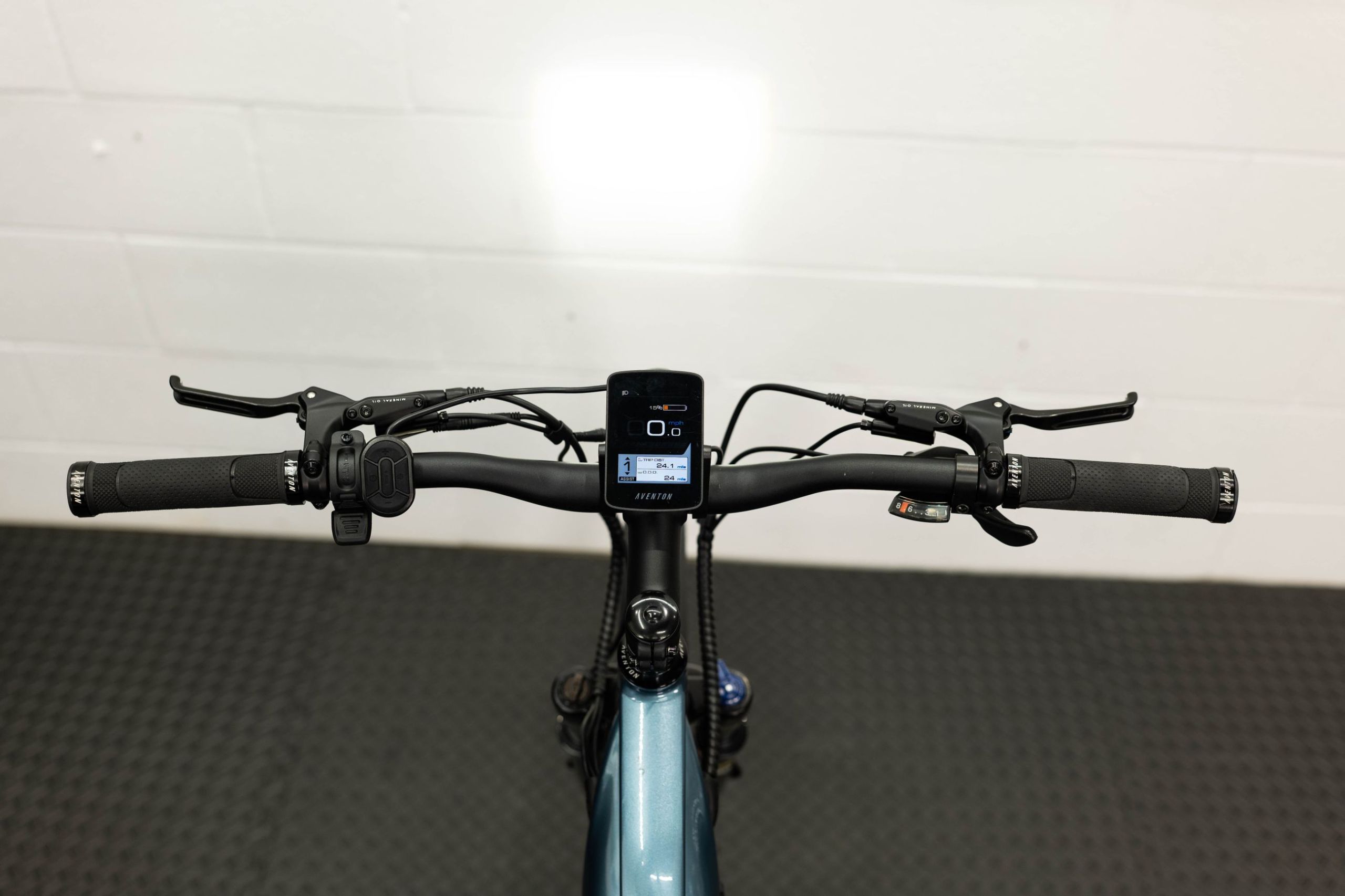

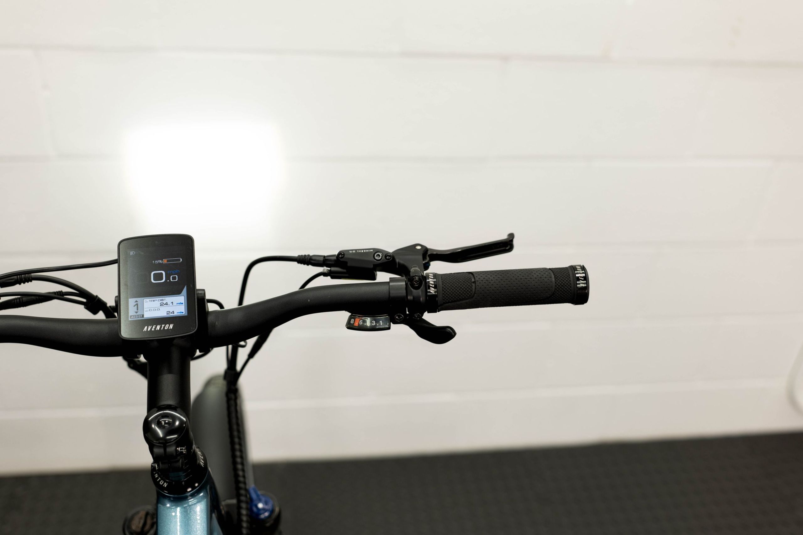

Cockpit and Control
The Level.2. is simple to control with its five-button touchpad, color display, and companion smartphone app. The touchpad has dedicated buttons for each function.
The color display is bright and easy to read, with solid functionality and metrics, including speed, odometer, assist level, and battery level. The battery level is displayed as a percentage for easier range estimation.
The smartphone app adds functionality by allowing easy access to settings. You can also track and share your rides with the Aventon community.

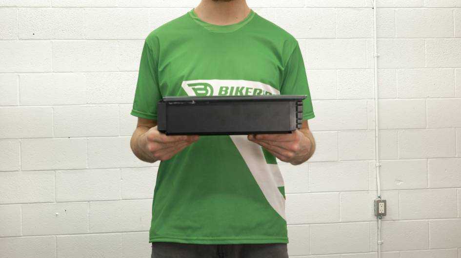

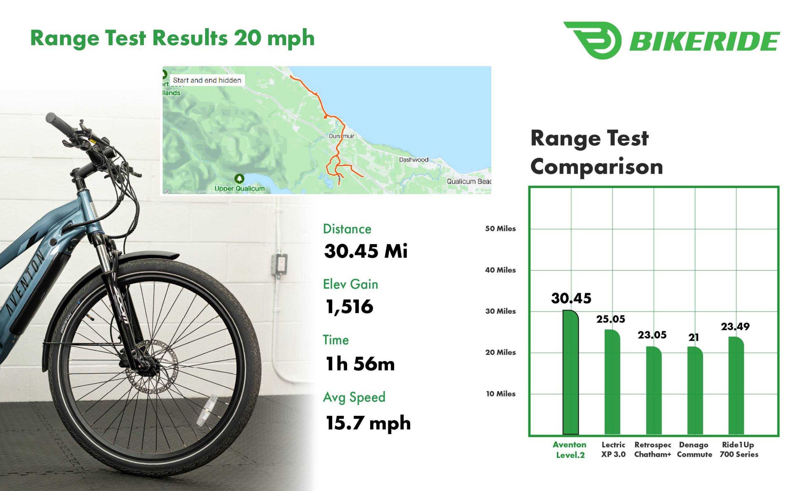

Battery
The Level.2 uses a standard 48V 14Ah battery, which returns solid range. We achieved 30 miles using maximum pedal assist and throttle.
Aventon stated max range is 60 miles at PAS level 1 on flat terrain, which we feel is accurate.
Aventon provides a 3A charger instead of the standard 2A found at this price. This results in a five-hour charge time.
Charging can be done on or off the bike. To remove the battery, you insert the key, turn it to release, and then remove the battery from the frame with the tab on the underside of the down tube.
The key needs to be installed for the battery to go back in. After installing and clicking the battery into place, you lock it to the frame with the key.

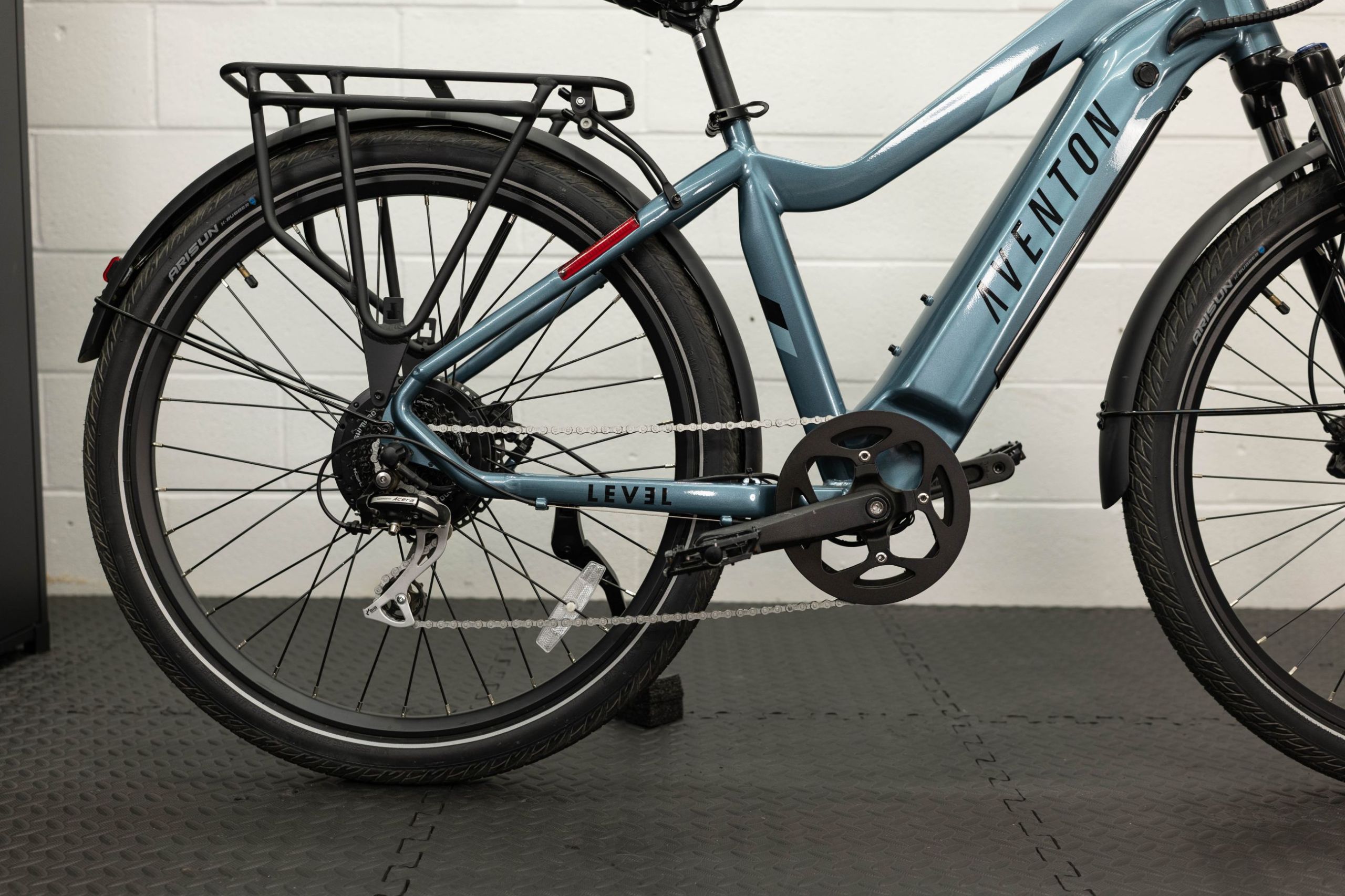

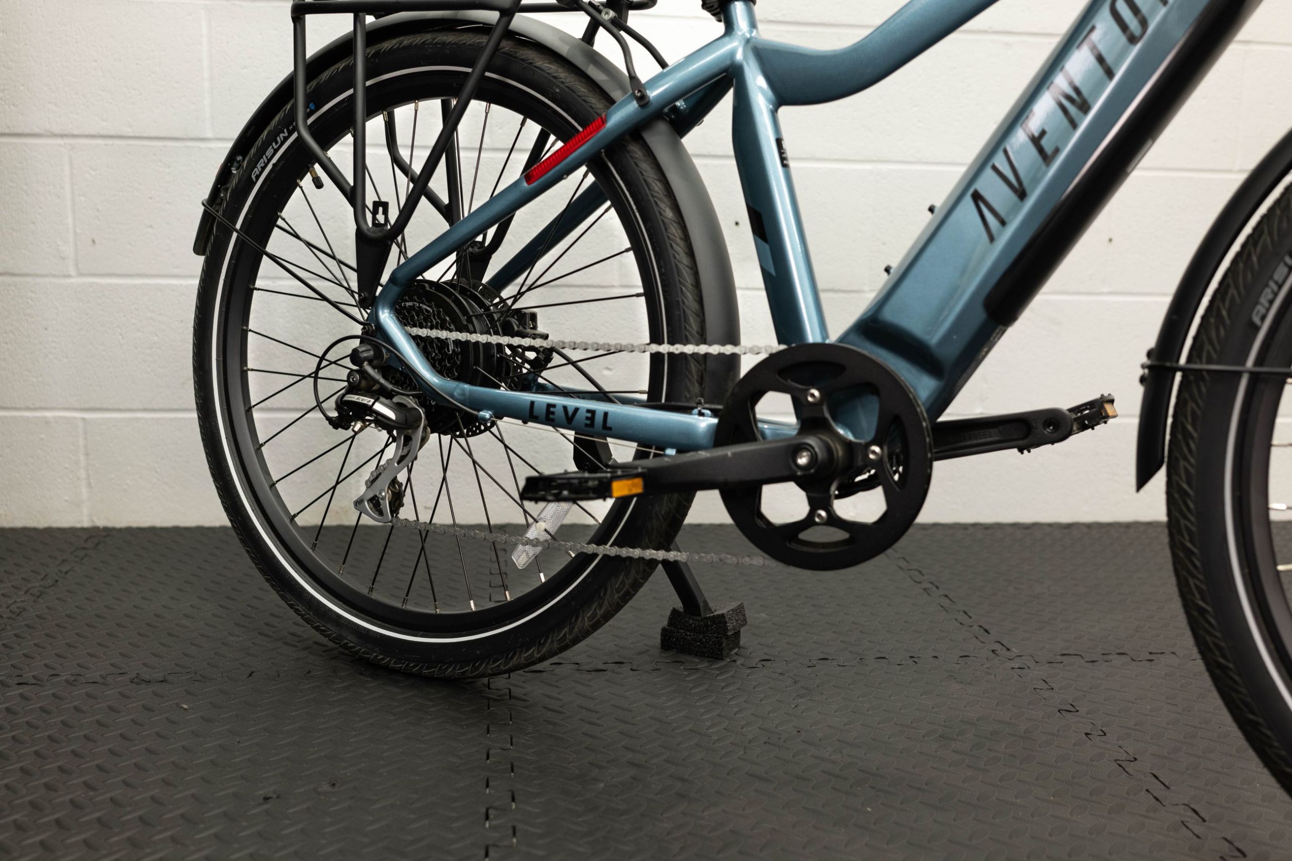

Drivetrain
It’s great to see an 8-speed Shimano Acera drivetrain on this bike, a welcome upgrade to the basic Shimano Tourney setup found on many competing models.
The 8-speed 12-32t rear cassette has enough range for climbing and riding at 20mph. The front chainring has a double-sided guard to keep your clothes clean.

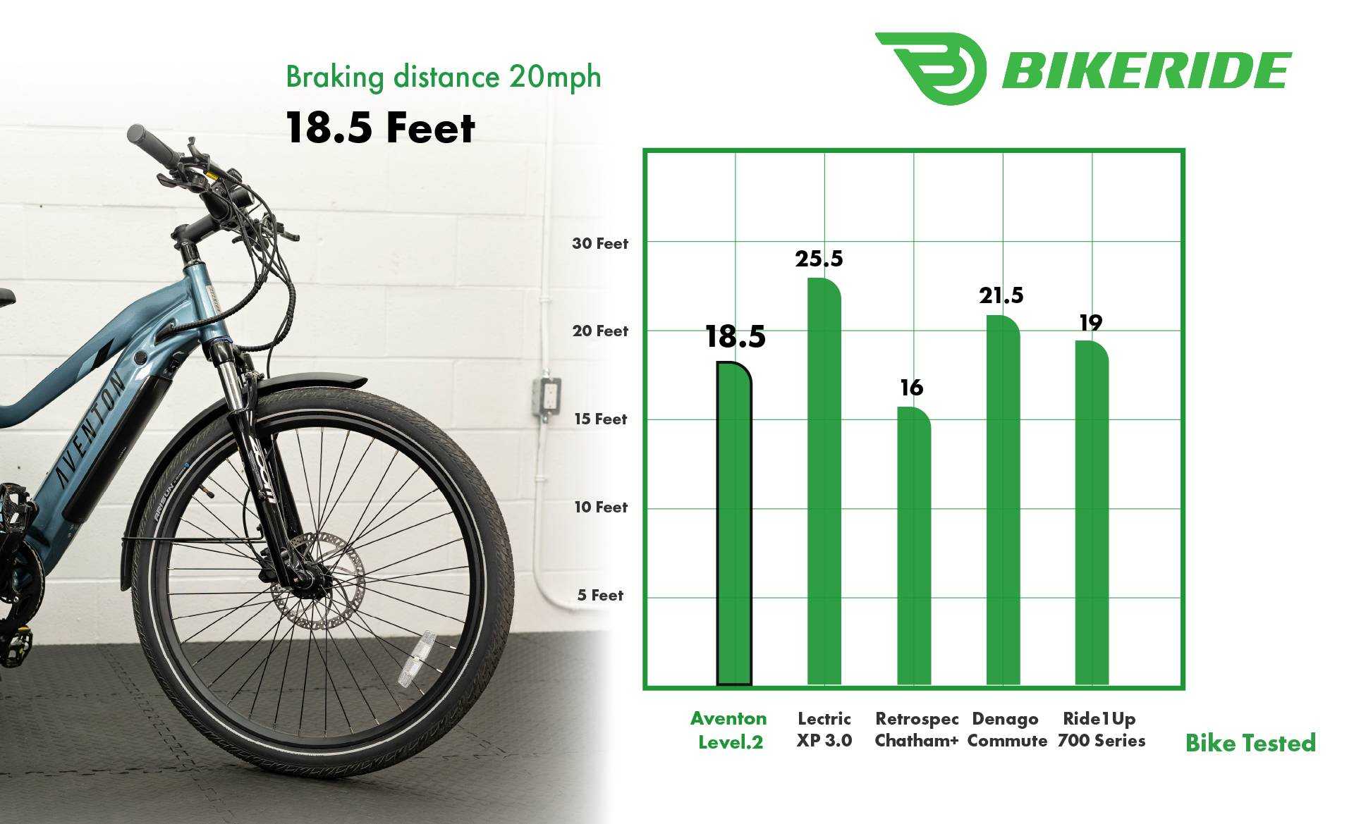

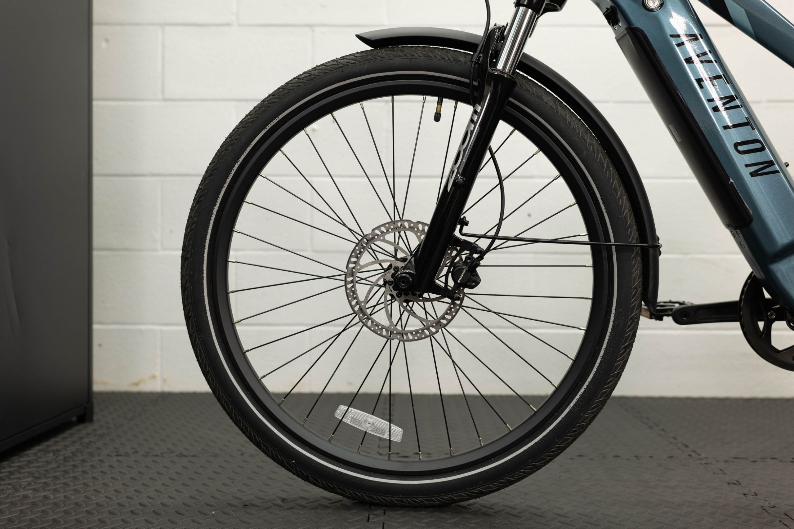

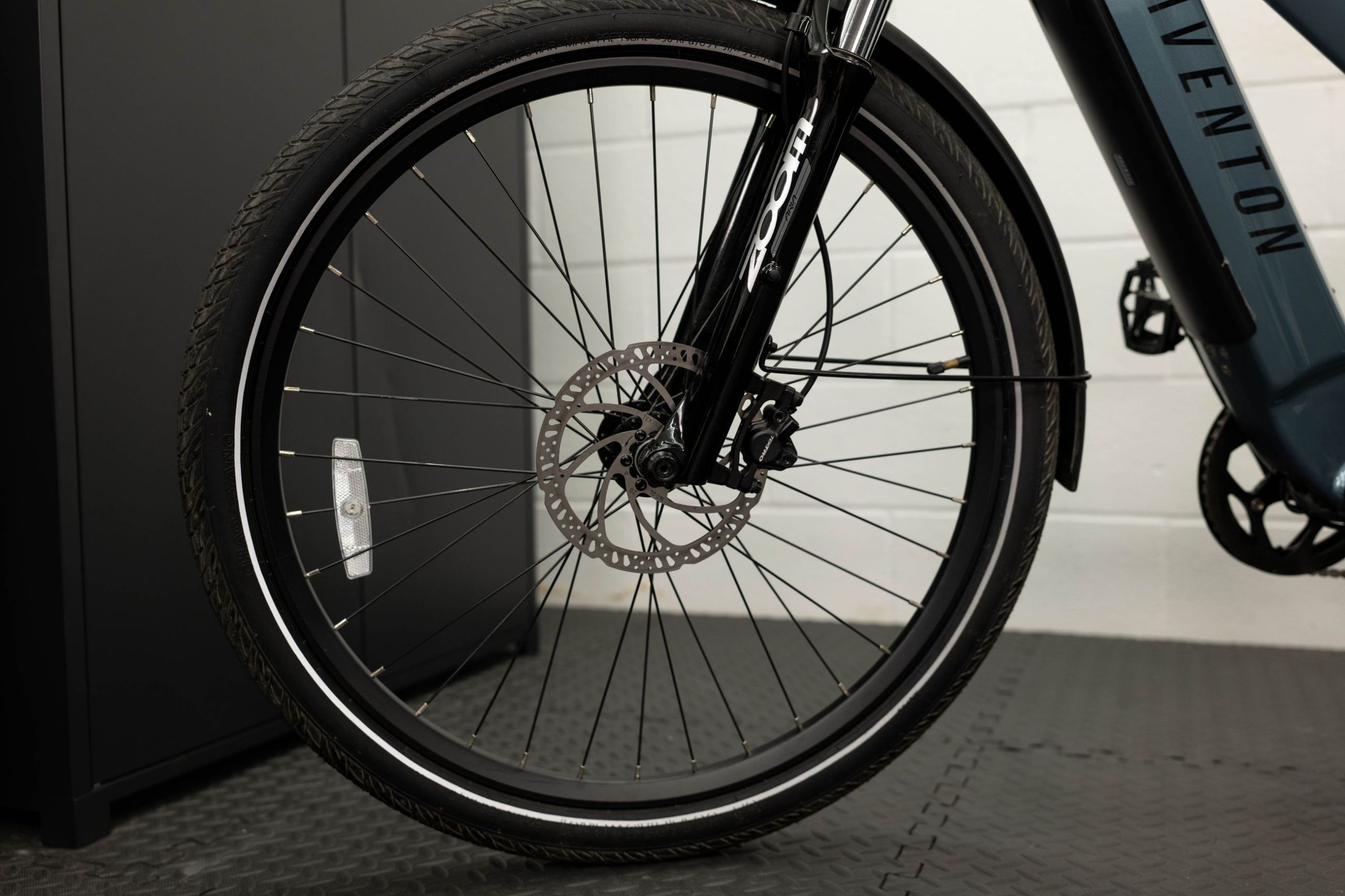

Tektro E-350HD hydraulic disc brakes offer above-average stopping power and inspire confidence when riding at high speeds.
Wheels, Tires
This bike runs 27.5″ x 2.1″ CHAOYANG hybrid tires with reflective sidewalls mounted on 27.5″ double-walled aluminum rims, an appropriate choice for this type of bike.
The tires offer balanced performance, traction, and comfort on pavement and light off-road paths.

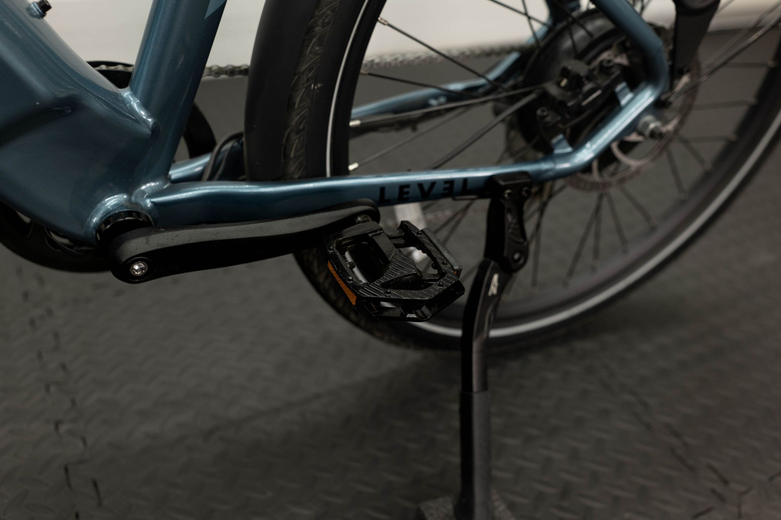

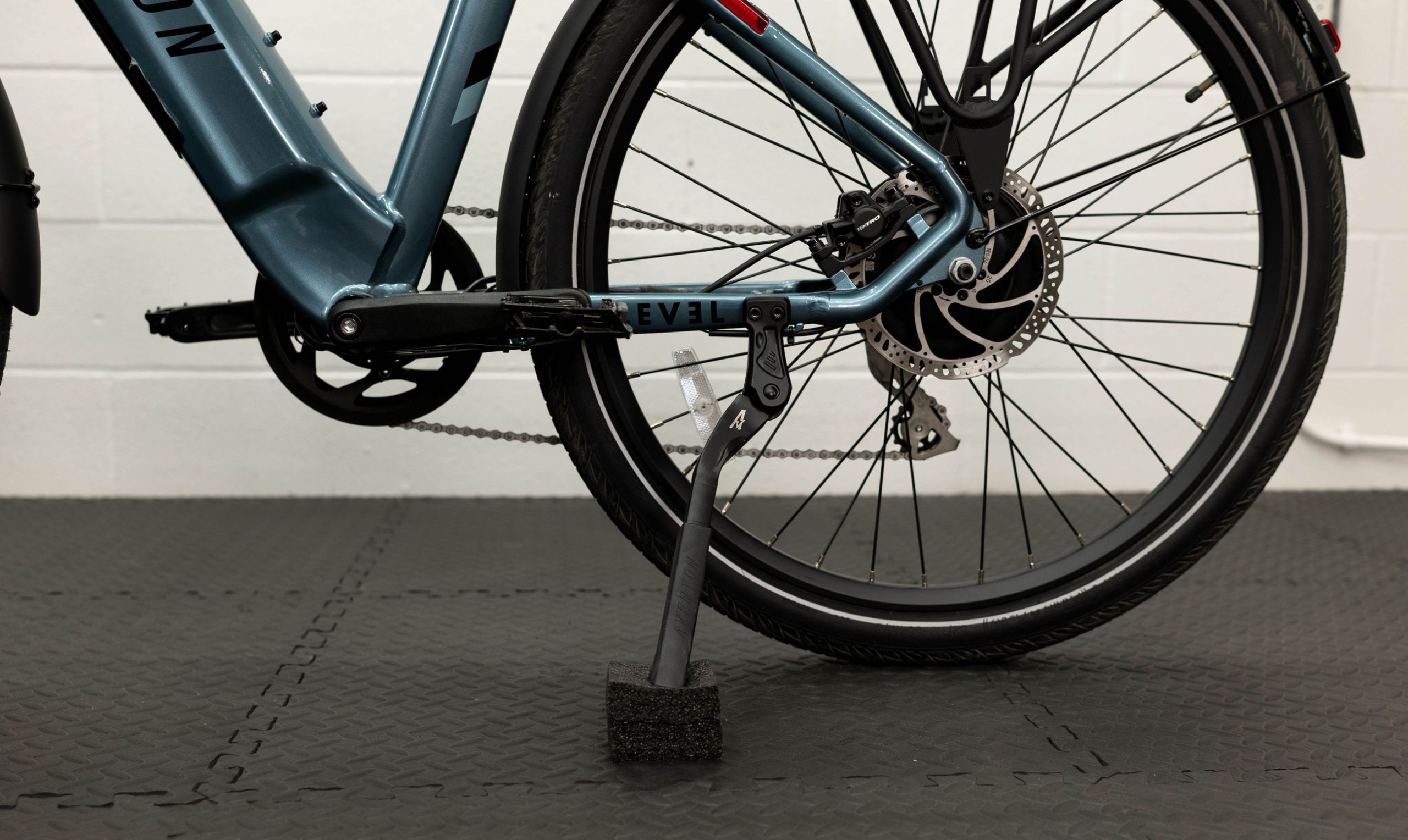

Kickstand
The Level.2 includes a standard single-sided kickstand with a wide base.

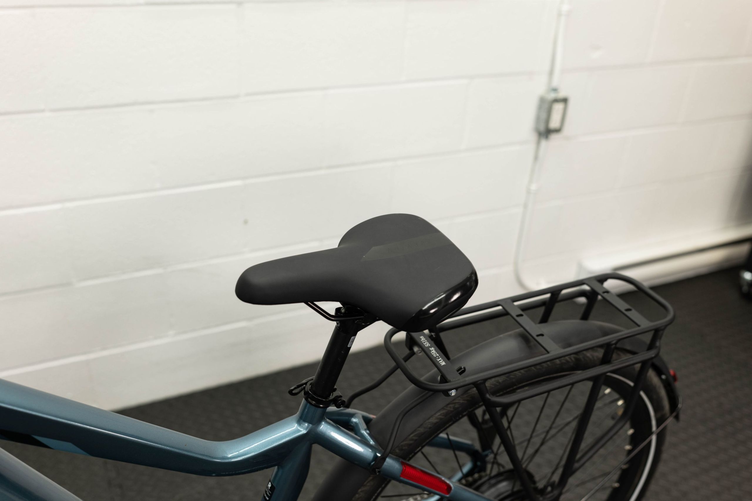

Saddle
The saddle is made by Velo specifically for Aventon. It is comfortable on short to mid-range rides, but being a more athletic-styled saddle, it doesn’t offer much cushioning. It became uncomfortable toward the end of the 30-mile range test.
Pedals
The Level.2 has platorm pedals from the brand Feimin. The small spikes provide reasonable traction and are fine to get you out riding.
