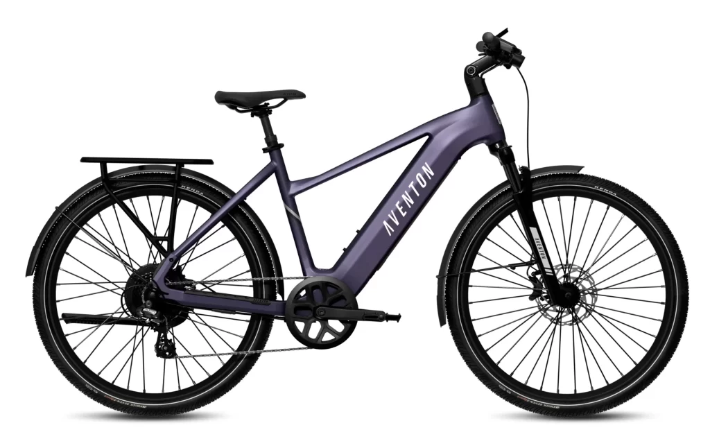

The Aventon Level 3 is a commuter e-bike with 27.5" wheels, a 500W motor, and a 720Wh battery. Upgrades over the previous version include theft prevention features, a wheel lock, a larger battery, a suspension seatpost, and an adjustable stem. Testers praise the smooth, responsive power, comfortable ride, brakes, and excellent range. The handy commuter accessories and security features add further practicality to this bike. Overall, experts feel Aventon's Level 3 offers impressive value and is a "serious competitor" in the e-commuter segment.

The Level 3 is the latest version of Aventon’s commuter e-bike. It’s offered as a step-through or step-over in regular and large sizes.
Aventon says the size large step-over we’re testing fits riders from 5’10” to 6’4”, and the regular fits 5’3” to 5’10”. For the step-through, it’s 4’11” to 5’7” for the regular and 5’7” to 6’1” for the large. Unusually, Aventon provides inseam ranges on its website to help buyers find the right fit.
All frames come with an 80mm hydraulic coil fork and 50mm suspension seatpost.
The Level 3 ships as a Class 2 e-bike, with a thumb throttle and three-level pedal assist with selectable torque and cadence sensors. The bike’s speed limits can be adjusted between 12 and 28mph for pedal assist, and 12 and 20mph for the throttle. The throttle can be removed for full Class 1 compliance.
The 36V electrical system includes a 500W, 60Nm rear hub motor and 19.88Ah (716Wh) battery pack. The battery is housed in the down tube and unlocks via the display or app.
Aventon’s Pace 4, Level 3, Aventure 3, and Aventure M all use the same battery and charger, so they can be swapped between bikes for those who own more than one.
The Level 3 has a five-button control pad and Aventon’s BC280 display. Aventon explains the controls and functions clearly in the owner’s manual.
The bike is certified for UL 2849 compliance, and the battery for UL 2271. The whole bike’s water resistance rating is IPX5, but the components are rated IPX6. These certifications provide peace of mind that the bike will be safe and reliable, even in the rain.
The Level 3 has 27.5” aluminum rims, with a 15x100mm front thru-axle and a nutted rear axle. The 2.2” Kenda Kwick Seven.5 Sport tires have puncture resistance and reflective sidewalls.
The drivetrain is Shimano Altus, with an underslung trigger shifter, 48t chainring, and 8-speed, 12-32t cassette.
Our test bike has Tektro HD-E3520 brakes with 180mm rotors. Older test bikes were shipped to reviewers with Magura brakes. Since then, Aventon swapped to Tektro brakes to give the bike motor cut-off and brake light activation.
The angle of the stem can be adjusted to make the most of the 680mm riser handlebar and nice rubber lock-on grips. Composite platform pedals and an Aventon-branded padded saddle round out the touchpoints.
The Level 3 comes with full-coverage metal fenders, a MIK-compatible rear rack, and integrated lighting with a headlight, taillight, and turn signals. Finally, there’s a pair of bottle cage mounting points on the down tube.
