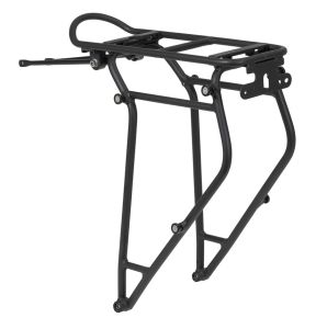

We have read all expert and user reviews on the ORTLIEB Rack Three. In summary, this is what cyclists think. Published Oct 15, 2025 by Rachel Rushing.
5 reasons to buy
  • Experts and most buyers say the Rack Three feels solid, and they express confidence in its durability.
  • Buyers appreciate the simple installation.
  • The Rack Three accepts a MIK adapter.
  • The load capacity is 66.1lb, which is high considering it isn’t axle-mounted.
  • OTRLIEB offers a five-year warranty on the Rack Three.
  • The Rack Three only comes with screws for M5 eyelets. Screws for M6 eyelets must be purchased separately.
  • ORTLIEB provides no product dimensions or information about compatibility.
  • Disc brake compatibility varies, and there’s no way to determine it before purchase, and several buyers find the mounting stays too short.
  • The upper pannier mounting tube cracks after seven months of use for one owner, but the cause is unknown.
  • Three buyers report that locking head mount screws arrive damaged, making them difficult to remove.
The ORTLIEB Rack Three is a cargo rack with a generous 66lb load capacity. It fits frames with M5 eyelets as sold. Frames with M6 eyelets require the purchase of appropriate screws. Installation is easy, and the top accepts a MIK adapter. Unfortunately, the short mounting stays may not fit some frames, and disc brake compatibility varies. Several receive faulty screws, and one reports a cracked tube after seven months. Overall, the fitting issues cause some experts and owners to look elsewhere, but others recognize how handy the ORTLIEB Rack Three is when using the brand’s QL panniers.
