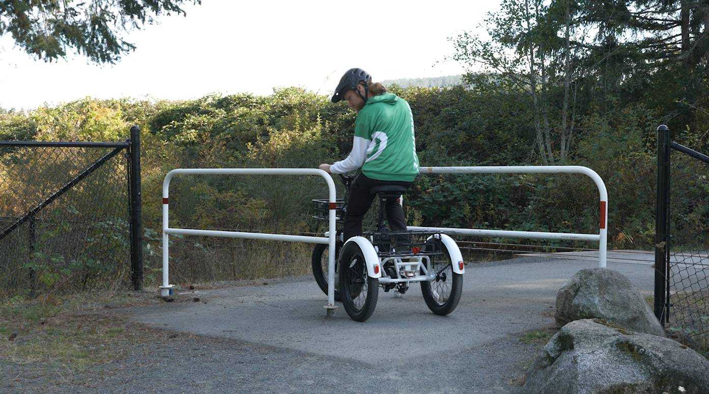

  • Testers appreciate the tight turning radius and low-speed agility.

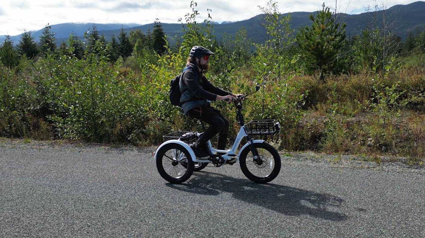

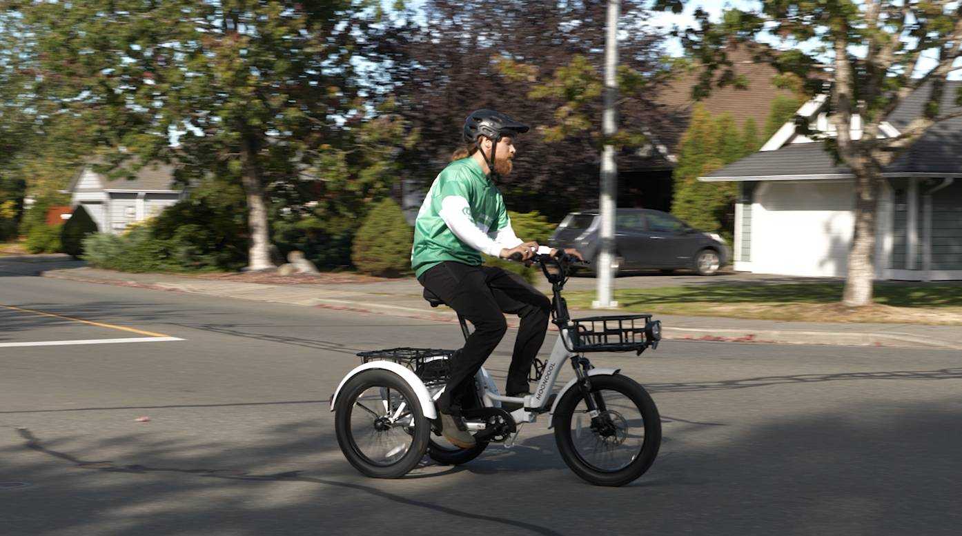

The top speed is 16mph, which is sufficient for e-trikes. The TK1 Folding is stable at low speeds, but riding over bumpy pavement can cause instability, especially for taller riders.
Stability
Again, the TK1 is stable when riding at low speeds over smooth pavement. It’s also perfectly balanced when parked, making it easy to mount or load with cargo. This stability makes trikes like the TK1 Folding excellent e-mobility vehicles for balanced-impaired riders.

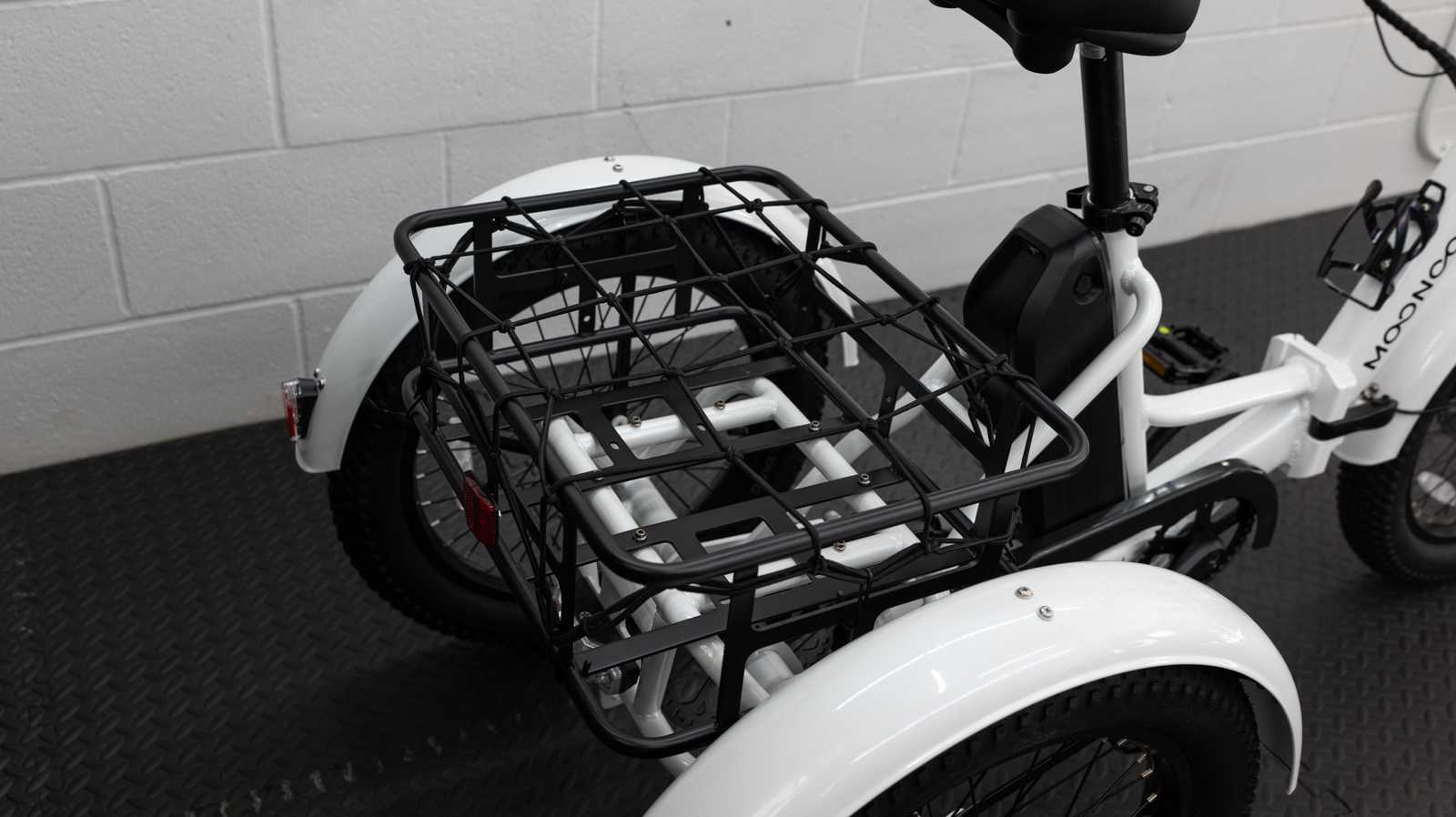

Cargo Space
The TK1 comes with cargo baskets in the front and rear. Combined, they provide lots of space for carrying items of various sizes.
The trike is easy to load, thanks to the third wheel, the parking brake, and the low rear platform. The bike comes with a net to keep larger items in place while riding.

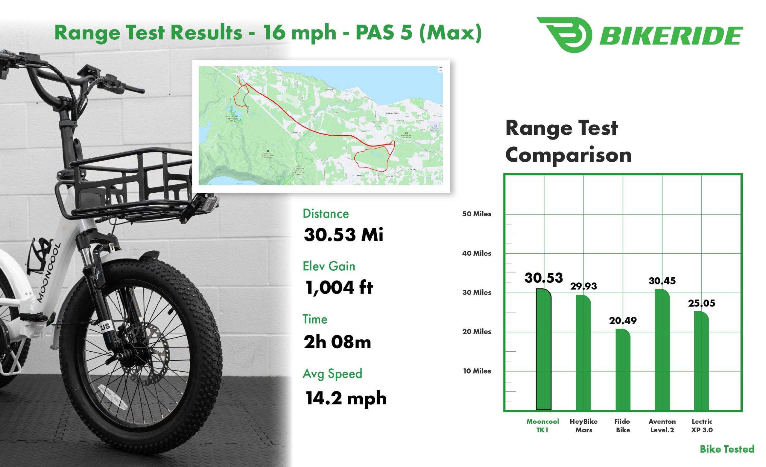

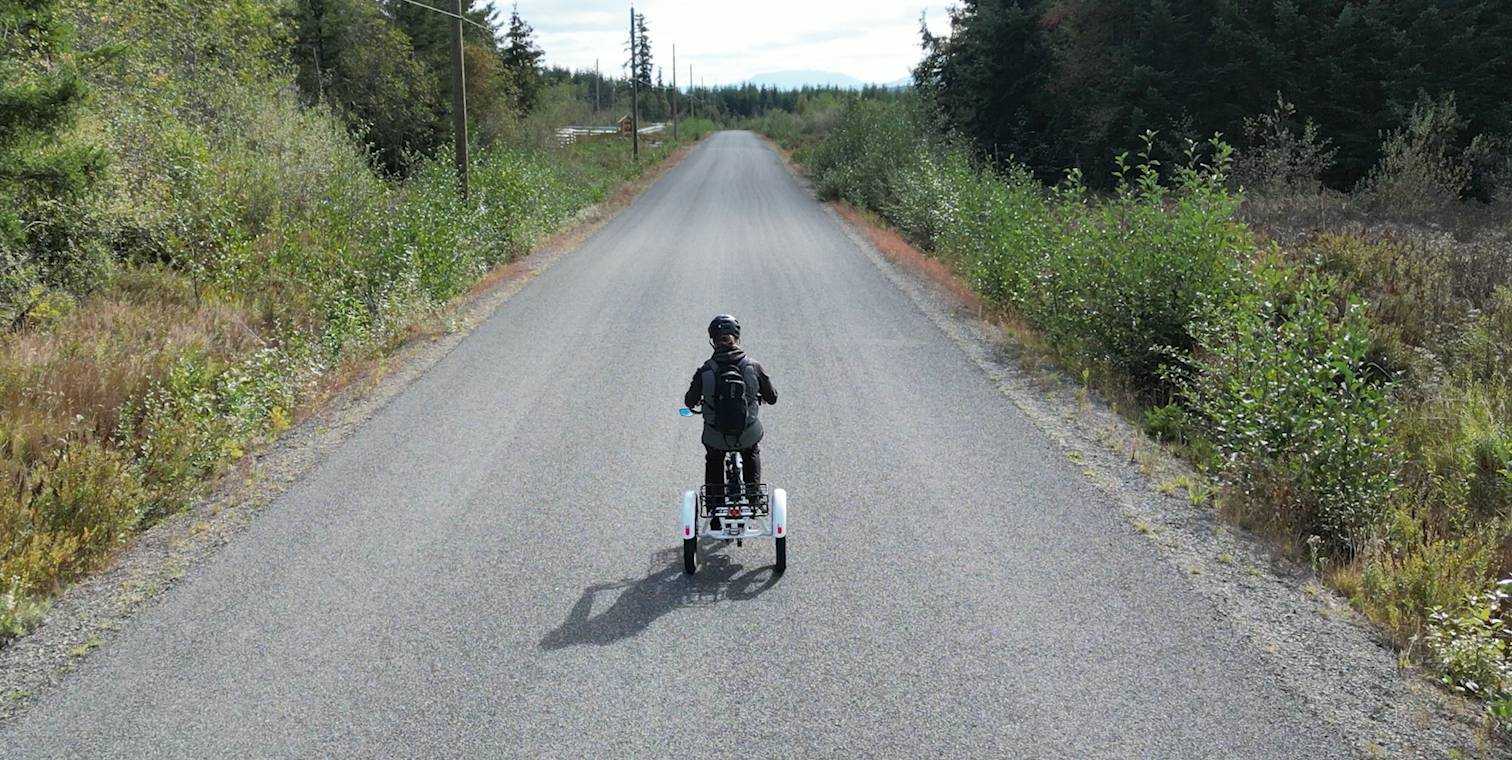

Throttle-Only Range
The TK1 Folding has a 14.5Ah battery that returns surprisingly good throttle-only range. In testing, we covered over 30 miles with minimal pedaling.

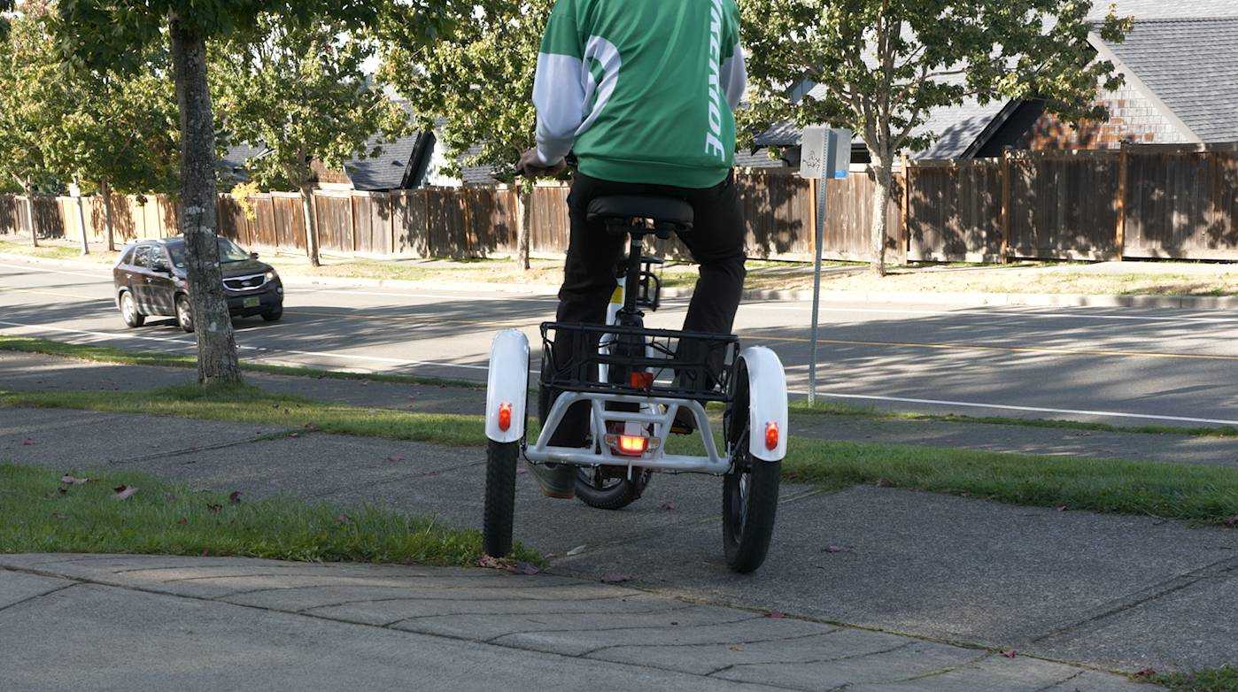

Poor Ride Over Bumpy Terrain
Overall, I didn’t enjoy how the TK1 rides. While it’s stable on smooth pavement, the ride quality is poor over bumpier surfaces, which causes the trike to jerk side to side, making you feel off-balance. Given this characteristic, riders should take care when riding over broken pavement and avoid going off-road.
I also found that brake pads would rub the rear brake rotor when my weight was leaning to one side, for example, while turning, resulting in a squeaking noise.

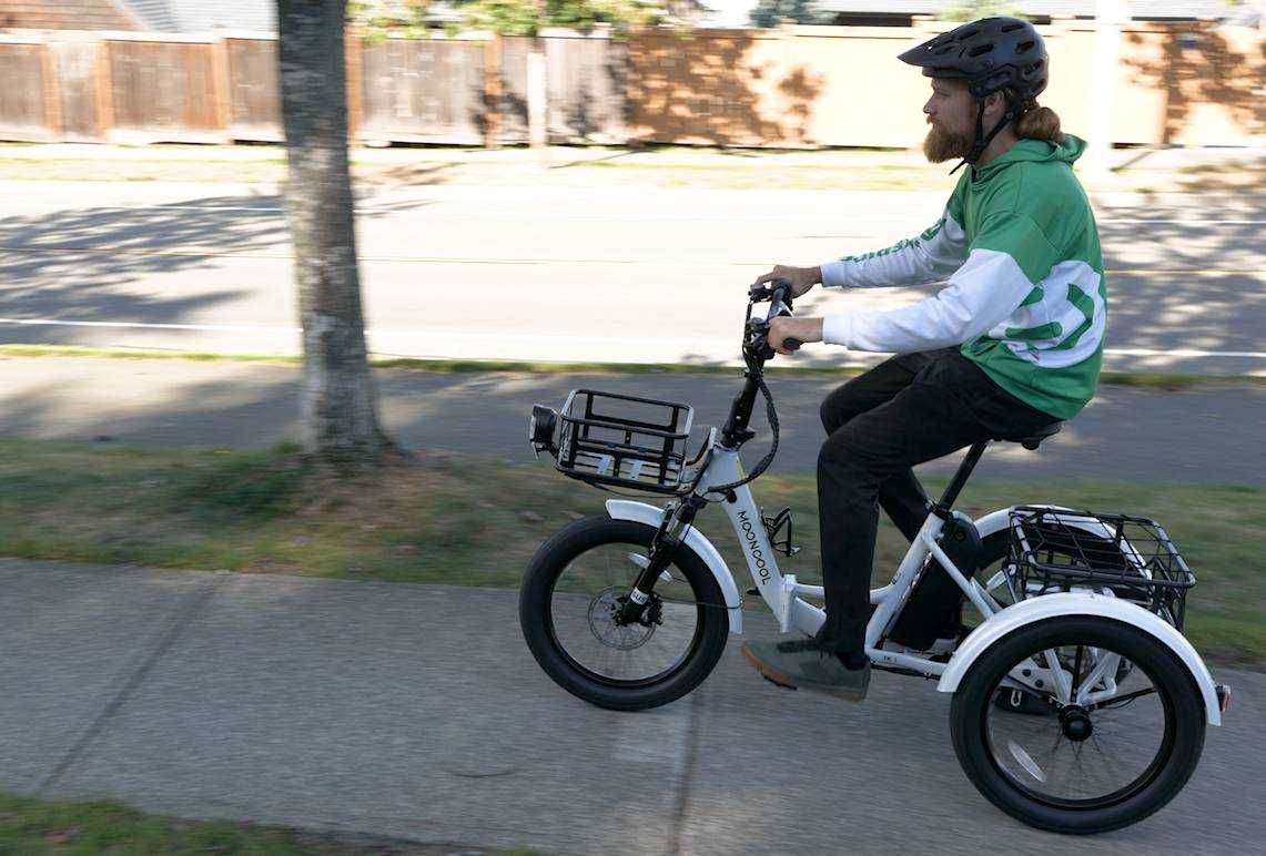

Ghost Pedaling
The TK1 Folding’s has a single-speed drivetrain with a small chainring, so pedal cadence becomes uncomfortably fast at speeds over 10mph. A slightly larger chainring would allow pedaling closer to the 16mph top speed.

The Mooncool TK1 Trike is easy to balance when riding at low speeds over smooth pavement, even while loaded with cargo. This will appeal to those who struggle to balance on two wheels.
The TK1’s large cargo area and stable platform make it a solid utility vehicle. It’s easy to load and easy to mount with cargo onboard. This 30-mile throttle-only range is also a noteworthy feature.

Range Tested: 30.53mi – 1,004 ft. – 14.2mph avg.

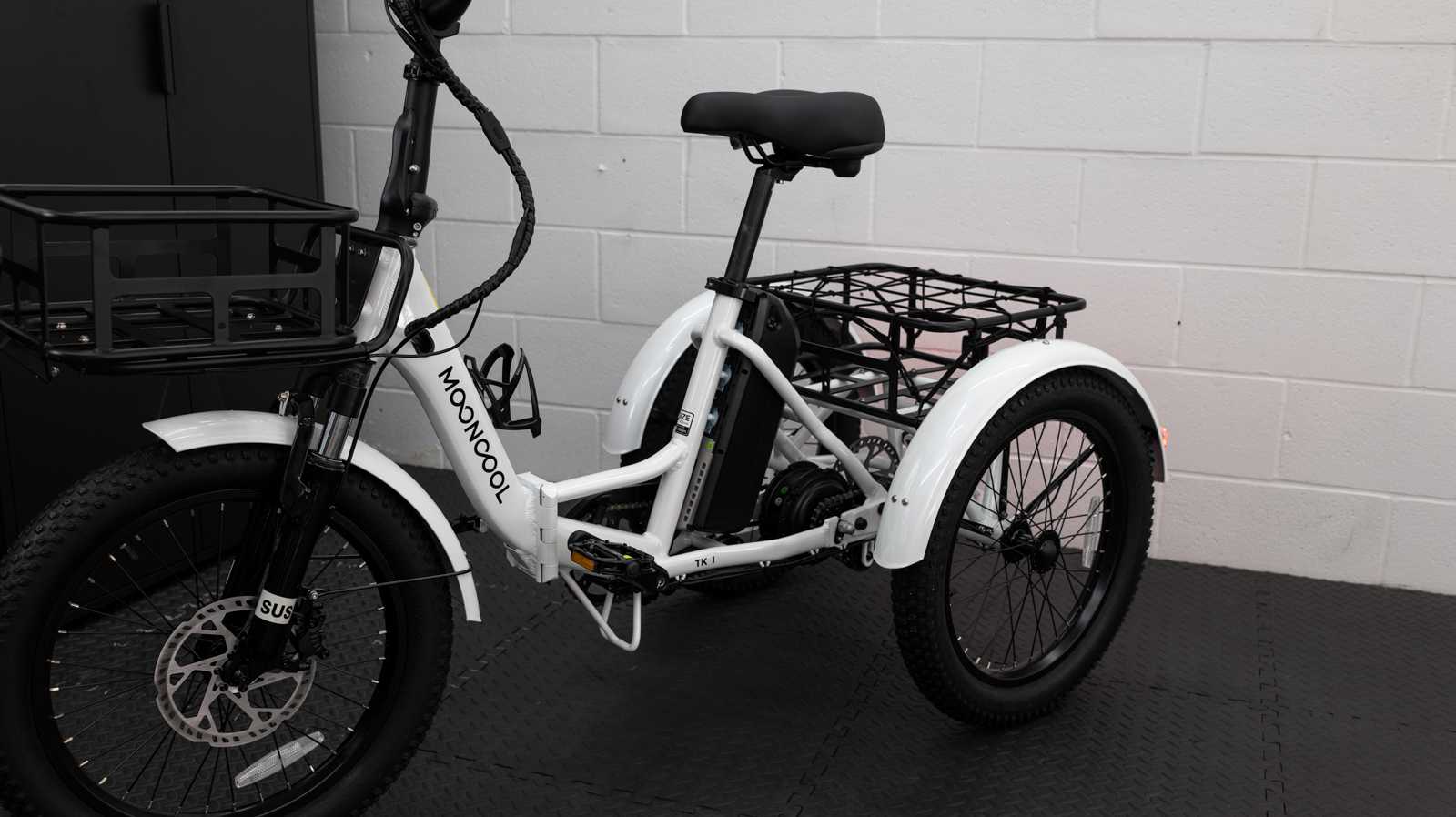

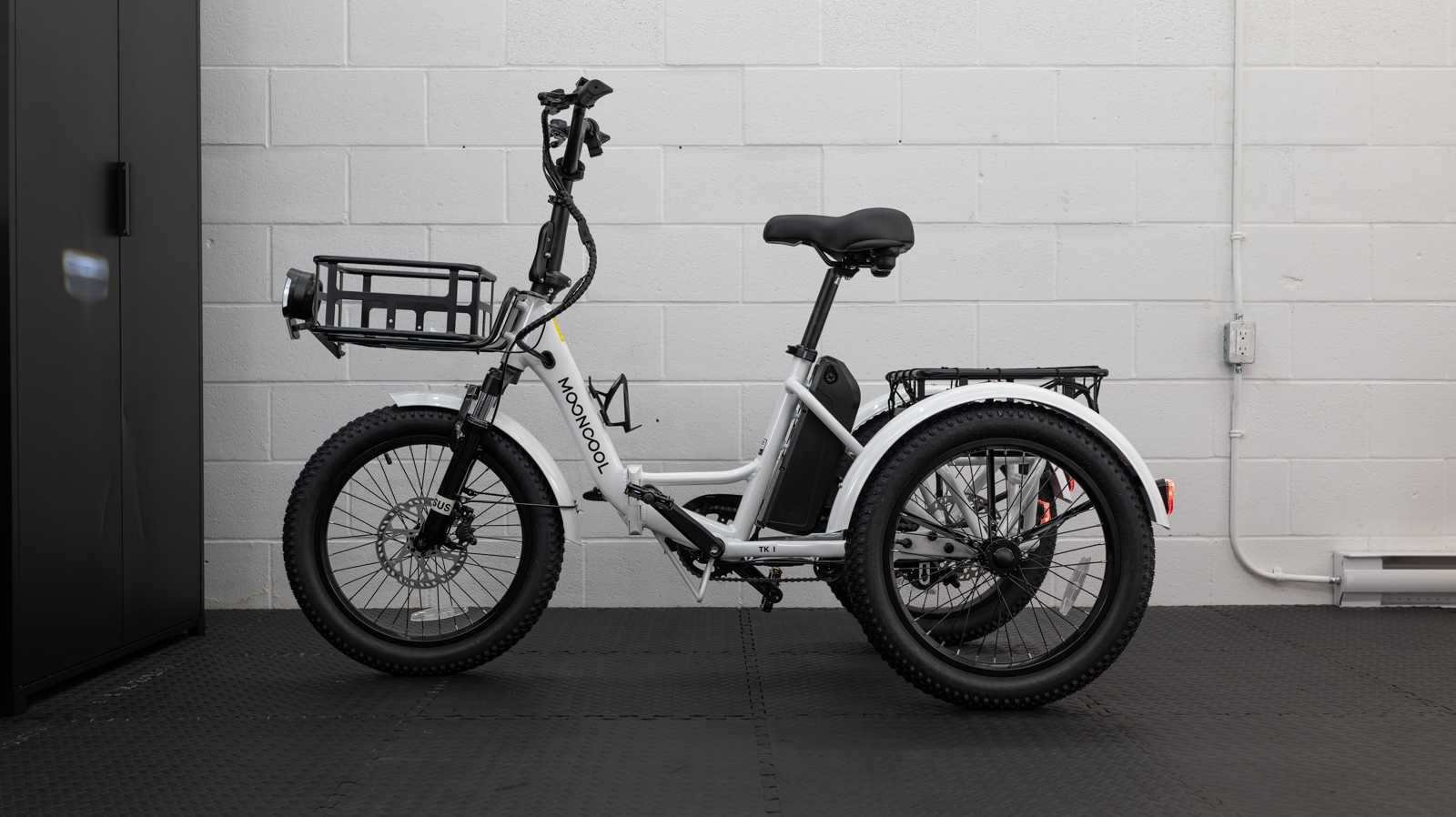

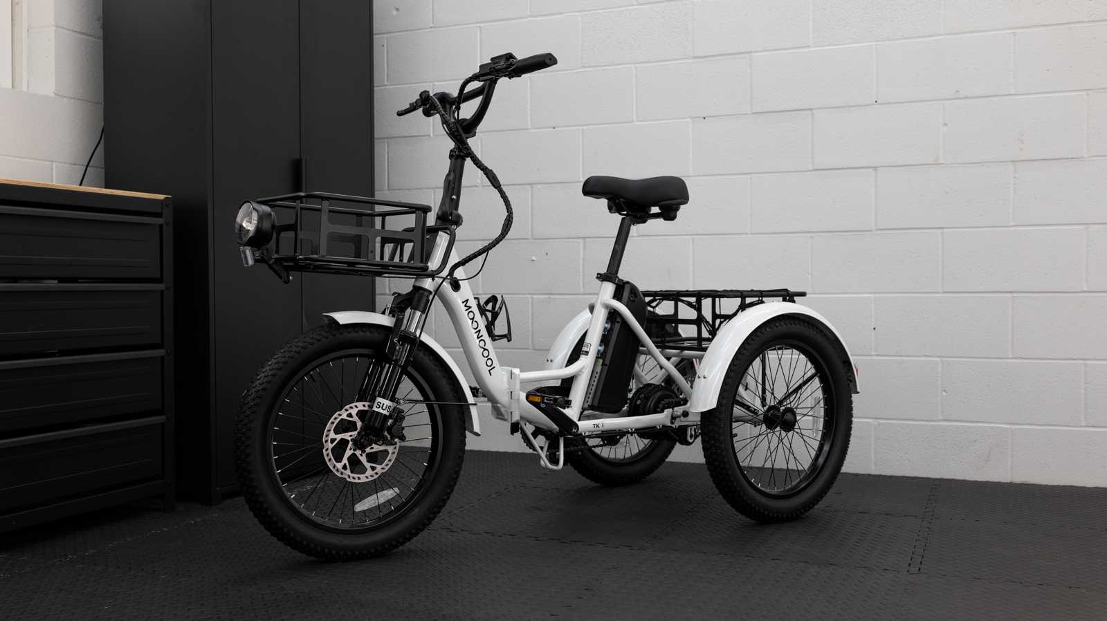

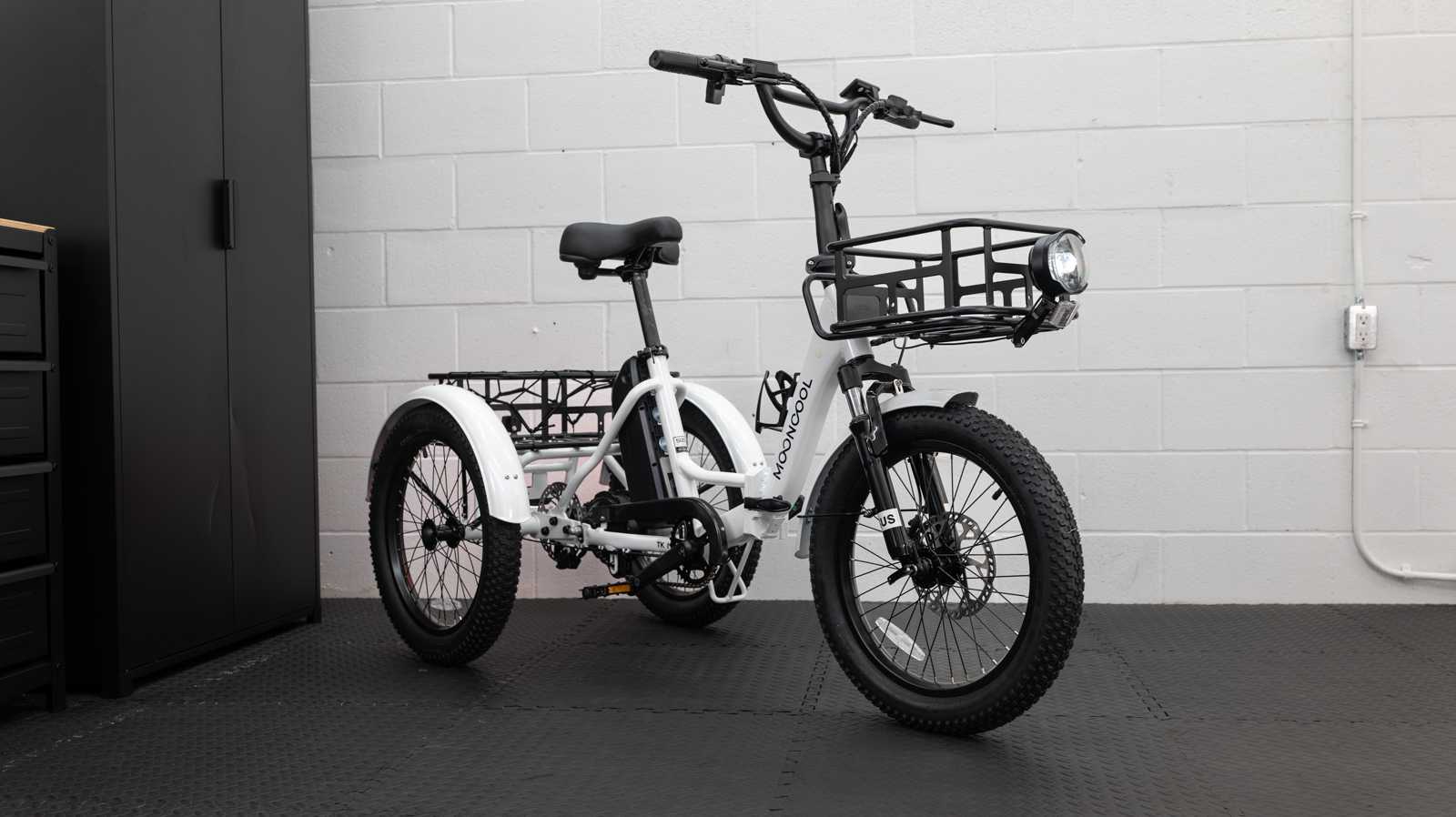

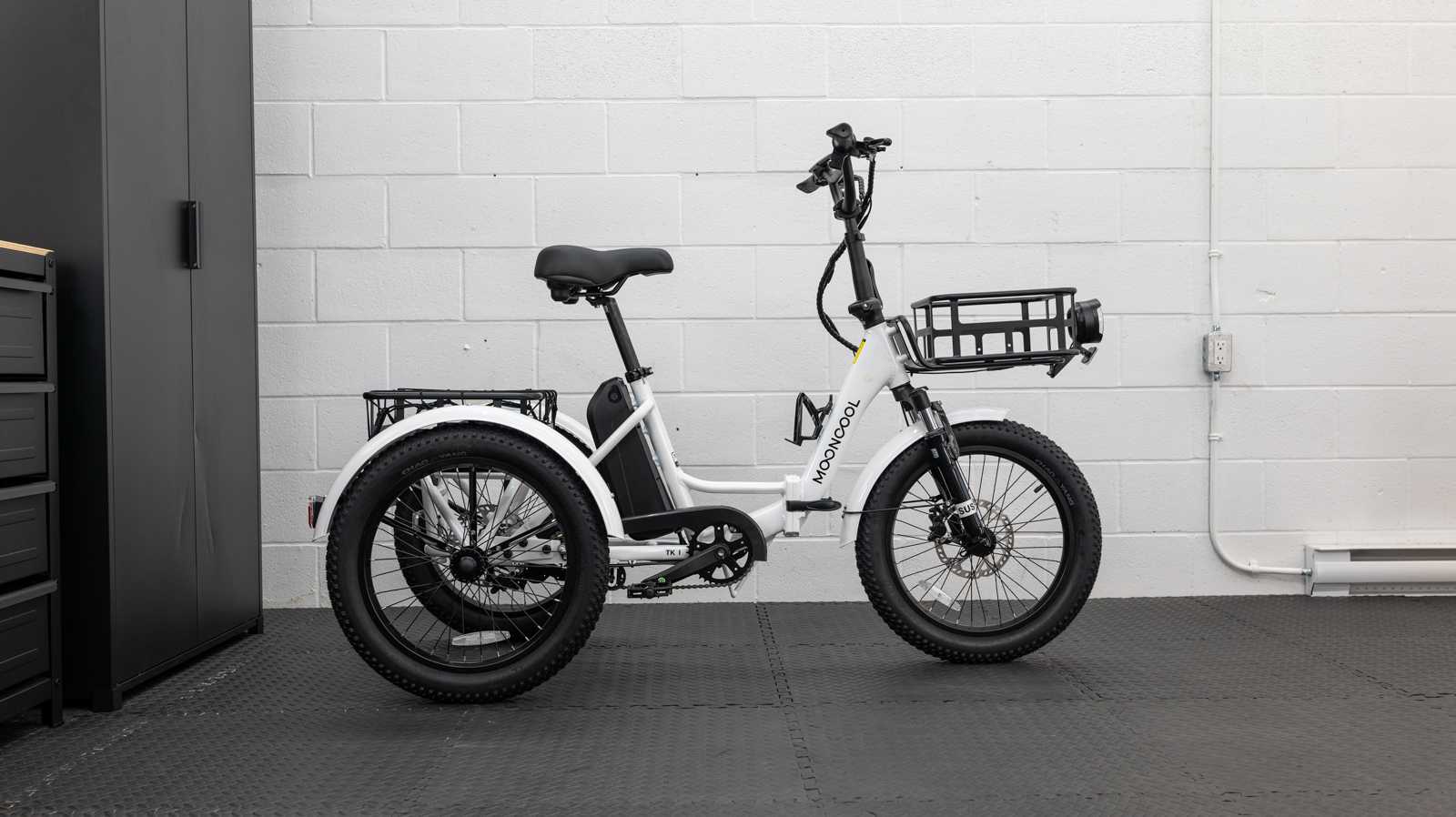

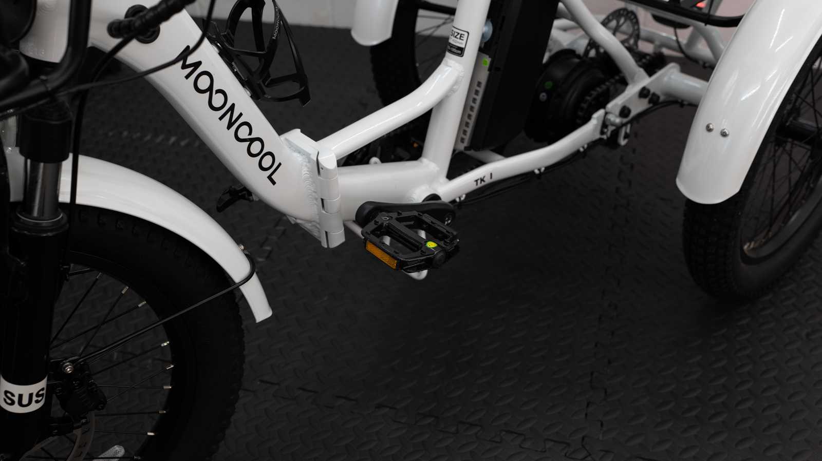

Frame and Geometry
The TK1 has a folding aluminum frame with a deep, wide step-through shape. The handlebar height is adjustable, allowing riders to fine-tune fit. Mooncool lists a height range of 5′ to 6’3″.
The trike has front and rear baskets that are well integrated into the frame. The rear basket is low to the ground, so loading it is easier. The payload capacity (rider and cargo) is 350lb, which seems low given many e-bikes can support up to 400lb.
Seat Tube: 17“ (432mm)
Reach: 13.5” (343mm)
Stack: 19” (483mm)
Stand Over Height: 16” (406mm)
Virtual Top Tube Length: 30” (762mm)
Min Saddle Height: 30.3” (770mm)
Max Saddle Height: 39” (991mm)
Wheelbase: 36” (914mm)
Total Length: 66” (1676mm)
Total Width: 29” (737mm)
Recommended Rider Height: 5’ – 6’3”
Folded Dimensions: Length – 39.4″ (1001mm) | Width – 30.3″ (770mm) | Height – 29.5″ (749mm)

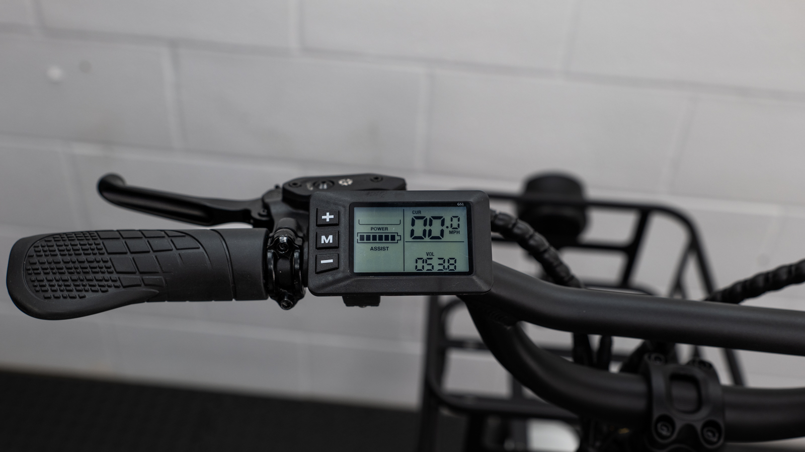

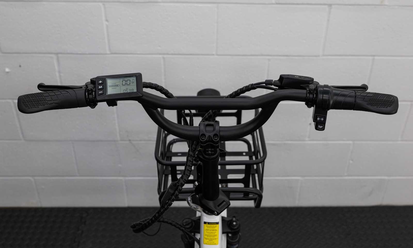

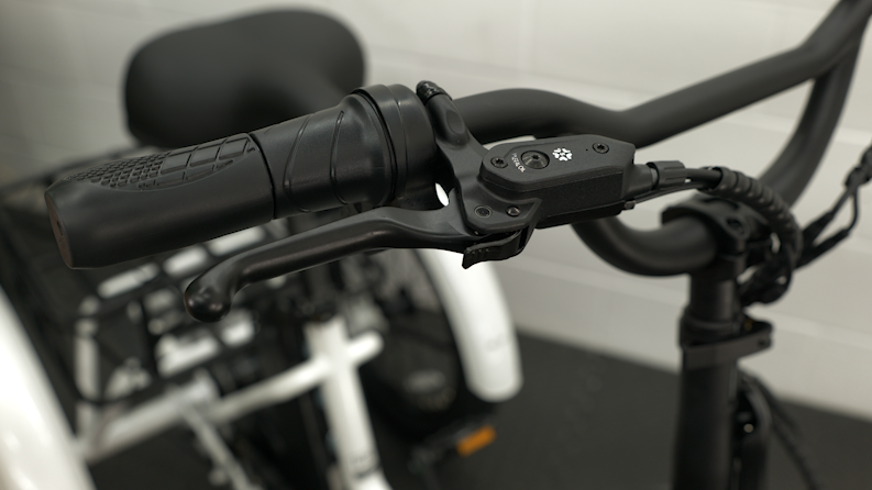

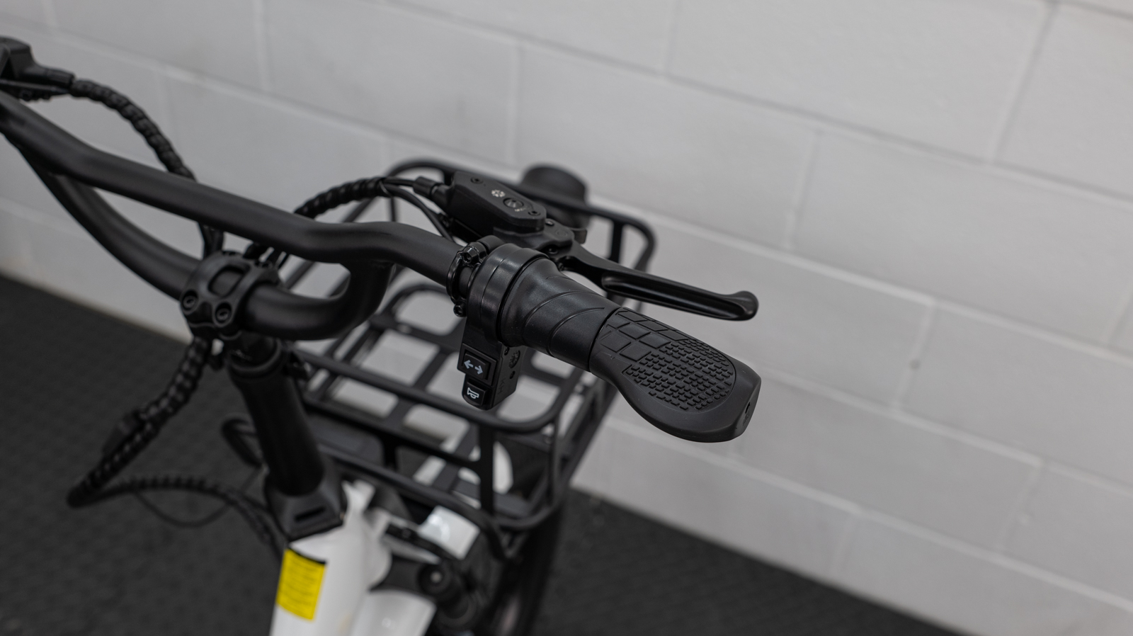

Display and Control
The TK1 Folding has a 2.5″ LCD display with a three-button control pad. On the right handlebar, there are buttons for the turn signals and horn.
The display shows current power output, current speed, battery level, assist level, and an odometer. Pushing the Mode button cycles through trip odometer, voltage, output current, and a timer.
The battery level is shown as a six-bar graphic. The battery level indicator seemed reliable throughout testing.

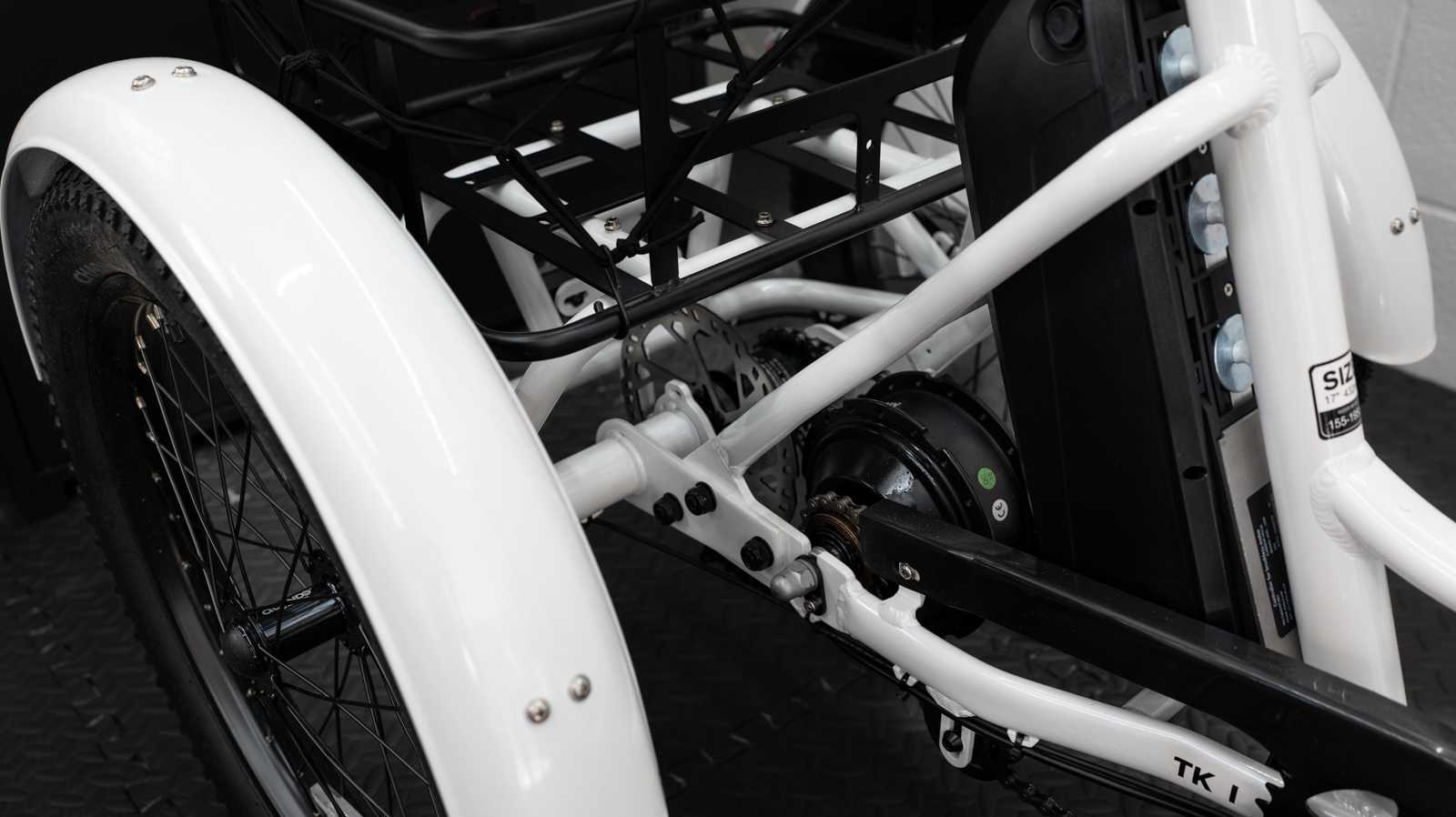

Motor

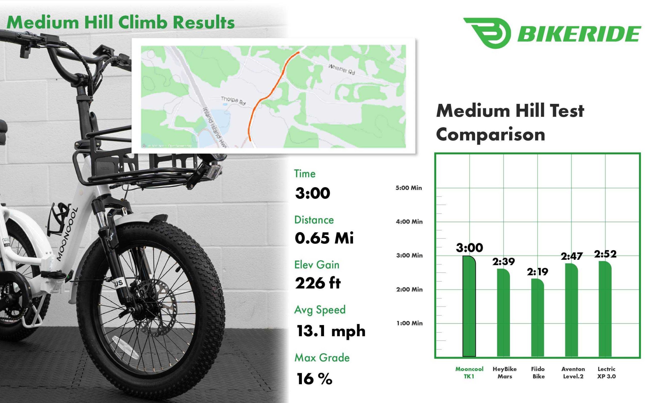

The TK1’s 500W motor has a peak torque output of 55Nm. The motor has enough power to push the trike along at 15.5mph. However, the modest torque, the trike’s high weight, and the single-speed drivetrain make it a slow climber, and acceleration can be jerky despite the low torque rating.

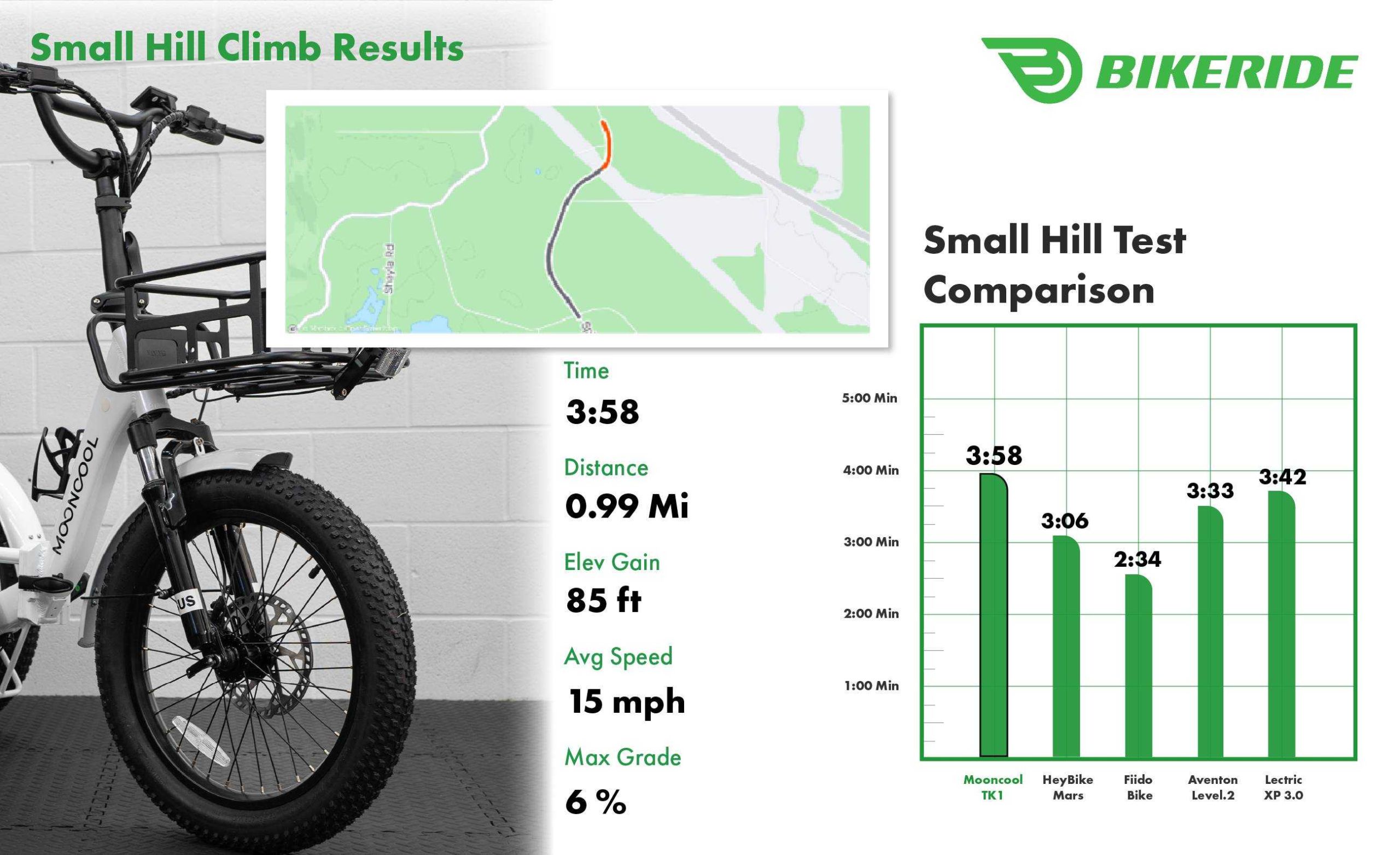

The motor was powerful enough to overcome both of our hill climb tests, though at a slow pace. The TK1 is best kept to relatively flat routes but can handle a hill when necessary.

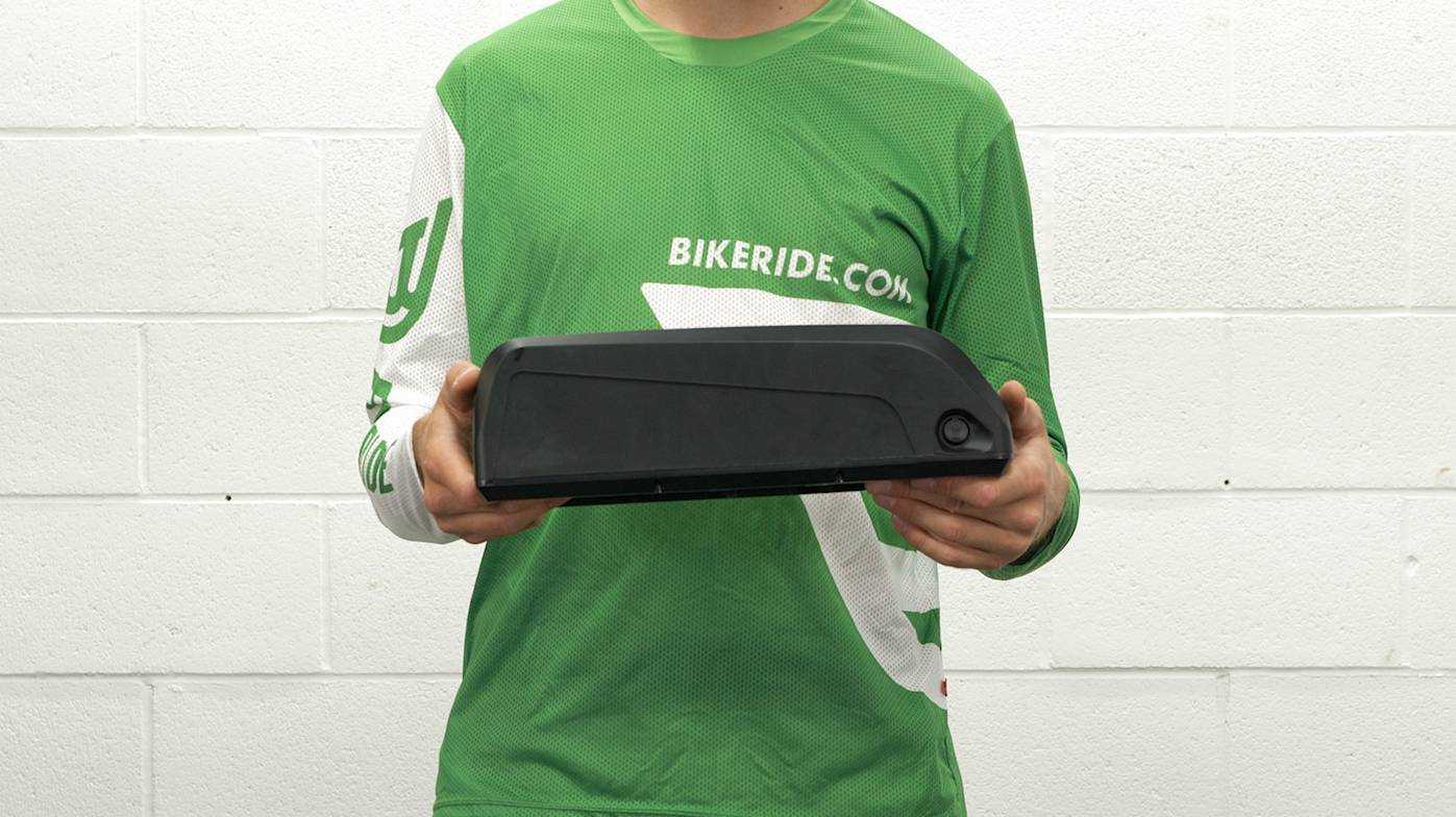

Battery and Charger
The TK1 Folding has a 48V 14.5Ah (696Wh) battery, and the electronics are UL-certified (UL 2849 and 2272). I was impressed by the 30.5-mile range with 1,000 feet of elevation gain and an average speed of 14.2mph.
The charge tapers reliably, making it easy to estimate remaining range. However, the TK1 didn’t offer a low battery warning. After reaching a single bar, the motor reduces power gradually until it stops completely.

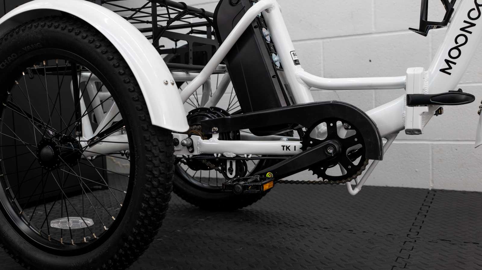

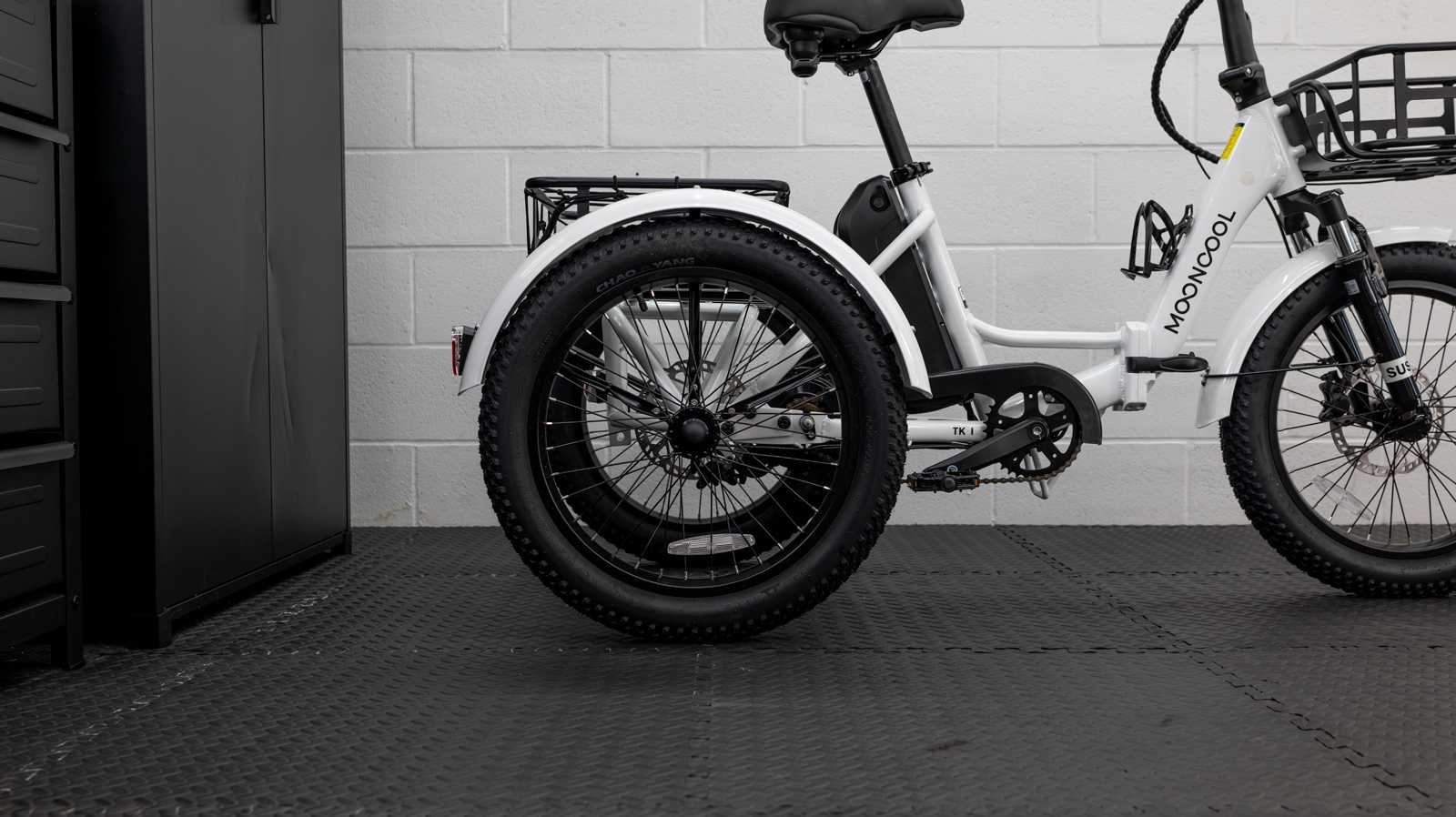

Drivetrain
The TK1 Folding has a single-speed drivetrain with a 36t chainring and 18t rear cog. This limited gearing means pedaling at speeds over 10mph is uncomfortable.
Overall, the pedaling experience on this trike wasn’t enjoyable. The one highlight is the responsive pedal assist thanks to the 24-magnet cadence sensor.

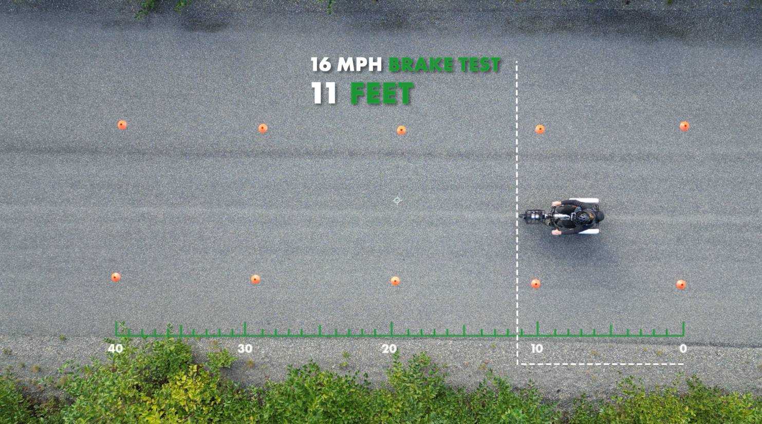

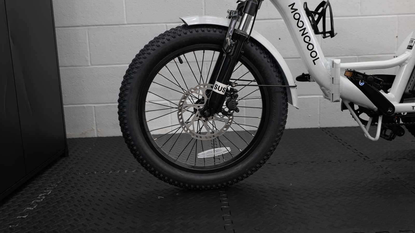

The TK1 has generic dual-piston hydraulic brakes from the Chinese brand 5 Star. Both the front and rear lever can be locked to stop the trike from moving when parked.
The brakes performed reasonably in testing. Our brake test is usually done at 20mph, so the shorter-than-average stopping distance is partially due to the test being done at the bike’s max speed of 16mph.
Wheels, Tires
The Mooncool TK1 has basic 20″ x 3″ Chaoyang tires with light tread. These offer good traction, but they don’t have puncture protection.
The TK1 has a front basket mounted to the head tube and a rear rack with another basket. This gives it considerable cargo capacity, and the low rear platform is easy to load.

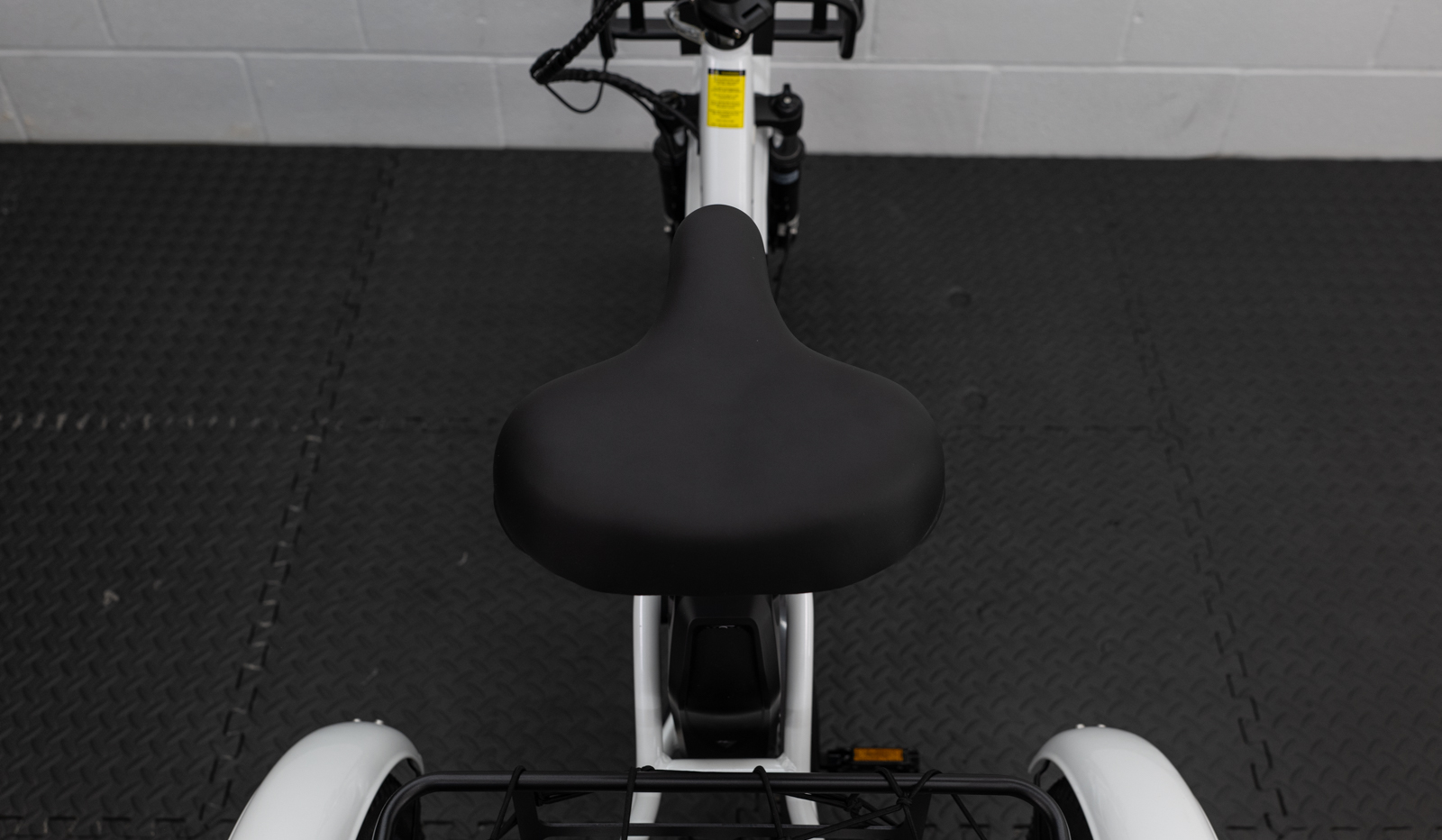

Touchpoints
The plastic grips are not the most comfortable, and swapping them may be challenging because the right side grip is integrated with the half-twist throttle.
The padded saddle is pleasant and was relatively comfortable throughout the 30-mile range test. Finally, the TK1 Folding has basic aluminum platform pedals.
