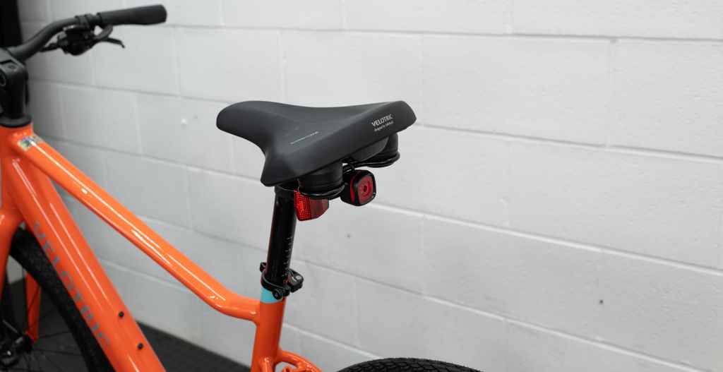

  • Our 6'0" tester needed the saddle at its maximum
  • No fenders, rack, or standard rack mounts

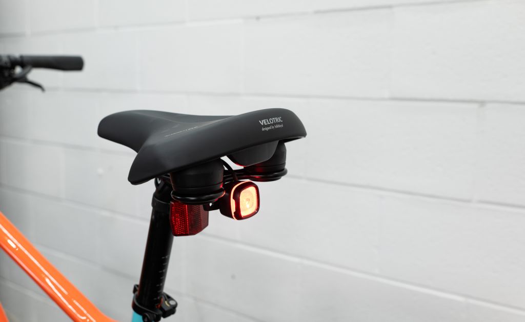

  • No brake light or battery percentage on the display

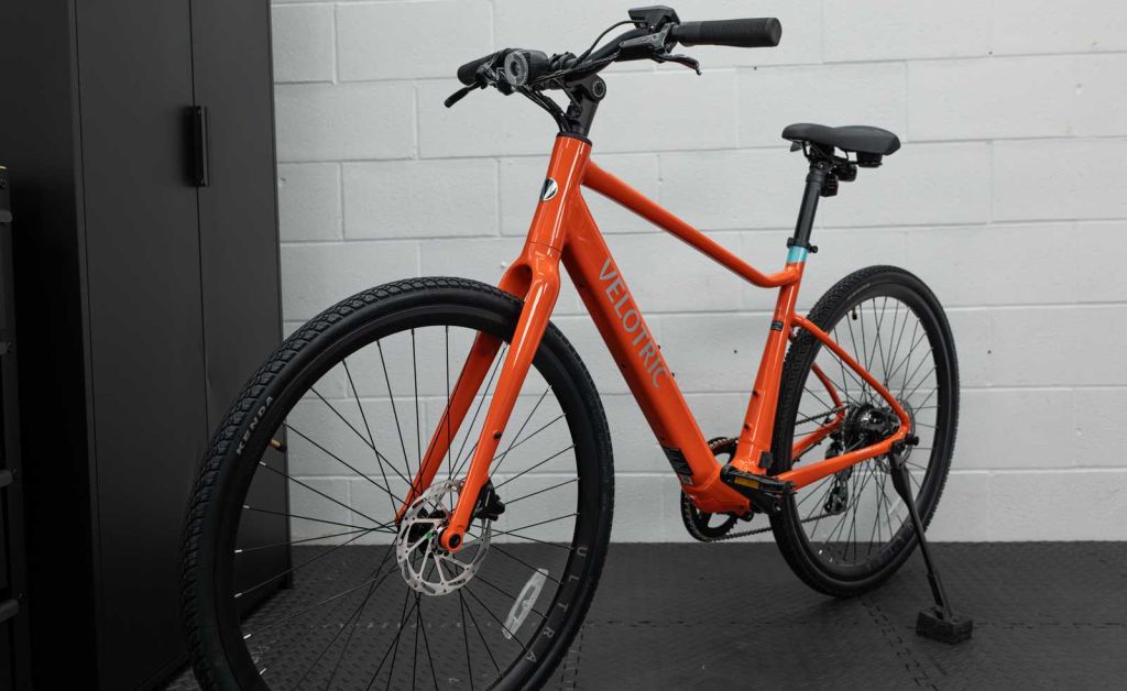

Geometry (size Large)Seat tube 490 mm, reach 467, stack 619, standover 700, top tube 650, saddle 810–1,045Every figure matched our tape measure✓ Verified
Fits our tester (6'0", 33" inseam)Size Large fits 5'6"–6'4"Yes, with the saddle at its highest setting✓ Yes
Claimed height range accuracyA 10" span of rider height (5'6"–6'4")9.25" of saddle-height adjustment: (10" − 2") ÷ 9.25" = 0.9×, inside our 2.0× limit✓ Verified

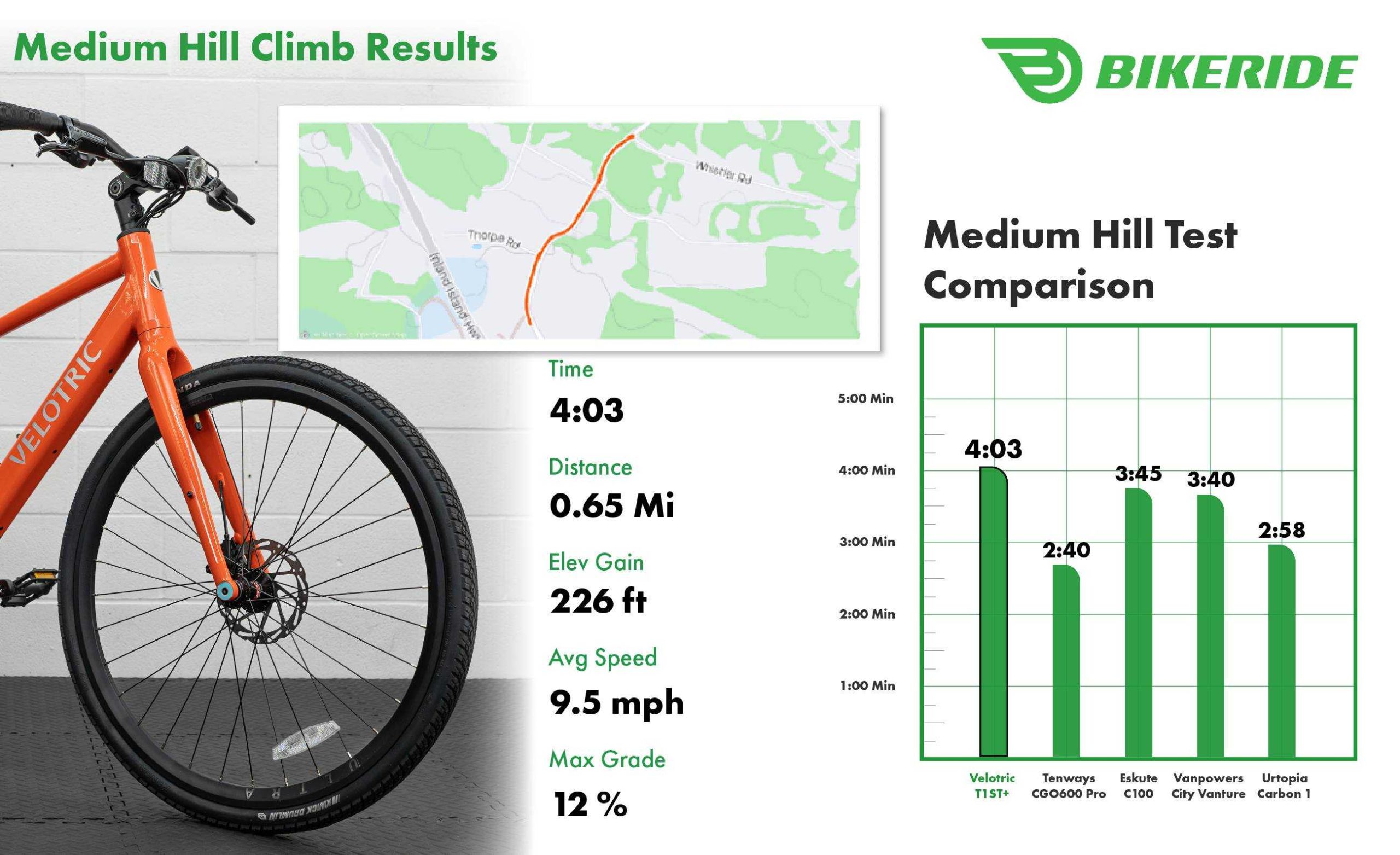

Climbing Test 2: Steep Hill
Measured
On the steep climb (0.65 miles at up to a 12% grade) the T1 ST Plus took 4:03 at an average of 9.5 mph. That is the slowest time in this group, 89 seconds behind the Pace 4, 66 seconds slower than the 2:57 average of the rear-hub e-bikes of 500W or less, and the slowest steep-hill time of the 79 e-bikes we have timed. Beyond about a 10% grade, the motor's help faded to very little.
Steep hill climb, max assist
Minutes:seconds · shorter is faster · 0.65 mi · 226 ft gain · 12% max grade
Aventon Pace 42:34
TENWAYS CGO600 Pro2:40
Fiido Air3:41
Velotric T1 ST Plus4:03
Velotric T1 ST PlusComparison bikesAverage of similar bikes (2:57)
T1 ST Plus: 4:03 · 9.5 mph avgSlowest in the comparison groupAverage of similar bikes: 2:57

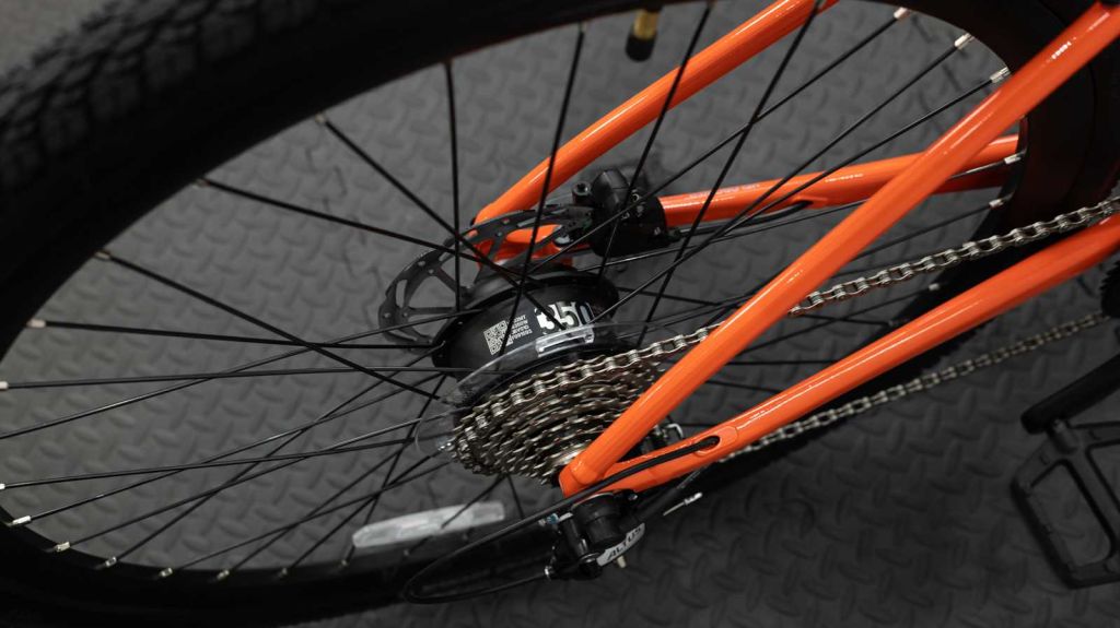

The Velotric-branded rear hub is rated at 350W nominal, 600W peak, and 40 Nm, and works through a torque sensor only. From a standstill, the assist arrived within a quarter crank revolution, a little behind the 0.2-revolution average across our database. It is smooth and subtle: it complements your pedaling rather than taking over, and only the highest levels feel like a push. The motor is impressively quiet, with none of the whine of most rear hubs.
The Velotric T1 ST Plus's small 350W rear hub motor and the cassette from the drive side, close up in the studio
The 350W rear hub motor: 600W peak and 40 Nm, claimed. Small enough to miss at a glance.

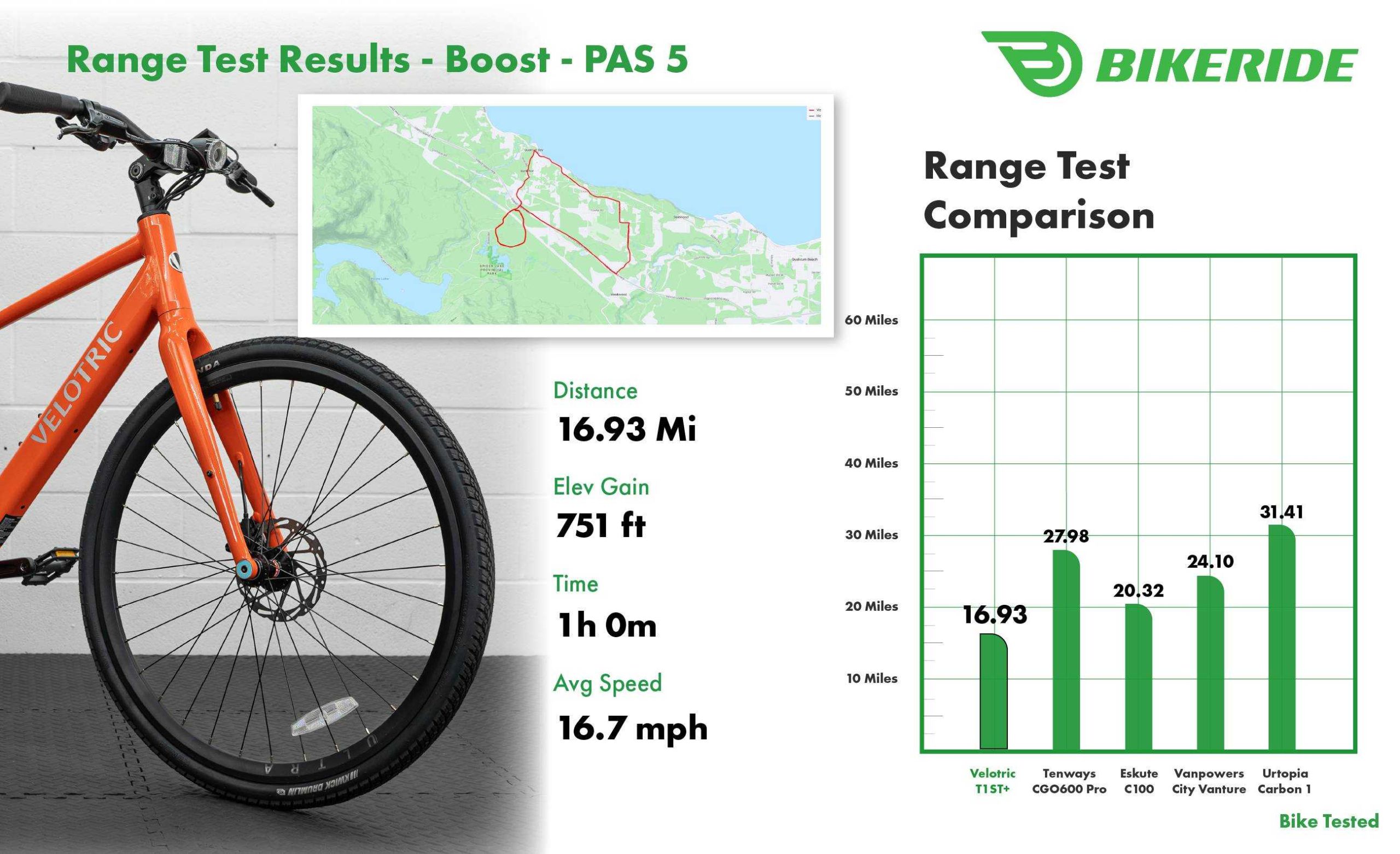

Range Test 1: Max Assist (Boost, PAS 5, 20 mph limit)
Measured
On our standard course at maximum assist (Boost mode, PAS 5) the T1 ST Plus lasted 16.93 miles with 751 feet of elevation gain, at a 16.9 mph average. That is the shortest max-assist run in this comparison group and the shortest of the 9 hybrid e-bikes we have tested, 41% below their 28.7-mile average. A 352.8 Wh battery pushing a 350W motor at full assist simply does not last long.

Range at maximum assist
Miles · longer is better
Aventon Pace 445.24 mi
TENWAYS CGO600 Pro27.98 mi
Fiido Air18.63 mi
Velotric T1 ST Plus16.93 mi
Velotric T1 ST PlusComparison bikesAverage of similar bikes (28.7 mi)
T1 ST Plus, Boost: 16.93 mi · 751 ft climbed · 16.9 mph avgAverage of similar bikes at max assist: 28.7 mi−41% vs. similar bikesShortest in the group

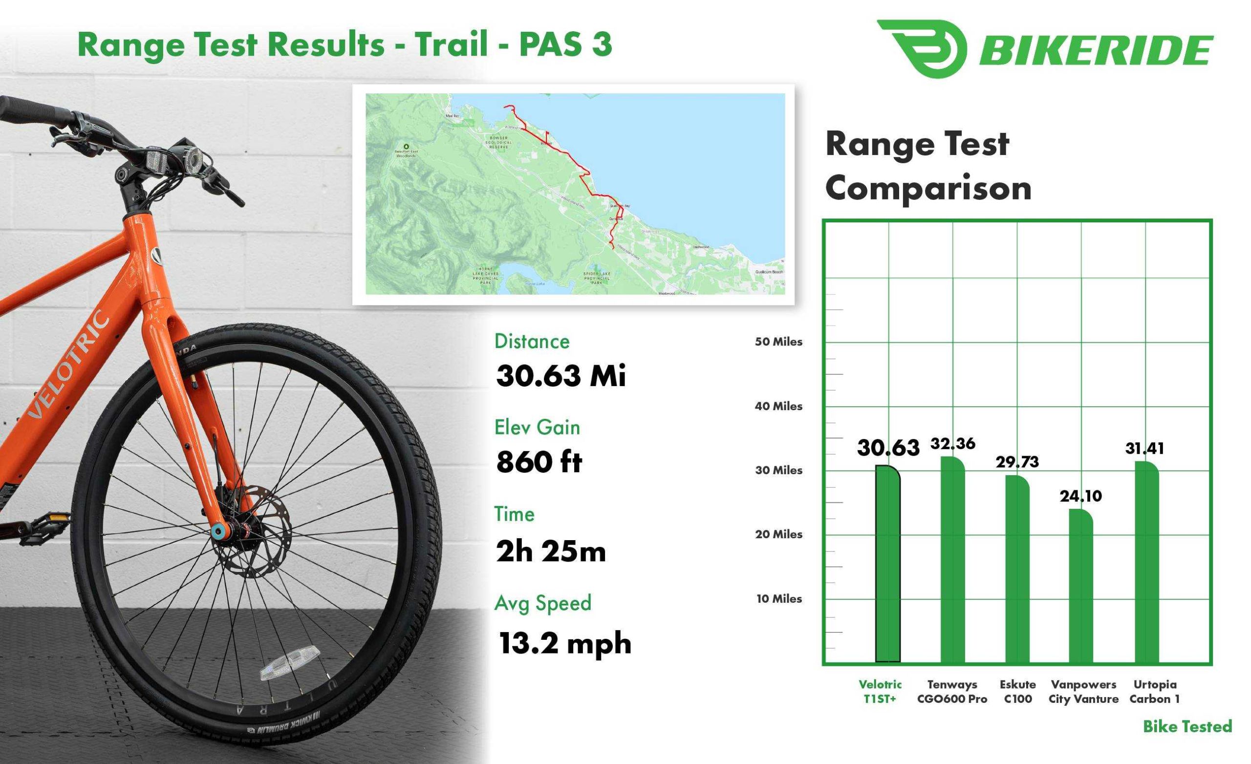

In Trail mode at PAS 3 the T1 ST Plus lasted 30.63 miles on the same course, with 860 feet of elevation gain, at a 12.7 mph average. That is 18% below the 37.4-mile average of the hybrid e-bikes we have tested at medium assist, but close to the CGO600 Pro and well ahead of the Fiido Air. With the assist used sparingly, the range is competitive.
Range at medium assist
Aventon Pace 454.79 mi
TENWAYS CGO600 Pro32.36 mi
Velotric T1 ST Plus30.63 mi
Fiido Air23.51 mi
Velotric T1 ST PlusComparison bikesAverage of similar bikes (37.4 mi)
T1 ST Plus, Trail: 30.63 mi · 860 ft climbed · 12.7 mph avgAverage of similar bikes at medium assist: 37.4 mi−18% vs. similar bikesThird of four in the group

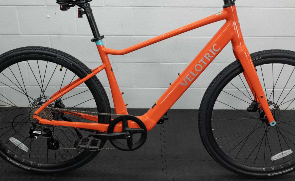

The 36V 9.8Ah battery (352.8 Wh) is built into the down tube. A screwed port sits underneath, but Velotric advises against removing the pack, so it cannot be charged off the bike or swapped. The battery is certified to UL 2271 and the electrical system to UL 2849, and Velotric rates the bike IPX6 and the battery IPX7. After wet rides, dirt had started to work in around the charge port's rubber cover, and without fenders, water could follow.
The Velotric T1 ST Plus's down tube from the drive side, with the battery built into it and the VELOTRIC logo
The down tube hides the 352.8 Wh battery. It stays in the bike.
✗ Battery not removable✗ Charges on the bike only✓ UL 2849 electrical system, UL 2271 battery✓ IPX6 bike, IPX7 battery (claimed)

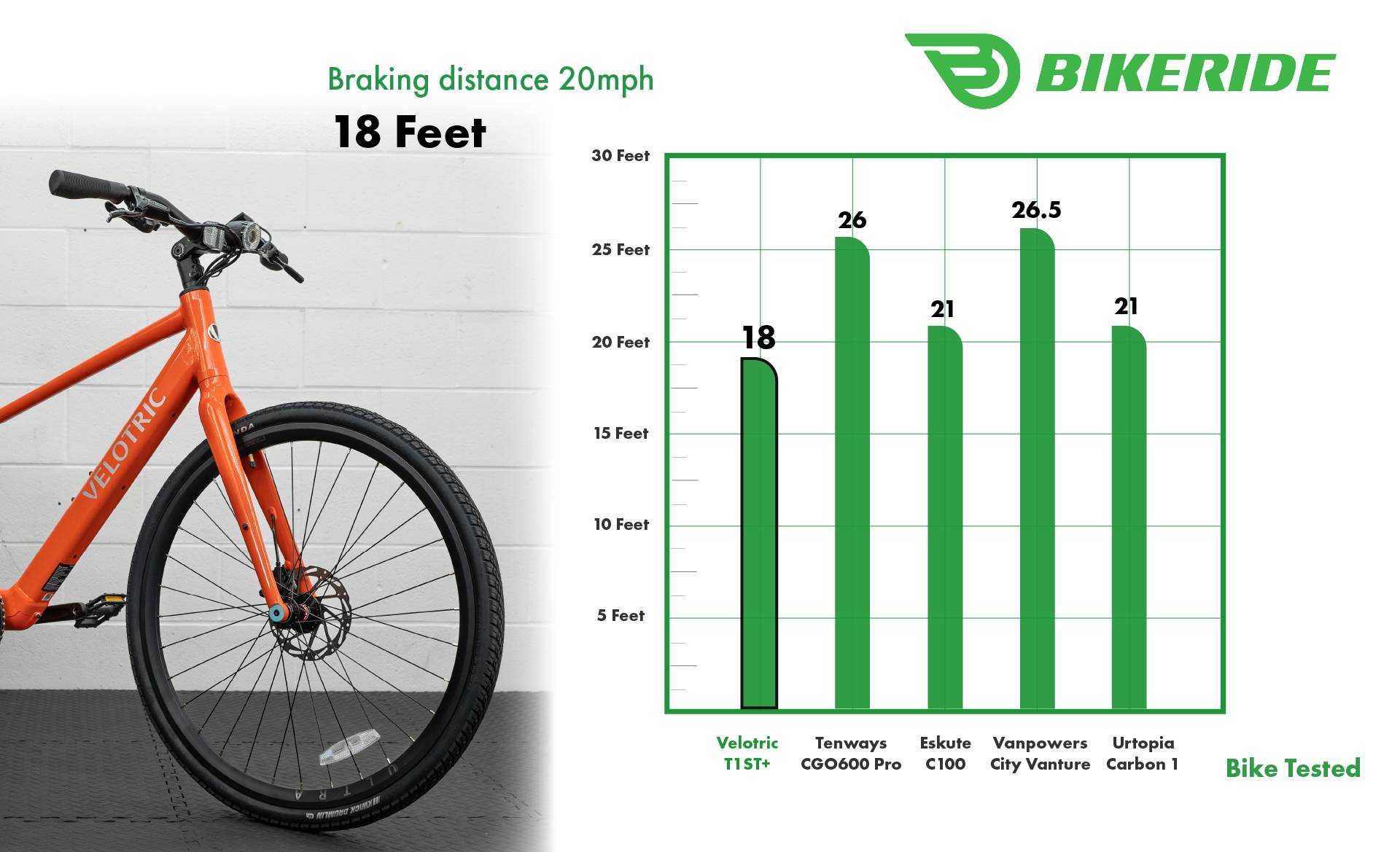

Brake test: 20 to 0 mph
Measured
The Tektro HD-R280 levers and two-piston calipers, with 160 mm rotors, stopped the T1 ST Plus from 20 mph in 18 feet. That ties the Fiido Air and the Pace 4 for the shortest stop in this group, 8 feet ahead of the CGO600 Pro, and only the Summit 1 has stopped shorter among the hybrid e-bikes we have tested. The brakes were quiet and inspired confidence, and lever reach adjusts with a 2 mm hex key.
The full stop from 20 mph, seen from above: 18 feet.
Braking distance, 20–0 mph
Feet · shorter is better
TENWAYS CGO600 Pro26 ft
Velotric T1 ST Plus18 ft
Fiido Air18 ft
Aventon Pace 418 ft
Velotric T1 ST PlusComparison bikesAverage of similar bikes (20.9 ft)
Where the T1 ST Plus sits: braking distance
Compared to the 9 hybrid e-bikes we have tested
T1 ST Plus
14.5 ft (best hybrid result)Braking distance26.5 ft (longest)
T1 ST Plus: 18 ftAverage of similar bikes: 20.9 ftTies shortest in the group

The T1 ST Plus has an integrated headlight, rated by Velotric at 60 lux, and a taillight on the seatpost that does one thing: steady red. There is no brake activation and no flashing mode, a step back from the Discover 2 we tested. An auto-light function switches the lights on and dims the display when the light fades, and can be turned off in the menu. Reflectors come fitted front and rear and in the wheels.
The Velotric T1 ST Plus's seatpost-mounted taillight, lit red, below the saddle in the studio
The seatpost taillight, lit. Steady red only, with no brake function.

The Velo Urban saddle, made for Velotric, was fairly comfortable, with no pressure points. The lock-on rubber grips flare outward to spread the weight of your hands. The plastic platform pedals are big, but their short, rounded pins gave little grip in the rain.
The Velotric T1 ST Plus's Velo Urban comfort saddle from the side in the studio
The Velo Urban comfort saddle: fairly comfortable, with no pressure points.

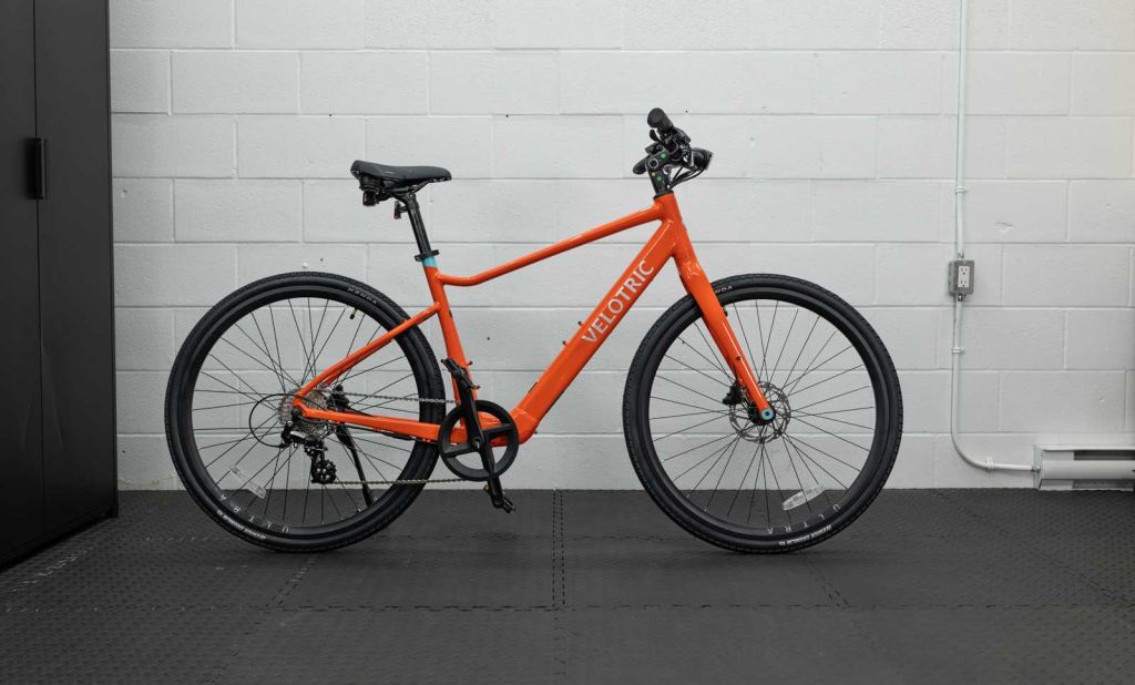

The 6061 aluminum step-over frame comes in Lava, as tested, or Sand. The paint, the welds, and the overall finish give the impression of a quality bike, and the wiring, cables, and brake hoses run inside the frame and fork. A 12×100 mm thru-axle holds the front wheel, the bottom bracket is threaded, and there are two sets of bottle-cage bosses and fender mounts front and rear. There are no standard rack mounts: Velotric sells its own rack.
The Velotric T1 ST Plus's head tube, top tube and down tube from the drive side, with the internal cable ports
The head tube and the top of the down tube from the drive side: internal cables, clean welds, Lava paint.

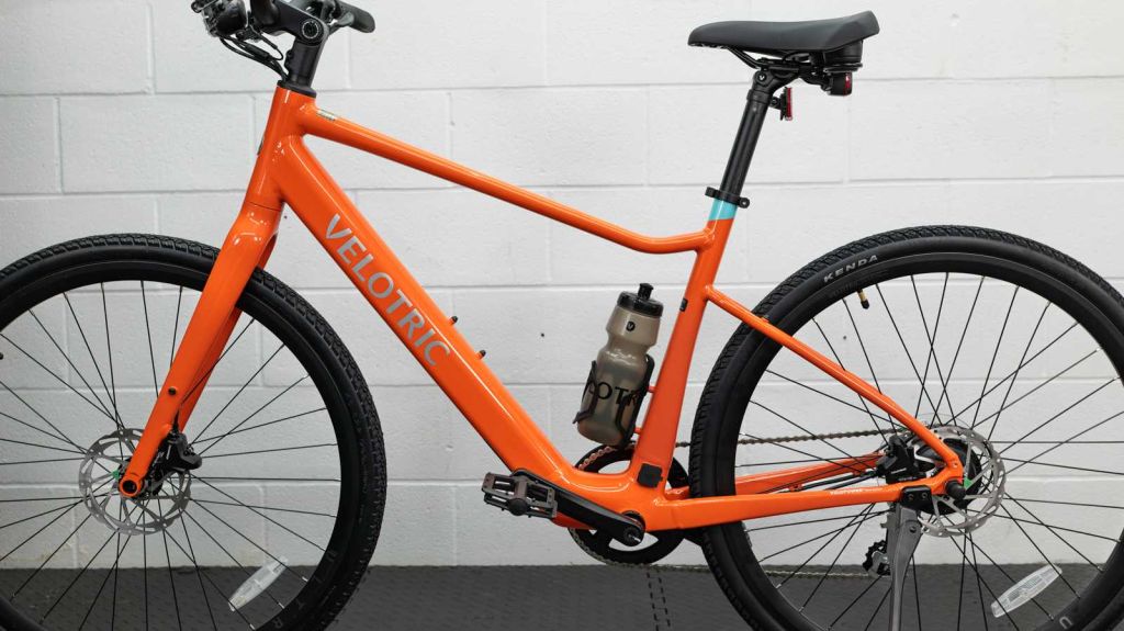

The Velotric T1 ST Plus from the non-drive side with a bottle cage fitted to one of the two sets of bosses
Two sets of bottle-cage bosses sit inside the main triangle, welcome on a fitness bike.
Frame welds and finish5/5Clean welds and a quality paint finish. It passes for a non-electric bike.

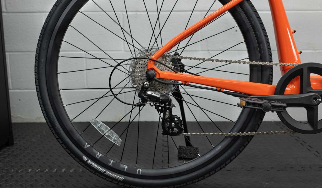

The Shimano Altus 8-speed drivetrain pairs a 46t narrow-wide chainring and single-sided guard with an 11–32t cassette. The trigger shifter is crisp, and the gearing suits speeds up to 28 mph. The low end is the problem: the 32t cog is not big enough for climbs, so with the small motor the hills are hard work, and the bike is tough to pedal unpowered anywhere but on the flat or downhill. It needs a lower first gear.
The Velotric T1 ST Plus's Shimano Altus rear derailleur and 11–32t cassette, close up in the studio
The Shimano Altus derailleur and the 11–32t cassette. Crisp, but the 32t low gear is too high for hills.
Shifting performance3/5Crisp shifting, but the lowest gear (32t) is too high for climbs.

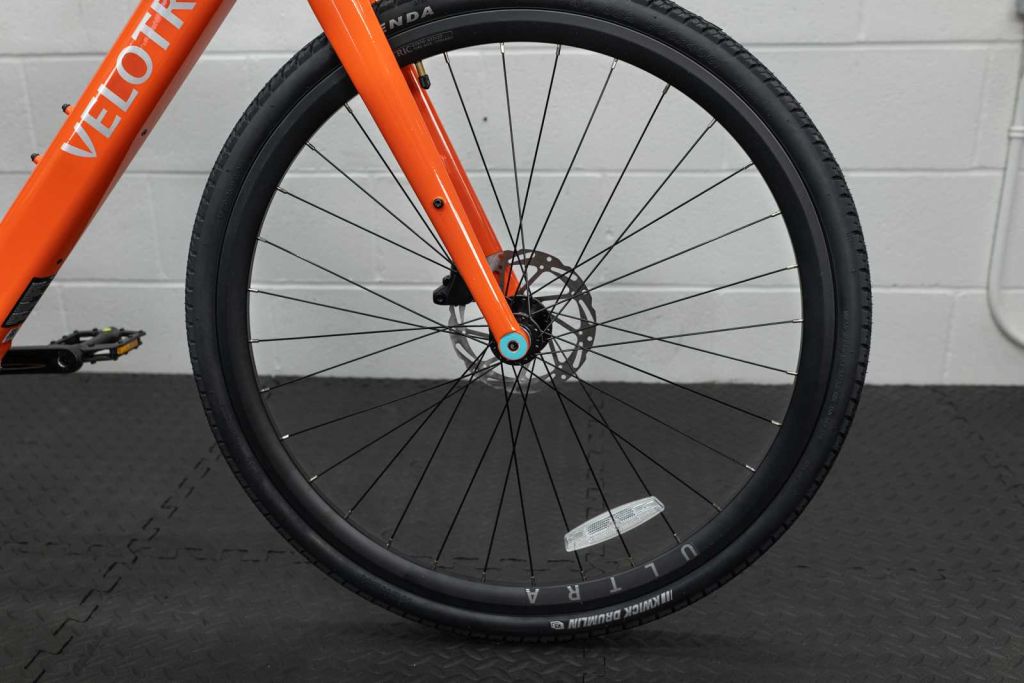

The 700C aluminum wheels run on a Novatec front hub and 700×40C Kenda Kwick Drumlin tires with Kenda's K-Shield puncture protection. The tires are a good mix of speed and comfort, with good grip on wet pavement, gravel, and forest paths. In the box: the lights, a bell, reflectors, a single-sided kickstand, and an assembly toolkit. Fenders and a rack are sold separately, and we doubt most aftermarket racks will fit the frame, which limits the bike as a commuter.
The Velotric T1 ST Plus's front wheel, with its 700×40C Kenda Kwick Drumlin tire and the thru-axle fork end
The 700×40C Kenda Kwick Drumlin tire: fast on pavement, with real grip on gravel.

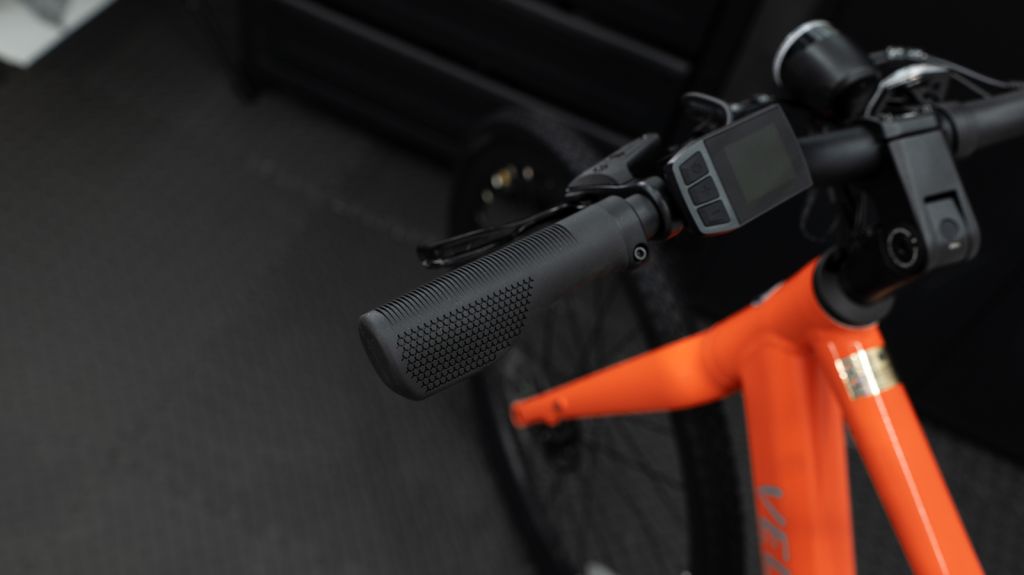

The 1.8-inch color display and its three buttons form one unit next to the left grip. Power cycles the riding data (odometer, speeds, calories, trip data), plus and minus step through the assist levels, a long press of plus works the lights, and a long press of minus starts walk mode. Holding plus and minus together opens the advanced menu: ride mode, speed limit, brightness, auto power-off, Find My, units, and the app link.
It shows less than other Velotric displays. The battery meter is a bar with no steps, so the exact charge means opening the app, and changing the ride mode means stopping to go into the menu. A USB-A port on the display charges a phone.
Stepping through the menu on the three-button unit.
The Velotric T1 ST Plus's display unit at the left grip, with its three buttons beside the 1.8-inch color screen
The display unit up close: three buttons beside a 1.8-inch color screen.
Display readability3/5Small and simple, but the battery bar has no steps.
Controls3/5Easy to learn. Ride modes are buried in the menu.

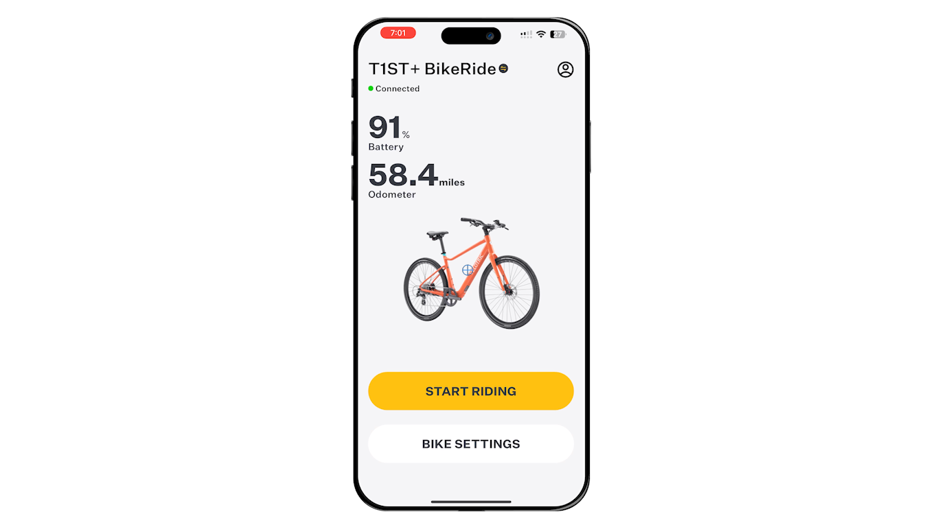

The Velotric app has a clean interface and is easy to use. It mirrors the display's advanced menu, shows the battery as a percentage, and connects to Apple Find My. It is the same app as the Discover 2's, minus the functions this bike doesn't have, such as the switch between torque and cadence sensors.
✓ Battery percentage in the app✓ Speed limit and ride modes on the display, no app neededSensor:  torque only, no cadence option
Companion app4/5Clean and easy, with the same settings as the display. It's the only place to see the battery percentage.

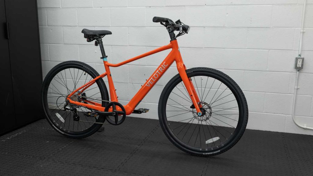

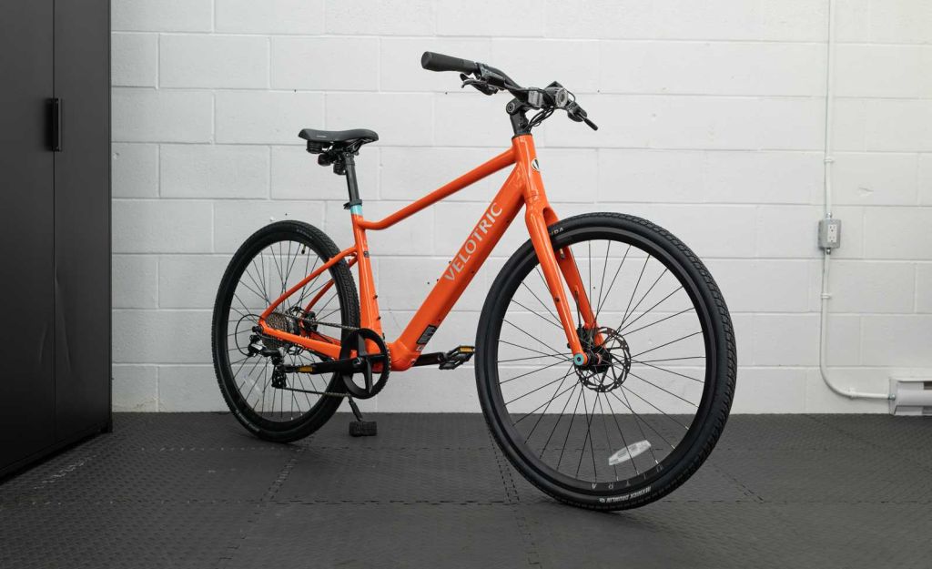

The Velotric T1 ST Plus from the front three-quarter, drive side, in the BikeRide studio
The T1 ST Plus from the front three-quarter: a fitness bike first, a commuter with accessories added.
Value verdict4/5Good value for urban jaunts or as the fitness bike Velotric says it is.

Gradual hill climb, 20 mph capvs. 26 other rear-hub e-bikes of 500W or less4:033:293:18
Steep hill climbvs. 28 other rear-hub e-bikes of 500W or less4:032:572:36

Range (max assist, Boost)vs. 8 other hybrid e-bikes16.93 mi28.7 mi29.6 mi
Range (medium assist, Trail)vs. 5 other hybrid e-bikes30.63 mi37.4 mi39.1 mi
Range vs claimedvs. 8 other hybrid e-bikes44%57%54%
