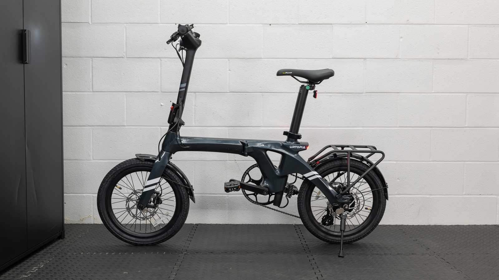

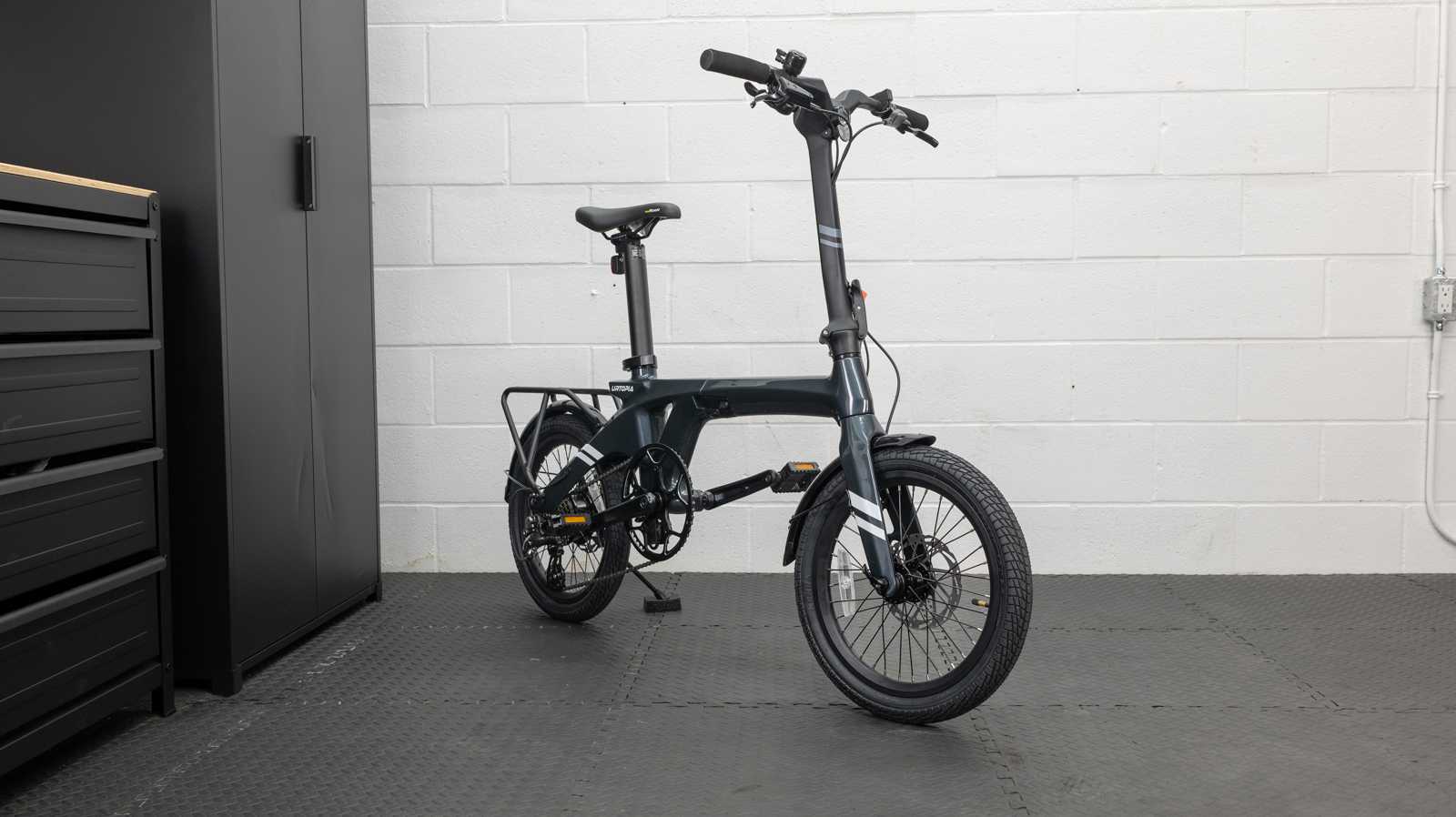

The Carbon Fold 1 is a folding e-bike with 18″ wheels and a lightweight design aimed at urban riding and commuting. Both the frame and stem fold, resulting in a compact package that’s easy to pick up and a breeze to transport in a vehicle.
Urtopia says the bike weighs 29lb. On my scale, the Carbon Fold 1 clocks in at 35.8lb, which is 6.8lb or almost 25 percent more than advertised. While this is disappointing, it’s still very light for an e-bike, especially one that folds.

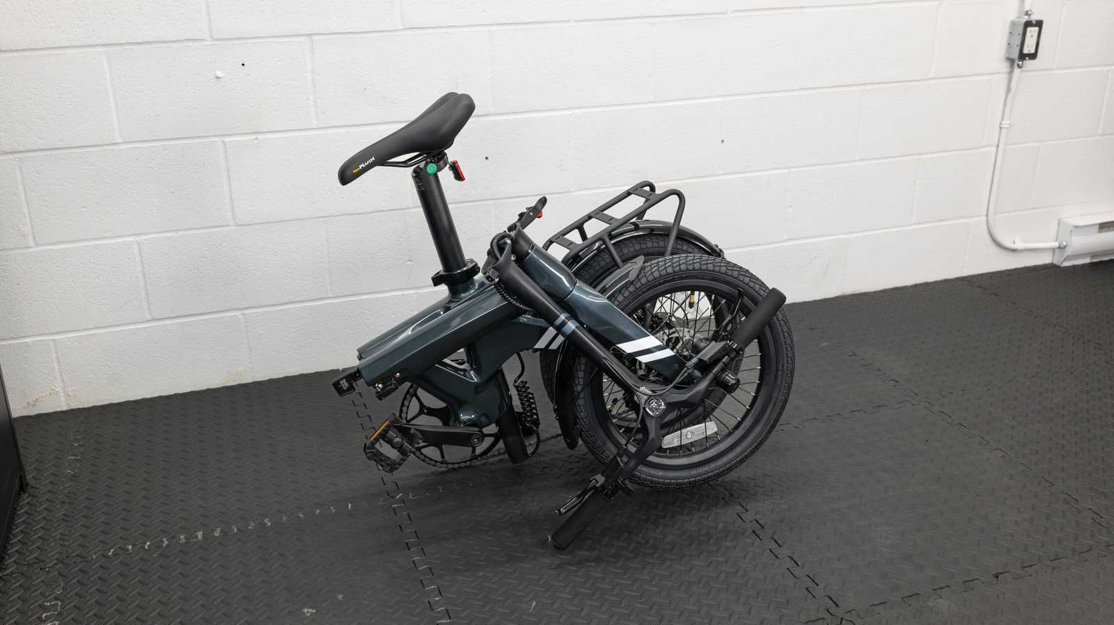

Folding Design
The Carbon Fold 1 doesn’t have the usual bulky aluminum frame found on so many folding e-bikes at this price point. This bike has an unusually slim and sleek silhouette thanks to the carbon construction and the fact that the battery is in the seatpost, not the frame.
The built-in magnetic clasp that keeps the frame closed when folded is a nice touch that, combined with the lightweight frame, makes it much easier to move the bike when it’s folded. Urtopia’s Carbon Fold 1 is also much easier to lift in and out of a car trunk than heavier aluminum folders, such as the 65.8lb Velotric Fold 1 or 68lb ENGWE L20.
Lightweight Carbon Frame
Alongside the folding design, the carbon frame’s low weight is a standout feature of this bike.
The Fold 1 is light and easy to pick up or maneuver when folded. The slim frame and low weight make it easier to fit into small spaces like the back of a car.

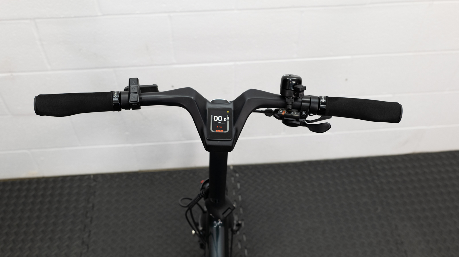

The carbon fiber handlebars have an integrated color LCD display in the center. Locking rubber grips, a bell, and the Altus shifter complete the cockpit. There’s no provision to change the height of the bars. The other touchpoints are Wellgo plastic folding pedals and a Velo Plush saddle.

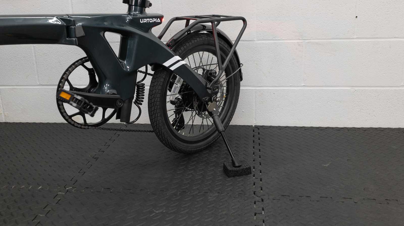

Urtopia provided fenders and a kickstand with the test bike. At the time of writing, these are included with the Fold 1, but they may cost extra in future. Without these two accessories, the Fold 1’s utility is significantly reduced. Our test bike also has a rear rack rated to carry 55lb, but this isn’t included.

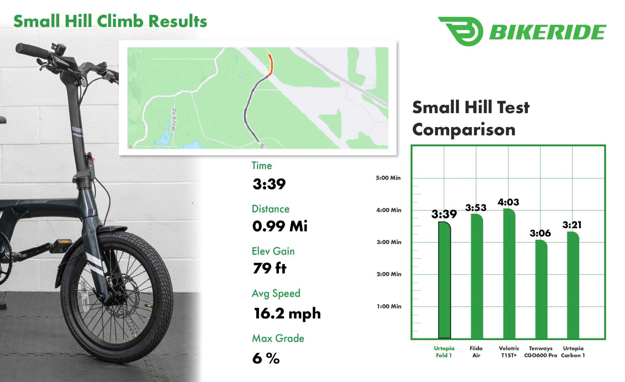

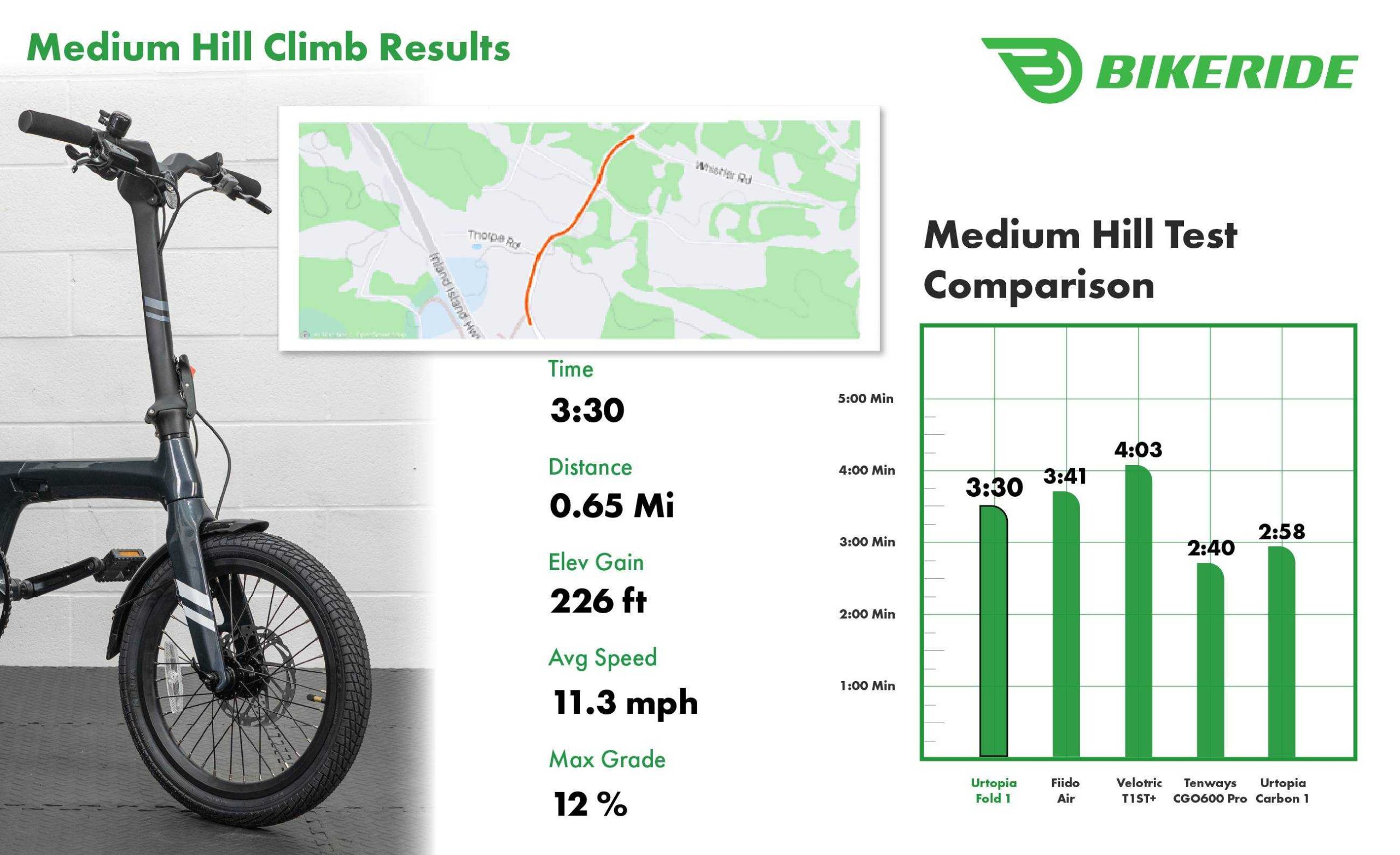

Hill Climb Tests
Compared to the other folders we’ve tested, the Urtopia Fold 1 is grossly underpowered. Its 250W motor isn’t a patch on the 750W and 500W motors found on the similarly priced folders with aluminum frames. Therefore, in these tests, we’ve chosen to compare the Fold 1 to bikes with 250W or 350W motors and similar torque ratings.
The Fold 1 sits smack in the middle of the pack when it comes to our longer, shallower hill climb. It managed to beat the Fiido Air and Velotric T1 ST Plus.
The Carbon Fold 1 also surprised in the shorter, steeper hill climb test, where, again, it was in the middle of the group, beating the Fiido Air and Velotric T1 ST+ but falling short of the CGO600 Pro and Urtopia’s own Urtopia Carbon 1.
These are great results considering the small 250W motor and 42Nm of torque. The gearing and low weight certainly helped the Fold 1 in this test.

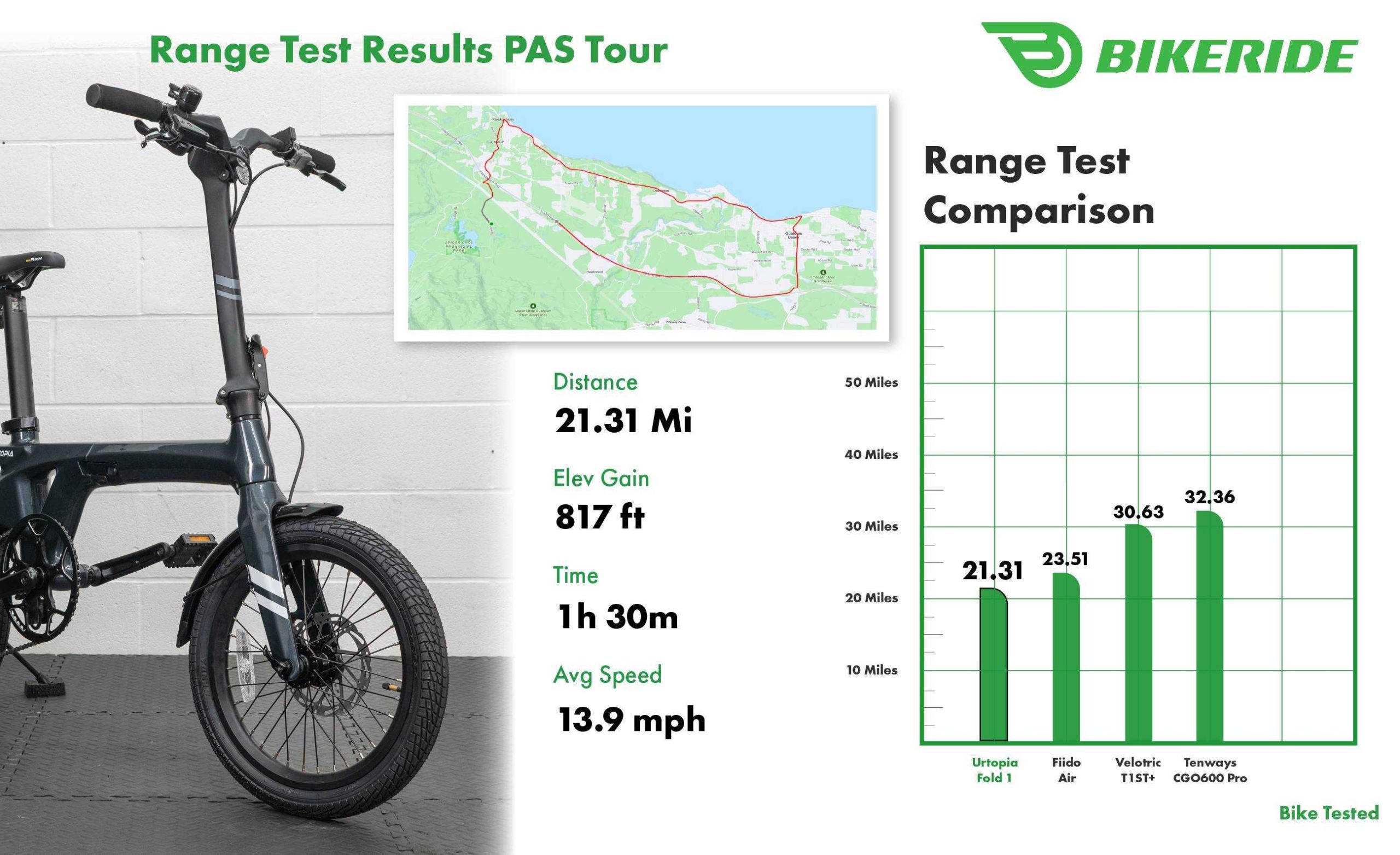

Range Tests

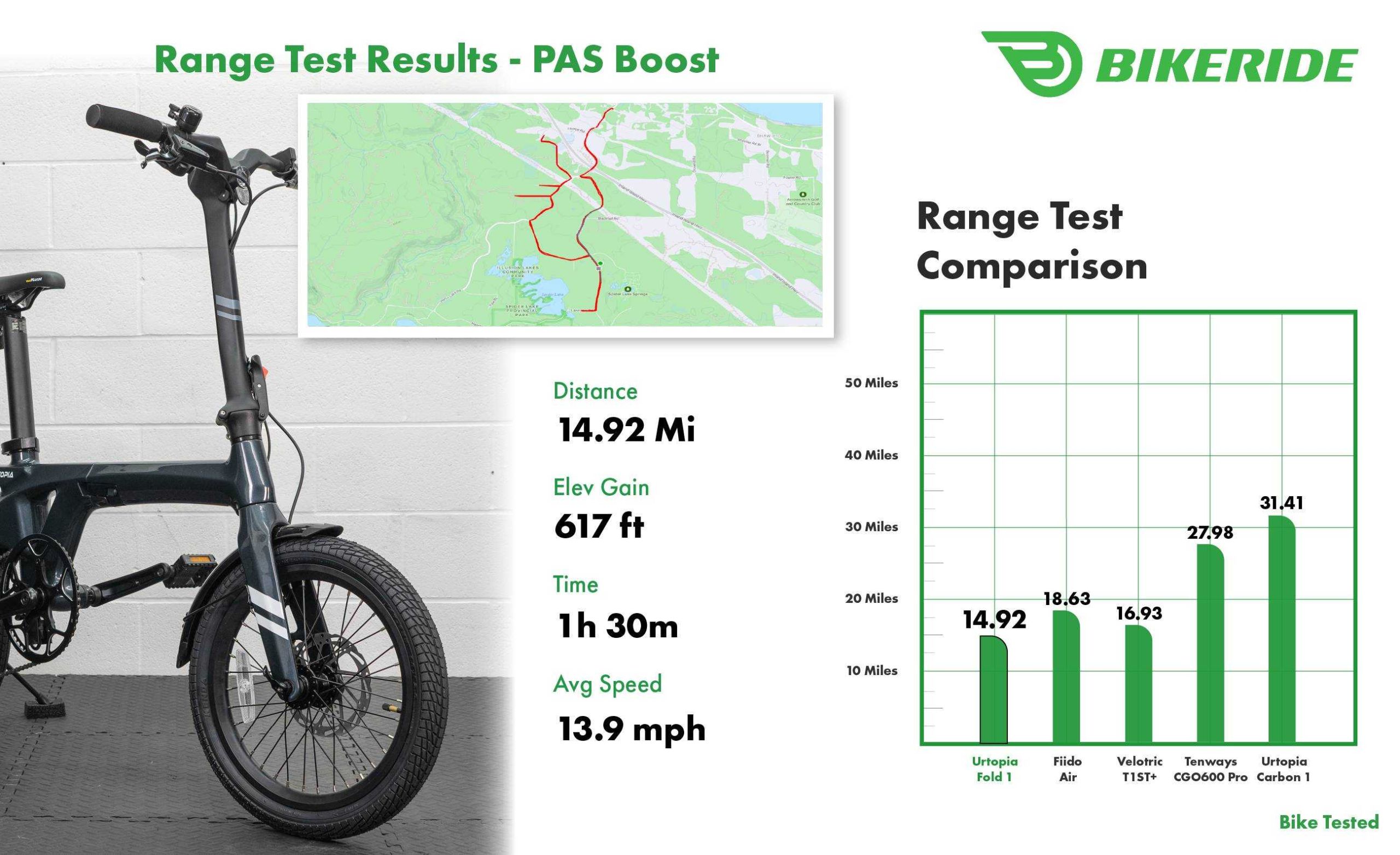

Throughout the rides, I struggled with the bike’s four-bar battery meter, which drops in an uneven manner. During the first range test, the battery level fell quickly, reaching the 50% mark after only seven miles. The bike then ran for another 10 miles before losing another bar. After just 2.5 miles more, the battery was dead.
With such an erratic decline in charge, it’s hard to know how long the battery will last and when it’s time to turn around and head home. This is made worse by the lack of reserve power. When the last battery bar disappears, that’s it.
For the second range test, we unlocked the speed limit to the maximum of 20mph. The battery meter was just as unreliable in this test. The bike feels like it starts to limit power at 50% charge, struggling to maintain 18mph. Below 25%, the bike won’t go faster than 12 or 13mph, even when pedaling hard in Boost mode.
Overall, the Carbon Fold 1’s range is disappointing. The bike’s apparent tuning to limit the motor’s output as charge drops is also frustrating. Motor output fell markedly at the 75%, 50%, and 25% battery levels.

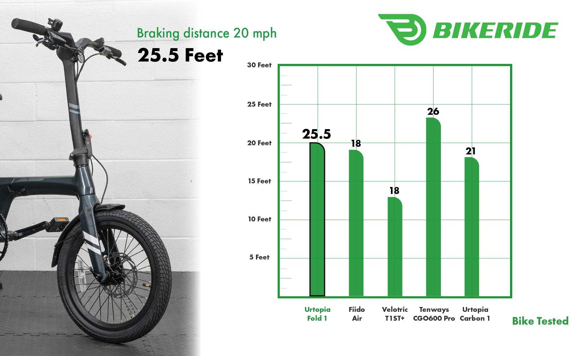

In the braking test, the Fold 1 also fell short of expectations, needing 25.5 feet to stop from 20mph. This distance is much longer than average. In fact, it’s 10 feet more than some of the best bikes we’ve tested.

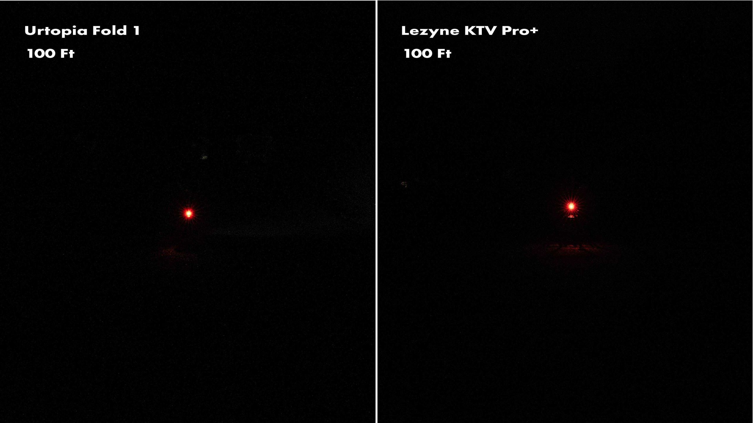

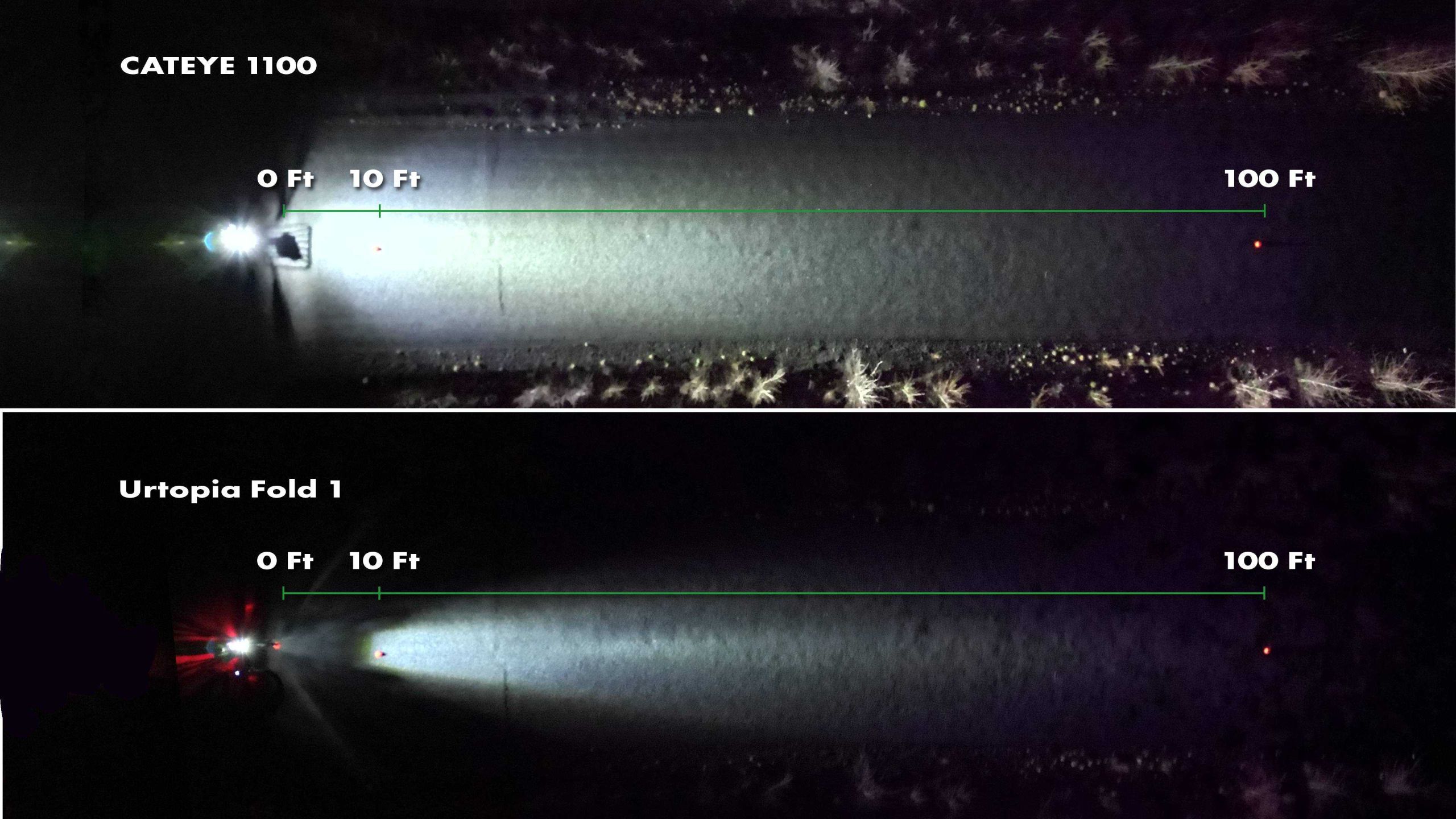

Light Tests

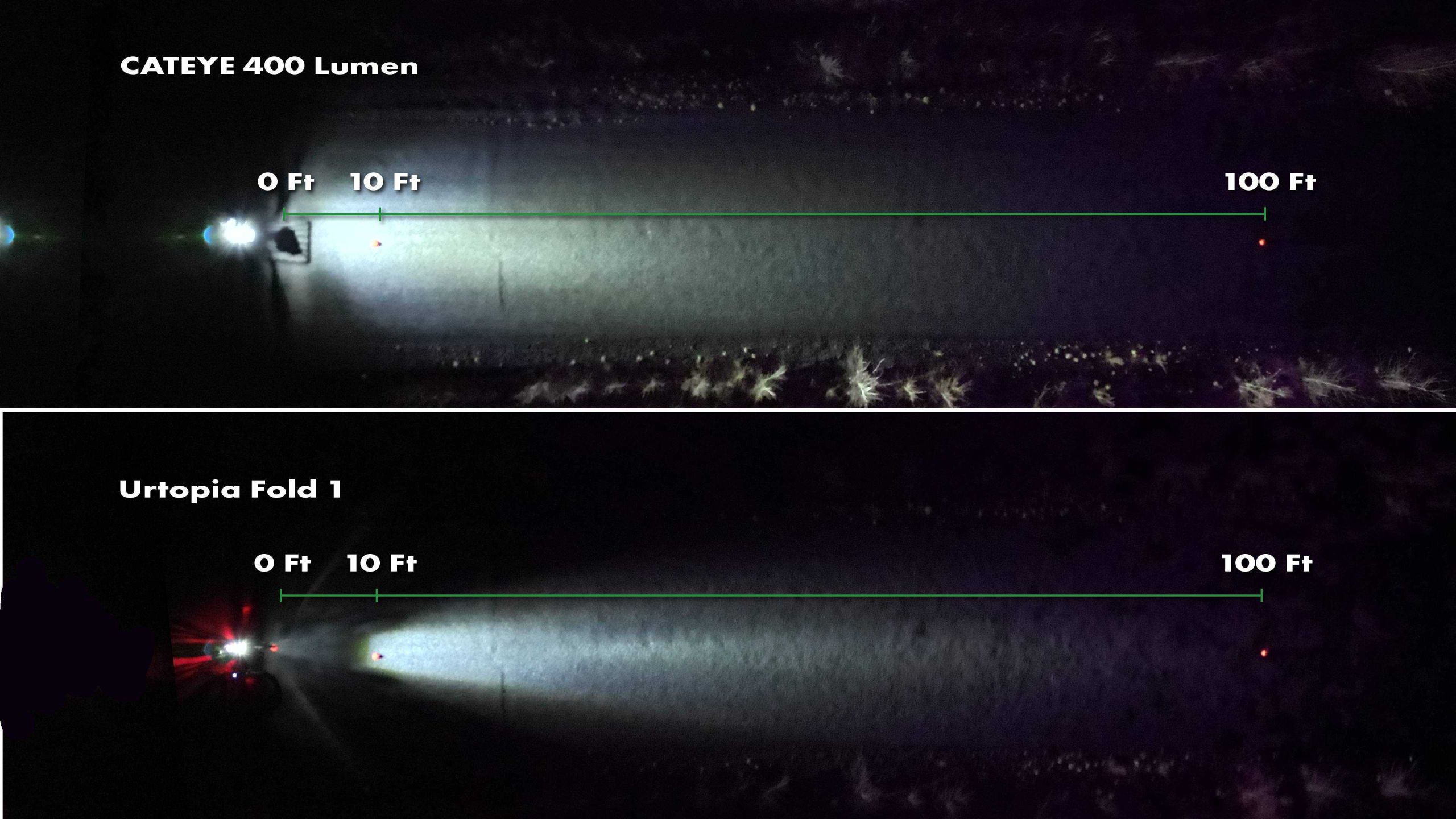

The Fold 1’s front light is surprisingly bright, given its size, illuminating the cone at 100 feet. However, it’s nowhere near as bright as our CatEye reference light on its 1,100-lumen setting. The Fold 1’s front light is closer to CatEye’s 400-lumen setting and still doesn’t illuminate the sides of the road, unlike the CatEye.
The rear light is very powerful and appears almost as bright as the reference light when viewed from 100 feet away.

Range Tested (PAS 2/4): 21.31 mi – 817 ft. – 13.9mph avg.
Range Tested (PAS 4/4): 14.92 mi – 617 ft. – 14.9mph avg.
