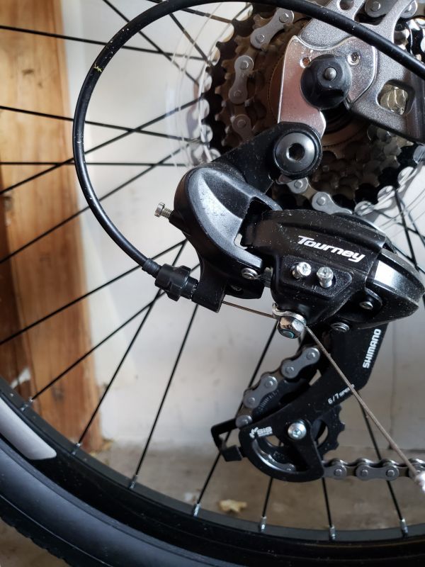

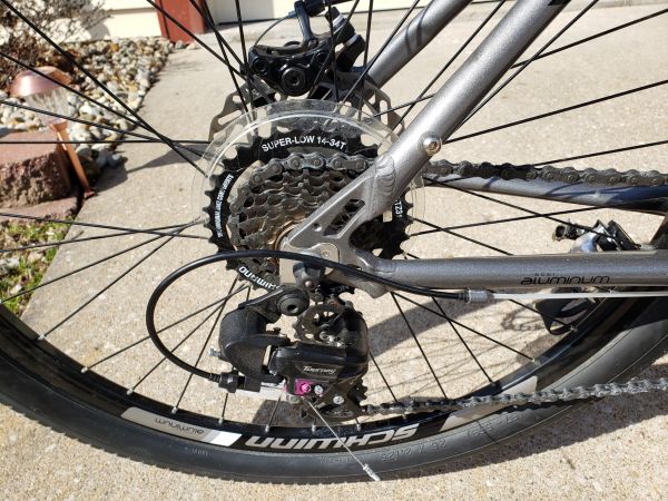

Original Freewheel
I also didn’t like the cheap freewheel. The stock 14-28T gears weren’t quite good enough for steep hills plus the middle gears made noise no matter how I adjusted the rear derailleur. I replaced it with a Shimano MF-TZ31 Tourney Freewheel (14-34T Mega 7 Speed) for $20. The noises went away and that 34T granny gear allows us to climb up steeper hills than the Katy Trail will throw at us. All told the bike shifts gears very well – much better than I had expected.
