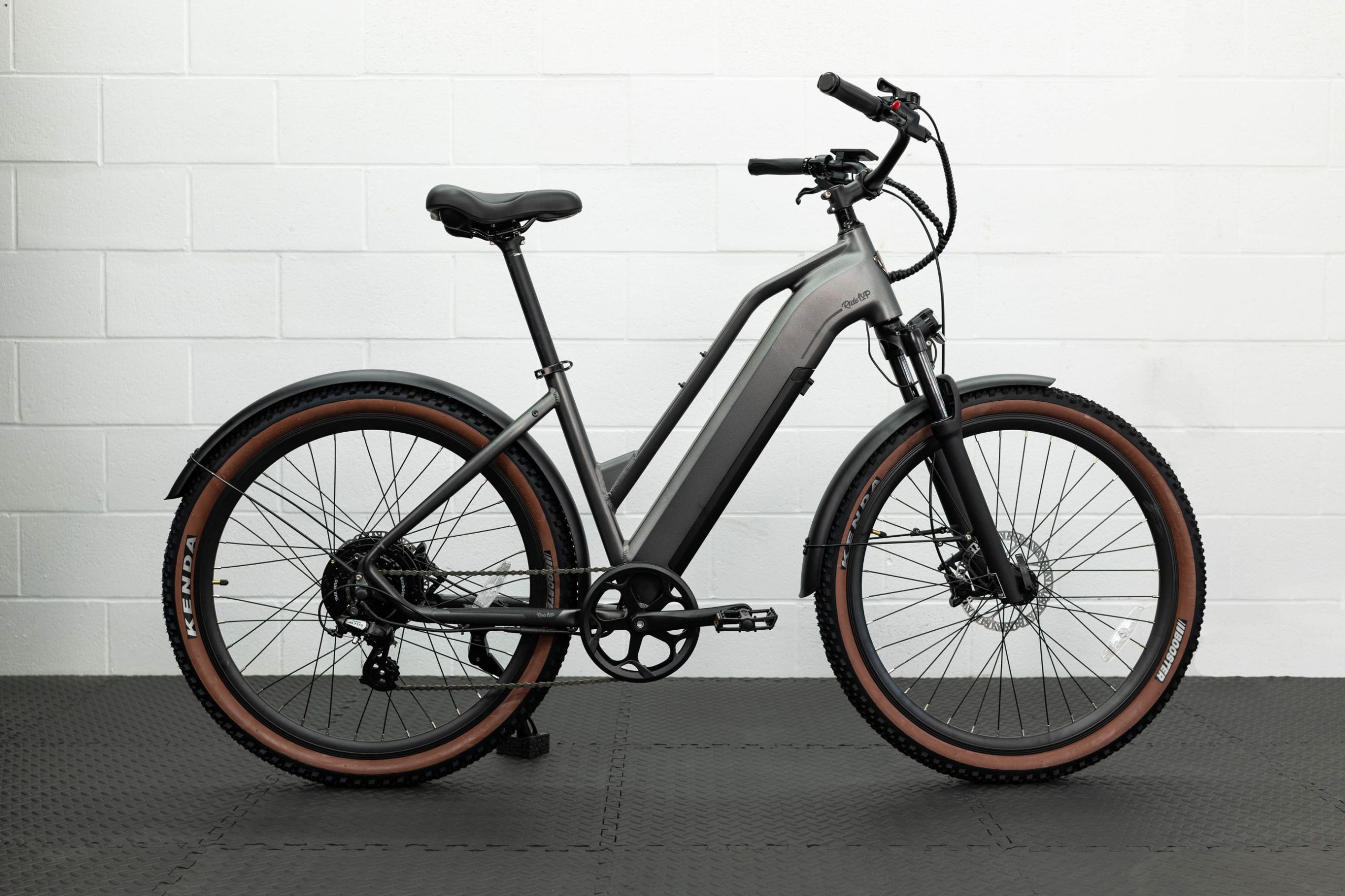

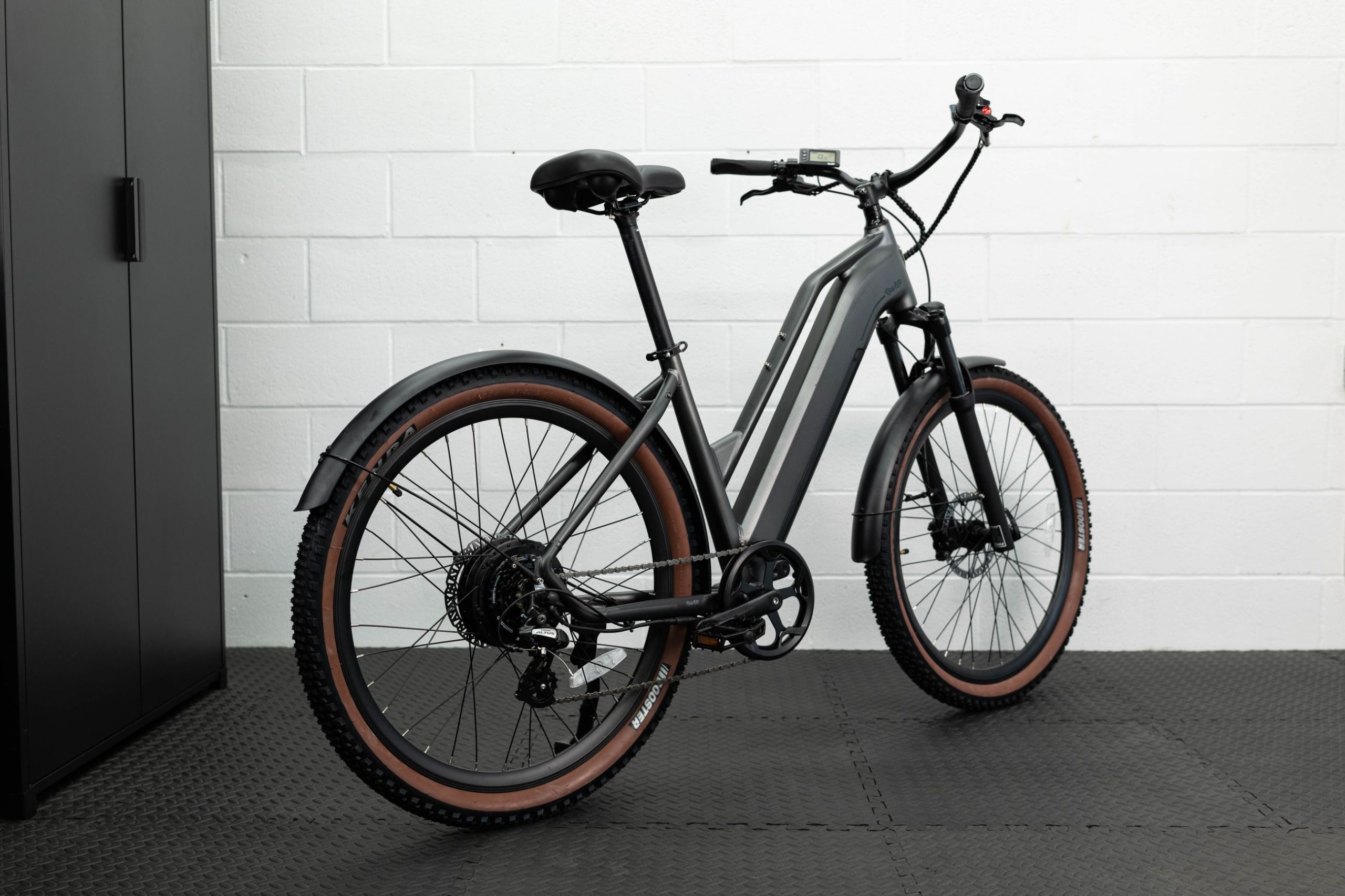

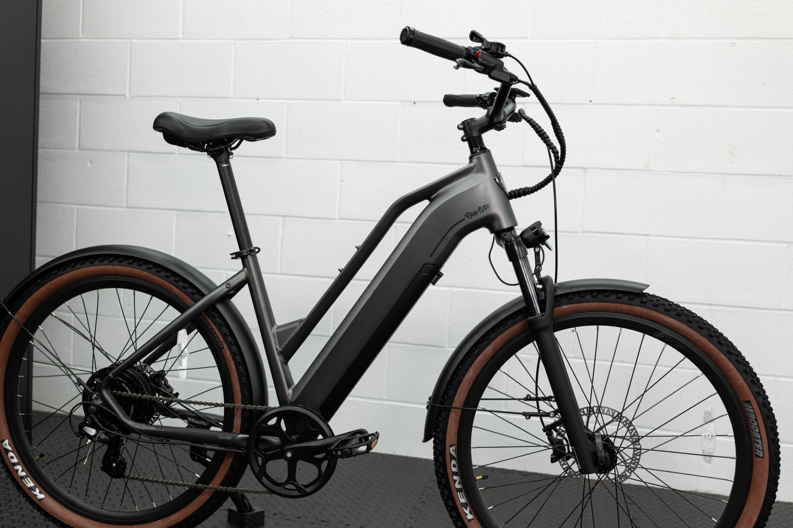

What Is the Ride1UP Turris?
The Turris is an entry-level e-bike with a hybrid frame, available in step-through and step-over versions.
The step-through (ST) frame is responsive and easy to mount, and the geometry and swept-back handlebars create an upright, enjoyable riding position.
The Turris rolls on 27.5″ rims with 2.4″ tires, and a 100mm suspension fork adds comfort and traction. The bike comes with fenders and a headlight, but a rear rack and taillight must be added separately.
Overall, the Turris is a versatile e-bike that can handle mixed terrains, making it suitable for urban commuting and recreational riding.

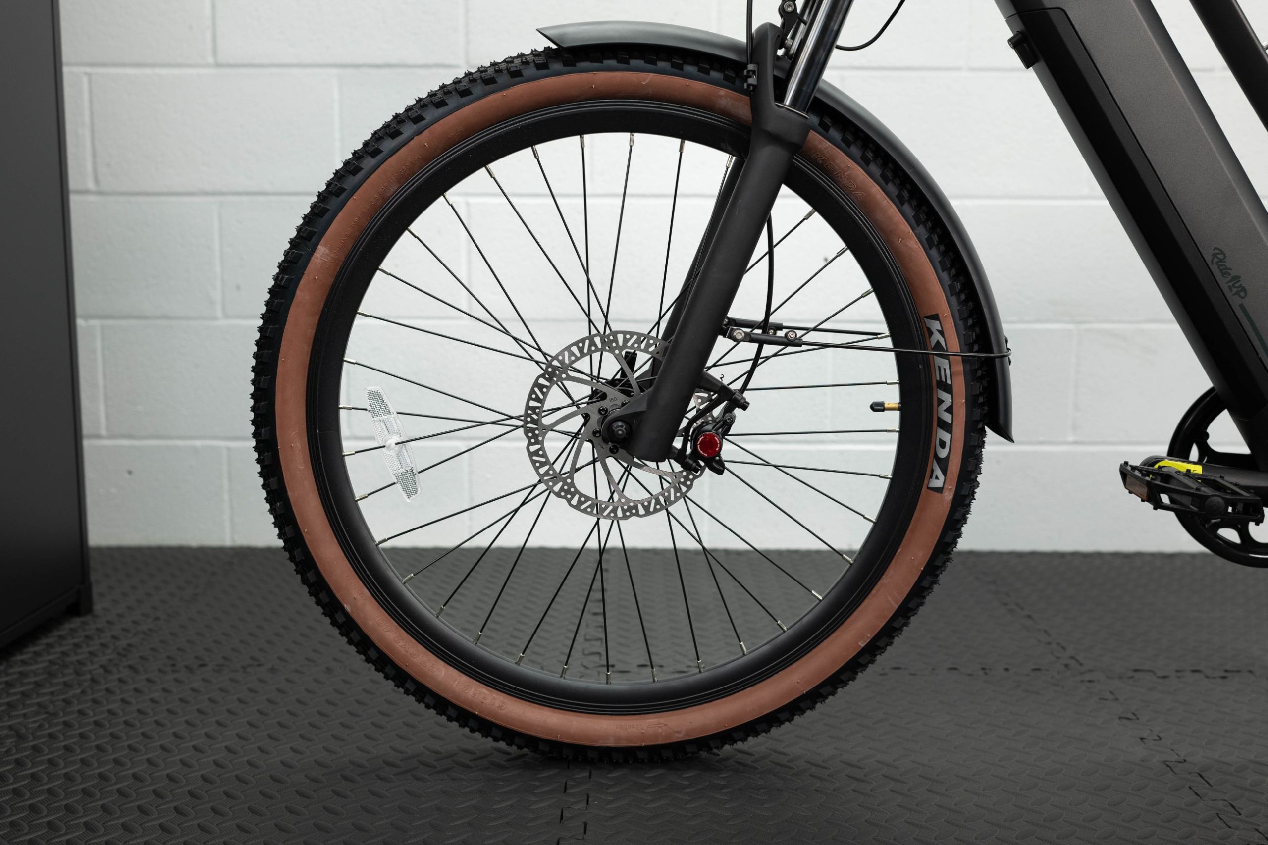

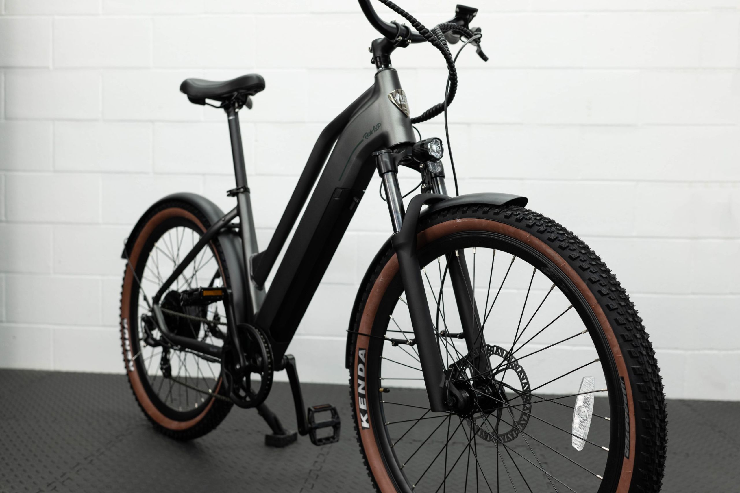

Suspension Fork
The Turris has a suspension fork with 100mm of travel, more than most competitors (usually 50mm to 80mm). It’s an inexpensive coil spring, but it works well for bumpy gravel or dirt roads and has a lockout feature.

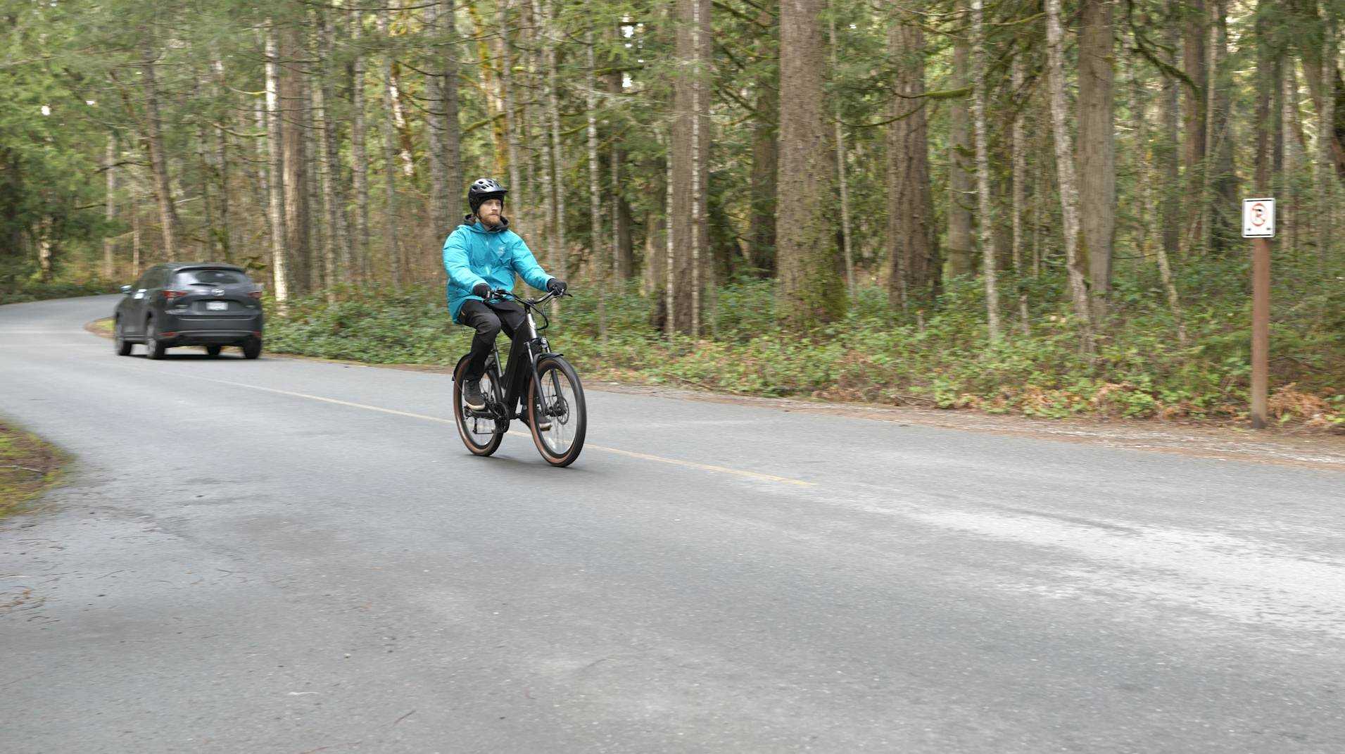

Maneuverability
Though not particularly light, the Turris is highly maneuverable. The 27.5″ wheels and 2.4″ tires make it easier to navigate tight or technical spaces, especially compared to the clunky fat tires often seen on bikes in this price category. Likewise, the frame isn’t as bulky as comparable models, adding to this agile characteristic.

Despite its 60 lux rating, the headlight wasn’t as bright as others we’ve reviewed. Additionally, this bike doesn’t have a taillight.

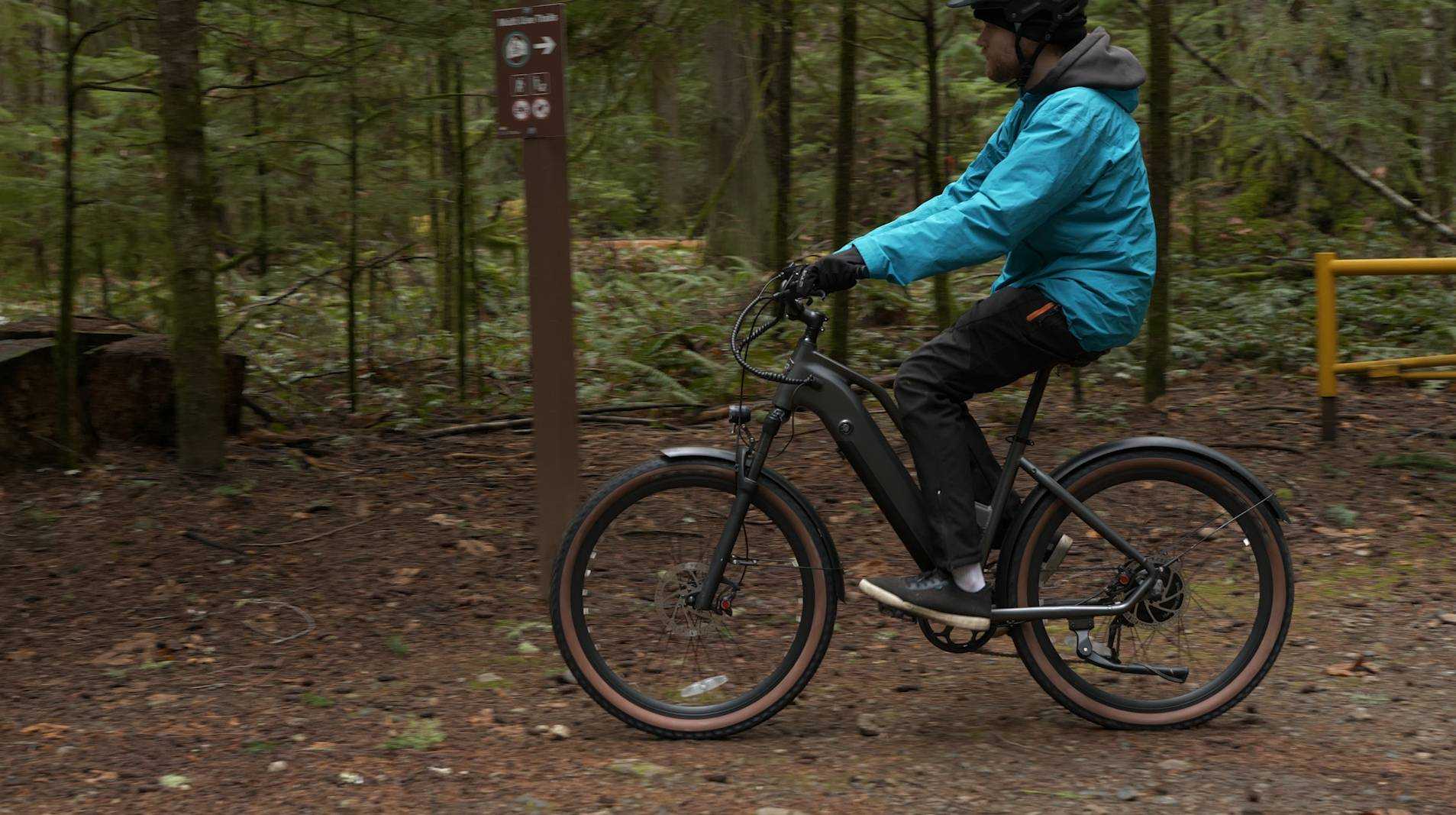

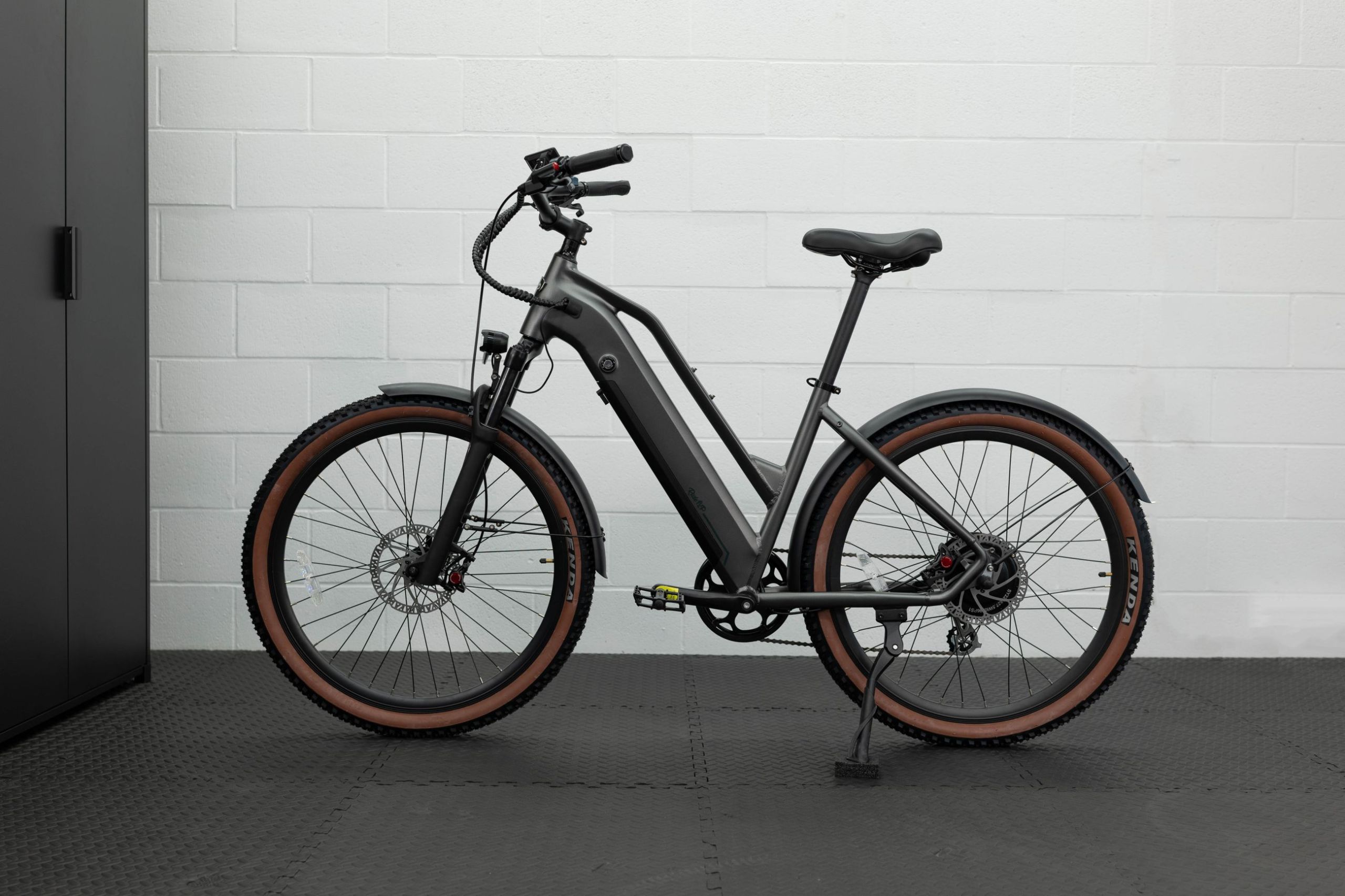

Frame and Geometry
The Turris comes as a step-through or step-over. We received the step-through version to review. This frame has a top tube and down tube that join at the bottom of the seat tube. This design creates a low stand-over height while helping to reduce frame flex.
The frame geometry allows easy control, and the straight-backed riding position and easy mounting make this an accessible bike. The sizing is appropriate for me at 6’0″.

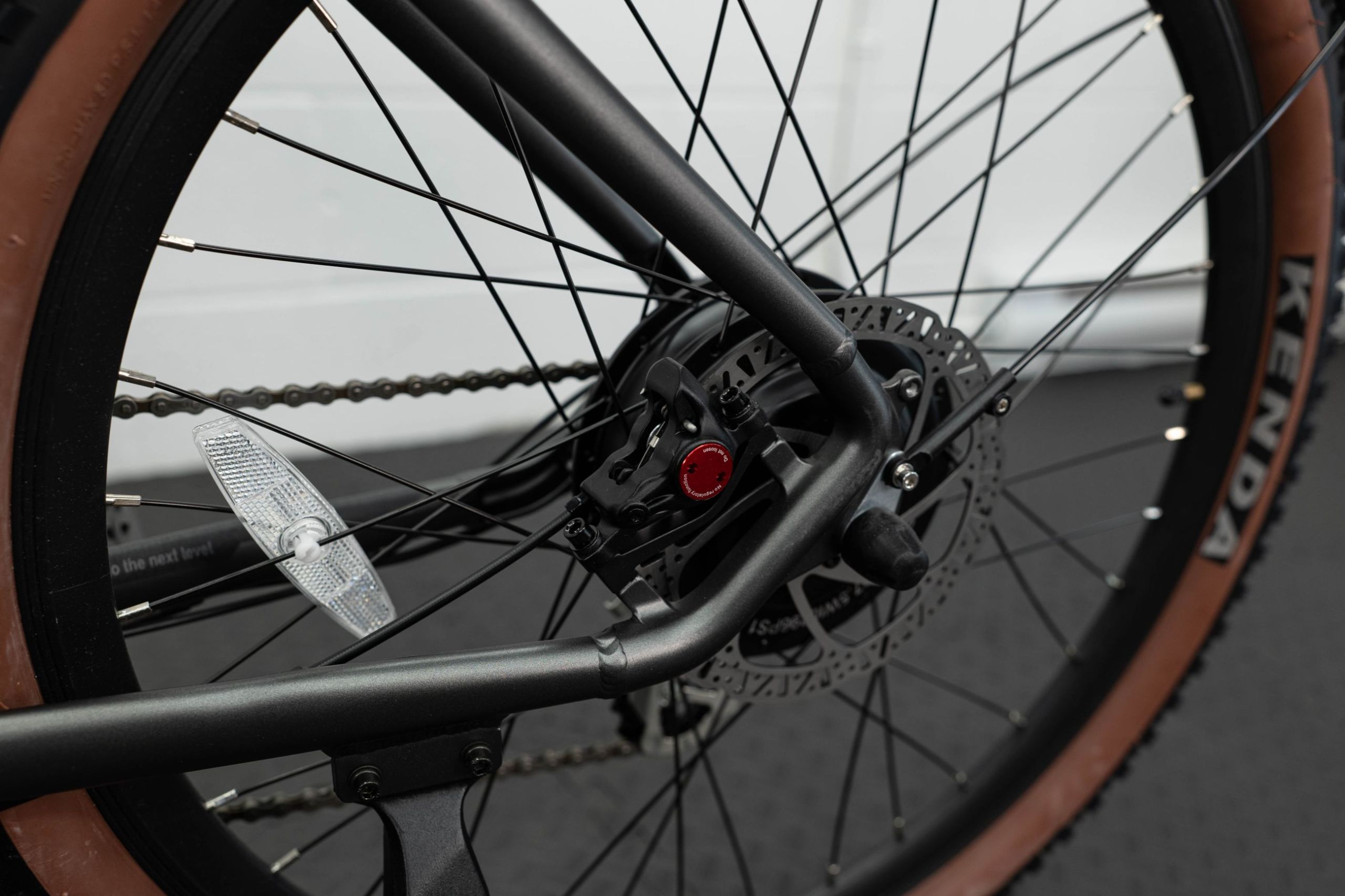

Motor
The Turris has an AKM rear hub motor. Ride1UP lists this motor as 48V, 750W, with a 60Nm max torque. However, the hill climbing ability doesn’t reflect this rating, even at high battery voltages.
The bike accelerates well on flat ground but quickly loses speed on gradients over 6%. The Turris achieved one of the slowest times in our medium hill test, performing worse than most 500W e-bikes we’ve tested, such as the Aventon Level.2 and Lectric XP 3.0.

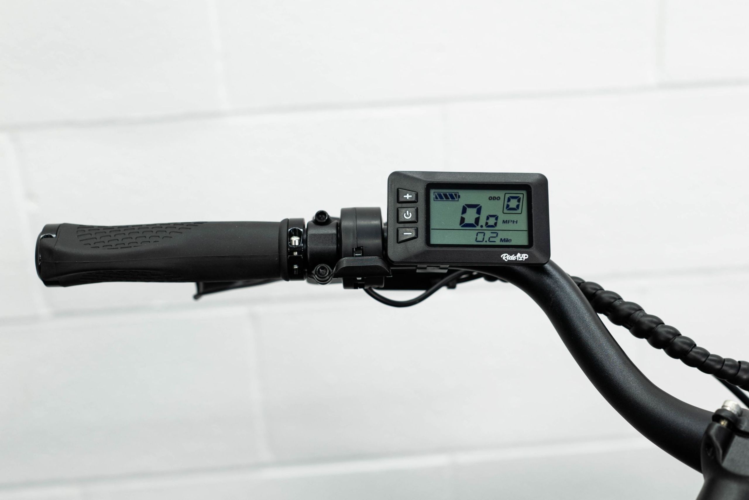

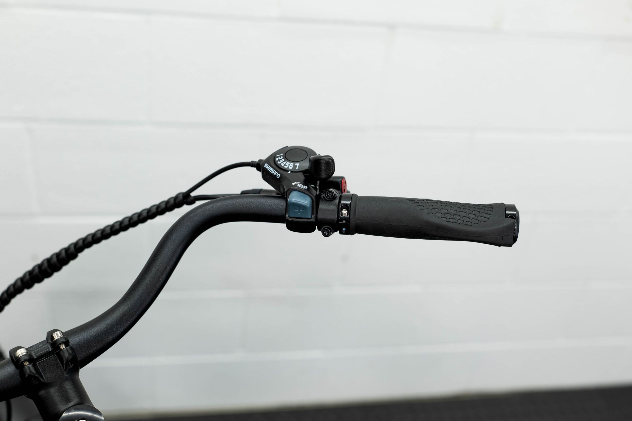

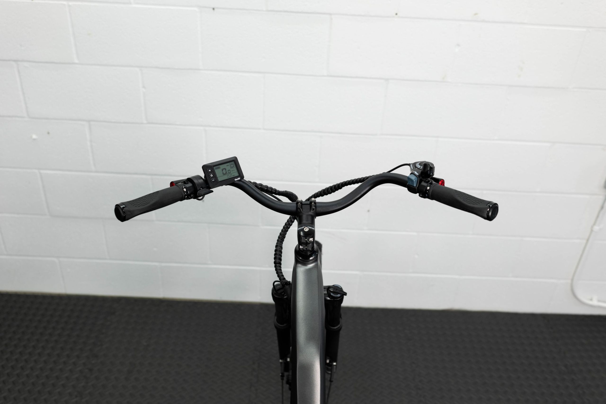

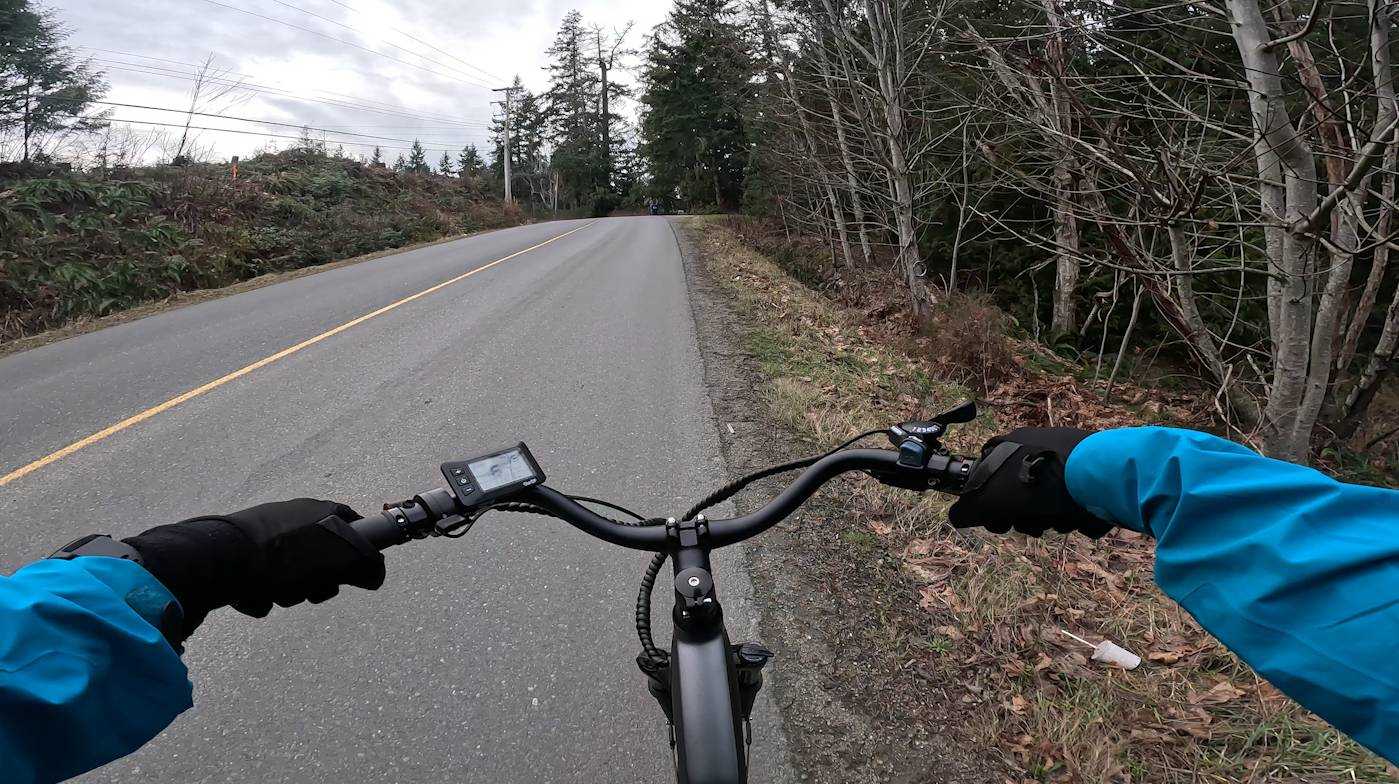

Cockpit and Control
The Turris’ cockpit is clean and simple. It features a combined display and control pad on the left side, leaving ample room for thumb-style throttle, Shimano Tourney index shifter, and Zoom brake levers.
The brake lever and throttle are comfortable to reach and easy to use. The display and control pad are also straightforward and user-friendly, the same as those found on other Ride1UP bikes.
The three-button control panel includes up, down, and power buttons for controlling the bike’s PAS level or navigating through the settings.
The handlebars sweep back towards the rider, which, combined with the upright geometry, allows for a comfortable straight-backed riding position. Overall, I found the cockpit comfortable and easy to use.

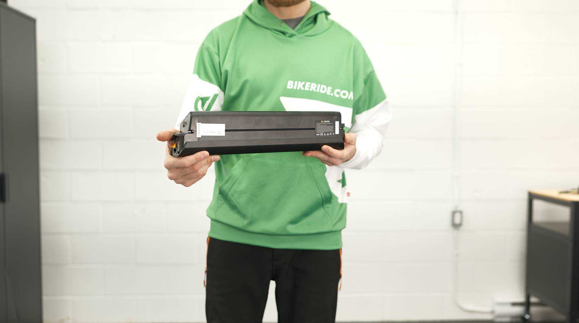

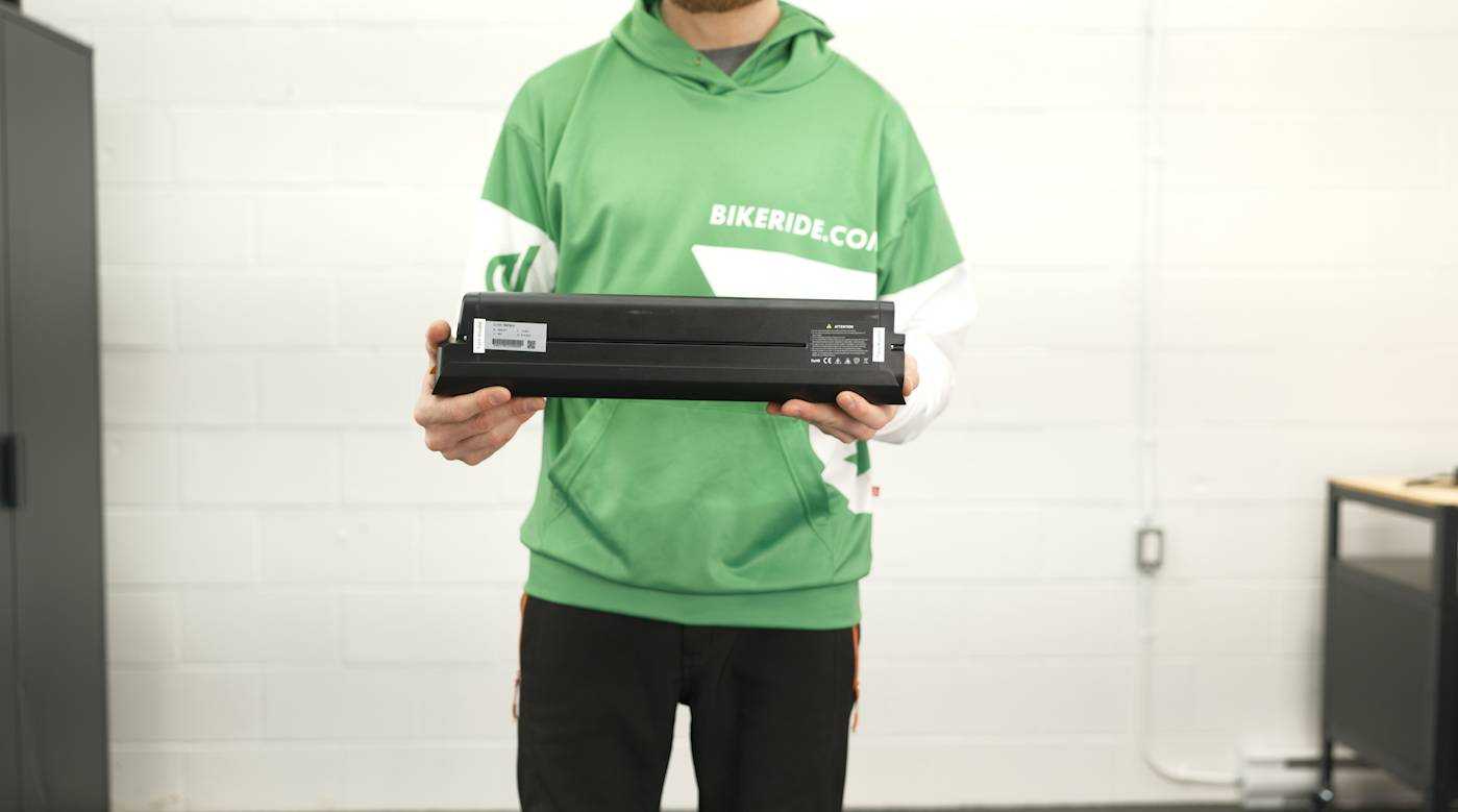

Battery
The Turris comes with a 48V 14Ah (672Wh) battery pack, which fell short of the range we expected. Using the maximum available pedal assist, we covered just 21.28 miles and 1,226 feet of elevation while averaging 13mph. This result is on the lower end for this battery size, but it’s decent for a bike at this price point.
Again, the major issue was the battery level inaccuracy, which meant the bike died suddenly, despite displaying four bars (~80%). I’d like to hear from other users about whether they have faced similar issues with the Turris.
The Turris comes with a 2A charger and is charged in seven hours from empty. Charging is possible on or off the bike using the external charge port, which is protected by a rubber stopper when not in use.

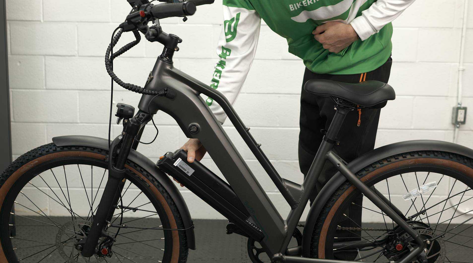

To remove the battery for transport or charging, you must unlock it with the key. The keyhole is located on the non-drive side. Once unlocked, turn the knob located on the battery to slide it out. You can return the battery without inserting the key; it simply slides back in and clicks into place.

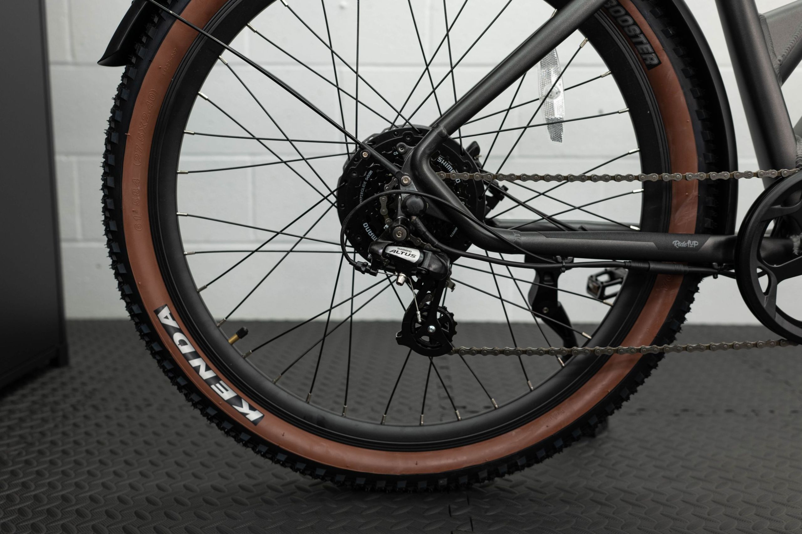

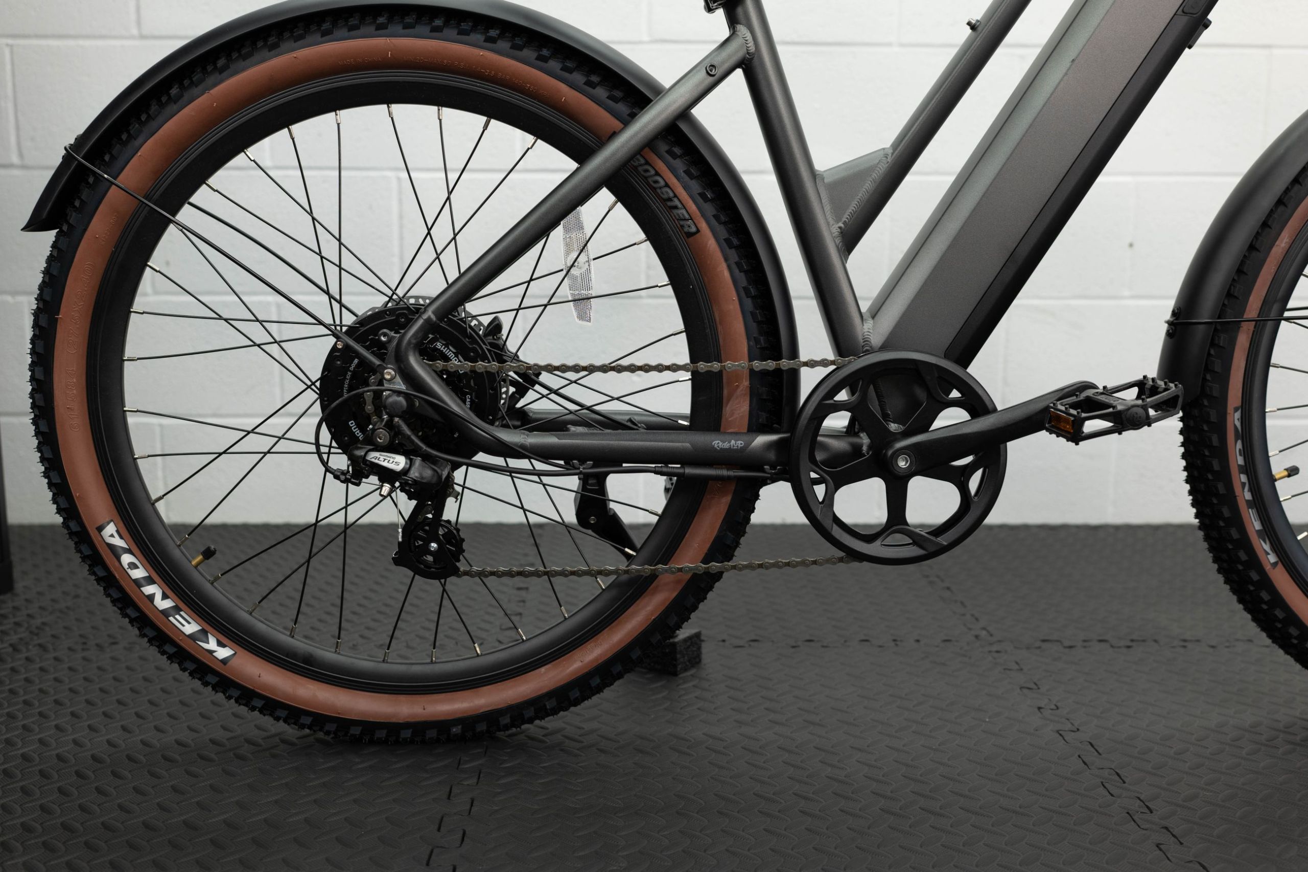

Drivetrain
The drivetrain comprises a Shimano 7-speed 12-32t cassette, 46t chainring, and a TX-30 shifter, which are bottom-tier components. Though shifting is clunky, there is sufficient gearing range to pedal at high speeds.

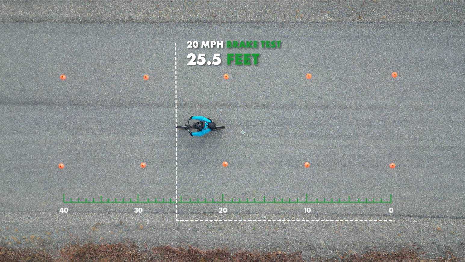

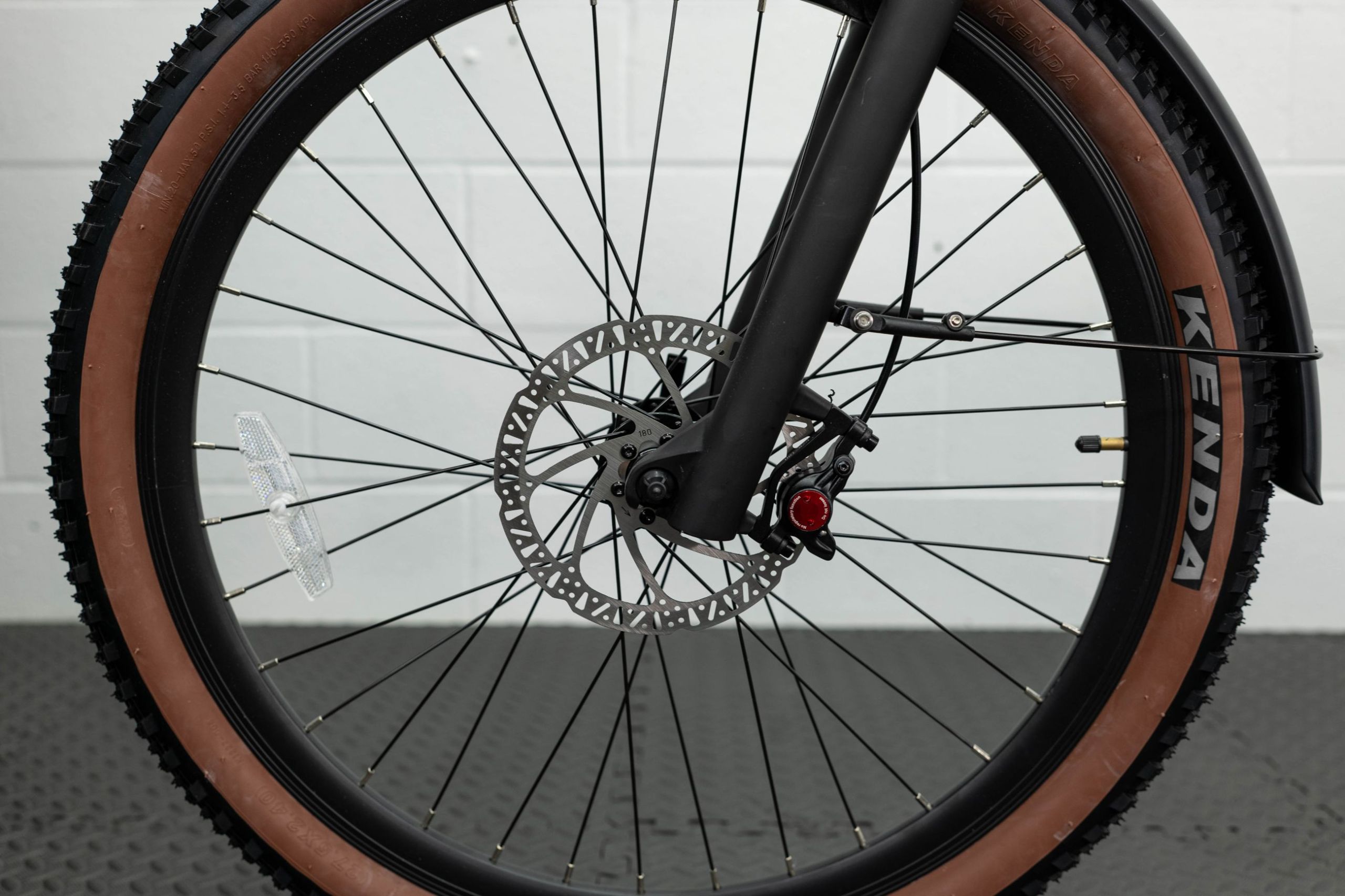

The Turris has Zoom two-piston hydraulic disc brakes with 180mm rotors. As the graphic shows, the stopping distance of 25.5 feet is significantly longer than that of competing models. The rear brake also required a bleed when the bike arrived, as discussed above.
Wheels, Tires
The Turris has a sleek set of 2.4″ Kenda tires with brown sidewalls mounted on 27.5″ rims. These tires roll fast and offer a comfortable ride with plenty of grip for mixed-terrain riding, a good match for the bike’s “adventure” designation.

Grips
The Turris has lock-on rubber grips with ergonomic flares. These are comfortable, offer good grip, and they don’t move around on the bars.

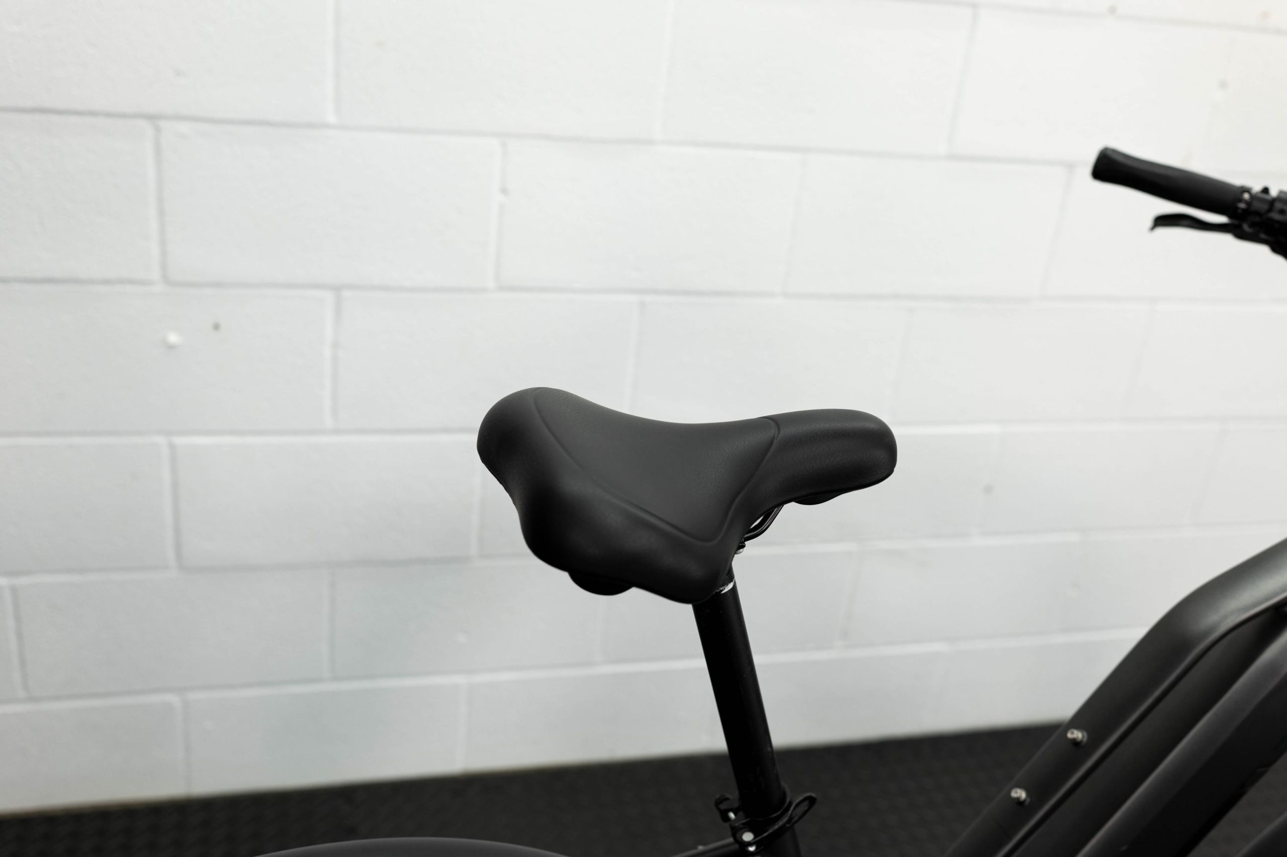

Saddle
The saddle used offers plush padding with polymer springs for added comfort. It didn’t cause any discomfort for me while pedaling or after a long ride.

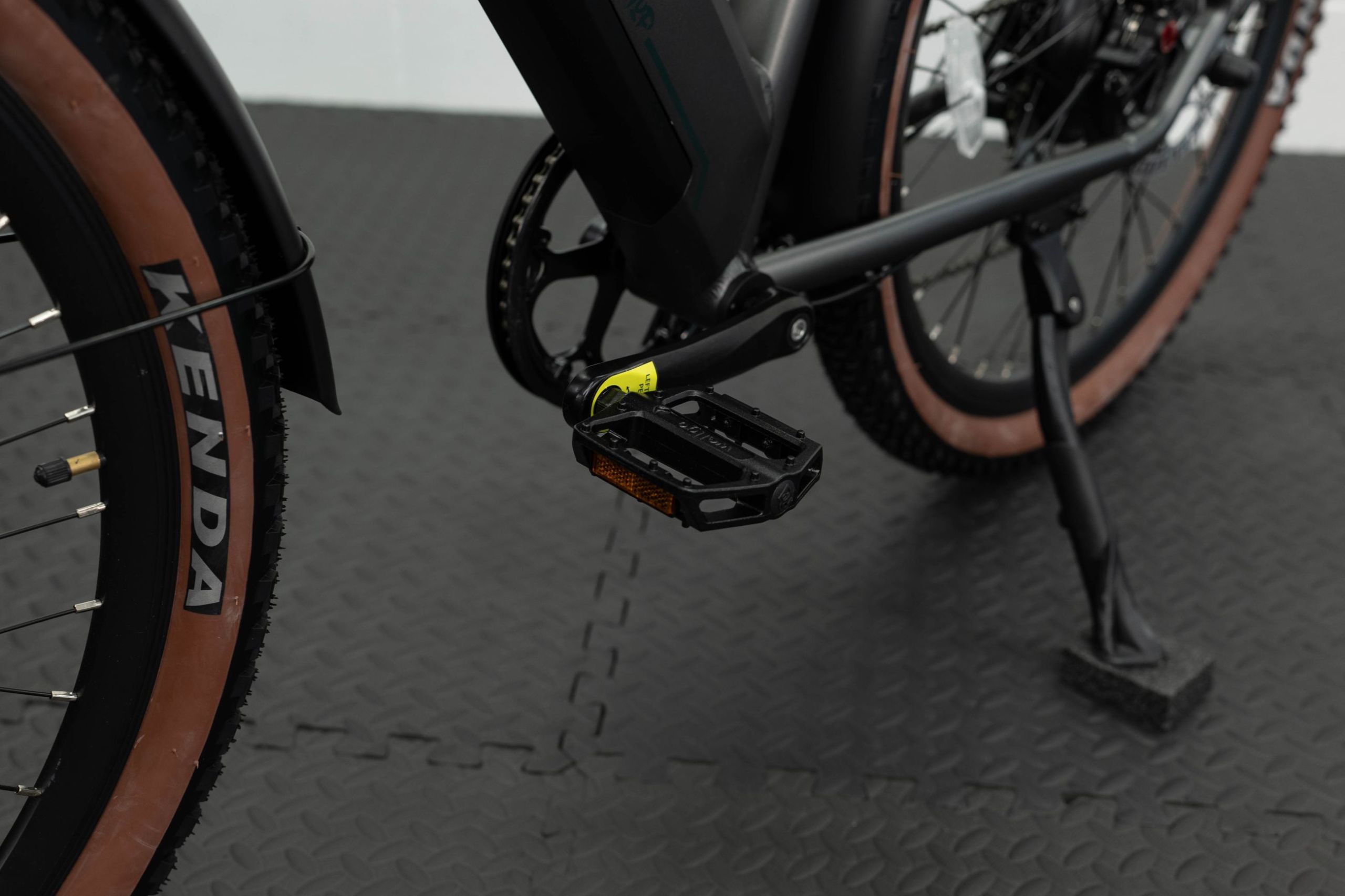

Pedals
The Turris has standard Wellgo platform pedals, which are appropriate for an entry-level bike.
