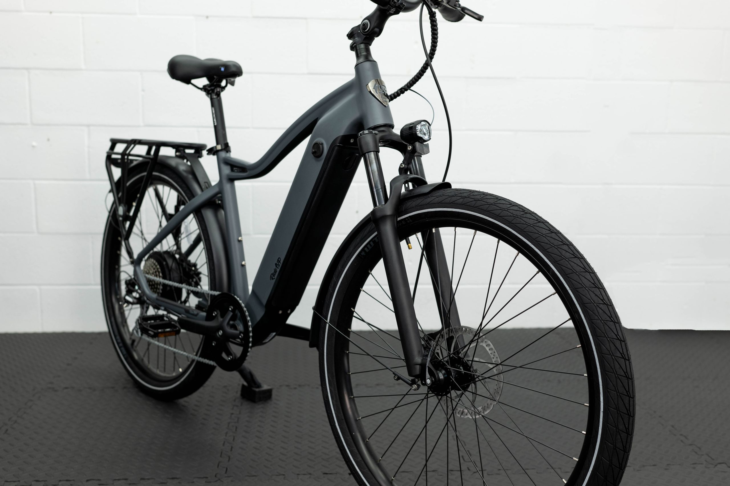

Bike Angle View

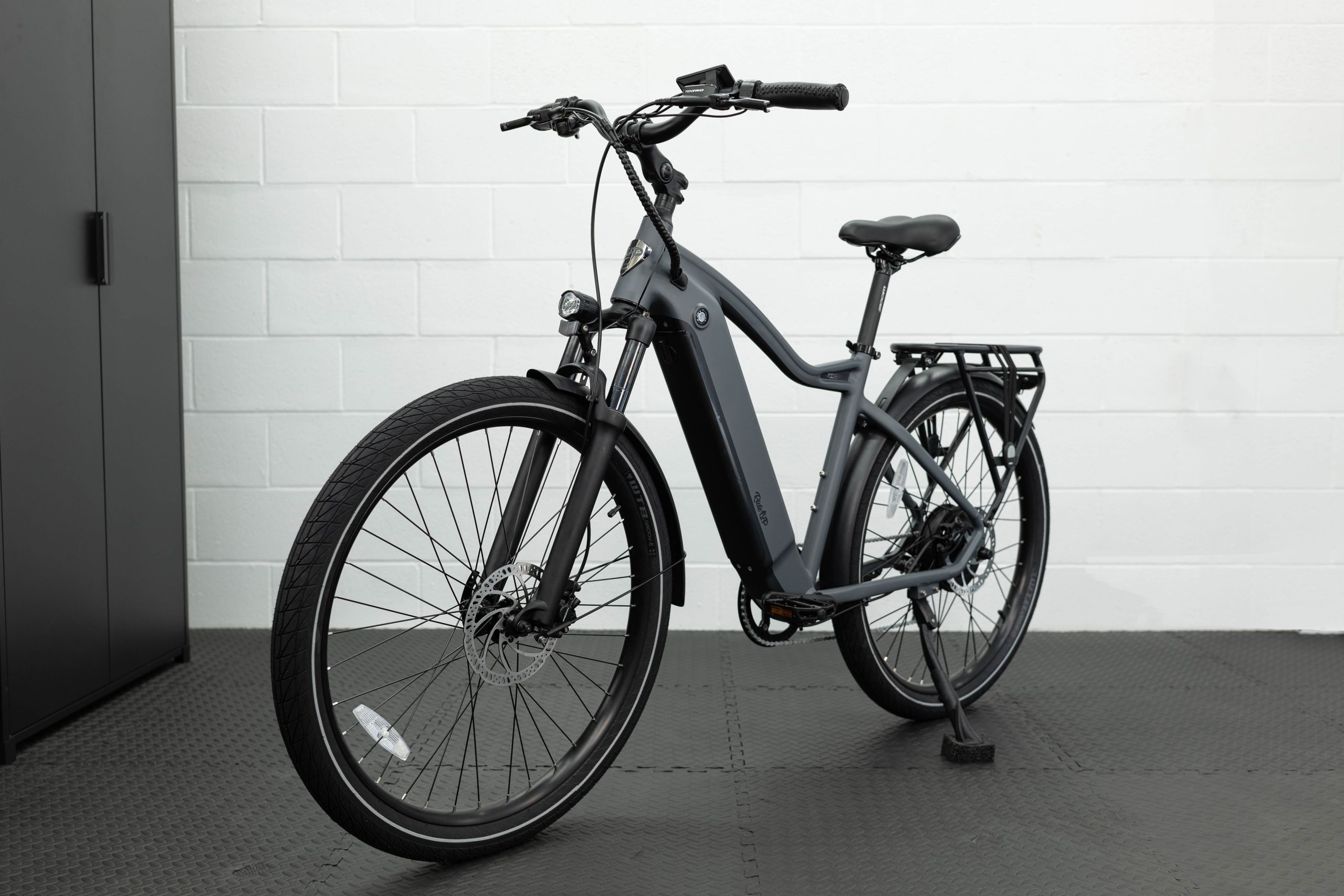

What Is the Ride1UP 700 Series?
The 700 Series is a well-designed commuter bike with components that defy this price point. Tektro hydraulic brakes and an 8-speed Shimano Acera drivetrain are a step above other bikes in the same price range.
In addition, it has a suspension fork and a 500W Bafang motor that propels the bike up to 28mph. The result is a comfortable and powerful commuter e-bike.

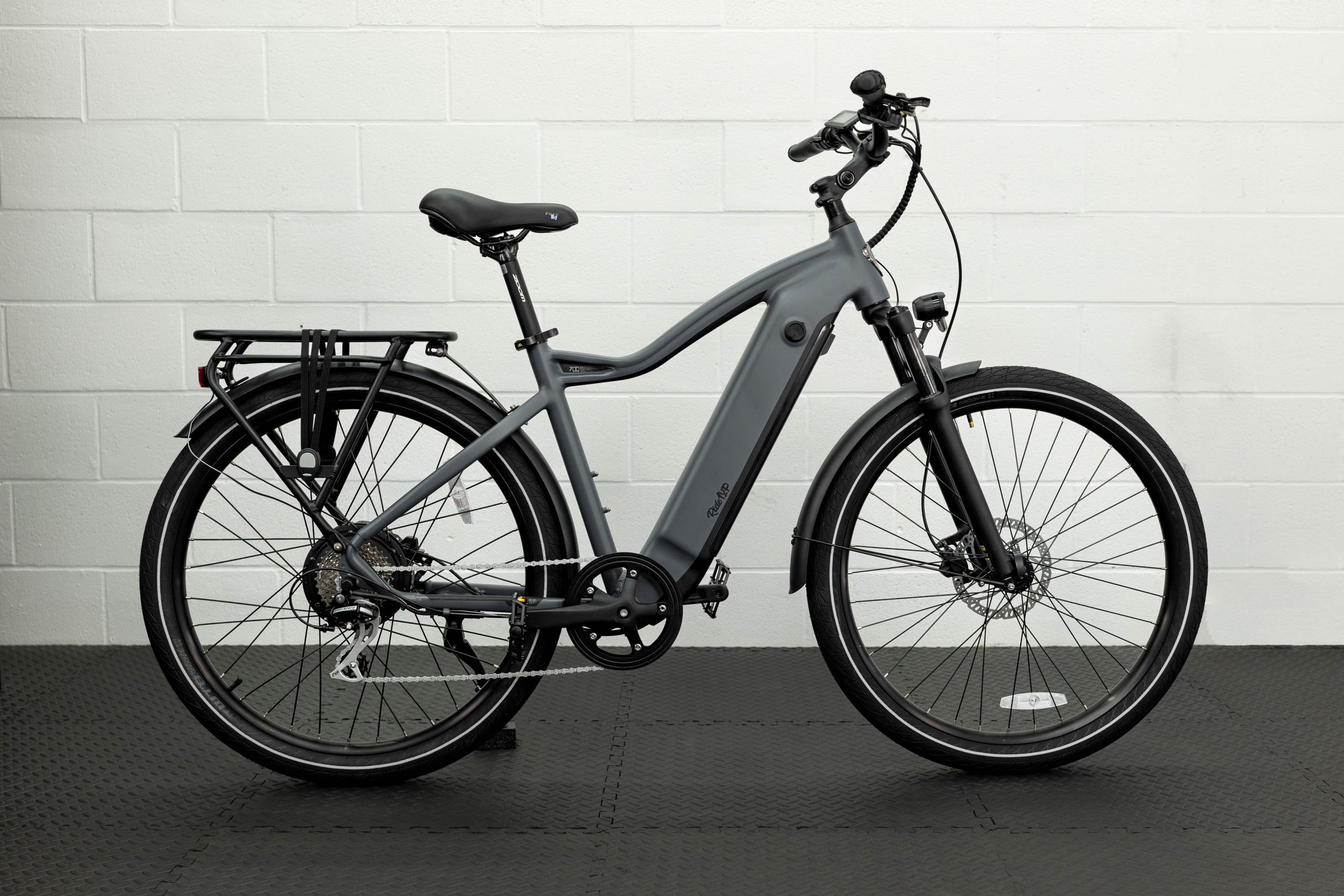

Bike Side View
High Top Speed
The 700 Series is a Class 3 e-bike that can reach top speeds of 28mph. You can save time by zipping along at 28mph instead of the Class 2 limit of 20mph. If you plan to commute full-time on your new e-bike, that extra speed will be a game changer.
Also, you travel much closer to the same speed as cars on low-speed urban roads. Matching the speed of the traffic makes you feel safer.

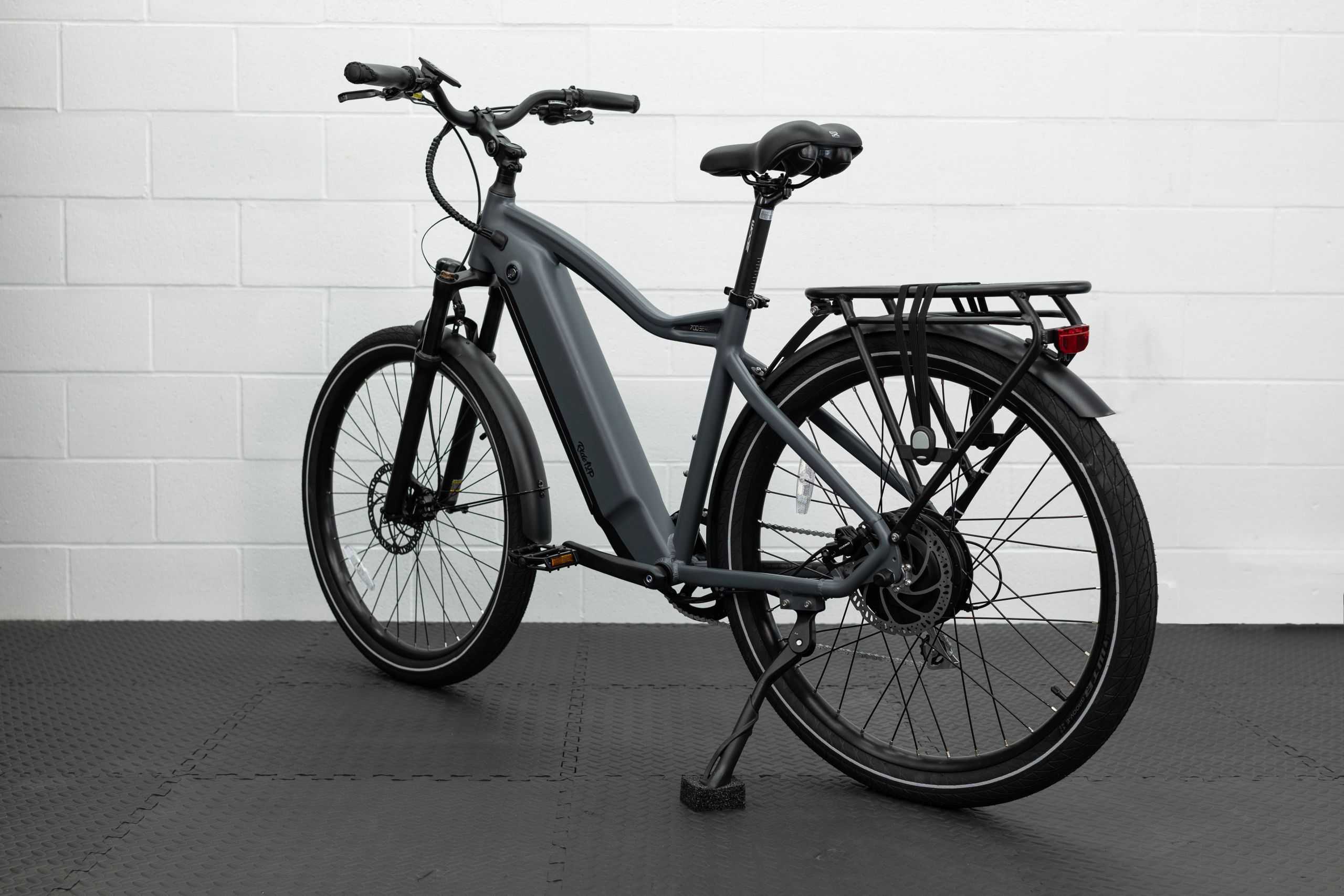

Rear Angle View
Well Priced
The 700 Series is a mainstay in the Ride1UP lineup and has dropped in price since its first release. It offers better value than most similar bikes at this price.
High-quality features like an 8-speed Shimano Acera drivetrain and Tektro hydraulic brakes stand out, and the Zoom suspension fork, lights, and fenders add further value.
The 700 Series is a complete package ready to be ridden and enjoyed as sold.

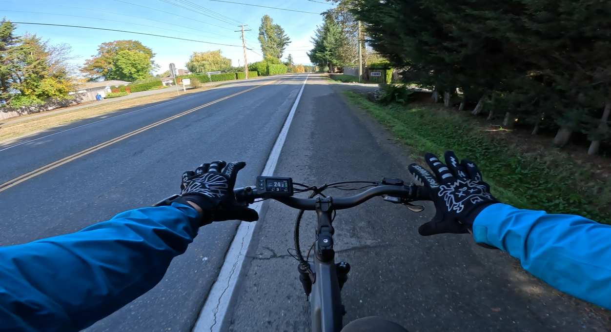

Front Wheel POV

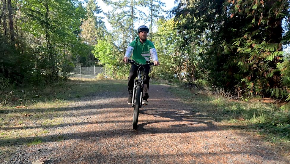

Front Wheel Wobble
During testing, the front wheel was unstable when I wasn’t gripping both handlebars. The bike began to wobble when I released one or both hands from the bars, so this is a two-handed ride only.
While this may seem like a strange con, I thought it was worth mentioning as the two other Ride1UP bikes I’ve reviewed (the Prodigy and Cafe Cruiser) could both be ridden at high speed with no hands on the bars, without this wobble.

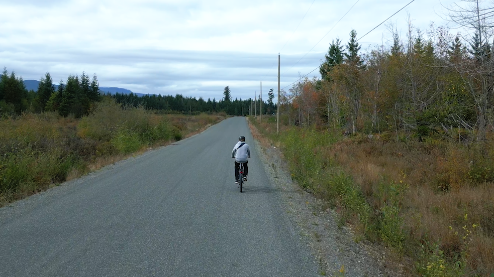

Low Range At High Assist
The 700 Series falls short of Ride1UP’s 30 to 50-mile range estimate, at least on the highest assist level. The 500W motor works hard to push the bike at its 28mph limit, resulting in shorter riding range. Dropping the assist to level three or four would extend the range to hit the claimed range.
The 15Ah battery used is typical for bikes at this price point, but some competitors offer larger 17 or 20Ah batteries for extended range.

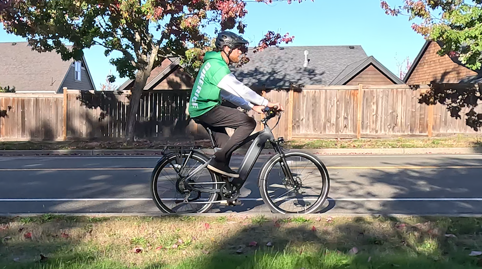

Short Reach
The 700 Series step-over is undersized for me at 6′, despite being listed for heights from 5’0″ to 6’2″. The seat post was long enough, so my legs felt comfortable while pedaling, with no cramping. However, the reach is too short. This meant I was perched on the bike in a cramped position.
Also, while cornering, I felt like I was being pulled over the front. Operating the 700 Series was OK, but the cramped feeling was ever-present.

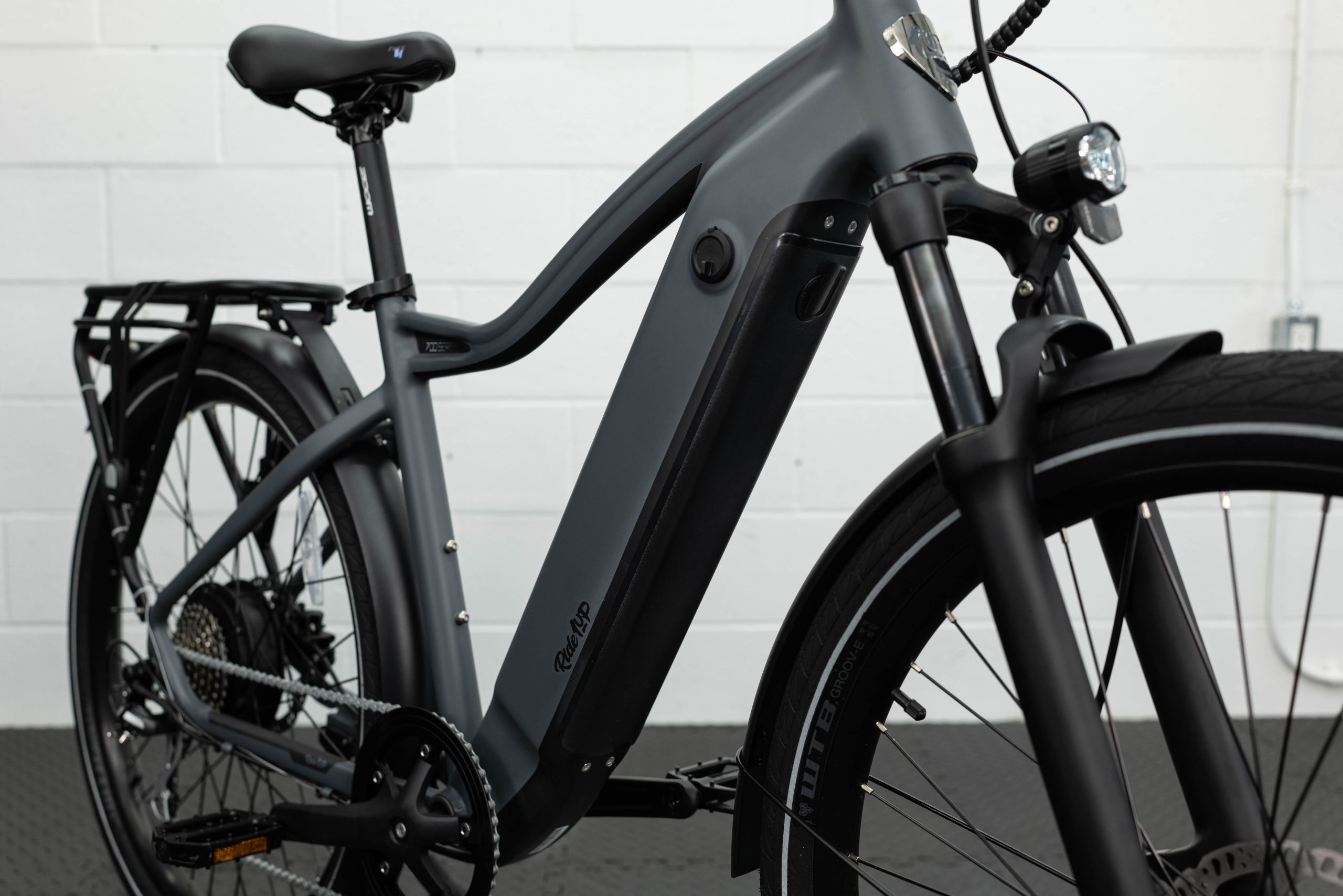

Frame and Geometry
The frame of the 700 Series features a familiar modern shape, with a sloping top tube flared towards the seat to lower the standover height. The battery is integrated into the downtube, and the wiring is neatly bunched and routed internally for a clean aesthetic. Our test model was a step-over, but the bike is also available as a step-through, both of which come in one size.
Again, the short reach of 15″ felt a little cramped for me at 6′. I felt perched on the bike and pulled forward over the front wheel. Despite being relatively comfortable to ride and maneuver, I would have preferred an additional couple of inches of reach.

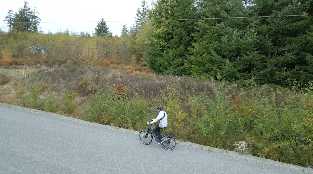

On level ground and moderate gradients, the motor performed well, with lively acceleration and the ability to reach the top speed of 28mph. When faced with gradients over 12%, the motor struggles more than the 500W motors we’ve tested. This limited performance is only an issue on steep gradients.
Acceleration:
  • 0-20mph PAS Max: 9 seconds
  • 0-20mph Throttle Only 13 seconds
  • 0-28mph PAS Max: 20 seconds

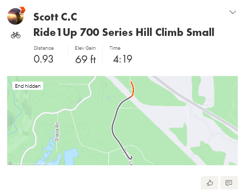

Short Hill Climb Info
Short Hill Climb:
  • Time: 04:19
  • Distance: 0.93 mi
  • Elevation Gain: 69  feet
  • Max grade: 6%
  • Avg Speed:  16.1mph

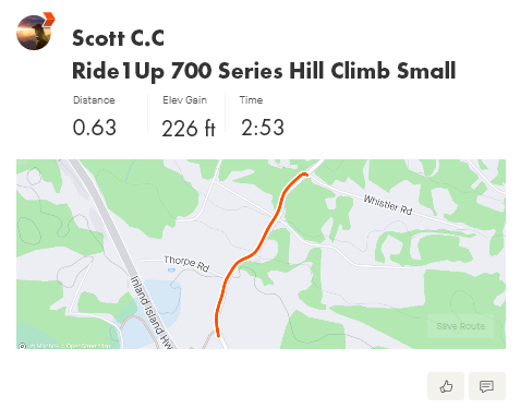

Medium Hill Climb Info
Medium Hill Climb:
  • Time: 02:53
  • Distance: 0.63mi
  • Elevation Gain:  226 feet
  • Max grade: 16%
  • Avg Speed:  13.2mph
Large Hill Climb: Not Completed

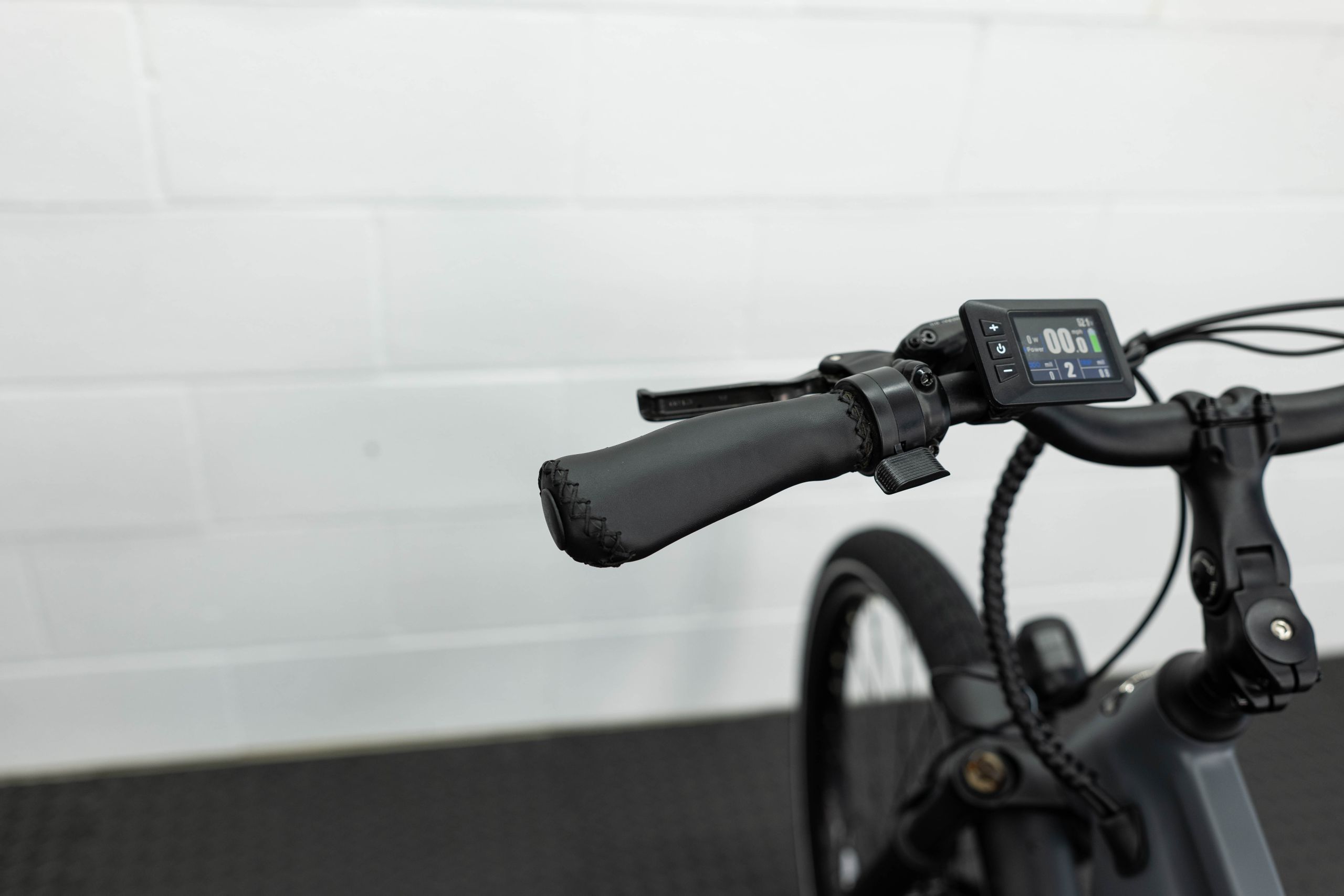

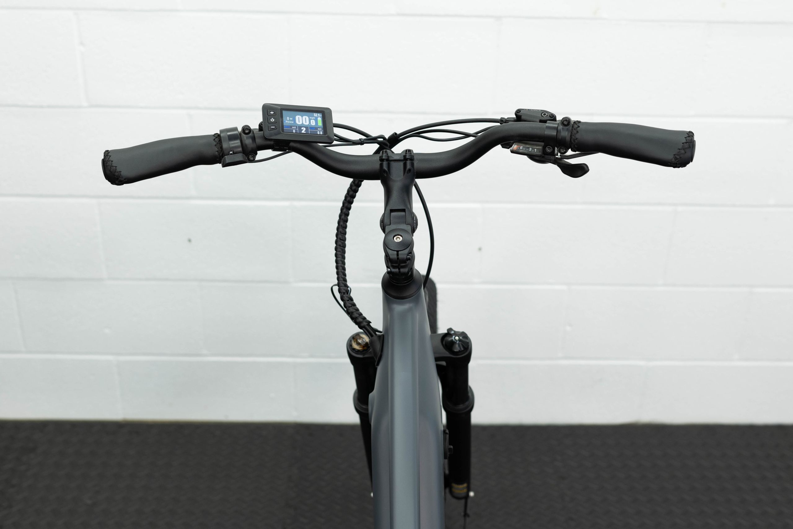

Cockpit
Cockpit and Control
The cockpit consists of a standard set of riser bars and an adjustable stem. The stem allows 60 degrees of adjustability to create a more upright or aggressive position.
The control pad is easy to use, and the bright color display is easy to read. Some advanced features are accessible through the display, such as modifying the PAS levels and displaying the battery level as a voltage or percentage.
Overall, the 700 Series is simple to control, and the cockpit includes all the standard controls with some room left over to add a phone mount or rearview mirror.
Battery on Bike

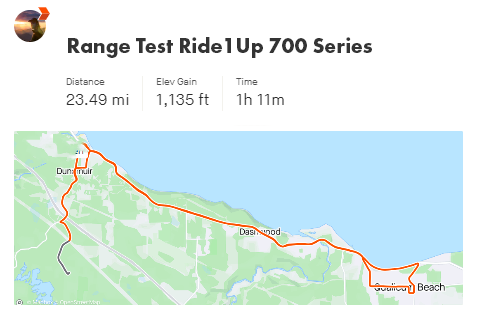

Battery
The 700 Series has a 48V 15Ah (720Wh) battery, a typical size for commuter bikes at this price point. The battery can be charged on the bike or removed for charging.
The battery performs well with a reasonable 24-mile range at max pedal assist. The high top speed of 28mph on this Class 3 bike means you can quickly eat through the charge when zipping along. Holding back on the assist will extend the range.
Range Test
Range Test:
  • Distance: 23.49 mi
  • Time:  1: 11
  • Elevation: 1,135  feet

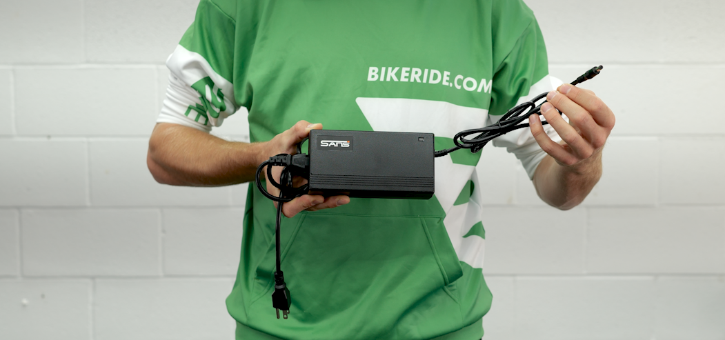

Charger
Ride1UP provides a basic 2A charger. This returns a relatively slow charging time of roughly eight hours from empty.
The battery is removed from the bike by inserting the key and turning to release the lock. The unit has a small knob at the top that you must twist in order to remove the battery from the frame entirely.
To install it again, insert it into the frame and click it into place; no key is required for installation. The battery can be charged while installed on the bike via the external charging port, which is protected by a plastic cover. Alternatively, remove the battery and charge it separately.

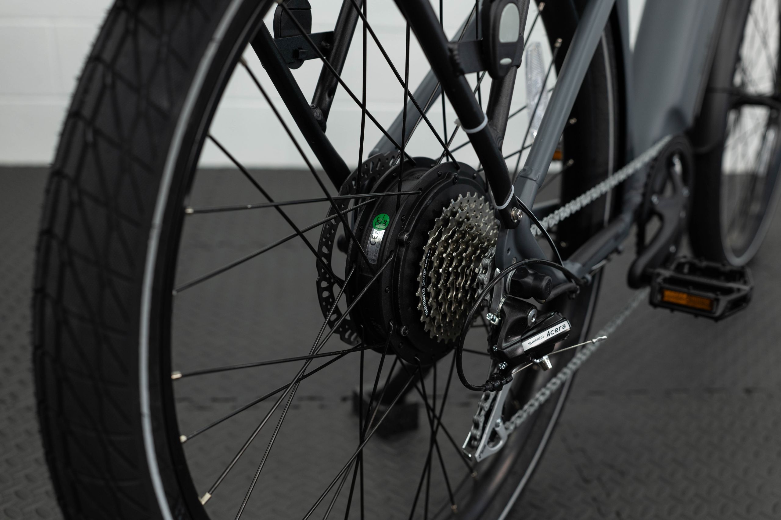

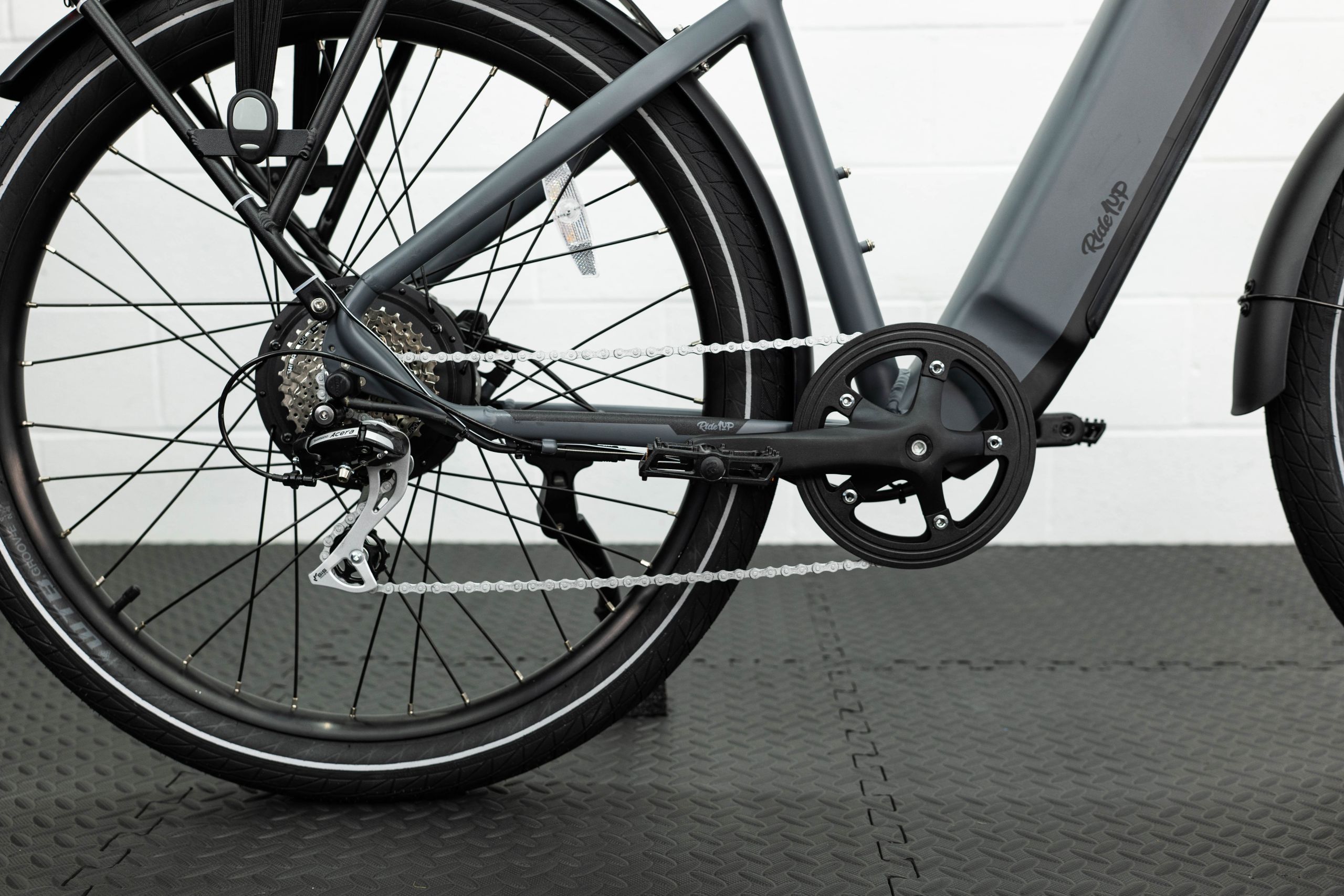

Drivetrain
Drivetrain
We have a nice little upgrade on the drivetrain, as we see a Shimano Acera 8-speed drivetrain with a 45t chainring, an 11-30t cassette, and trigger shifters.
Most e-bikes in the same range offer a 7-speed Tourney setup or mixed drivetrain. Acera shifts better than Tourney, and the additional gearing range makes it easier to find the perfect pedaling cadence. The 11-30t is a step up from the 7-speed 14-28t cassette.

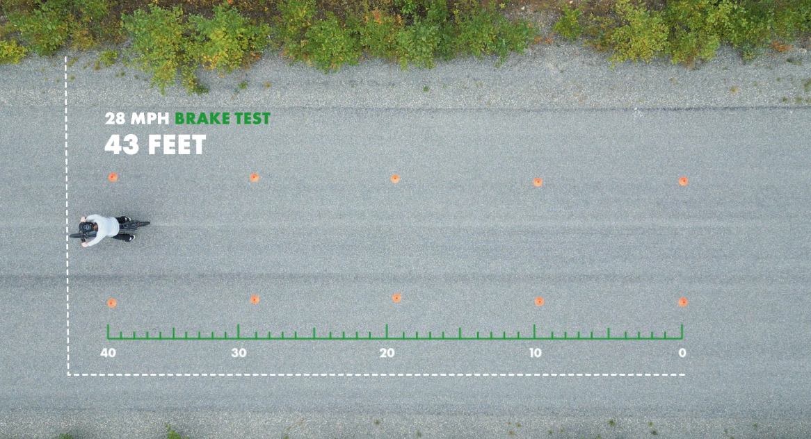

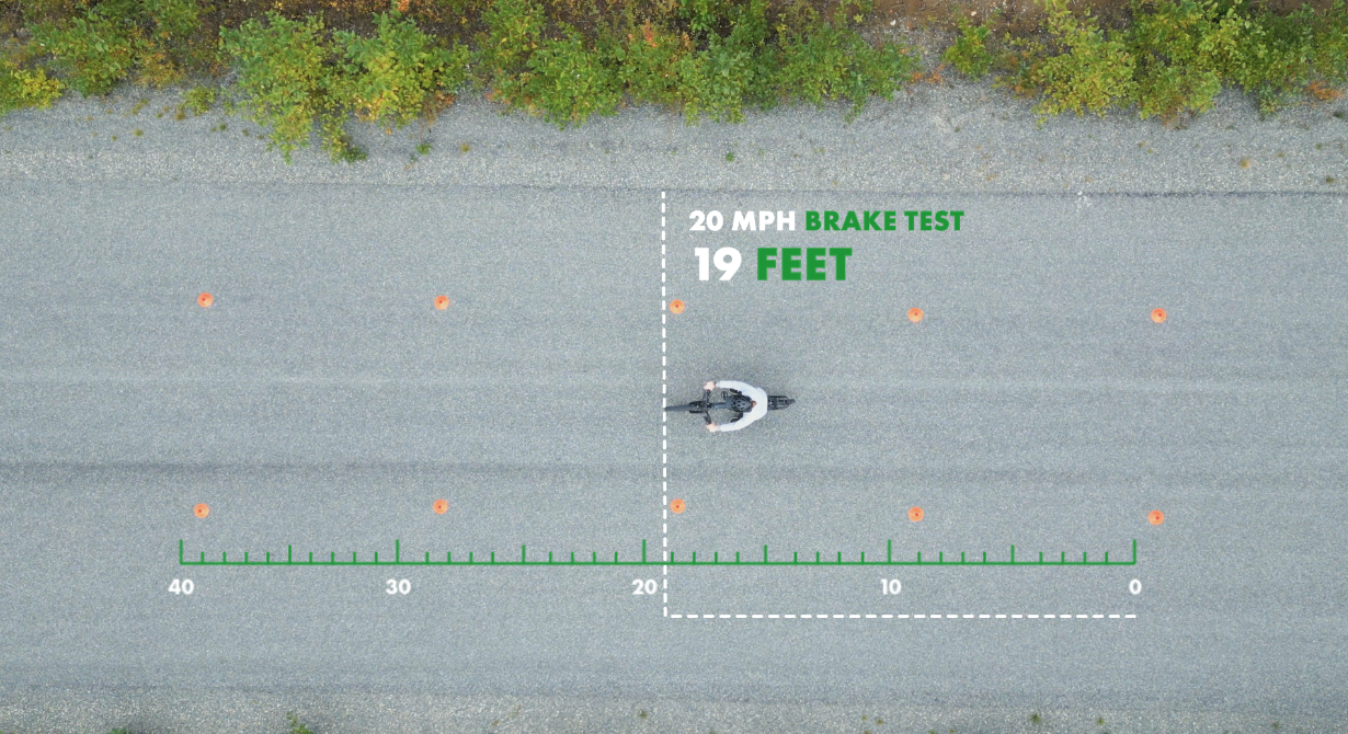

The 700 Series features Tektro E-350 dual hydraulic brakes, another above-average component at this price. It’s a great setup, with 180mm rotors, a pleasant lever feel, and good stopping power.
This brakeset performs well and is suitable for high-speed, heavy e-bikes, so we’re happy to see it on the 700 Series.
Braking Distance Results
Braking Test 20 mph
20 mph:  19 feet
Braking Distance 28mph
28 mph:  43 feet

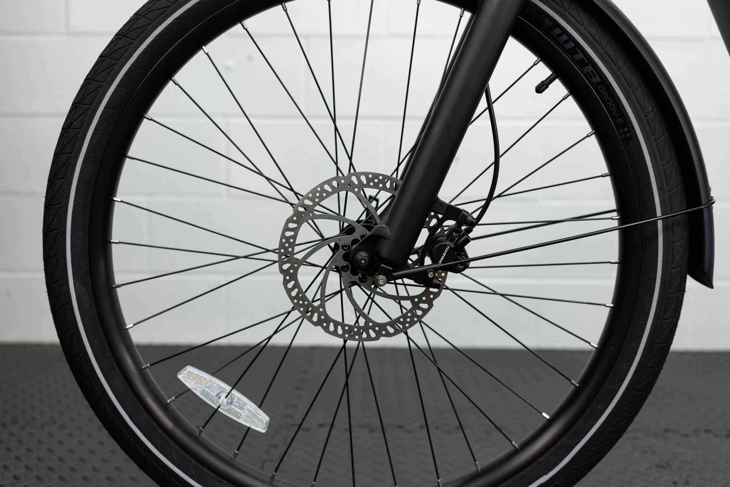

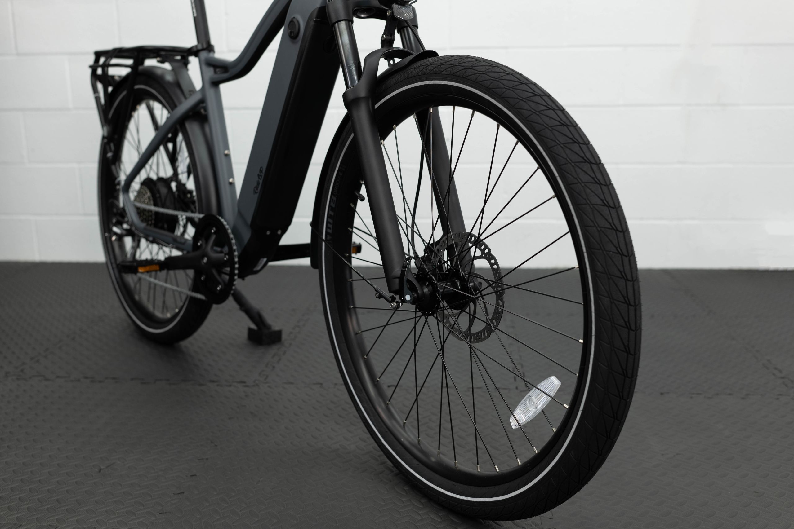

Wheels
Wheels, Tires
The 700 Series uses 2.4″ WTB Groov-e tires on 27.5″ 32mm alloy rims. This tire width balances comfort and performance, while the 27.5″ rim is easy to maneuver and faster than 26″ rims.
The 2.4″ tires have a slick urban tread that performs well on hard-packed surfaces and is slim enough to fit most bike racks, unlike fat tires. They also have enough volume to absorb bumps and can be tweaked to find the perfect tire pressure for your different terrain.

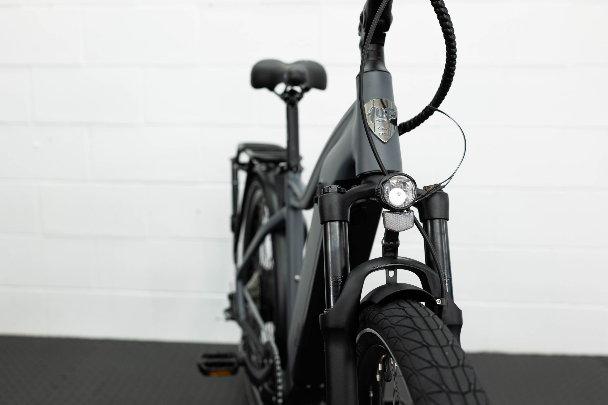

Front Light
Safety
The 700 Series has front and rear lights and reflectors for visibility, so it’s ready to ride at night. Both brakes also feature motor inhibitors that cut power to the motor as soon as you squeeze the levers. This works for throttle and PAS and is a nice touch, as there can be a lag in the motor disengaging on cadence sensor bikes.

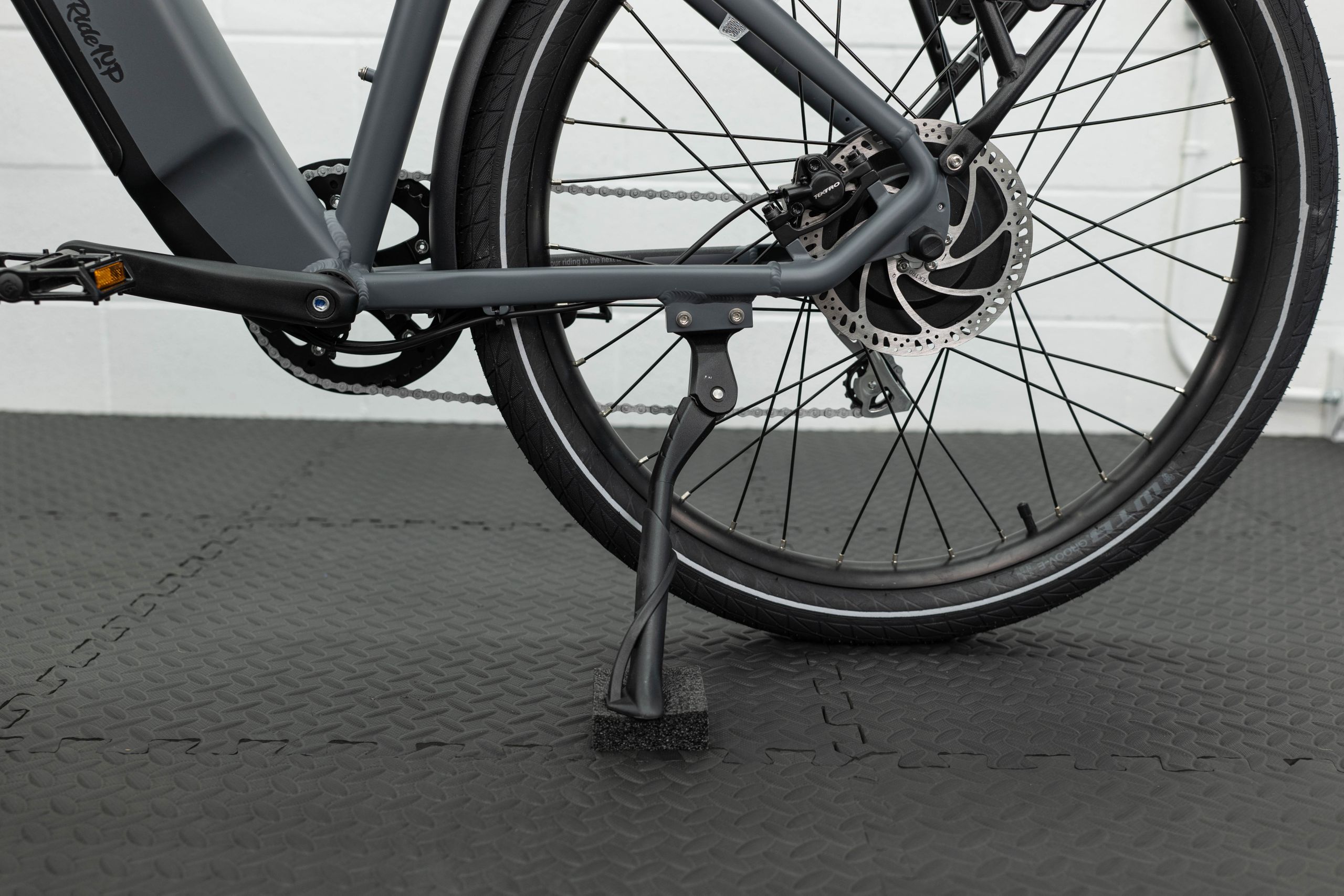

Kickstand
Kickstand
The 700 Series features a standard single-sided kickstand, which is perfectly functional and offers no issues when riding.

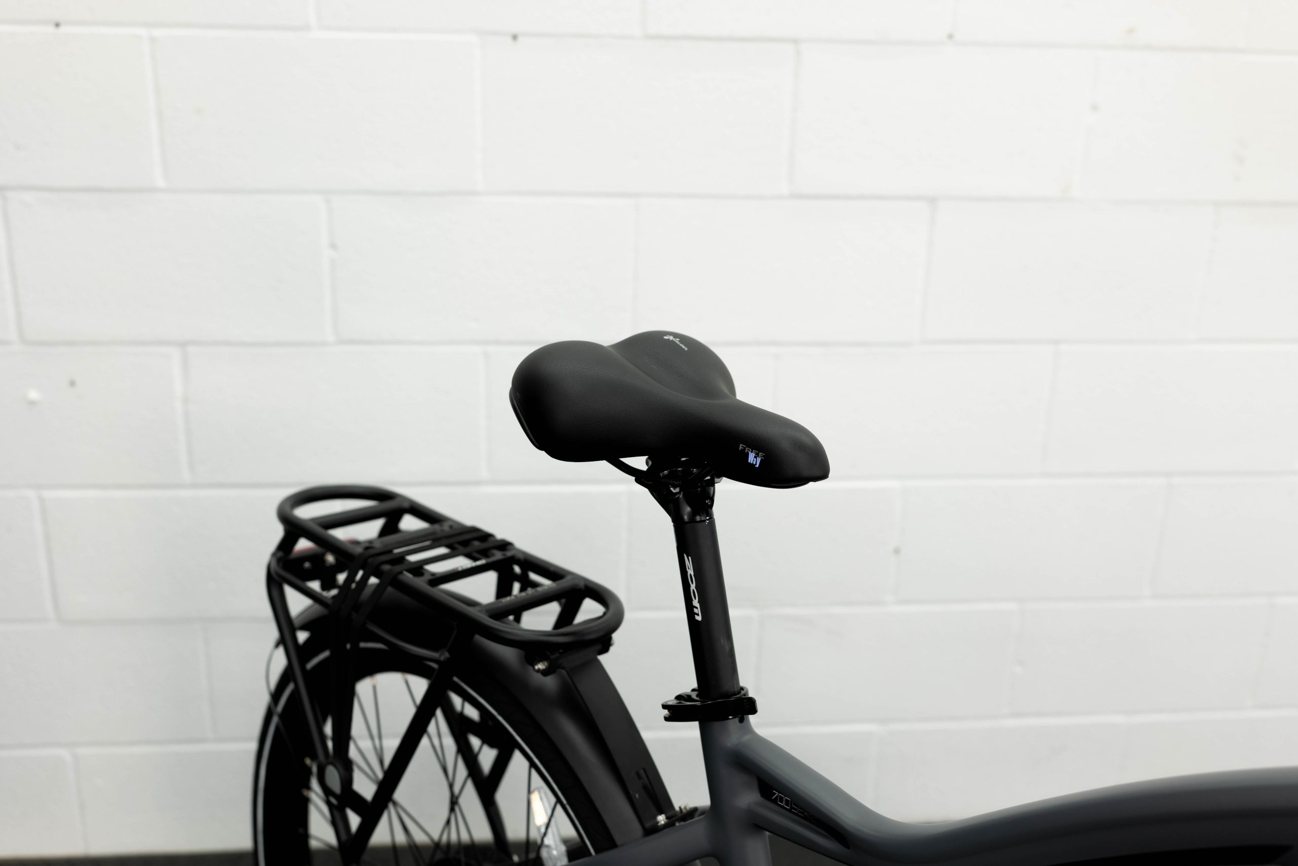

Saddle
Saddle
The 700 Series has a Selle Royale Freeway saddle. It’s relatively wide (but not enough to impact pedaling) and has polymer springs. It was comfortable for our 24-mile range test.

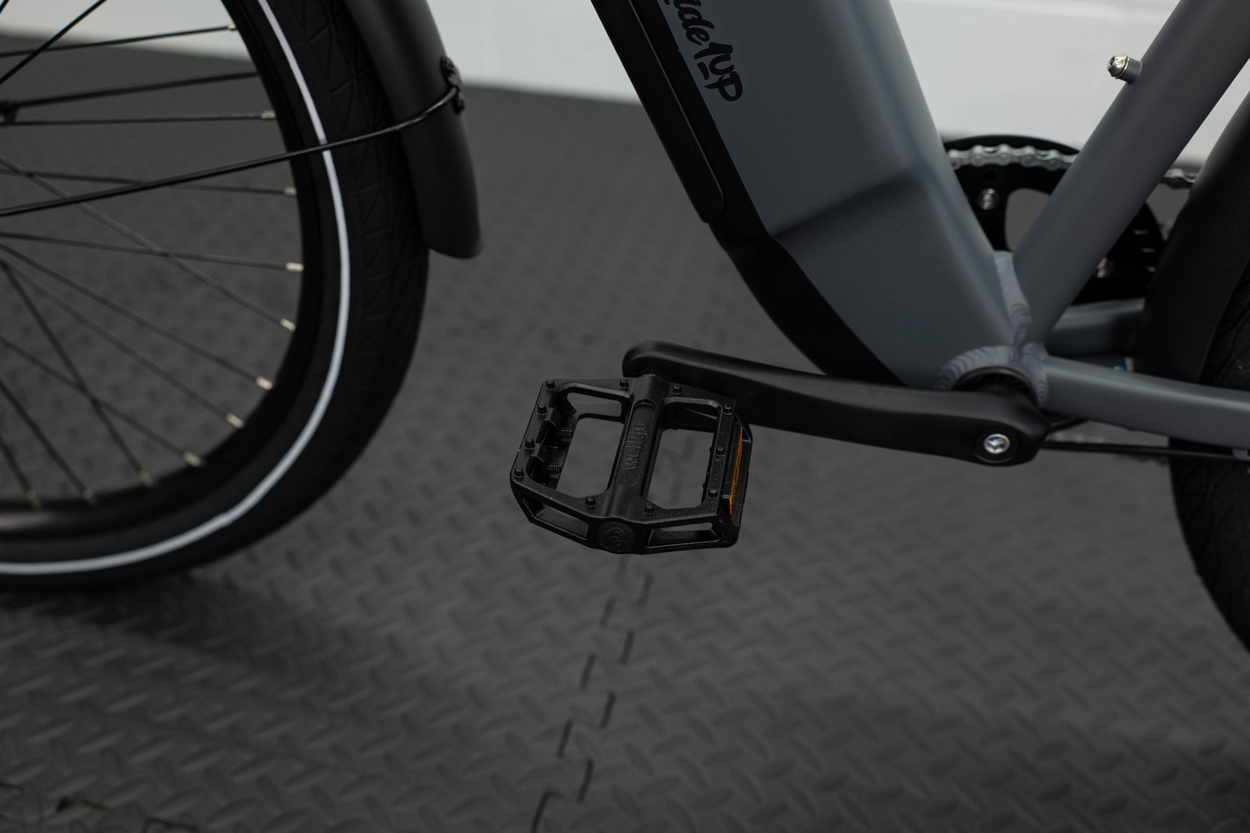

Pedals
Pedals
This bike has a standard set of Wellgo platform pedals. These are perfectly fine to get you out riding, and the pegs offered reasonable traction and support. I see these pedals on many e-bikes, and they offer good entry-level performance.
