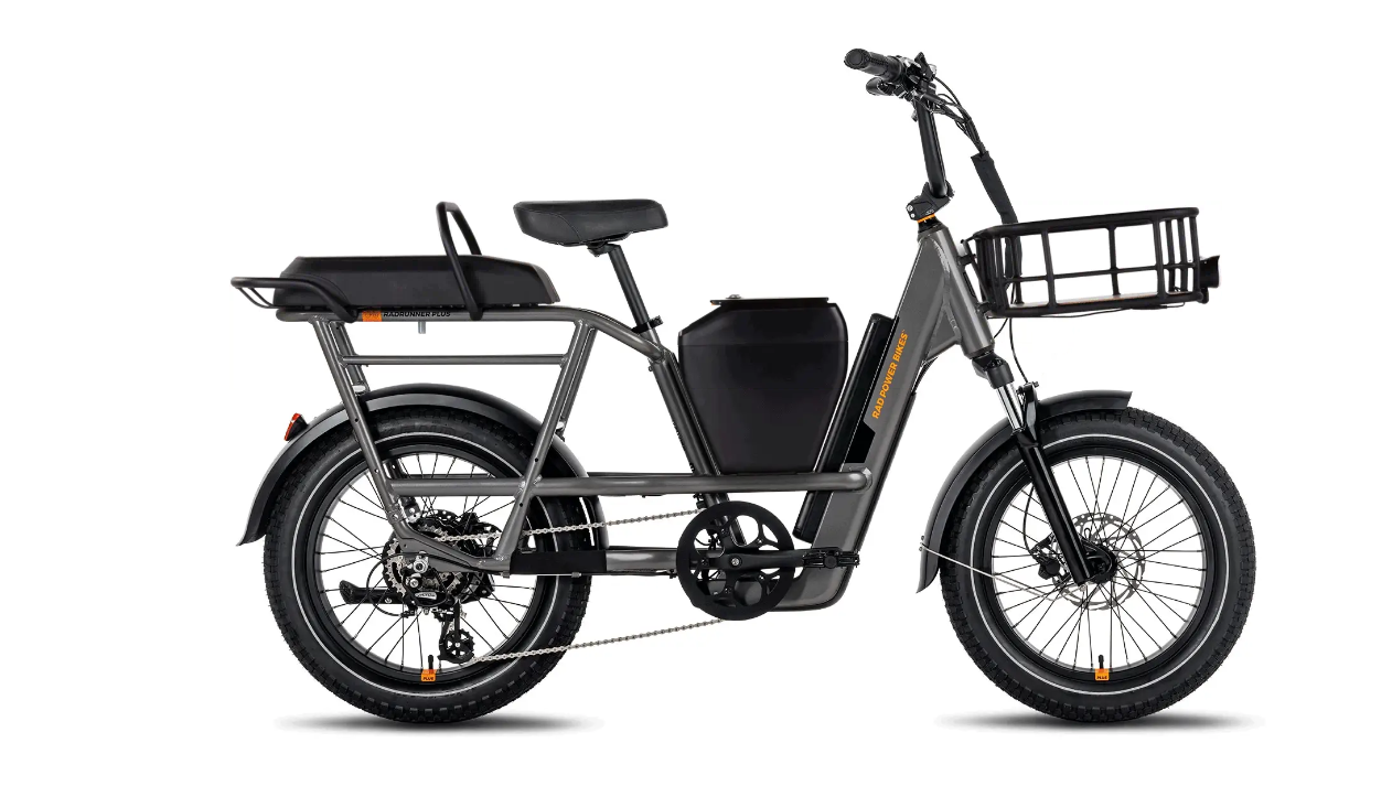

The Rad Power Bikes RadRunner 3 Plus is an electric utility bike designed for versatility. A 120lb-capacity rear rack gives owners plenty of options for cargo carrying, with space for a passenger. Powerful hydraulic brakes and smooth motor assistance help riders stay in control with heavy cargo on board. At this price point, reviewers would like to see a higher-tier drivetrain with more gears. To some testers, handling felt unwieldy next to comparable e-cargo bikes. However, the bike wins praise for its customizability, versatility, impressive electronics, and comfortable ride feel.

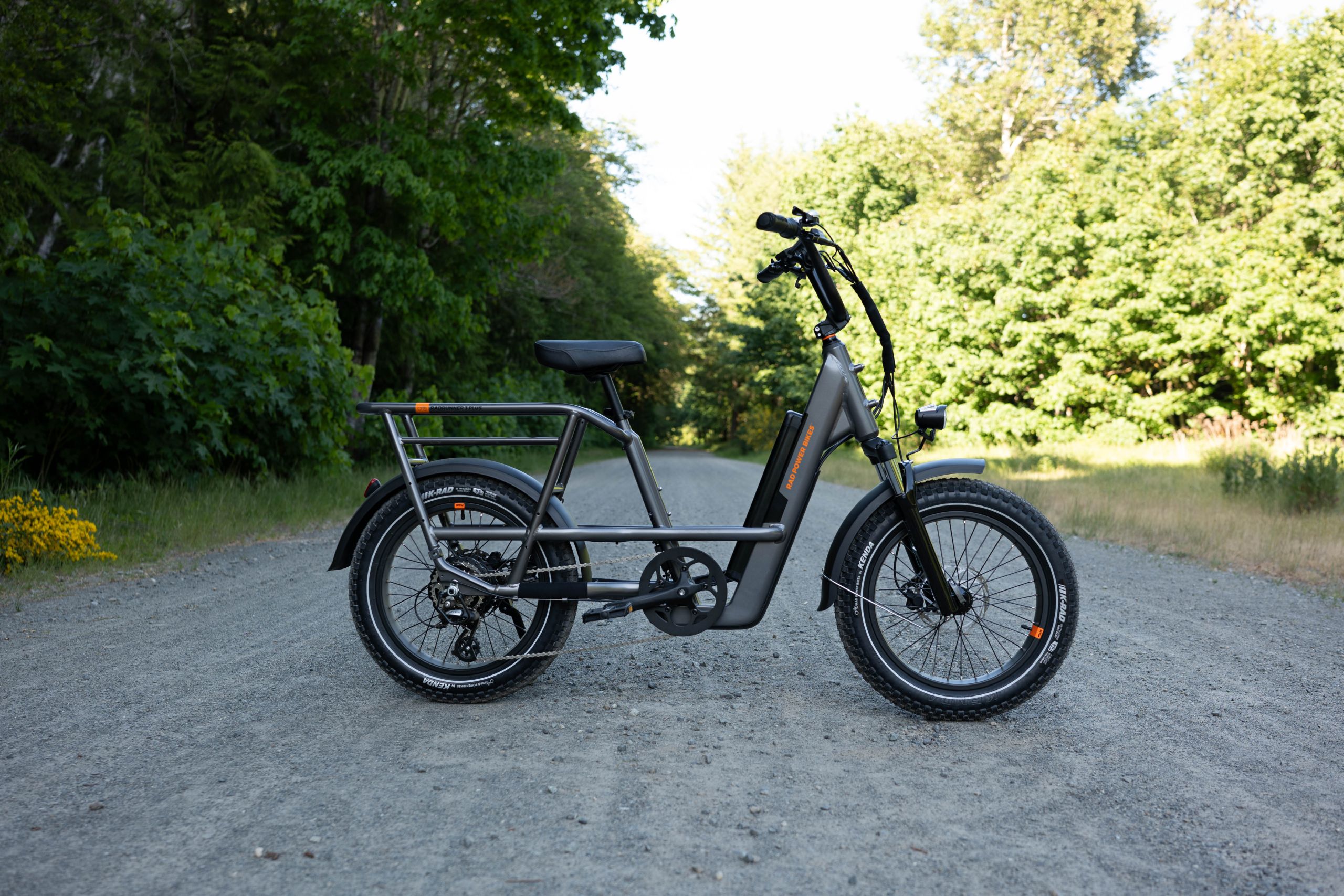

If you are in the market for a utility-style e-bike, you have probably heard of the name Rad Power Bikes, and rightly so. They have been in the game since 2015, when the first Rad Power branded bike, the RadRover electric fat bike, was released. Now, with nine different models to choose from, we are narrowing it down to take a look at one specific bike, the RadRunner 3 Plus.
Rad Runner Side View
It’s truly a workhorse, with an impressive number of attachment points and accessories available. We had to choose a few and see what this utility-style e-bike is really capable of. Rad Power claim great range and peppy performance, all packed into a nicely crafted package.
A large 350 lb weight capacity rounds out the specs, leaving us scrambling to pack up some gear and see just how far this bike can go! It’s time to see if the RadRunner 3 Plus is up for the challenge. Let’s go ride some bikes!

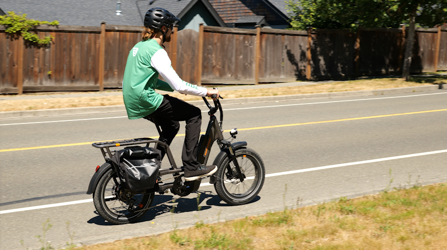

The RadRunner is fun because it’s so easy to use. With a great step-through design, it’s very convenient to get on. After you hop on, a well-laid-out cockpit with easy-to-see-and-use controls welcomes the rider. The straight-backed riding stance is comfortable and the seat offers nice cushioning.
When you get under power you will find the bike cruises very nicely. Despite its lack of rear suspension, the small 60 mm suspension fork and general geometry of the bike do a great job eating up small bumps in the road. I was pleasantly surprised while riding, as to how comfortable the bike is on rougher terrain such as gravel and dirt roads. The larger 3.3” tires float well in loose gravel, and level out uneven paths.
Other features, like the easy-to-remove battery with ten-bar indicator, make the bike very approachable, and ensure you have a good experience whether you are riding or not.

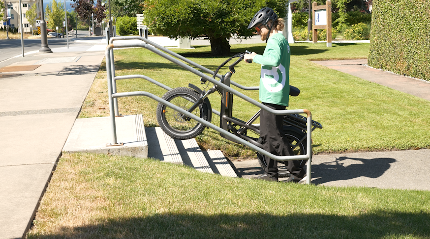

Heavy to Lift and Maneuver
The RadRunner 3 features some heavy-duty construction, and tires that can be considered ‘plus’ or ‘fat’ at 3.3″ wide. This results in a heavy 75 lb package, and with those wide tires it needs a little extra room on the bike rack. This should be taken into consideration by the main audience for this bike: recreational riders, commuters, and those looking to replace a car and use this for cargo hauling or errands.
The heavy overall size means it’s hard to get up stairs or to lift vertically. While possible, it’s not the easiest, and this should be taken into consideration. Those large tires also limit your options for bike racks. So, commuters be careful, and ensure you have ample storage on both sides of your trip, as well as if you need a ride in the middle.

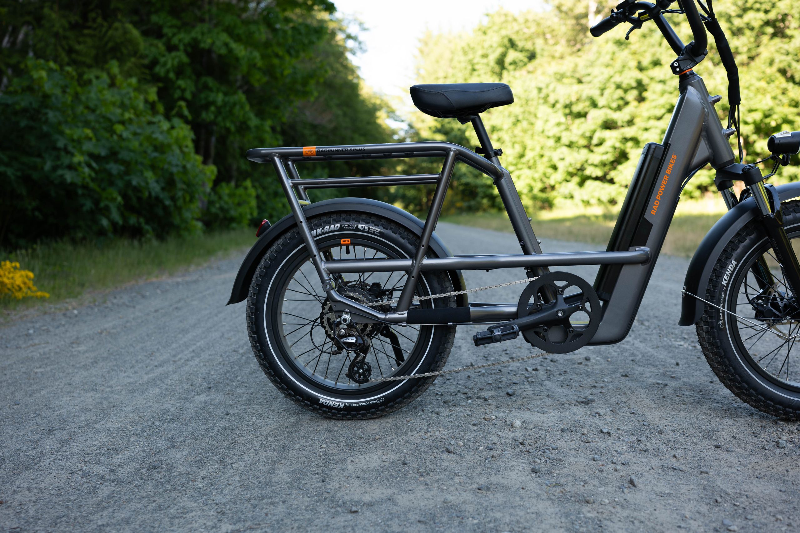

Rear of Bike

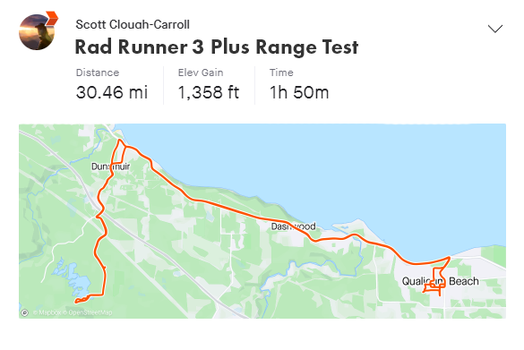

Range Tested: 30.46 mi @ Assist Level 5

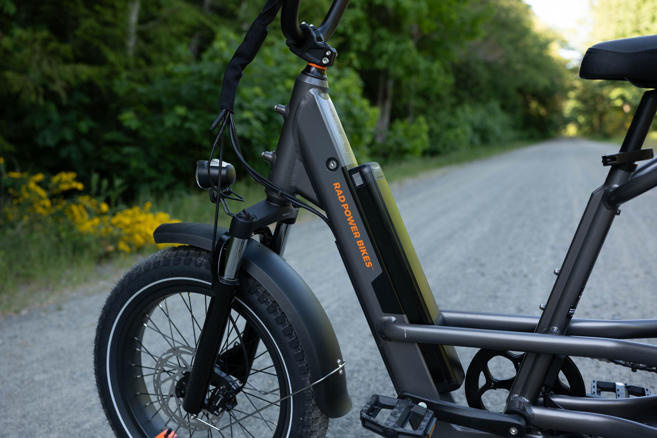

Frame
Frame and Geometry
We have a wonderful-looking and highly functional frame on the RadRunner 3, featuring a low standover height and easy mounting with that deep step-through. The center of the frame can also easily accommodate one of the cool center consoles from Rad.
The battery is wonderfully placed, and its partial integration into the frame makes for a clean look and very easy access. Moving towards the rear of the frame, they have managed to give this bike an excellent cargo capacity.
They’ve created a robust frame with some nicely connected tubing and a fully integrated rear rack. This rear rack can accommodate 120 lb so you can easily have a second person or a ton of gear along for the ride.
I was impressed by how robust and easy to approach the RadRunner is. It is shockingly comfortable to ride, for a heavy hardtail. They have done a good job of using the geometry and attack angle of the front fork to minimize jostling over bumpy roads, and combined with the plush seat the bike is comfortable to ride.

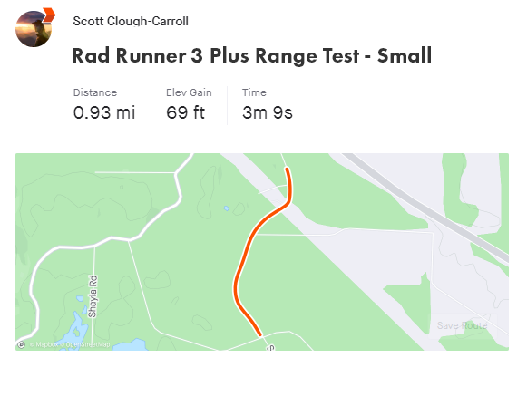

Small Hill Test
Short Hill Climb:
  • Time: 03:09
  • Distance: 0.93 mi
  • Elevation Gain: 69 ft
  • Max grade: 6%
  • Avg Speed:  18 mph

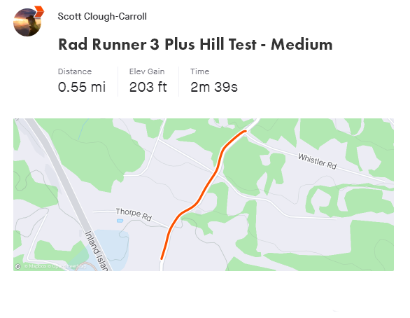

Medium Hill Test
Medium Hill Climb:
  • Time: 02:39
  • Distance: 0.55 mi
  • Elevation Gain: 203 ft
  • Max grade: 16%
  • Avg Speed: 12.6 mph

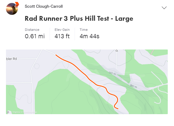

Large Hill Test
Large Hill Climb:
  • Time: 04:44
  • Distance: 0.6 mi
  • Elevation Gain: 2413 ft
  • Max grade: 20%
  • Avg Speed: 8 mph

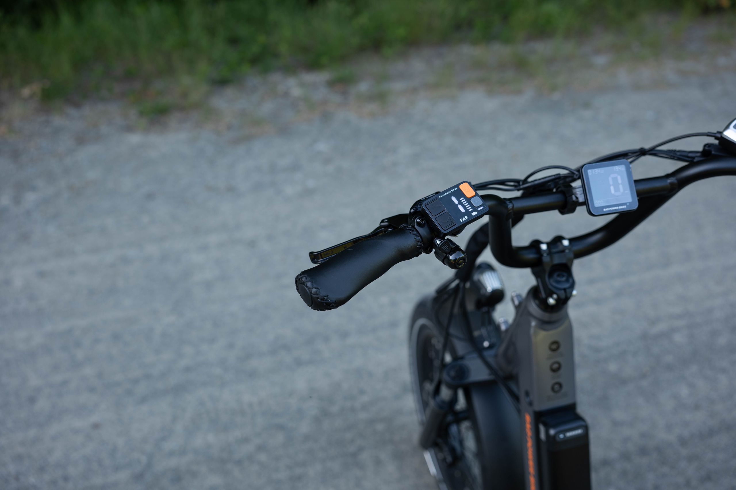

Cockpit and Control
A first look into the cockpit reveals not one, but two control screens displaying information, with a 1.5” secondary LCD screen showing your current assist and battery levels and a larger center LCD screen providing you with information about your current speed, trip, and time. The small control pad is well-marked, and the buttons are nice and clicky.
Tektro hydraulic levers are pleasant for braking and a nice choice for the RadRunner 3 Plus. Rounding out the cockpit, we have some less-expensive faux leather grips (not my favorite as they’re non-locking and can twist) and a budget Shimano SL-TX50 thumb shifter.
Overall, the cockpit is pleasant and easy to use, with the best part being the easy-to-use-and-see controls and screens. The Tektro levers are also a wonderful component and these compensate for the underwhelming shifter and grips.

On paper, the 48V 14Ah [672Wh] battery may not seem like the largest. But after it threw down a range test matching the company’s specs, with over 30 miles at 20 mph, it was a different story.
It’s a great range that could easily be extended by lowering that assist level, something that’s made easier because this bike is actually fairly pedal-efficient. The battery uses good cells from either Samsung or LG, depending on the current sourcing.
Range Test Rad Runner

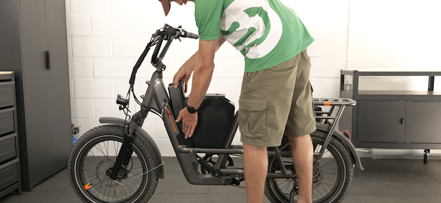

Battery and Key Access
Charging and key access are very simple. Sporting a partially-integrated battery, it’s easy to spot, but still works with the aesthetics of the bike. The keyhole and charging point are right next to each other at the top of this battery, making them easy to find and use!
After turning the key the battery pops right out, and it’s easy to remove and insert, even with the attached center console. Plus, if you want to charge while on the bike, just pop off the rubber cap on the charge port and plug in.
Drivetrain
The 1×7 Shimano drivetrain is nothing special, but it’s well-matched to the bike’s capability with an 11-34T freewheel. The bike only has a small amount of ghost pedaling at top speed, so the gearing is a fine choice. The Shimano thumb-style shifter is a budget item but it’s functional and easy to use. This drivetrain is pretty basic yet perfectly functional, so it’s not getting any complaints from me.
Drivetrain

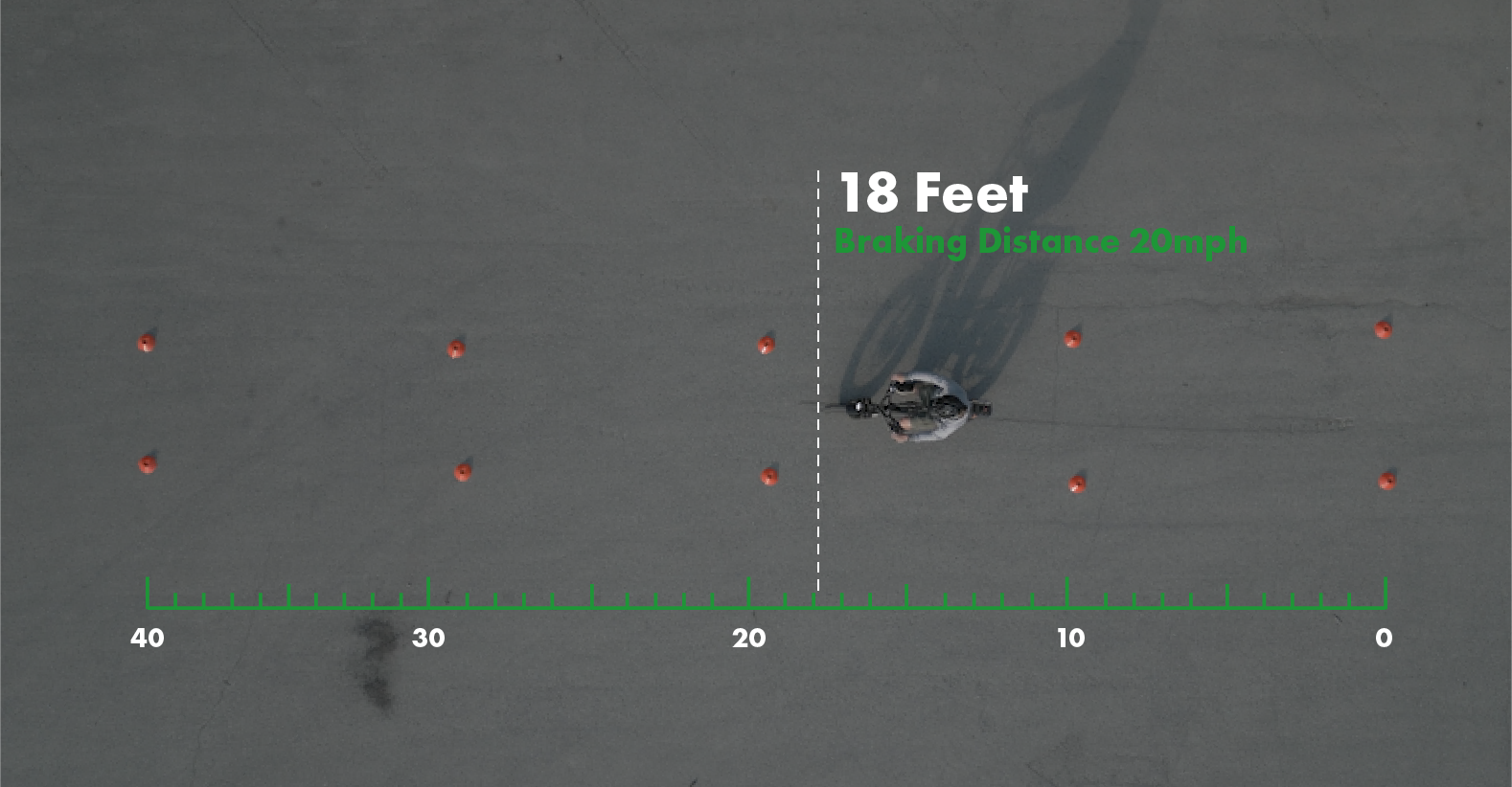

I am a big fan of these Tektro HD-E350 brakes. I find them powerful and responsive with a very nice lever feel. The 180 mm rotors are well-matched to the size of the bike and combine with the larger tires to bring the bike to a quick stop.
I am happy to see a nice brake setup, and it goes a long way to making this bike feel well-controlled at speed or when loaded with cargo. With a maximum payload of 350 lb, it’s essential! So this is a big plus for the bike, and every time I needed to slow down I was happy to be using these Tektro brakes.
Braking Distance Results
Braking Distance
20 mph: 18 ft

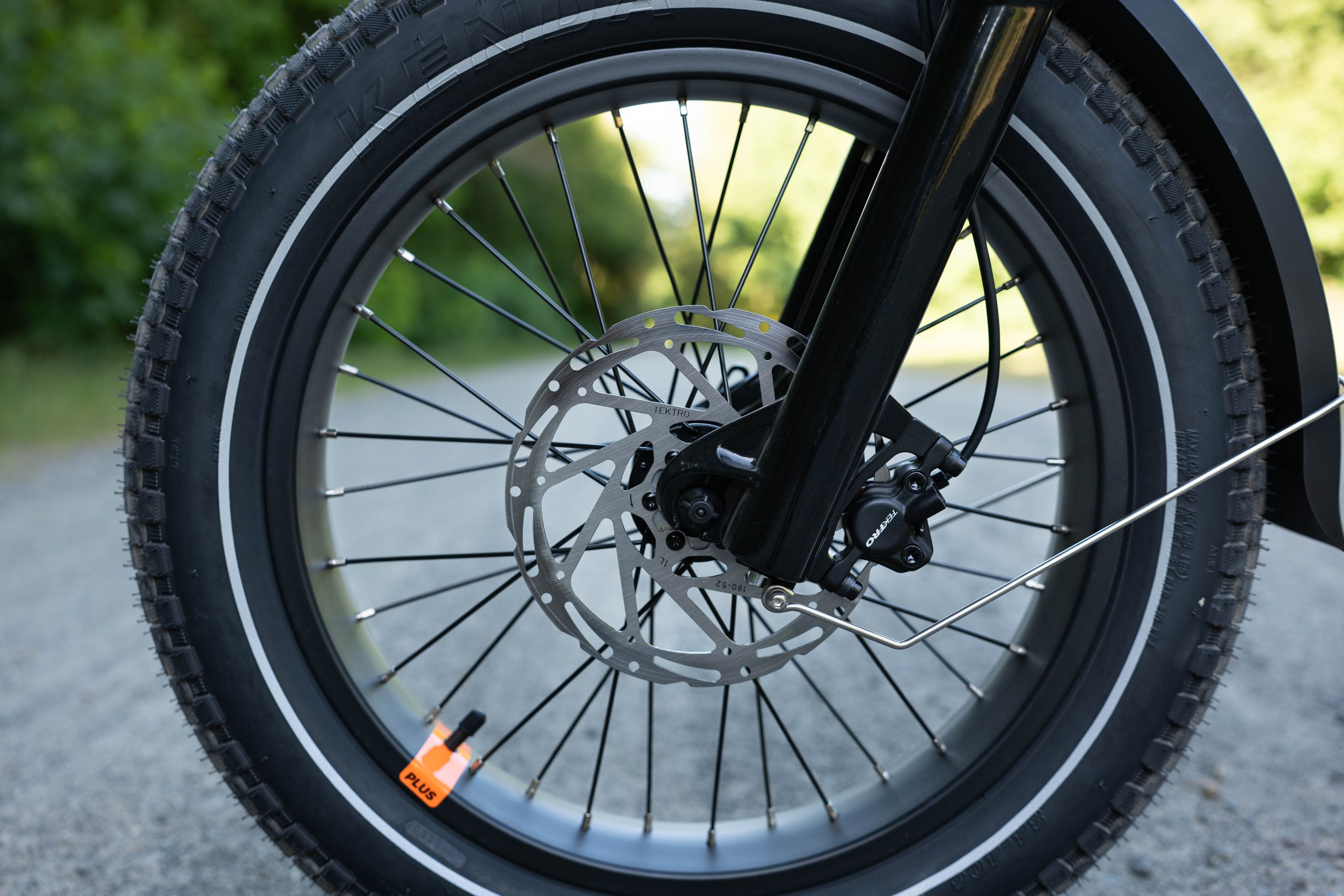

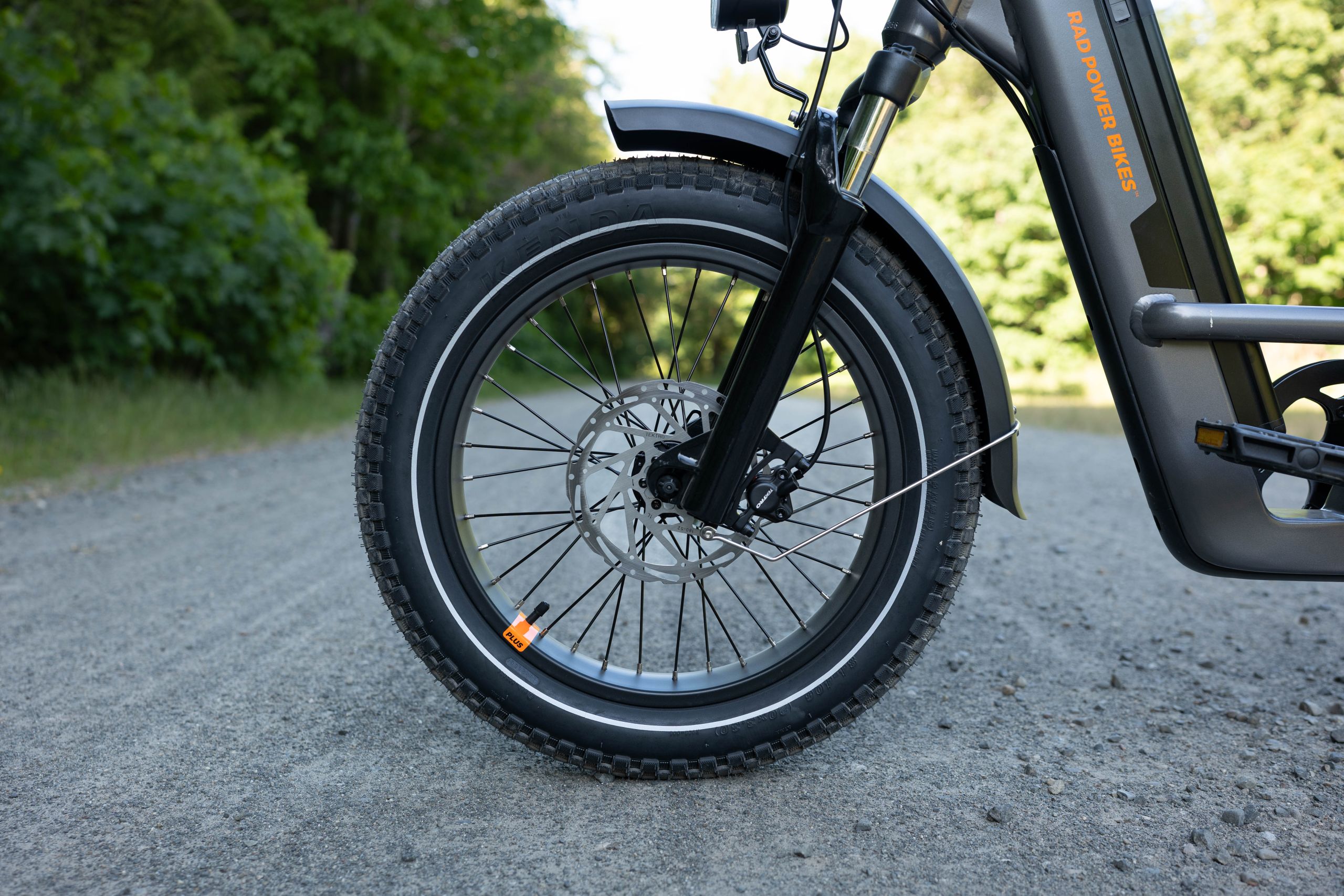

Front Wheel
Wheels, Tires
It’s not something you see on every bike, but Rad Power has gone the extra mile and collaborated with Kenda to create a custom tire. The Kenda K-Rad K905 is a fat 20”×3.3” checker-pattern tire that works great on a mix of pavement and other surfaces.
The bike’s performance was impressive over bumpy ground or rough terrain like gravel, sand, and dirt roads. With no rear suspension, items like the tires are really working hard, and these offer good bump resistance and nice float over loose gravel.
On the pavement, these tires accelerate well and offer a pleasant ride quality. They remain confident at top speed, while carving into corners in the wide arc you would expect from plus-size tires.

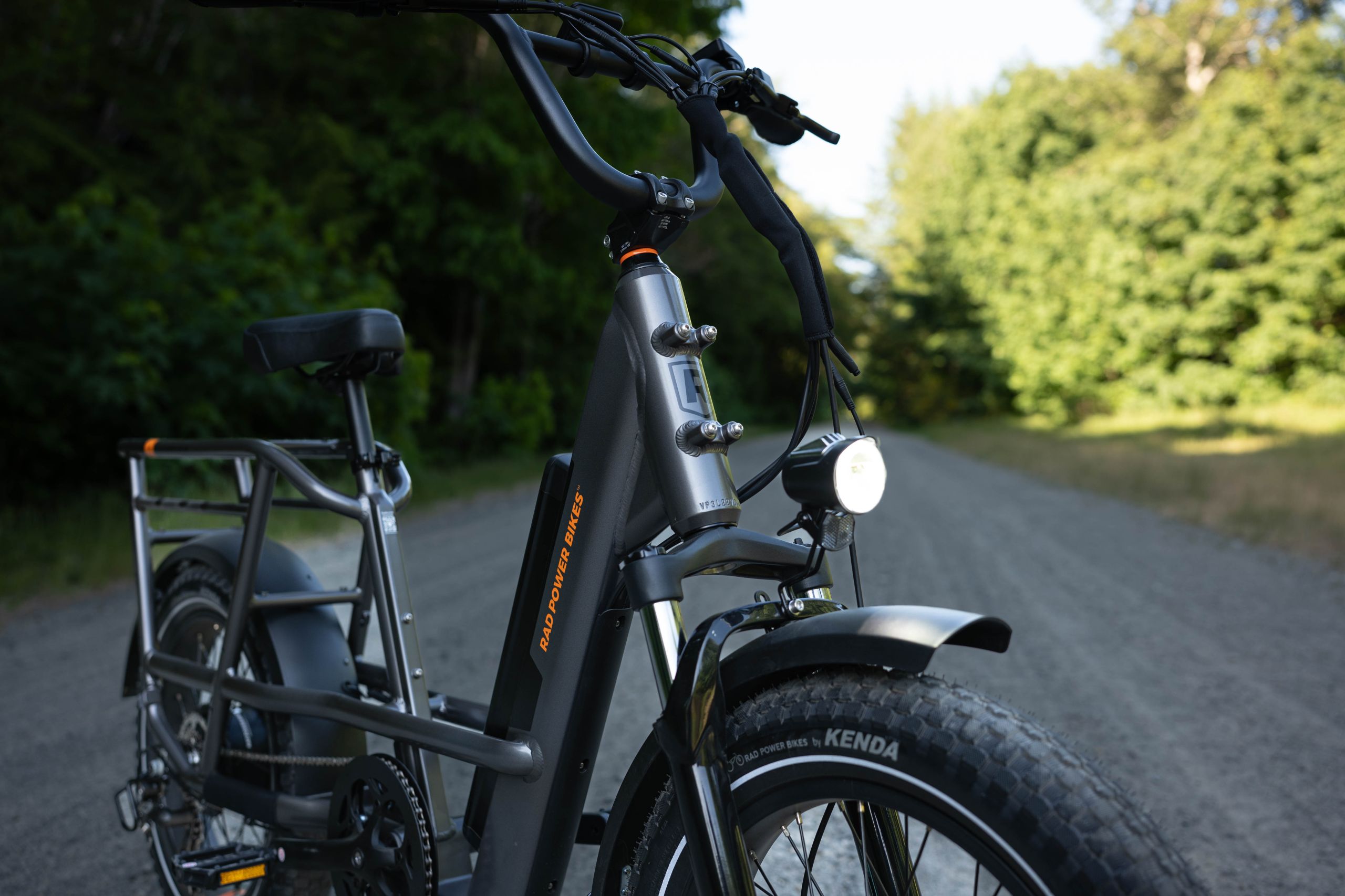

Front Light
Safety
The RadRunner 3 features a 100-lumen headlight and rear brake light. The brake light is controlled by the brake lever and also illuminates for visibility when the lights are turned on. The bike also features reflective halos on each side of the tires to increase nighttime visibility.
Rounding out the safety features, we have a good set of Tektro brakes with motor inhibitors on each brake lever to ensure power is cut to the motor the moment you choose to stop.

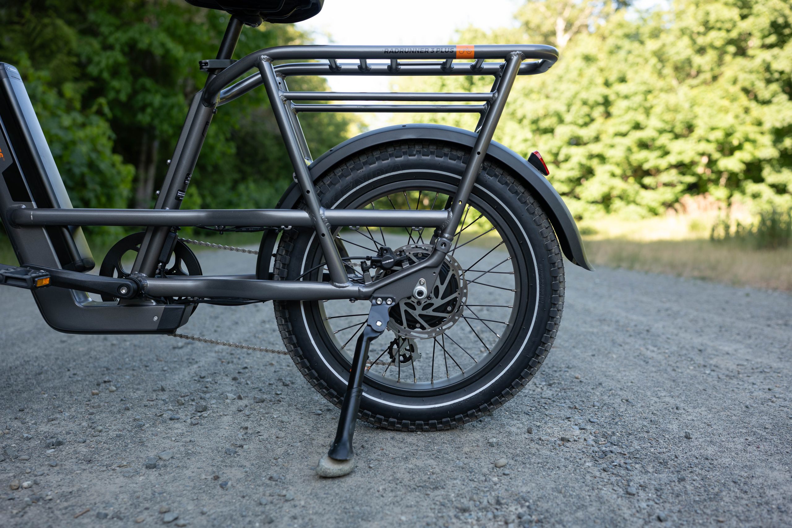

Kickstand
The RadRunner’s single-sided kickstand works well as a nice companion for holding the bike upright. There are additional attachment points if you want to fit a double-sided kickstand.

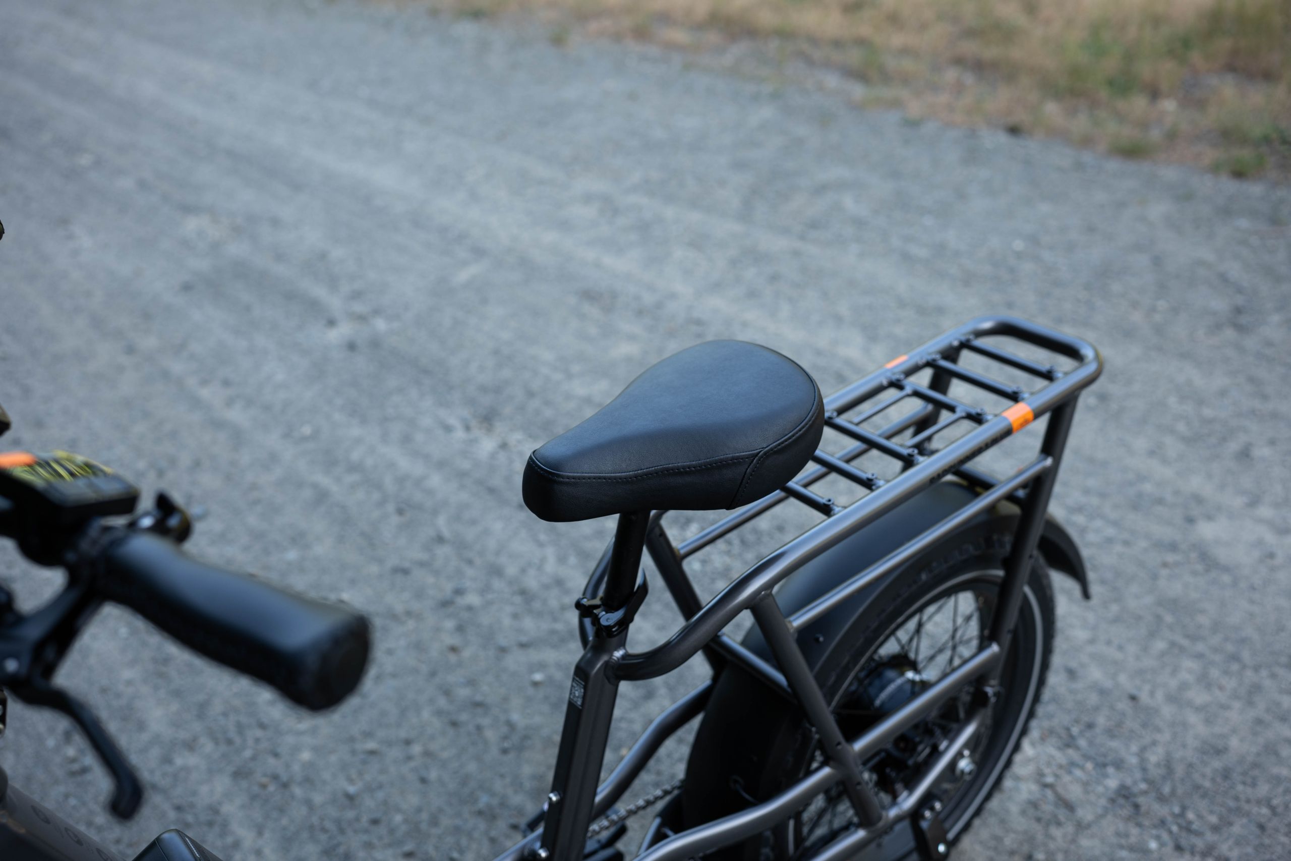

Seat
The seat is an apparent upgrade from the original RadRunner seat and it features more padding and traditional seat rails. This means you can adjust it and swap it out for another seat or choose to add the SR Suntour SP12 NCX suspension seatpost from Rad Power.
I found the seat very plush, but with an odd shape. The only way I can describe it is like having a softball between your legs. There was a strange circular pressure and slope to the seat that I am not accustomed to. While not overly uncomfortable, I found I would consistently search for a good seating position, moving forward and back to try to get comfy over time.

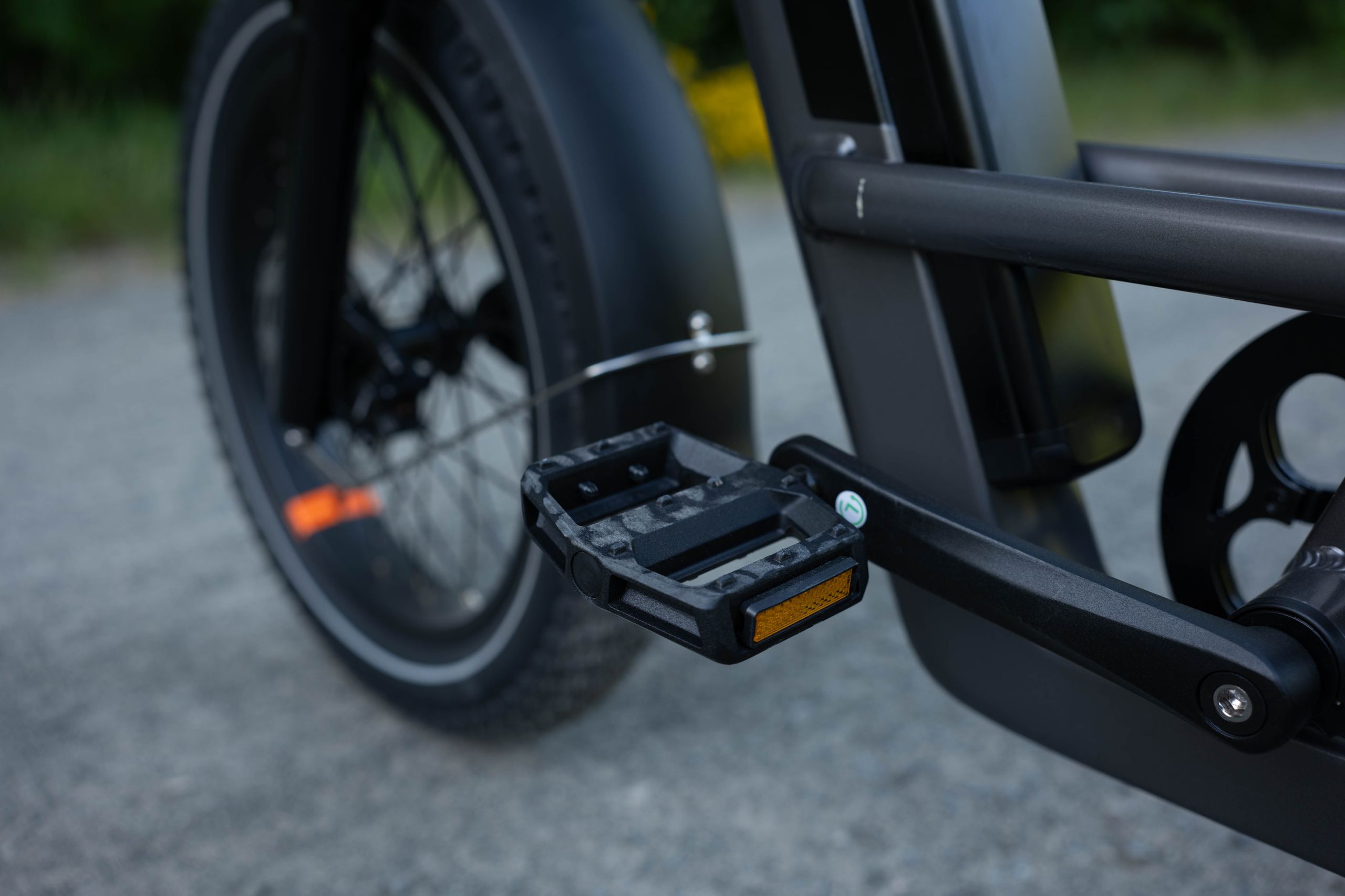

Pedals
The flat unbranded plastic pedals are nothing fancy. They are functional and offer a large stable platform. No problems here.

We got to try out two of the accessories; the Fremont Pannier bags and the RadRunner 3 Console.
The pannier bags are great. They’re made from a durable waterproof material and have sturdy attachment points that match up perfectly with the bike. Easy to install and remove, these bags can be brought with you when parked, but feel secure and safe while in motion.
I love their roll-up top and great capacity. They even have a little velcro tool bag inside for your gadgets and tools, so this is a really great way to increase your carrying capacity while protecting your gear from the elements.
For our second accessory, we have the RadRunner 3 Console. Now, this center console fits perfectly in that slot in the center of the RadRunner 3’s frame. If you opt for the Console, the only thing that you’re really missing out on is the ability to step through the frame. You’re going to have to swing your leg over the back of the bike.
By adding the console, you’re also adding some really valuable cargo space. I enjoyed the simplicity of this little container. It’s very simple to install on the bike. It only requires one spin to attach it and it’s quite easy to line up. And once it’s on, there’s no real easy way for a thief to get this off, other than breaking the whole unit. It’s going to be pretty secure.
You could keep some valuables in there and it’s going to really keep them safe from the weather, so I’m a big fan of this console. When combined with one or two rear Fremont Pannier bags, it really turns this unit into a very capable commuting bike.
