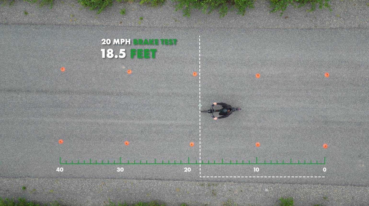

  • In brake tests, the Rambler Premium achieves "better results than most e-bikes" reviewed by one expert.

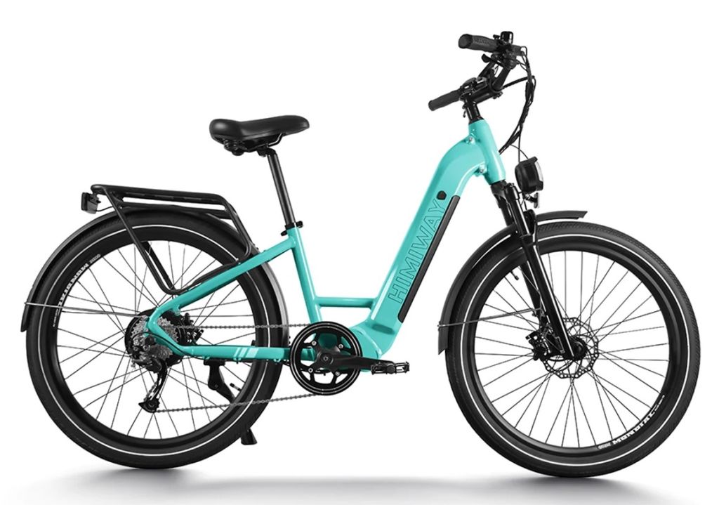

The Himiway Rambler is a step-through electric city bike available in three builds. The base and Upgraded builds have hub motors; the Rambler Premium has a mid-drive. Reviewers complain about the display and report underwhelming climbing performance from the hub motor. However, the mid-drive performs well on hills. The Rambler earns praise for its comfort, stability, and riding range, while ample carrying capacity and commuter accessories add functionality. Overall, testers feel the Himiway Rambler, available at three price points, is a good choice for a range of commuters.

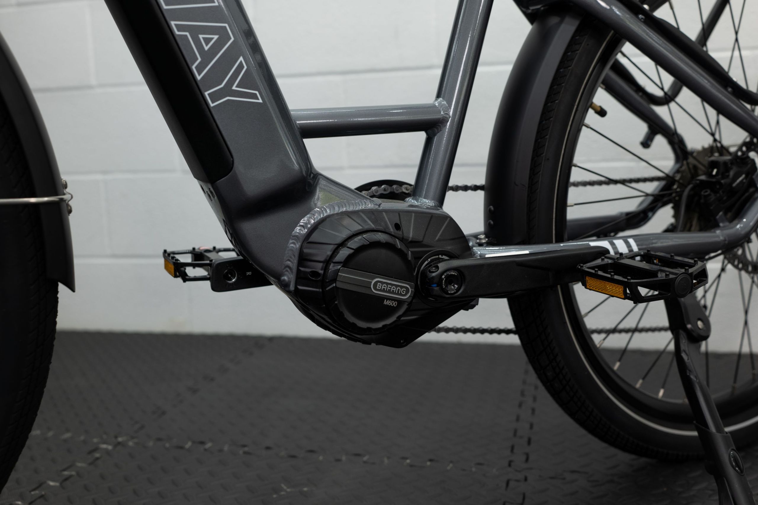

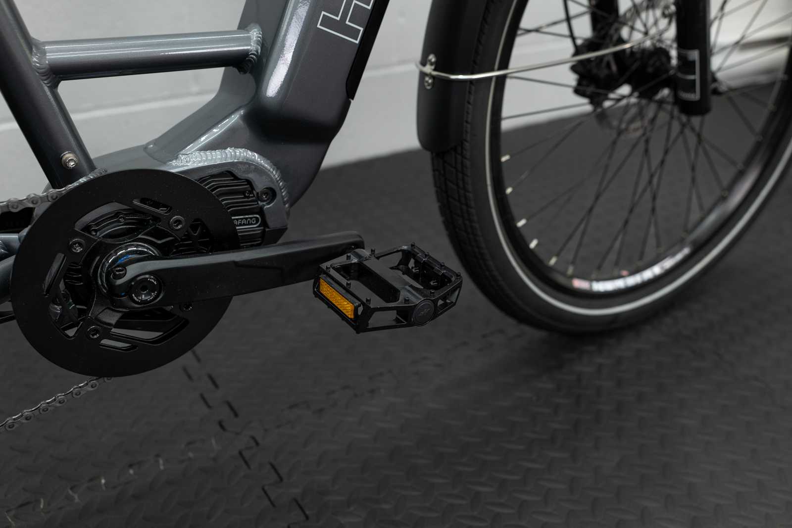

Responsive Mid-Drive Motor
The M600 Bafang mid-drive motor is a solid inclusion at this price, offering responsive assistance and a natural riding experience. With a torque sensor, the motor’s power output matches your effort when pedaling, making you feel like you have superhuman strength.
The M600 is quiet during operation, generating less noise than a rear hub motor. The inclusion of a throttle in this mid-drive system is a nice touch, as most mid-drives don’t have one. Throttles are particularly useful when starting from a stopped position if you forget to shift to a lower gear.

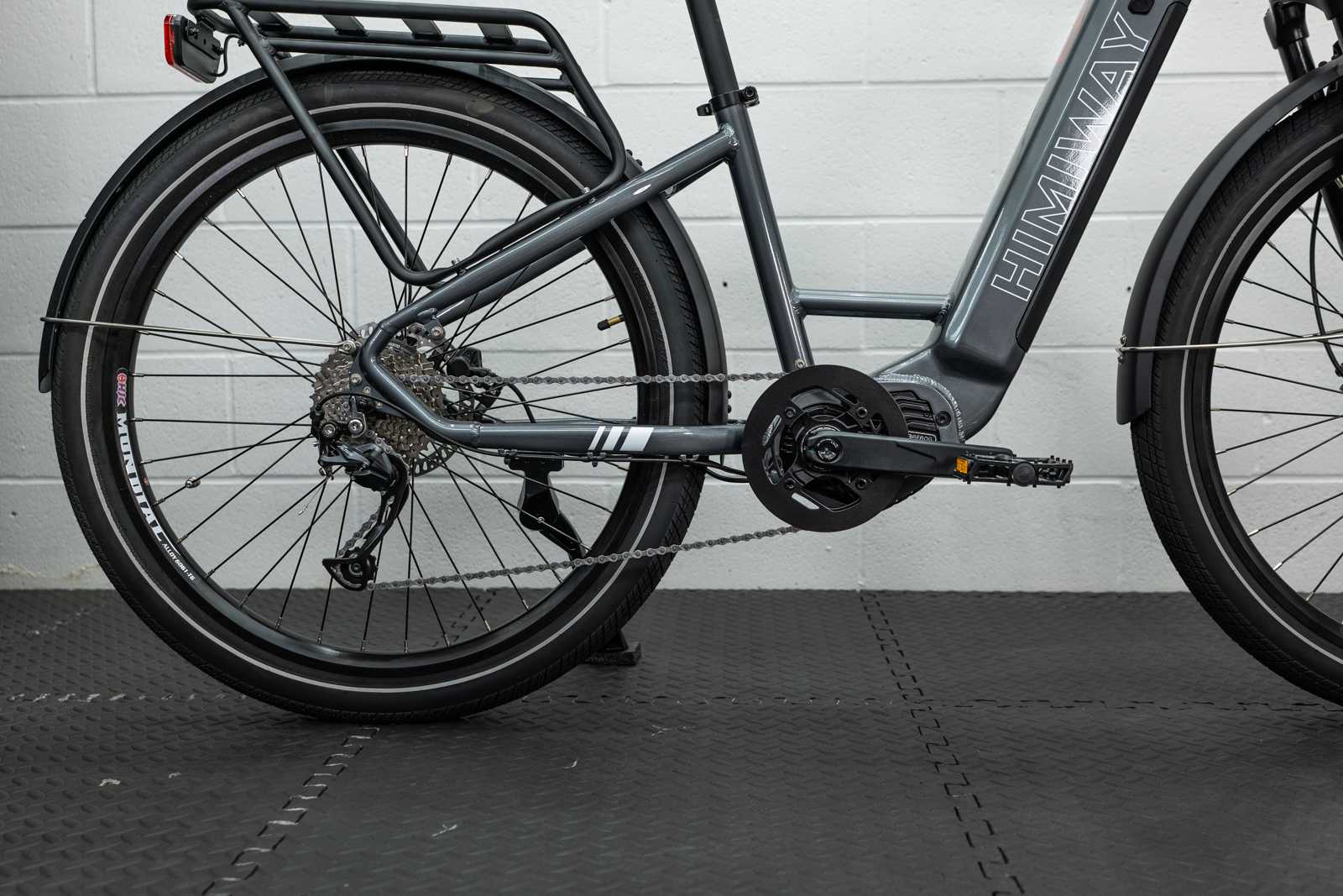

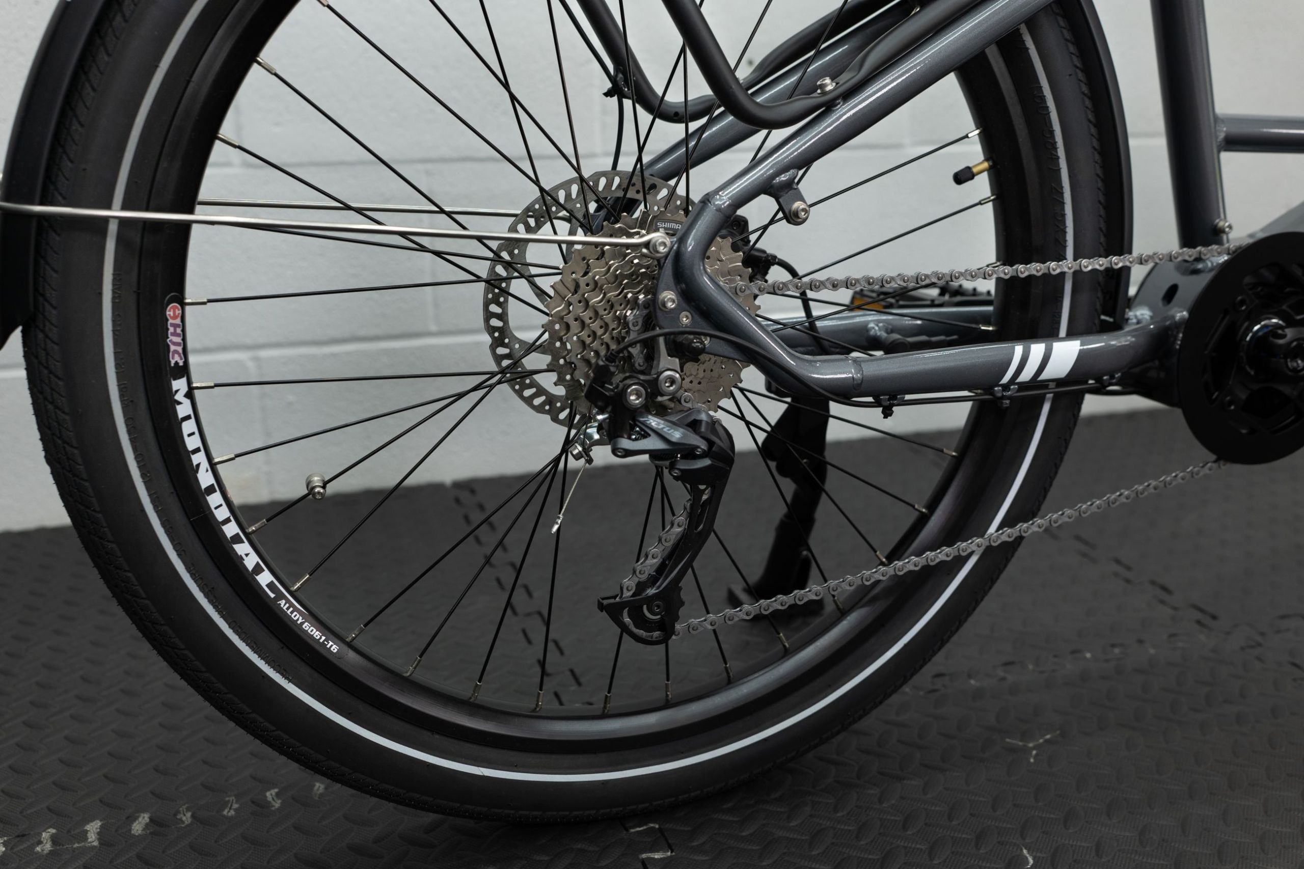

9-Speed Drivetrain
The Rambler Premium has an above-average 9-speed Shimano Altus drivetrain, which shifts better than lower-end alternatives.
The 13-32t cassette and 46t chainring provide ample gearing range. This is important for mid-drive e-bikes that rely more on rider pedaling input than hub-drive systems. With more gearing, riders can find a comfortable cadence at different speeds, get better performance from the motor, and use the battery more efficiently.

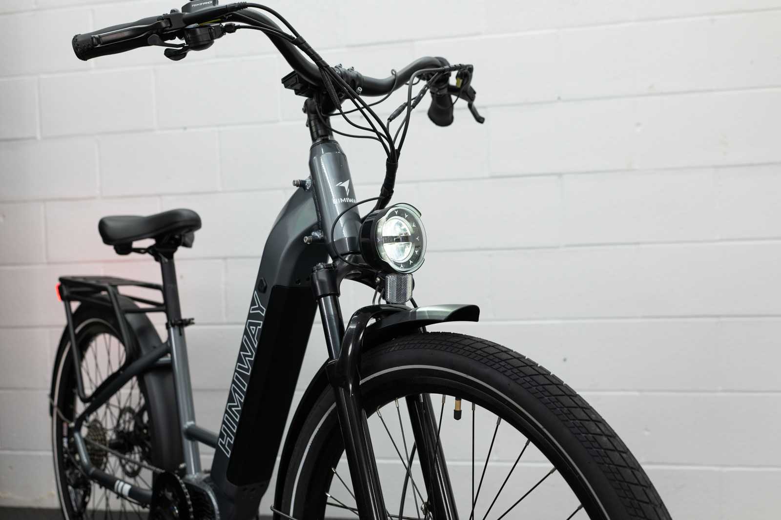

Bright Light With Automatic On/Off
The Rambler Premium’s 500-lumen headlight is large and bright. It can be turned on with the control pad or programmed to turn on and off automatically based on ambient light. This is a great feature for a commuter e-bike. The bike also includes a taillight with a steady setting and a braking indicator. The battery powers both lights.

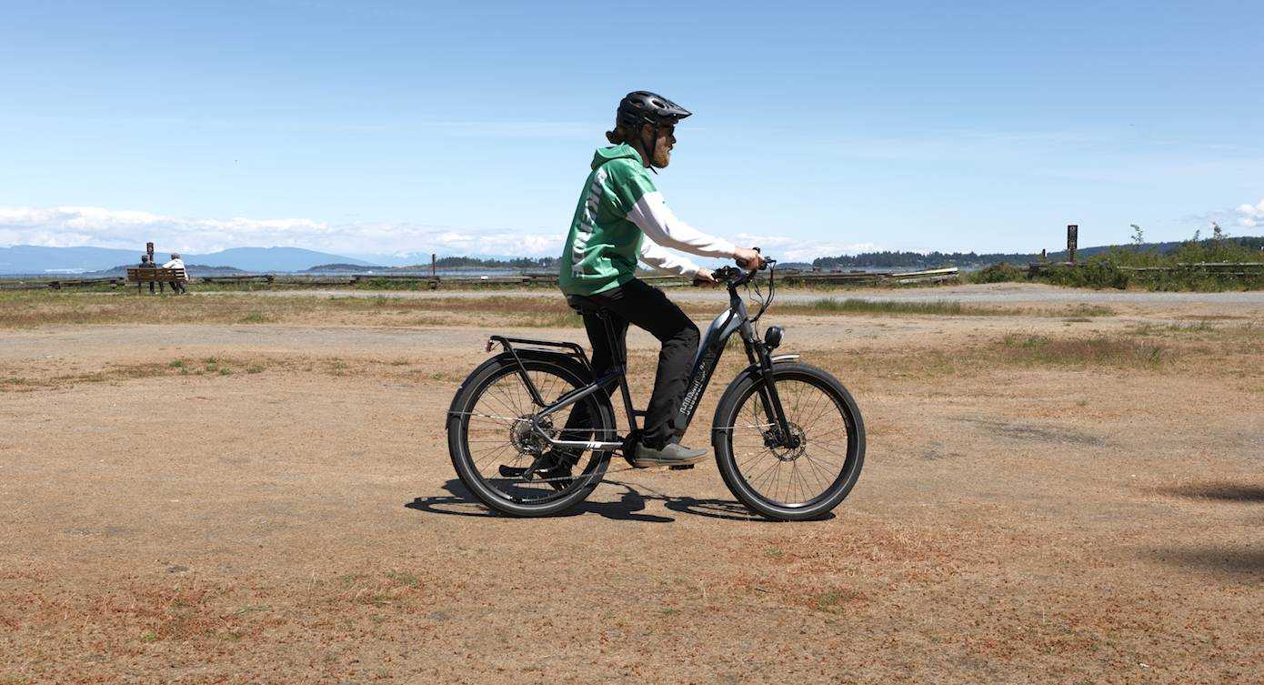

What Does It Do Best?
The Rambler Premium is a Class 3 e-bike with a top speed set at 25mph. The Bafang M600 mid-drive motor is noteworthy at this price, performing well and providing natural-feeling, responsive power output.
The bike also has an above-average Altus drivetrain with a 9-speed 12-32t cassette and 46t chainring. This combination works well with the mid-drive motor and offers crisp shifting performance.
Overall, I enjoyed the bike’s performance and found it easy to control and ride. It’s also fully equipped for city riding with a rear rack, bright lights, and fenders.

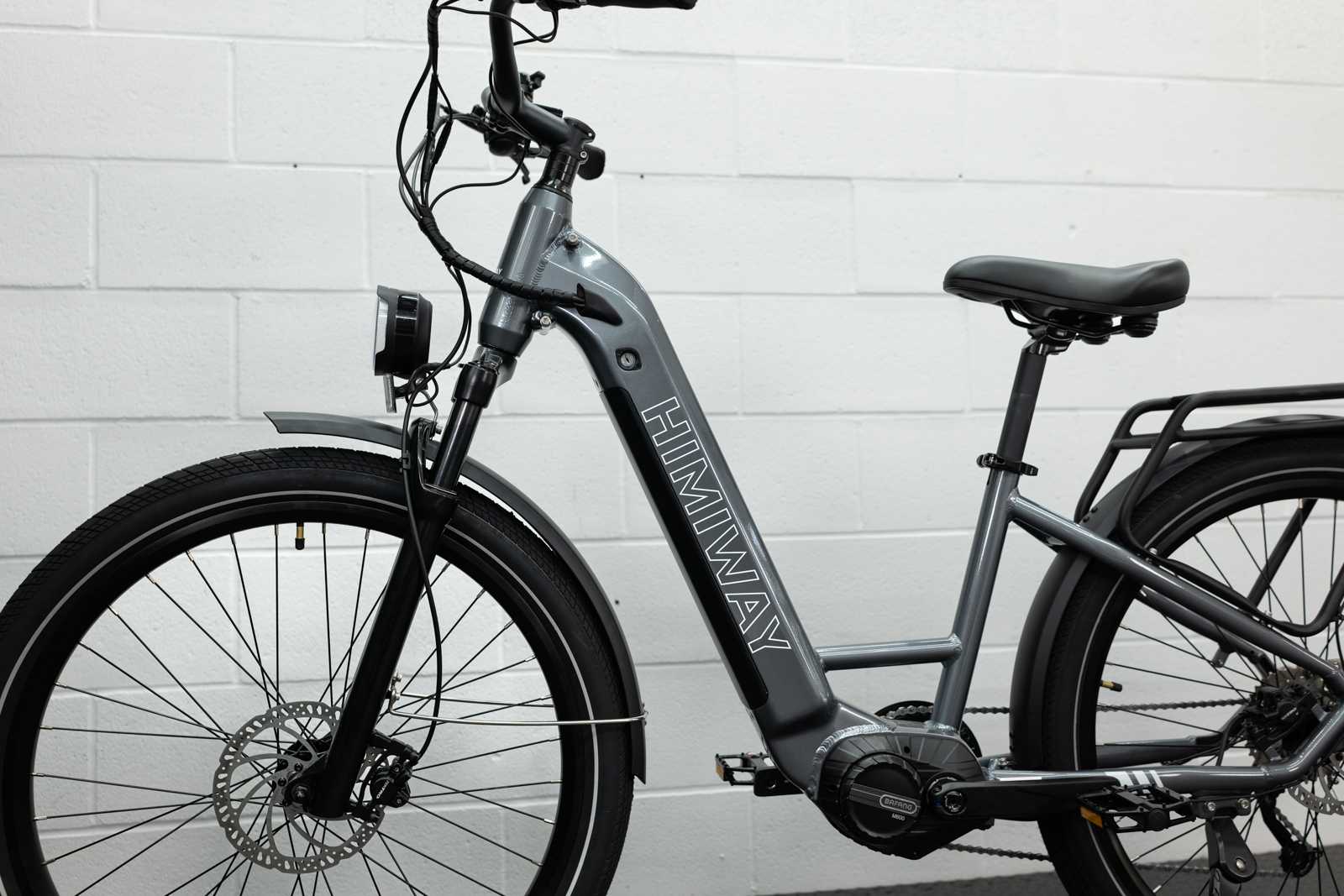

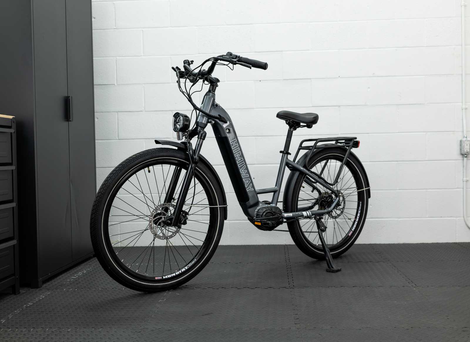

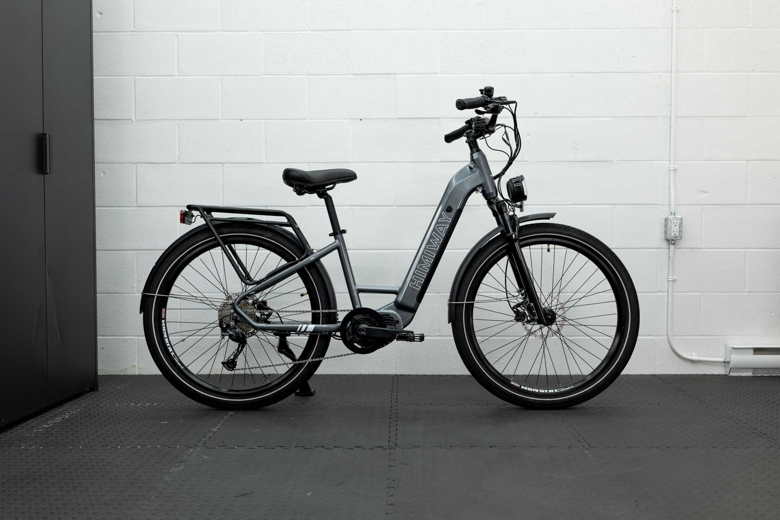

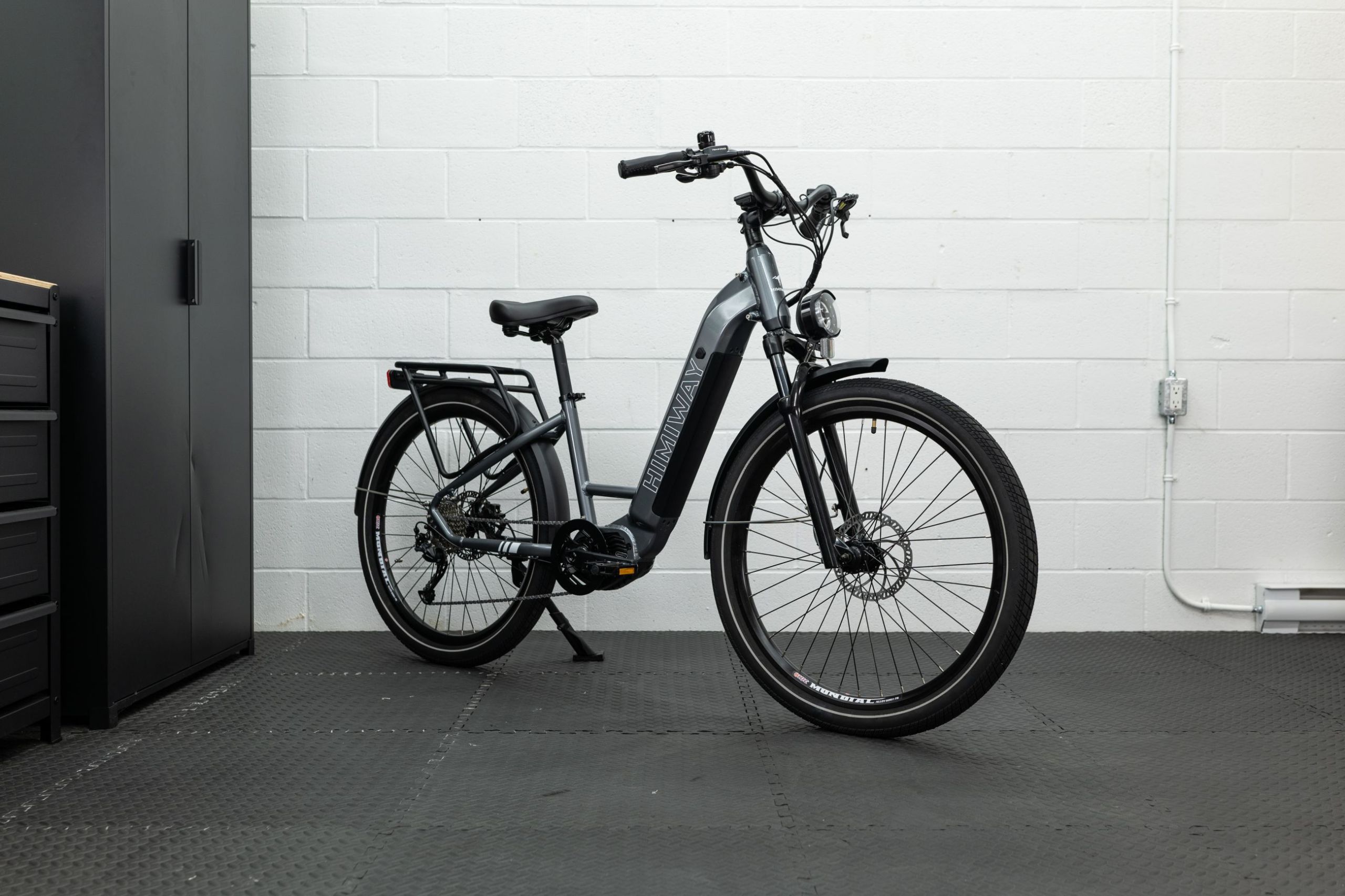

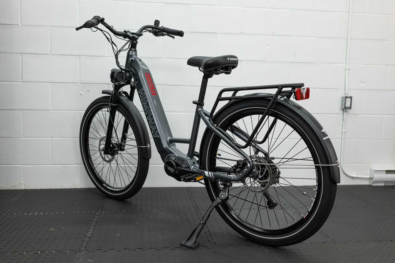

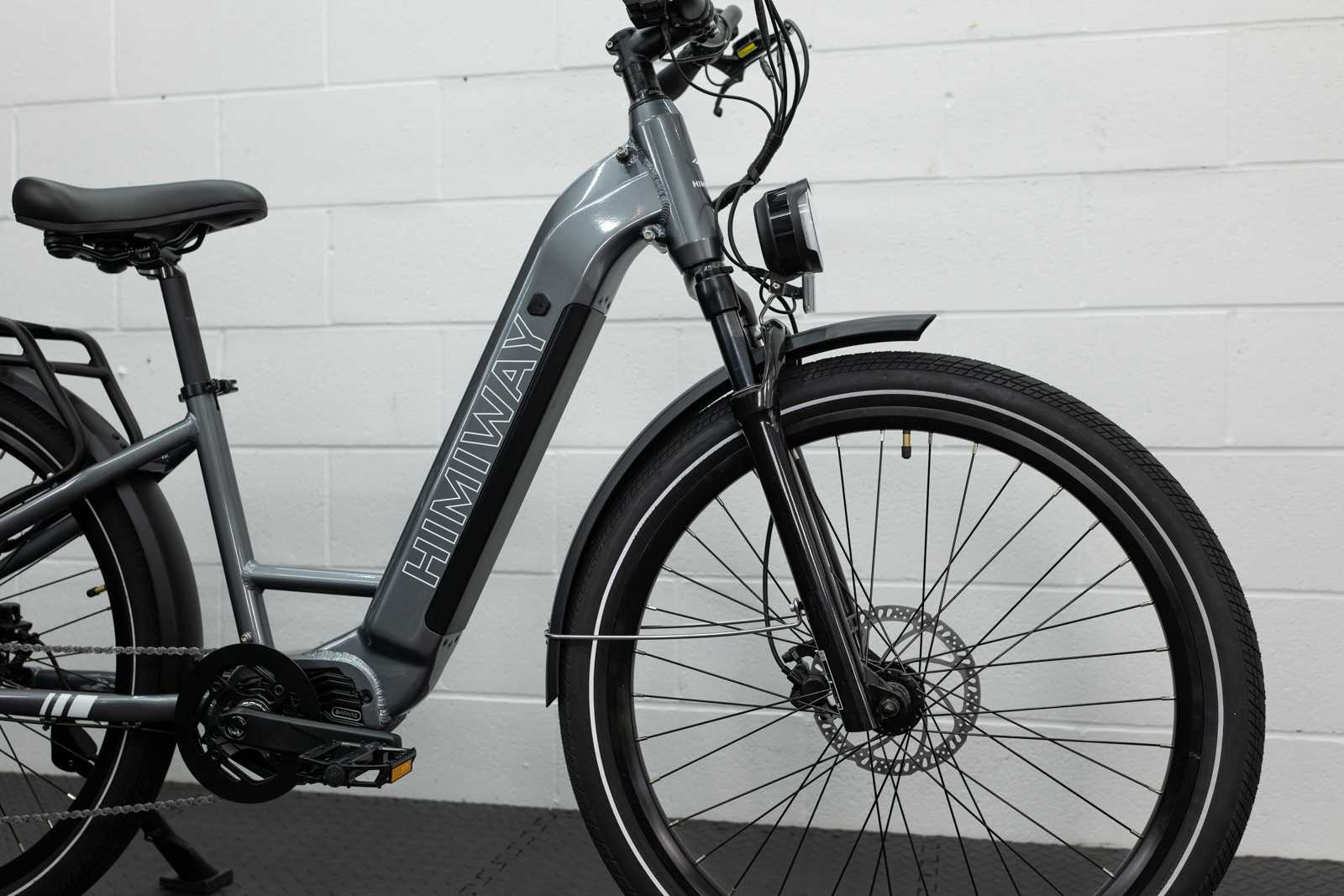

Frame and Geometry

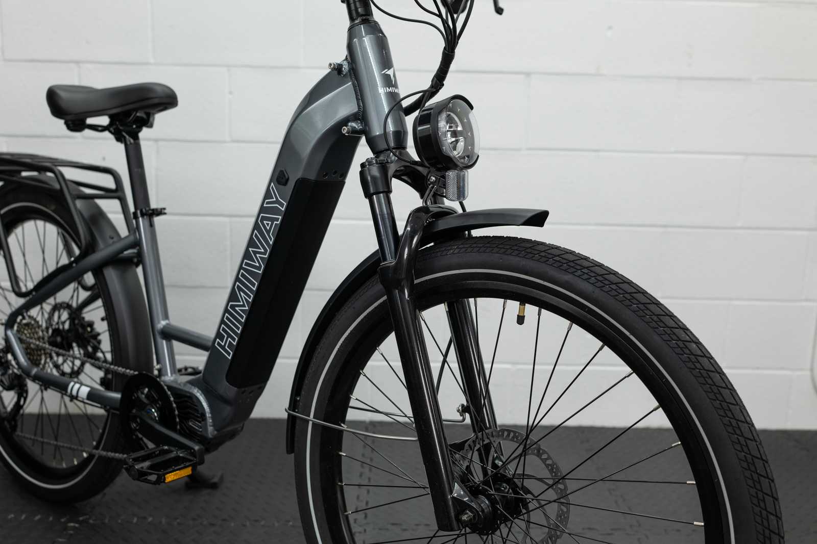

The Himiway Rambler has a sleek step-through frame that’s easy to mount, even when loaded with cargo.
The frame flexes considerably during use despite the additional tubing reinforcing the lower section. This side-to-side flex is especially noticeable on bumpy terrain, raising doubts over the frame’s strength.

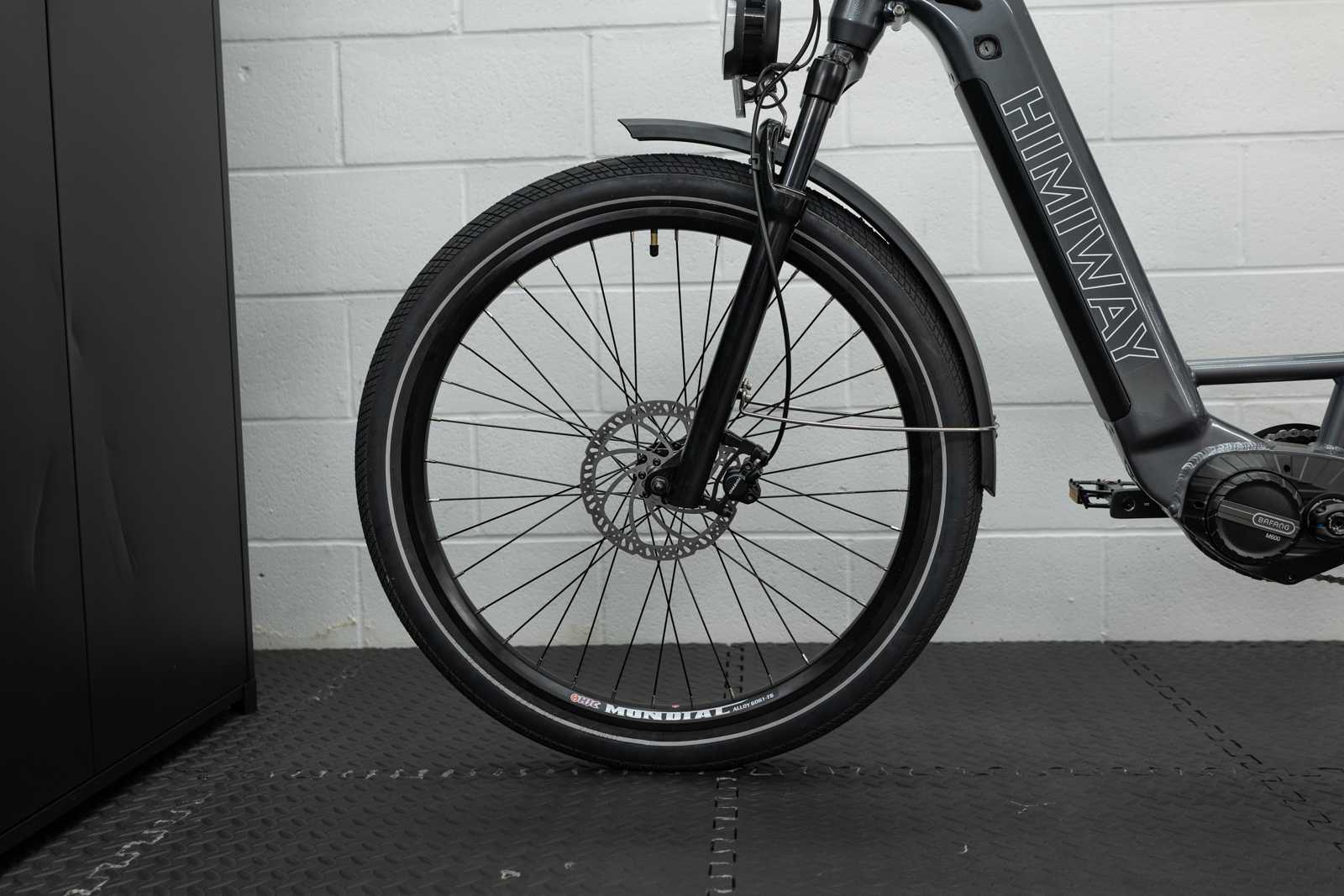

The Rambler Premium comes with a short-travel 80mm air suspension fork, a nice upgrade over the more common hydraulic coil suspension found at this price. The fork’s pressure wasn’t correctly tuned out of the box, sitting at 70 PSI, causing it to bottom out from small impacts. A shock pump is required to increase the air pressure. I adjusted the fork to 105 PSI, which improved its performance.
The Rambler’s one-size frame has a stated height range of 5’2″ to 6’4″, but this is exaggerated. As mentioned, at 6′, I can’t get full leg extension, so the bike certainly wouldn’t be comfortable for taller riders. A realistic height range would be 5’2″ to 5’10”, though some users up to 6′ tall may enjoy riding it.
Seat Tube: 15.5 “(394 mm)
Reach: 17″ (432 mm)
Stack: 19.2” (488 mm)
Stand Over Height: 18.1″ (460 mm)
Virtual Top Tube Length: 22.2″ (564 mm)
Min Saddle Height: 33″ (838 mm)
Max Saddle Height: 38.5″ (978 mm)
Wheelbase: 46.4″ (1178 mm)
Claimed Height Range: 5’2” – 6’4”
Measured Height Range 5’2” – 5’10”

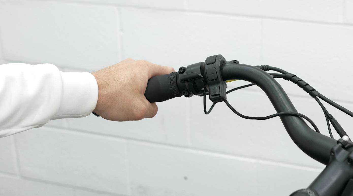

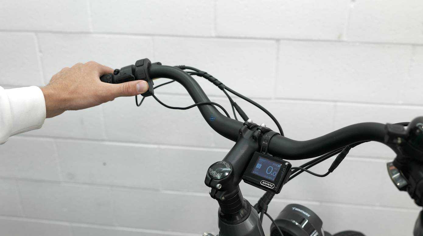

Display and Control
The Rambler uses a 1.75″ black-and-white Bafang display controlled by a three-button pad on the left side. The display has a USB port for charging devices on the go. A key is not required for operation, and the bike doesn’t feature a lock to prevent it from being turned on. The lights are integrated with the bike’s electronics and have an automatic on/off setting.
Battery level is displayed as both a bar and a percentage. Pushing the power button cycles through the different metrics, including max speed, average speed, odometer, trip info, current power output (in watts), and a range estimate. These metrics are nice to have, but the small display is hard to read while riding.
The up and down buttons control the assist levels and allow you to access a walk mode by pressing down until you go past 0 and see a walk icon on the display.

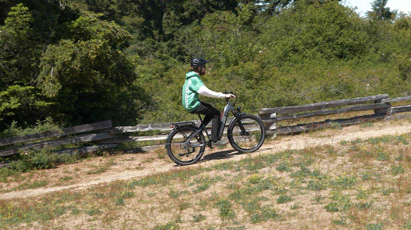

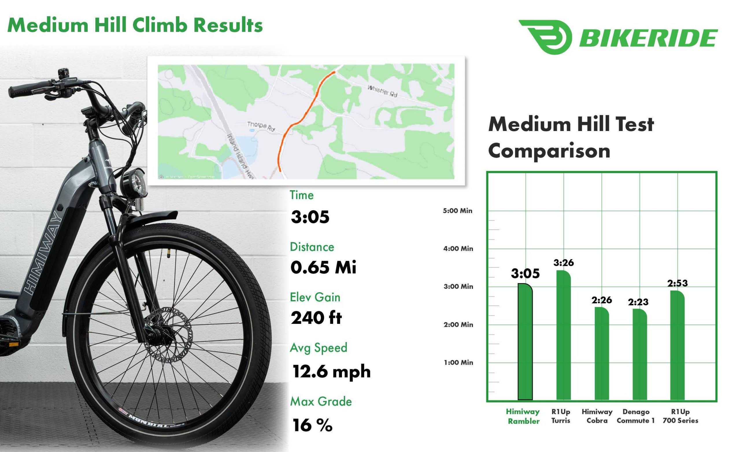

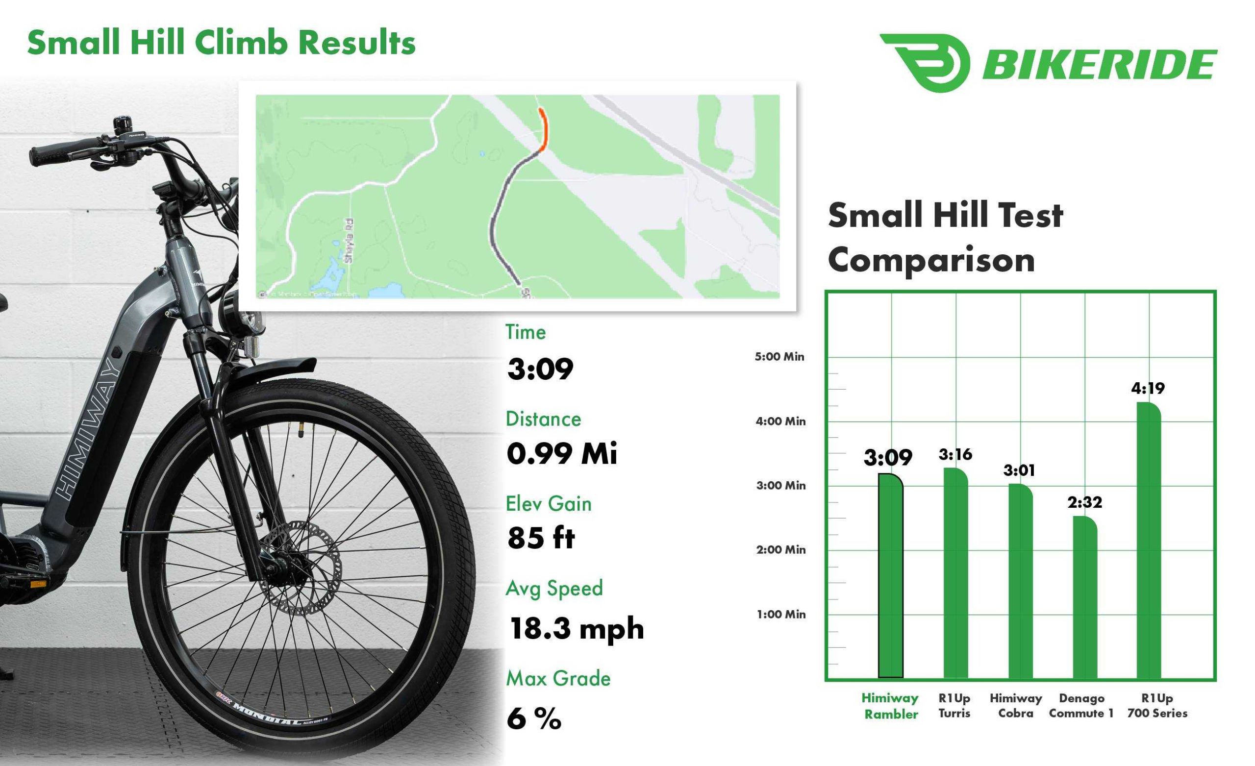

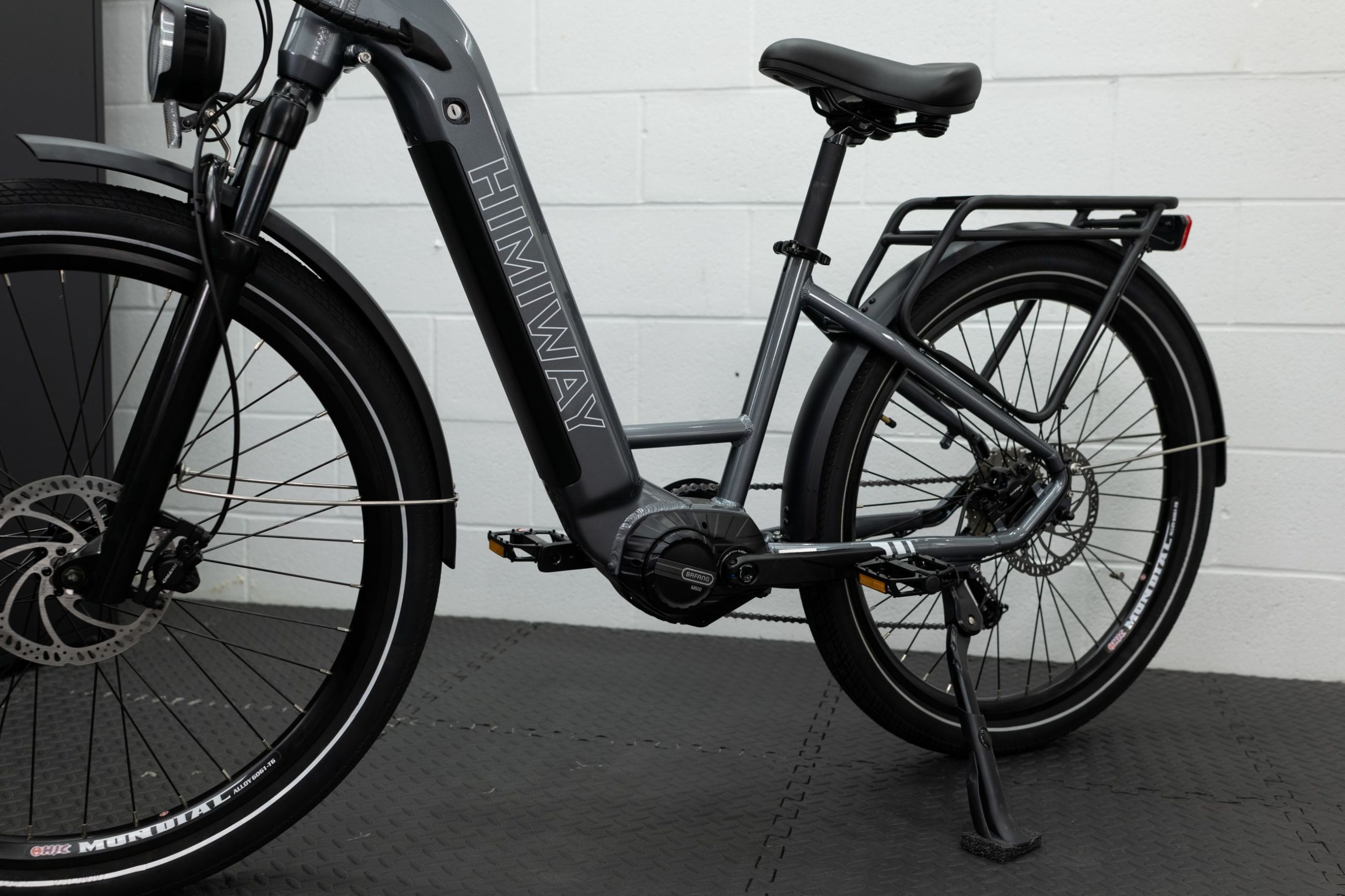

Motor
The Rambler Premium has a 500W Bafang mid-drive motor that provides 120Nm of torque at max output. The motor has three sensors (one torque and two speed), resulting in an intuitive and natural riding experience.

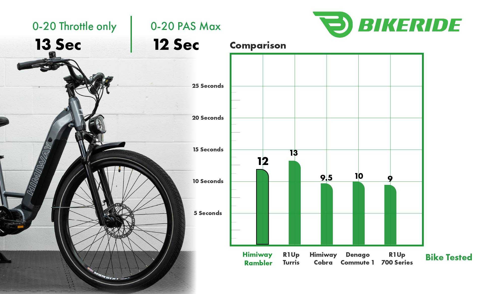

As a mid-drive, it didn’t perform as well in our 0-20mph test as the hub-drive bikes we more frequently test.
When stopping with a mid-drive, it’s necessary to shift to a low gear. Then, to get started again, the rider moves up through the gearing, gradually increasing speed. It’s advisable not to shift the drivetrain while under load to avoid damage, slowing the initial acceleration further. However, when moving, the Rambler Premium accelerates quickly.
An annoying characteristic of the controller’s programming is the large reduction in power when the battery falls below 20% charge. This means that if you have a hill late in your ride, it will require a lot more rider input to maintain speed.
I also found that despite the motor’s high torque rating, it is a slower climber than most bikes we’ve tested. It completed the small and medium hill climbs at below-average speeds.
The final thing to be aware of with a mid-drive is to stop pedaling to shift gears. Doing so will reduce wear on the drivetrain and lower the chance of the chain dropping. Higher-end mid-drives usually have a shift sensor to cut motor power while shifting.

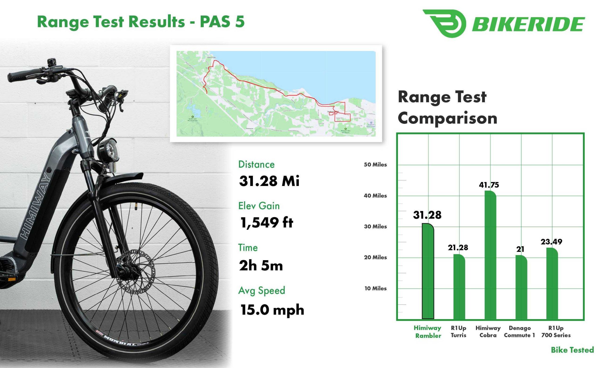

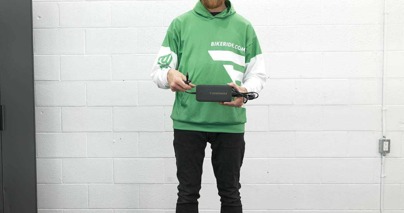

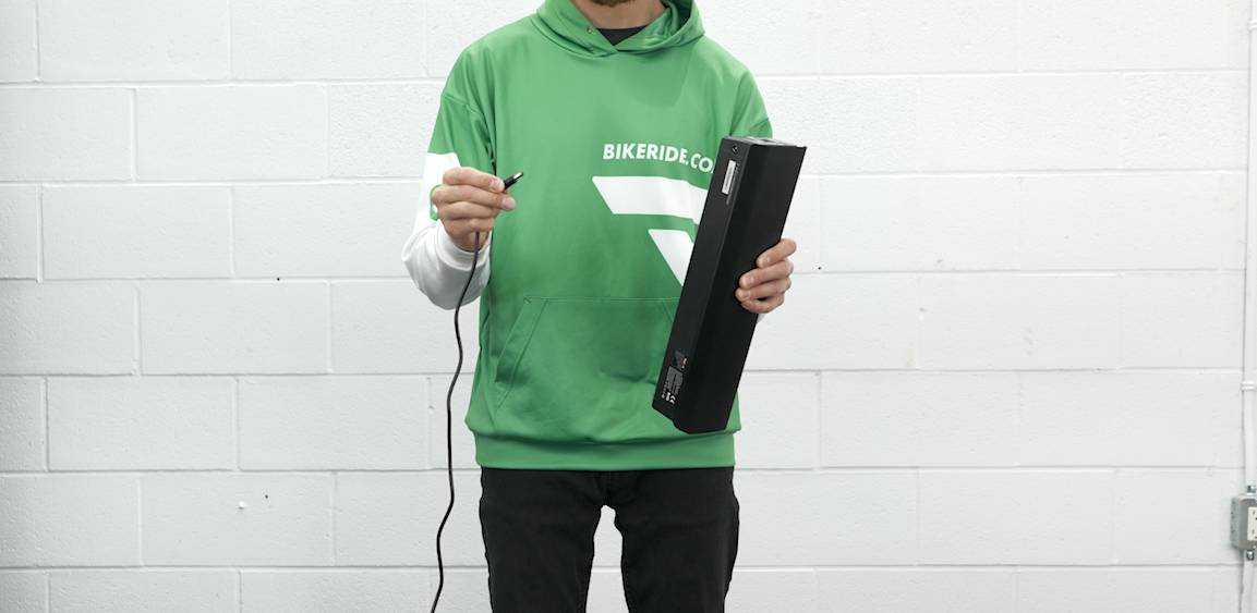

Battery and Charger
The 48V 15Ah (720Wh) internal battery combines well with the power-conscious mid-drive motor, providing solid range. This battery is not currently UL-certified, but Himiway has told us that the UL 2849 certification is in progress.
The bike comes with a 3A charger, providing a faster charge (around six hours) than the more typical 2A chargers seen at this price. The charge port is on the opposite side of the keyhole at the top of the down tube.
In our PAS 5 test on a hilly course, we covered 31.3 miles and 1,549 feet of elevation, averaging 15mph. This range is well above the commuter average.

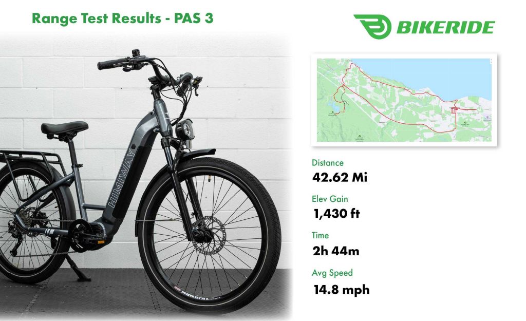

For this and future reviews, we’ve added a PAS 3 range test to reflect a more typical real-world range. The Rambler Premium achieved great results here, covering 42.6 miles and 1,430 feet of elevation at 14.8mph.
Himiway Rambler Range Test Level 3

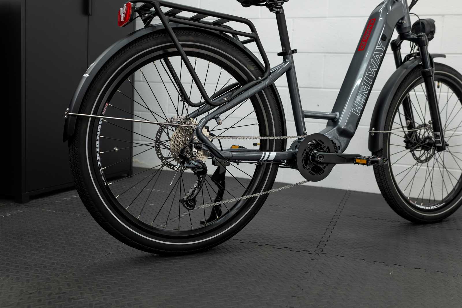

Drivetrain
The Rambler has a 9-speed Shimano Altus drivetrain with a 46t chainring and 13-32t cassette. This gearing is adequate for pedaling at speeds up to 25mph speed limit and on moderate inclines. As mentioned, maintaining a steady, high cadence is key to getting the most from mid-drive motors.
Unfortunately, this bike doesn’t have a shift sensor to cut power to the motor when you shift. Given that, riders must be careful to stop pedaling before they shift.

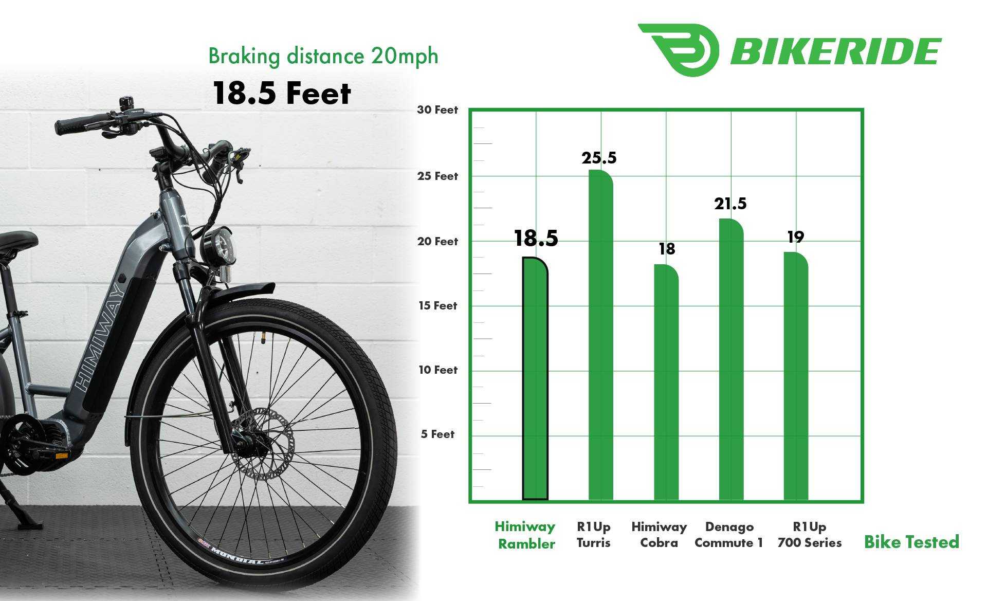

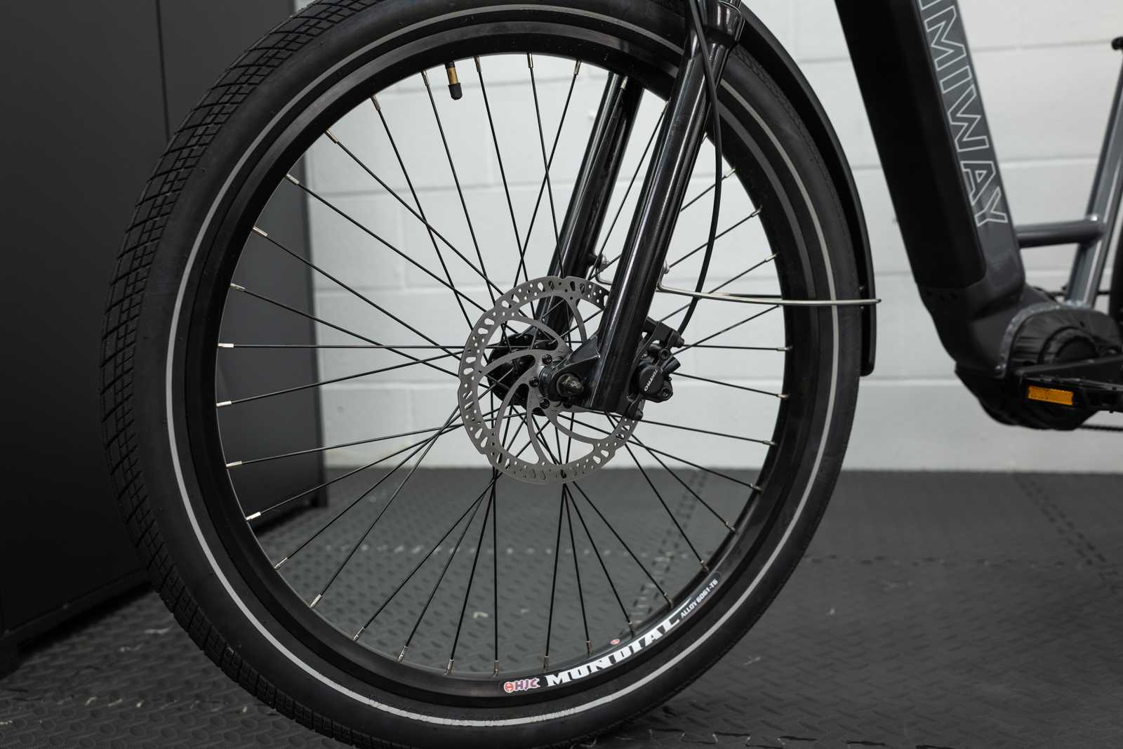

The Rambler Premium has two-piston Tektro HD-E350 hydraulic brakes with 180mm rotors, a powerful set of brakes that offer reliable performance. These are a big upgrade over the mechanical discs on the base Rambler build.
The brakes were quiet throughout testing, unlike many cheaper brake setups. This brakeset has a motor inhibitor to aid with stopping, and the levers are reach-adjustable.
The average braking distance when stopping from 20mph is 18.5 feet, a better result than most e-bikes we’ve tested.

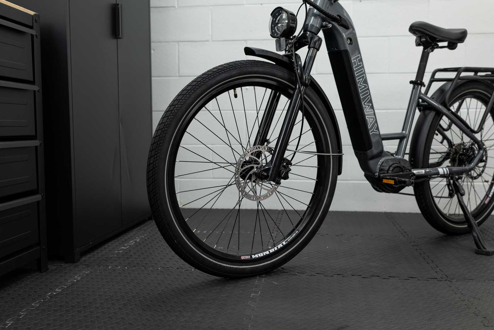

Wheels, Tires
The Rambler rolls on a set of 27.5″ x 2.4″ tires from Innova, an urban tire with a light tread pattern and a reflective halo on the sidewall. These tires don’t have puncture protection.
During testing, the tires performed well on pavement and hard-packed gravel, but they don’t offer much traction on looser surfaces.

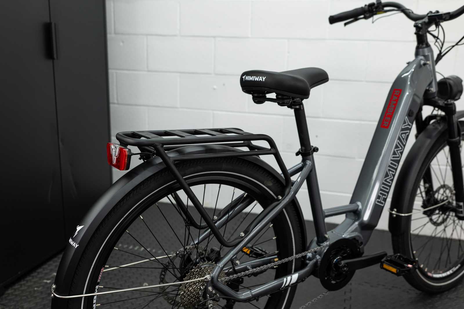

The Rambler Premium has a bright headlight, rear light, aluminum fenders, and a rack. It also has mounting points on the headtube for a front rack.

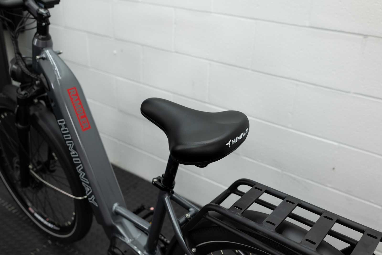

The included rack is well-designed and has a weight capacity of 33lb. The taillight is attached to it and has a braking indicator. Both lights can be operated using the control pad or set to turn on and off automatically.
The aluminum fenders offer good coverage and do not move or make noise while riding. Finally, the Rambler has a typical single-sided kickstand, which is stable.

The saddle is by Selle Royal. It has a wider base than sport-style saddles and is comfortable and well-suited to the bike’s commuter designation. I found it comfortable even on the 42-mile range test.
Himiway chose standard aluminum platform pedals for this bike. These offer fine traction for most shoe types, and the small metal pegs are better than the plastic pedals on similar bikes.
